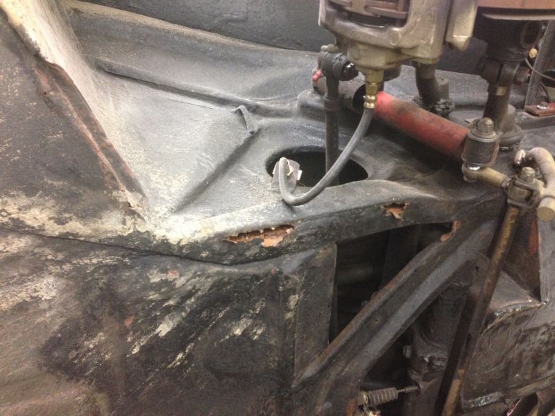

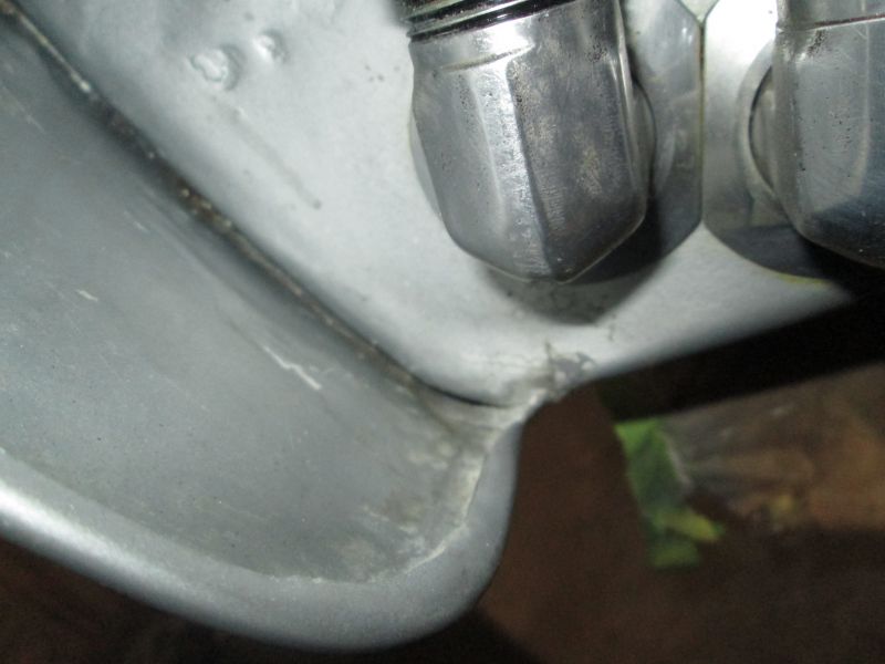

            • This is the best pic I have at the moment, although the outer flange as been bent the wrong way from years of driving. The cars I've looked at have the metal crimped over...however on the repair Jack and I are doing to a 1960, where we're replacing the longitudinals we are planning on NOT crimping it over so it doesn't become a dirt/mud trap.

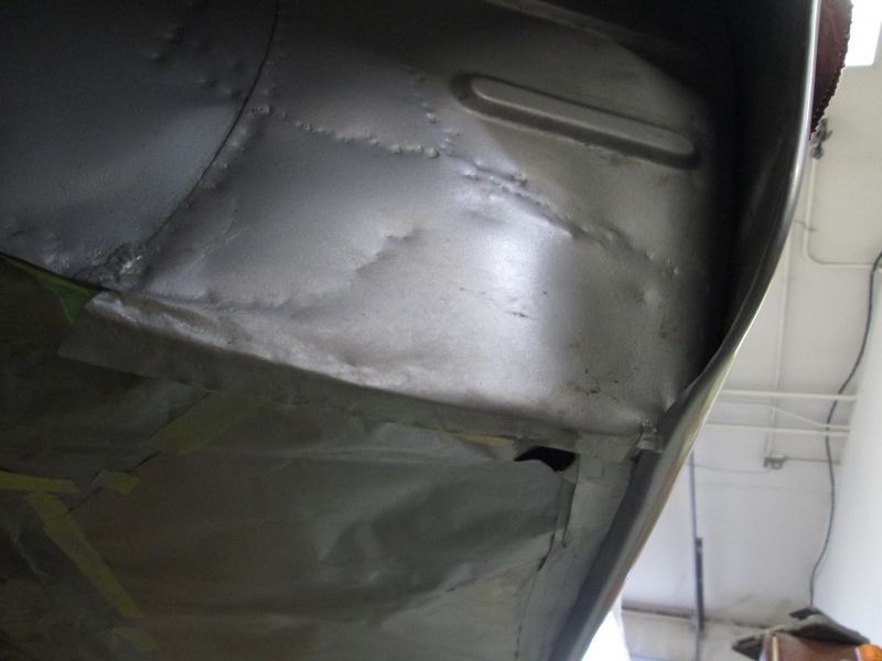

              • Thanks for comments one and all on the transition issue on rocker to wheel well rim; as its not clear to me 100% yet I decided to leave it till I get more info. and move on to the rear well.

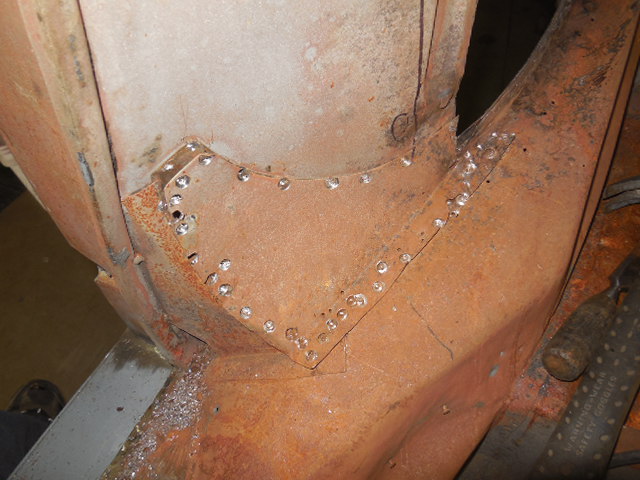

                As you can see some metal "guru" plated it using the "toothpaste" approach to welding

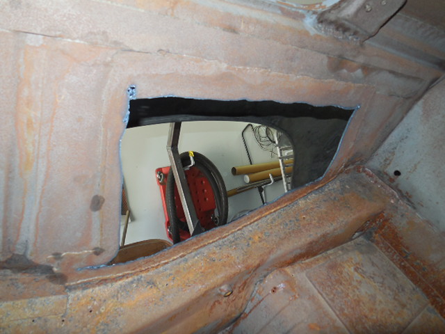

                First step was to get the plasma cutter out to roughly remove the repair.
                and then use a thin cutter wheel to get back to where I hoped I could insert the repair patch. Optimistically, I thought the 3 recesses that help give strength to that panel, would align with the old recess and I could 'hide' the top weld behind the metal strip that carries the 1/4 light trim bar.
                Close but not close enough, so I had to cut further back, upto the top edge/ledge, and also take out the longest recess which is closest to the door opening. My repair hole is getting bigger but the repair panel is for the whole of that section, so I have plenty.
                Another reason I was hoping to leave the longest recess was that I wouldn't have to remove the inner small support plate; so that came out first ...

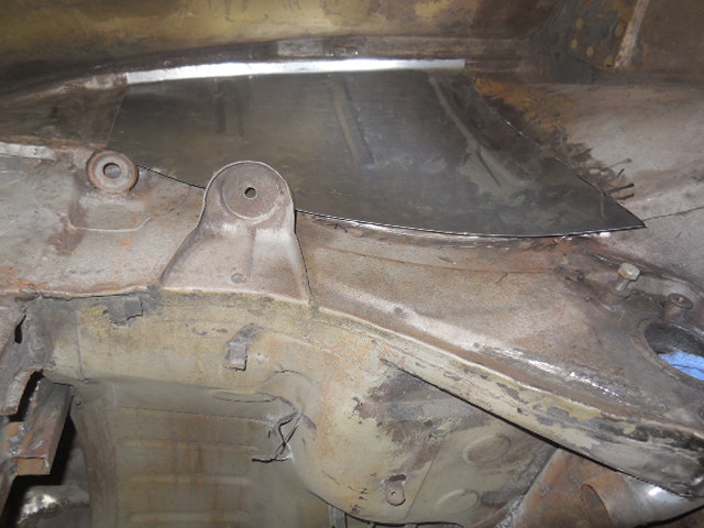

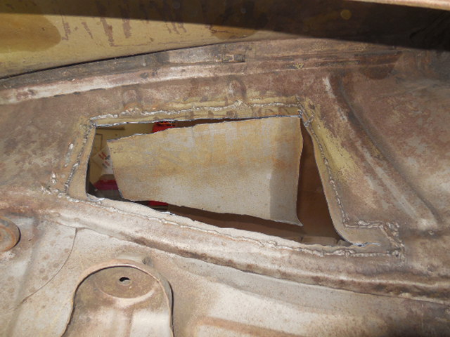

                Then I roughly sized the repair panel and offered it in. For once I think the curves will work and it "shouldn't" be too bad to sort out.
                I had to create a new bottom edge/lip, lost 80% of the original in the cutting out, but that was a nice simple diversion. The three pen marks up by the quarter window, are the center marks for the 3 recesses - so the panel all has to slide forward; I think I have allowed enough margins

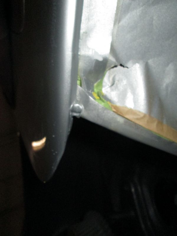

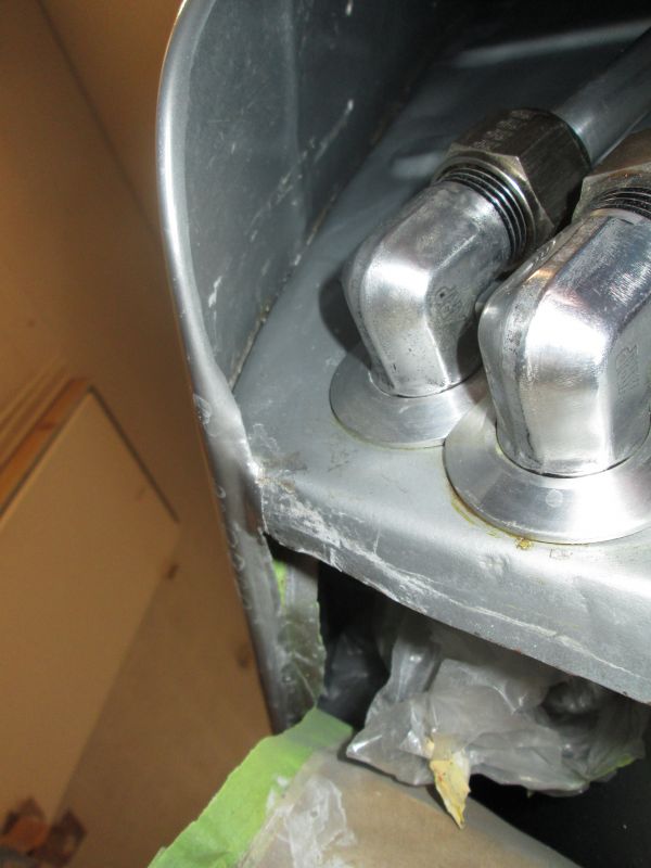

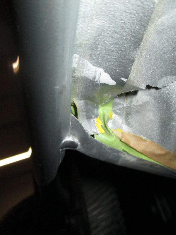

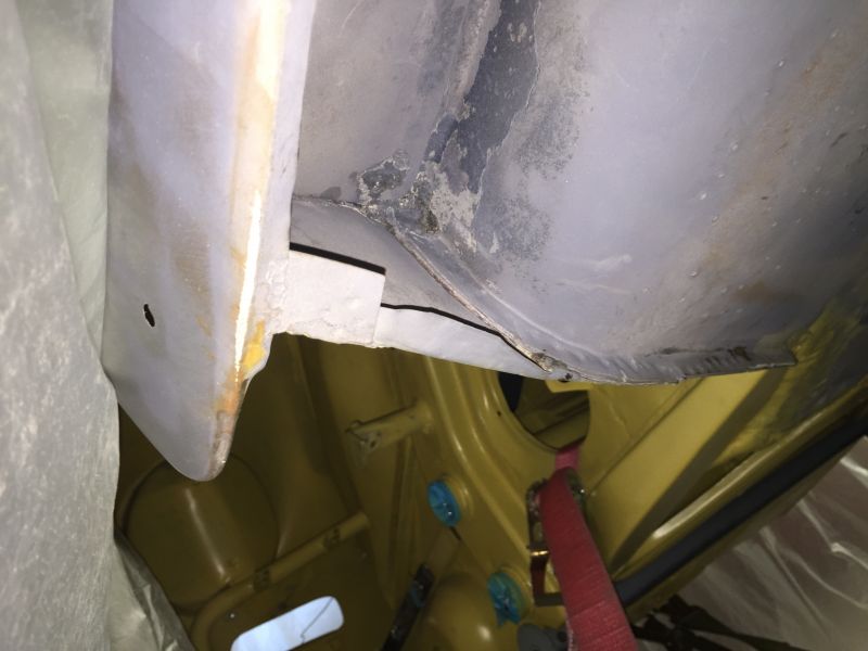

                • Here's how my rockers were attached to the splash pans:
                  On the right side the rocker lip was relaxed around the flange with a seam weld.
                  This created more contact surface which trapped grime and water and eventually rusted through the rocker skin a little.
                  Reproduced the way it came anyway.
                  The left side was done differently as splash pan was hammered in to accomadate the rocker flange.
                  A little button of weld was used to secure it. This is factory untouched BTW. I would recommend doing it like this as the contact points are much more airy impeding decay.
                  Lower flange does not get hammered tight against the longitudinal instead it slowly relaxes to about a 30 degree angle as it makes its way toward the center. Note too the little seam weld detail on the edge of the two panels. Hope these answer your questions on this area.

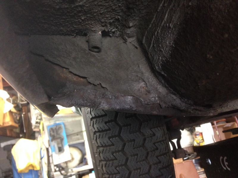

                    • Steve,

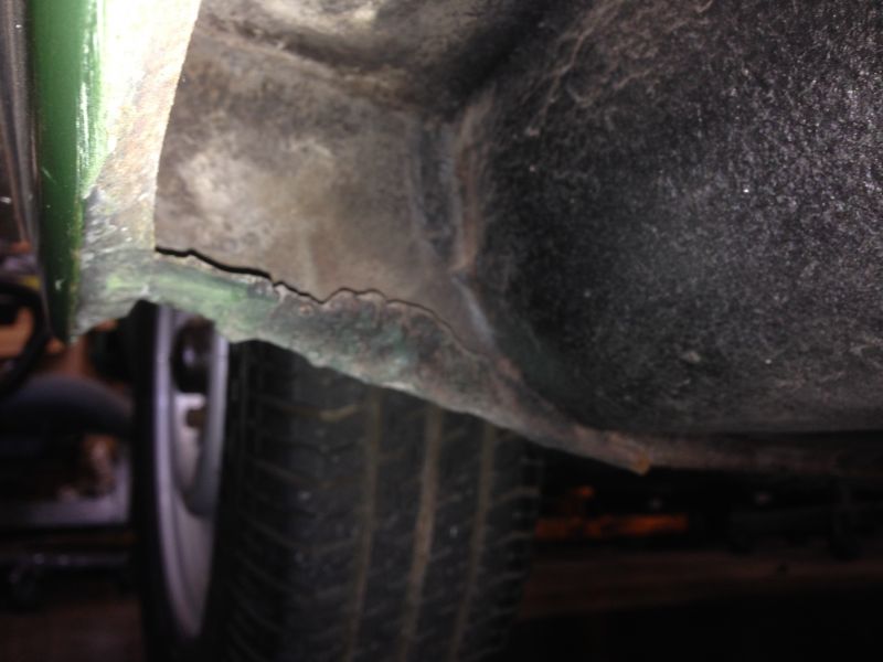

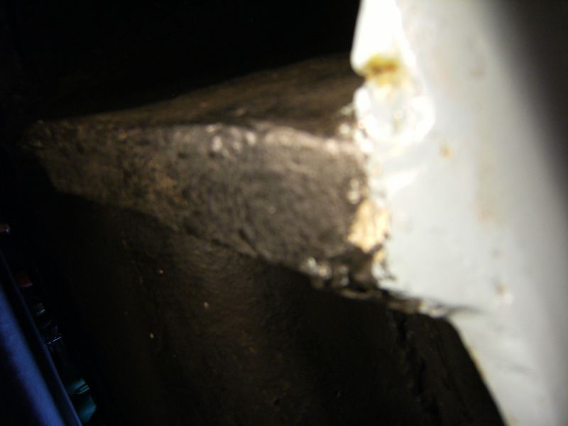

                      Justin's photo's of the drip pan closing panel to the outer rocker are in principle exactly like my original ones. His look like the rest of his car perfect in every way. Mine are nothing special at all to look at but are not rusted through even after 57 years. So if you look at my photos I took today it makes it look like my car needs a total re-work but at least it proves the principle they used.
                      Pleased Justin takes good photos mine are very poor really.
                      I must tidy that area up someday I feel rather ashamed
