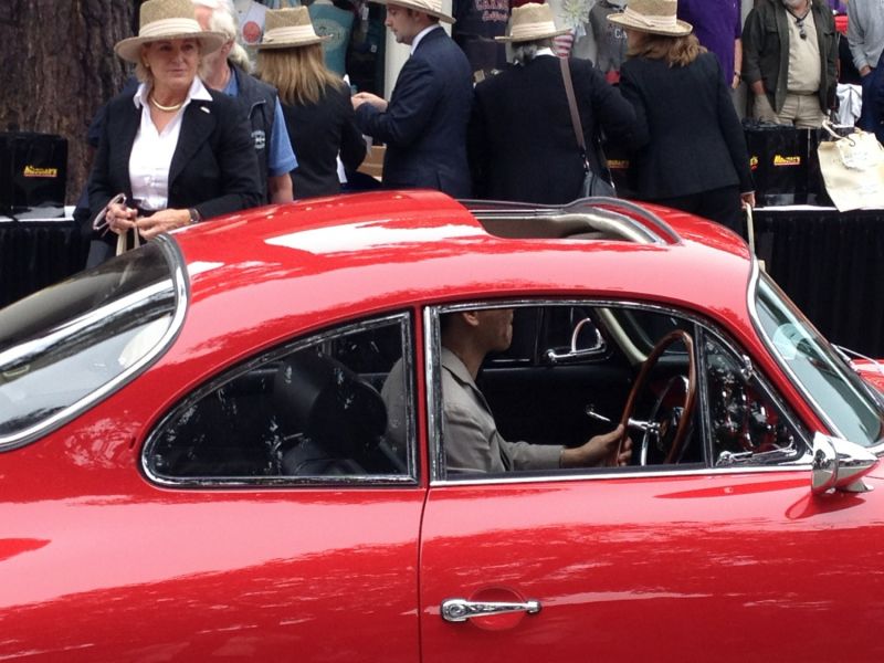

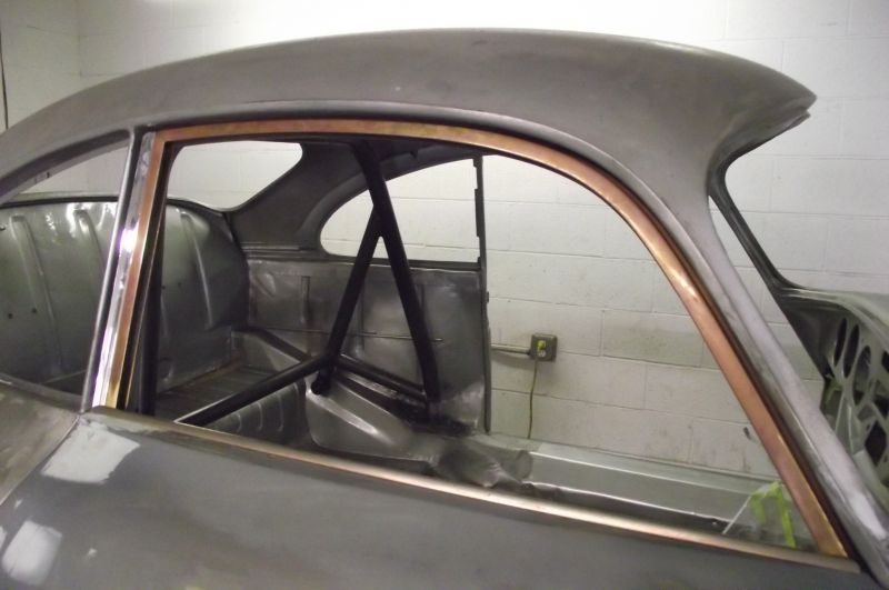

  • Looking at more pictures from the Registry, it would seem that the gap between the window frame rear wind deflector and the quarter window B-pillar should be 3.5-4 mm to continue the gap between the rear of the door and fender. If this is so.....then the gap between the top front of the window frame with the car sheet metal should also be 3.5-4 mm? Can anyone verify this as it looks like I've got to reposition the door some more?
    Thanks.
    [email protected]
    • Hey John,
      My observations are that the gaps are all over the place on the window frames. As you say most cars have a larger gap at the front. I "adjusted" my frames for a consistent gap all the way around, but it's still tightest at the rear. The other annoying thing to me is the frames lean in a little bit when viewed from the headlights. Perhaps I can adjust it better once the rubber is fitted.
      So far your fit looks pretty good to me. I wouldn't mess up the door gaps to get the frames looking better. I did hammer and dolly on the front channels to improve the fit.
      Also my frames sit lower in the doors than yours. Have you put the 1/4 round piece in to make sure it covers that notch?
      Thanks,

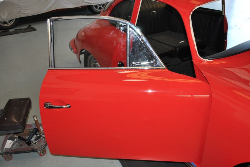

          • [quote="John Pierce" post=38154 I'm mocking up the window frames again and things are not fitting as well as I'd like. In order to get some reasonable gaps around the top and sides of the window frame I'm having to move the door more forward which messes with the front door to fender gap which is all OEM metal.
            [/quote]STOP NOW. Do not move your original fit door to original front fender if clearance is good at the interface above the top hinge when opening the door. Modifications in this area can have deleterious effects. I see several other issues. No time now, sorry
            • It's me again John,
              I know one thing Jack was going to say is that your wind deflector is hanging over the door edge. Same thing happened to my car and Jack pointed it out on my thread. It's one of those details that I procrastinated and now it's causing problems that my paint guy is having to deal with at my expense.
              Something looks different though with your doors. My doors were missing the small flange or lip that spaces the frame inward. That lip needed to be welded to the top of my door. The confusing thing is that lip is already there on your door. So I'm not sure why your frame and wind deflector are so far rearward. My car isn't close by, so I can't look at it or I would try to help further.
              Has lead been removed from the end of your door? One of my doors did have a good amount of lead there on the end. Jack and I have discussed this in detail and we both agree that lead filler here is not the best fix as it does crack due to the stress riser in the sharp corners. Jack has seen a few examples of cracks where the door frame meets the door. Instead, it's best to cut the door move as needed and re-weld in steel. (It still might crack).
              Also check the clearance between the door and front fender when the door opens. The area that Jack is referring to is just above the upper hinge. Justin's thread has a detailed discussion on this too. My car isn't painted yet, but I'm looking for a credit card thickness minimum.
              The notch I was referring to is the one in front of the wind wing. Your notch is showing above the top of the door, which is why I asked if the chrome strip covers it? If not, then your door is probably hung too low. That notch is there to allow the frame to sit lower in the door if my memory is correct.
              I hope this is consistent with what Jack was going to say, but hopefully he will have time to share his thoughts later.

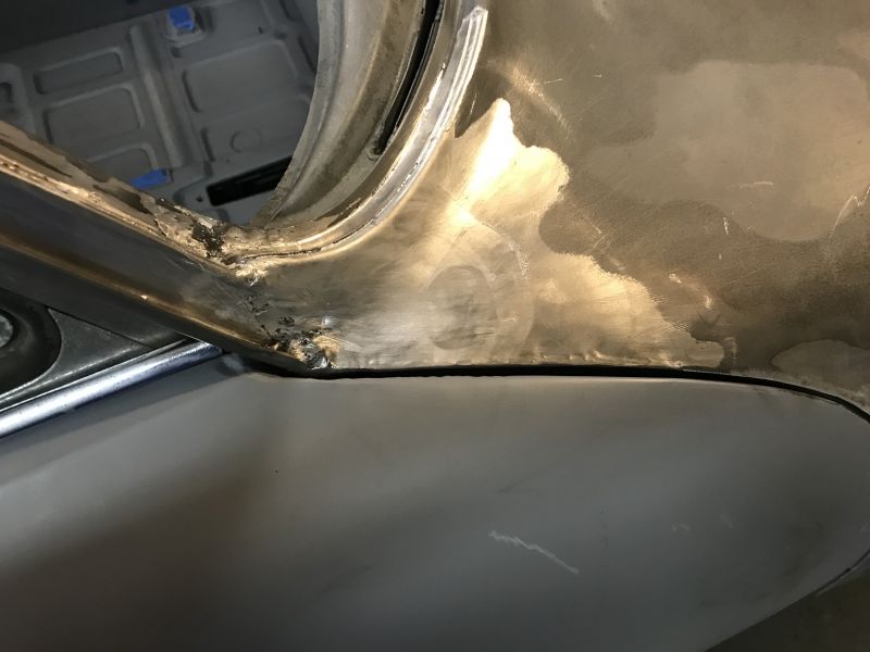

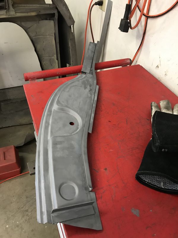

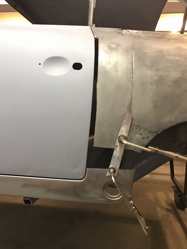

                      I've got an OEM replacement B-pillar. Since I'm replacing the whole thing I can manipulate its position for best fitment of the door and window frame.
                      By moving the door forward the front gap is now at 6 mm and the 1/4 round chrome covers any holes. The front gap still seems wide in comparison to the top and rear window frame gaps and also in comparison to the 3.5 mm door gaps.

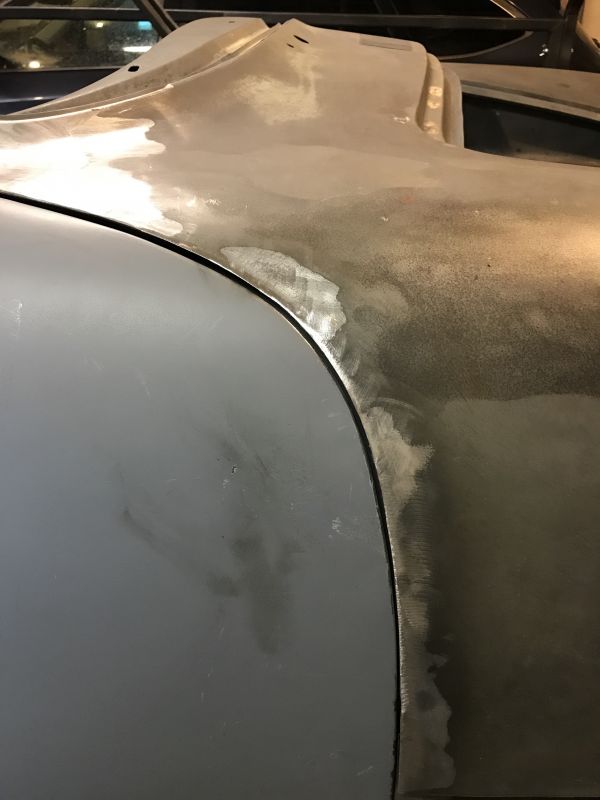

                      As you can see I removed the lead in this area, which was pretty thick. With the door moved forward this door to fender gap is 3.5 mm.
                      I can make the door to fender gap anything at this point as I'm not married to saving the fender metal. The door opens and closes nicely without hitting. I can still move the door forward and trim back the fender edge if people think that the front window frame gap is still too wide.

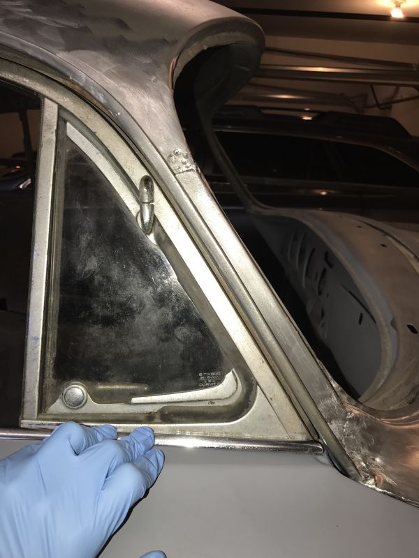

                      The rear window frame gap looks pretty good with the wind deflector in place. I can move the B-pillar if the experts think it's not in good position. The outer top rear part of the door did originally have some lead as it is concave. I don't remember seeing lead on the rear of the door to fix the overhang of the wind deflector and 1/4 round chrome, but maybe there was. Lead in this area would make sense as there's a pretty big gap between the door and the B-pillar.

                          A couple thoughts. John, if your front fender at the rear edge is still original, as well as the front of the door (no cutting,welding, lead removal, etc), I would set that gap to spec and shim the door hinges for the best fit using a straight edge across the gap. Hold the straight edge parallel to the ground measuring from the bottom of the door to the top, including where the gap becomes diagonal. Check for clearance at the critical upper spot. Work your fit towards the rear per Bruce's excellent post ( about an hour of thinking and typing at, least for me...).
                          The window frame seems unusually high to me at the vent window, as show by pics from Tom.
                          Finally, there is a temptation to install the striker plate too far forward in an attempt to close the gap at the rear of the door. That could cause issues like Phil experienced, or even worse. On original cars that have had the lead melted out in that location, gaps can require 10mm or more of filler to restore proper gaps.
                          Hope this helps.
                          Jack

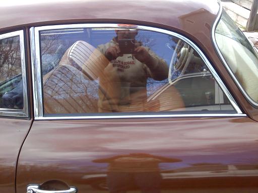

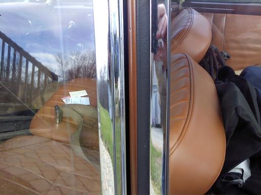

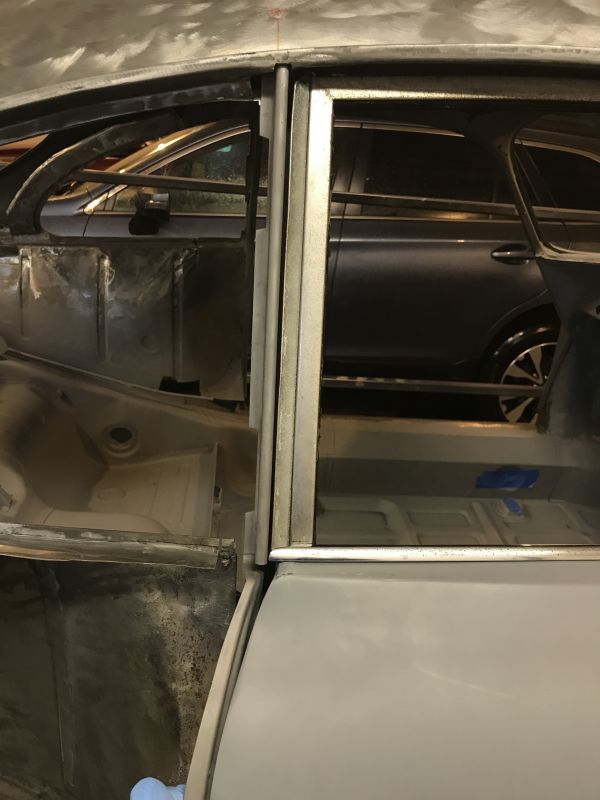

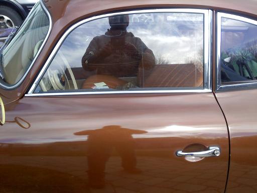

                          • I know I don't have a vent window but here are some shots of mine. The window frame gap at the b pillar is 3-5 mm, top gap 5-6 mm, front gap 5-7 mm. When you are looking at it you don't notice it at all that the gap is not exactly even all around. The most visible is the back at the b pillar as it continues the door gap so I feel this is the most important to get visually correct.
                            In your post above you show the "door moved forward" to give you a 3.5 mm gap. I think this is to tight in this bare stage of work. Don't forget you need to have some lead most likely, primer then paint.

                            • Don't get too caught up with the door frames. Your rear quarter window frame fitment will dictate your B-pillar position.

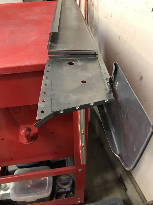

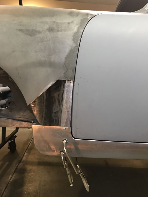

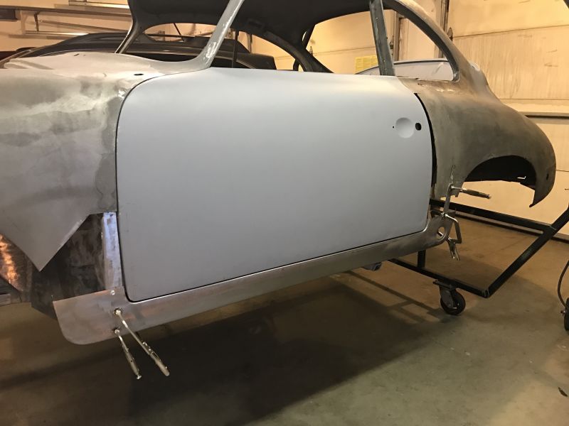

                              • I finally got some time to work on the car and took a break from the right lockpost to finish up the left rocker and sill.
                                Front flange rebent to match the splash panel.
                                Plug holes and a relief cut placed. The hole for the hinge pin was repositioned.
                                Pretty good gaps and fit.
                                The rear fender is a bit of piecemeal assembly and will be repaired.
                                Slowly looking more complete.
