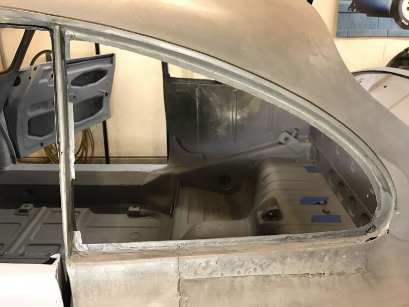

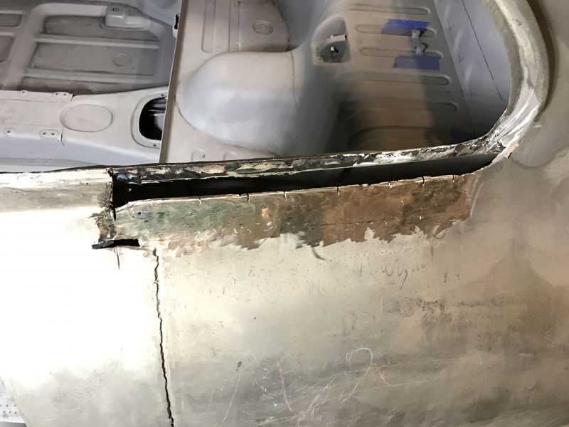

          Before fitting the new lock posts I needed to fix the quarter window surrounds.
          This is how things looked after media blasting and removal off a huge booger of plastic filler in that hole.
          The inner ledge wasn't that much better and the crimped flange was full of rust.
          After removal of the offending pieces....a big gap.

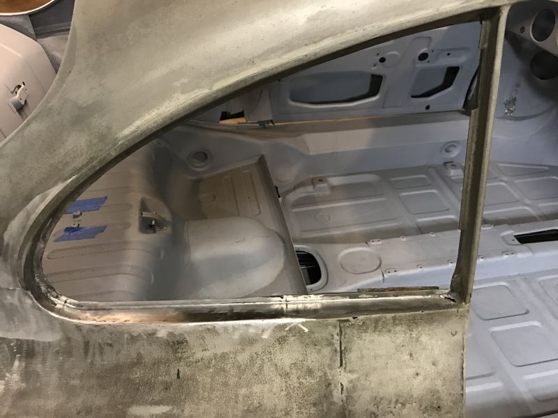

          The outer ledge fitted and welded in place with a nice curve to the rear formed with a shrinker.

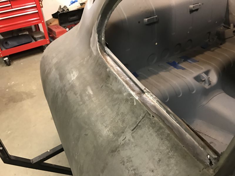

          View from the inside. I ended up removing more the rearward metal due to thinning.
          New inner ledge fitted and welded in place.
          Edge bent over to capture the vertical flange. I'll spot weld this later and add the Karmann drainage hole as OEM. The more forward holes will be fixed when the new lockport is installed.
          Thanks for following.

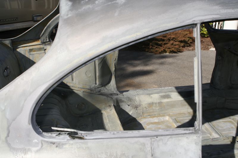

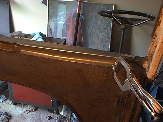

                • Too good! Could be worse:
                  • John
                    Brings back fond memories. Glad to see you back at it.

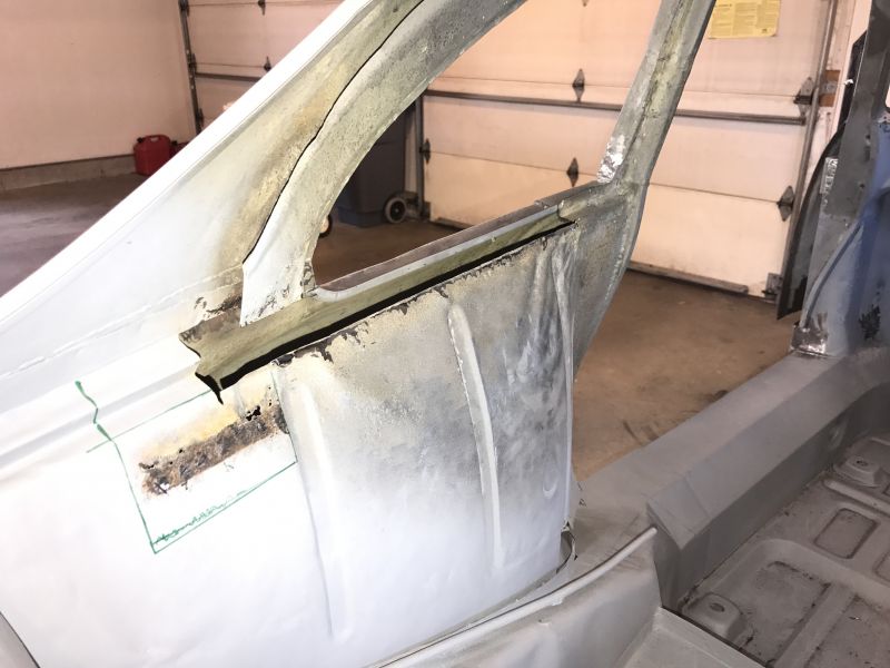

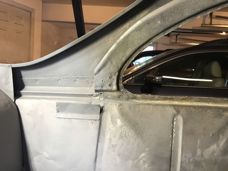

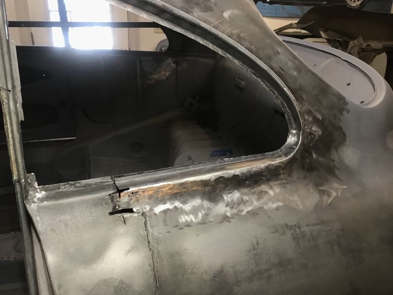

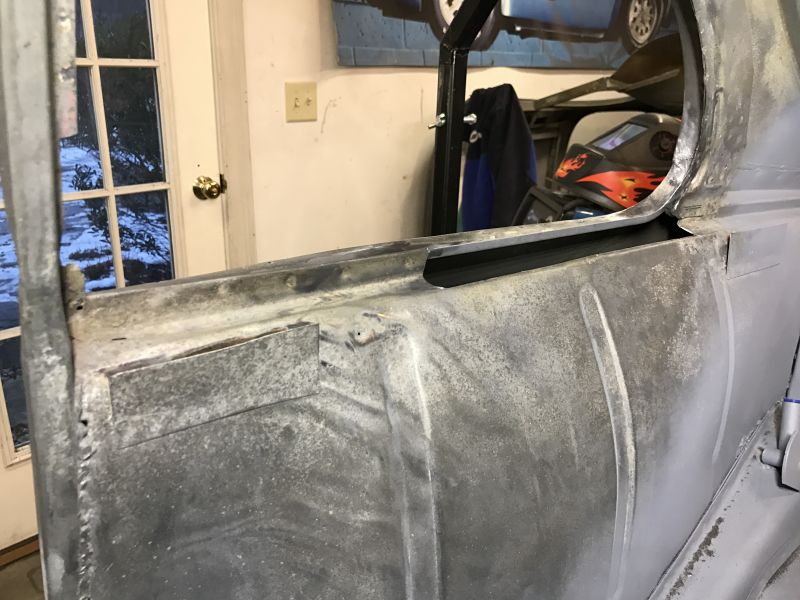

                    • Thanks guys for the support. I got a bit of free time this weekend before the Patriot's game
                      Time to work on the left quarter window.
                      Bubba really went wild on this side. A big 18 gauge chunk of metal bent to fit over any underlying holes. Ouch!!
                      He did miss a few holes though

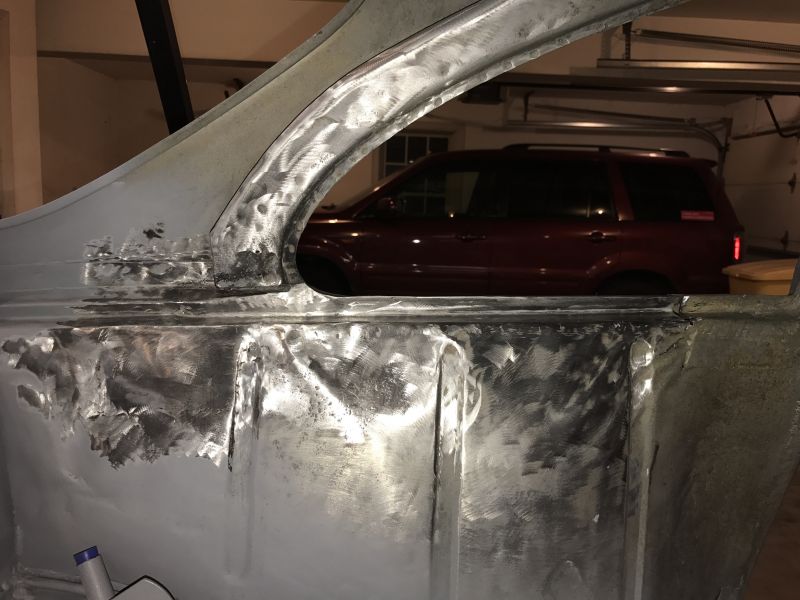

                      Offending metal and underlying rust removed.

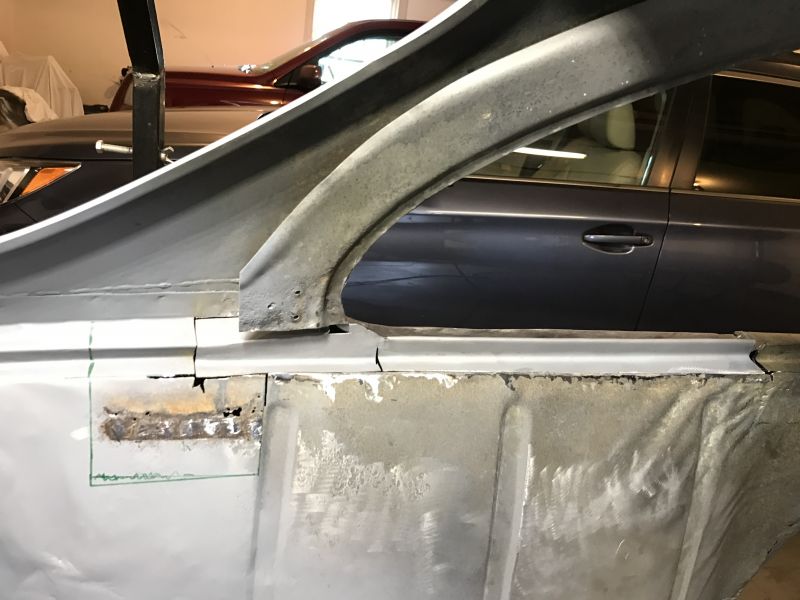

                      Nice fresh metal shrunk to fit the window curve.
                      Pretty good fit.
                      So much nicer.
                      The inner side is just as bad and will be my next task.
                      JP

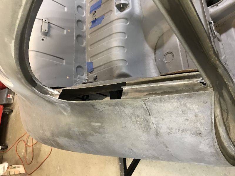

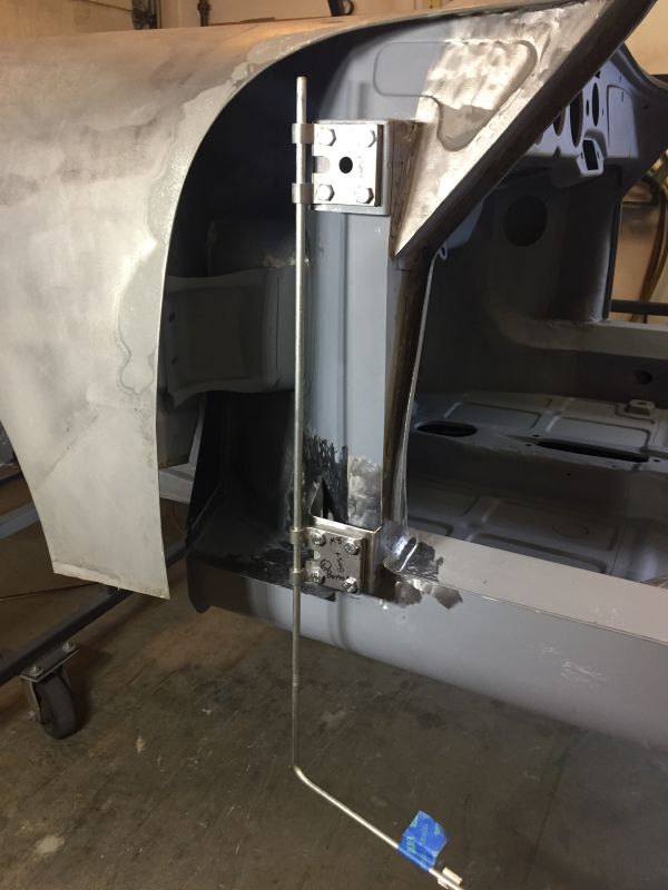

                          • Buttoning up some loose ends like the cap on the left hinge boss and hanging the doors.

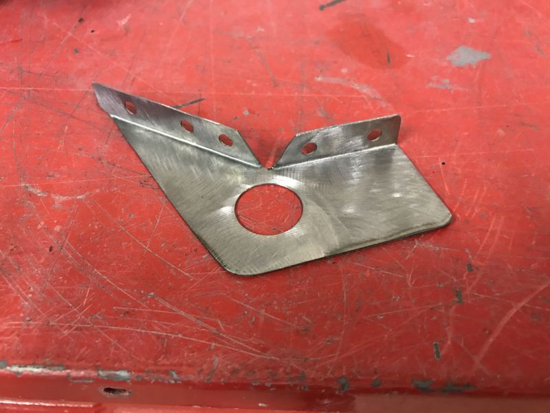

                            New hinge boss in position.
                            Hinge boss cap cut from a template and the hole cut to line up with the upper hinge boss hole so the antenna will sit straight.
                            All buttoned up.
                            I've got a question: Are the hinge shims primed +/- painted before the hinges are installed for the final time? My worry is that I'm now fitting the doors with the correct number of shims, but if I paint them the paint will add thickness and throw off door to fender edge. On the other hand: If I don't paint them they will rust.
                            Thanks.
                            • Looks good John. We are still twins it seems. I recently did identical repairs to the rear quarter window sills on both the Swiss Miss and a '64 coupe I'm doing for a guy from Texas.
                              For your hinge shim question, no they were not painted from the factory. But personally I like to put a light dusting of krylon primer on them before installation to guard against future corrosion. That light coat of primer, even though on several stacked surfaces, wont be enough to make a noticeable difference in the final product.
                              DG

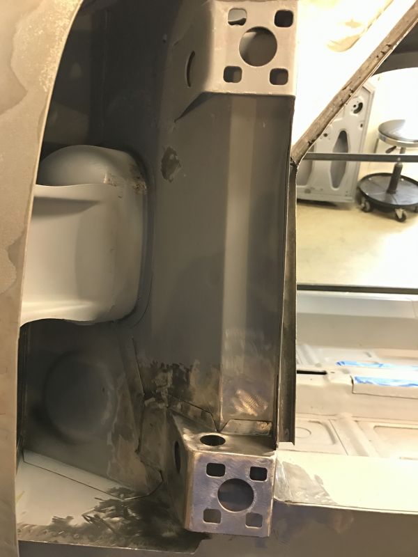

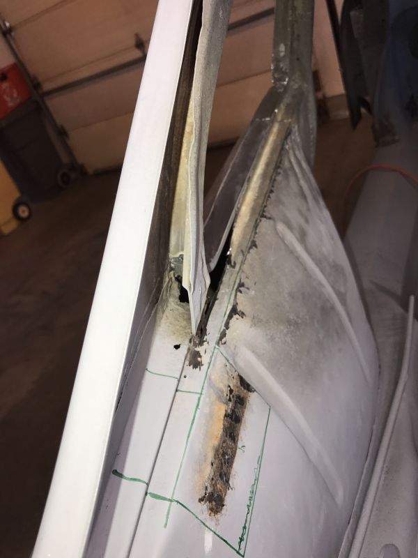

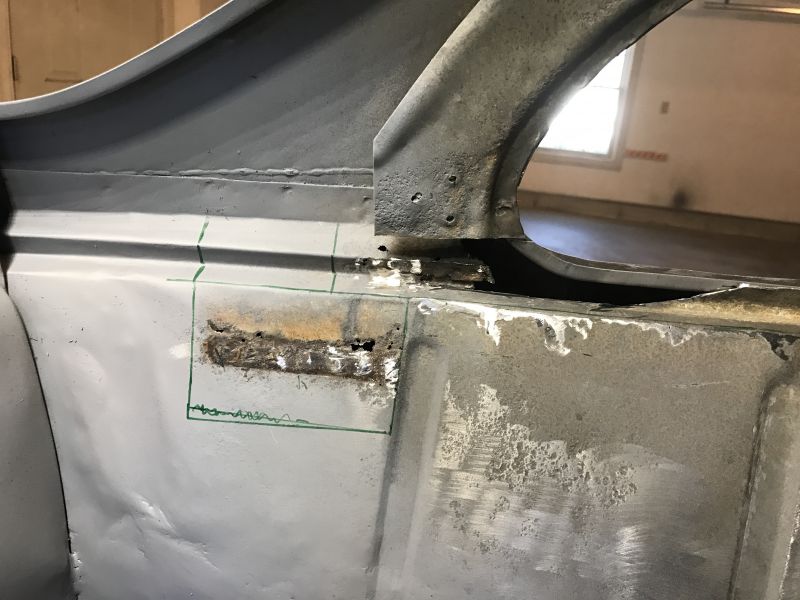

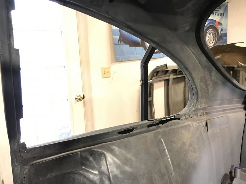

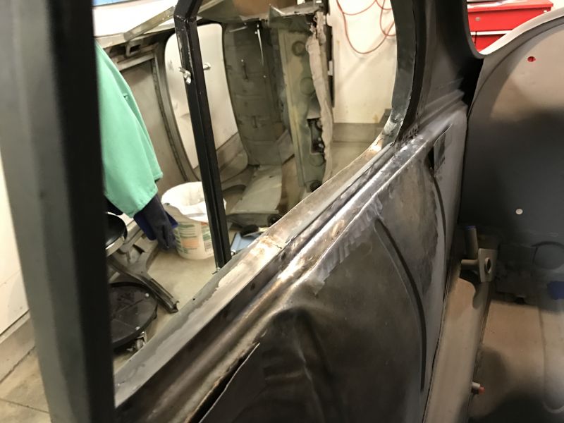

                              • On to the inside of the left quarter window.
                                Just like the outer window sill, the inner also had an 18 gauge piece of metal welded on top of the holes and rusted metal.
                                The rust and holes extended behind the tabs and into the wheel well.
                                A really tough place to get to and work in. I had to turn the rotisserie over multiple times to get all the rust out of that pocket where the quarter window latch attaches.
                                Most of the offending metal removed. I'm leaving the forward mess to be fixed when I work on the lockpost. Leaving the metal also provides much needed stability to the inner and outer wheel wells.

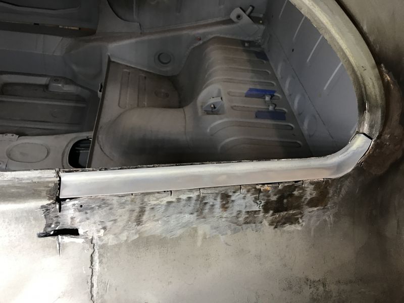

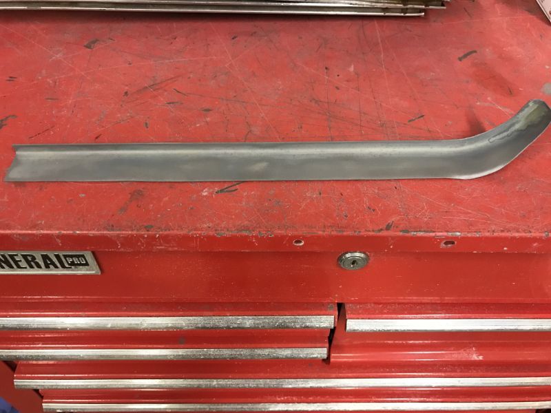

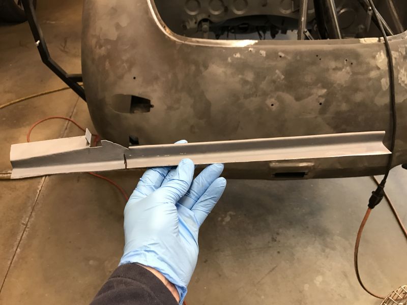

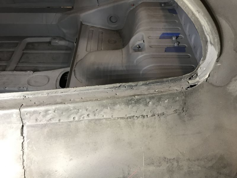

                                A convoluted patch piece. The sill top edge is bent over as done originally to capture the outer sill flange. Then the two pieces are spot welded together.
                                Pretty good fit....at least for MIG work
                                Looking so much better. The rear tabs were welded in place to finish it off.
