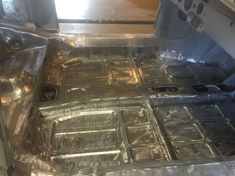

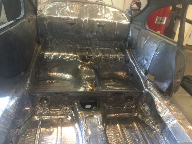

    I wonder if I could hire a local kid to grind down all these damn plug welds?!! Man....what a boring job At least the bottom is done. Now for the cockpit side.

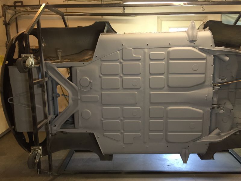

                          The bottom is done!! It's so nice to have this behind me.

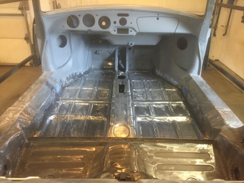

                          The cockpit welds are ground down and most of the metal sanding prep is done. It's better than lifting weights if you want a workout.

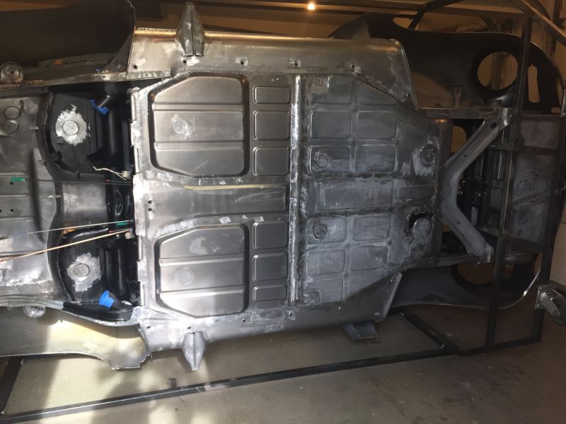

                          I spent a lot of time getting into the nooks and crannies with 3M metal prep disks and sand paper to remove any remaining dirt or rust.
