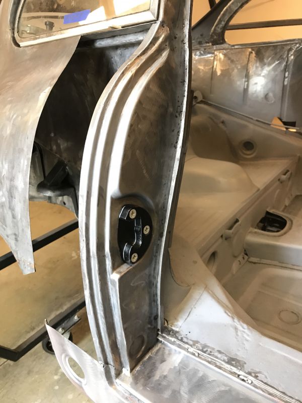

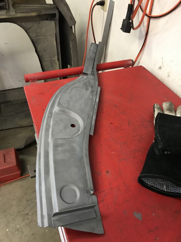

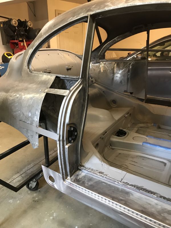

  • Time to repair the lockpost. Something that I was not looking forward to as it would show me if everything else I've done has been measured correctly or.....

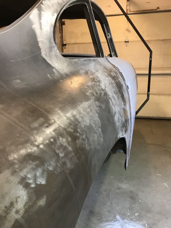

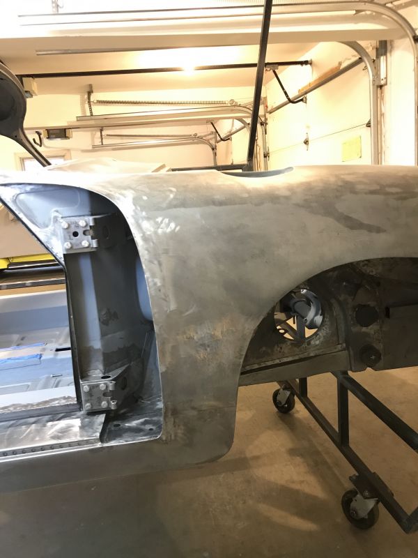

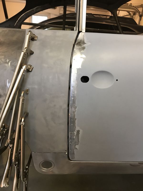

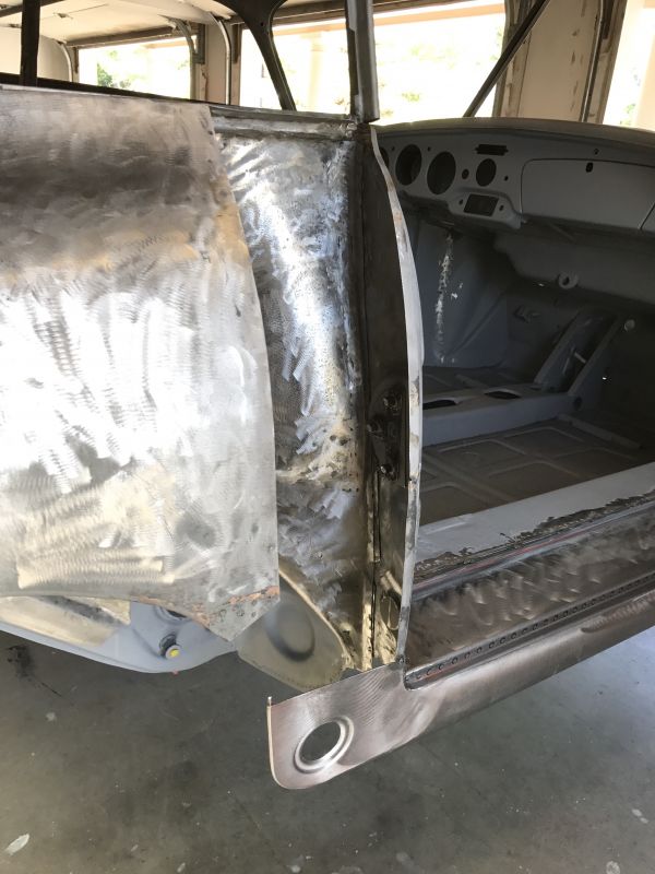

    The first step is to make a big gap Can't get much bigger than this.

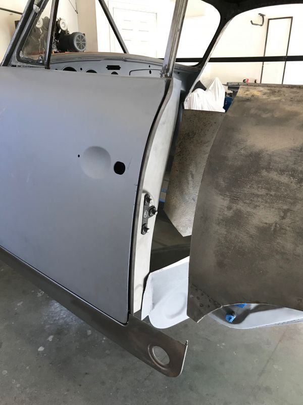

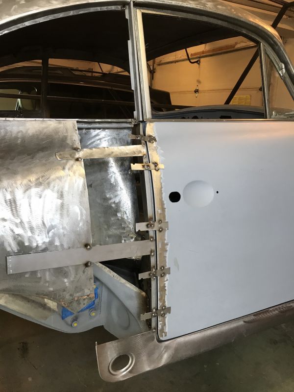

    I thought that I could use this OEM piece as is and it would miraculously fit perfectly. HAH!! What was I thinking? Time to slice and dice.

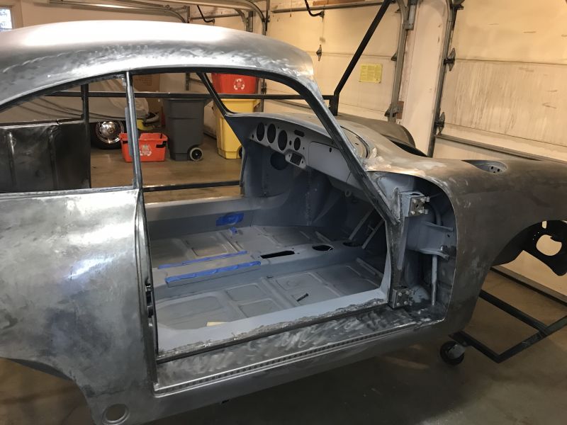

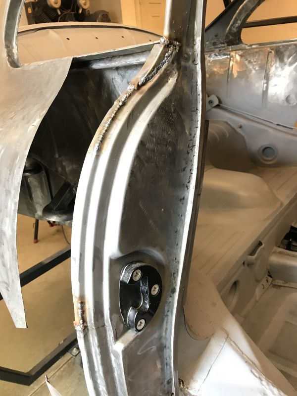

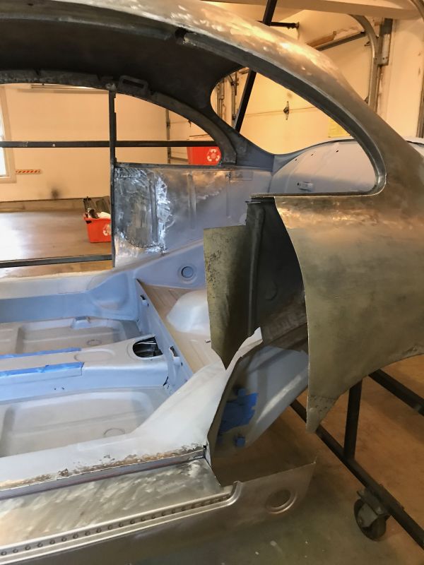

    After getting the door and window frame gaps set I cut the lockpost in half and installed both pieces in their best positions. I then welded metal strips on the inside and outside of the car to hold them in place.

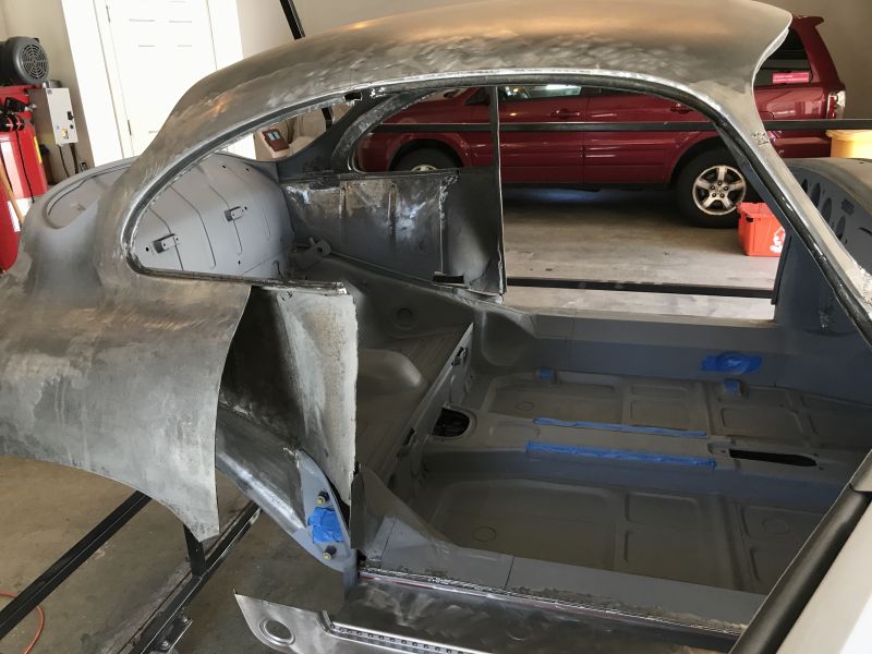

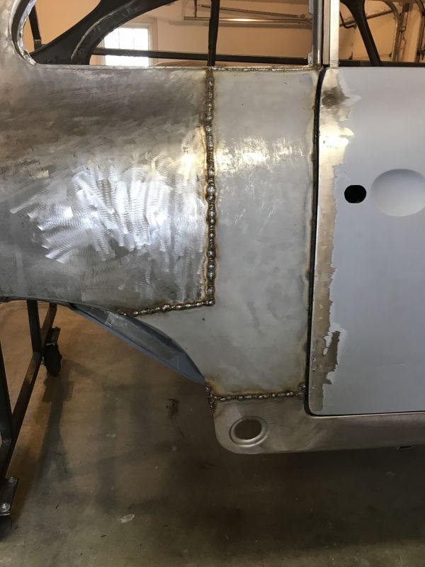

    The lockpost was then welded to the sill and quarter window top and bottom. The metal strips welded to the fender also act as sight lines for a smooth contour and transition along the side of the car.

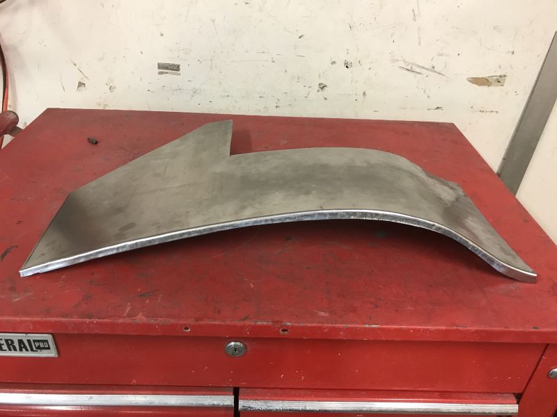

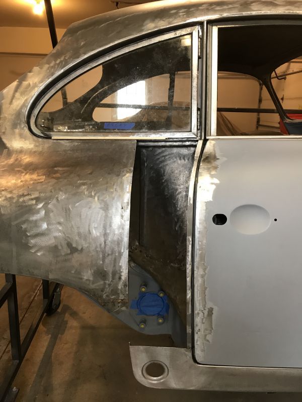

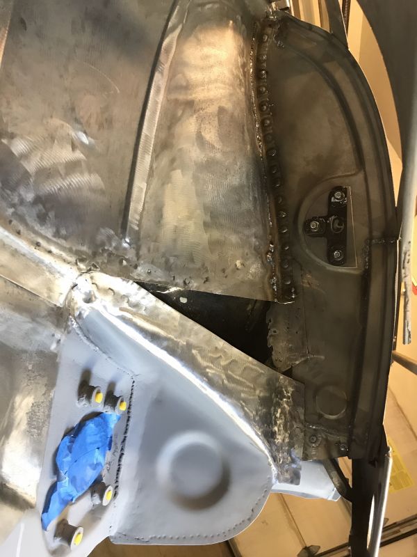

    The inner wheel well flange had been previously removed by Bubba and directly welded to the previous replacement lockpost. After repairing the inside corner buttresses I made a new flange and plug welded it to the lockpost as OEM with the correctly overlaps.

    Repair panel to finally close up the inner wheel well.

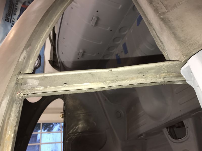

    Inner side as OEM with new buttresses.

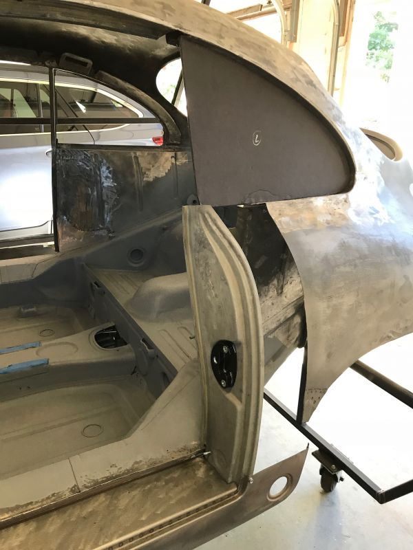

    The lockpost is in a reasonable good position, but as it was installed on a car that had already gone through multiple restorations, there were areas that still needed work.
    Several areas of the outermost flange sat too high which would have placed the repair fender too far out from the door skin. A little slice and weld took care of that issue The inner part of the lockpost that holds the rubber was too far away from the door to give a good seal so that was also moved. As you can see the outer top of the lockpost sits too inwards and the Porsche factory workers put a lot of lead to bring it out to the correct level with the door skin. It looks like all the companies that make lockposts left it as original. Instead of using lead later on I cut the flange and added metal to bring it to the correct height.
    NOW it's in good position.
    Ready for new fender metal.

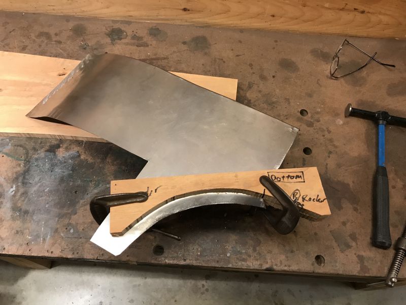

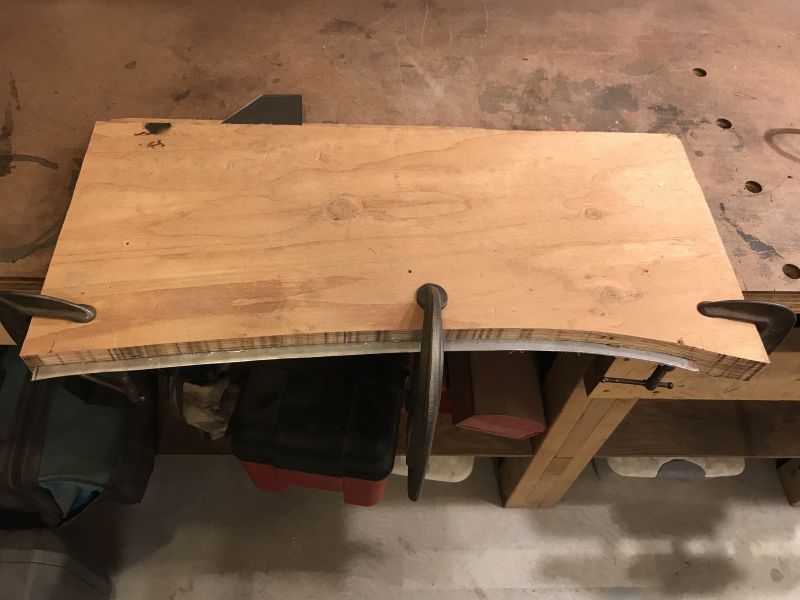

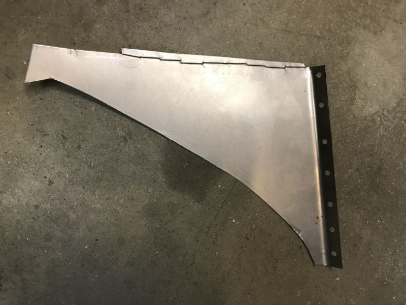

          I made a template of the door edge then made it larger to allow forming it to the correct contours.

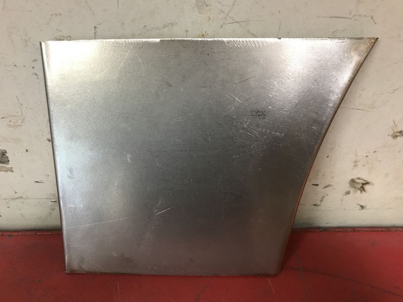

          Initial 20 gauge stock.

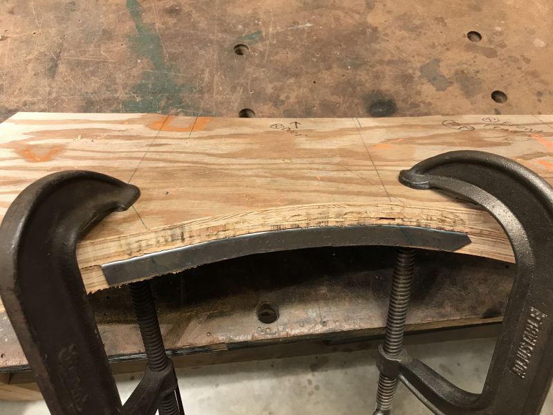

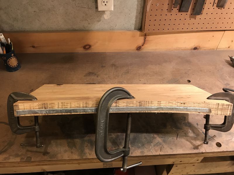

          I made a wood buck with the door edge contour using a bandsaw.

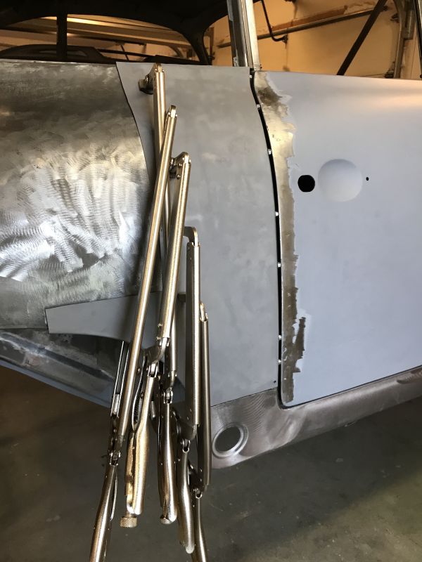

          The replacement panel Cleco'd in place and fits nicely. The extra metal will be cut back once it is welded to the lock post.
          Panel counters are tight against original fender. The fender had to be preloaded to give it a little outward convexity to give a nice transition to the door.

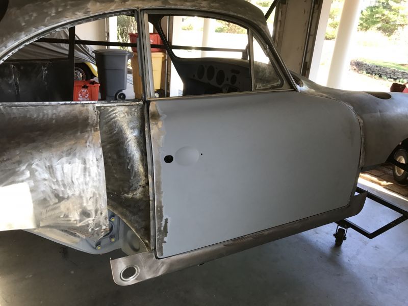

            • Thanks Roy. Your comments are much appreciated. The most important thing though is that this is fun to do and a good stress relief.

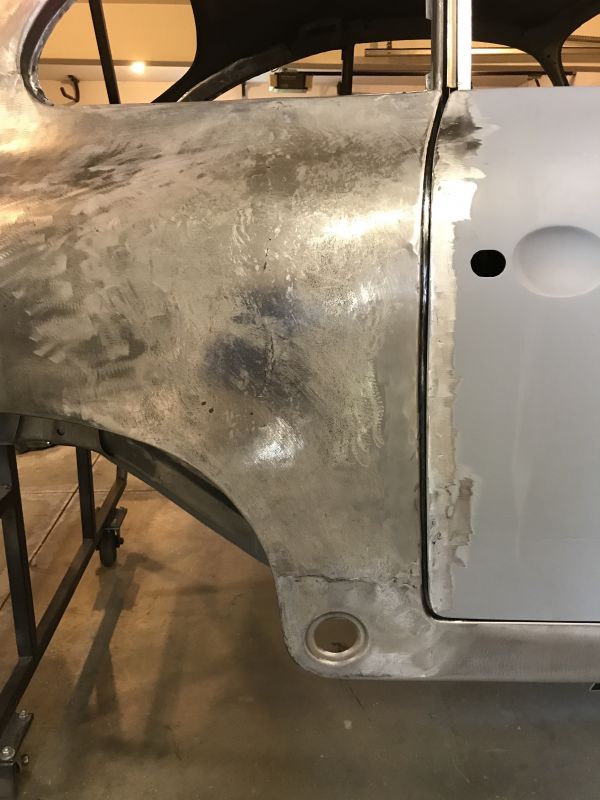

              Time to finish the right rear fender.
              A few hours of dolly and hammer work turned out very nicely.
              Lock post finished.

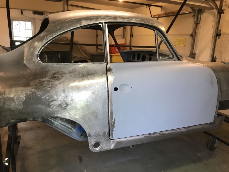

              Smooth counters top to bottom and front to back.
              The door closes nicely with a clean 3.5 mm gap.
              I'm so excited that this turned out so nicely. Now onto the right front fender.

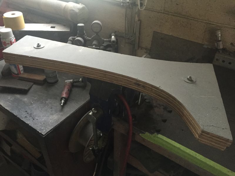

                    My latest of the hammerforms. They don't last long but they are easy to make. A plywood sandwich.
                    This one does trailing front edge and leading (leeding) rear of door edge. One needs to pay attention to not make two of a 'sided' piece with the same bend!
                    Rear of door right and front of door left side? You must be a lefty like me......the opposites are more demanding. It's a hammer and dolly thing but more natural applications are usually chosen first.

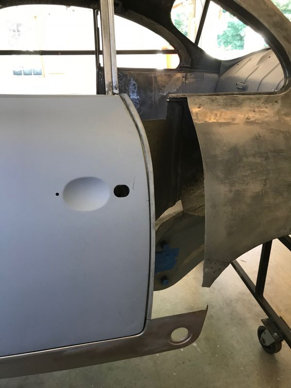

                    • Got some time to work on the passenger side of the car again to finish up the front fender area.
                      Even though the door is numbers matching to the car, so many things have been changed over the years that the front door to fender gap was very uneven. I thought that now is the best time to address this issue as the rear gaps are well set.

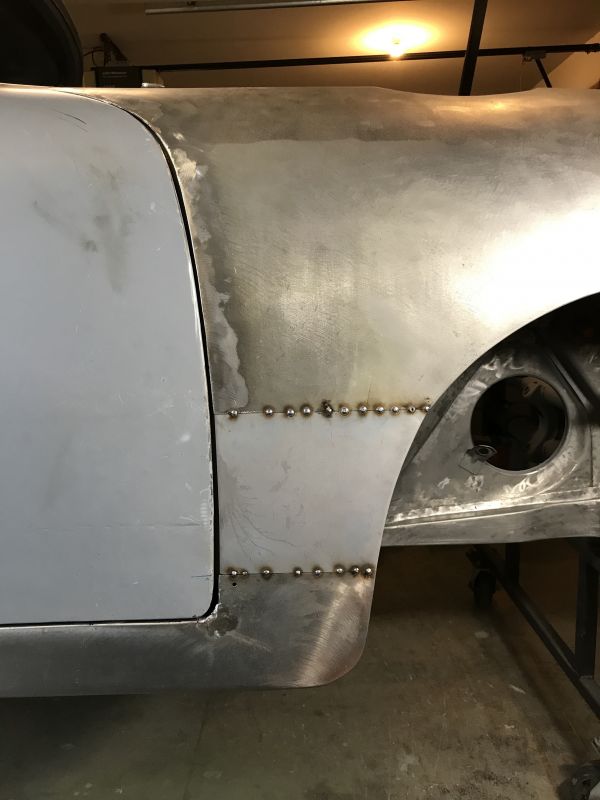

                      A started by making a template of the big gap.
                      The replacement piece is oversized to allow for variances at the edges of the fender curves, which always creep in and can be cut out in final form.
                      I made a buck out of scrap 3/4" plywood with the correct fore and aft curves.
                      The tricky part was that each side is curved, which needs to fit perfectly with the OEM metal.
                      I used the fender edge wire to ensure enough space and correct bend.
                      Nice fit.
                      Some grinding and dolly work and it looked pretty good. I also reworked the fender to door edge to give a consistent 3.5 mm gap.
                      The passenger side is looking so much better dressed in new metal.
                      Thanks for following.

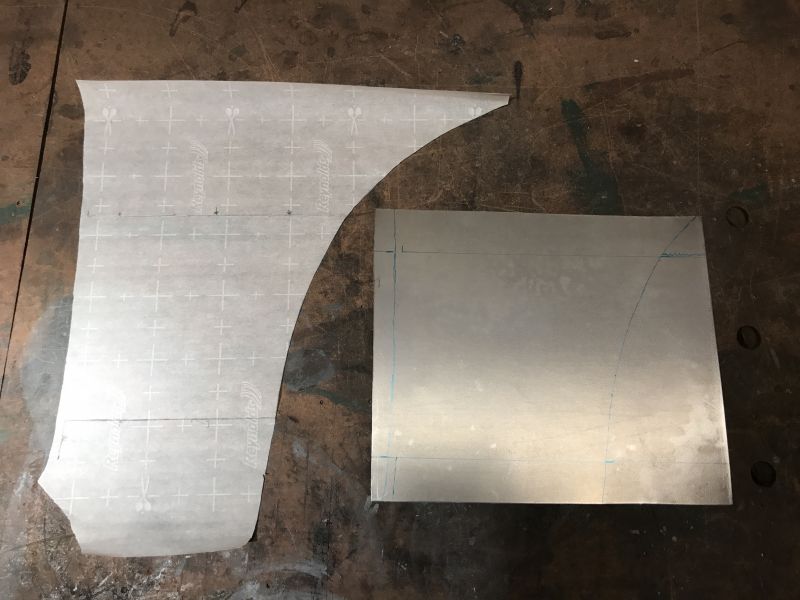

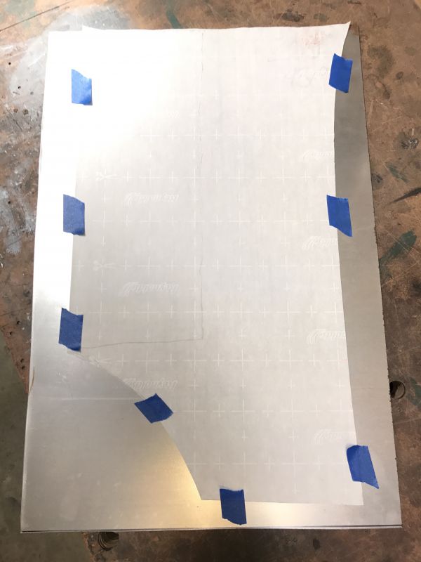

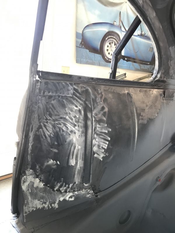

                              • Now that the summer is over I've got some time to work on this project. A couple of months ago I finished up the passenger side lockpost and fenders. Now onto the driver's side.
                                This is what I started with. Lots of overlapping metal with big troughs between the welded sections. The rusted OEM metal is mostly still there.....just covered over. Oh yeah.....the door gap is a bit off

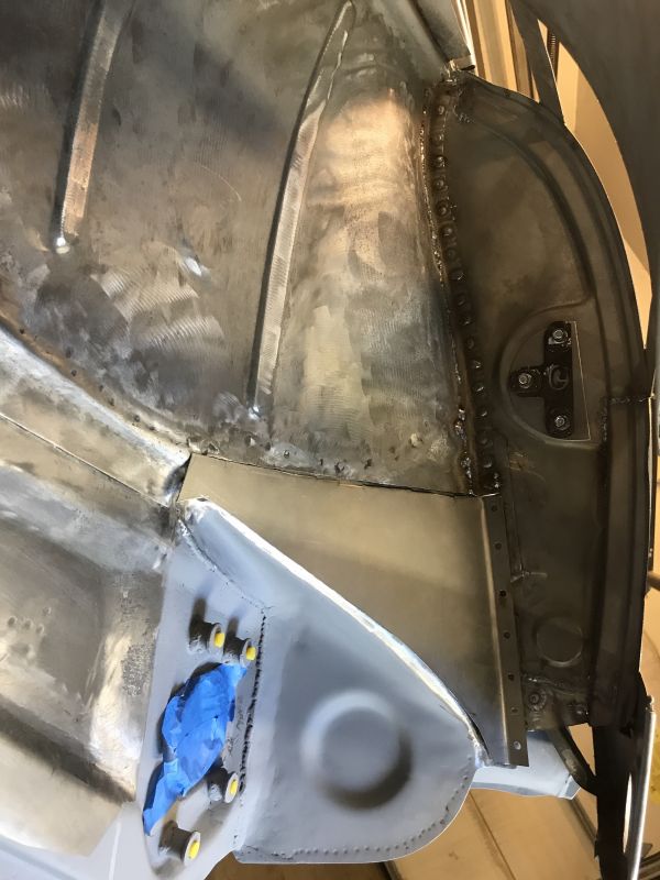

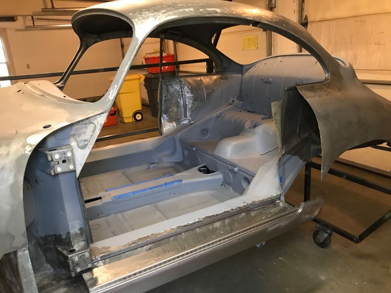

                                Unfortunately, the B-pillar was just as bad off with big welded on sections on the rear side and lots of blow through rust.
                                Best thing to do? Just remove it all and start fresh
                                I saved as much of the OEM inner and outer fender metal as possible. As you can see, I'll have to address the fender edge at at later date.

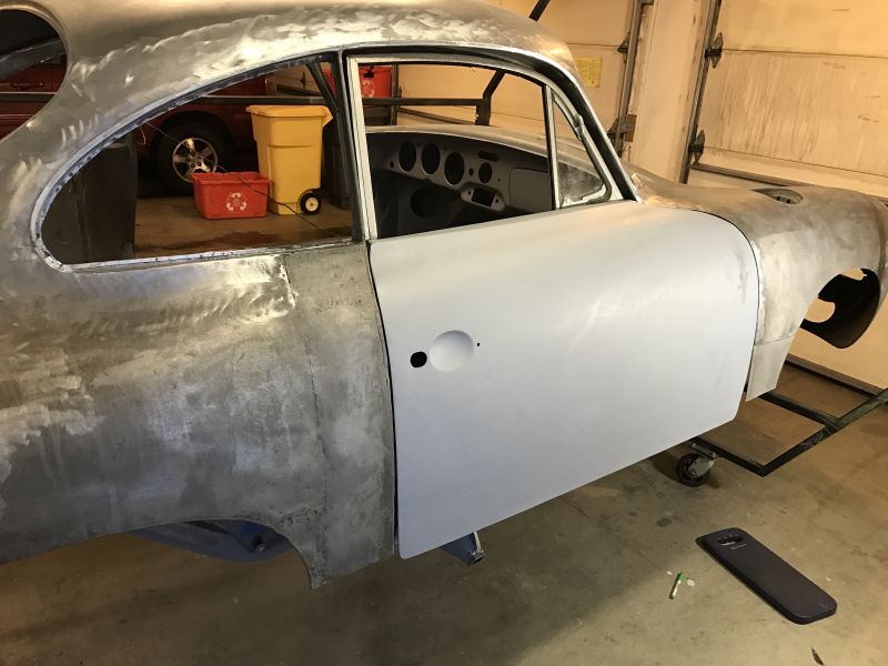

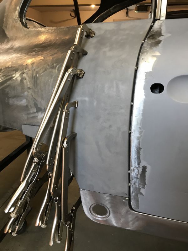

                                I spent some time getting the front door gaps set to 3.5 mm and the bottom door gaps to 3.0 mm. Even though the doors are original to the car I had to open up the hinge plates to move the door a bit rearward. Then I locked down the door hinges so there would be no movement as I set the lockpost in position.
                                Good gaps all the way around and the contour of the door and lockpost match nicely with just a few adjustments. Unlike what I went through on the right side.

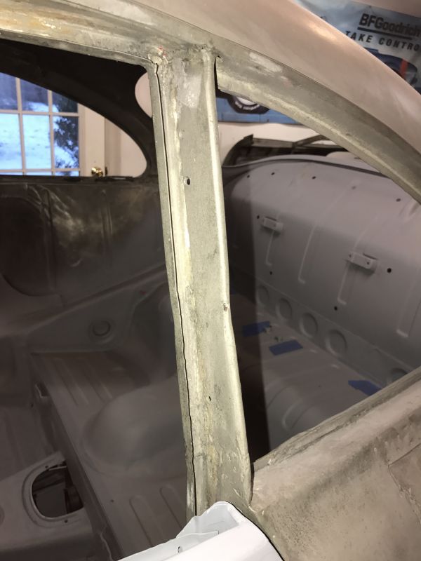

                                I used the door window frame and this quarter window template to position the lockpost. The template will definitely come in handy when replacing the B-pillar quarter window and replacing the window sill. I then welded the lockpost in position before working on the quarter window frame.
