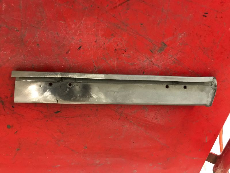

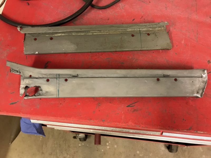

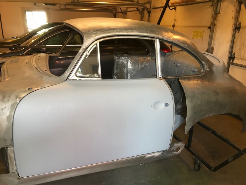

          The next thing to install to keep the lockpost in position was the top of the B-pilar. The one on the car was too buggered up to save so I had to ditch it. I had installed a complete OEM piece on the right side so I had a piece of the original right left over.....but reversed. I also had a left one from the sunroof clip, but after media blasting it, found out that the bottom had been filled with Bondo.
          I little slicing and dicing and voila....a usable piece. I made it longer than original so I could accurately fit it to the lockpost and fit it up inside the roof drip edge. I ended up welding closed the 4 holes for the quarter window so I wouldn't be married to their positions when mounting the window.

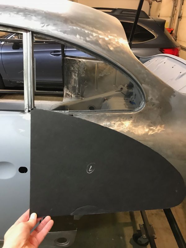

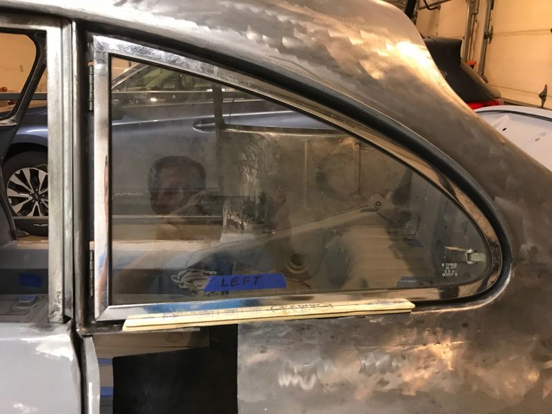

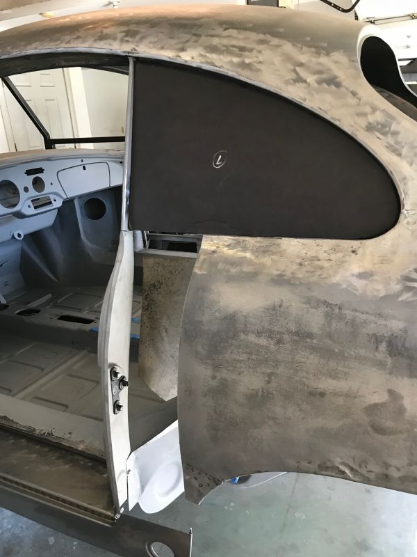

          The quarter window template came in handy for accurate positioning.

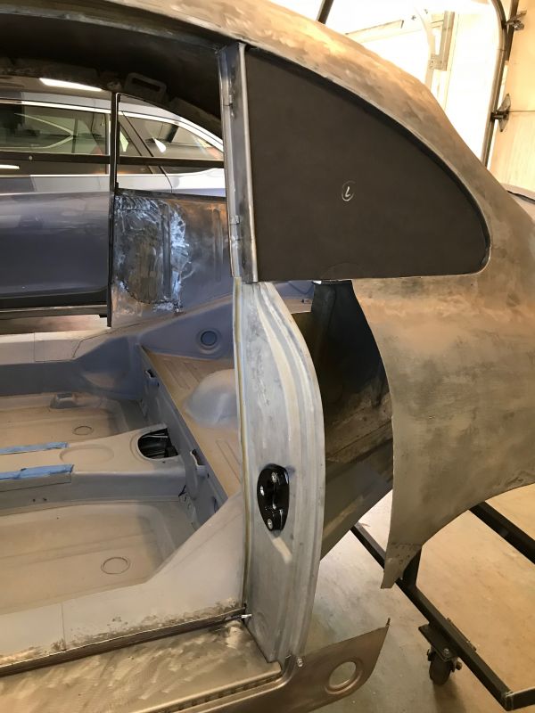

          Nice fit all the way around. The door glass frame wind deflector had a nice even gap.

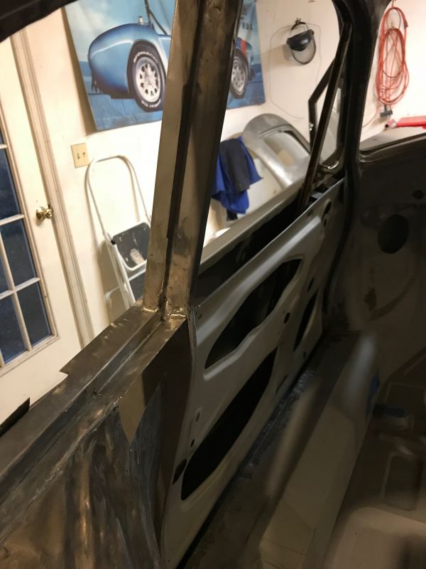

          Complete B-pillar and more solid.

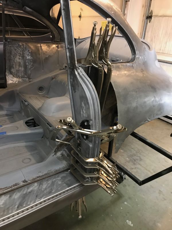

          Next was to cut and bend the pieces for the quarter window bottom to really hold the B-pillar in position.

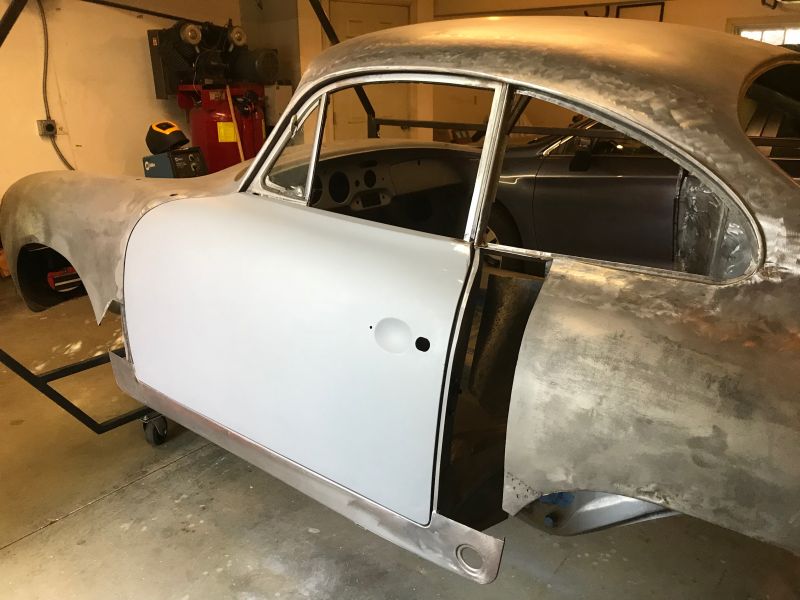

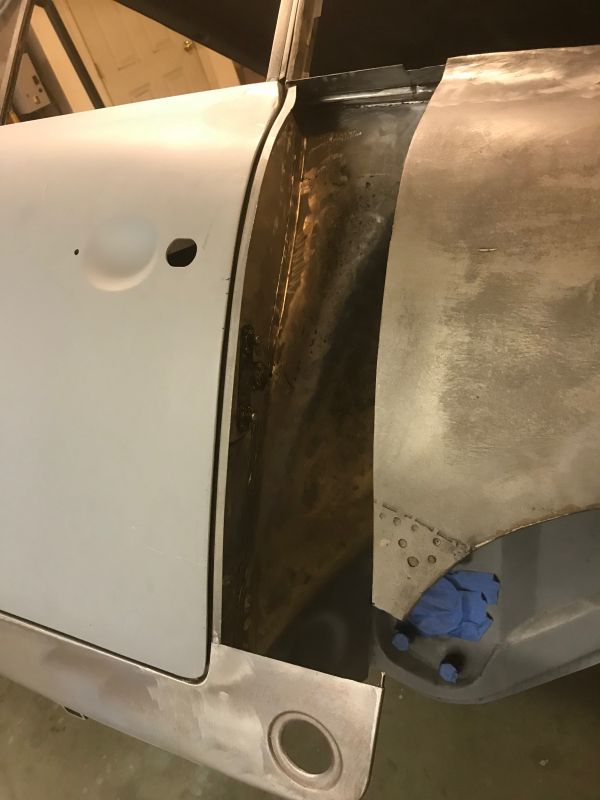

          Rock solid. The door can be slammed shut with no movement!

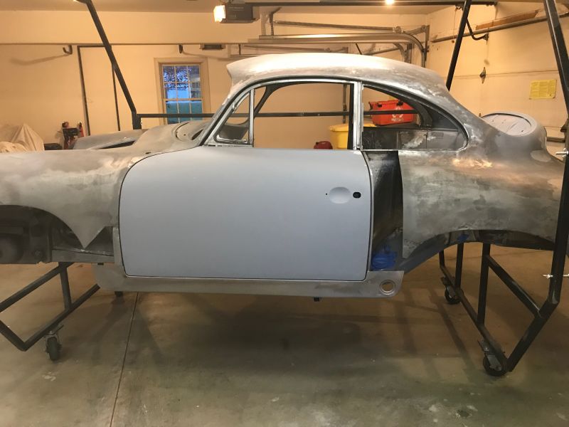

          Good gaps all the way around. Now to work on the buttresses and inner wheel well.

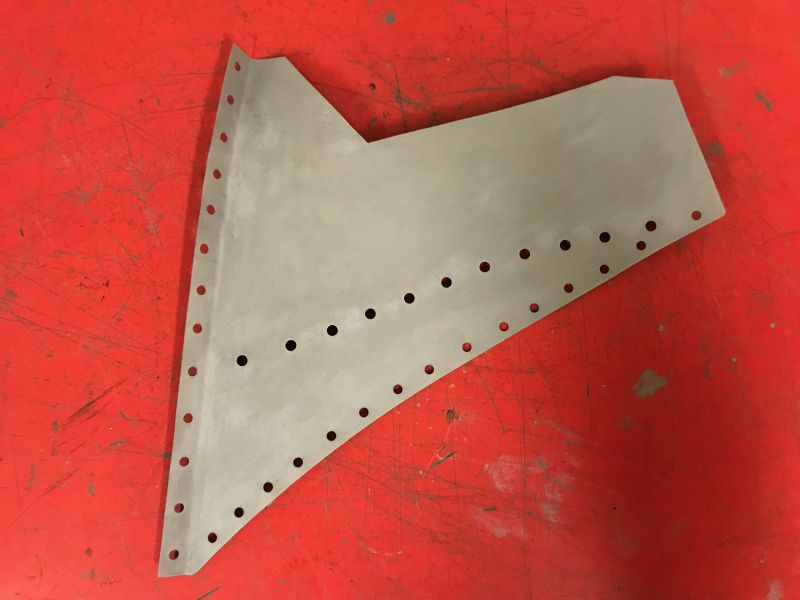

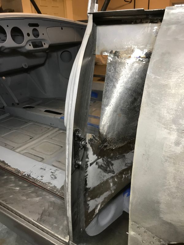

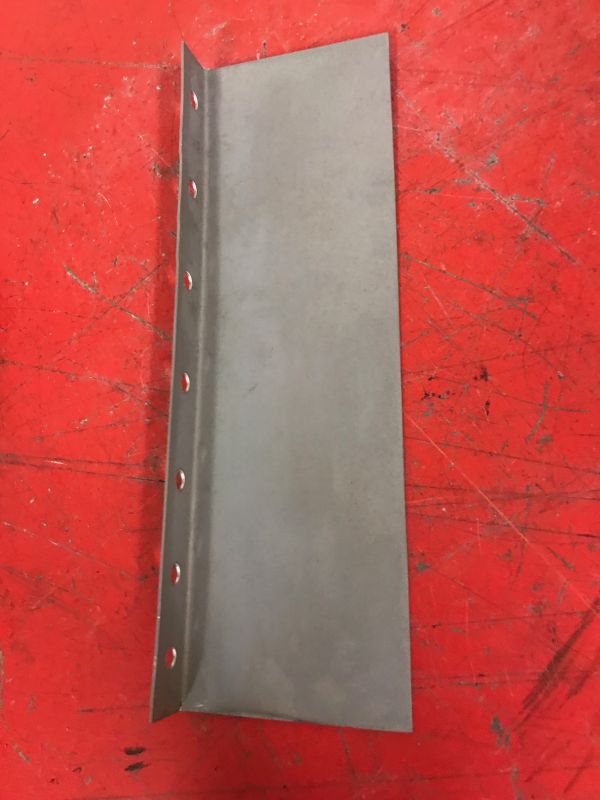

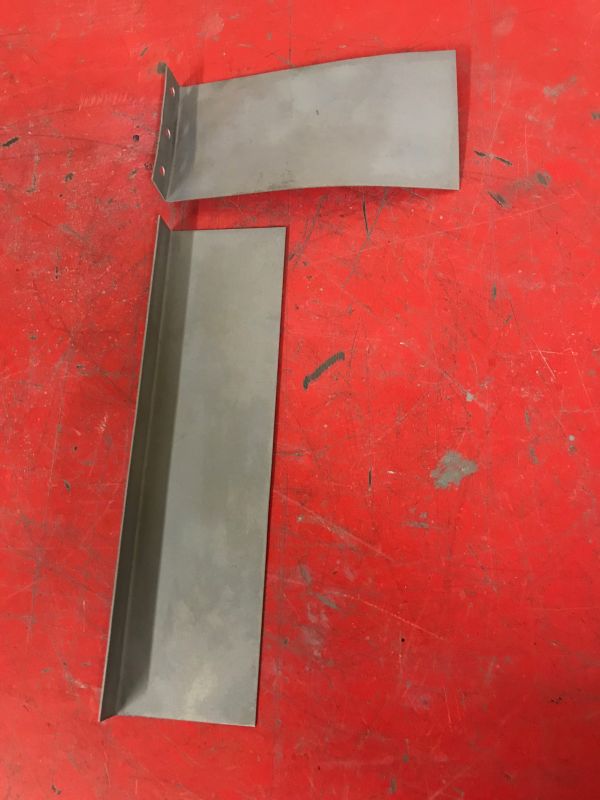

            • Before repair work on the inner fender can start, the B-pillar gusset needs to be installed as the inner fender overlaps it on the lockpost.

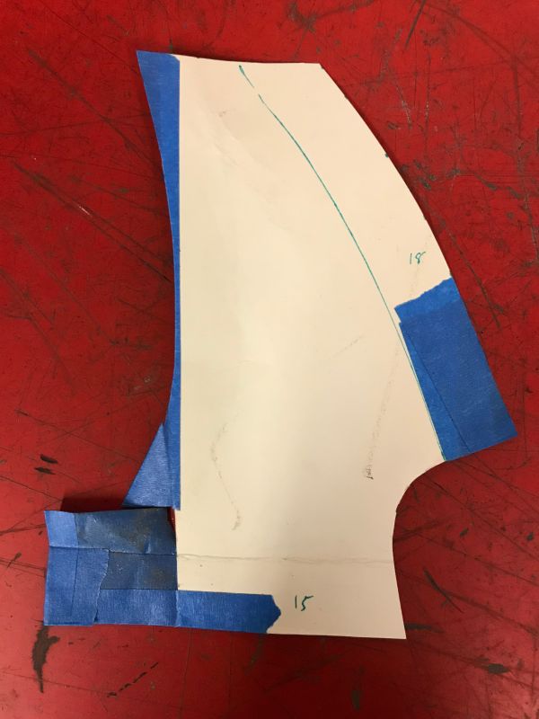

              Template with all the needed bends.

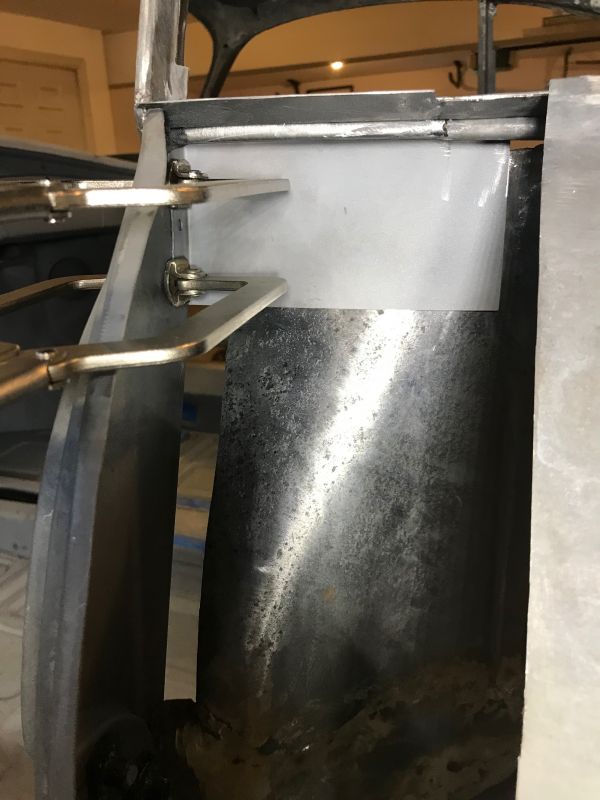

              Made from 18 gauge CRS as it needs to stabilize the B-pillar when the door is shut.

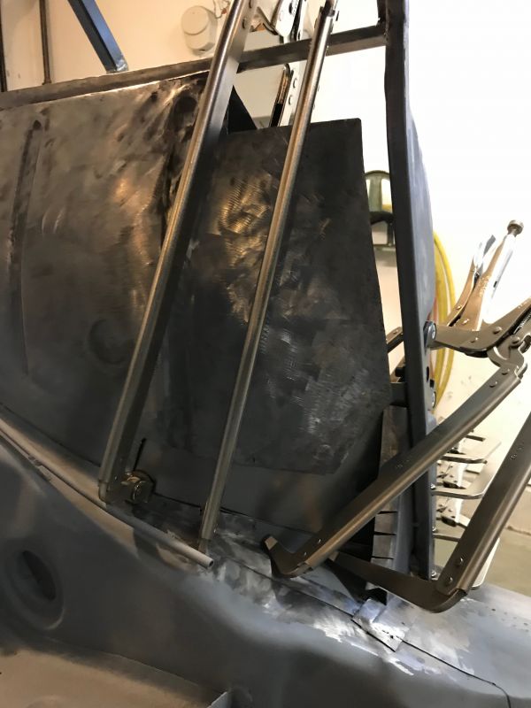

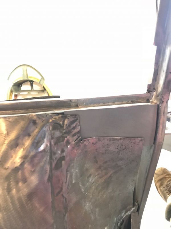

              Plug welded, front and back.
              Now to start filling the fender gaps.
              Thanks for following.

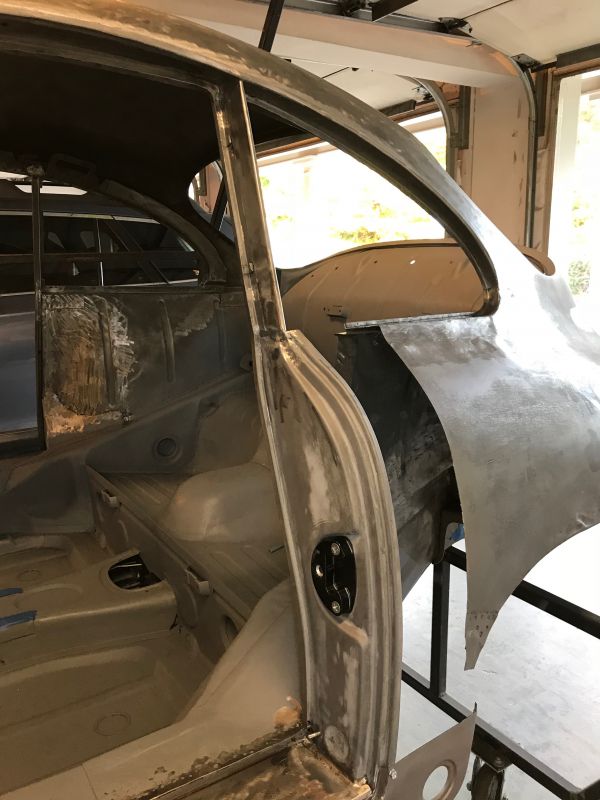

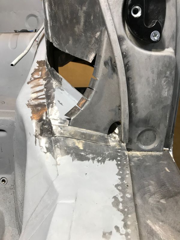

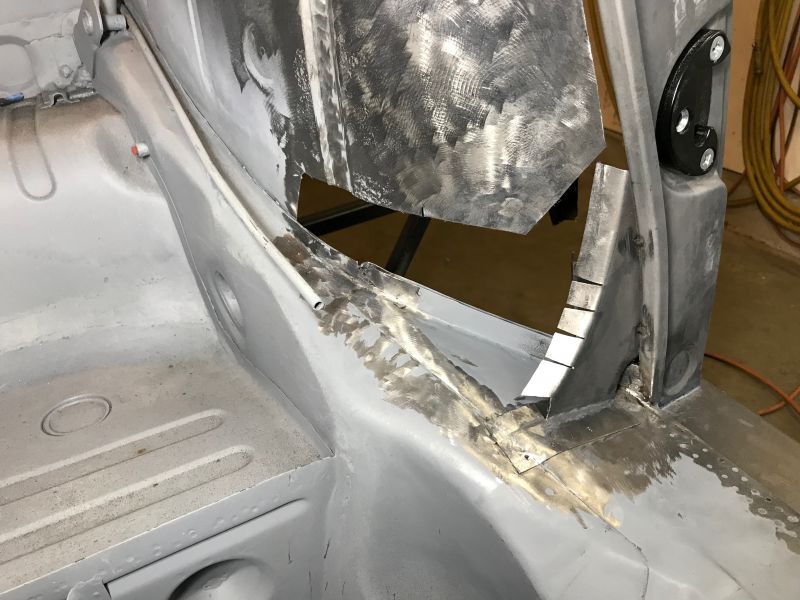

                    • Time to start repairing the BIG holes!
                      I tried to salvage as much of the OEM inner fender as much as possible, but the metal was quite thin after 55 years.

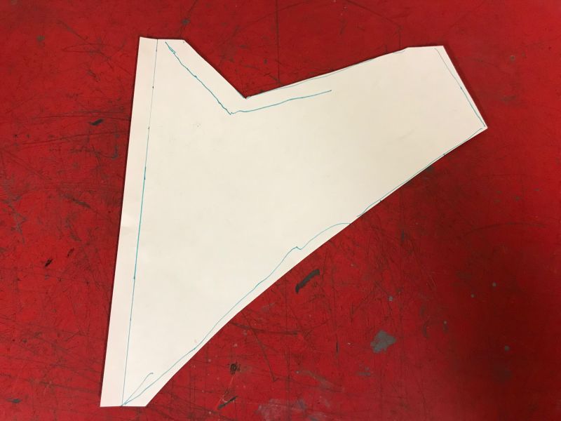

                      Crude template to start with as I planned to overlap the OEM metal and slice it out.

                      Once the bottom piece was in and dollied/hammered I fit the top piece that mated to the window ledge.
                      This piece was also made oversized so I could cut back the thin OEM metal.
                      Old metal not looking too good.
                      Then to the last hole.
                      Nice curve to follow the lockpost.

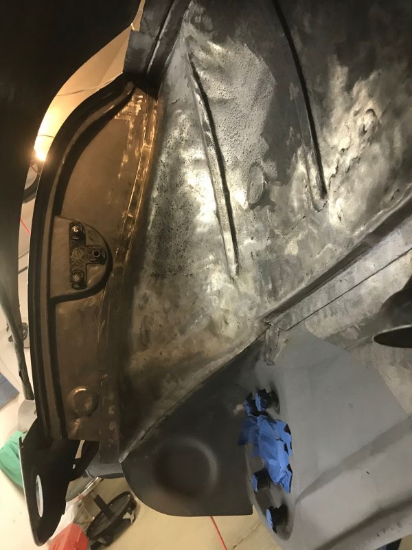

                      • Onto some small, but important parts.

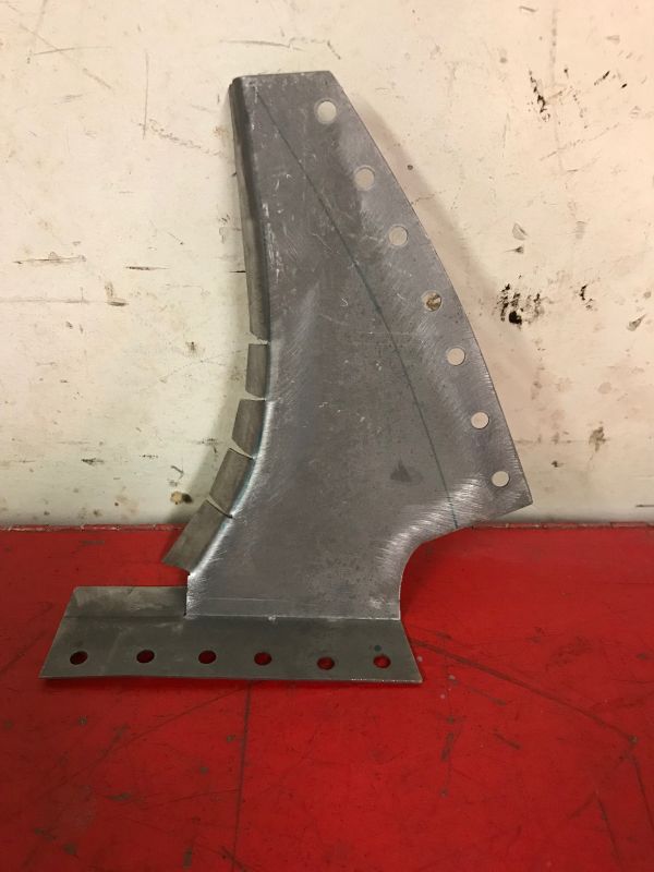

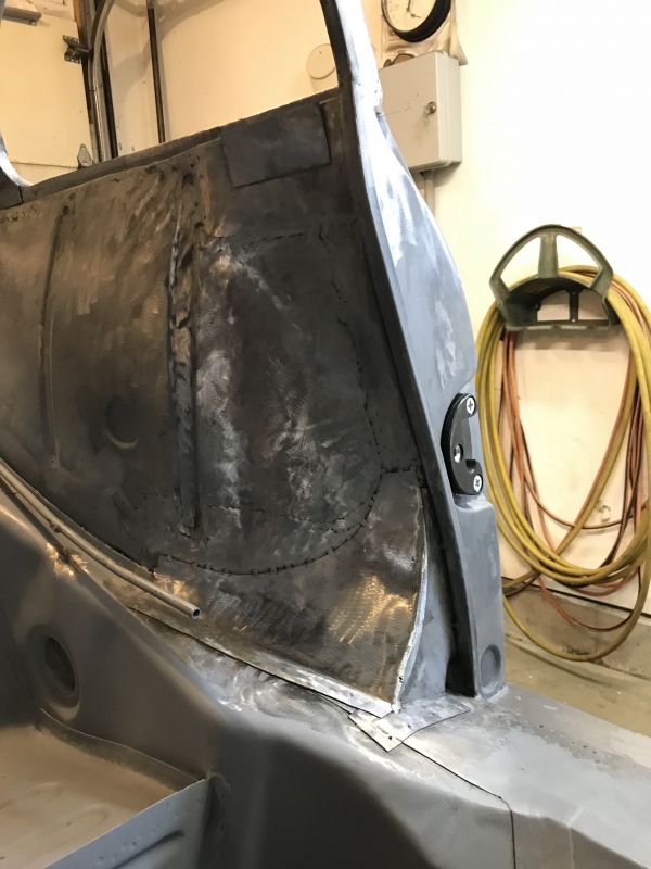

                        Time to finish the gussets at the lower inside corner of the lockpost.
                        Completed gussets. I also installed a new metal tab for the upholstery at the top inner wall.

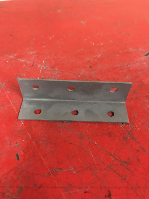

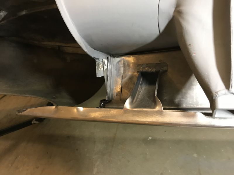

                        The T6 356's had this angled piece installed at the lockpost/sill intersection. Made from 16 gauge CRS.
                        Installed looking from below. The sill flange holdoff was also spot welded into position after insuring a nice transition from door to sill.
                        Slowly getting there, one piece at a time.

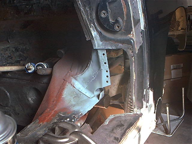

                          • Hi Phil,
                            I think that hole can be traced back to the early 356's. Maybe it was there for water drainage?
                            Here it is on my car. The shadow on the last picture hid it.
                            JP
