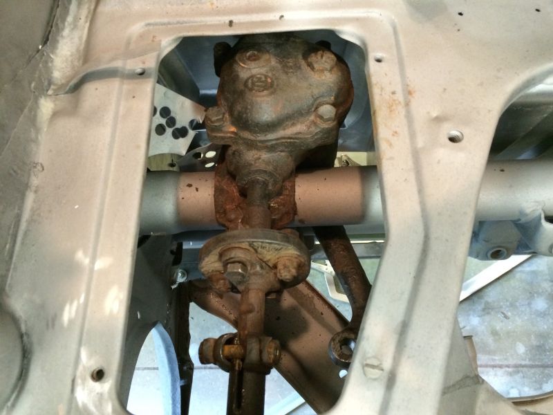

        Also, DG was kind enough to measure the distance from the steering box hole to the back of the indented driver's side rear wall at between 4-7/8" and 5". Can someone get a quick measurement from the thinner portion of the lower torsion bar as another reference point? I'd hate to weld everything in to find out later that the steering box doesn't fit!

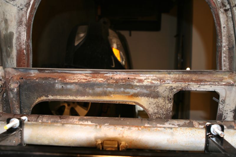

            Here's a picture before I took the battery box apart. Even with the patched on metal the back wall is pretty close to the torsion bar. This welding is some of the better areas that was on the car.

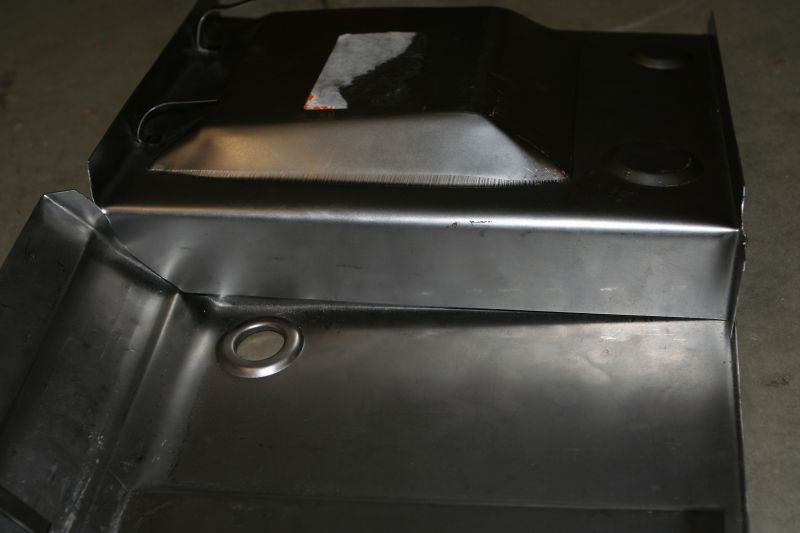

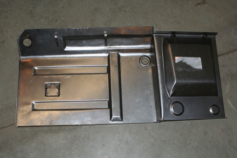

            The rear wall comes in two pieces as in the original. The height is dead-on accurate. Mine was dented in a few places and needed some work to get right. Each outer top corner has to be cut to fit the angle of the trunk floor.

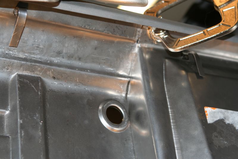

            The area where the two pieces join is not finished and needs a lot of measuring/cutting/massaging...repeat.....to get to fit correctly.

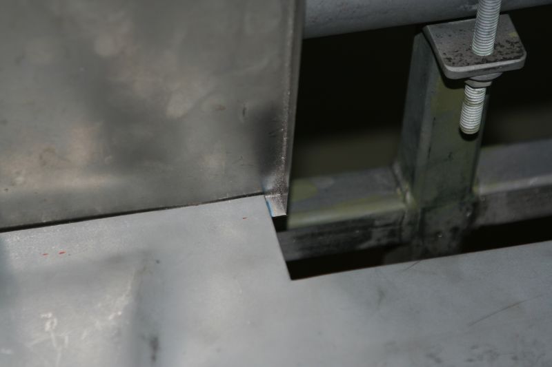

            The length of the larger piece, however, is too long by 6mm (almost 1/4")!! Grrr....

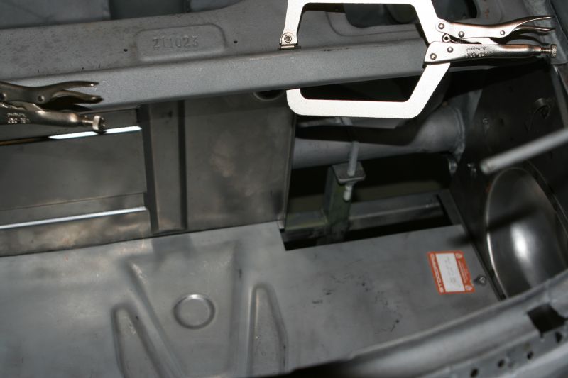

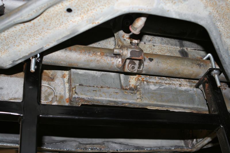

            What's funny with all this measuring is that it doesn't mean anything if the steering box doesn't fit! The gear box has a nipple that fits into a hole in the torsion bar, so you know you're in the correct spot. Simple solution. There was enough wiggle room. I installed the steering column just to make sure and things were good. If anyone is interested: the long rear battery box wall is 25 mm (1") from the thin portion of the torsion bar. I can fit an 11/16" socket in between the torsion bar and rear wall to get a standard from side to side.

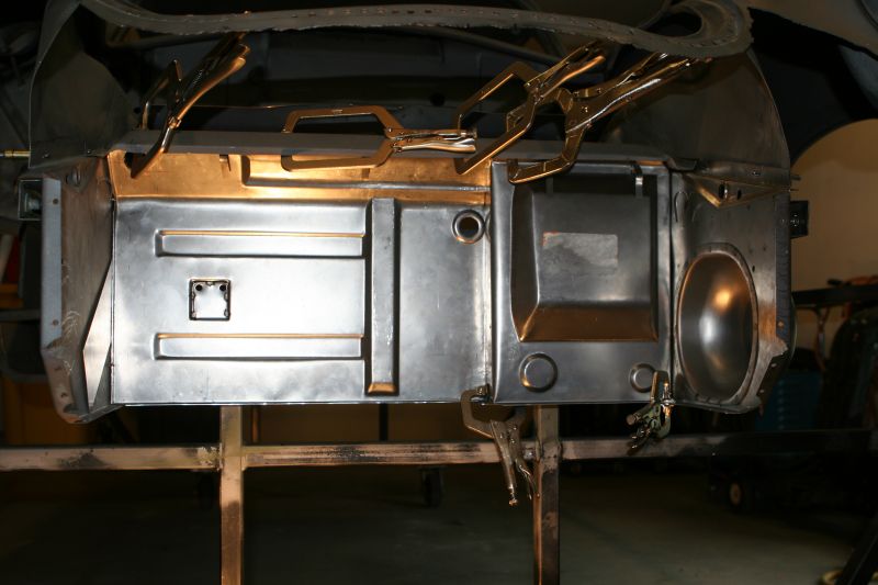

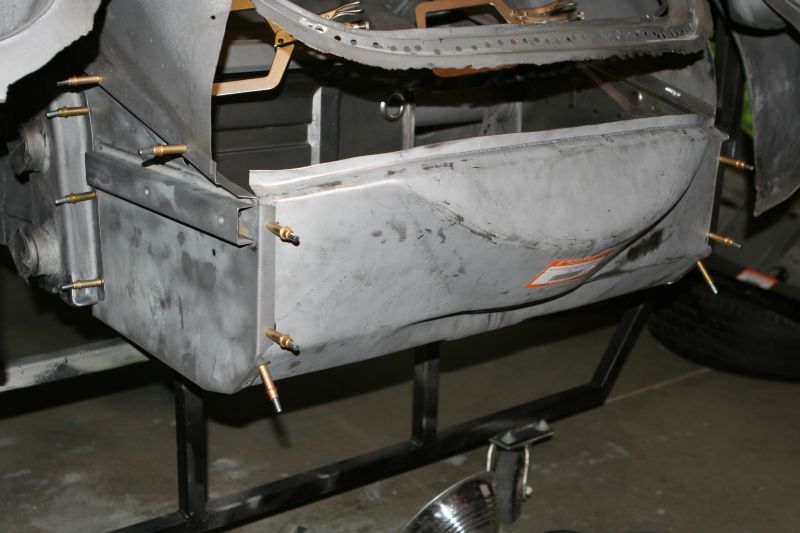

            One more piece mocked up. I love these Clecos. All the other panels (sides, front and floor) fit almost perfectly without need for cutting.
