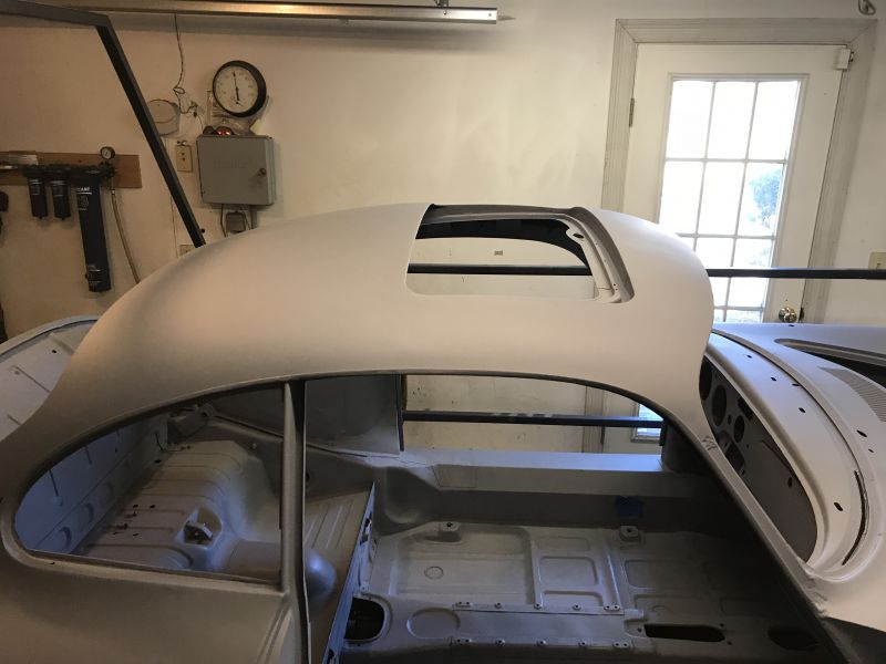

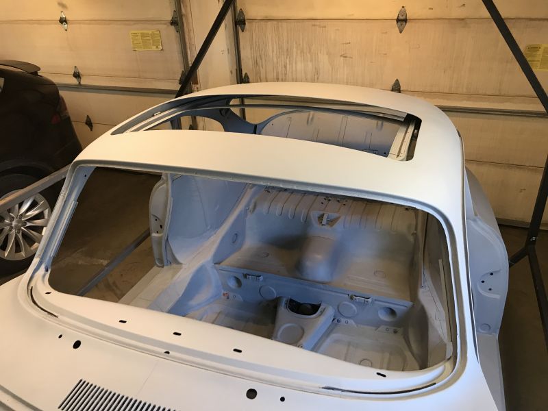

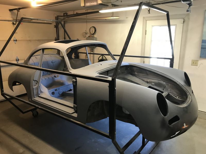

      • Thanks guys!! A sunroof installation is definitely not for the faint of heart
        Everything is now in primer.

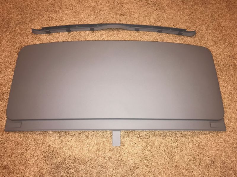

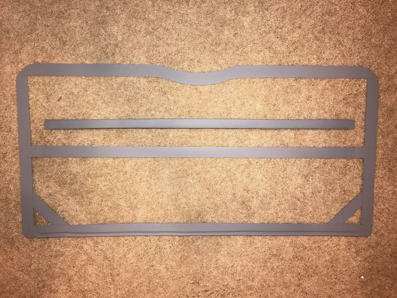

        Headliner frame and reinforcement piece.

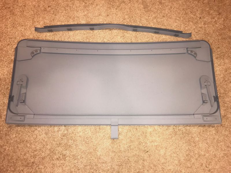

        Inside of cover with sealing rail.
        Outside of cover.
        Looks pretty good
        I'm glad that the hole I cut into a perfectly fine roof turned out so well.
        Lots of new metal throughout the car. I now have to fit the hood, light buckets, fender supports, and miscellaneous nose parts.

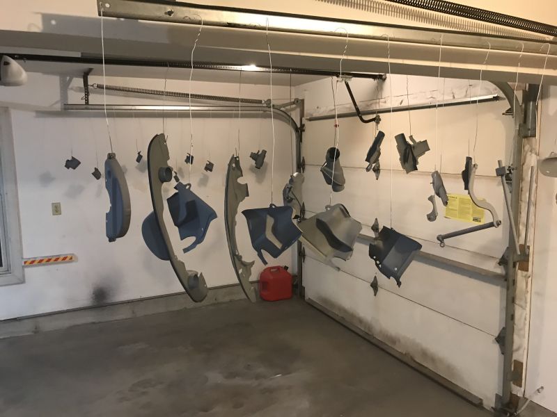

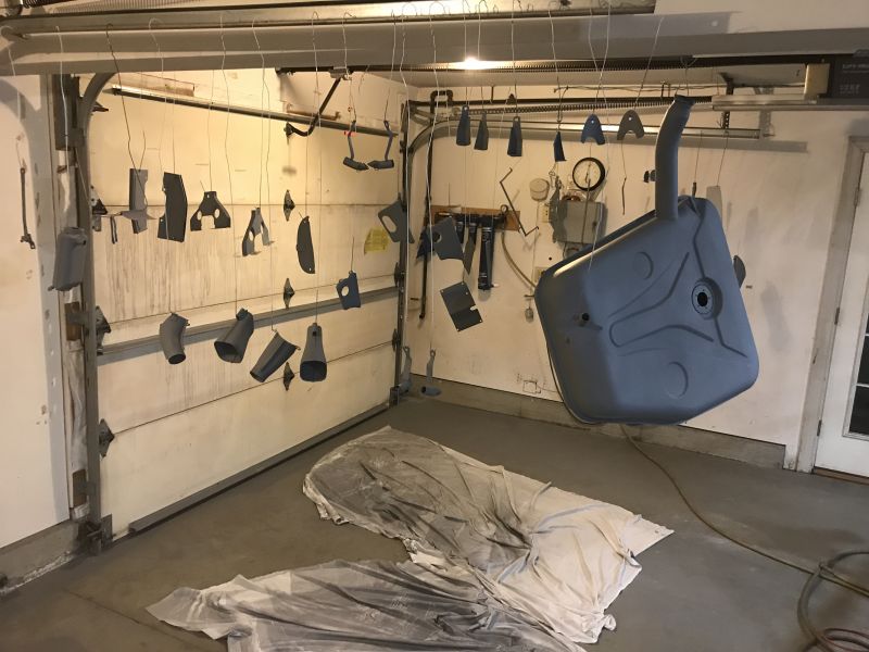

        • Hi Group! I decided to take a break from metal repair as working in the garage during New Hampshire winters is not the most fun. I took on the daunting task of preparing, renewing, finding, purchasing all the small parts that make these cars run. I focused on the things in the trunk. It's amazing how many parts go into such things as the emergency brake system, wiper system, windshield washer, and fuel system. The car had been left outside for many years so things were just a bit rusty and pitted. In addition, the car had been disassembled and the parts stored in multiple boxes with new rhyme, reason, or markings.
          The first thing to do was research the parts in the Porsche manuals then go through the boxes to locate what I could find......then peruse the Stoddard catalog and then purchase or make what I couldn't find. After that came hours and hours with the media blasting cabinet. The benefit was that I listened to a lot of great audiobooks while blowing glass beads.
          This past weekend I cleaned out the garage as the temperature was finally above 50 F. I also burned some kerosene to get the garage into the 70's. Perfect to prime then top coat.
          I'll post pix as I start putting things back together. The wiper motor assembly is pretty cool.
          Thanks for following.

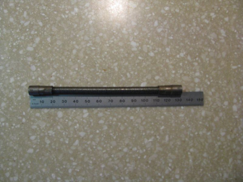

              • Hi Joel,
                The flexible shaft is NLA and comes in 2 different lengths: 150 x 6 mm and 130 x 6 mm. I've heard that Larry Markham, at Markham Motor Works in Burbank, CA, used to make a replacement sunroof flex shaft using a section of a truck speedo cable with the ends that would fit the sunroof motor and drive. I don't know if he still does. If you reach out to him, please let us know. Maybe Jack, Justin or Bruce may know if anyone is making these.

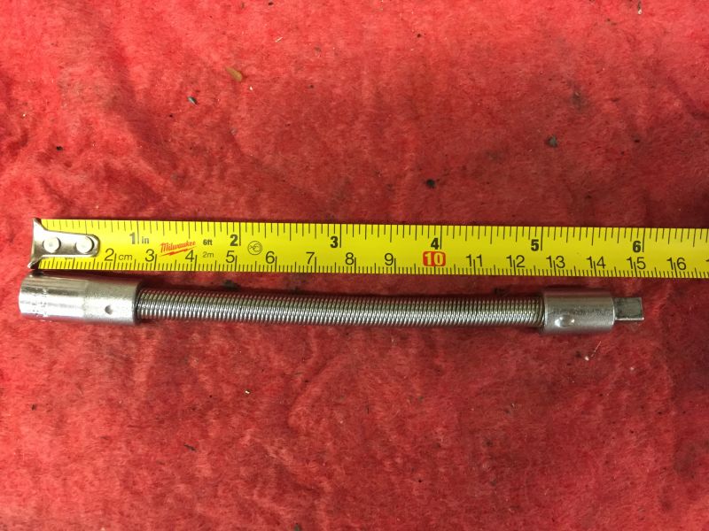

                          After looking in my tool drawer for quarter inch stuff I don't use often, I found this Hazet extension, essentially 6mm ....but adding a socket goes beyond the long measurement of the two, 150mm ...... but there's a start.
                          Meanwhile, this part will likely be found in a box of old 'stuff' at a swap meet or on eBay for a bunch of money. There were Golde optional manual variations with a folding crank handle with a black know that was in a formed white plastic cup in the center of the forward roof above the mirror where the "emergency" mechanism is. I like that solution best.
