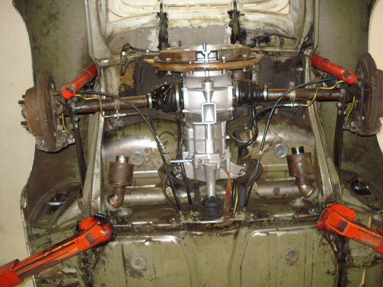

        • Sorry John for making you work harder
          But what is the 2 "round holes/bolt looking" spotted on the rear floor pan under the tranny connection ? ( just in case you have not welded the rear part in yet.... )
          Sorry that I do not recall whom Credit it is for the photos that has been shown....found a couple of years back.

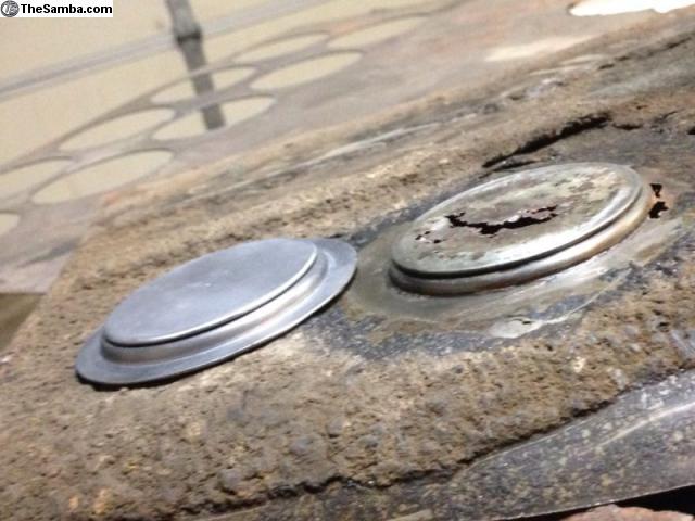

            The plugs that you are seeing are holes/plugs in the 2 seat bottoms that are also a Karmann thing. Tom Perazzo made some replacements that are exact replicas. I've got a pair, but don't know if I've got the energy to install them as the repro embossments look pretty good.

            Here is a picture of an OEM plug juxtaposed to Tom's plug.

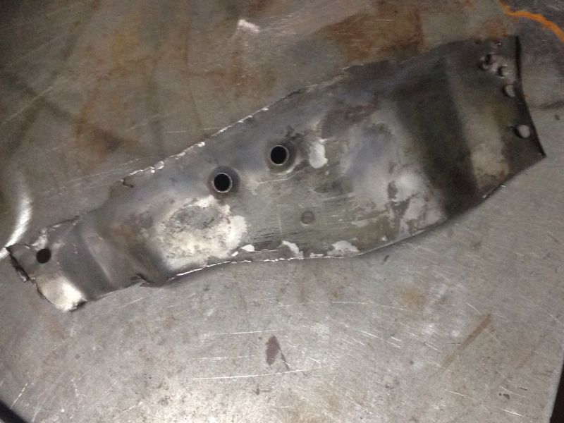

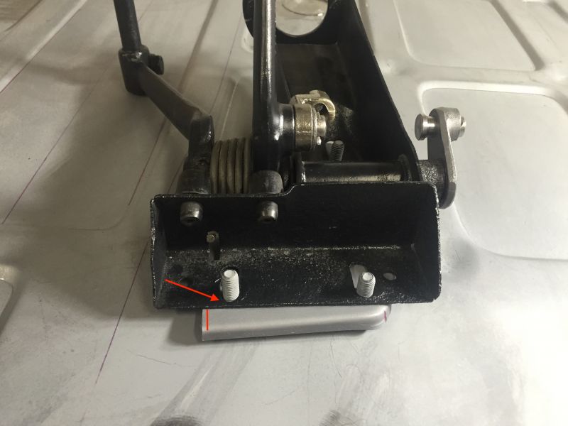

                      • Another repro piece to modify to allow better fitment. My car came with no "C" bracket pedal cluster support and Bubba had welded the pedal cluster to the pan. So I bought a repro piece from Stoddard, which is very well made, but the bolts weren't in good locations.
                        The left-most bolt did not sit against the rearward portion of the pedal cluster. Also, the bracket did not sit underneath the pedal cluster to give the best support when pushing forces are applied to the pedals. The bracket needed to rotate clockwise and be moved forward.
                        I dremelled out the bolts, drilled new holes and welded the old holes closed. This allowed the "C" bracket to fit tightly around the floor pan embossment. The picture shows the original holes and the amount they had to be relocated.
                        All the bolts now sit against the rearmost portions of the pedal cluster cut-outs and the bracket now sits directly under the pedal cluster to give the most support.
                        Complete and one less thing to do as the pans are fitted.

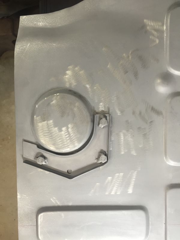

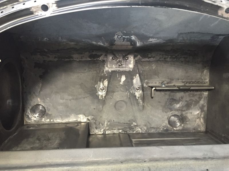

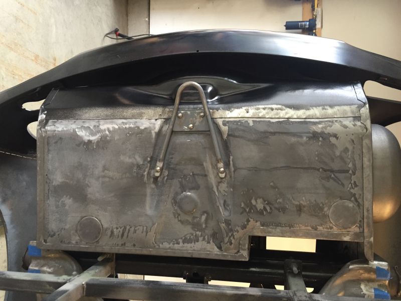

                        • I took a break from fitting the pans and worked on my pet project.....the Karmann drainage holes and plugs. Tom Perazzo and I have research it a bit more and found some more pictures and got measurements from an OEM battery box pan. So......
                          The left plug is centered 50 mm from the left side of the pan and the right plug is centered rearward of a pan embossment and is 600 mm from the left side of the pan. Both plugs abut the bottom pan flanges.
                          Looking pretty cool. The plugs are just like the K-plugs in the floor pan.
                          JP

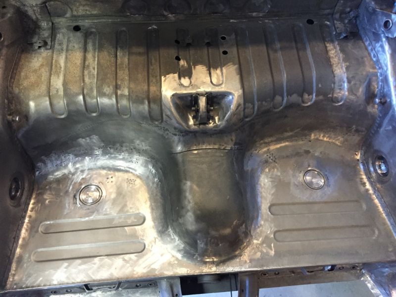

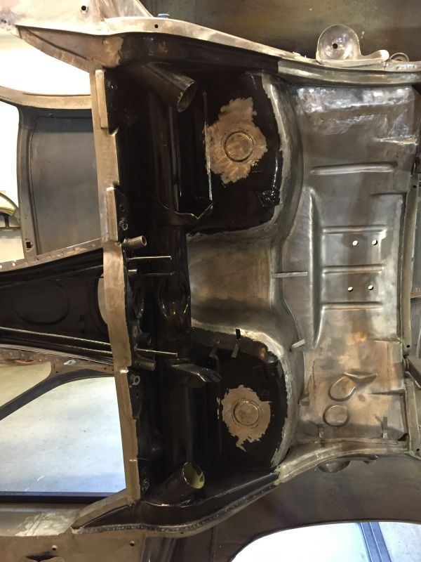

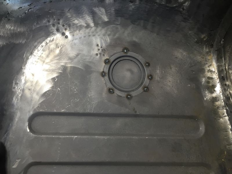

                            • Just a quick update as I had to work all weekend......the OTHER job!
                              Spot welded in Tom's replacement plugs which have a raised rim, which is different from the floor and battery pan plugs.
                              Looking good from the bottom. You can also see the Karmann drainage holes in the the outer rear frames near the torsion bar and also in the outer longitudinals.
                              Seat pans.
                              Thanks for following.
                              • Not just the plugs but the entire rear seat tray looks great! A lot of hours spent there for sure. Nice work John!
