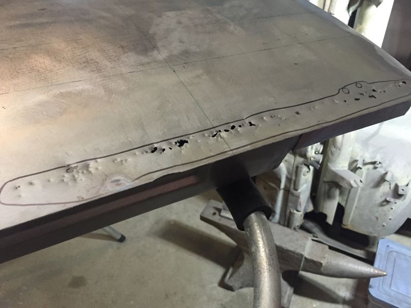

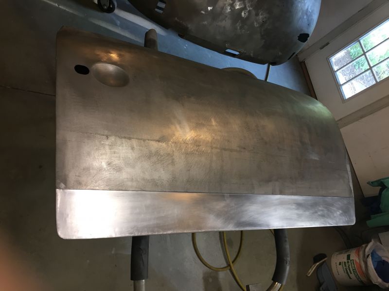

    The bottom part of the door skin needs a bit of help now that I've repaired the rest of the door.

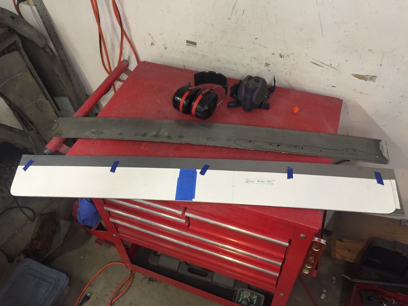

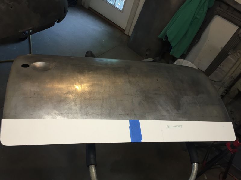

    I made a template and placed reference marks on the door to help realign the replacement during welding.

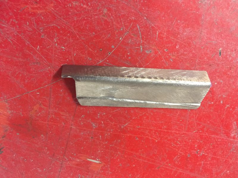

    Replacement piece.

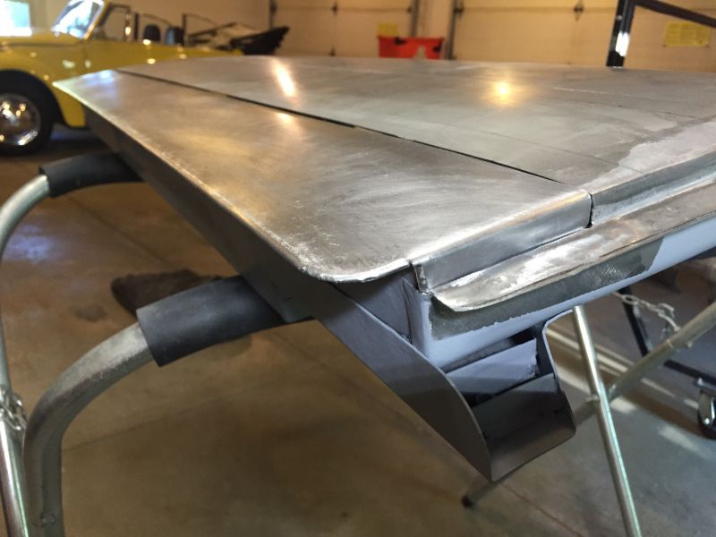

    Repaired and looking so much stronger.

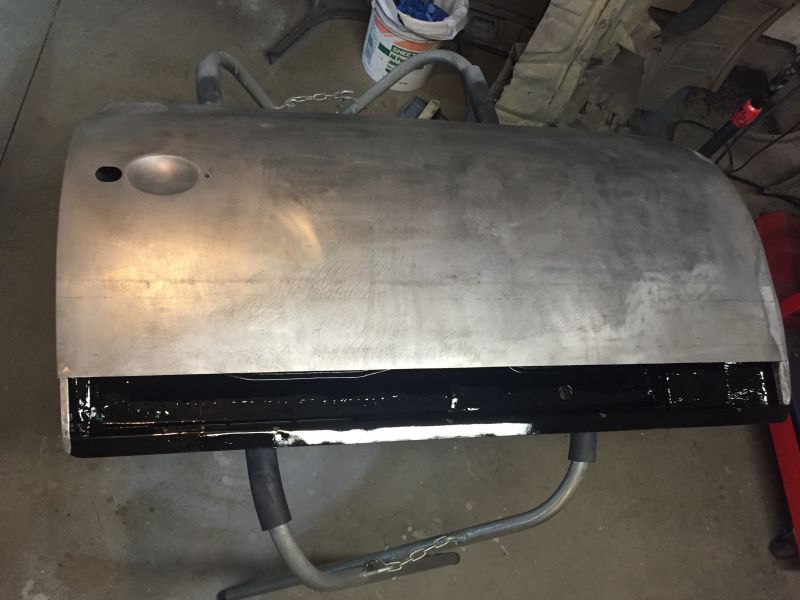

    The inside sanded to remove the old paint and rust and the remaining tar removed with scraping and gas then treated with phosphate.
    Epoxy primed and top coated. No future rust!

    • Looks good John. Just make sure your weld line is high enough to planish with a dolly behind.
      • That's for sure, Phil! I haven't made the final cut yet, but it's very near where it needs to be to get my hand and dolly in there. I want the two metal edges to mate up evenly so I can work on improving my TIG skills

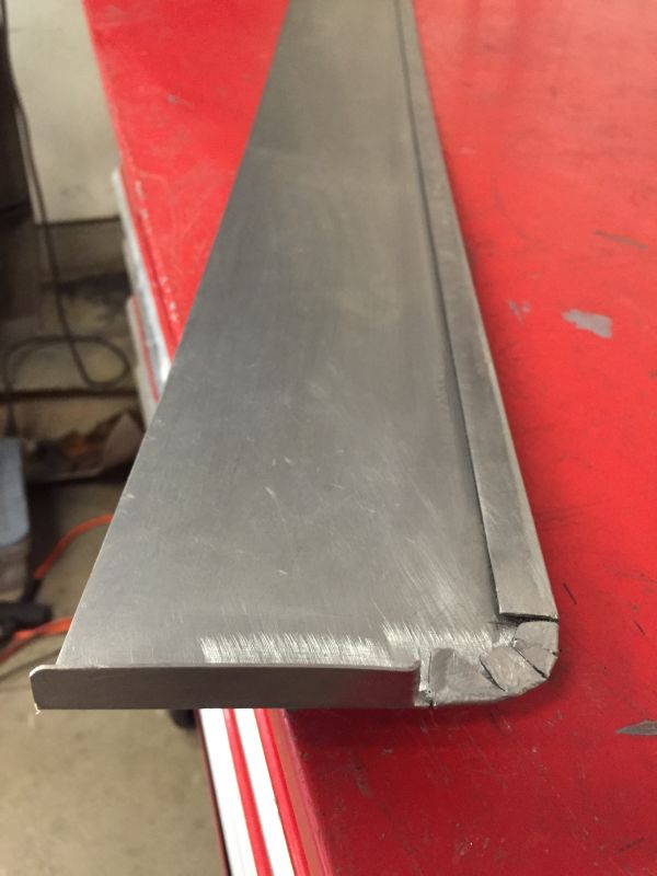

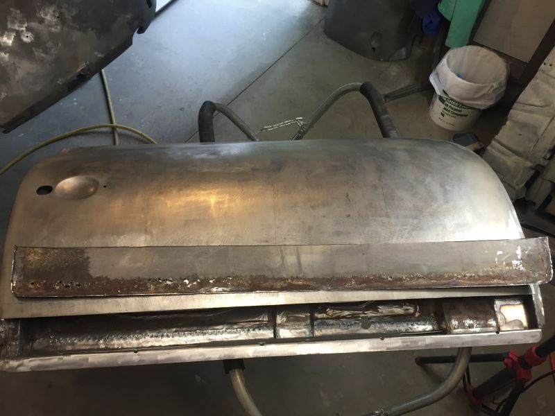

        • Finally to the point where the door skin can be repaired.

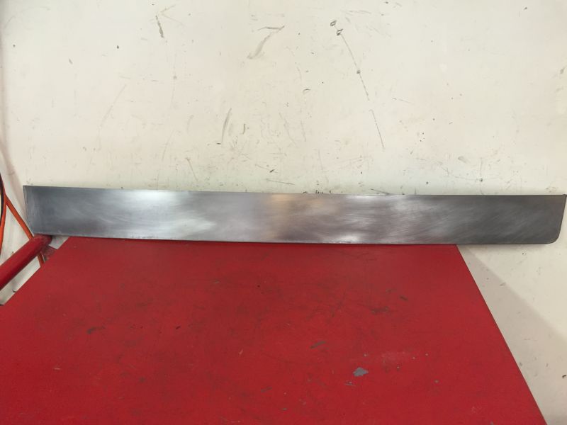

          Cutting the replacement panel. The Stoddard panel front matches the angle and curve of the original door and the rear is unfinished so it can be made to fit any door. I originally bought a replacement panel from RD, but the gauge metal was heavier, it was galvanized and the front angle didn't match up. Oh well....

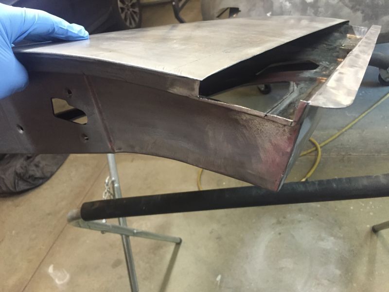

          The panel needs to be cut to size and the flanges bent correctly as they come only rudimentary bent over.
          I pie cut the rear to make the curve easier and also had to place a 90 degree bend to finish the side off.
          Pretty nice match. Once the jigs are in place there will be no gaps.
          The panel has a nice crown and fits perfectly for TIG welding.
          Thanks for following.

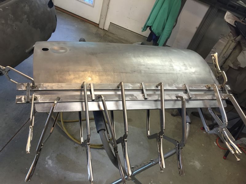

          • Glad you had a great vacation and good to see you back at it John! I'll be watching this lower skin repair with great interest to see how well your holding jigs performed in controlling the heat warp. Wishing you best of luck here.

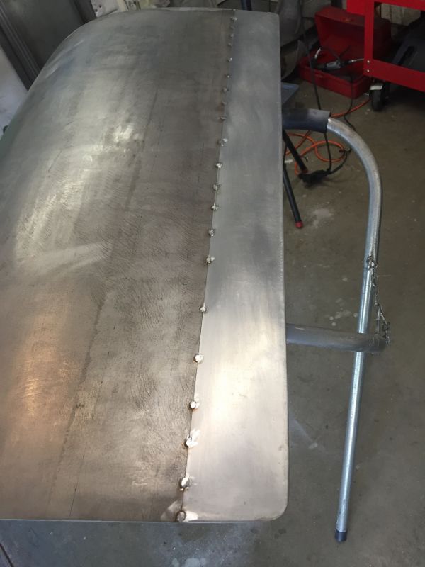

            • What an experience welding the door skin!
              Jigs set up and ready to weld.
              Spot welded together and things looking good with no heat distortion. I then TIG welded the two panels together and all went to hell. But I recovered from it. The hard part was keeping the curve from front to back as the door gets fatter in the center.

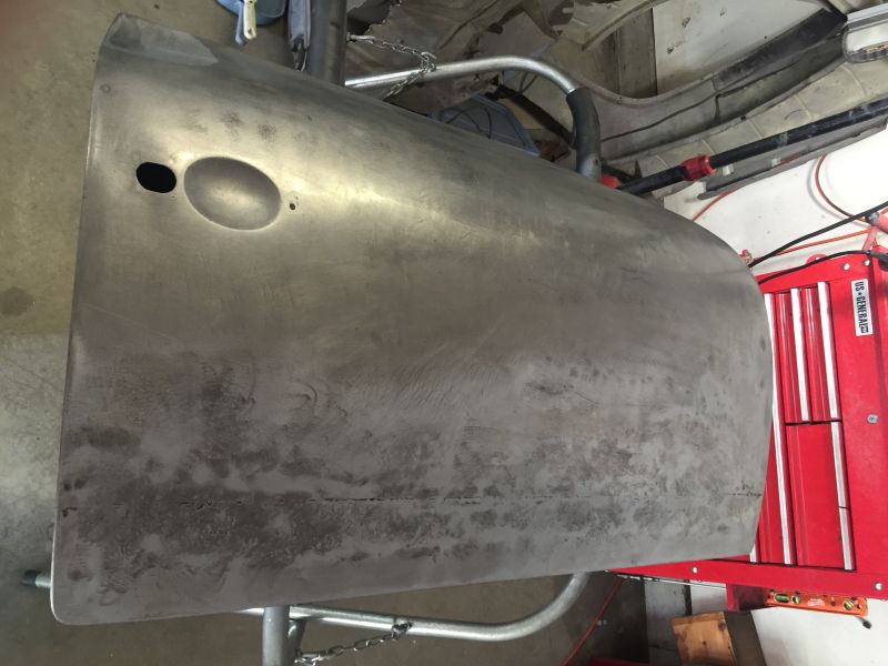

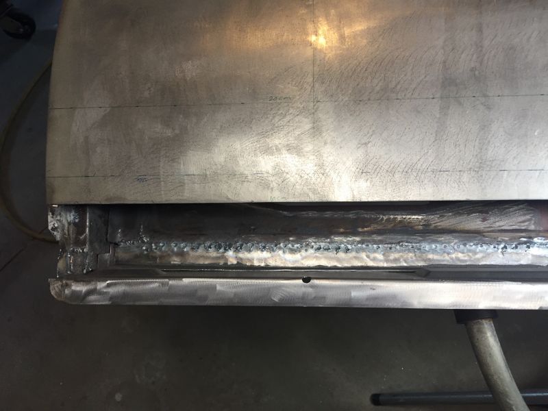

              Inner side flanges.
              Complete after 3 days of hammer and dolly. The nice thing from this whole experience is that my shrinking and stretching skills are really good now and all the distortion is gone. The door skin has a nice curve top to bottom and from front to back.

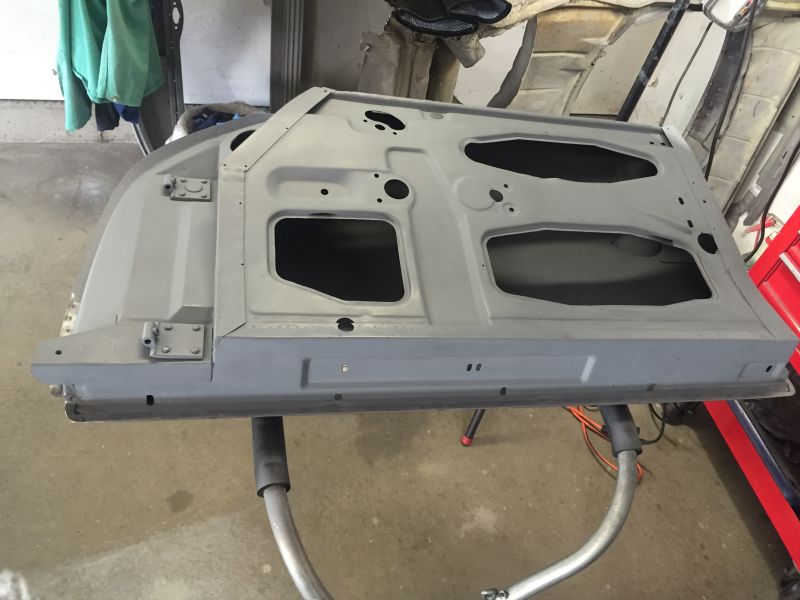

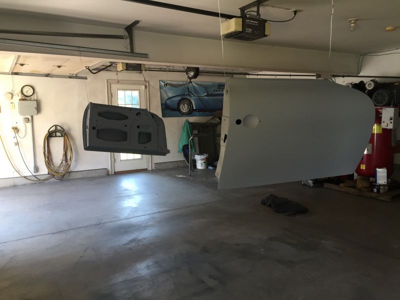

                    • Spent a few hours today ensuring the insides of the door were clean of any previous sound deadener then sanded them down and primed them. I had previously converted any remaining rust in the seams.
                      Moved the rest of the car outside so it could enjoy the lovely sunny weather
