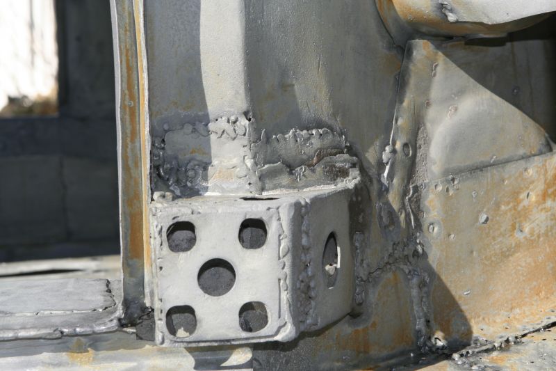

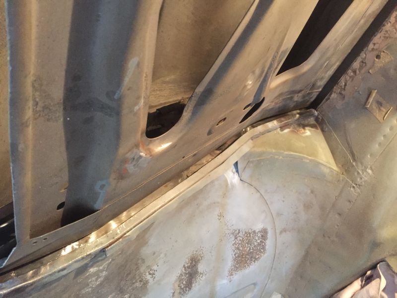

        This is what things looked like before any metal repair. Pretty nasty.
        Even nastier!

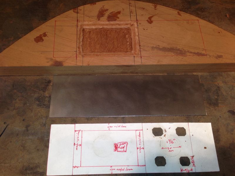

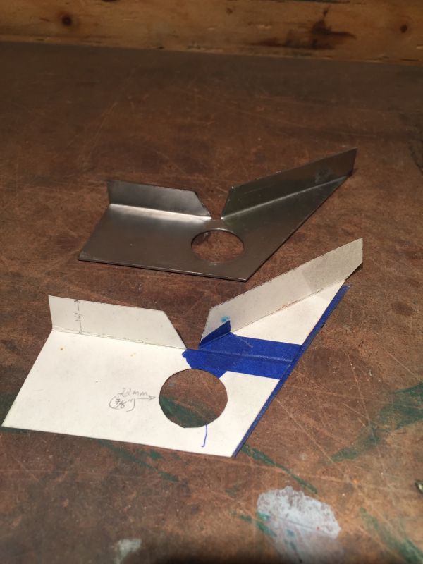

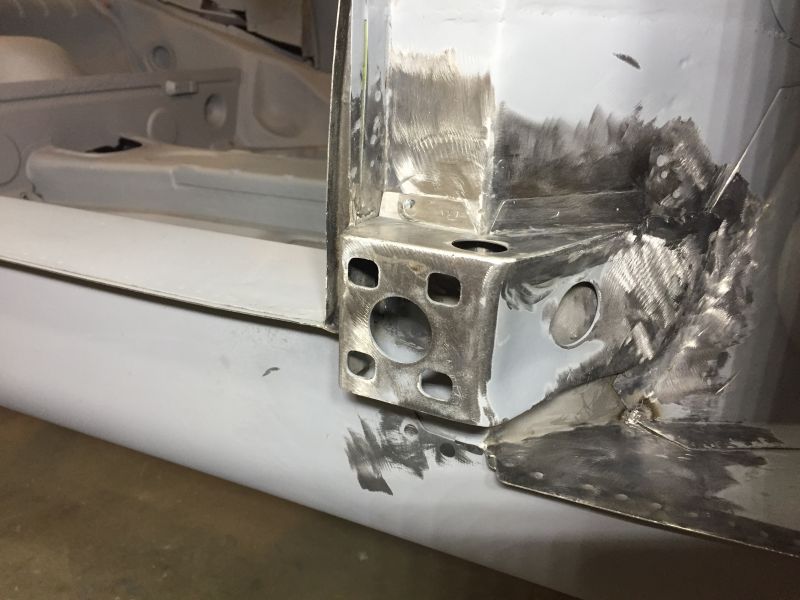

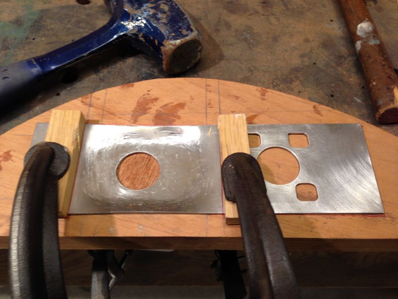

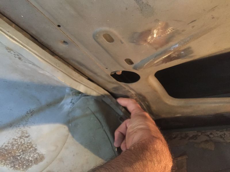

        New door hinge bosses were needed. I made a wooden buck and used 14 gauge plate with a template.
        A little hammer time.

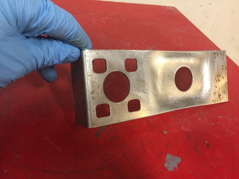

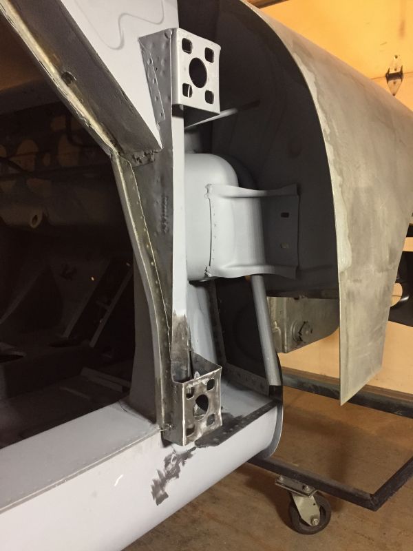

        Looking much better.

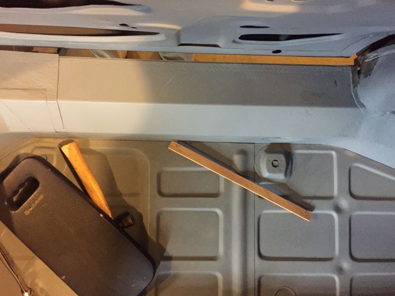

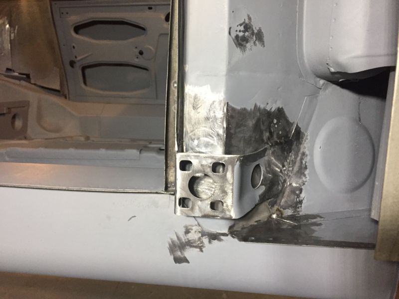

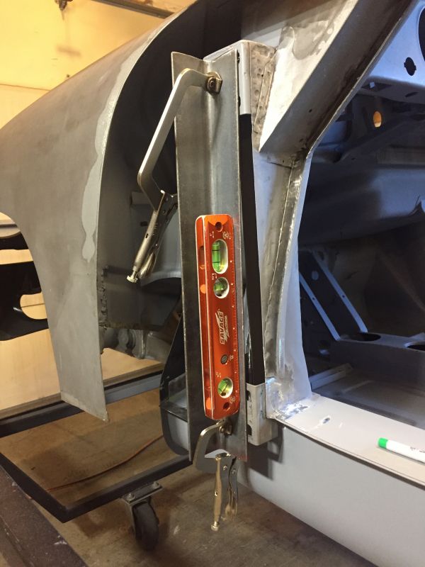

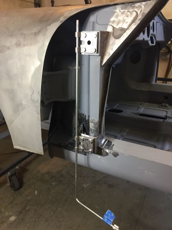

        Making sure both hinge bosses are in the same plane.
        Tacked in place and verified with a metal rod.

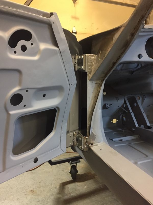

        The doors swing freely.

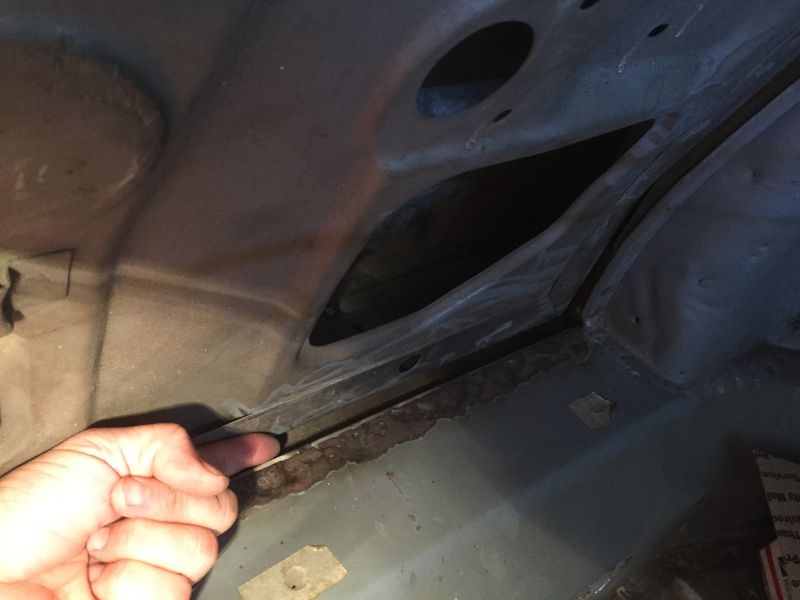

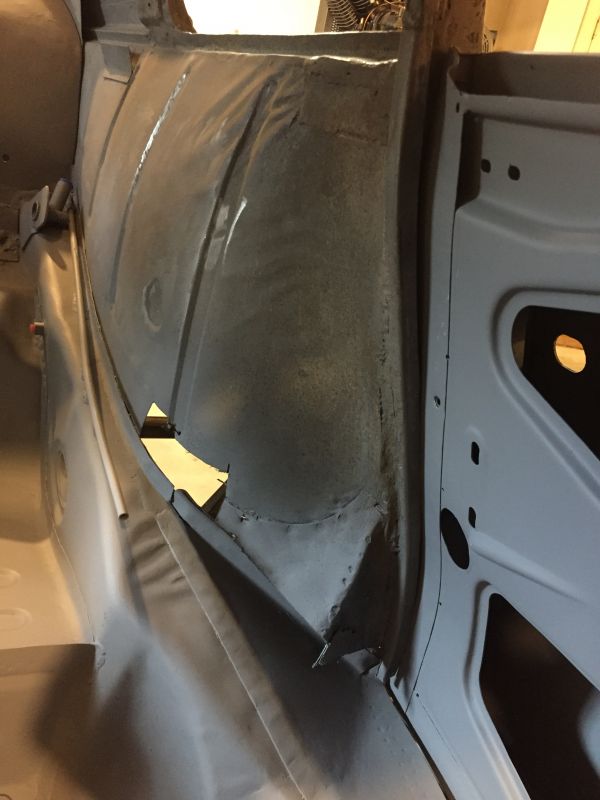

        Now some questions for the experts All my original landmarks are missing due to the rebuild and I couldn't trust those anyhow due to Bubba's previous repair attempts.

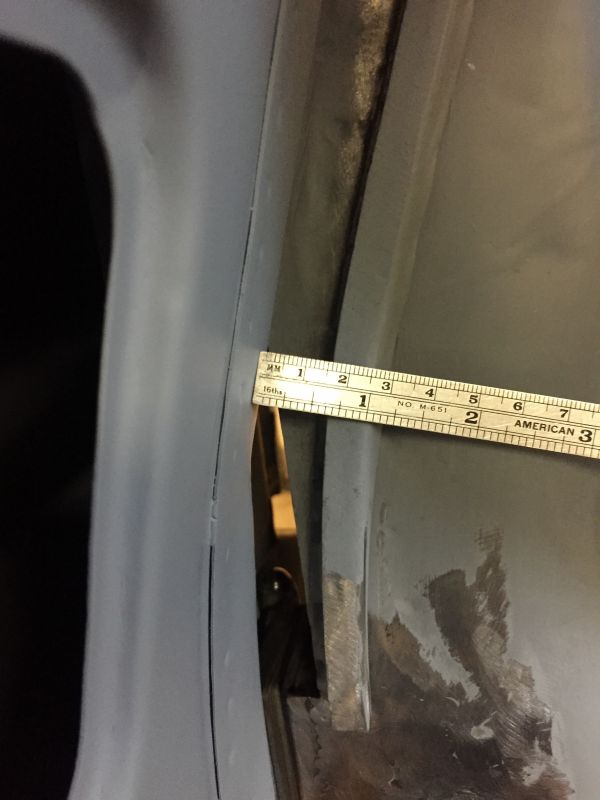

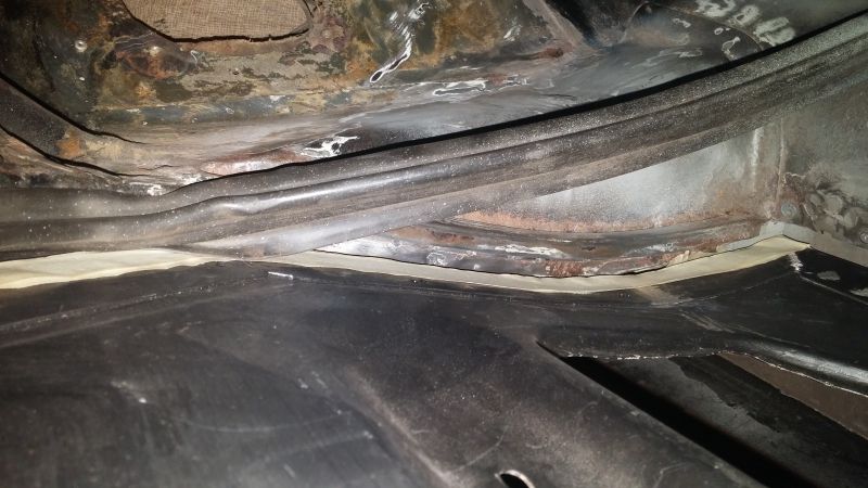

        Is this front gap too wide between the door frame and channel?

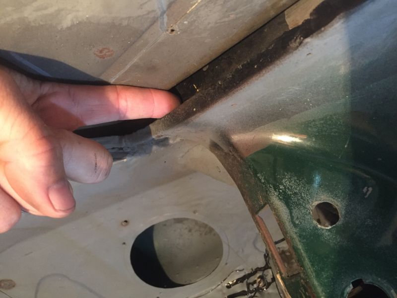

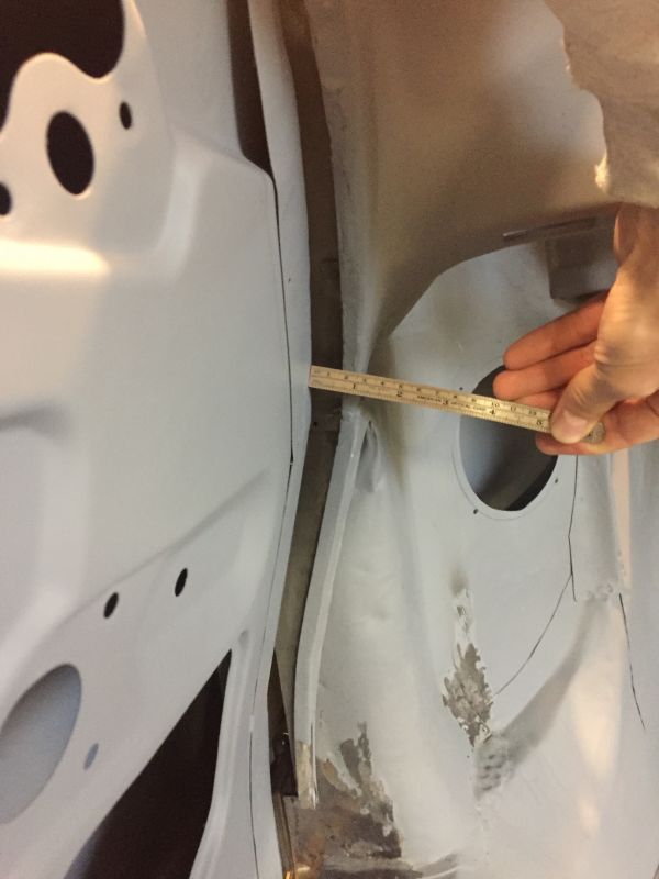

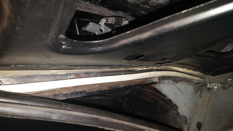

        What about this bottom gap? The sill will be installed here, but is this gap too wide?

        • Hummm, I have not been on this site (or any) for a while and now see some of what I have been doing lately is the subject here. Timing. Also emailed alerts.
          I don't have handy pictures but here are the highlights until a real expert chimes in:
          Obviously, being "made by hand" the doors are all of a slightly different fit, car-to-car.
          Coupled with that, various vendors of seals have those in their own rendition of what's "correct."
          Thus, I buy every seal from every vendor and use those often huge discrepancies for fitting compensations.
          The average vertical gap (channel) which will pass the "dollar bill test" when completed is 15mm, + or -. A "finger's thickness" that's tight without hurting.
          The lower horizontal gap for the sill seal is USUALLY slightly wider, but a trial fit is always preferred prior to paint.
          Details: if the sum of the parts that influence the rubber are taken into consideration by year and model, I use multiple layers of masking tape to mock-up the thickness of wraps of (and including) eventual paint, glue, headliner material, vinyl or leather upholstery, etc.
          The door latch and jamb striker must be installed and the door window frame included in the pre-paint trial assembly. There are thinner and thicker door seals to try.
          Often, the edges need to be trimmed here and there or thin shimming in the channels is needed to move the rubber seal inward or outward to get a good average. I use black thin dense foam rubber strips I cut from sheets I buy at a craft store.
          Know that if a thin rubber door panel seal on the door's edge(s) is factored in, a few layers (at least 6) of tape will be a good idea.
          This is all for a Coupe. Open 356s should be gapped and mocked-up on their wheels or at least suspension, fully loaded whether really weighted or the equal in anvils and sandbages, etc.
          One last thought: some (most?) replacement door panels come with a bottom sealing sleeve containing a foam rod. Those rarely work as the original rubber tubing did, so remove those if they are interfering or replace them with softer hollow rubber tubes.
          I am being frustrated right now with an A Coupe that was restored in Europe about 30 years ago. They used C doors and A chrome frames. Now, I am mad at myself for not noting how the frames sealed when it came in because now a decent seal fit would be best done with the thinnest seals for the door shell and the thickest for the chrome window frame and that has been shimmed and adjusted and shimmed at the door inner bottom as much as possible. I did have to straighten the frames where they were kinked at the door tops before re-plating with chrome and that should have triggered the thought that something just wasn't right!
          There is more that goes into this step of de-Bubba-izing, but I will add if and when that comes to me. Seriously, I hope others with experience in this step, well, step forward.

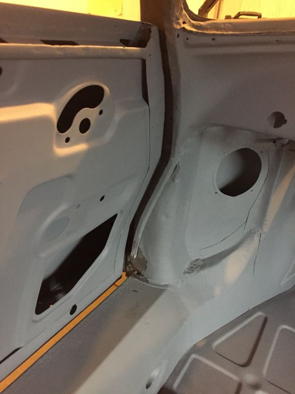

            Here's some shots of my seal channels with door installed. I haven't installed the seals yet, but I doubt I'm going to do any more metal work on these. I plan to modify or shim the seals as needed. As Bruce says it's about a fingers width. A pinky in the B pillar gap. Index finger everywhere else. Please don't take this as gospel because my car has been through a lot of repairs as you have seen.

                Thanks for the advise with the door to body gaps. I mocked up my rubber seals and put 6 layers of tape on the door to get an idea of how things would fit when done. There is still a pretty sizable gap between the door and rubber seal.
                Bruce mentioned that "the average gap between the vertical body channel and the door, which will pass the "dollar bill test" when completed, is 15mm, + or -." I measured the distance from the door to the edge of the U-channel at about 16 mm. Is this the correct location where to measure? Someone on the R posted years ago that they got 11 mm. If need be I can remove the U-channel and weld it in closer to the door.
                The "index finger's thickness" test without hurting works out fine, unless I've got really wide fingers

                    The other thing to strive for is an evenness in raw gap. John, that mid-lower front drivers gap may measure 16mm but the other parts, upper and lower, look better.... but what are they? (that's really rhetorical.)
                    Simple physics, or geometry, or some other class I missed while in the gym in high school insists that the front toward the hinges can crush better....but too much resistance there can compromise the rear end of the door being able to crush the seal as well... back there. A balance is needed. The thin chromed window frame is weaker and needs more aggressive contact to do the same dollar bill slide-out test. It's a lot of adjusting or you get really lucky.
                    Another thing is to anticipate (with tape, usually,) both sides of the opening, not just the door. That includes the 'wrap' on the cockpit side of the gap; headliner, vinyl or leather, both ......and the door top inner 'garnish rail" that may or may not influence any fit areas.
                    The 'wrap' of material is usually at least a millimeter if not more. The angle in the seal channel makes a need for a cut in the hollow 'bulb'/rear of the rubber seal at that point to keep it flat when glued.
                    So, about the same thickness as the rubber on the door under the upholstered panel, front and rear and about the same over the outer edge of the seal channel on the body, install the rubber of choice (which will be too long so as to allow a 'tail' of skived seal over the ribbed threshold mat a short way over the quarter-round door bottom seal onto the horizontal...and tape in place here and there.
                    Install the door latch and striker on the lock-post and adjust the door to be level with the rear quarter panel and the door front to the fender, as well. Then place a dollar bill in the closed door, with chrome channel in place, and see if the dollar can be pulled out easily or not a all....or just a smooth tug, which is what you want.
                    Sometimes, shims ARE needed....Porsche did that, regularly. Now, most seals are different...and we are talking about millimeters here.
                    I have had to remove a couple of millimeters to make room on the outer edge of a channel with tin snips. I've had really tight spots where the rear (in the channel) of the hollow area of the seal was trimmed off and that worked. Sometimes both.
                    Whether the door was original or the car was hit and tweaked a little, I couldn't tell....but I'm speaking of 356s already painted and the doors not closing well or have air noises or water leaks. All the fitting should be done prior to paint. Yes, it take more time to pre-fit everything, but that's what a good job requires....51 or more years down the line.

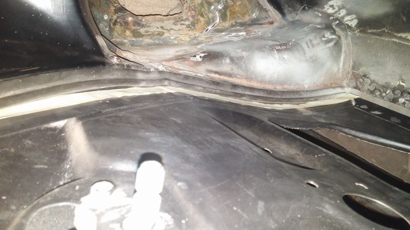

                      John. Did a check on foam car drivers door. About 1/2" gap at front and tighter than that at rear. Have most of the tale build up per Bruce and old rubber installed. Closes pretty nice. Will try the dollar bill test
                      edit - I tried doing this direct from cell phone where I had pics. Pretty bad. Will do it the old way on the laptop next time.

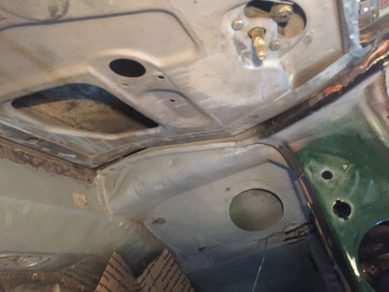

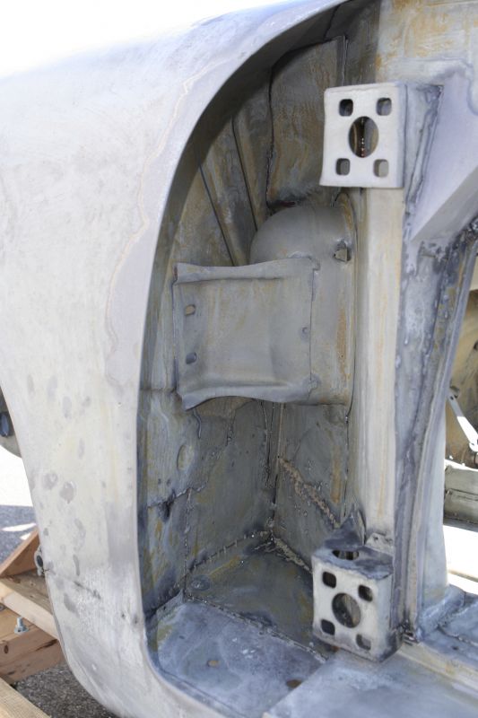

                          • Thanks for all the replies. The front left door gap for the rubber is too wide on my car even with a numbers matching door and original front fender and rubber channel. I'm going to have to play with it some more and will probably need more advise. Meanwhile, I went to the opposite side to install the hinge standoff.
                            I made a new standoff and installed it. Much less perseveration after having installed the left side.
                            Lots of double and triple checking to ensure that the door gaps were good and the door swung freely.

                            Template and hinge boss cap.
                            Everything buttoned up.
                            It's always interesting to look back to where this area started.
                            Thanks for following and have a great Thanksgiving.
