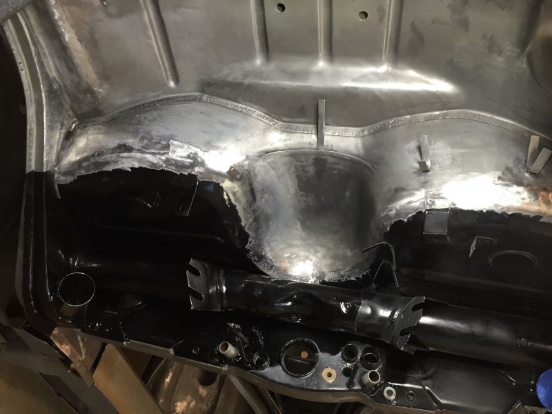

      • Finally back at it. A slow process of cutting out the old bad, making new pieces, welding and grinding. But it's getting there.
        Area that needs a bit of TLC.
        The wheel well sheet metal was cut back to more viable tissue Both the inner and outer frames in this region were a mess especially with the previous repairs and needed to be cut back.
        New 18 gauge inner and 16 gauge outer frame members/flanges were made and welded in place.
        Wheel well metal closing up the gaps.
        Now to continue into the more forward cavity. I'll end up replacing the 20 gauge metal that I put in previously with more appropriate 16 gauge. Not a lot of room to work in so it should be an interesting project.

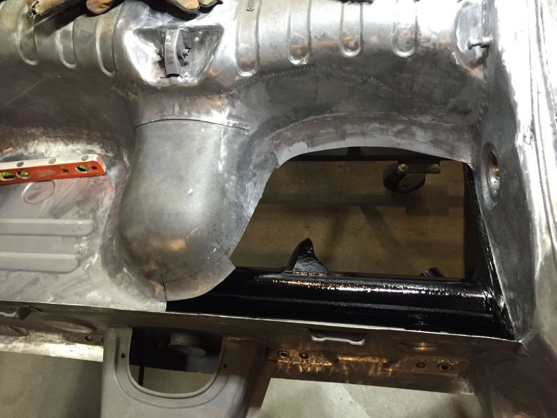

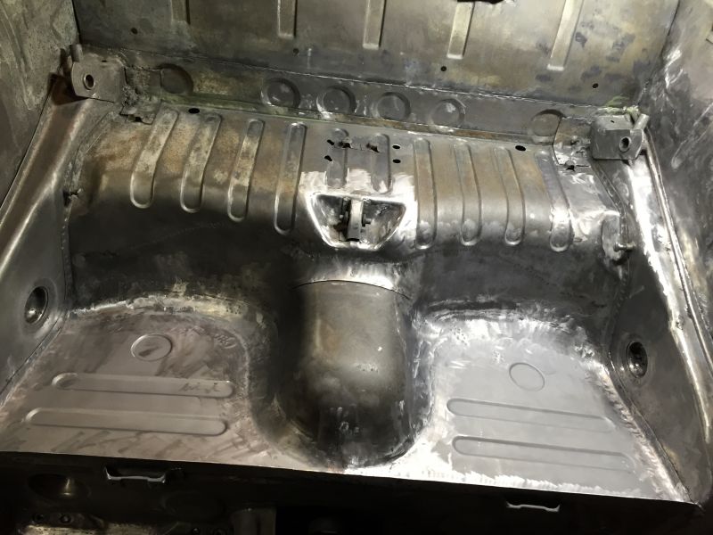

        • Another productive weekend.
          The torsion tube and the hard to get to undersides were primered and top coated as I'd never reach these areas after the seat was installed.
          Likewise the bottom of the seat was painted. I added the flanges now to make my life easier.
          The underside is looking so much better.
          The rear of the car is pretty much restored at this point (ignoring the sheet metal ).
          Thanks for following.

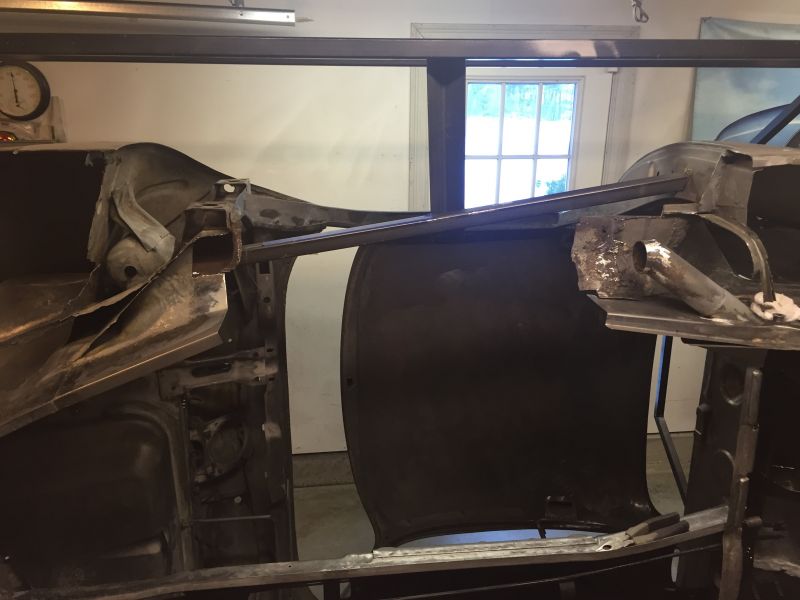

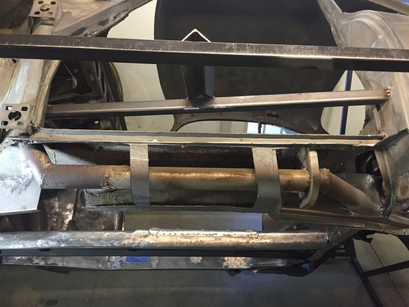

              • Onto the left middle longitudinal. As was expected....lots of previous repairs to dig through before finding any original landmarks.

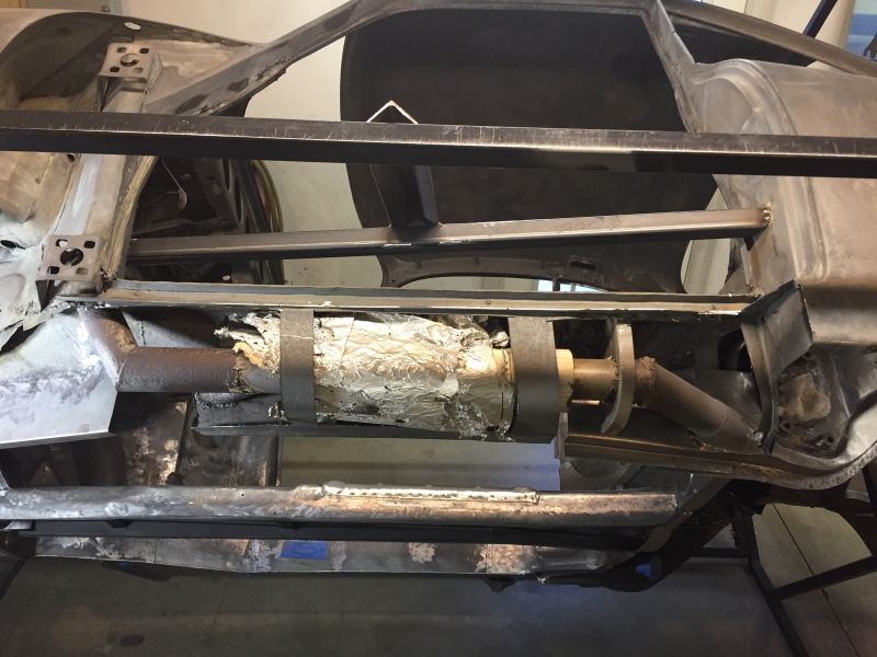

                Cutting away found foam piping insulation wrapped in tin foil. No idea what they were thinking here
                Solid heater tube underneath the insulation. No heater muffler to be found.
                Most of the bad removed and measurements taken. The front heater tube assembly was rusted through as was the floor in the A pillar.

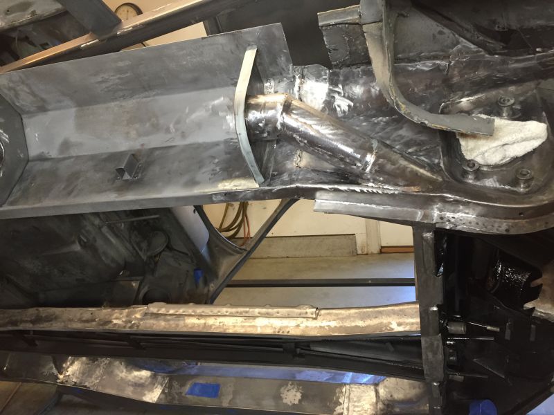

                Took out the remaining outer frame forward of the rear closing panel and replaced it with 16 gauge. I welded it to the heater tube for additional strength.
                Now to build a new middle longitudinal.

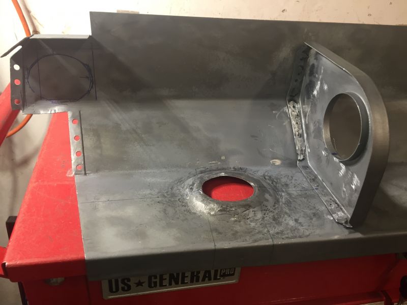

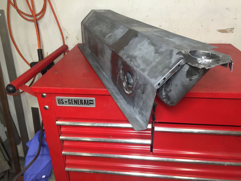

                  • Got some quality car time Lots of hours building the driver's longitudinal.

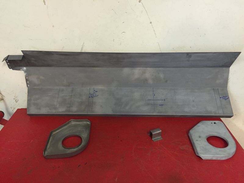

                    Longitudinal fitted to size. The A-pillar floor was rusted out so I continued the longitudinal into this area. Now ready for the heater tube bulkheads and hat clamp bracket.

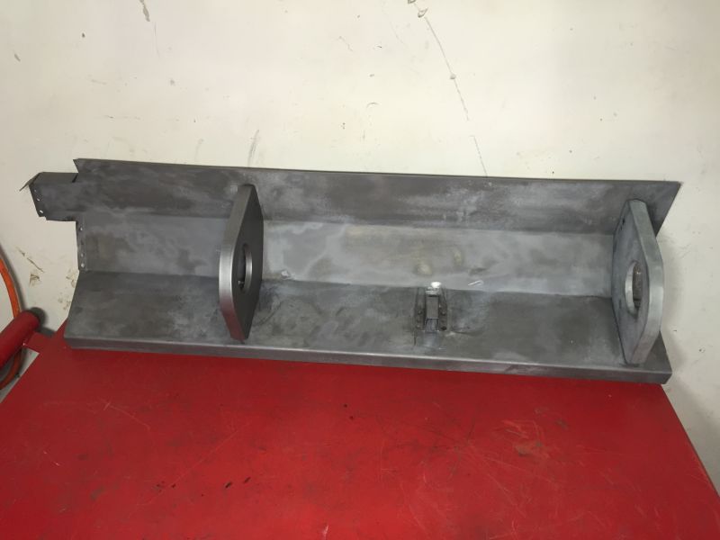

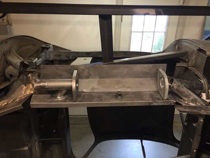

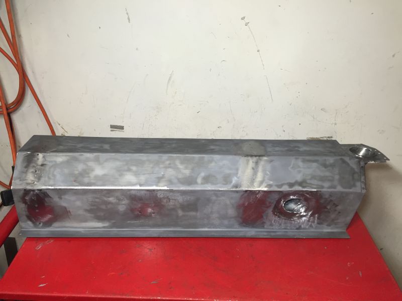

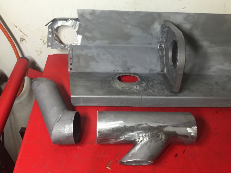

                    Parts to make the front heater tube assembly. The original on the top was pretty thinned and rusted out. You can see where Bubba welded in the new center section then slathered some rubber goop all around to stop any leaks.
                    With the innards spot welded in place the longitudinal got some strength to it.
                    Floor duct concavity formed. The opening for the heater tube into the A-pillar next.
                    Front heater tube assembly coming along nicely.

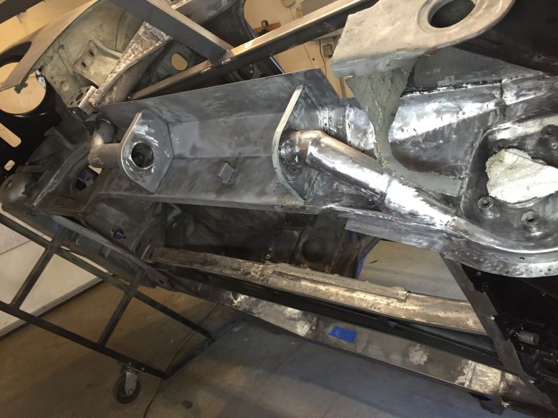

                    Front all welded up.
                    It's pretty cool to see how this all fits together. The Porsche engineers did a pretty cool job.
                    Ready for a bit more fitment then onto installation!

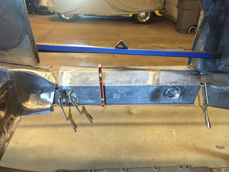

                        • Time to complete this puppy.
                          Everything measured twice, thrice..... and level. First few tack welds placed.

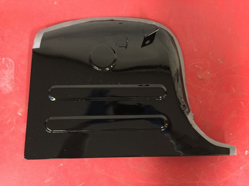

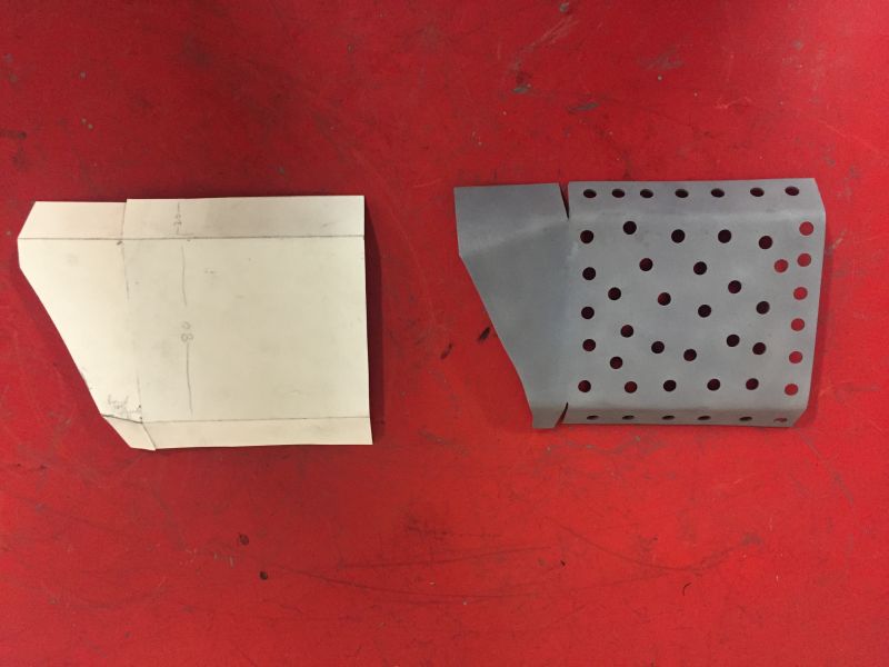

                          Template for the "V" covering plate.

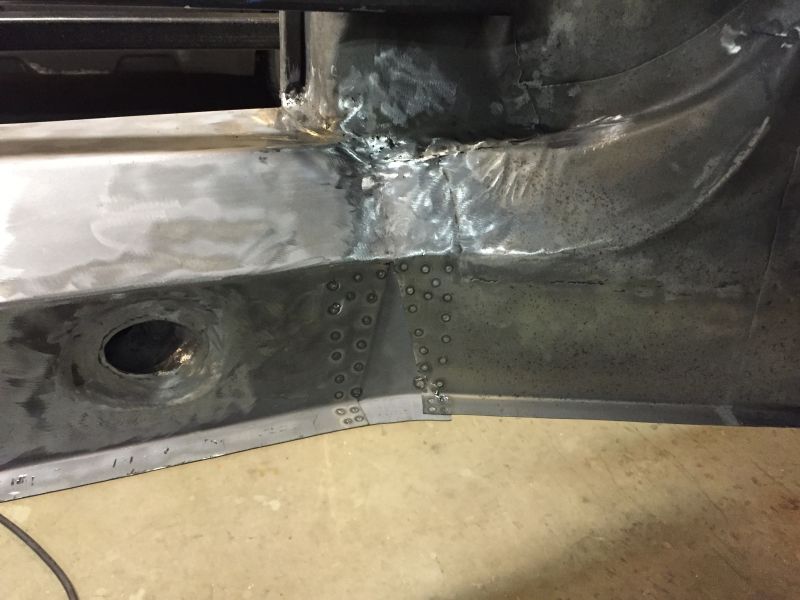

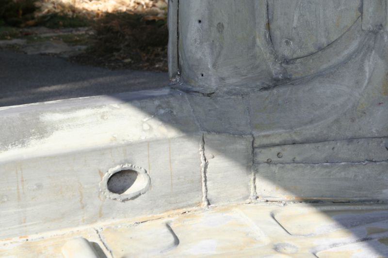

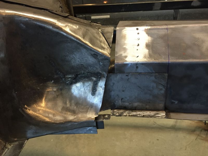

                                The joining of the rear portion of the middle longitudinal to the inner and outer rear frames needed some TLC to get correct.

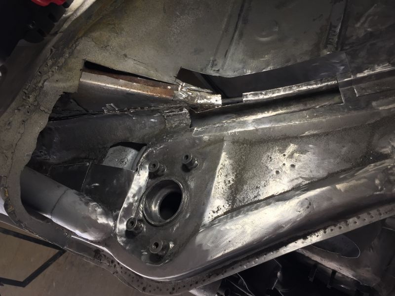

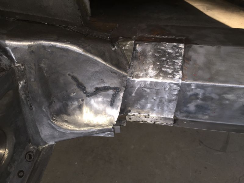

                                The upper half of the 16 gauge outer frame was cut back to remove all the previous rusted metal.

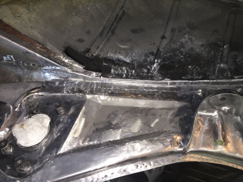

                                A template and repair patch were made.
                                Then welded in place to mimic the original joinery.

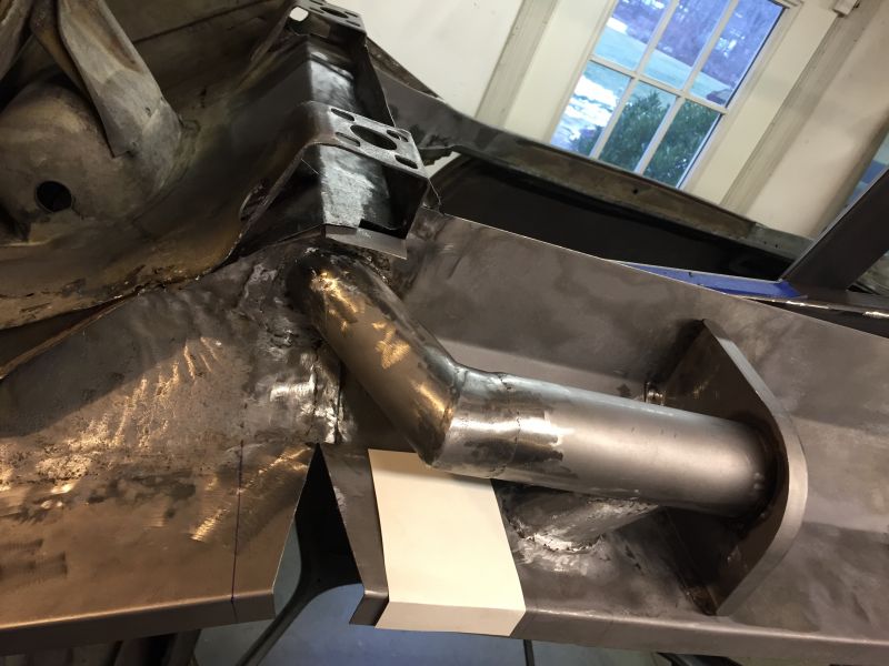

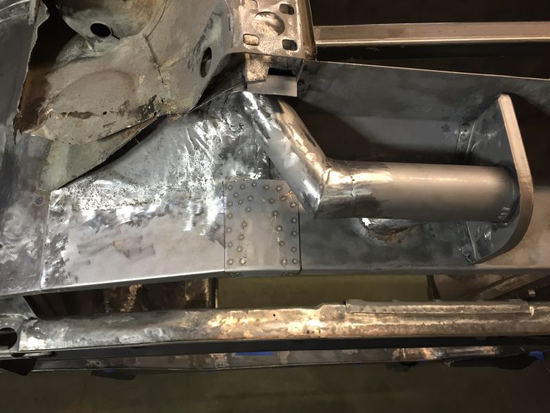

                                The rear heater duct was replaced with new correctly sized tubing and welded in place.

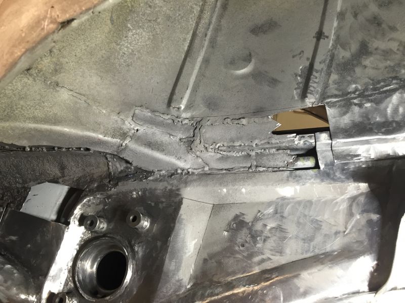

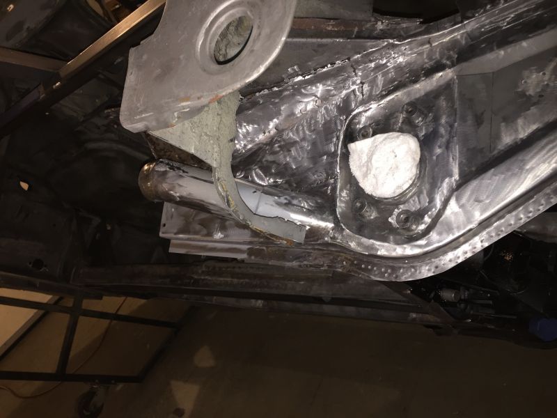

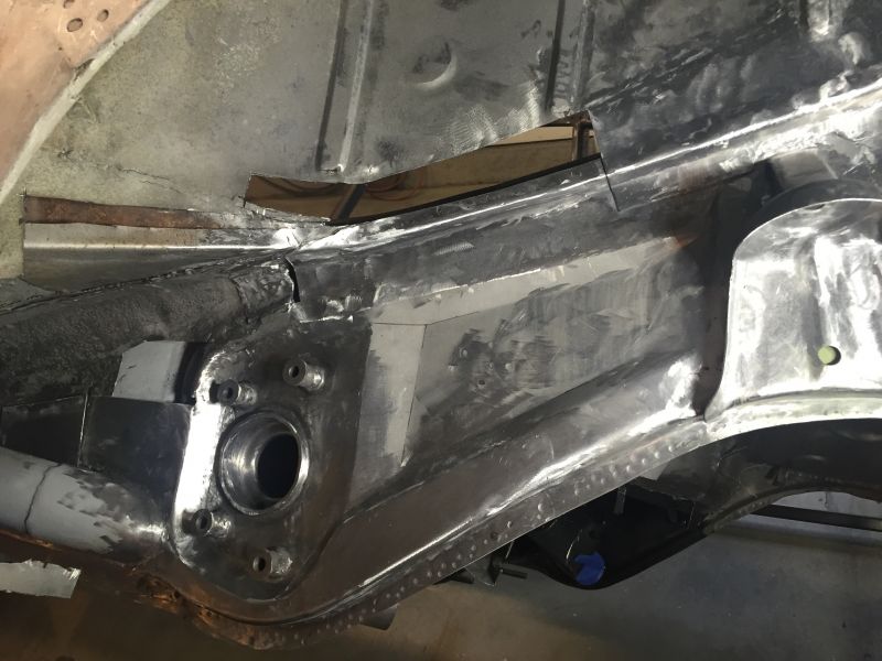

                                The bottom flanged area of the outer frame was cut out and a replacement piece installed to give the correct angle from the torsion area to meet the middle longitudinal.
                                As you can see in the earlier pictures, the convex portion of the inner frame where it joins the middle longitudinal needs to be cut out and a new piece made and installed. I may do it in sections as the concavity is pretty deep with some pretty good 90 degree bends near it.
