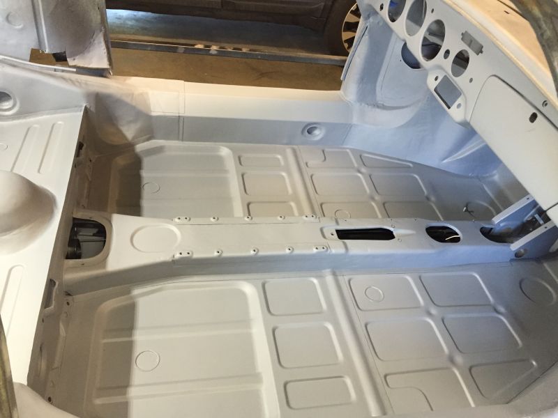

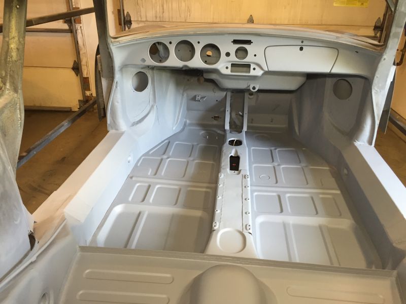

        Dash, foot wells and under the dash primered.
        Cockpit done.

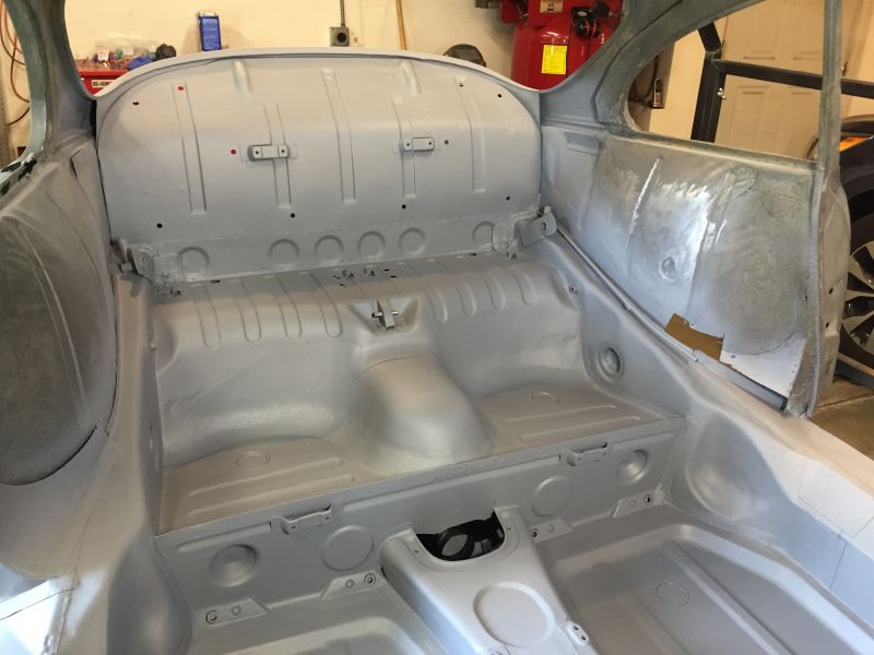

        Rear seats and firewall.

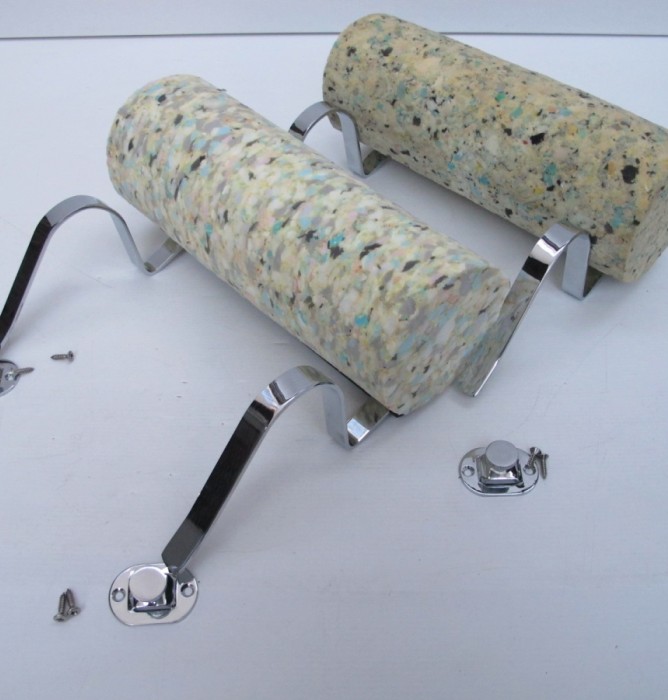

        Time to start fitting the seat mounts, rails and seats. I was looking closely at my seats and they originally came with head rests though I'm missing some of the metal pieces and the head rests themselves. Does anyone know who makes these or where to get OEM's as the regular sources don't have them?

              • I think the headrests are available from Autos International and perhaps Bob Campbell.
                Mike

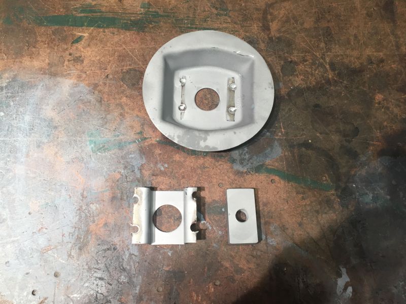

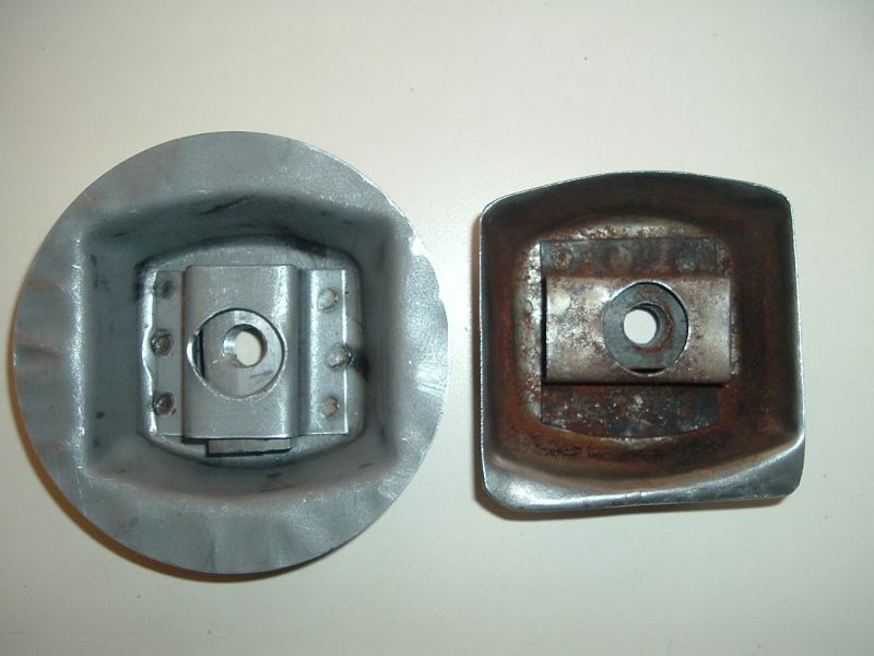

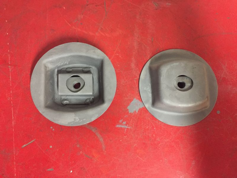

                    Don posted a warning about a month ago regarding the Restoration Design front seat rail mount's caged nut being turned 90 degrees to where it should be. This won't allow good side to side adjustment. Bruce mentioned that the hole should also be oval and not round.

                    Restoration Design on left and OEM on right. Picture from Don.

                    A little drilling took care of the cage removal.
                    The drilled out welds were filled. The cage and nut were spot welded back in place, but 90 degrees from as bought. The hole was made oval. Check. Check. Check. One less thing to worry about.

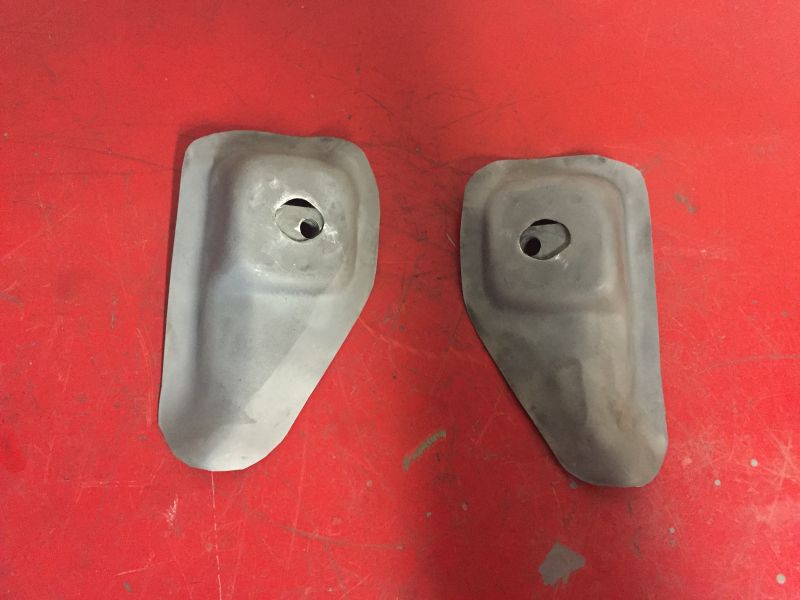

                    The rear seat rail mounts also had round holes that needed fixing.
                    Now to start mocking up the seat rails.

                        • Did anyone check to see if the RD front 'pods' could just have been turned 90*? It's a level part with the only bias left and right with the originals having a lateral oval for adjustment, the repro having a hole that may have been as round as the original oval was wide.

                          The round repro T-6 front seat mounts are just wrong...at least for today's attention to detail and the repros in general are thinner gauge than the originals....but John, your over-trimmed original would be that much more trouble to add to your great results so far.
                          • Hi Bruce. Yes, the RD mount could've been turned 90 degrees and I wouldn't have had to go through all those machinations. But......it wouldn't have been correct. It's all about how anal you wanna be
