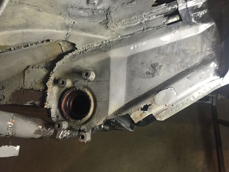

      • The sunroof "clip" I have is a bit large. It includes rusted out torsion areas. Now to fix mine.
        I drilled holes large enough for the bosses with enough space for welding.
        Everything bolted in place to give the correct distance and height measurements. Also to act as a jig to cut down on the amount of heat distortion.
        Nice and strong again.
        Onto the inner and outer frame repair.
        Thanks for following.

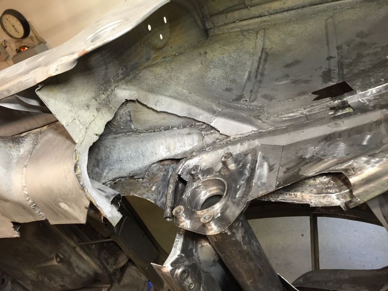

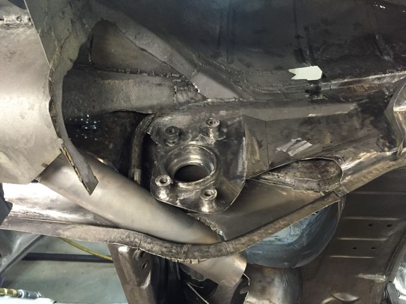

        • Got some quality time with my car this last week
          All the rust and crappy replacement metal has now been removed and the new metal has been fitted.
          Outer view.

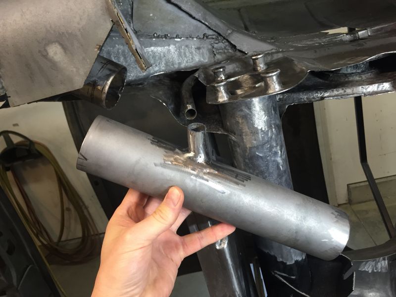

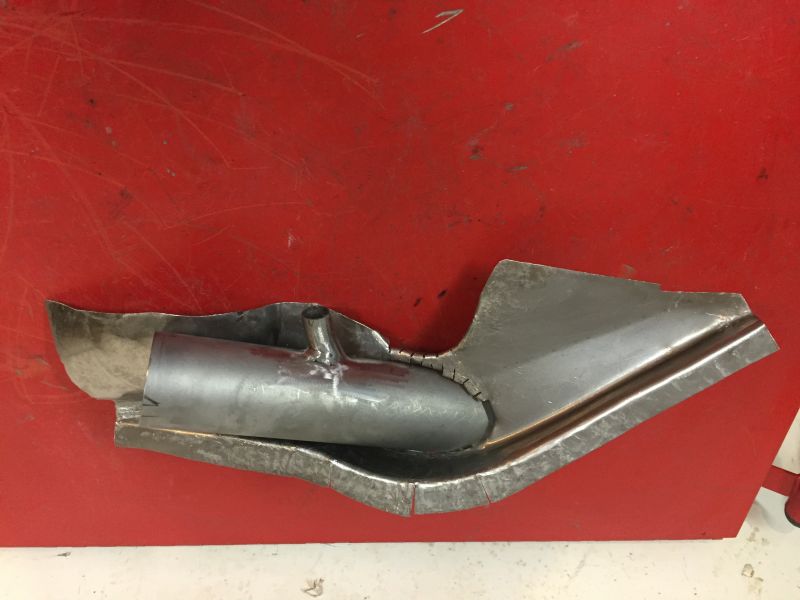

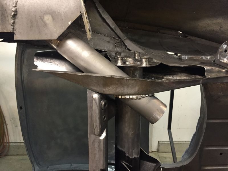

          Have to work inner to outer so the first thing to repair is the heater duct and rear defrost. I made a replacement piece with connections to both.

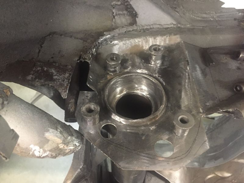

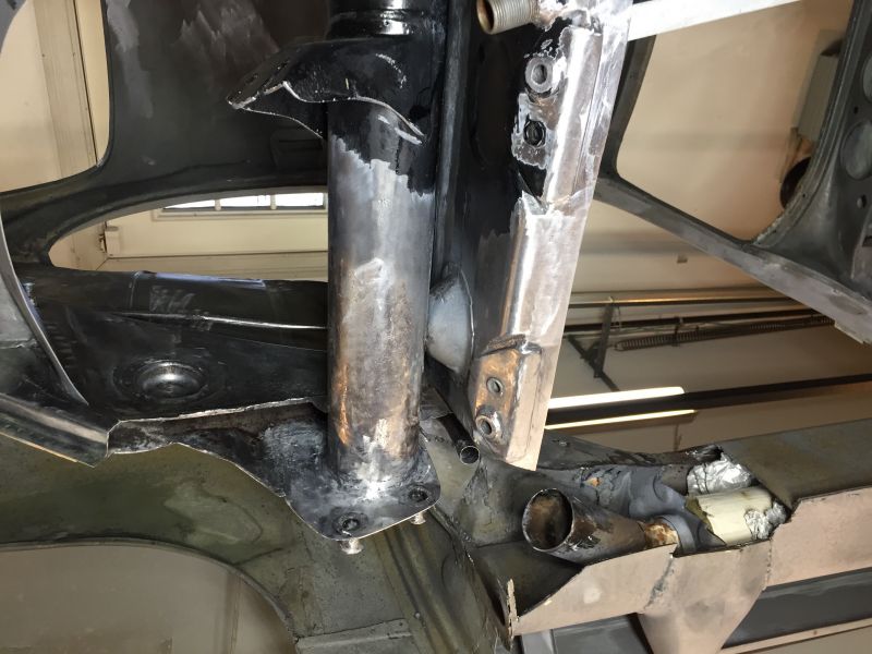

          The inner frame repair piece fitted to the heater duct. I made a flange to weld to.
          This is a very tight fit with very little wiggle room.

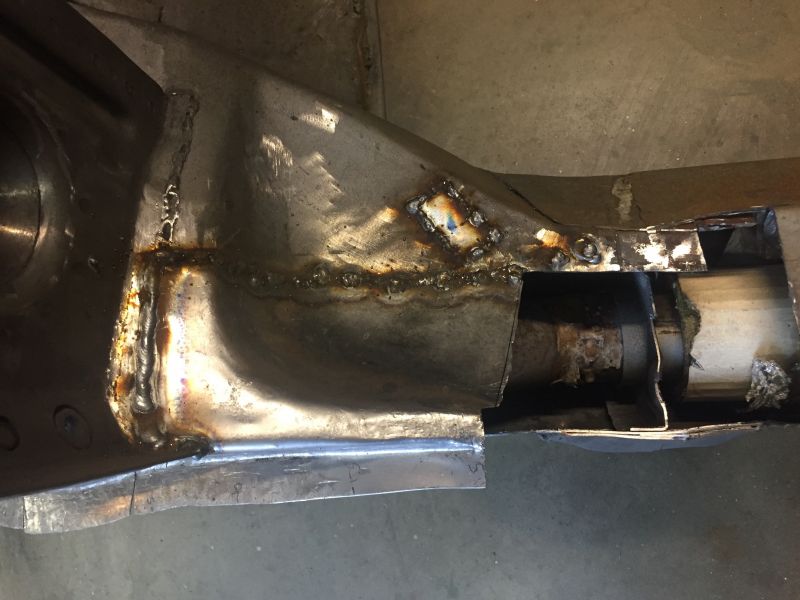

          Tacked in place.
          Every time I see this I am amazed how the Porsche engineers crammed so much into this small area. The heater duct barely goes through.

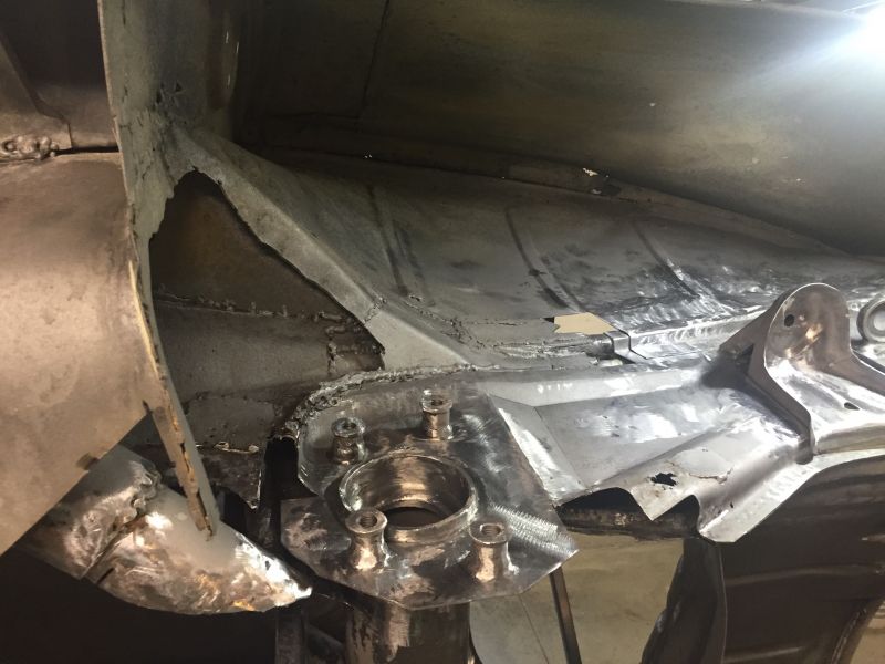

          I fit one section only to find more thinned metal that needs replacement.
          All buttoned up.
          Ground and planished.

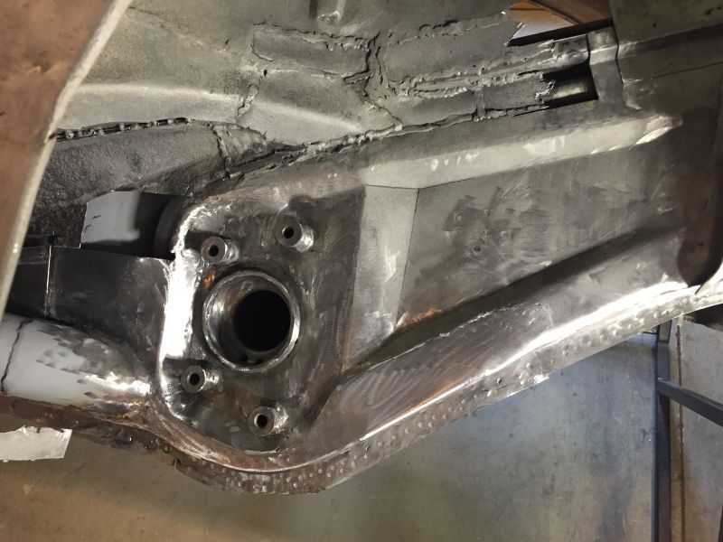

          Looking so much better from where it started.
          Next will be the outer frame member.

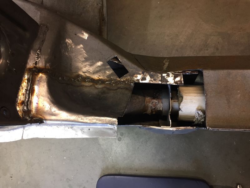

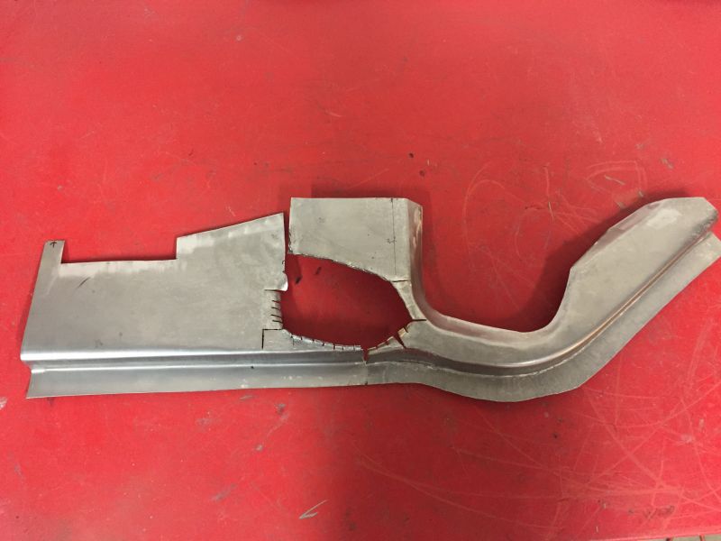

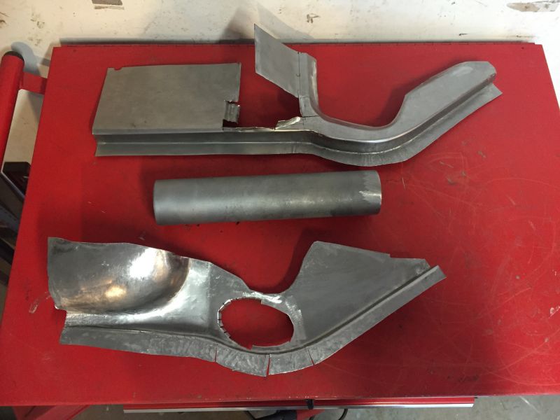

              • Thanks guys! Stoddard sells small repro sections of the inner and outer frames that are pretty close to the contours. They are made from 19 gauge metal, which is a bit thinner than the originals, but to make these complex shapes you gotta take what you can get. Unfortunately, a close approximation does not mean that it will fit as desired. The center portion of the repair panel is nice, but the front and rear portions don't fit at all. Like any repair panel the outer sections are only run-out. I cut out all the sections that didn't fit and placed the heater duct holes in the desired locations. Lots of time involved in the fitting.
                This is during the fitment stage. Lots of tweaking to make fit. The bowl shape on the inner frame was a lot off and had to be cut to relieve the stress in the metal then reshaped.

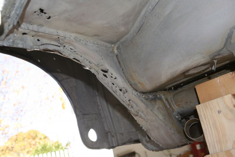

                      • John

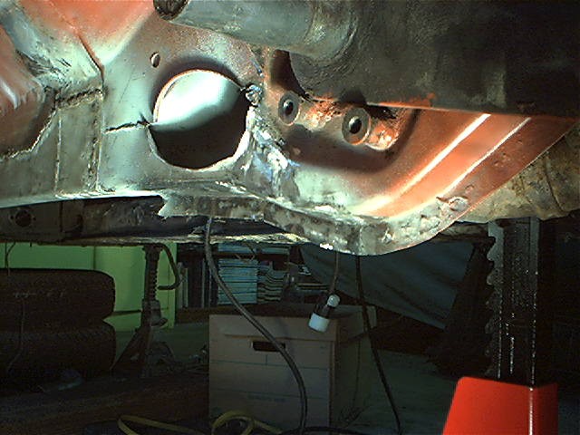

                        In our quests for "correctness" this may only be a Reutter thing, but the front of the bottom pinch weld flange on Foam Car had a rounded, pointy shape which I preserved:
                        Maybe Karman's did not have that.

                          • Originally posted by foamcar" post=31588
                            In our quests for "correctness" this may only be a Reutter thing, but the front of the bottom pinch weld flange on Foam Car had a rounded, pointy shape which I preserved:......Maybe Karman's did not have that.
                            I have seen that forward end 'finished' in many ways, both R and K. Usually rounded, not pointy and often just bent over, it seems that it was whomever had the most time to be spent did whatever they could to make the pinchweld end somehow less pronounced.
                            I'm sure Jack has seen more survivor cars than I have, so maybe he will shed some experience to this detail.

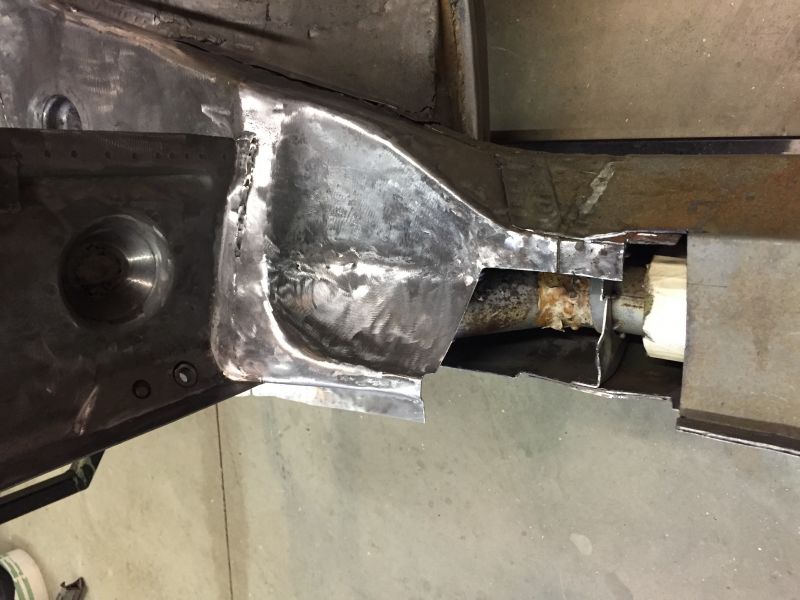

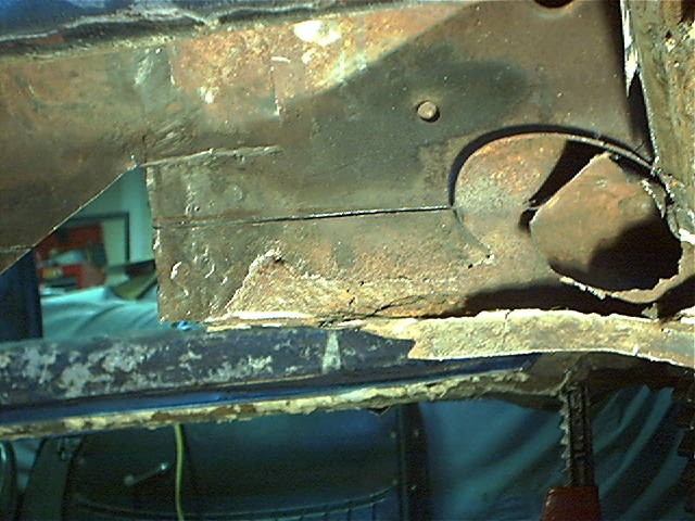

                            • Thanks guys for all the feedback. I've ruminated on the 20 gauge vs thicker gauge issue for weeks now and agree with what everyone is saying. I just finished the outer frame repair and still have the opportunity to replace some of the straight sections with thicker gauge.

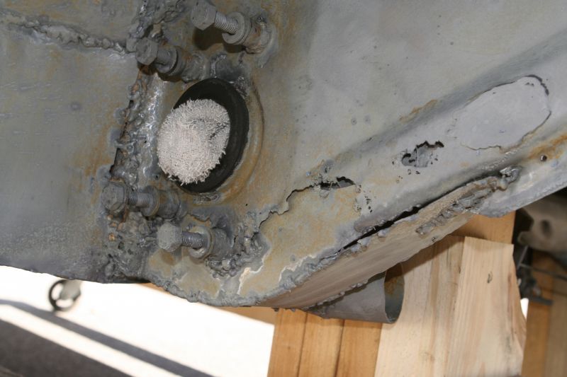

                              This is what I started with. Not much to be desired.
                              The inner frame member. Not too strong especially as there are gaps with no metal around the torsion tube.
                              After removing most of the offending metal.
                              I replaced the flat metal around the torsion bosses with 16 gauge and welded new bosses in place to give the original strength and rigidity to this area. The inner frame has been installed and the cavity has been painted.

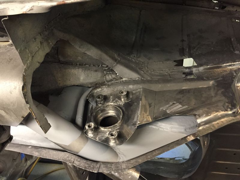

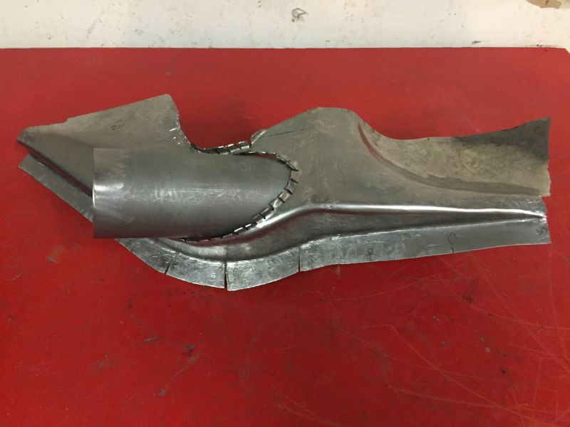

                              Crazy looking repair panel. The hole is flanged so it can be welded to the heater duct.

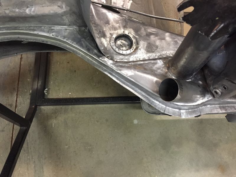

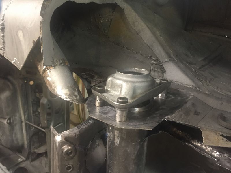

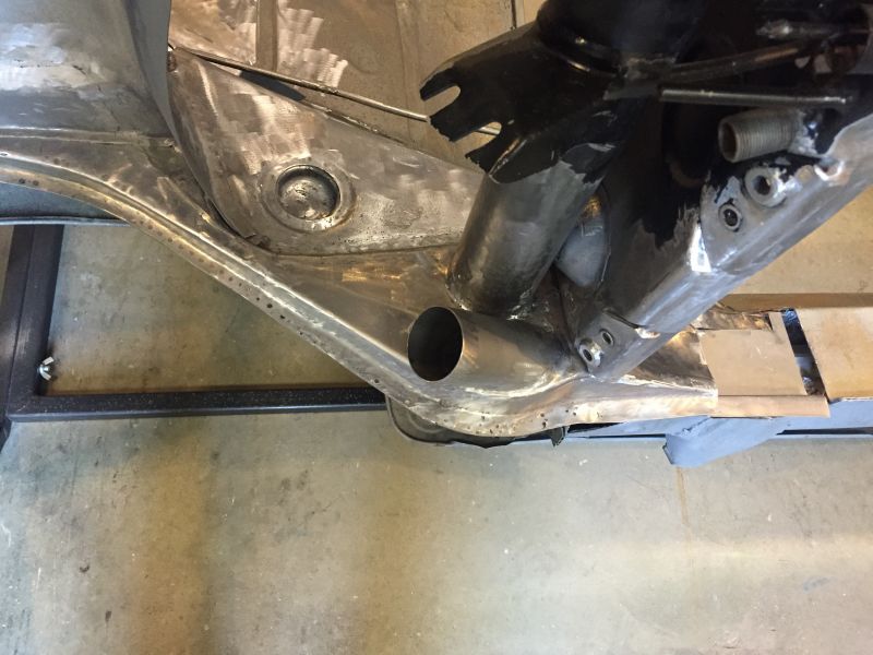

                              After a few fittings.....Voila! The outer frame buttoned up with new metal. After these great discussions here, the flat metal from the heater duct to the middle longitudinal will probably be replaced with 16 gauge to strengthen it further. Unlike OEM I welded the heater duct to the frame for strength.
                              As seen from inwards. Things have come a long way.
