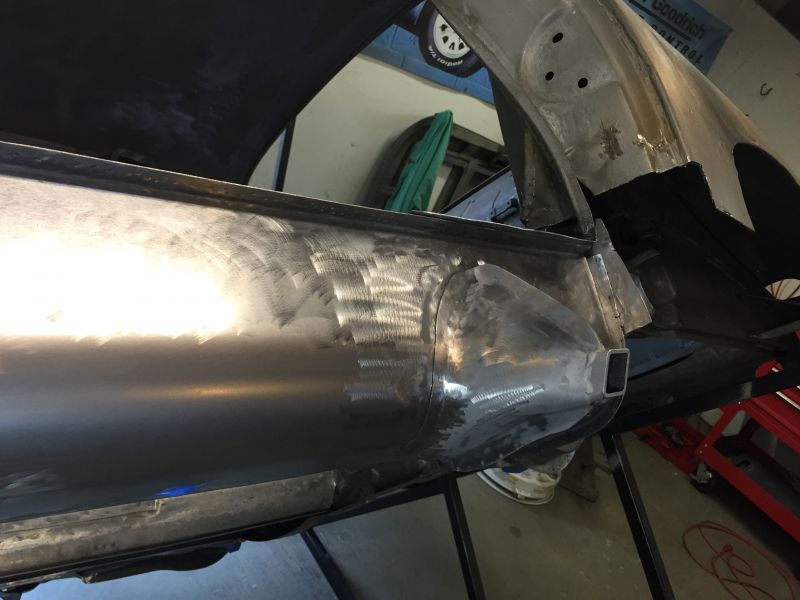

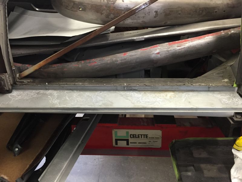

  • Finally to a nice big piece of metal to install!

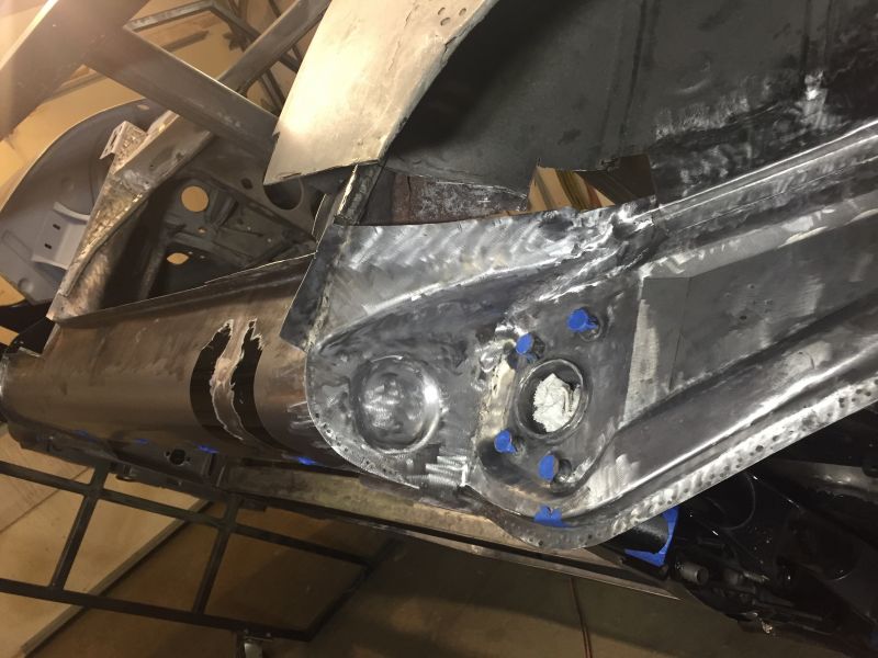

    First to prime and coat this area so it hopefully won't rust out in the future.
    Nicely protected!

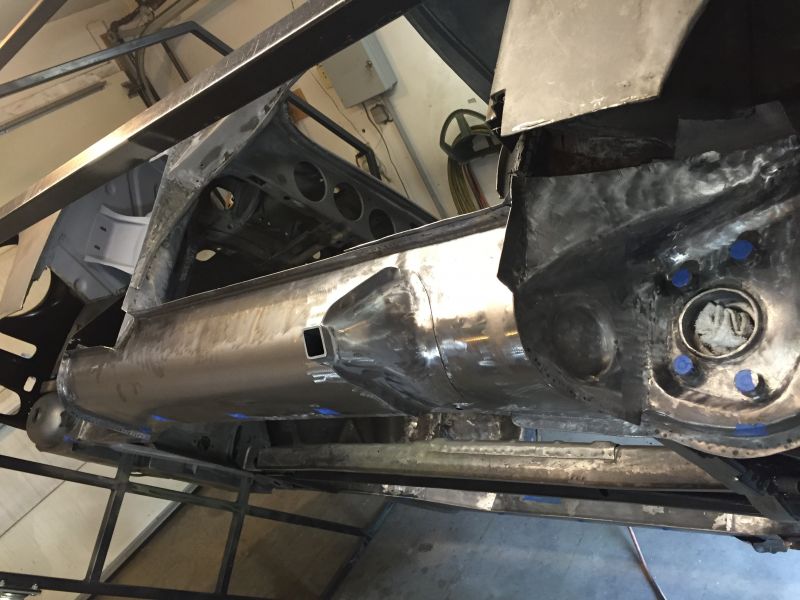

    Outer longitudinal primed, top coated and ready for installation.

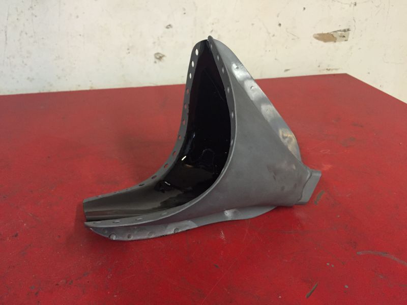

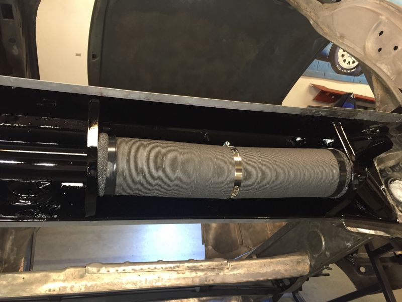

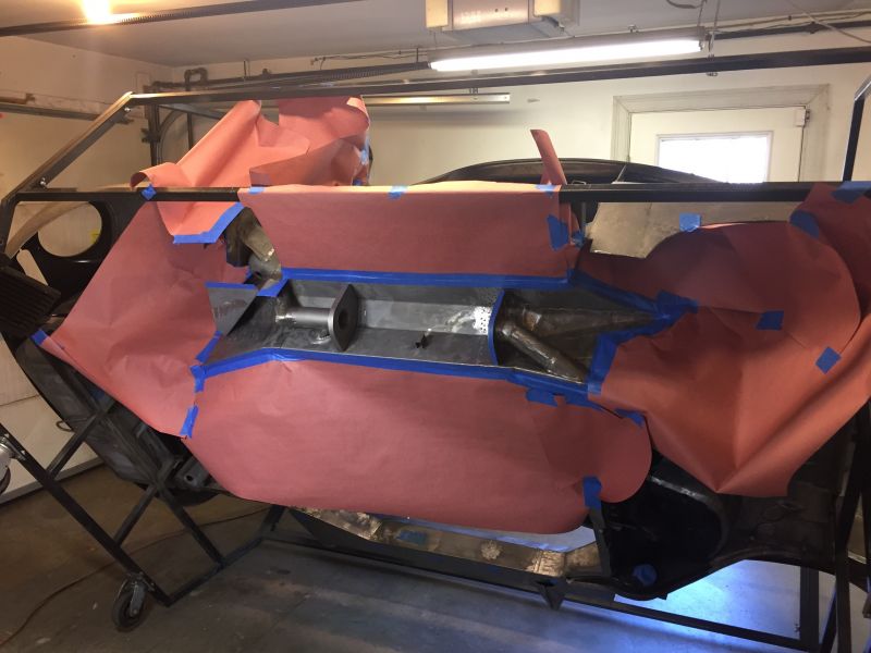

    Can't forget the heater muffler before buttoning things up!

    So nice to be beyond the original mess that Bubba gave me.
    Onto the closing panels next. Thanks for following.

    • Wonderful job John and congratulations with your current progress! Are you now past all of bubba's repair attempts?
      • Thanks Justin. ALL of Bubba's previous metal repair has now been painstakingly removed and replaced with fresh metal. Woot!! I'm now at a big milestone where the unibody frame is now complete.

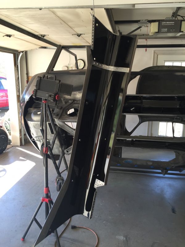

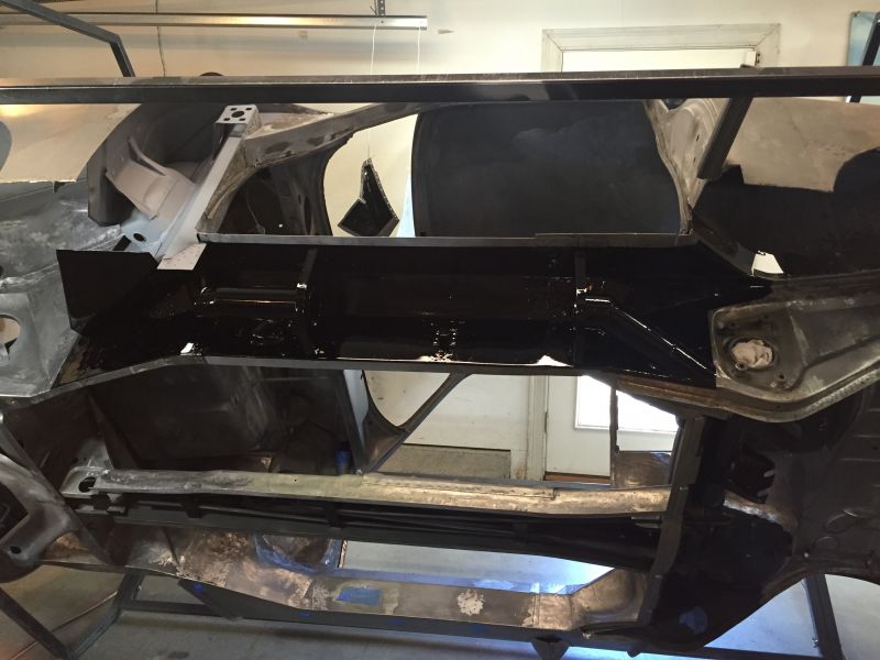

        Some finishing touches on the longitudinal: front and rear closing panels.

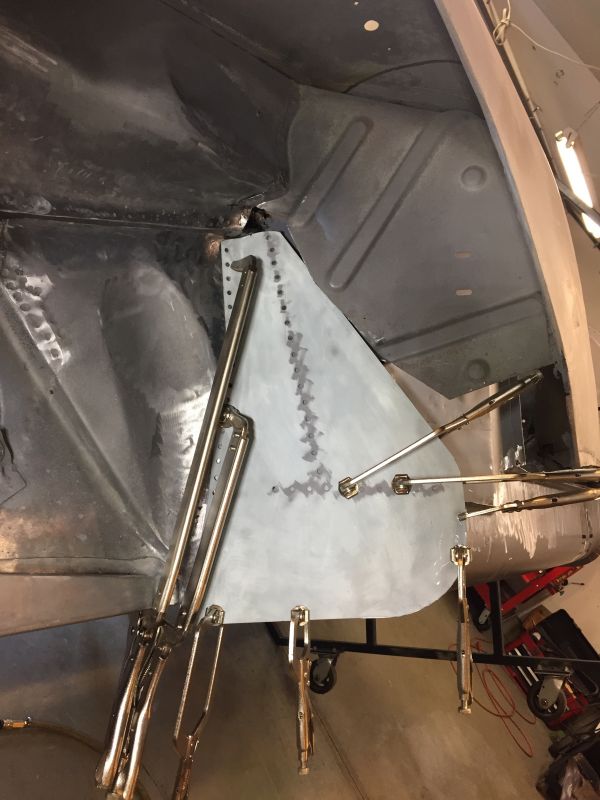

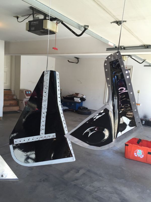

        Closing panels fitted, cut to size, primed and top coated.
        Front closing panel with a good fit.
        All closed up.

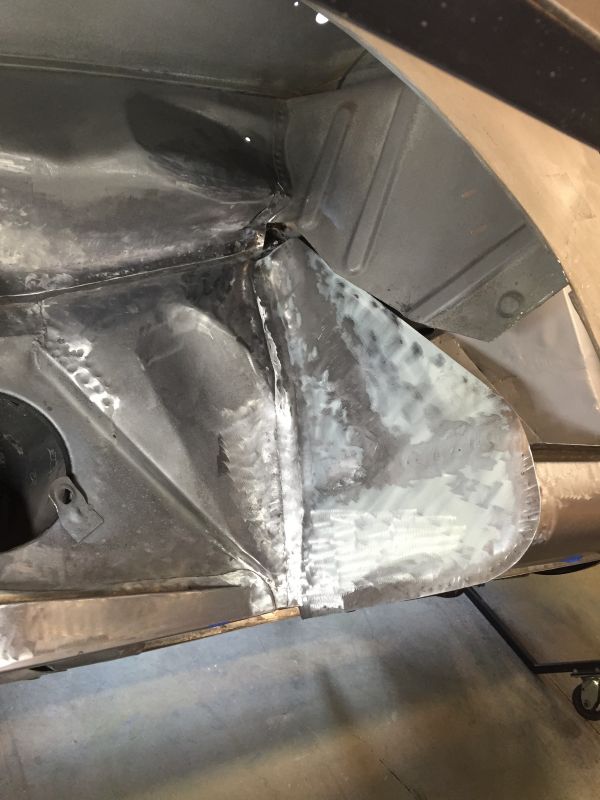

        • Last part for this side....the jack spur.

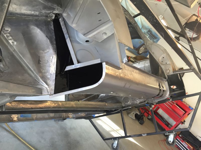

          The flanges were remodeled to fit underneath the rocker and the inside primered and topcoat.
          The door and rocker were installed to get a close fit of the jack spur and the flanges were bent to hug the rocker.
          Nice new strong metal.

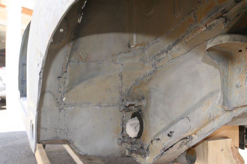

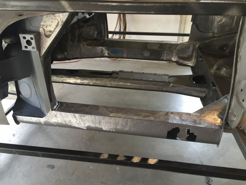

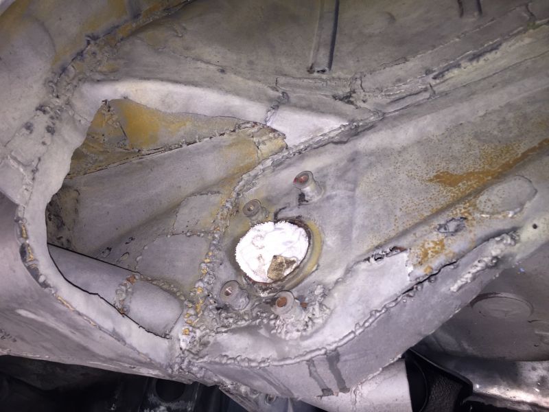

          It's nice to look back to see what I started with.
          Lots of bad!

                      Ron Roland recommends installing the floors before working on the hinge bosses, lock posts, door to fender metal and rockers. I like having the floor opening to be able to reach and to step through. How much torsional stability do you think the floor provides especially as the longitudinals are now solid and the car is on a rotisserie? If you guys think it could help to get things more solid I'll install the floors next.

                          The more I think about what you wrote and the stresses involved, would it better to install the floor pans now? The car is on an Emory "hoop rotisserie" attached to the lower front torsion bar and rear transmission mounting points and the car is level. If I install the floors now then I can align the fenders, doors and rockers without risk of further movement. Good or bad idea?
