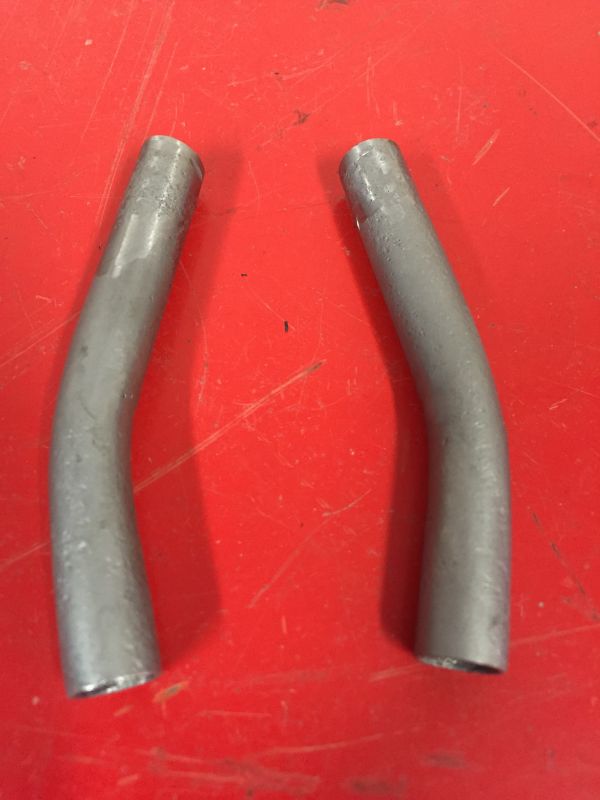

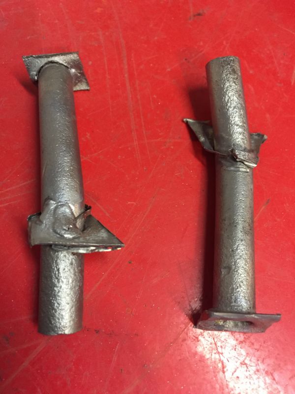

      The nose drainage tubes had to be cleaned up and a few holes welded closed.

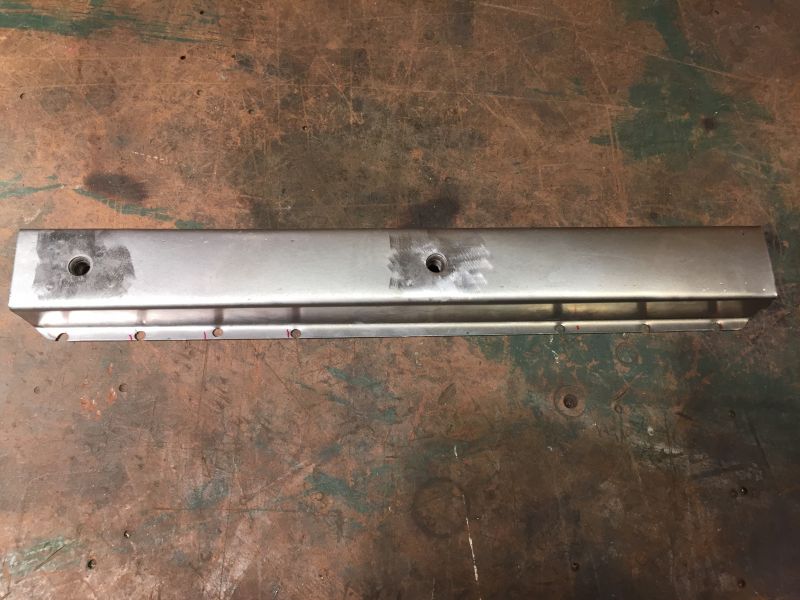

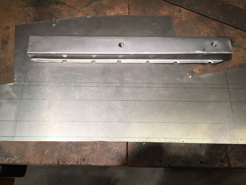

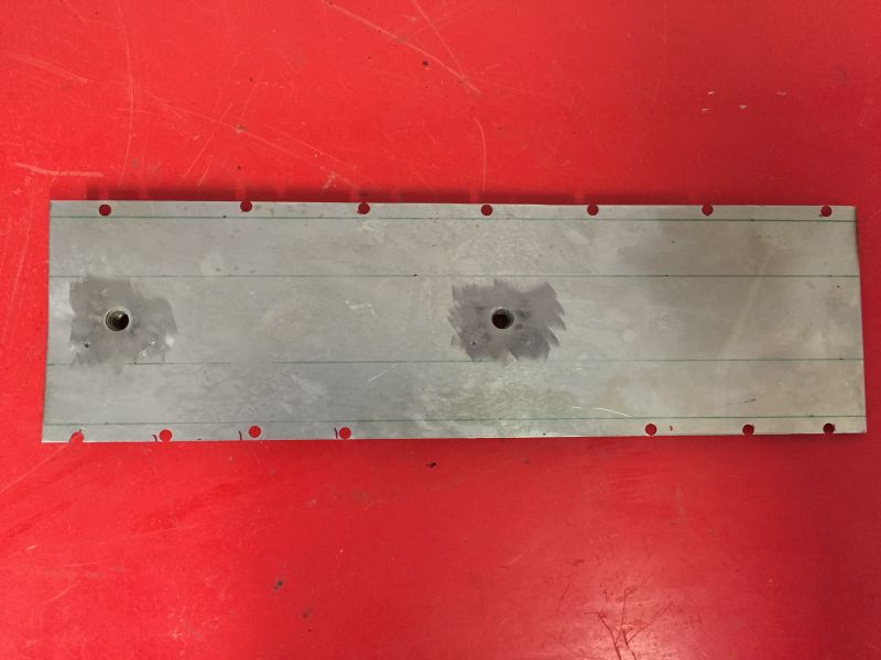

      Next was fitting the bumper brackets through the nose openings. The passenger's side brackets fit pretty well while the driver's side were too low and medial. It's probably best to install the bracket mounts after the nose is installed. The Stoddard battery box panels I bought already had these spot welded on though. I ended up grinding out the spot welds and making a new mount.
      I took the weld nuts off the Stoddard piece and welded them on after drilling the bolt holes. It is now ready for the brake. This mount is 4-5 mm taller than the passengers side to accommodate the nose opening.

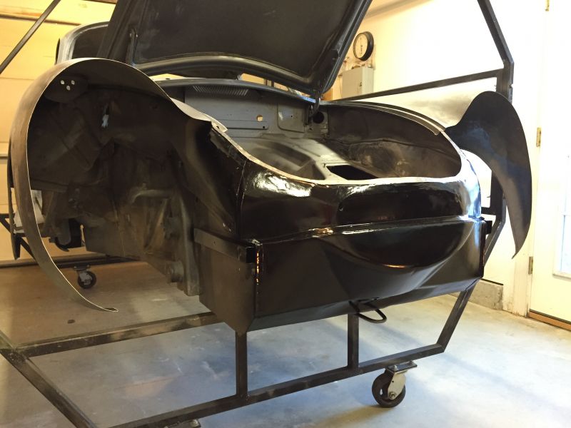

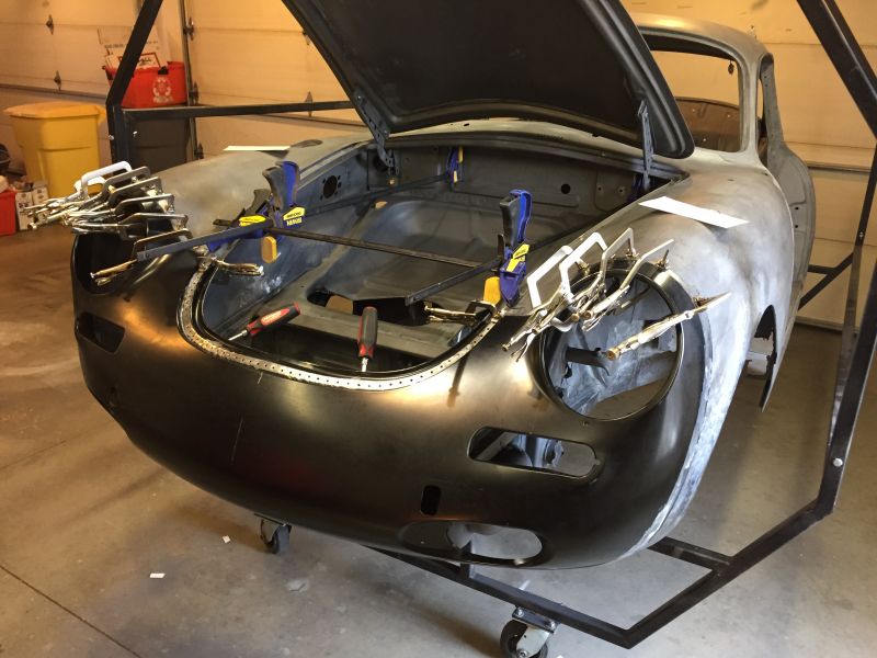

          • Today was finally the day! After much angst I got the nose spot welded in.
            The front was primered and top coated and the flange was painted with weldable primer.

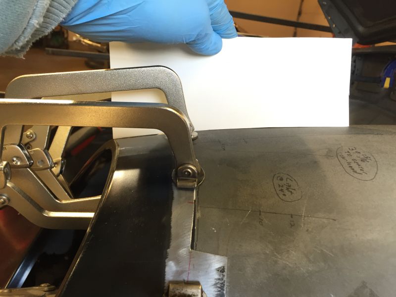

            Just a few clamps to hold it in position! The blue clamps are pushing the sides out to give correct gaps around the hood. Many measurements showed that it wasn't my previous welding of the inner fender that caused the hood not to fit well, but that the fenders bowed in a bit. Easily corrected.

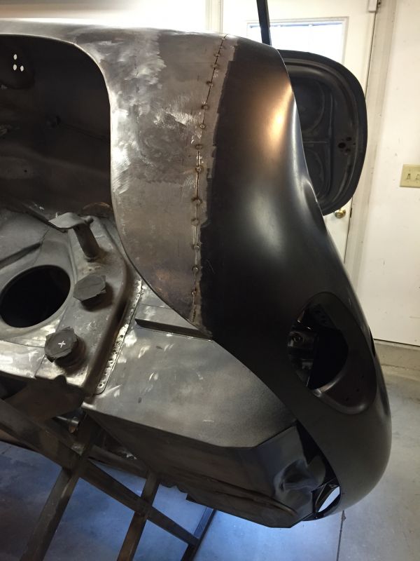

            I made templates of the fender/nose curvature before removing the original nose. These came in quite handy when fitting the new nose. The measurements that I marked on the fenders also allowed me to feel comfortable before putting down the first spot weld.
            Spot welded in! I still need to fit the outside portions, fit the bottoms to the curve of the fenders, rosette weld the drip channel to the front closing panel......

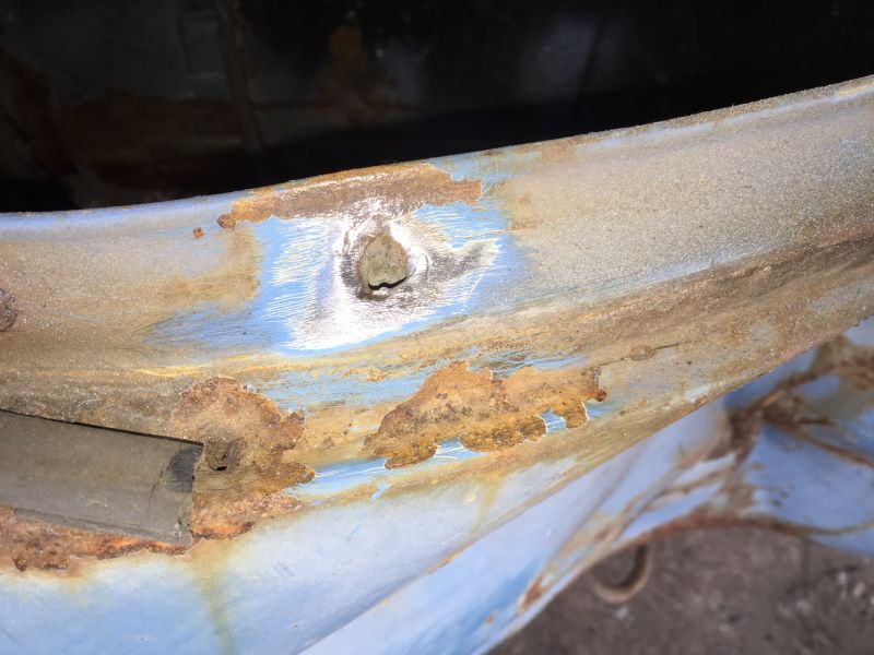

                        I was going to add that the drain tubes were often brazed, not welded. I looked at and used a wire wheel on a convenient (to me) original owner, original paint C (that can be your next job if you want it). The drain tubes are welded and not too pretty...and it needs a new front end 'nose,' but since you have 'paid your dues' you have a chance to use your skills now like any "professional." (But 'real bodymen' don't wear rubber gloves)

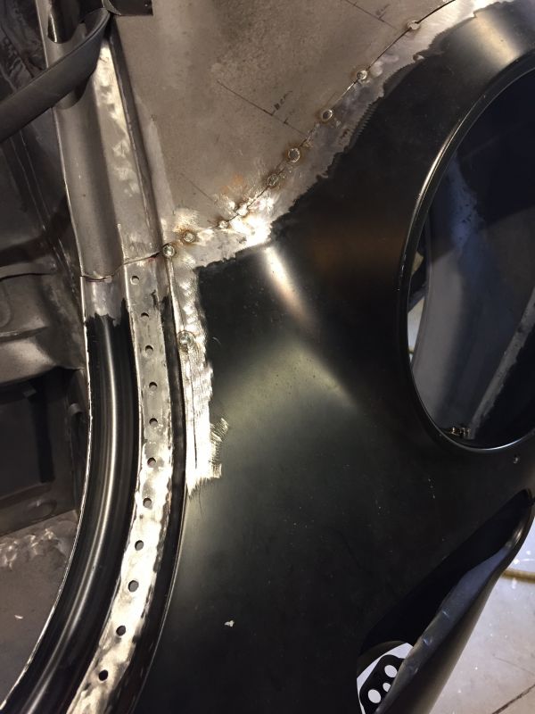

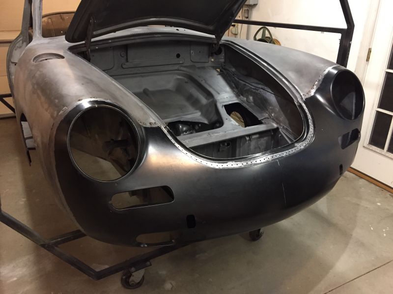

                            • Lots and lots of measuring today. I ground down the previous welds around the torpedo tubes and planished them. Then commenced fitting, cutting and spot welding down the fender.

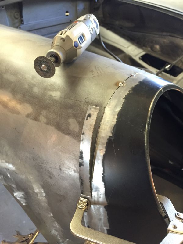

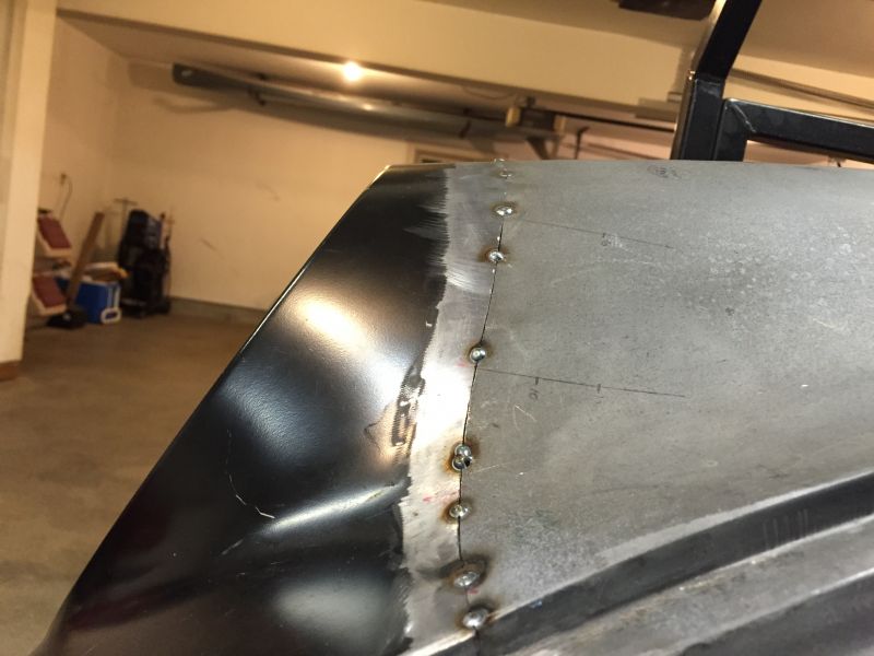

                              The nose panel has extra metal to the rear that really doesn't approximate the curve of the fender very well. It's best to use the factory weld line as a jump off point and remove the extra. I used a Dremel and cut-off wheel to obtain a thin gap then spot welded as I went down. I did this in 4 sections to get a nice curve and fitment.

                              Spot welded in place and the bottom flange fitted. Really nice curve. It's so niece to see metal back on the naked car.

                              I had to cut a relief in the "medial" aspect of the nose (just like on Bruce's car) as the Porsche OEM panel was a bit narrow. Nothing that a little TIG can't fix.
                              Now onto more planishing the spot welds then rosette welding the front closing panel shut.

                              • Really nice work. Can I ask - in the shot with the Dremel - are you cutting through both pieces of metal simultaneously, or just the nose piece on top? If just the nose, how are you guiding your cut - have you drilled small pilot holes from the inside? Or just doing it millimetre by millimetre and easing the cut along? I ask for specifics as I will be doing this job in the next few months (quivers of trepidation!).
                                Cheers, Jonesy
