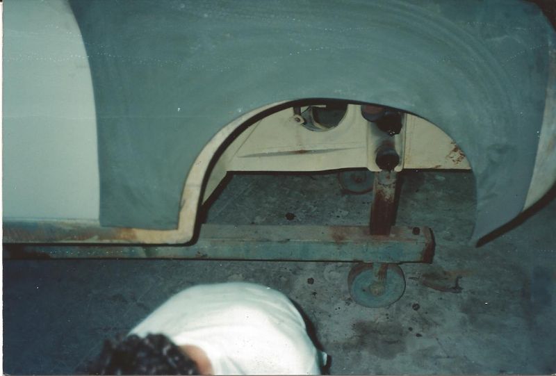

                • Yep, make them match. To bolster Justin's point about anomalies, here is a picture of a Porsche replacement fender over an original on a 356. Which is correct? The car is a C-2 Cabriolet, so I matched that opening even though it was different from other 356s I referenced.
                  I am guilty of saying too many times "Ya can't see both sides at the same time" but I firmly believe Porsche INTENDED to be symmetrical in it's construction of all 356s, even with minor differences one to another.

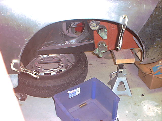

                    Here is that fender during installation on Foam Car:
                    I modified his fender to match the rocker.
