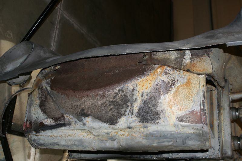

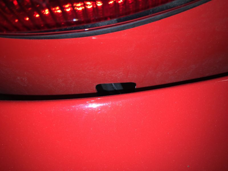

      • OK, here are two original cars with holes for the rear bumper brackets peeking out past the bumpers-

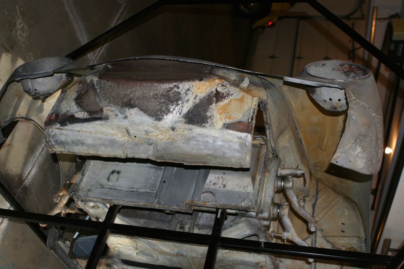

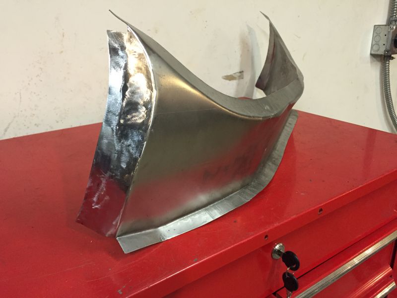

                • I got some time today, between the holidays, to finish installing the front closing panel.

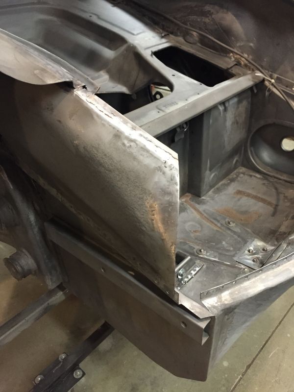

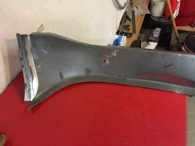

                  The top flange and front portion of the side walls were rusted through. The rust was cut out and new metal welded in.
                  The closing panel was not wide enough so an extra piece of flange was welded in. The panel fit pretty well after a few bends here and there.
                  Longer right flange.

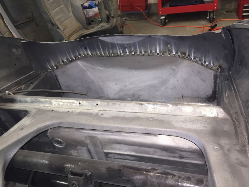

                  Lots of plug welds (top, bottom and sides) to ensure a strong fitment.
                  Welds ground down and dressed. Things are looking much better.
                  This is how things were earlier this year and after media blasting.
                  Lots of pinholes in the closing panel which was also paper thin.
                  Onto the nose fitment for the New Year!
                  Thanks for following.

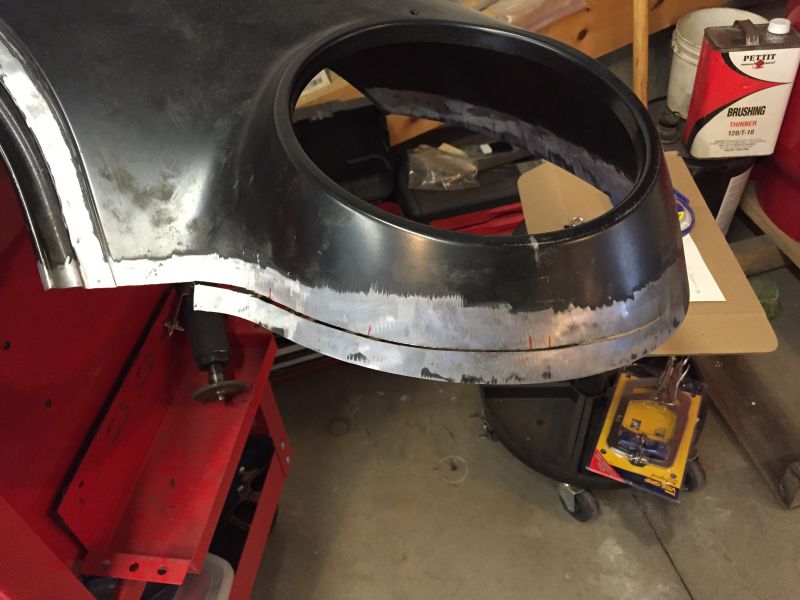

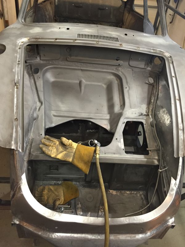

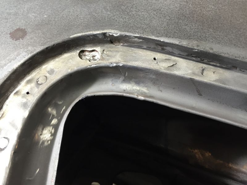

                      Before fitting the hood I need to place the seal in position with tape. Multiple screw holes where present throughout the perimeter, many of which were oversized and in the wrong locations. I welded up all the previous holes and drilled new ones using new corner pieces as starting points. Lots of measurements. BTW: there are 28 screws
                      The driver's corner looked fine to weld up, but when I started welding there was a lot of snap and pop. A little digging found a pretty good rust spot underneath. I dug out the rust and welded the crater closed. The seal must have leaked in the past, but now the metal is as good as new! I also spent a few hours removing caulking and rust beneath the cowl where the fresh air box resides. This area was missed even though it was hit with two rounds of media blasting.

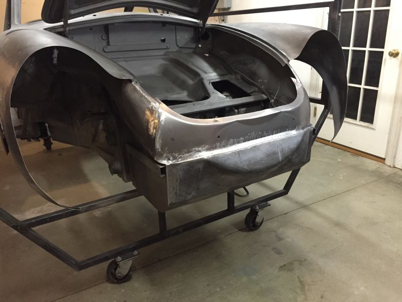

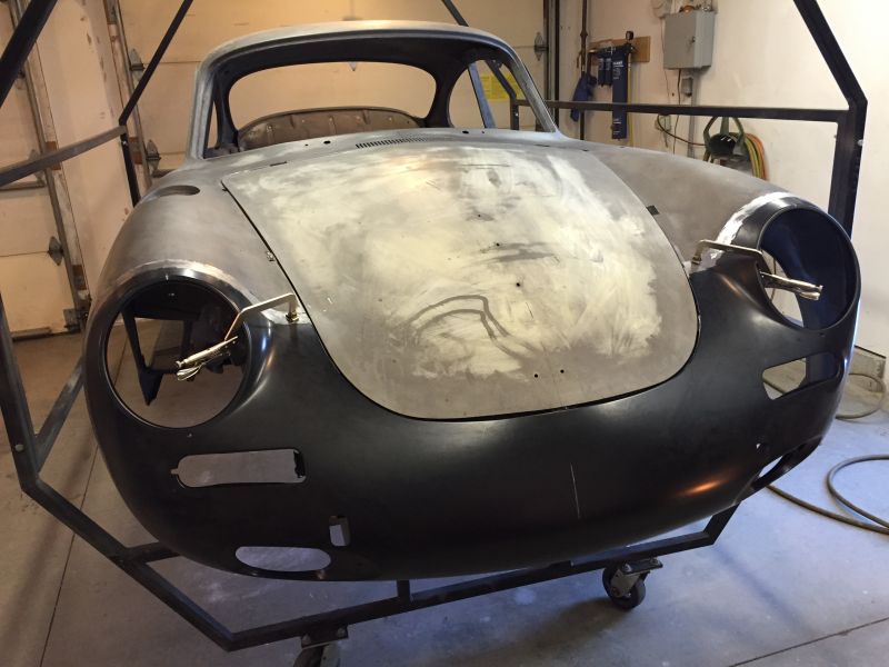

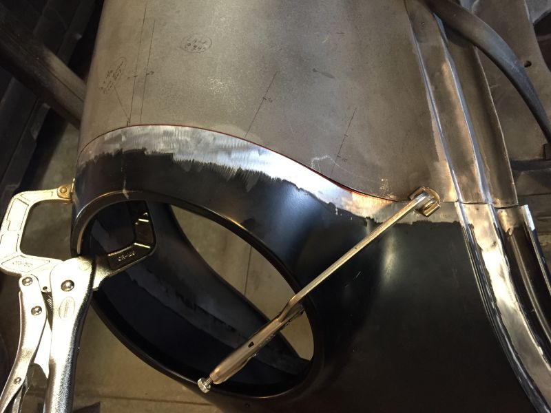

                      The nose is mocked up. I've removed the previous leading and have a seal from IM in place. The fitment is a little odd even with playing with the hood hinges.
                      I previously marked the location of the light bucket hole edges as reference points, which is quite helpful during the new nose install. I also am measuring front to back and diagonally from the holes in the dash and centerline to make sure the nose is symmetric. Now to take a deep breath and start cutting.

                      First piece cut. I am only cutting a bit at a time and remeasuring. Best to sneak up on the correct fitment then to cut off too much. I'm leaving the more lateral portions uncut for now so I can mock up the hood opening.

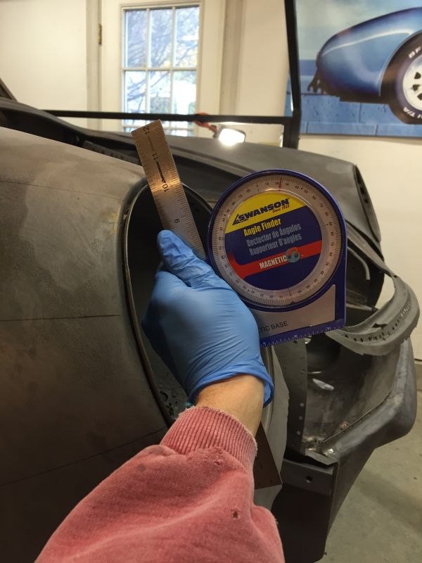

                      The original light bucket was at 24 degrees, which I'm trying to replicate.

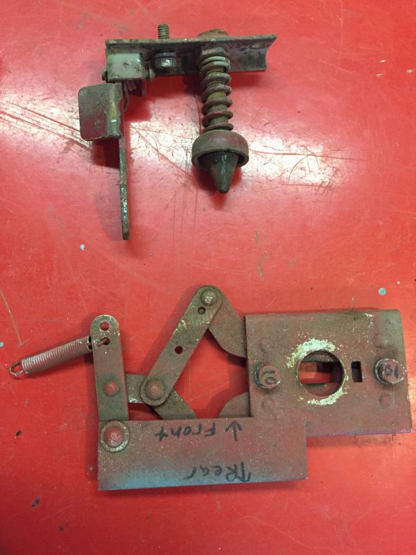

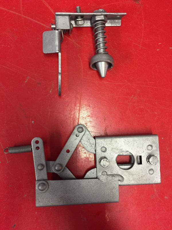

                            • Lots of time with the small things again so not much to show. Fitting the hood takes lots of little tweaks to try to get it to fit correctly and really eats into the day. Hood up; fit nose; place seal; hood down; check alignment; tweak; repeat. Ugh!!
                              I think I may have figured out why the whole left side of the hood sits high. I thought about it from 180 degrees the opposite direction: it may be due to the fender sitting low. I had previously done a lot of repair work on the rusted out flanges where the inner fender wall meets the trunk floor and I'm thinking that the heat shrank the metal and pulled the fender down. A little metal stretching should put it back into position and also widen the hood/fender gap.

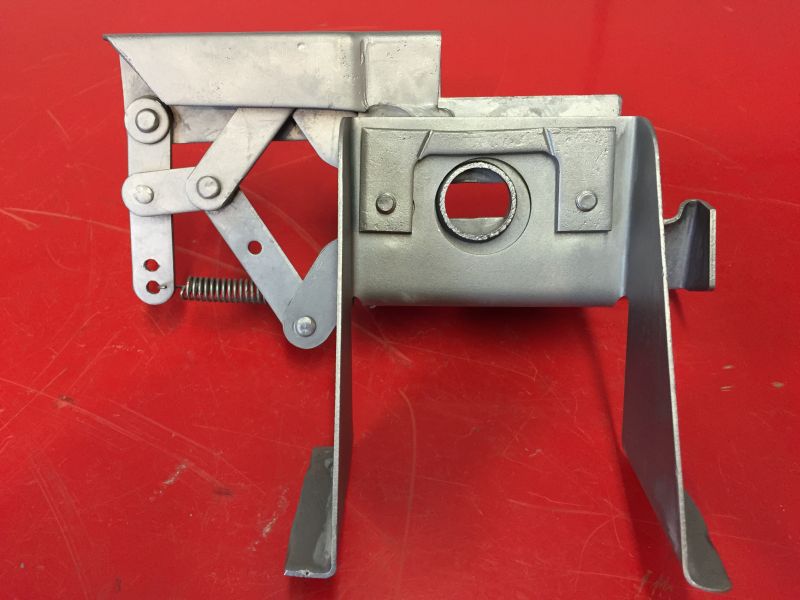

                              I also have to fit the hood latch system before any welding takes place. So a little restoration work to break up the hood fitting monotony.
                              Latches as they came off the car with multiple coats of paint and rust.
                              Taken apart and media blasted.
                              Back together and looking/working much better.
                              Everything back together and ready for some trial fitting.
                              Tomorrows another day to chip away at the project!
