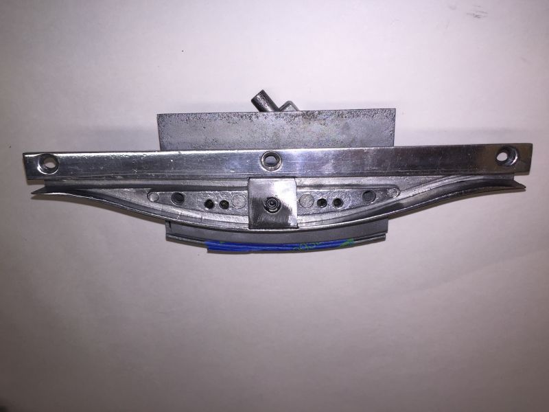

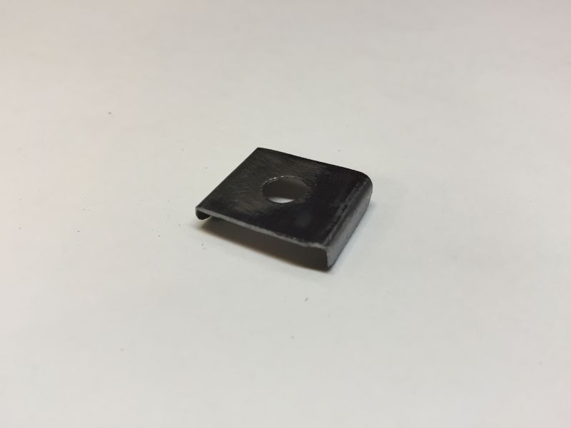

    After a lot of measuring I ended up making the piece from 24 gauge metal. The top is 20 mm wide to span the center cutout and transmission. The front and rear bends are 18 and 16 mm wide and hold the cable against the central pinion gear. Fun little project.

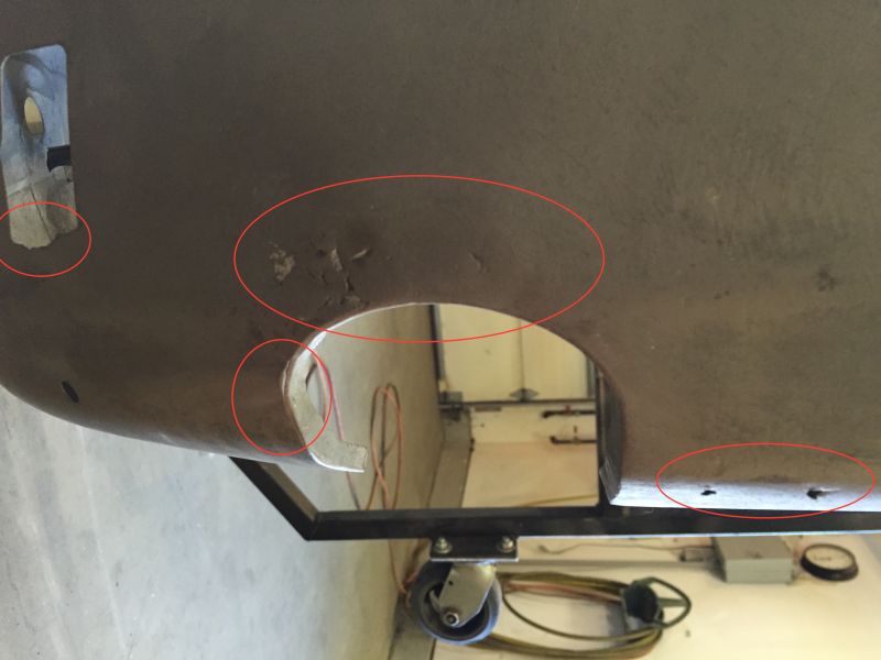

                Back up light area missing the right clip tines.

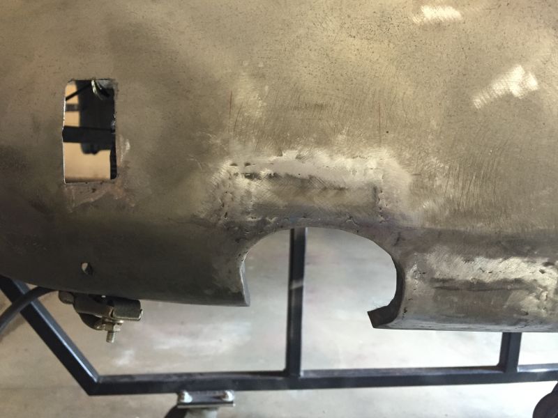

                Left exhaust area. Lots of thinned and fractured metal. Same for the right side.

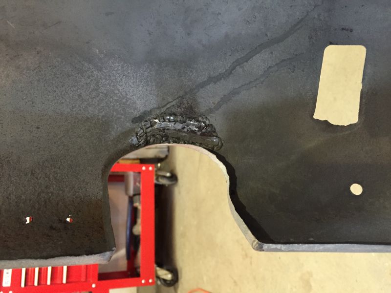

                Left exhaust area inside view. The previous owner (Bubba) used just a bit of MIG welding to install the body support.

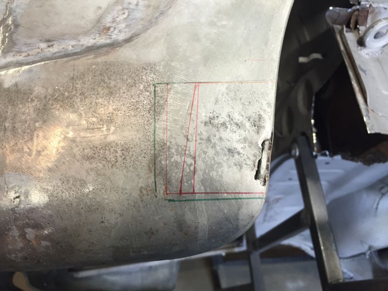

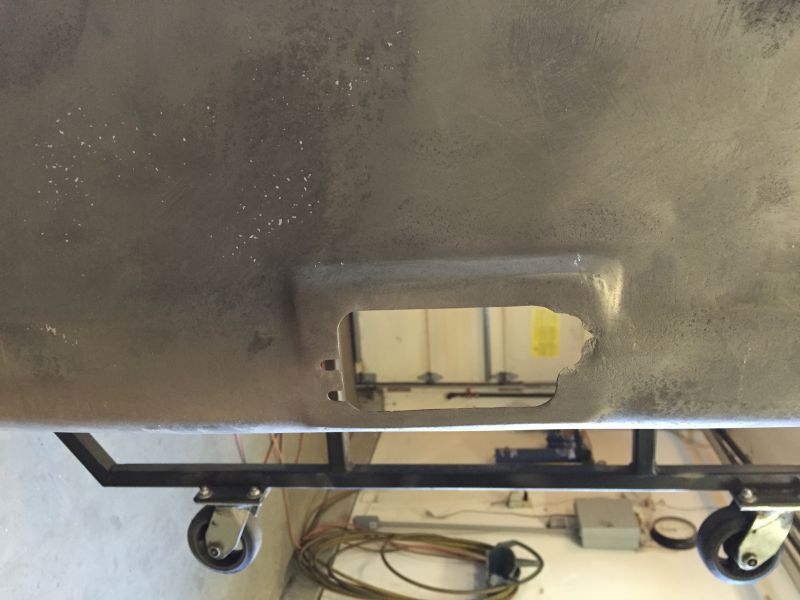

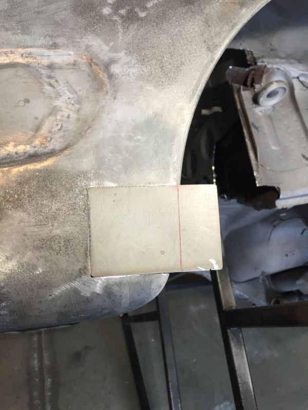

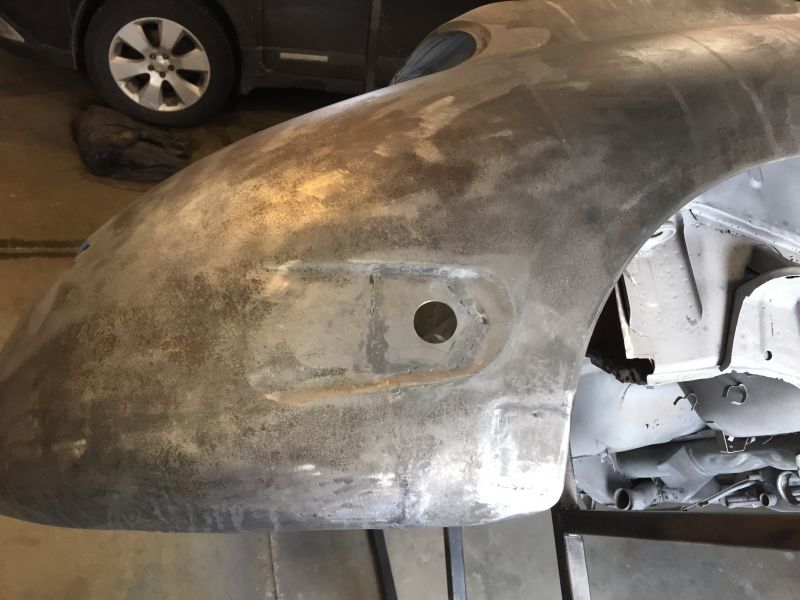

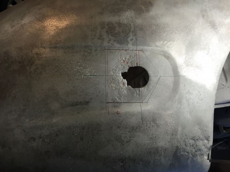

                Right bumper bracket hole with thinned and missing metal. I thought it would be best to remove a larger area (back to good metal) and redrill the bracket hole.

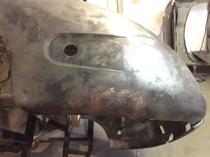

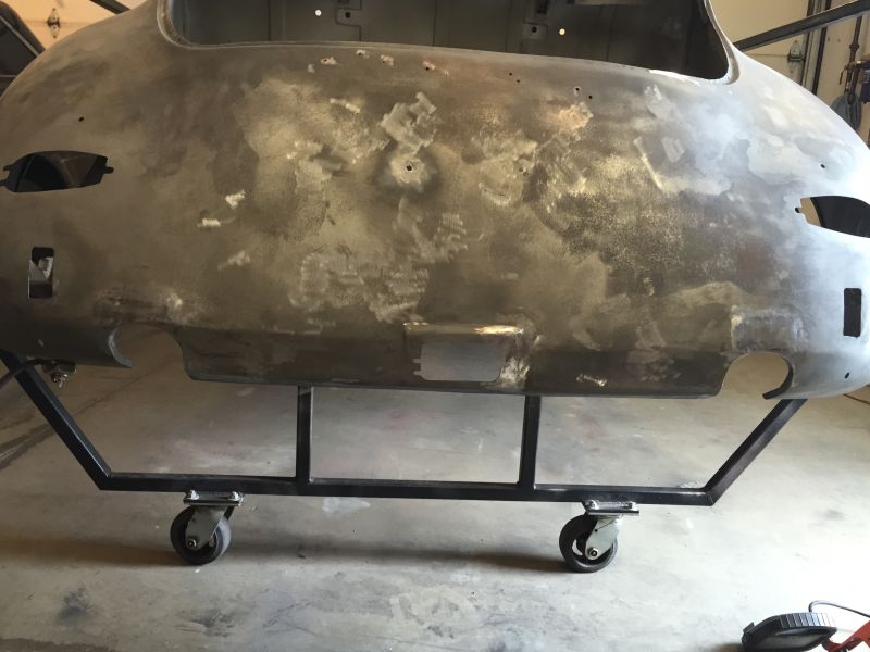

                Right rear fender with thinned and missing metal. I'll cut around the inner support wire to save the contour.

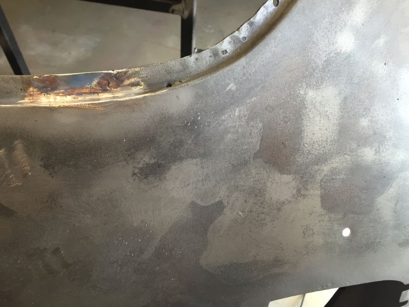

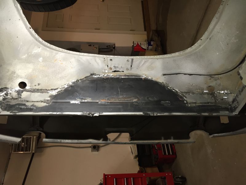

                Drip rail eaten through. It was a tough job to clean out the previous Bondo and rust. I guess Bubba thought Bondo was as good as metal to make a repair. Looking pretty good here after a bit of work.
                Drip rail repaired.

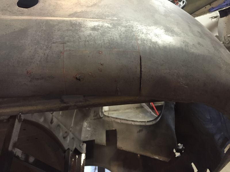

                Template for the fender edge. I'll turn the edge over the inner wire with a hammer and dolly then cut off the excess after welding the flange.

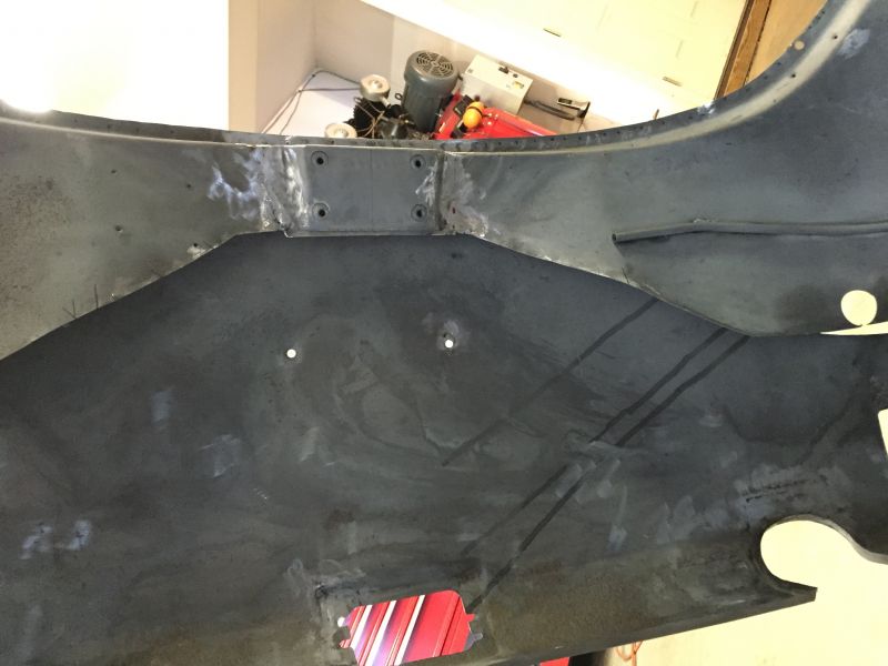

                Right side repaired. The bottom portion of the original weld seam had to be rewelded as it was also thinned out.

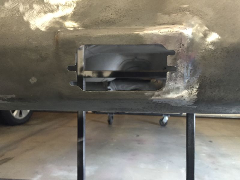

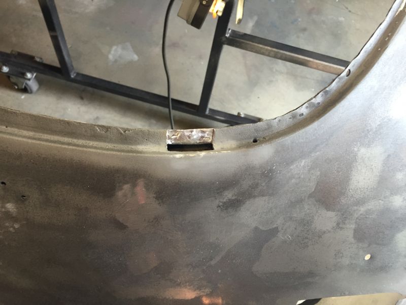

                Back up light area repaired.

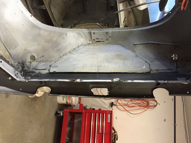

                                Now onto some of Bubba's more frightful repairs. This is the rear inner closing panel with not one, but two, 18 gauge patch panels welded on top of partially removed original metal.

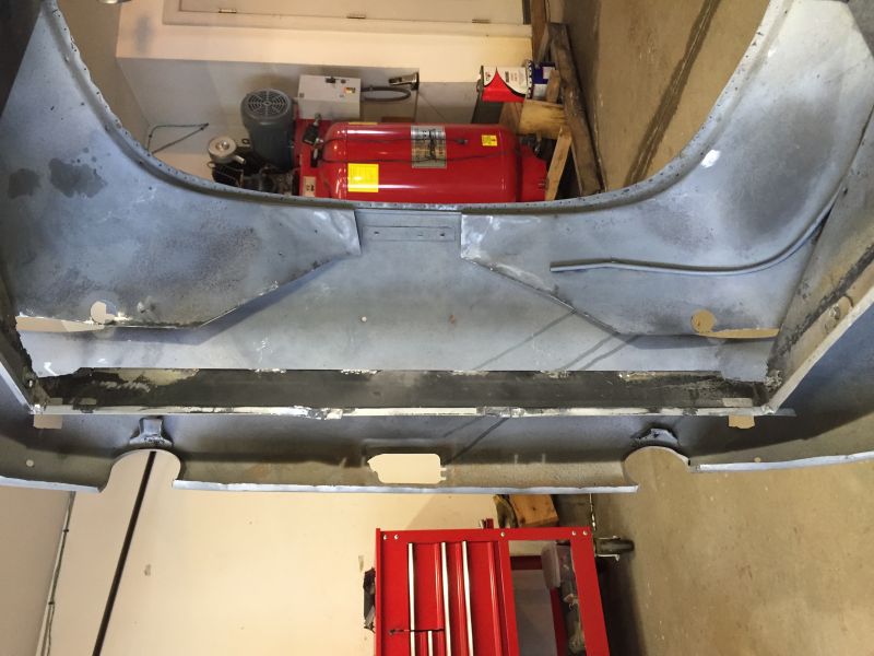

                                This is the second panel after surgically finessing out the outer panel. I also ground down all the proud welds thinking that maybe I could save everything and save me some time and effort. Then I thought better of it and didn't want to cut corners at this point.

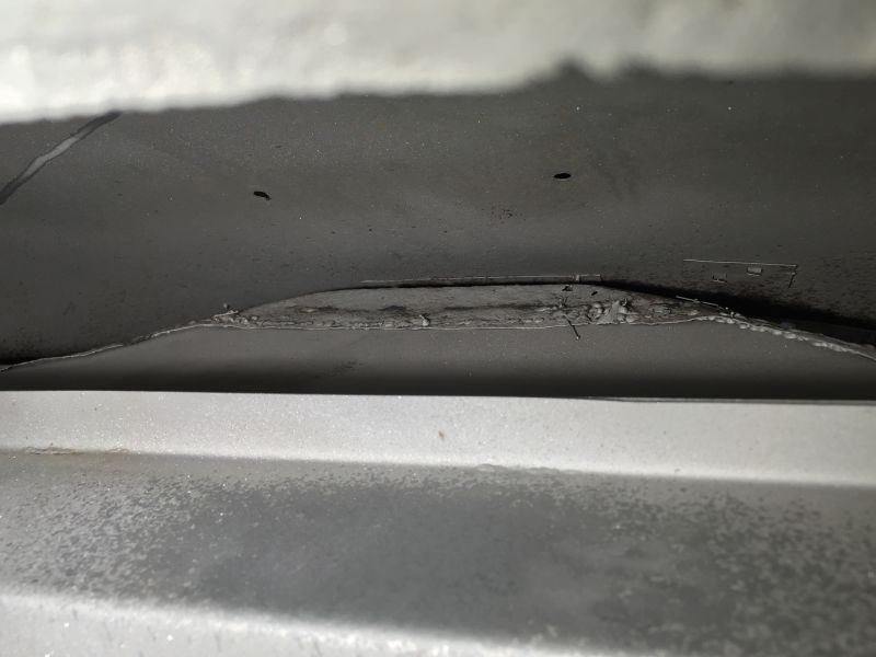

                                This is the backside of the welds. Some of the original metal was cut out and the remaining was never cut back far enough to remove the rust. The new metal was just welded on top. So frustrating. After seeing this there was no question of the need to remove it all.

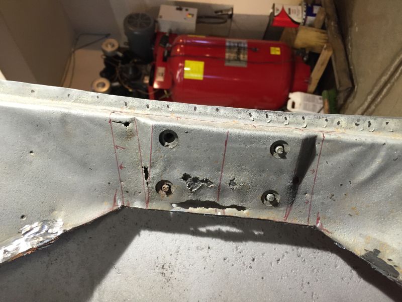

                                The lock area was rusted through and 3 bolts were broken off inside the weld nuts. Easier to remove and replace.

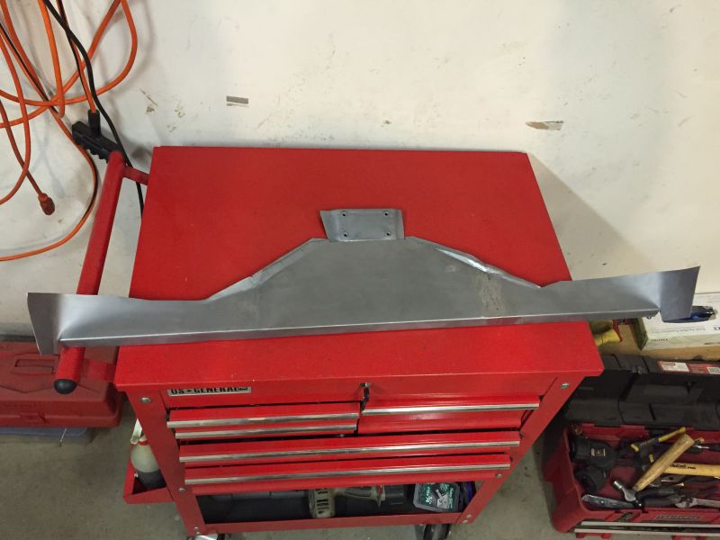

                                Replacement panels made in 4 sections. The larger panel has been TIG'ed together to make one replacement. I need to spot weld the electrical retaining clips on the backside and will probably spot weld the crossbeam before fitting, as I won't be able to spot weld it afterwards due to access issues.
                                The new lock post welded in position.
                                I've got to repair the rear portions of each frame member first, before installing the lower section of the rear closing panel, as they are rusted out also. One step at a time.....
