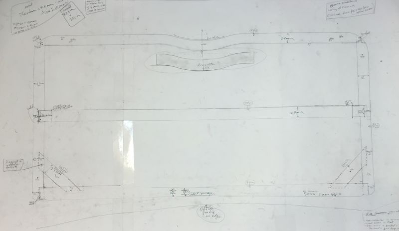

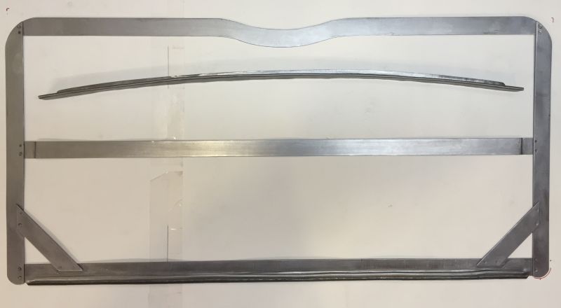

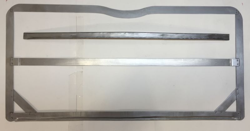

                • This New Hampshire winter has been fabulous for skiing. Not so much for working on the 356 in an unheated garage when the temps start in the single digits and only get up to the teens. I bought a sunroof clip this past fall and unfortunately all the small parts were missing. It's been fun tracking all the stuff down as everything but the seals are NLA. Of course anything with the Porsche name on it brings top dollars and the Golde Porsche sunroofs have unique parts that other marques don't use. I spent the last week making a new headliner frame and reinforcement piece for the sliding portion.

                  I'm going to rebuild the sunroof transmission next, restore the aluminum rails and then fit everything together. It won't be installed until after the chassis is restored and the floors are in so the car is as stable as possible.

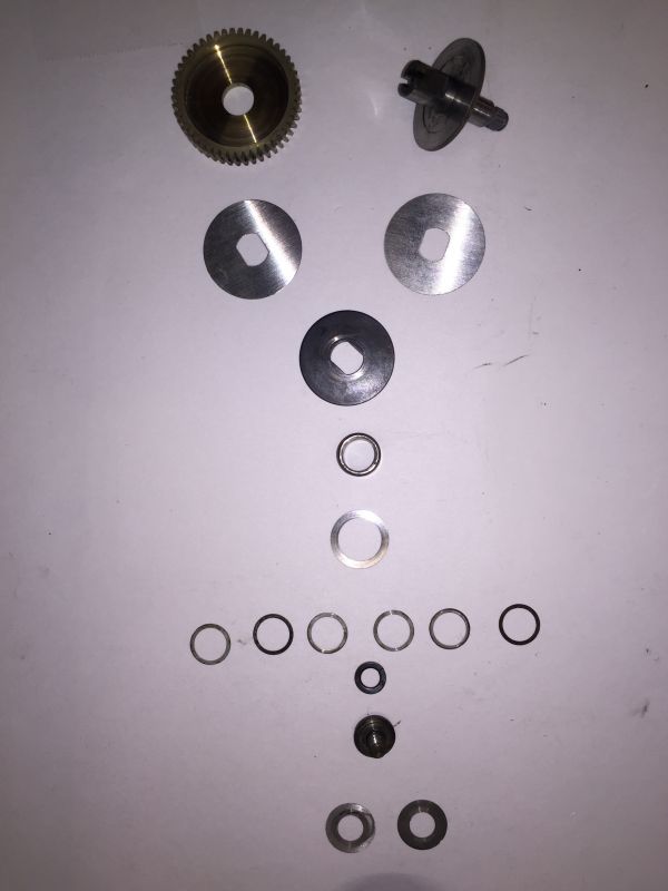

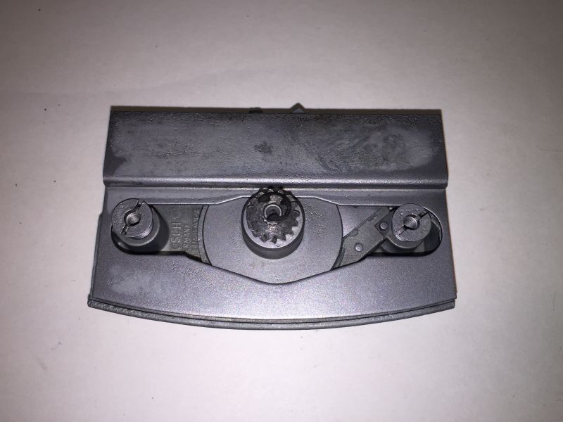

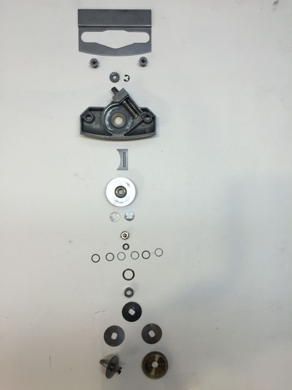

                      I spent the last few hours taking apart the SR transmission, cleaning it and putting it back together. I was amazed at the number of parts that are involved and need to work together....like a swiss watch. I'm definitely going to fit everything before any headliner installation.
