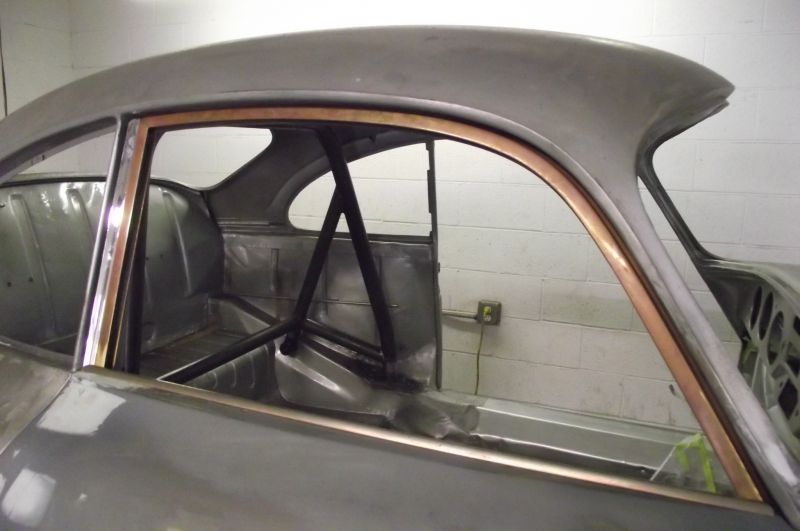

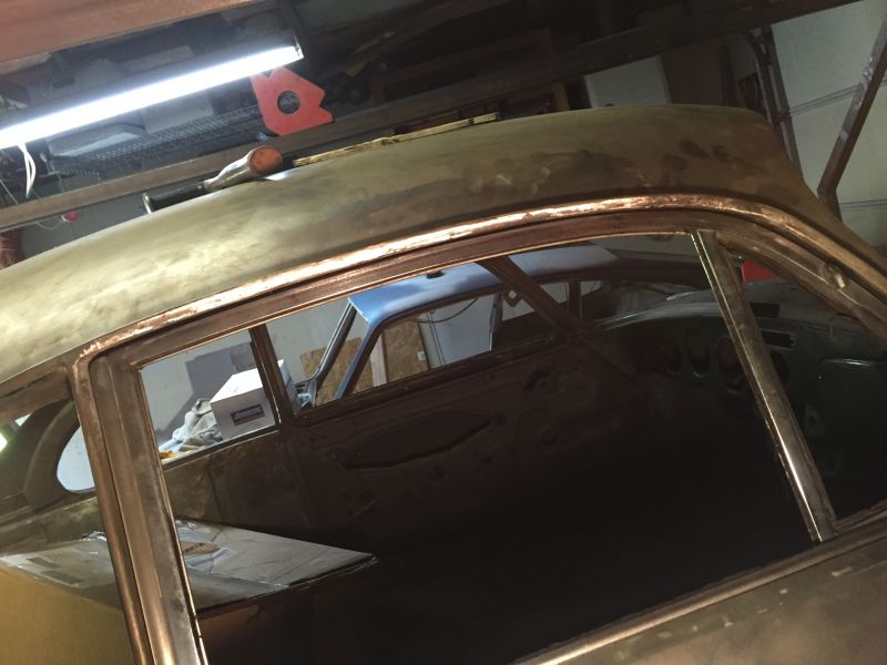

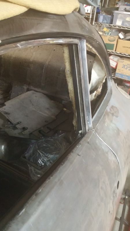

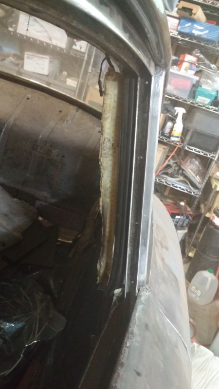

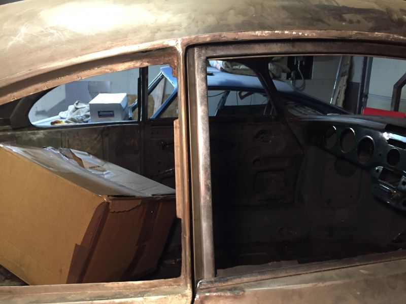

        Last night I tinkered with the passenger window frame. It needed a bit of tweaking similar to the passenger side. I got the gap even all the way around although it's hard to see in the pictures due to shadows in my dark garage.

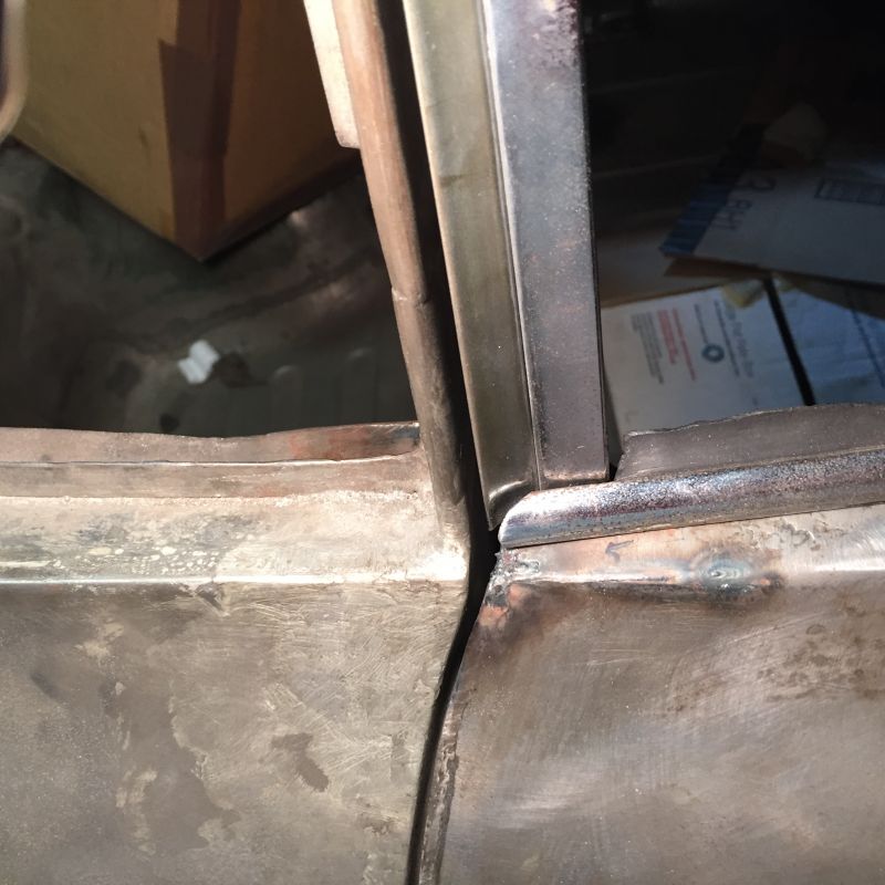

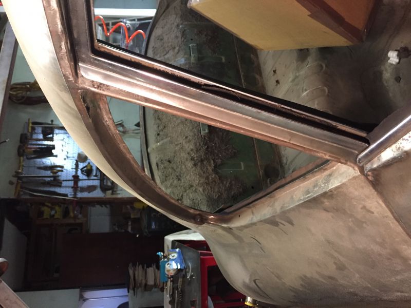

        There are few things that I'm not 100% sure about though.
        One is the angle of the frame relative to the B pillar. The drivers side lines up more parallel. I know I can slot the door bottom more and bring the top out, but that will also reduce the gap at the top some.

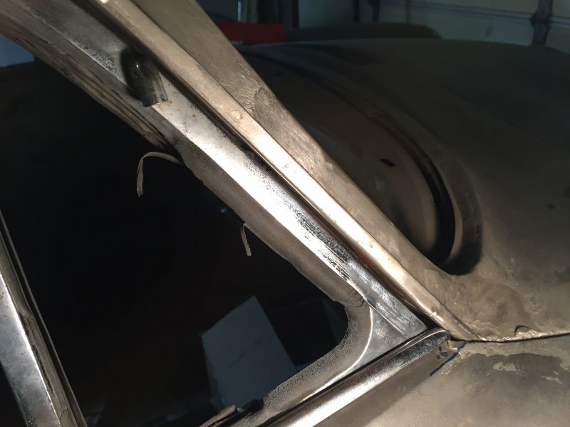

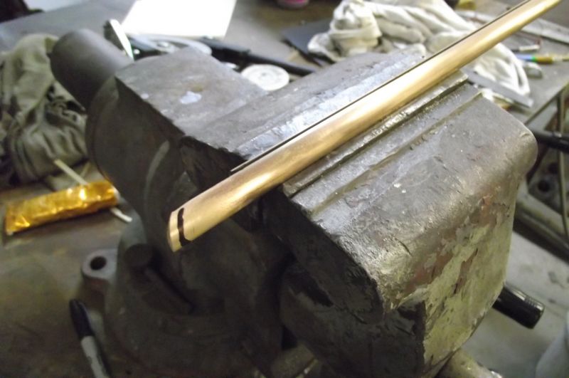

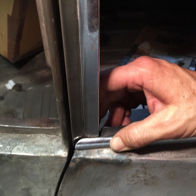

        Second is the threshold strip seems too long at the front.
        I guess given all the work that's been done to the doors and pillars I suppose I will need to grind the strip a bit, but I hate to do that.
        Thanks for watching these minute details!
        • Tom, those window frames seem to be all over the place, even on OG cars. I shoot for even gap at the vertical B pillar when veiwed from the side, even if they are wider from one door to the other. Yours looks good there. As far as the "tilt", the frames must be adjusted to allow good contact with the door seal to reduce wind noise. Don't worry too much about some differences there.
          RE: the part you call the threshold strip. Yours seems to be a bit out of position. I could be moved a little rearward to give a tigher fit to the chrome wind deflector at the rear of the window frame. The gap looks too big there. That will give the needed relief at the front as well. You will need to build up the trailing edge of the door a bit, as the deflector and strip should not extend over the door surface. Irregular gaps at the very top of the door are common, but those chrome bits should not be flapping in the breeze over the edge, as your deflector is now. So don't sell your welder yet!

            Jack's right the top strip should hug the deflector profile. There is most certainly a left and right side orientation to these strips and a distinctive profile shape at each end. The back is sharp and elongated to mate up to the deflector and the front tip is much blunter in shape. You may have yours switched or if you've acquired these you may find out that you two rights or lefts instead of a matched pair. I learned this one the hard way a while back.
            Like a moron I sold all the original frames to this car thinking they are all the same. This side fit natural
            But this strip ended up being a touch too long as Jack described.
            Excess was removed to fit this car properly.
            Live and learn but so glad I found out all before chrome plating.

            • Door top strips on doors with vent window can not be can not be switched left to right, as the mounting flange is cut away at the front to accommodate the mechanism.
              • Oh, that's right, I forgot all about that damn vent wing. I better stick to T1 stuff.

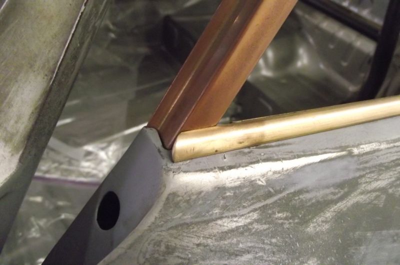

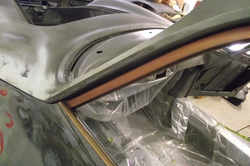

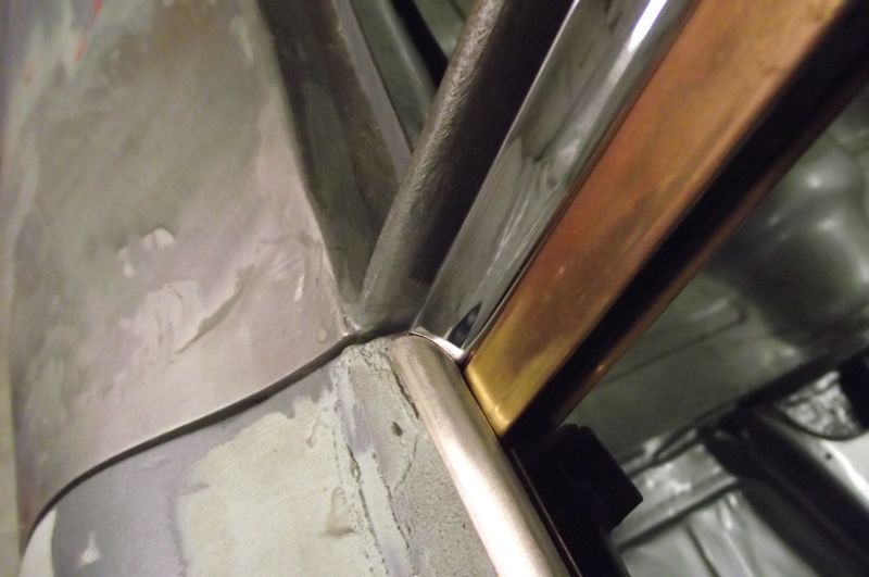

                  I have the frame and w/s installed on Foam Car's drivers door(which has no mirror holes so your research will be useful to me). Here are 2 pics showing the angle. The second one shows better how the frame butts to the w/s.

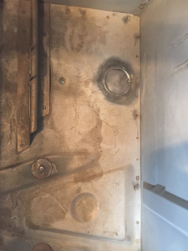

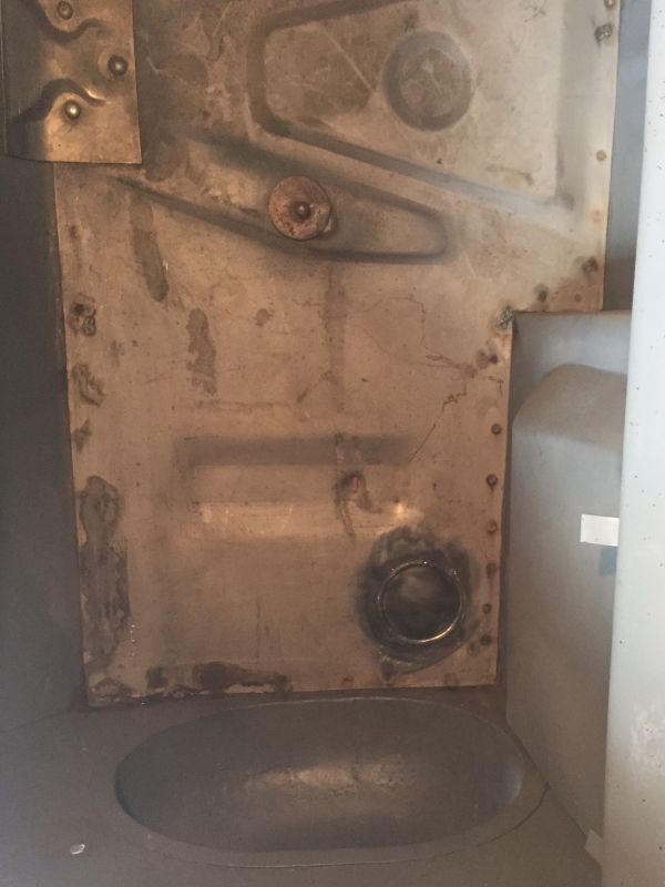

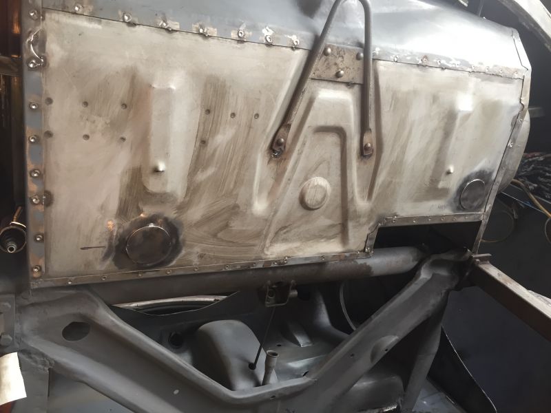

                    I'm still fine tuning small details here and there as time allows. Here's a few pictures of additional Karmann floor plugs in the battery box area. Thanks to John and Bruce for researching these further. My original floor pan was unrecognizable and if I had known earlier it would have been easier to install these plugs before the battery floor was welded in.

                    • Tom,
                      I think you've hit all the Karmann details. It looks great.
                      As you said: they definitely would've been easier to install before the pan installation. It's tough working in confined quarters.
                      • I did not buy a Reutter on purpose, but glad I don't have to go back and add all those plugs. Looks great Tom. Keep at it.

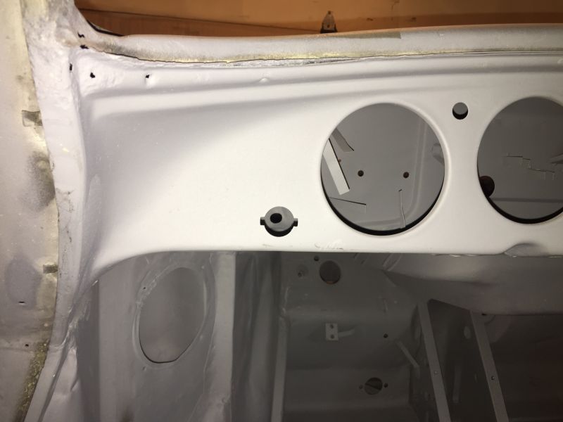

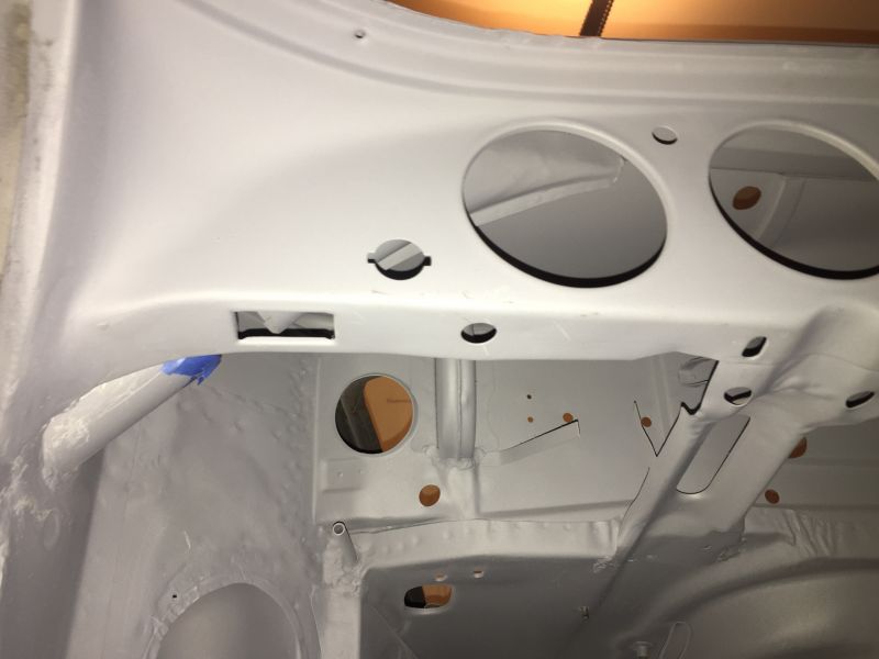

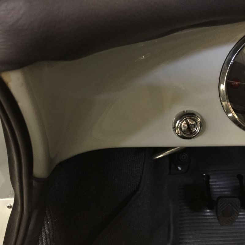

                        • Can someone confirm that the left hole on my dash board is not factory?
                          Thanks,
                          • I don't have it on my car and I have not seen it on other dashes.
                            HTH.
                            JP
                            • Consensus says:
                              • Tom
                                Foam Car has a hole there that is definitely not factory. Someone punched a hole there for an electric fuel pump switch, which I just recently removed. Will have to fill it in.
