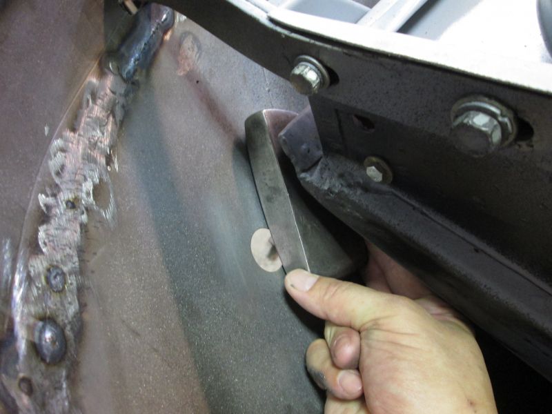

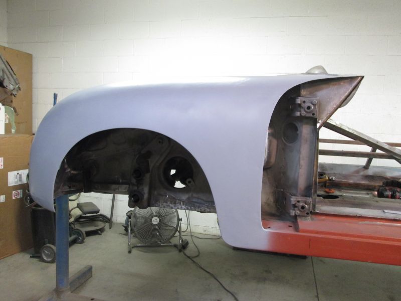

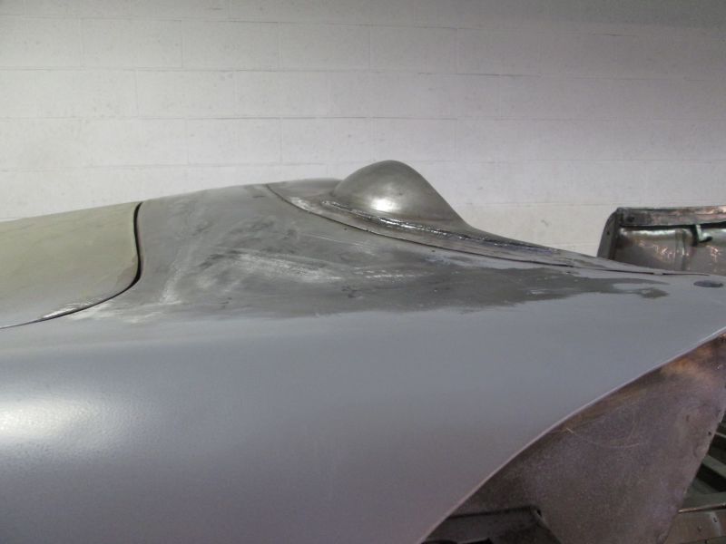

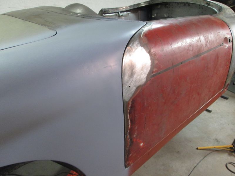

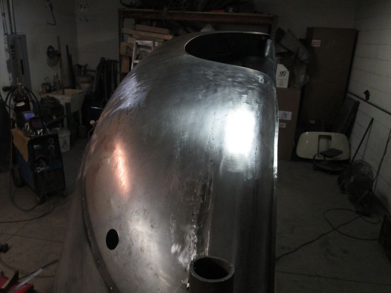

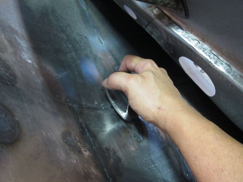

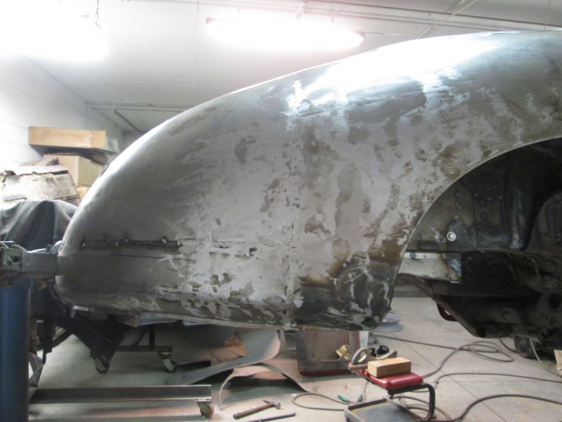

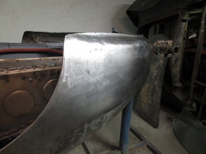

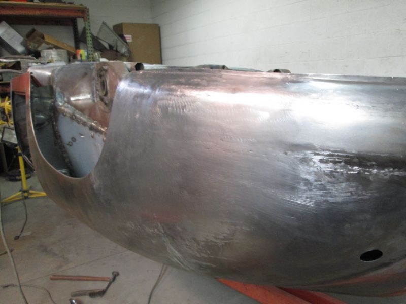

    Picking, filing and shrinking the welding joint and old accident damage on that old original section comprising the bridge patch.

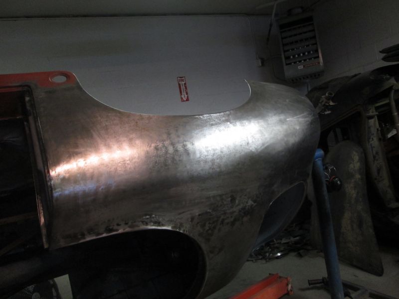

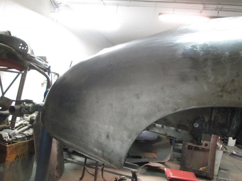

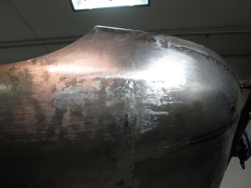

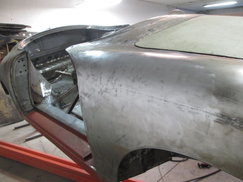

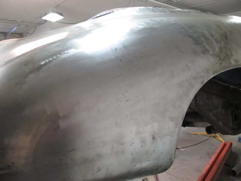

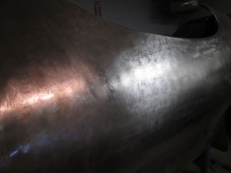

    Same story as with the left; spending as much time on it as I can cleaning it up so its not a nasty repair patch requiring a ton of filler.

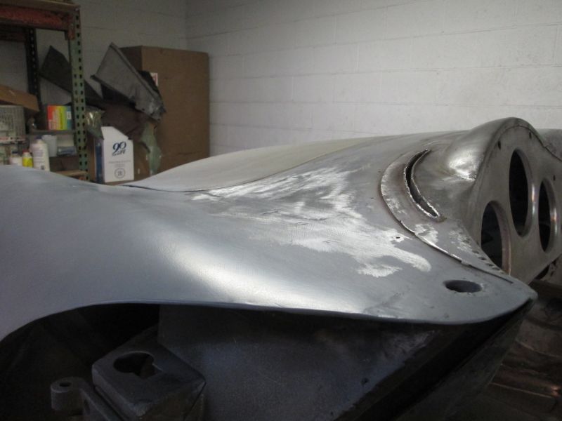

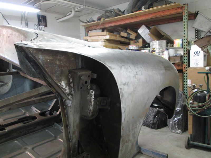

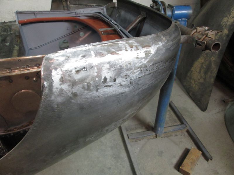

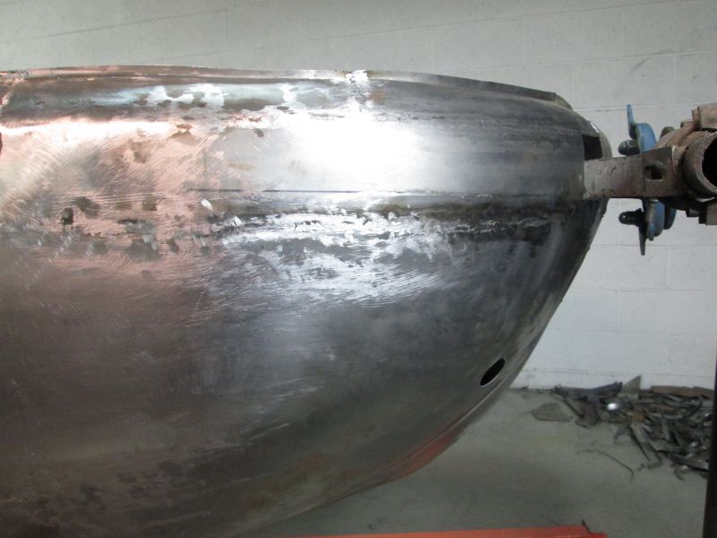

    Like the other side,gentle rollers remain but its a close enough fundamental shape that won't need a lot to take it the rest of the way.

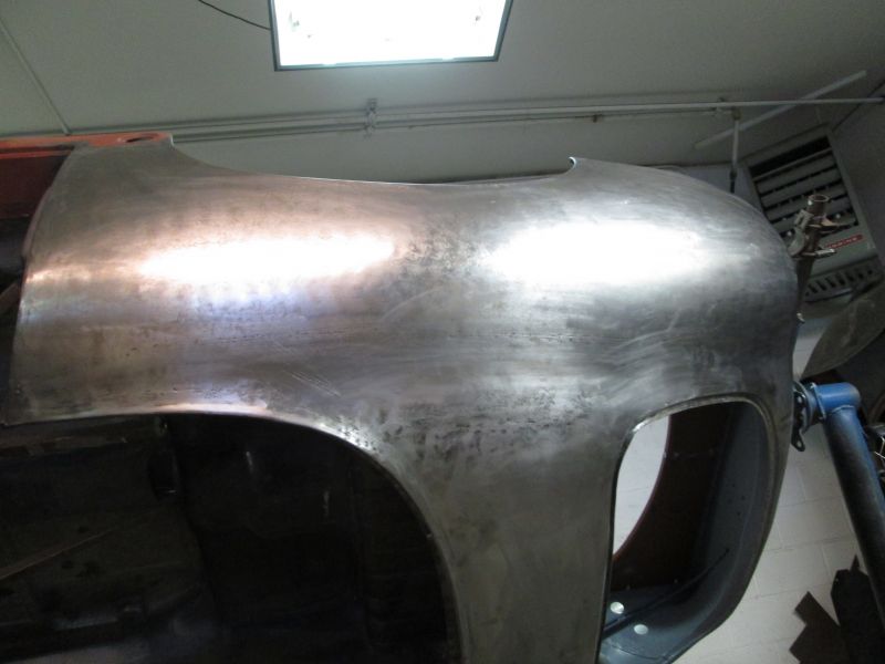

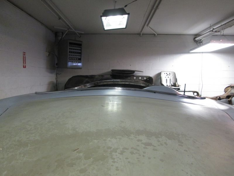

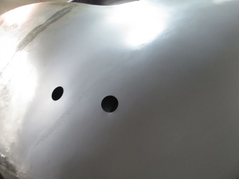

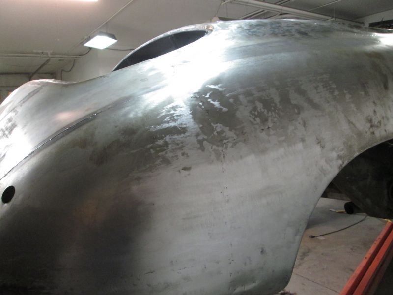

    Its monsoon season here so the humidity is a lot higher than normal and I noticed my freshly completed left fender is beginning to flash rust.

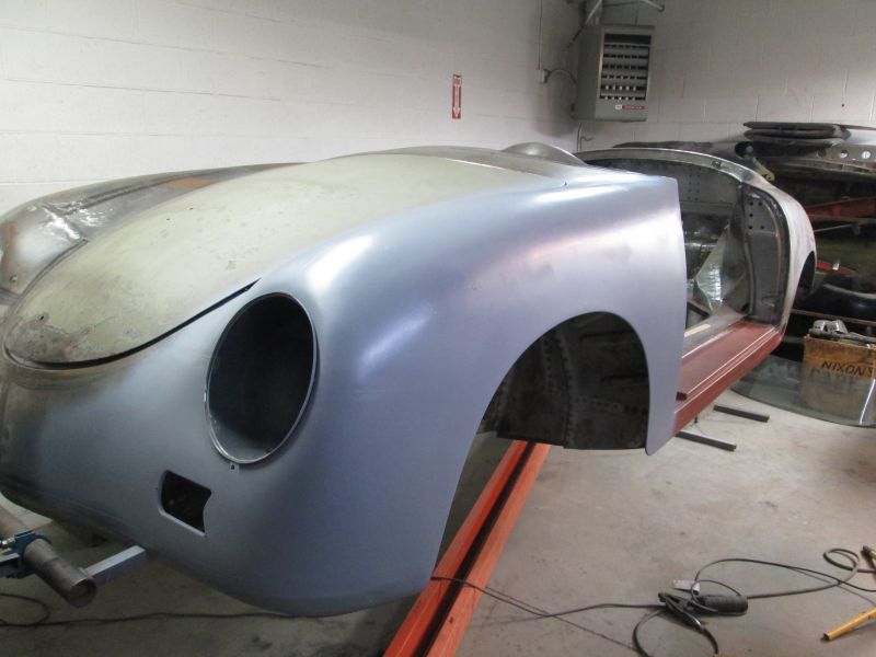

    This car will be media blasted again but thought of watching all these silver panels fog over brown was too much to bear. I brillo'd the fender back clean and gave it a quick coat of primer.

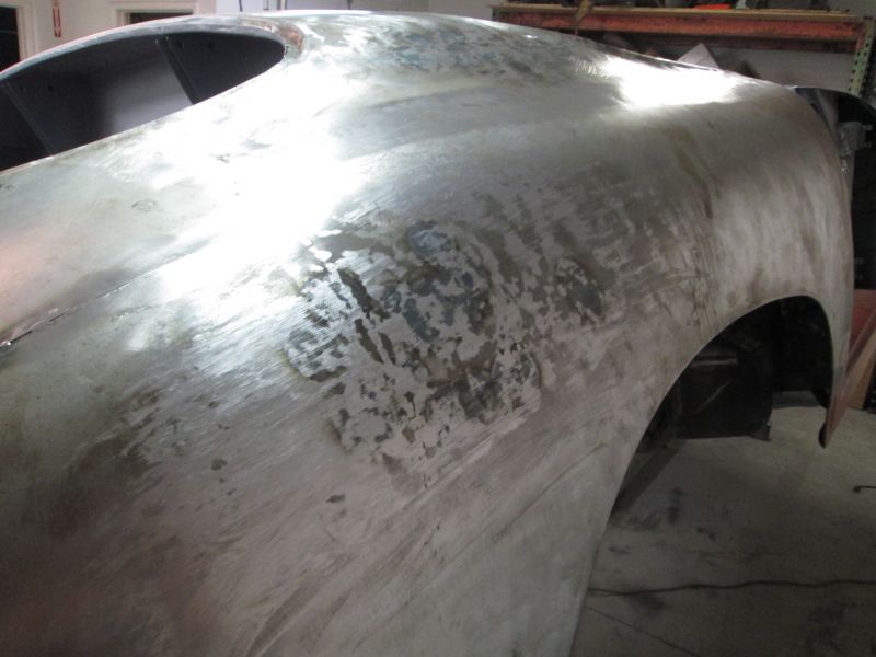

    At the same time it was nice to get the surface in different perspective so I could better make out the shape and its short comings.

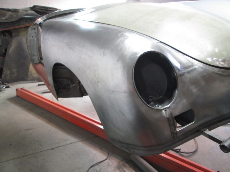

    Not perfect but a lot closer than I ever thought possible as I was initially fitting these sections to the car.

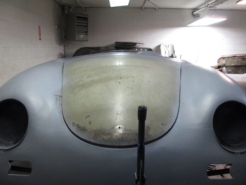

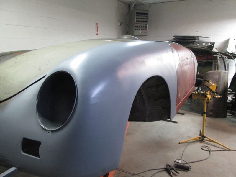

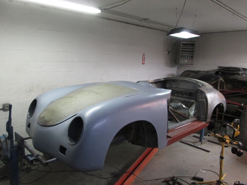

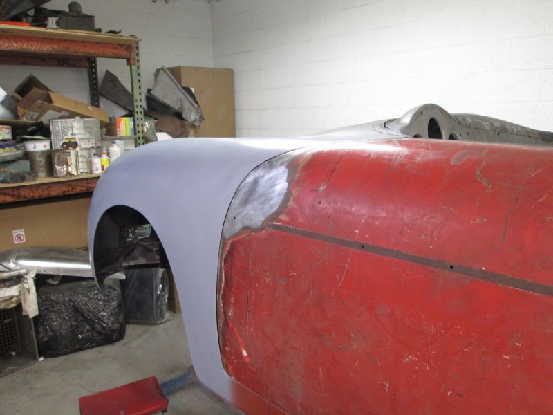

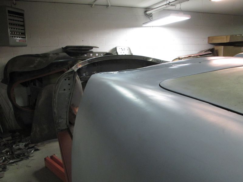

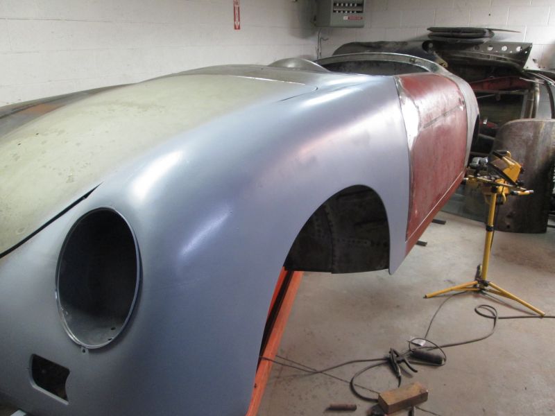

    Added the door to again check for general shape and body contour across these two panels.
    Body work yet to do but its down to just MM's of correction. I can live with that and able to pass this car off to the next guy with a straight face.

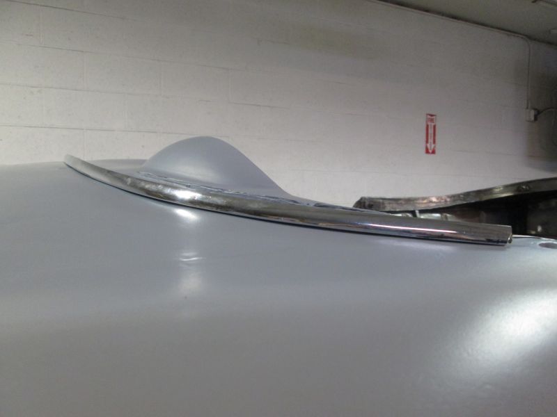

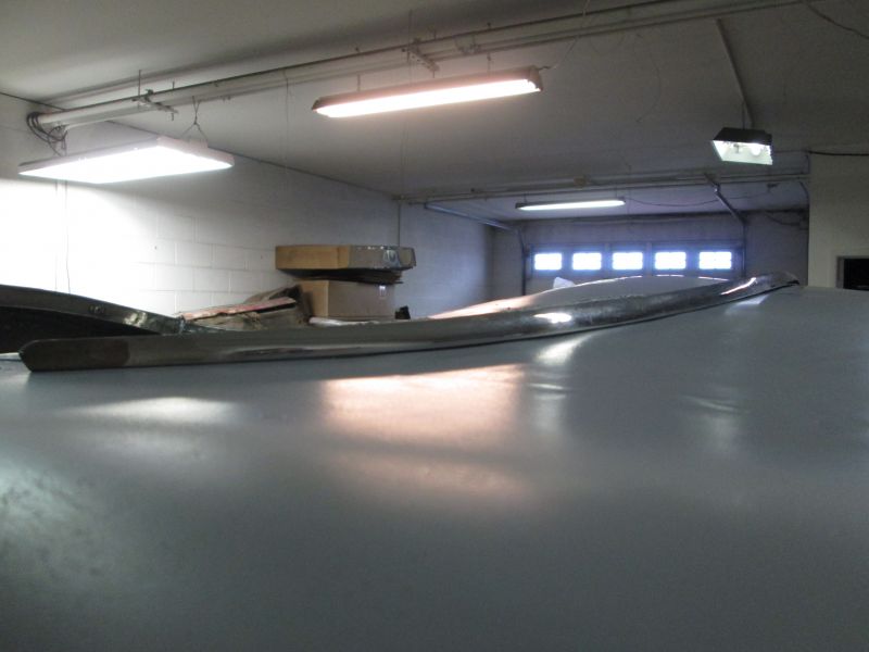

    High lighting top profile and contour sweep with door.

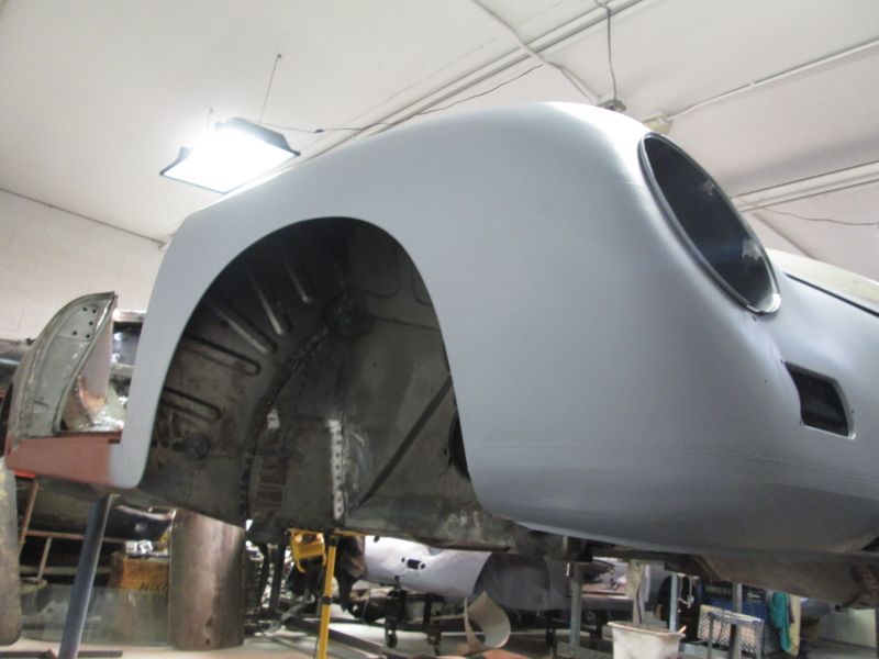

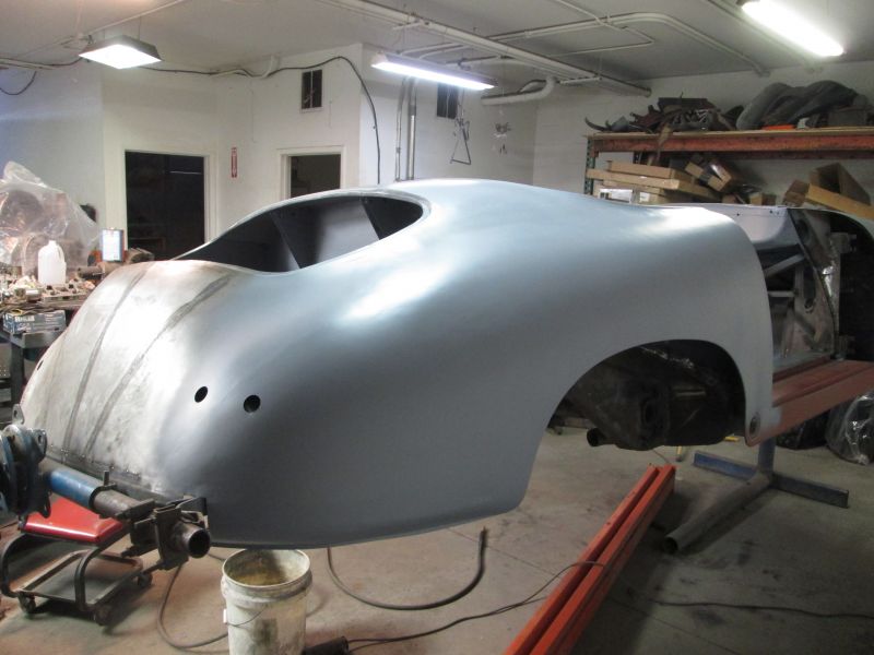

    Transitions off the door and over into the cowl as I hoped it eventually would. Again I can live with it.

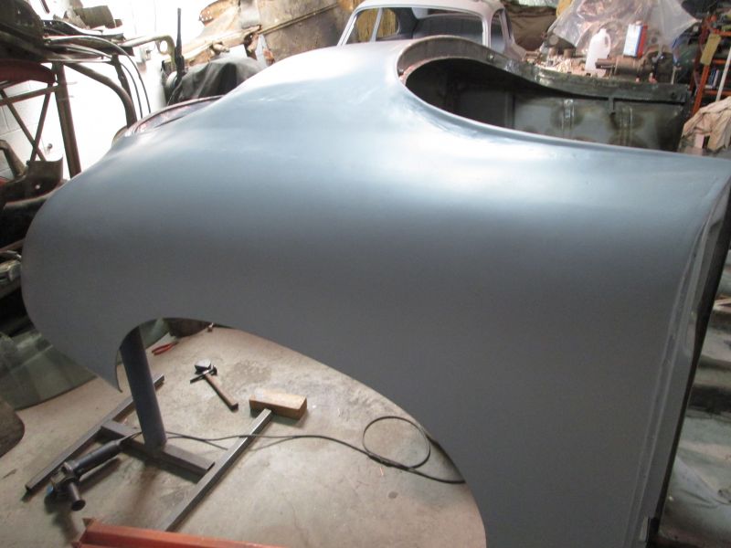

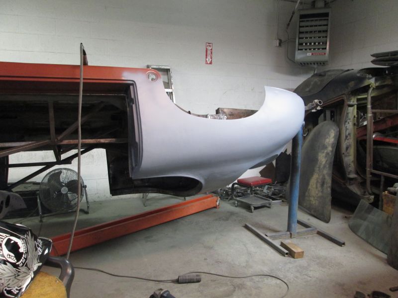

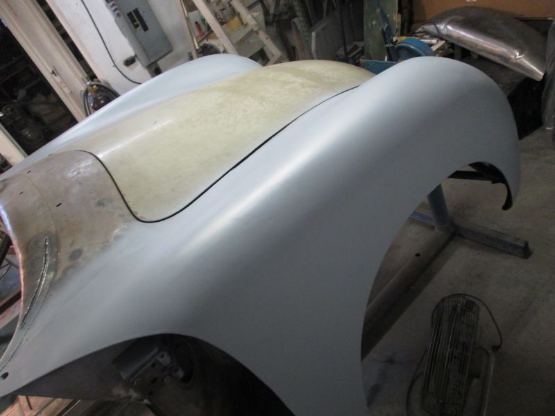

    I wasn't planning on primering but this did make for a definite and nice "period" to the end of my work on the majority of this fender. Just gotta get that damn trough area set. I'll be facing that soon enough but not yet; treating the right fender to some primer next then moving onto finishing out the skin along the tail section.

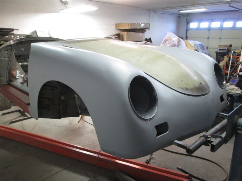

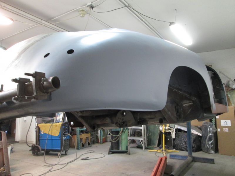

    • Front section in primer

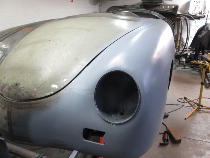

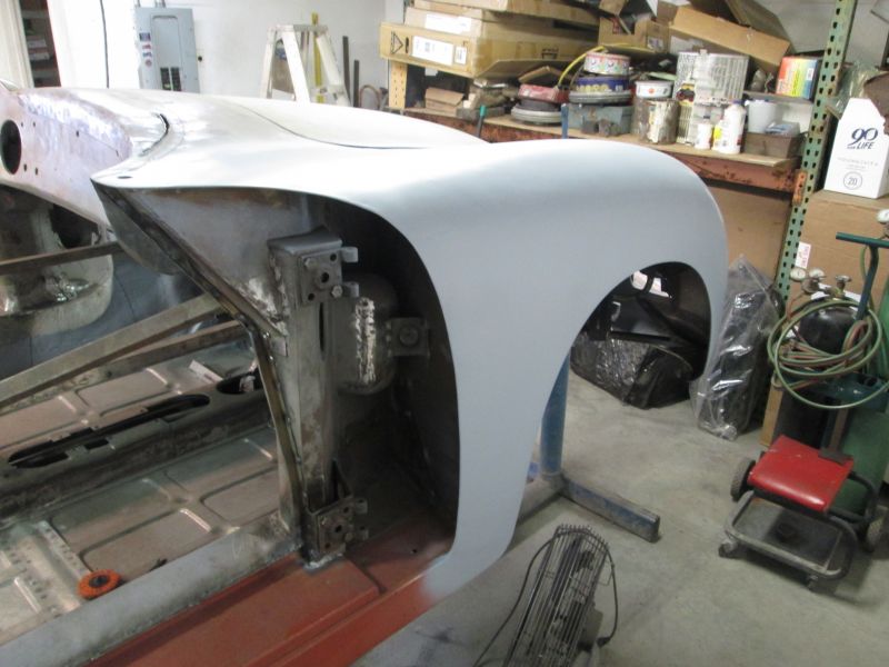

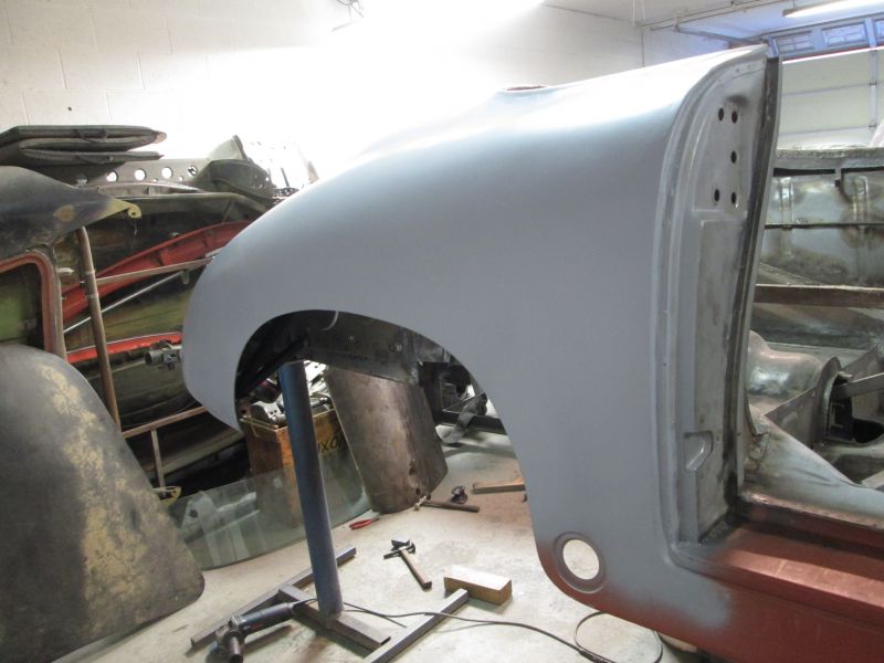

      Right fender scrubbed and ready for a quick sealer coat to hold down the flash rust.
      sealed
      About as good as the other side
      though there is a spot or two I may chase down later if time permits once the rest of the body is to this stage.
      Cleaning up the cowl and dash area next.

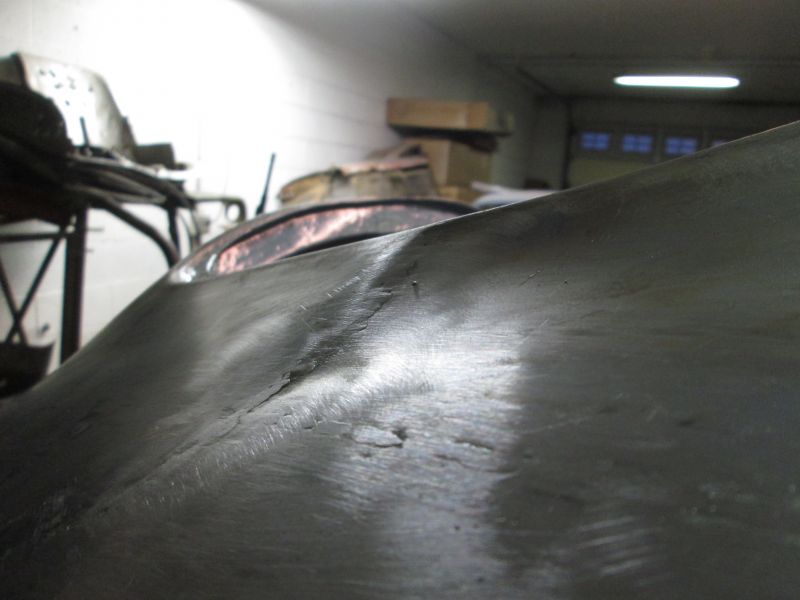

            7/28/17

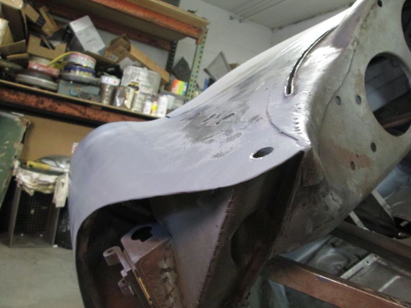

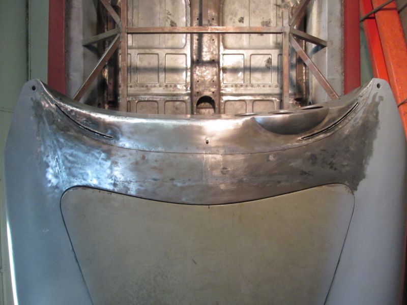

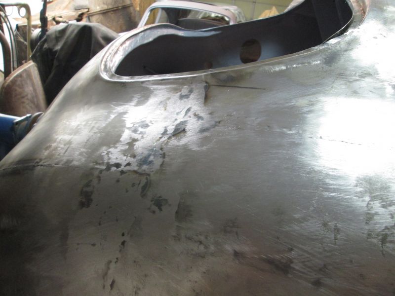

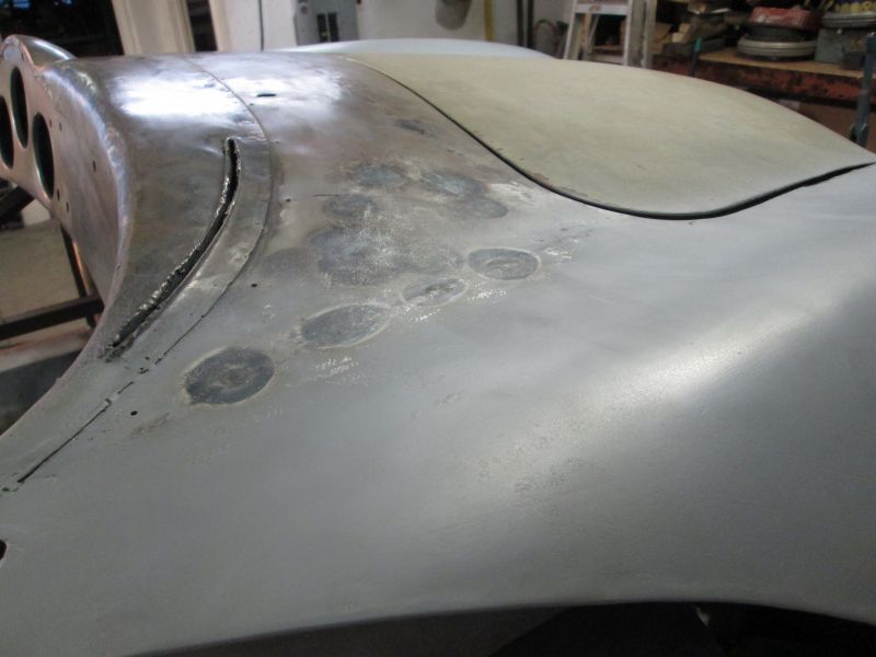

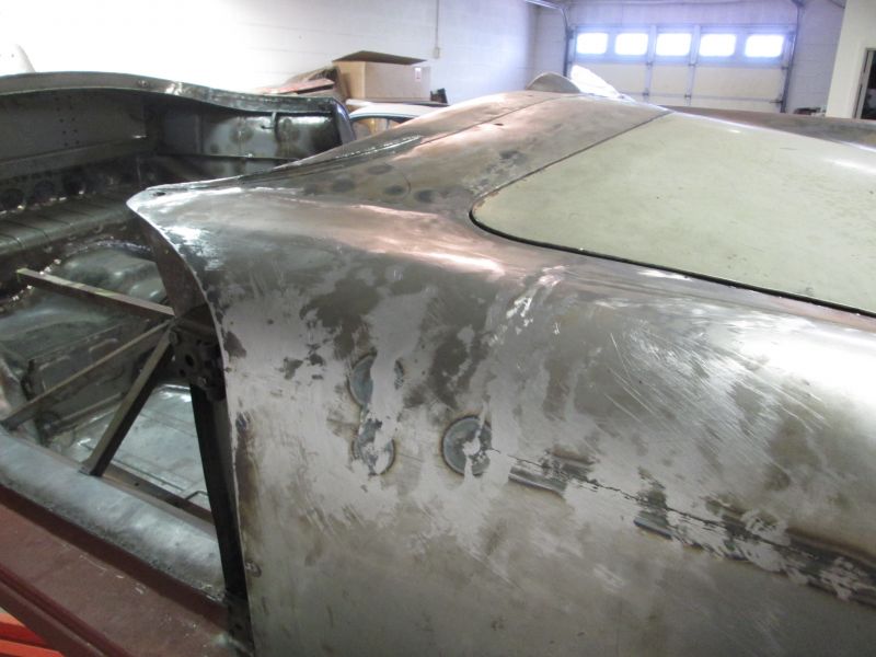

            Left side cowl contour and weld joint.

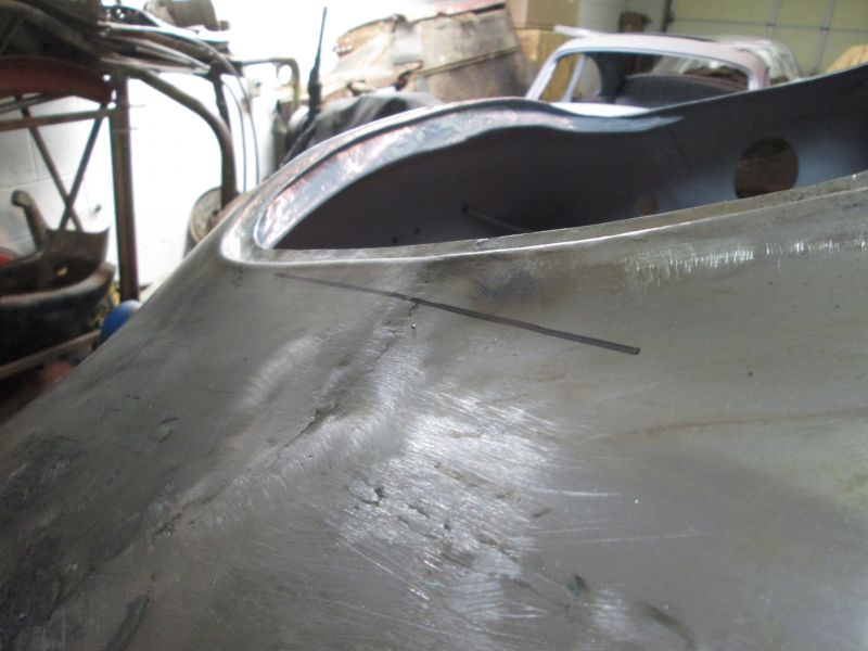

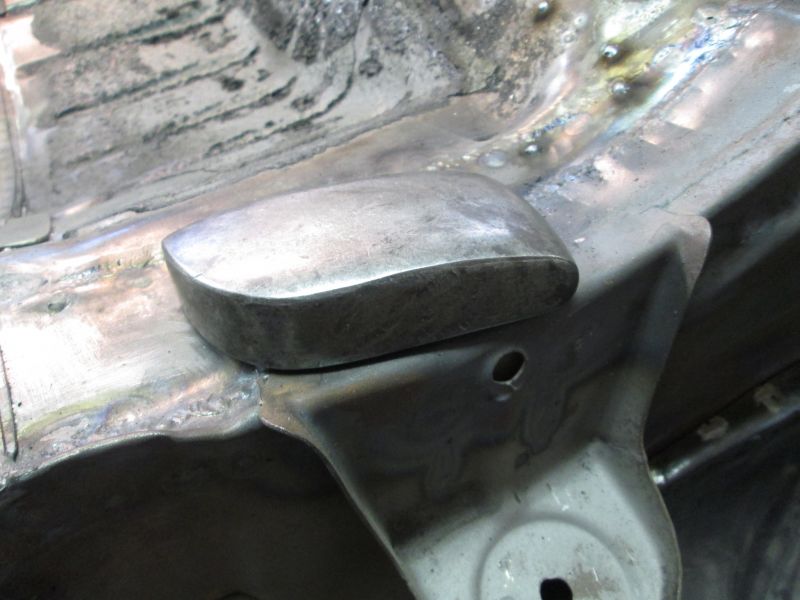

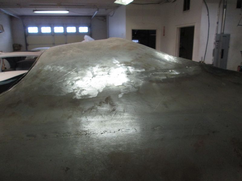

            Have a definite bulge profile going on both sides of this cowl and was afraid to touch them because they are stable and not "oil canning" but with new corner sections welded up I realized they were eventually going to have to be corrected by someone to ever look right. Began heat shrinking that area first then picked and filed that weld joint

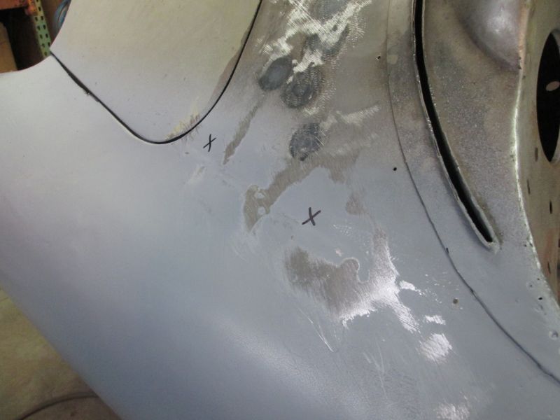

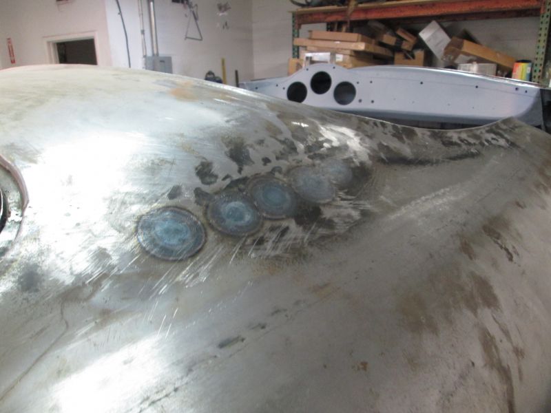

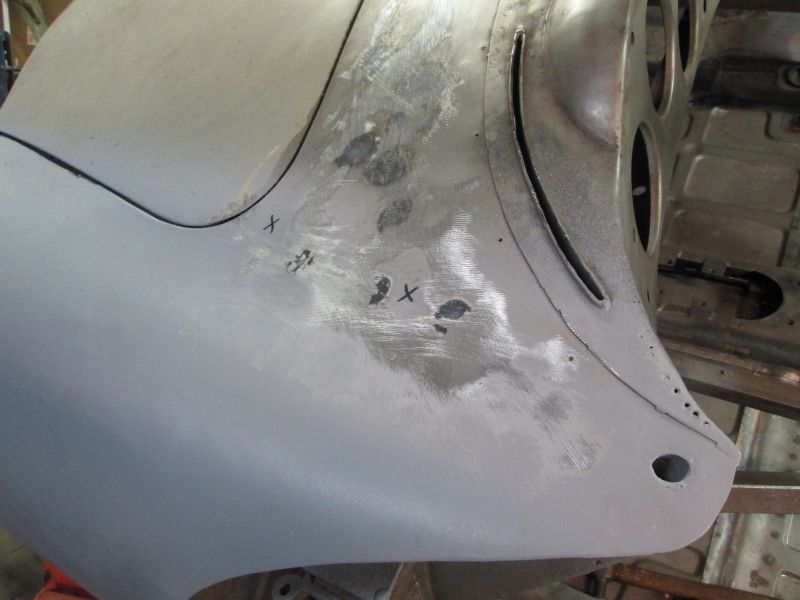

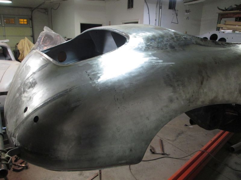

            Leveling the joint was going pretty well but there where two spots (high lighted by the "X"s) I could not get a clear shot at from underneath due to the forward closing wall and the vent duct.

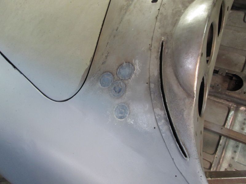

            With a bit more effort I was eventually able to reduce the area of those low spots but could not eliminate them entirely. I found myself short on tools, time and talent. A deadly combination if you're striving for perfection which I was, but...

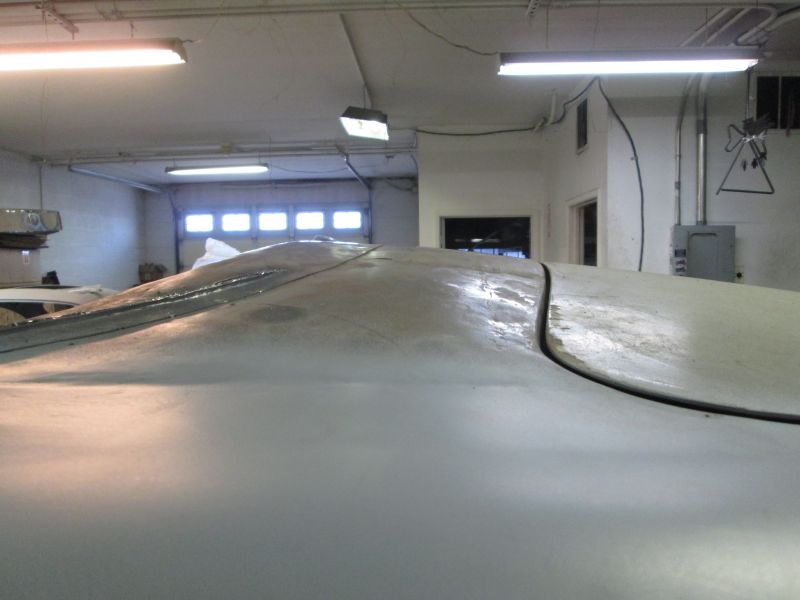

            I did end up with a good general sweeping profile before it was all over.
            Continues the profile off the hood on up to the windscreen and most importantly its stable and not oil canning.

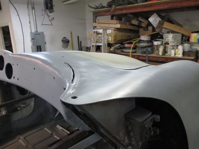

            • 7/29/17 part 2
              Right side cowl area

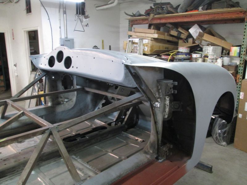

              Much better access underneath on this side to get at my weld joint. The trade off was the lump on the cowl side was very stubborn.
              Eventually got it down close enough and prepped the rest of the dash area for a quick sealer coat.
              Several rollers remain but its close enough for gov't work.

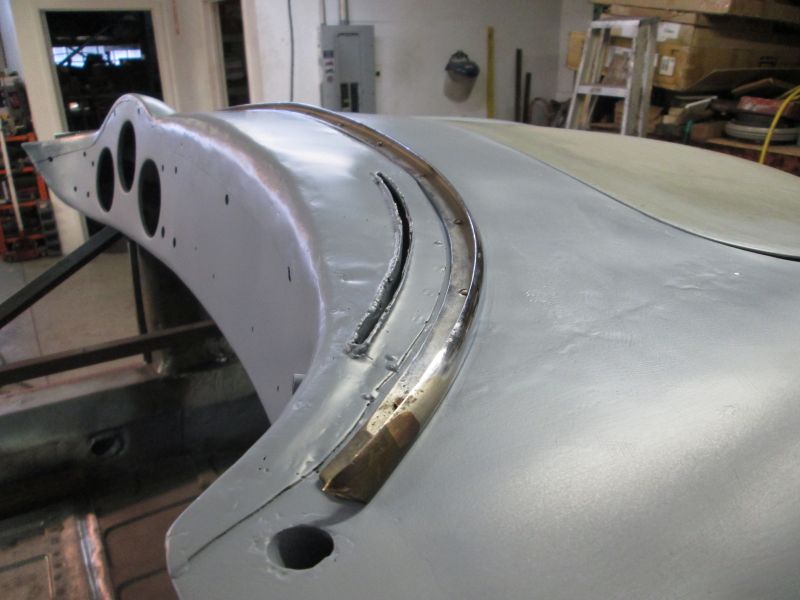

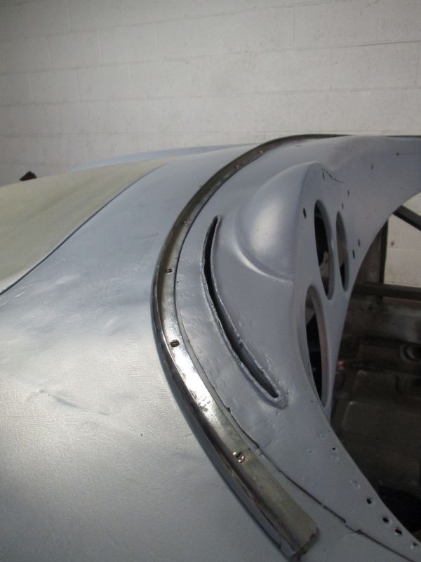

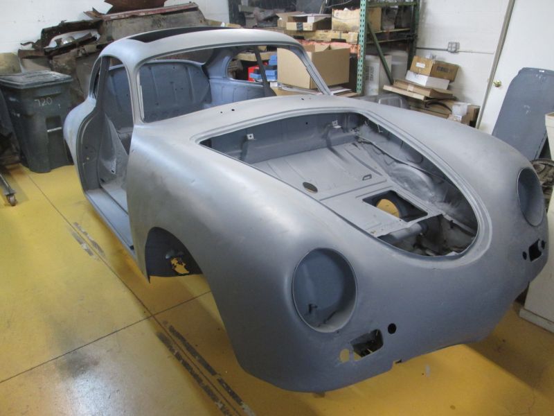

              Before I wrapped it up for the day I figured now was a good time to make sure my lower Windshield was still going to seat properly after all of the adjustments that were made out at the corners.
              Much to my great relief it seated right down with no issues.
              Several mild rollers and gaps along the way but nothing serious. Again this my raw shape fitment with no lead any other fillers.
              Most OG speedsters I've seen have this dash lap joint completely smoothed over with some kind of filler.
              With that in mind its pretty damn close and won't require very much to be perfect.
              Anyway I can now confirm that an original factory Speedster windshield base will seat correctly on this car. Another big relief!

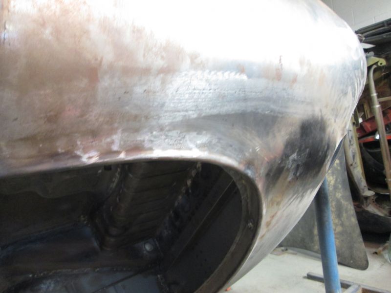

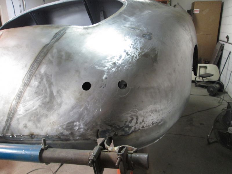

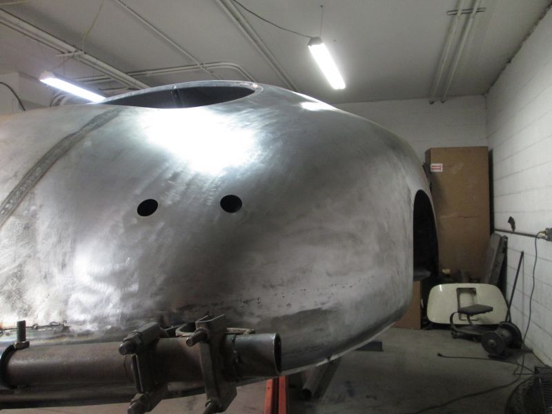

                  7/31/17

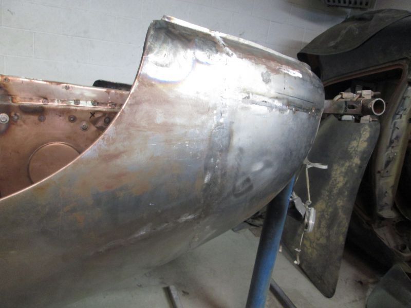

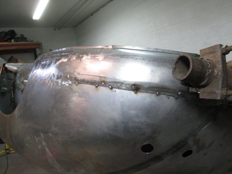

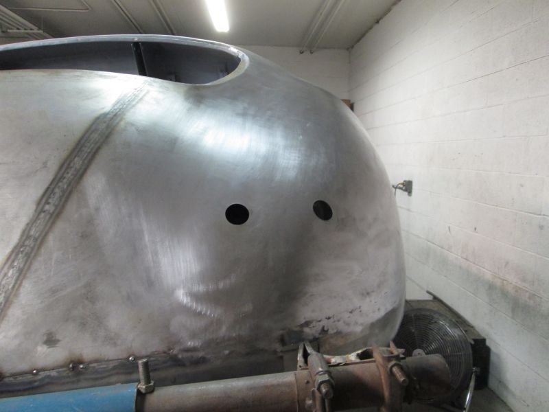

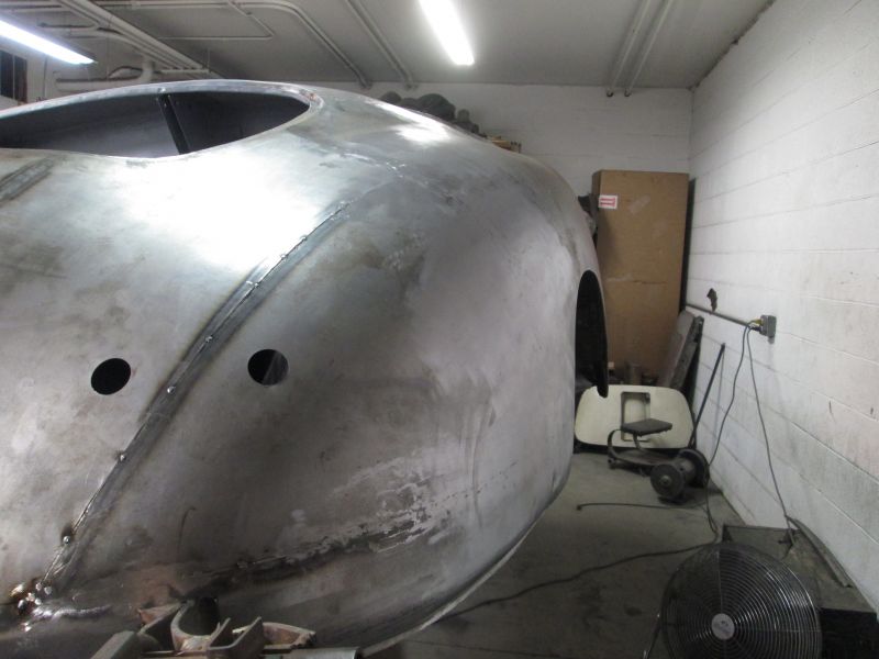

                  Begin finishing out the rest of the weld joints on the tail skin.

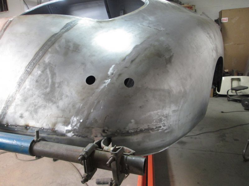

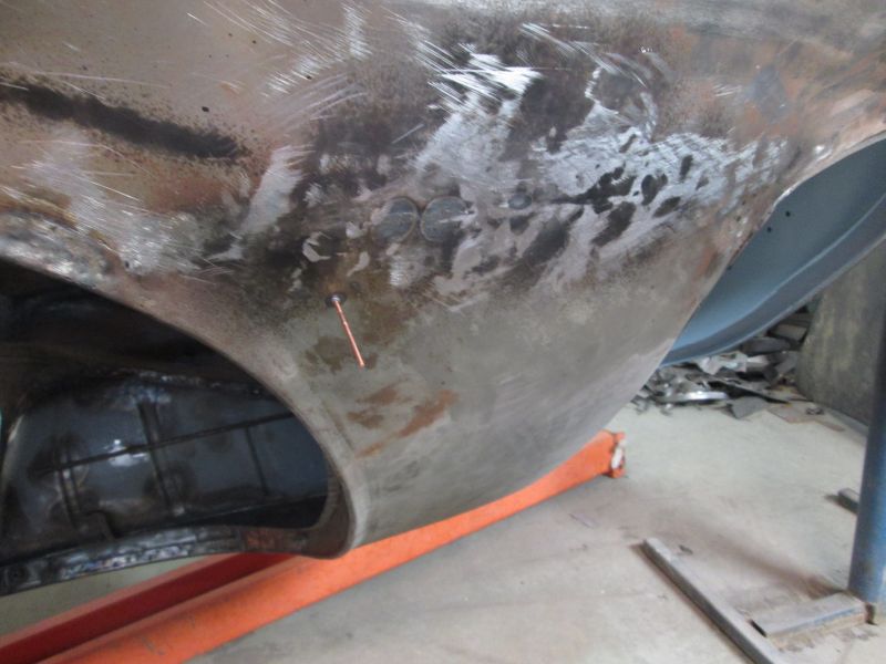

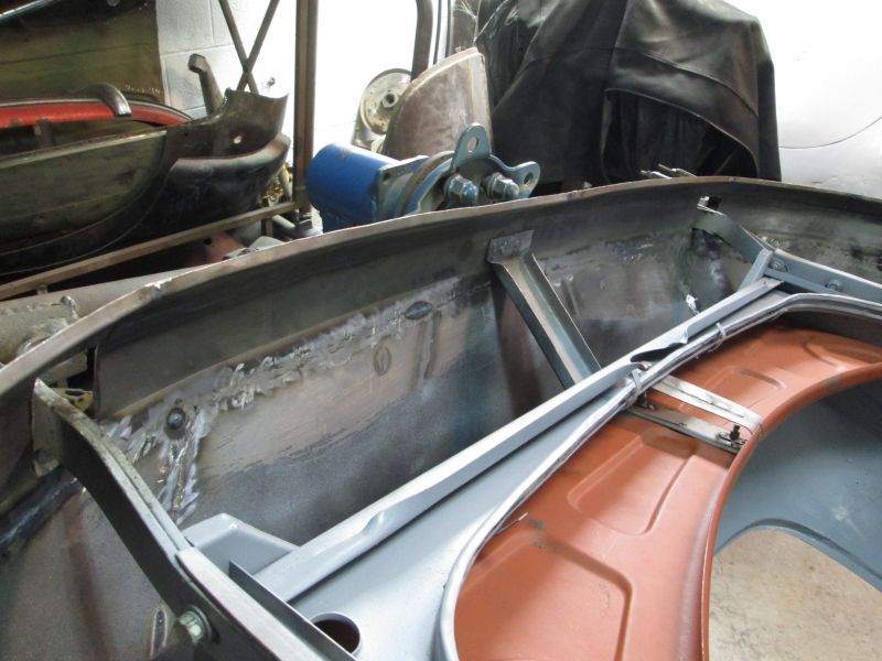

                  I had welded up this joint some time back. It of course suffered the worst of the heat warp up toward the lip where its least accessible from underneath.
                  Picked and filed most of it and that relief cut I had to add just at the lip so the contour sweep would line up and work.
                  I was able to peck most of it out but there were several spots that where just too deep to reach behind so I had to resort to my stud puller.
                  I tried to place that weld joint out in the open as far as I could for this very reason but as you can see it ended up just out from the closing wall. I can get to some of it but not a real clear shot.
                  I spooned it out pretty close but not a well as I would have liked and certainly not as well if I had direct access to the back. Before it was over I did notice I had more of a drastic dome shape going on toward the bottom here. I few spots of torch heat leveled that out. However I just realized I'm still not quite done as I have just noticed a shape discrepancy with the other side. I'm going to hold off for now until I get the other side all welded up then see what will be required to get them to mirror one another a bit more closely. Always something.

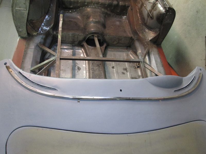

                    BTW, your inner bracing reminds me of that which I made to create the Cabriolet top jig that Auto International still uses to use to build a Cab top when the actual 356 is not present. I bought an A Cab from a guy who just wanted whatever he could get for it after I gave him the bad news as to how bad his floor was and how much it could cost to attend to the floor and all else that was rusted through. (Today, that would be a "restoration candidate" for sure.)
                    But hey, the fenders were good and I needed those to un-SCCA-flare 84255 to be Vintage legal!
                    The bracing first allowed me to trim all else away, saving the front and rear cowls and windshield frame. Roy Nielsen was thrilled and I think we traded some A.I. work for that.

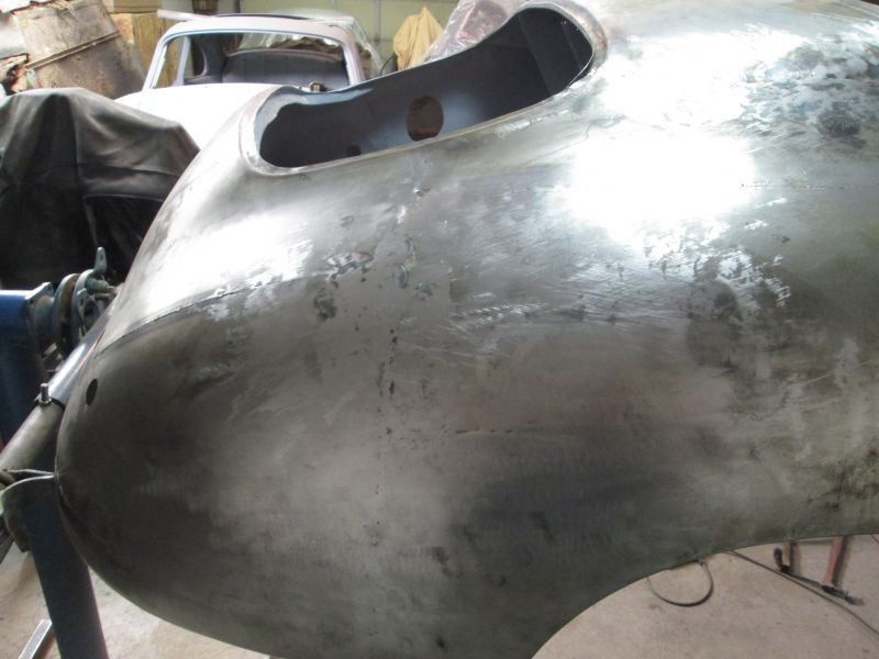

                      8/3/17

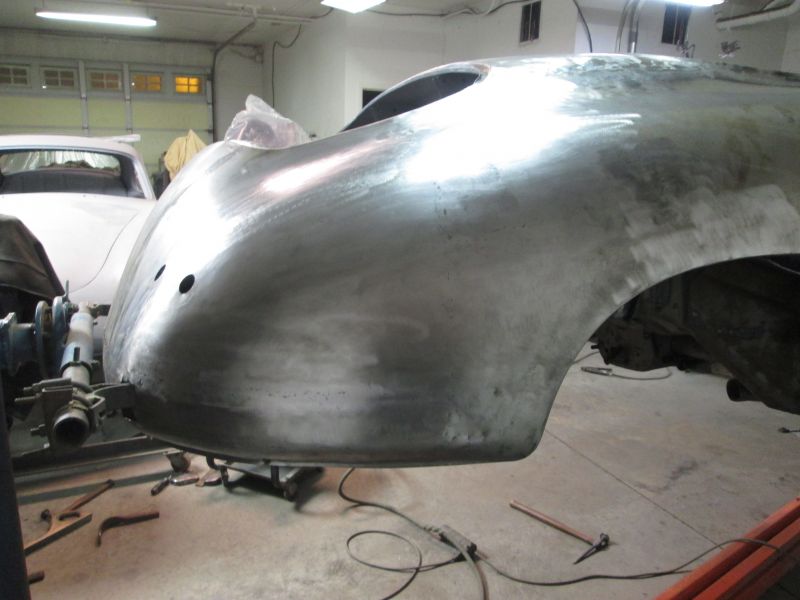

                      Right rear fender corner work.

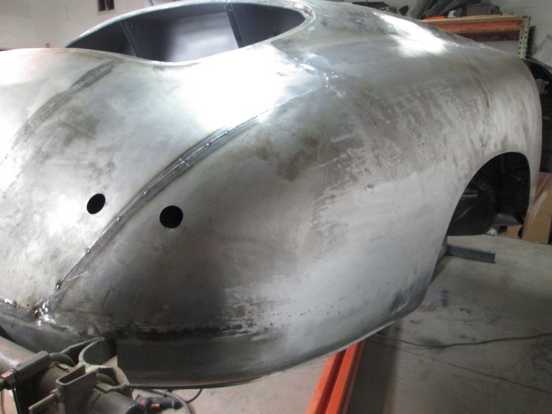

                      A ton of shape discrepancy across these two panels that was addressed earlier but even after all of that both panels still wanted to turn and sink in where they met.
                      It took some doing but I eventually got the immediate area on both sides of the joint to raise up where they needed to be.
                      It was very easy to get overwhelmed with all this mess so I had to take it one small area at a time to keep myself going.
                      Eventually got this immediate area I focused on to clean up. I can't begin to tell you what a confidence builder this was to be able to keep on slogging through.

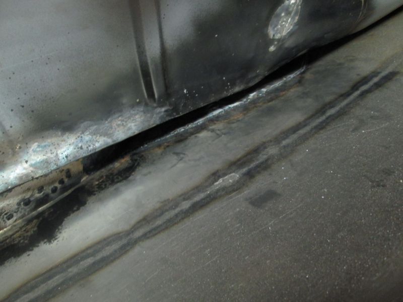

                      keeping with that "belt line" of progress I turned to stitching up this lower apron joint.
                      After removing that strip of excess out along here so an exhaust system would clear (thanks again Jack) set both of these pieces rolling in as they met too. After welding some picking and filing was required to get this contour back as well.

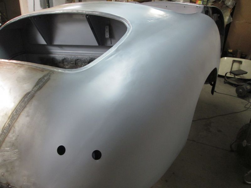

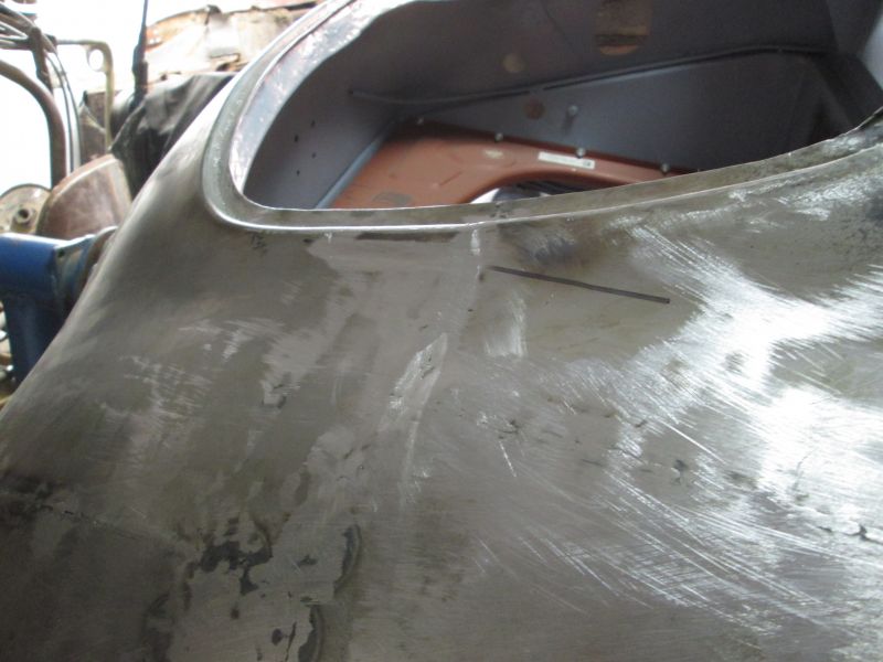

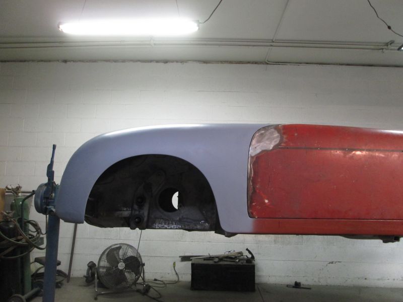

                      • 8/4/17
                        Right rear fender joint continued.

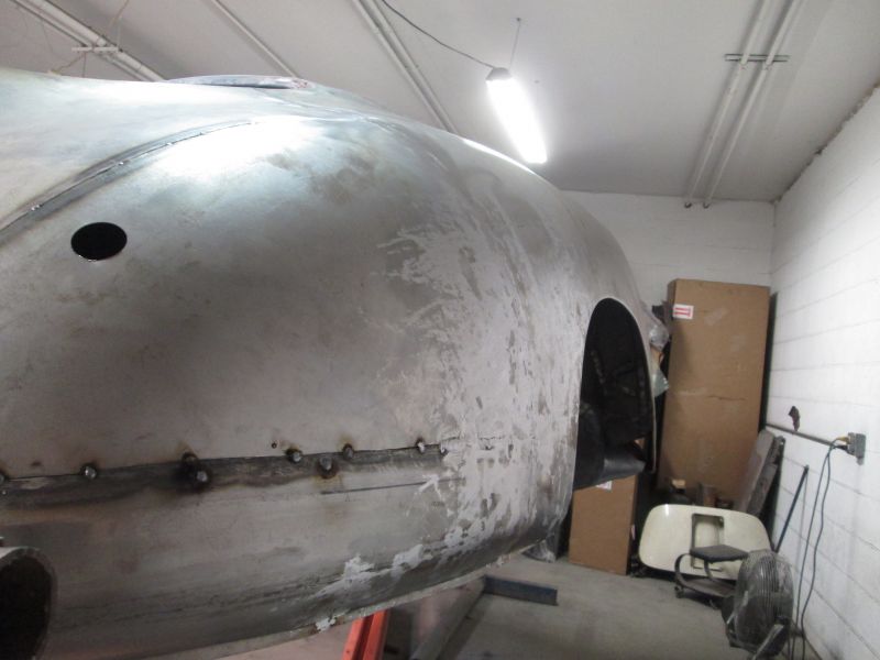

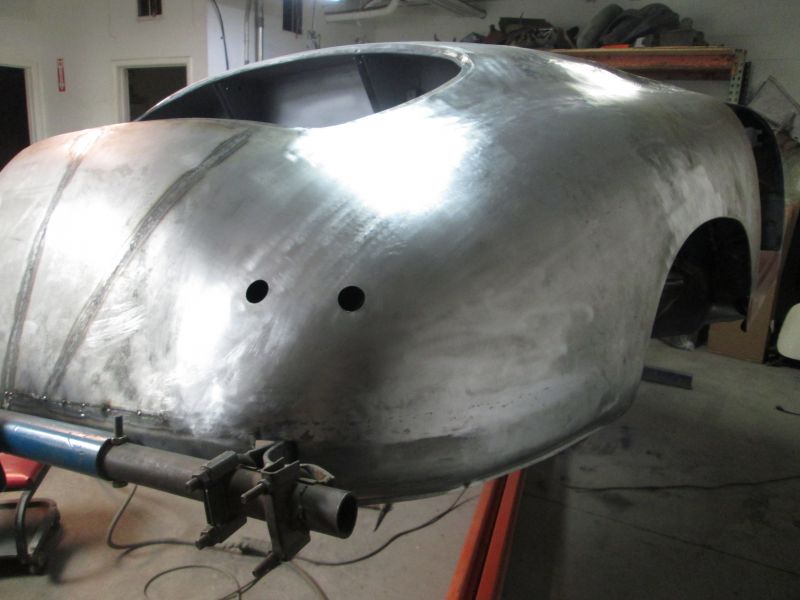

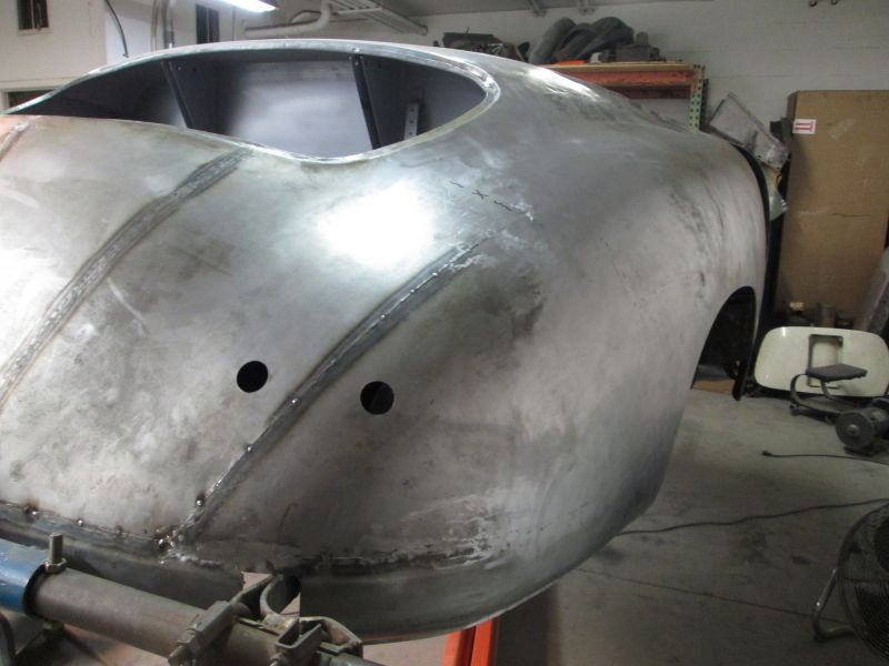

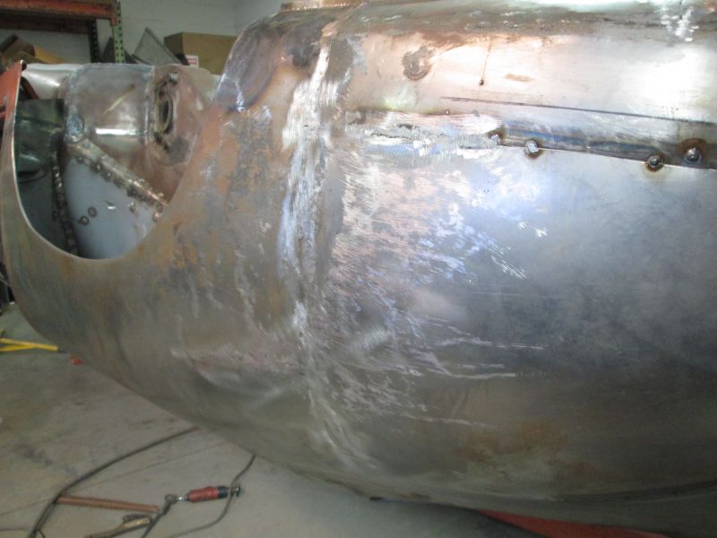

                        The next section of this joint fought a lot more so several rounds of torch heat was needed to get the area to come up.
                        Before the day as out I had it out and smoothed to a level that I could live with.

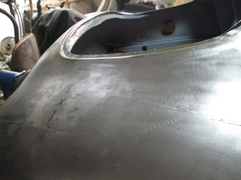

                        Not perfect but a great relief to have this correction completed.
                        I will bring up that low spot highlighted by the X once I get the joint between the tail lights stitched back up.

                        Stitching the tail light joint next.
                        • 8/5/17
                          Right rear fender finishing completed.
                          Tail light joint restitched and dressed. Ready to begin picking and filing it, the lower apron joint and that highlighted low spot above it all.
                          Lower apron joint went surprisingly well.
                          Picking and filing this run now.
                          Right rear fender chased down about as far as I can.
                          subtle irregularities remain...
                          At a minimum a consistent general contoured shape is there.
                          A smooth transitional shape from fender to tail was my main concern.
                          Began prepping the entire surface for a quick sealer coat.
                          Interesting planishing marks from Trevor's power hammer that my block pick up.
                          That cowl joint is a lot rougher than I would like but time and access to the back are very limited. I may take another stab at it once I've got the left rear fender to this level. Ready for a coat of epoxy.
                          • [quote]
                            The next section of this joint fought a lot more so several rounds of torch heat was needed to get the area to come up.[/quote
                            looking good justin
                            not that you need advice or guidance but applying heat will make the metal want to shrink during its cooling. best to stretch it with a dolly behind and a flat hammer or flipper. preaching to the choir i know but sometimes when your up to your proverbial's in a job it's easy to over look things. having said that stretching while the metal is softer during heating is easier than working it cold, but it will still shrink during cooling.
                            i have to ask though now this job is coming to an end, what's next? other than finishing your own car. what will you do with your time? seems selfish just to finish your own car lol.
                            great work, much respect
                            • Justin, looks great as always. Q, what tools did you use to get behind the tail light area and work it? When I repaired mine from the dreaded teardrop conversion, there was some shrinkage due to my welding. I have to get it out, but there is so little space to move around. Just wondering what tools and tricks you used. Thanks, Mark
                              • Hey Neil, Thank you so much! No, I'm always open to some guidance and or advice. I certainly don't claim to know everything about metal work in fact quite the opposite; I see what you're up to and think man I'm a hack.
                                I just grind through with what little tools and experience I have at the moment to some how get the job done and with a final presentation I can live with. Always looking to improve of course but some of these lessons are hard won and take a while to sink in. At least for me. As for the heating I'm doing, I guess I should have explained better, the low and flat spots I was dealing with at the tail skin joint where pretty bad.
                                I initially tried working it cold using a trick I learned watching my buddy Jason Bobruk by which you're using the dolly from underneath as the hammer to make the "big moves" upward for the stretch. After several swings it was raising but was still very low and getting lumpier. So out of pure necessity I thought about heating the general area BTW not the concentrated dime size cherry spots for gathering material but more of a soft general heat to the problem so it would raise like bread dough. With the area warm I can tap it a lot lighter and finesse it up with much more measured control versus brutally beating it out, not to mention it was so much easier on me. Sure it does shrink up a bit when cooling but if its still low I'll try and bring it out the rest of the way cold or repeat with heat if necessary. I use it sparingly and mostly when I feel likes its getting nowhere's fast. Now who's preaching to the choir?

                                As for what's next besides my own projects it is this '59 S/R coupe. My buddy has been waiting...and waiting for me to complete this coupster so I can help him out with the steel work on his car. Now that I'm so close I'm really feeling the pressure to get going on it which is motivating me to make the final push on this current project and get it off to the body shop. I've started a build thread on it: http://www.abcgt.com/forum/14-356-Restoration-Projects/38672-1959-356A-SR-coupe-project-chassis--108625.html
                                And will give a detailed chronicle about its progress the same way I did here.

                                Mark, I used this dolly get down between the cross-member and the tail skin.
                                Its all I really had and fortunately for me it slipped in between. Sorry, I can't offer any tricks to making it easier because as you guys know very well, it never is; you just have to keep attacking it until you have what you want. One thing I will say about limited rear access like this is to always try and plan for outward heat warp so you'll have a fighting chance at a uniform finish. If you have to spoon it out and up with some sort of a lever its not going to be very pretty. That right cowl joint is the perfect example.
                                Thanks again you guys, it is always greatly appreciated!
                                Quick sealer coat
                                Adding this top coat really high lighted a few more flaws.
                                Again went a bit too strong on that contour line next to the lid but as you can see it does continue that line that runs the length of the fender. Didn't quite get the shoulder knocked off the tail joint.
                                Some light taps with my ball peen hammer softened it really quick.
                                The cowl joint area is a lot rough than I'd like. If I have time I'll chase it some more.
                                Though rough the fundamental contoured shape is there as this shadowed shot highlights so it keeps me calm.
                                Not perfect but well within striking distance. Time to move on.
                                Stitched up the entire lower apron run on my way toward the left rear quarter panel/tail skin joint. That up next.
