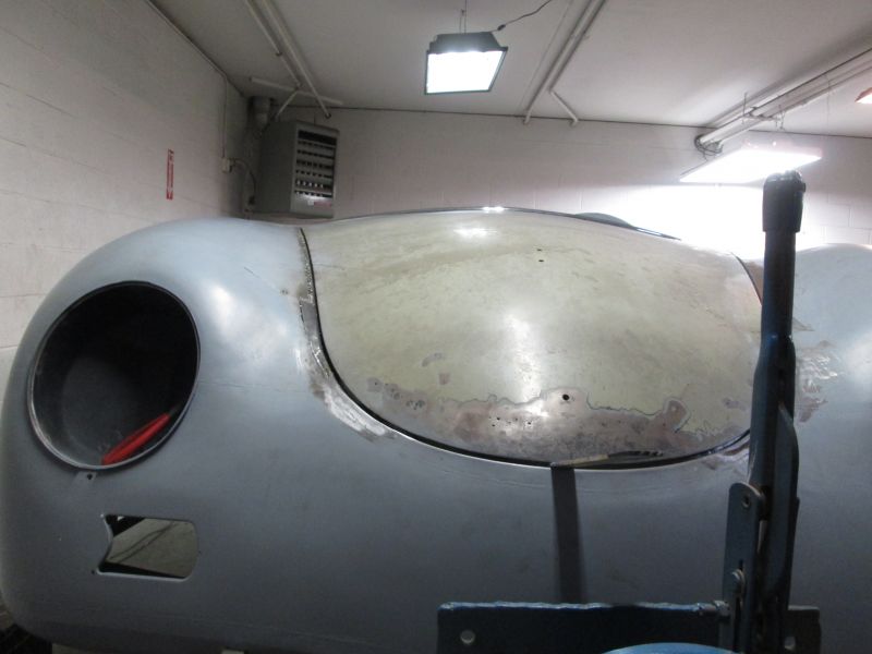

  • Justin, here's a photo of a C coupe that I just put a Trevor nose on. How do you like this lovely starting gap?
    You could drive a speedster through the passenger side gap! But in the end it came out good. Only 9000 hours of tapping, banging, filing, leading, tapping some more.....banging some more, etc....But you know all about that of course.
    DG
    • I just don't know how you both manage to get the gaps correct however many hours it takes. Truly amazes me every time I look to see the advances. How you corrected the bonnet lid to get the gap correct on the passenger side I can't get my head round.
      I presume? you had to cut the wing section and add metal, then lead it? Difficult beyond words probably.
      • Thanks David! That's pretty wide but I guess that must fit around Trevor's sample hood? On an issue like that its been tempting just to add onto the edge of the hood versus cutting into all that complex trough work as you accurately state does not lend itself to moving very much but on a gap that wide you really have no choice but to cut and rebuild to suit it as you know too well.
        Roy, all these alterations come purely out of necessity and sometimes require a bit rethink until I can get my own head around it.

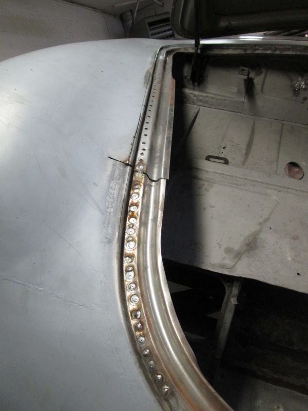

        Last of the left side trough and gap work.
        Finally settled on sectioning this area this way to get it all to move over where needed. I of course jumped the gun and previously plug welded too far into this turn as a lot more of it needs to swing wider. At this point my easiest answer was to cut the loose section off reposition out where needed. All welded in here.

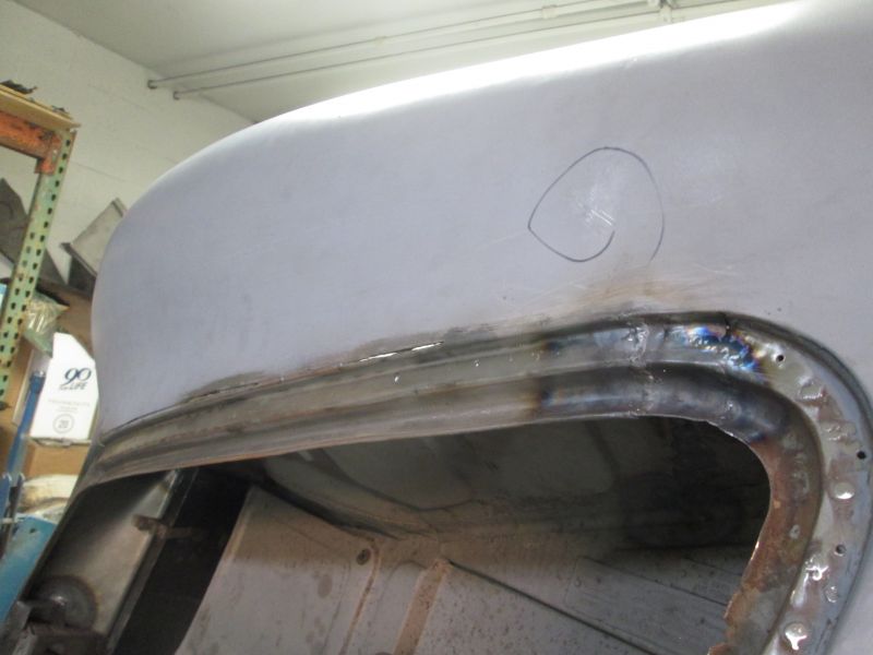

        Below that I had to cut the shoulder free from the previously plug welded mating surface move it out then just back fill that newly created gap where it had been. A bit messed up but this is what I created for myself. Now the trough is free to be moved into alignment; about a quarter inch or so.

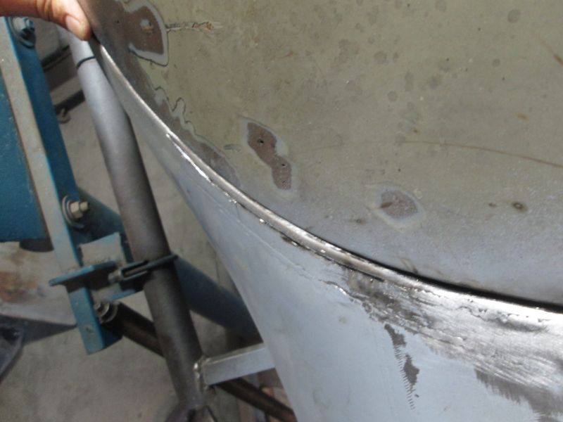

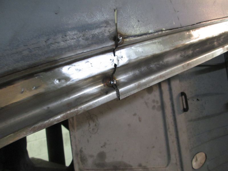

        Had to extend the relief cut at the trough down a few more inches at the bend to break its back and allow for a gentle swing into alignment. A few rounds of torch heat and my dead blow hammer began taking it in the needed direction.

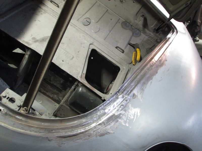

        While the trough now aligned at the ends you can see that the approach angle below the joint is still too straight and needs more curve sweep added in. Before I could do that the end of the trough had to be secured first so I went ahead and welded it up.

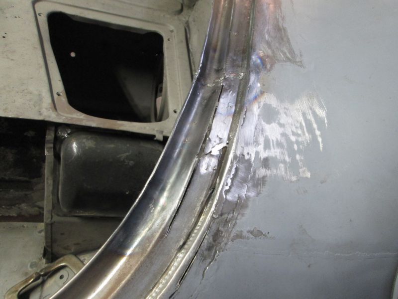

        Gas welded seam finished and replicates what was left by the factory. The remaining relief gap here allows for that contoured sweep I need. A few more rounds of hammer and heat next.

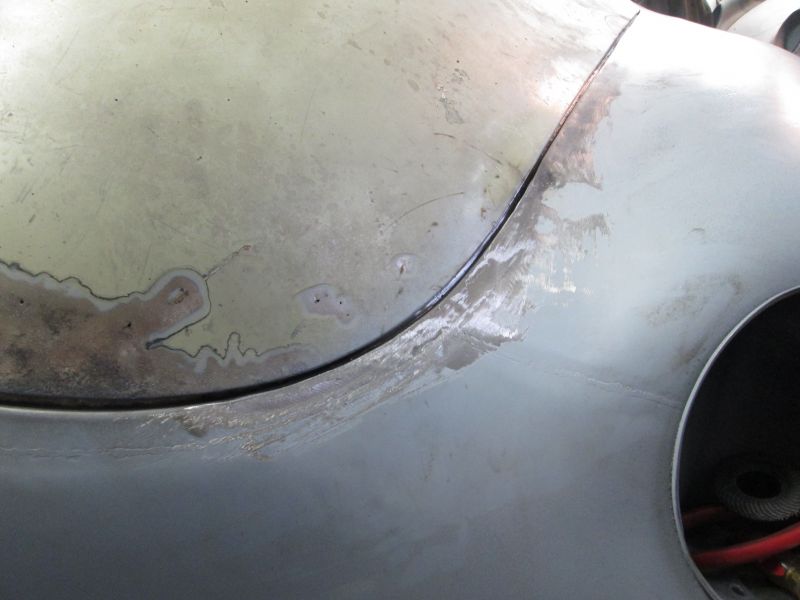

        Dropped the hood for a test. I swept the upper corner transition a touch too wide but a mill or two of lead will correct that. Marked out the rest of the relief cut needed to get the rest of the gap opening I need.

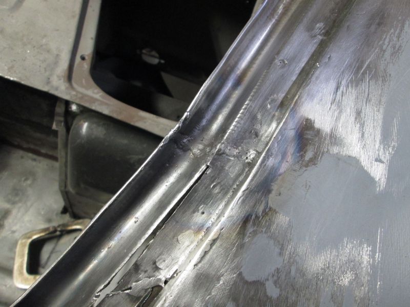

        • Part 2
          Left side gap and trough finished!

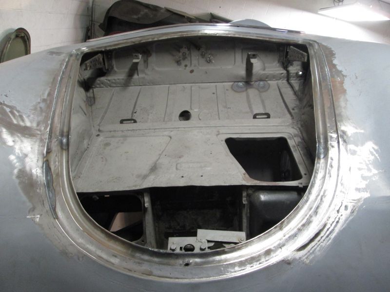

          Entire run shaped and finished. This thing was a Mother-f'er; just in case my last post didn't make that quite clear.
          I think subconsciously I knew what I was in for which is why I had to step away and finish the rest of the body first before I could mentally deal with this.
          Everything at a level I can live with.
          Have some welding slag on the underside to clean up
          but nothing too heinous.

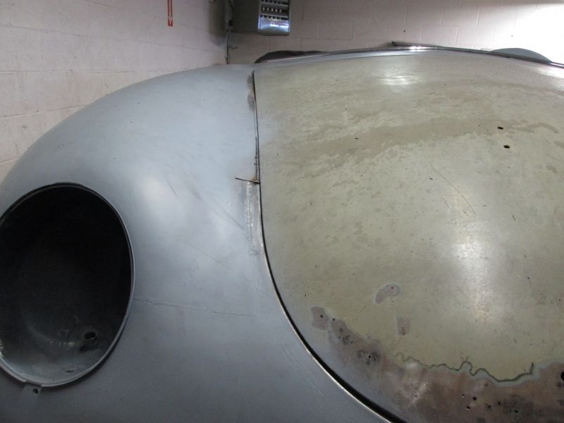

          Final gap. Swung it just a touch wide on the upper transition but the photo makes look worse than it actually is.
          It'll need filler but not too much. Anyway....I'm done here!

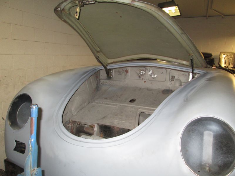

          Have some work to do but its all lined up here on this side so much to my great relief I've tackled the hardest side to deal with first.
          Working on this final body related adjustment next.
          Thanks for reading through all of this!

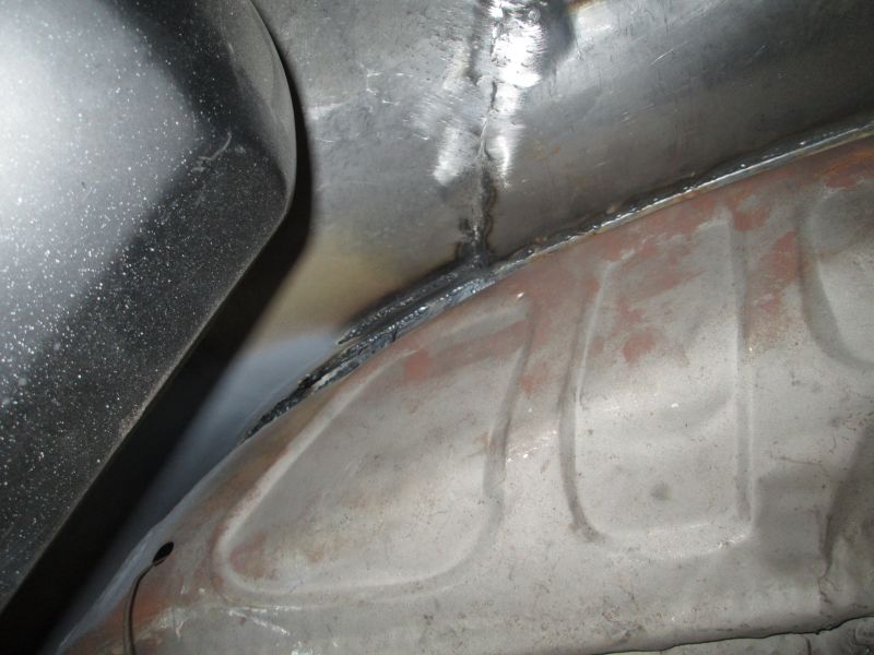

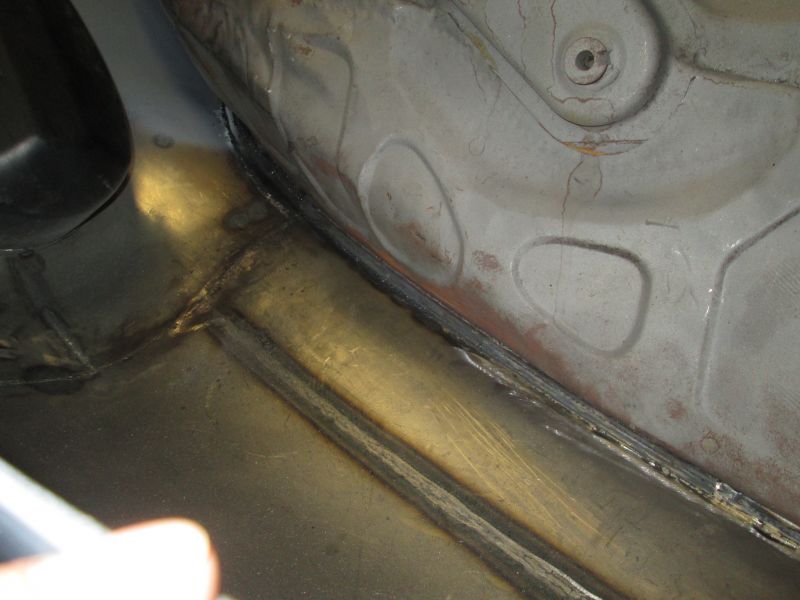

              9/5/17
              Right trough

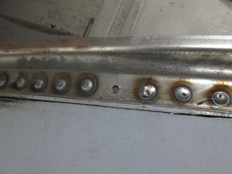

              Had to take a shot of my official final plug weld on this car! When I think back to just how many plug welds have been laid down on this entire car... I thought I'd never see the last one but here it finally came.
              A great luxury having with these two ends line up without any fuss. Tacked up nicely.
              Plug weld run dressed smooth and inner lip folded over tight.

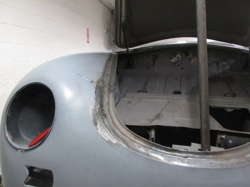

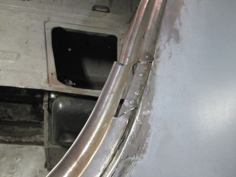

              Finished the session with the gas weld detail at the rear corner here. Just a few small things left to address then its onto the lateral hood gap.

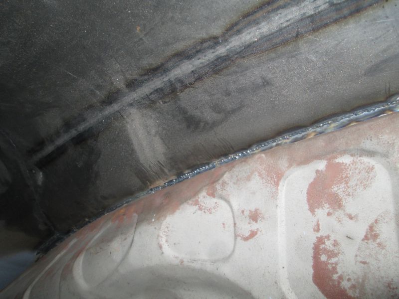

              • 9/21/17
                Right trough run finally stitched up.
                Though I didn't have the misalignment issues of the left side, this opposite side still proved to be just as miserable and time consuming to finish out.
                All tacked up with basic gap now open.
                Not perfect like the other side but a little lead solder will clean up all the short comings pretty quickly. paint stick at the bottom roughly represents space for the thickness of the eventual trunk seal.
                Now the slow process of stitching it all up.

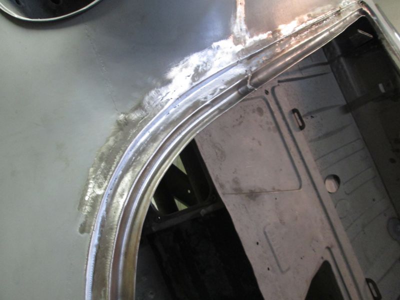

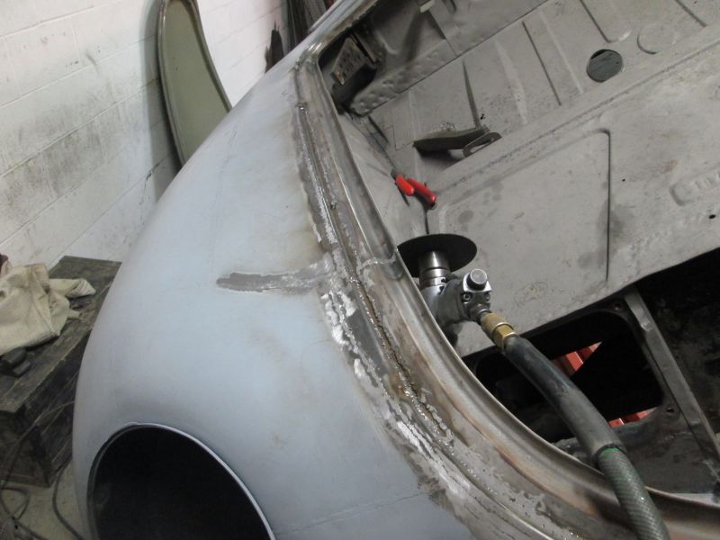

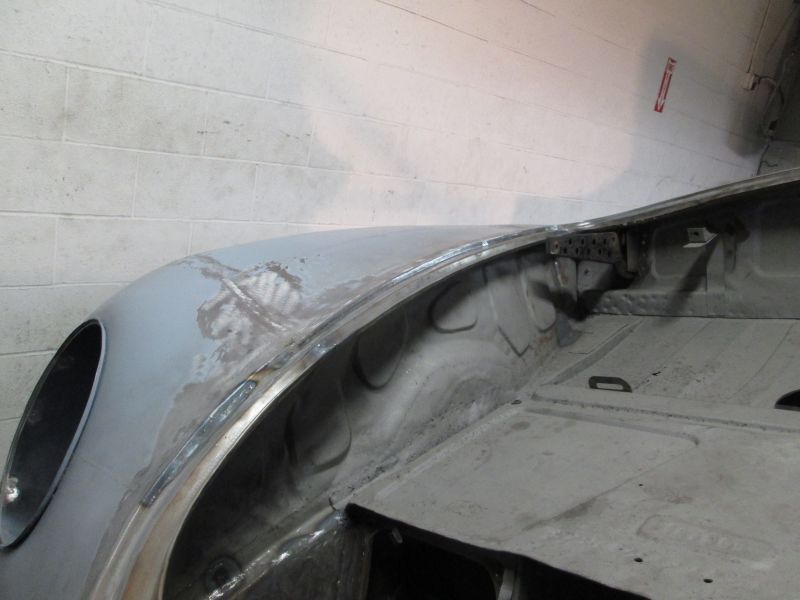

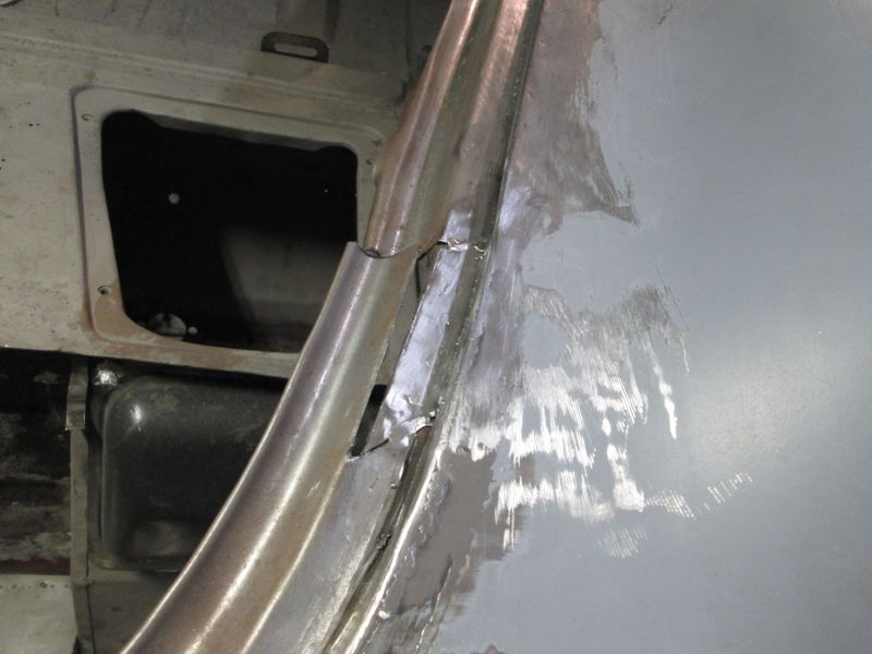

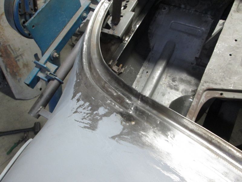

                Once it was all welded up I had the great pleasure of grinding and shaping those long runs down. For the past few weeks my shop visits sucked pretty bad. I was too depressed to even bring it up here until tonight.
                Little bites... needed to grind and final shape small sections of this run at a time to be able to slog forward on it.

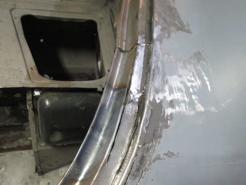

                I eventually ran out of weld to grind.

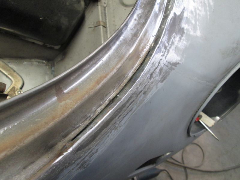

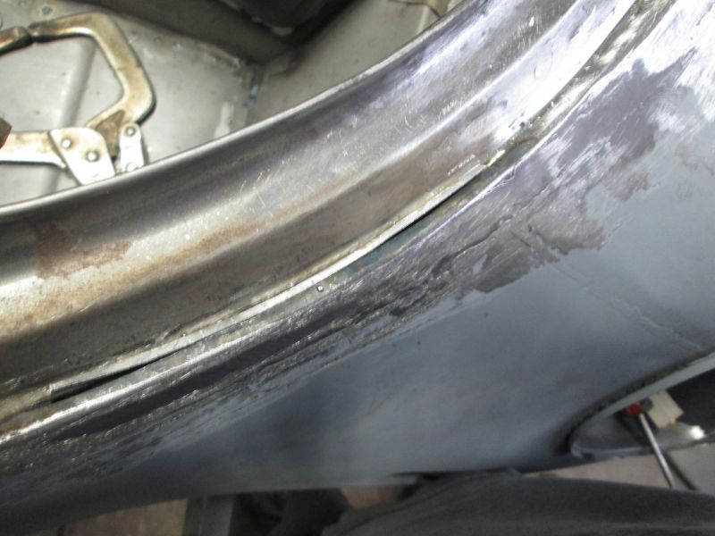

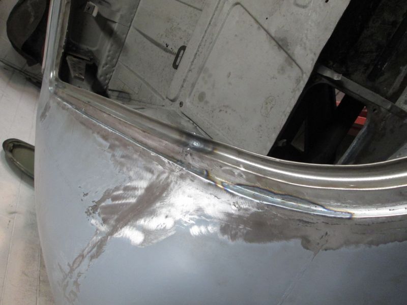

                Dressed the slag on the underside as best as I could but the shoulder shielded a lot of it and I just could not reach it with my grinder. Nothing major, just not as tidy as I would prefer.
                a bit of weld scar and divots here and there remain but its as far as I dare chase it to keep from thinning this area too much.

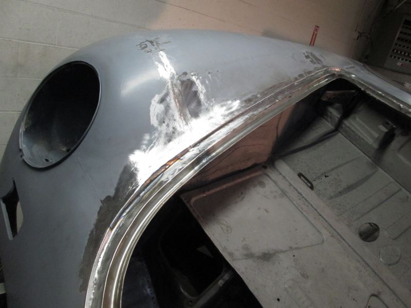

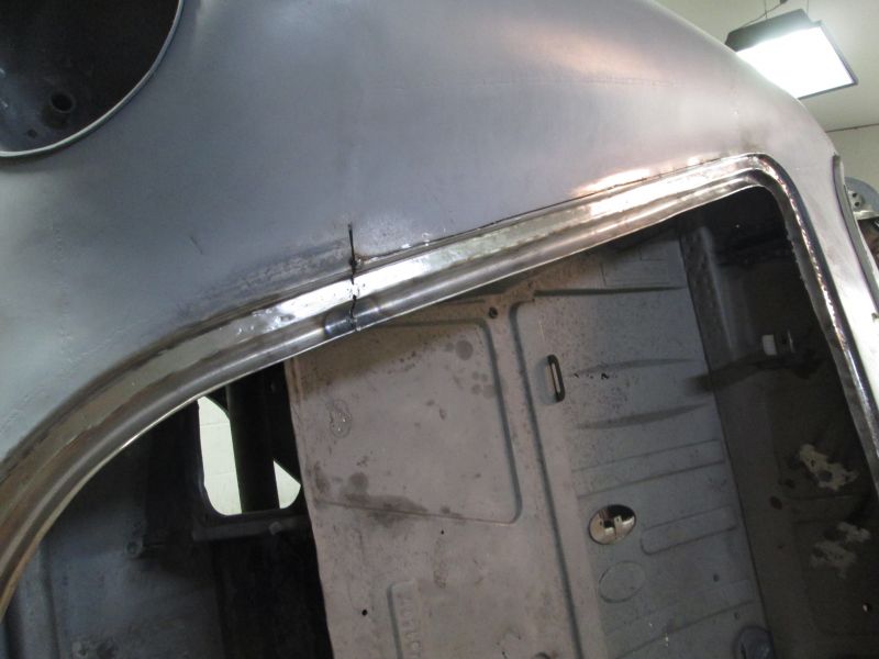

                One valuable lesson I did learn here is not to commit and begin welding too soon. Its too painful to correct after the fact especially when all your talking about is a MM or two.

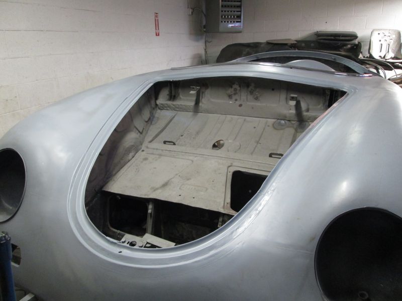

                Its a good fundamental shape I can live with.
                This officially completes my duties of welding on this body!! I have some small chores to do on the closing panels yet but for all intense purposes I'm done.
                area behind a coat of epoxy to close this chapter.

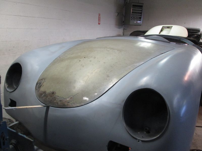

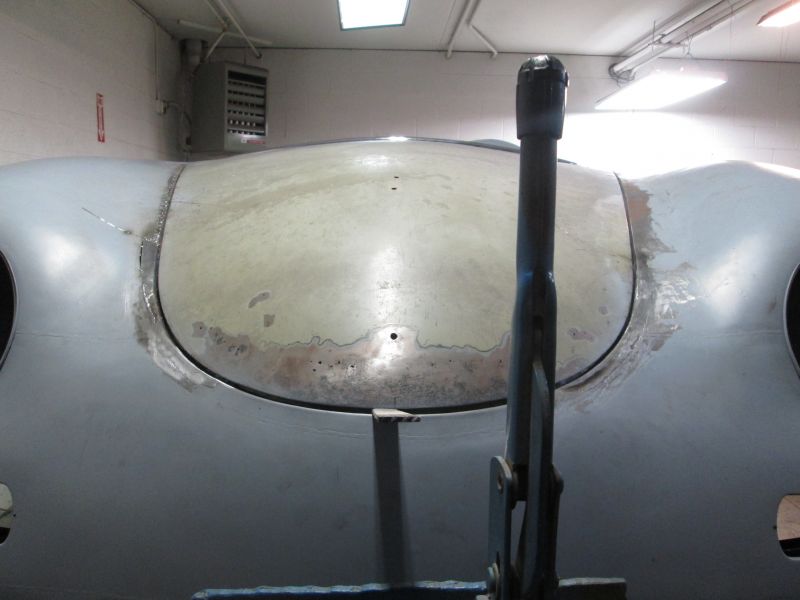

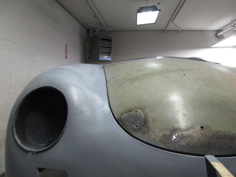

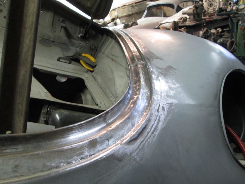

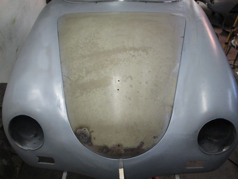

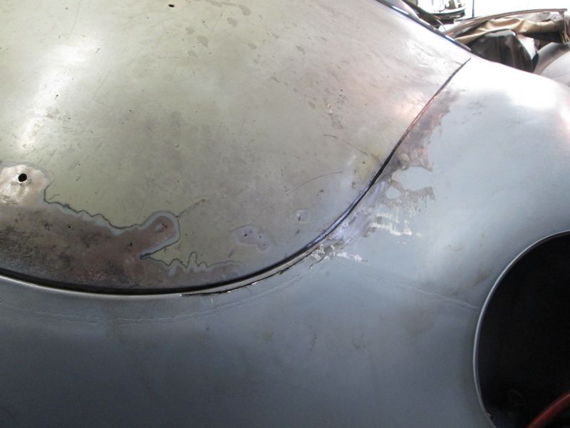

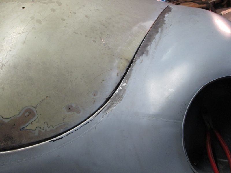

                Hood remounted to see what I eventually ended up with.

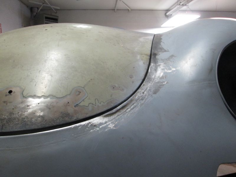

                This corner swung a little wide too so some lead will be needed to perfect that gap.

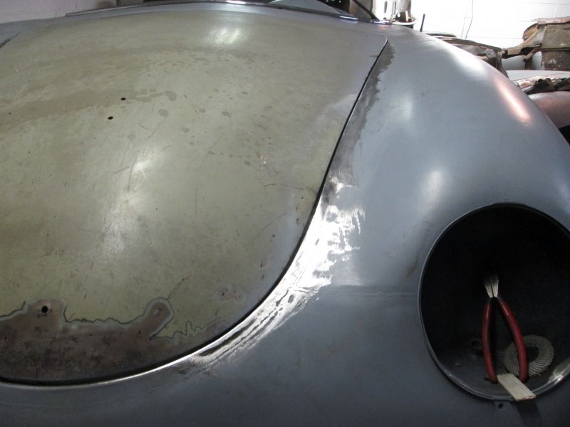

                but its as far as I can chase it.
                Like the rest of the body it will need a little more love and some filler to be perfect but not a ton of it.
                I'm just relieved that the back of these fenders spill into the hood contour as close as they do. I had serious doubts when I began fitting them. Anyway, onto filling those rust holes in the front of this hood next. The serious heavy lifting is done.

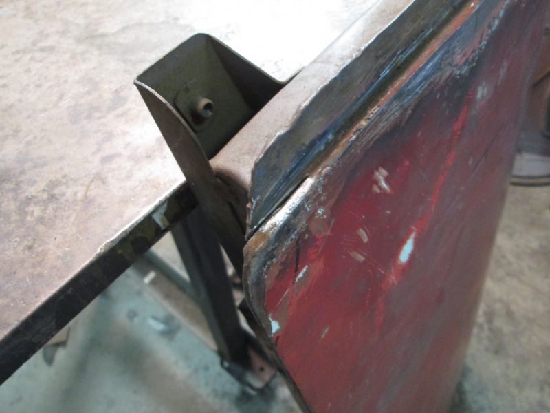

                        Welding up slight modifications that had to be made like this relief slice as this corner was hanging out just a touch too far past the rocker.

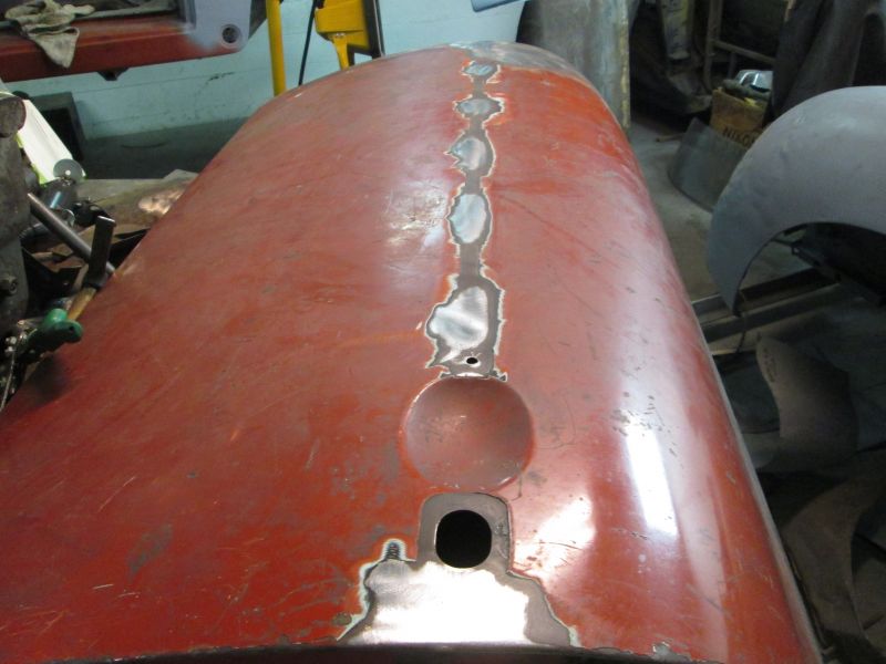

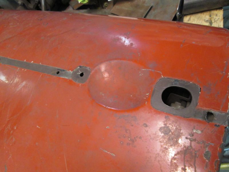

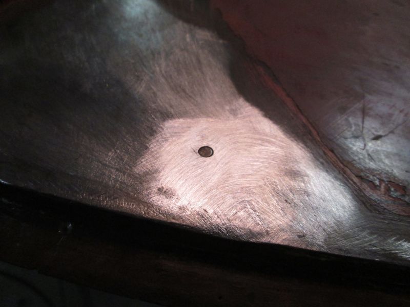

                        Spear hole filling. This an NOS door once upon a time as it has no VIN ID so it was never fitted to a car by the factory. The side spear holes where drilled by someone and are too low. The spear should come right off the center of the handle, not below it.
                        Knockouts from my hole puncher made for perfect fillers.
                        Done with the loose ends here. Now the body shop is free to reset the spears across the car as whole. Onto the next the next item on my to do list which is getting very short.

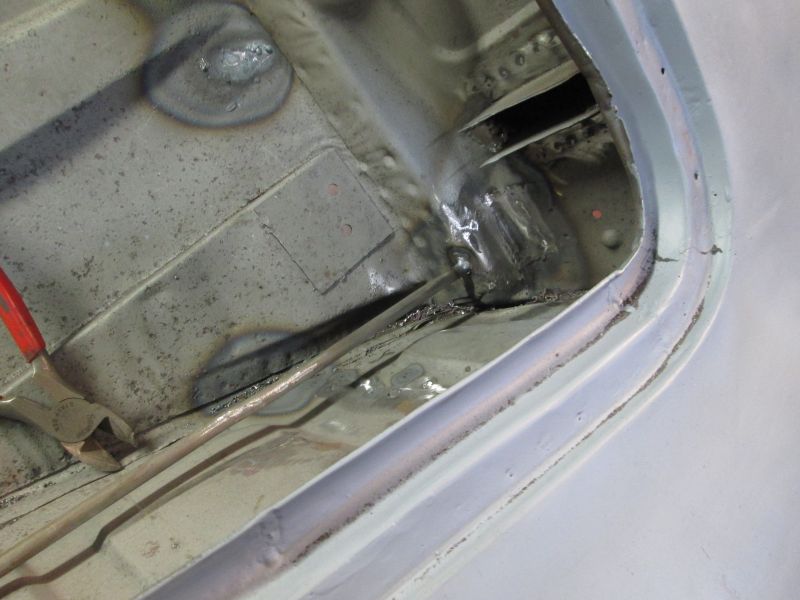

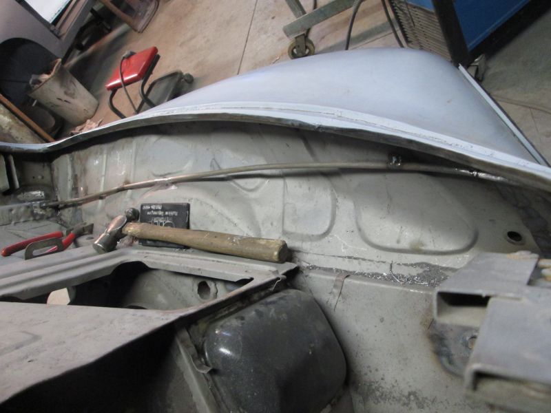

                          Trunk release conduit.

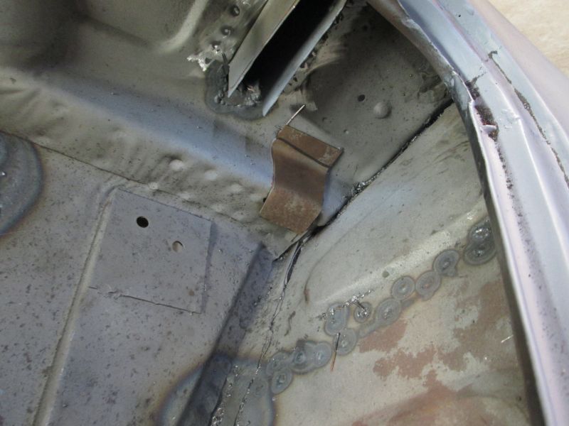

                          Just realized I hadn't reinastalled the trunk release tube. I swear one of these days I'm actually going to be done welding on this thing.

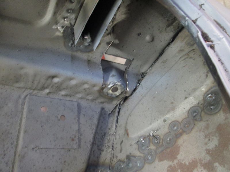

                          Before the tube could be installed I had another T2 detail to convert to T1. This arched relief for a trunk lock option needed to go.
                          Easy conversion as just a flat plate is needed. Toughest part was working down in that corner.
                          All welded up with conduit installed and directly welded to it as my T1 Reference car shows.
                          Done One more thing off the final checklist.

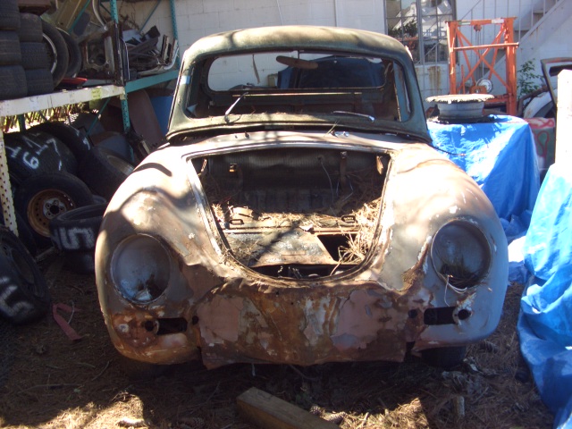

                              Here's a blast from the past I got from Rusty Tubs:
                              Here's this donor just before it went to the media blaster. That old truck cab clip might be a tempting build.
                              Later without Truck cab roof...
