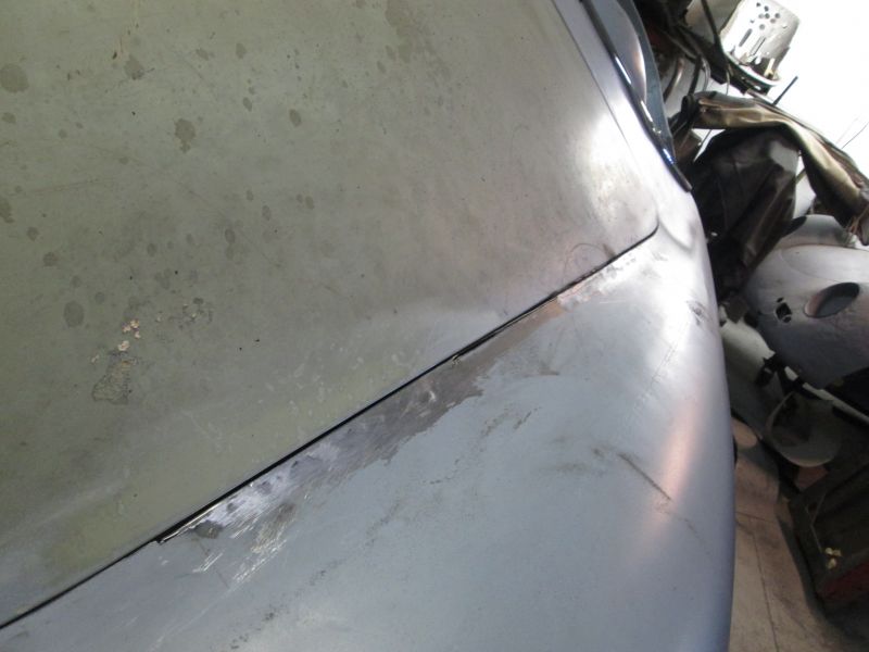

      I had the "180" rule. If the raw (good) bodywork passing along to a painter required anything more coarse than 180, then the bodymen couldn't point to the painters as wussies or prima-donnas. (If the bodymen took it to any primer, they had to finish with 180 grit or finer.) If the painters got the car in 180, they could only point fingers if real issues were found in the bodywork that required re-work.....however, the painter was the last QC and responsible for the ultimate smooth paint work, no matter what.
      The actual painting is "about 4 hours of fun" after masking and cleaning the primer base. Guys would fight over who got to do the painting! I did my share. I was thrilled to see a 356 2 weeks ago that I painted in 1979! Faded but it sure made me feel good! RM acrylic enamel with a DRX additive that allowed sanding and polishing not that long after the squirt.

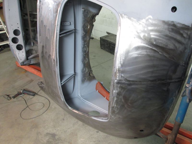

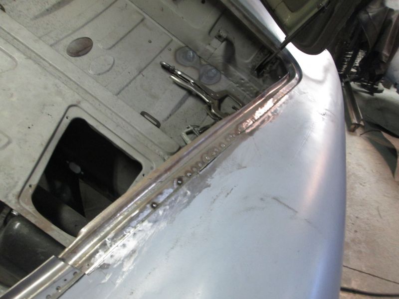

          Welded up the last stretch of the apron and ready to begin some planishing.
          Like the right side working from the bottom upward.
          This area went just a bit easier than the right side did.

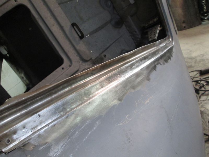

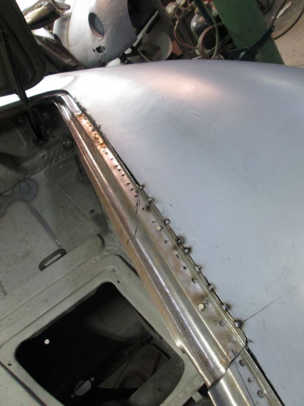

          Tail light and cowl joint all stitched and dressed here. Smoothing out this next section of the fender joint now.

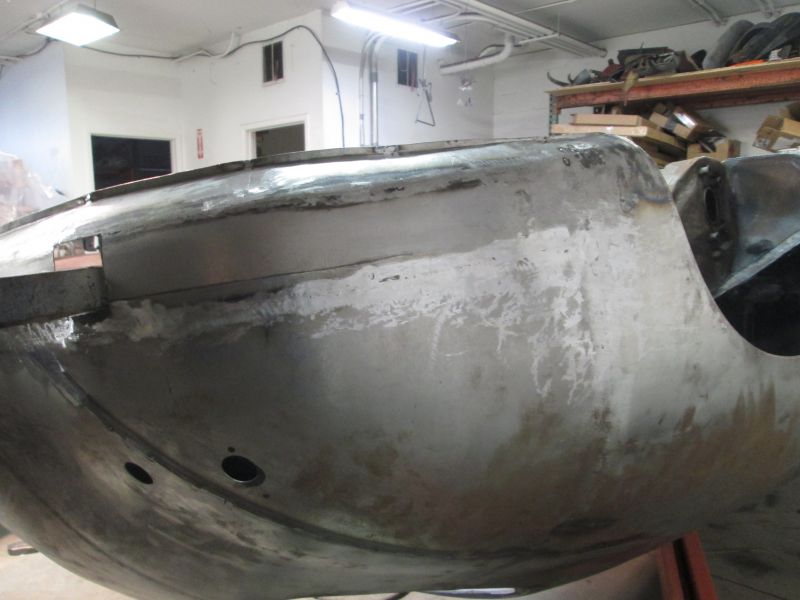

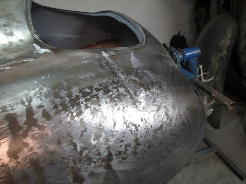

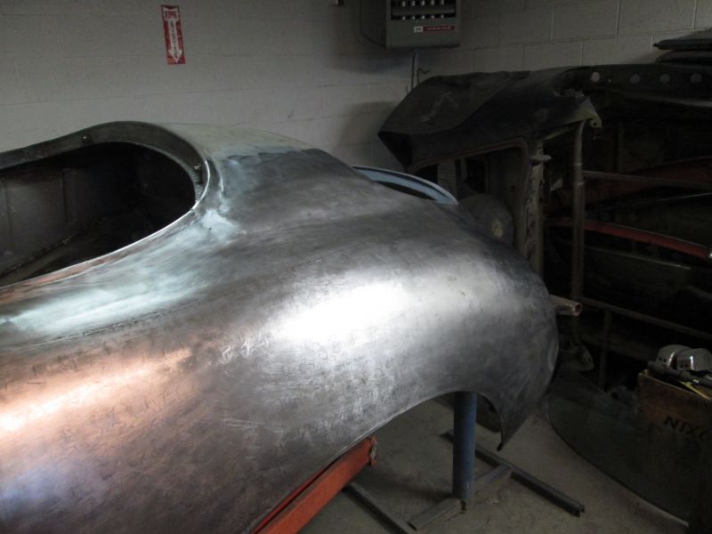

          • 8/17/17

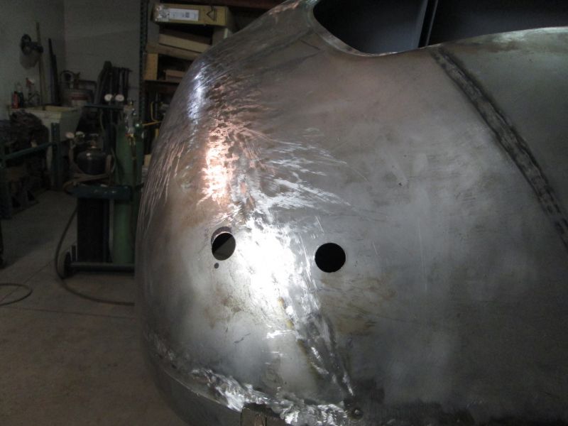

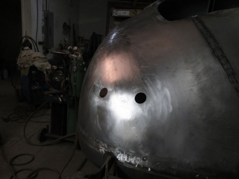

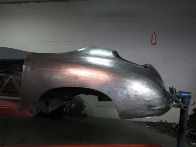

            Left rear fender joint almost finished.
            I saved the worst for last as the shape contours at this junction where most inconsistent from tail to fender. I put several relief cuts in the fender to tone down the curve and bring it more in line with the tail section but I ended up creating some knarly flat spots in the process. Its been a process of reversing what I've done just enough to create a consistent line through the entire run. Its been hard to stick with for sure but as of this entry Its getting very close.

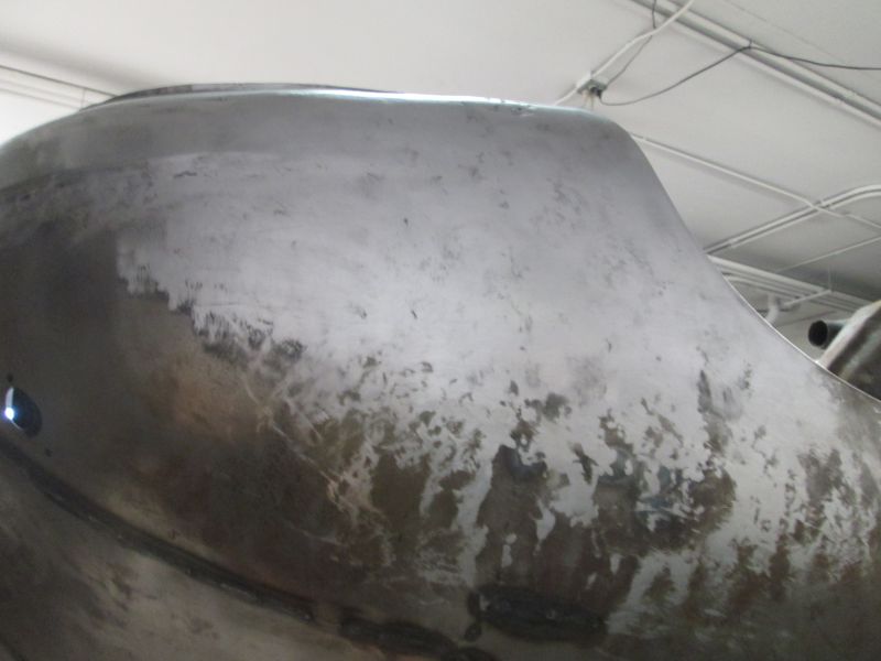

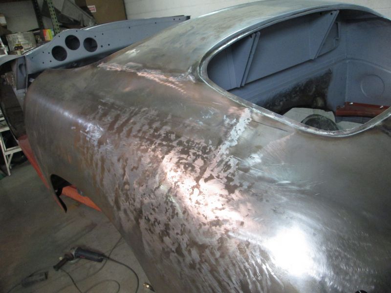

            Top profile was really on the flat side in and around the weld joint area. Began beating that profile upward while making my toward the lid opening where I had to recut a small section and add in that relief profile that continues on from the fender which is highlighted by the marker line.
            after several rounds of beating the flatness was slowly giving way to a promising curve on that top profile of panel transitioning off to the tail.

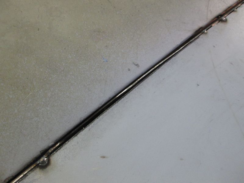

            Fine finished the surface
            and ready for some sealer. Again not perfect but close enough.

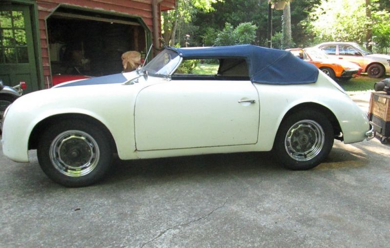

              • Thanks once again for the nice words Roy, Appreciated! I think we talked about that subject a while back; I didn't estimate or quote on this project, I refused to. Mainly because I had no idea what I was actually getting myself into as this was my very first time dealing with a car/donor this rusty and also my first full rebody. I've had plenty of experience working on my own 356's over the years but they are desert cars. The time I have spent on them opened my eyes clearly as to just how difficult it can be to build and repair these cars correctly and/or to a level that I'm going to be able to live with. I also watched my buddy here in town (who restores 356's)through the years bidding and taking on jobs only to stop by and find him having a major melt down (throwing his tools across the shop) half-way through the job because it was going sideways for some reason. He go, " awe fuck Justin, I didn't charge enough, I'm lucky if I'm averaging 10 bucks an hour on this EFFEN- job!" I remember this happening on every one of his cars. I used to leave there thinking "man, I love my job, I never want to be put in that position. So when is project came around I made sure that I didn't. I was clear with the Doc at the beginning, this is not my day job and the work would be performed during my free time and since it is my free time if I spend an hour working on it then I want to be taken care of for that hour. Time on this car means time away on my projects. His safety valve was and is that he is always at liberty to pull the plug at anytime and for any reason. Just settle up and come and get your car. Professional repair shops certainly can't operate like this as they usually must quote and work within a budget. They're also motivated for the job to cover shop overhead, employees etc. I'm not in the "business" so I can happily walk away.
                As you read through this saga I hope that I've been able to convey just how much I've been screwed with at almost every turn as nothing fits or goes according to plan. It fights every step of the way and You really have to claw your way through it...slowly. But what mentally allows me to chase and plow through it is that my time is covered. If I had quoted for this job I know for a fact I would have low balled it and been completely underwater. Corners would have been cut and development along with the final presentation would have suffered greatly.
                Here it is and all within my quoted budget...Enjoy your coupster Sir.

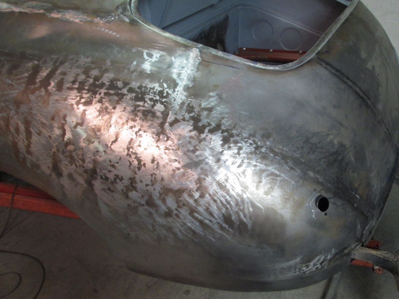

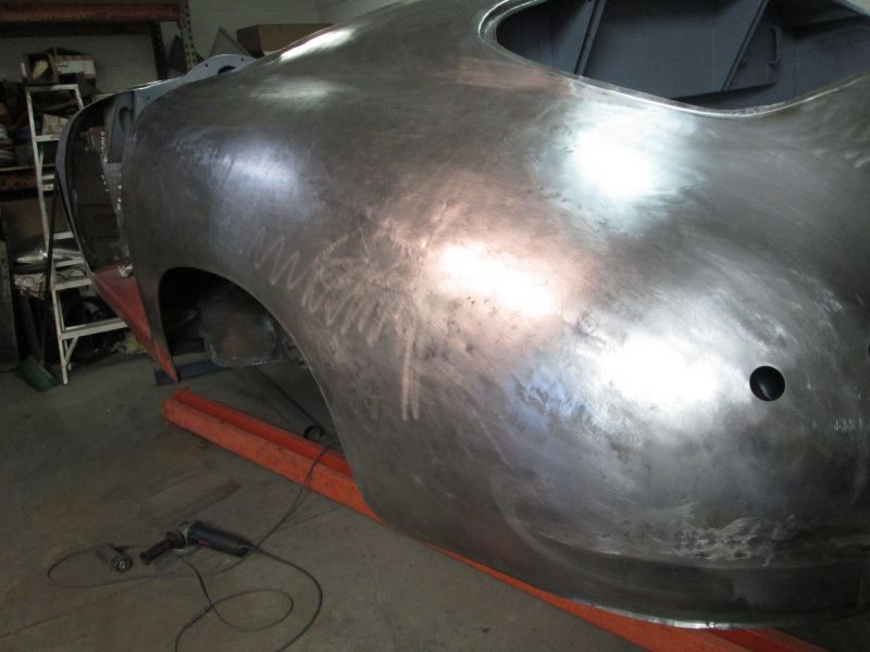

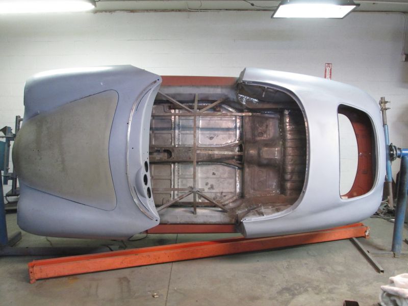

                8/21/17

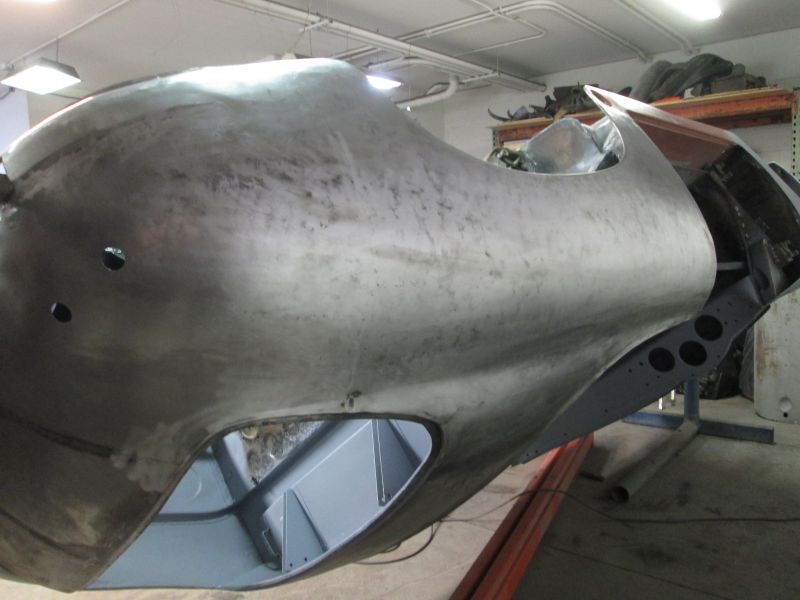

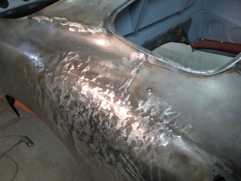

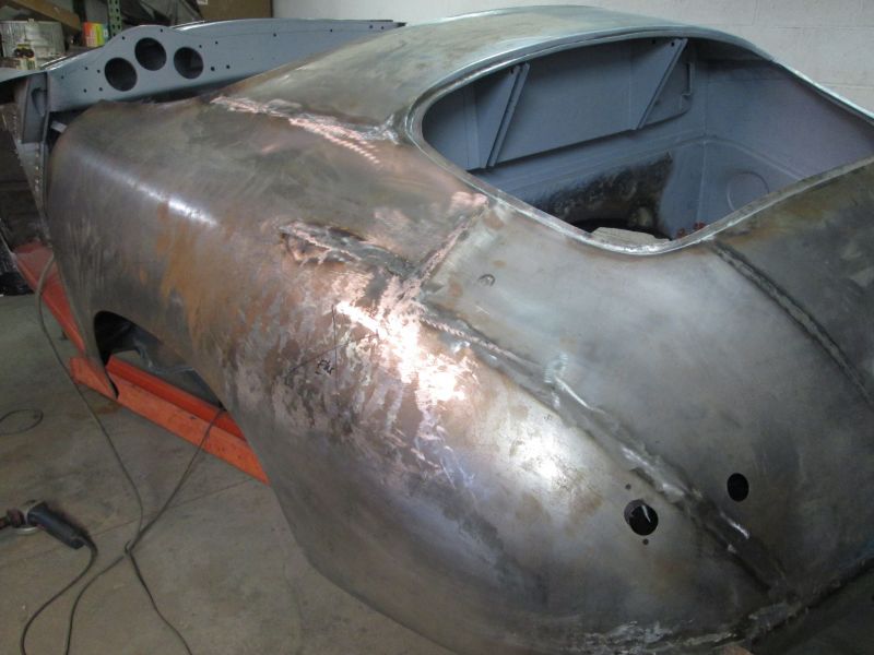

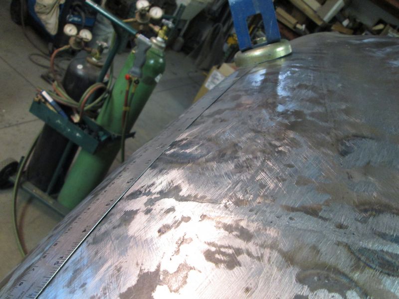

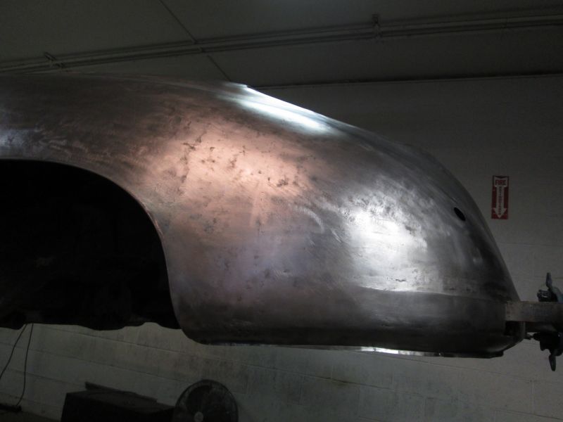

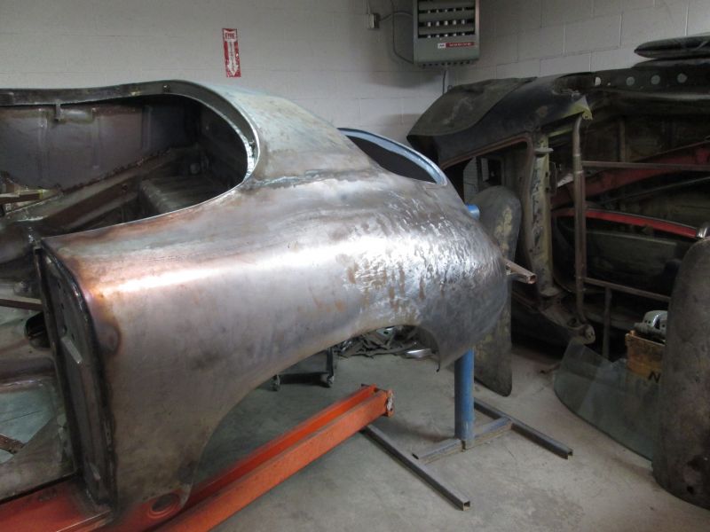

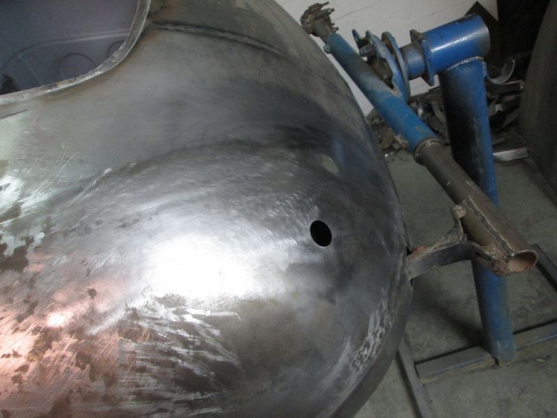

                Metal finish and shape completed on the left rear quarter. This officially ends the major steel work on the body itself.

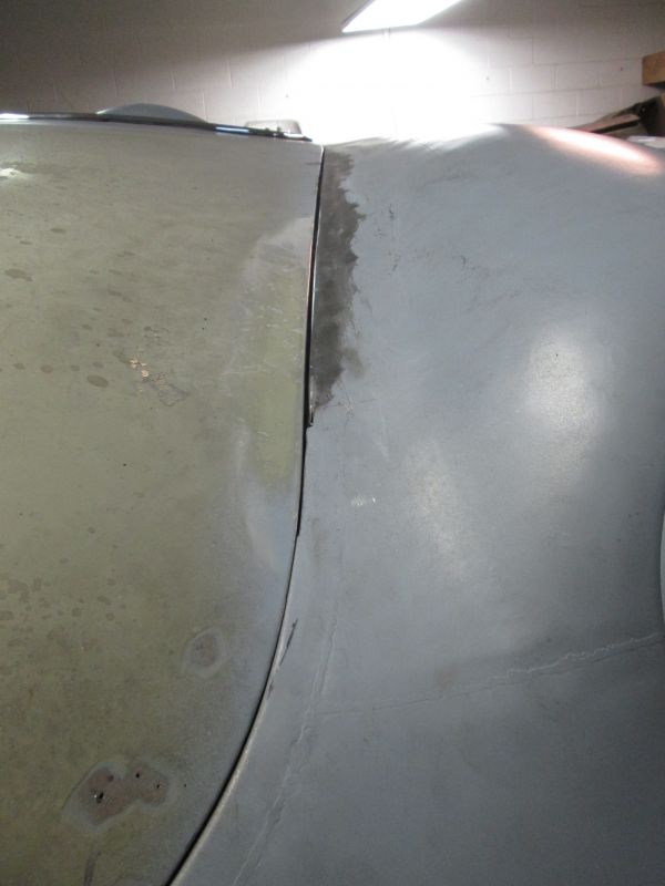

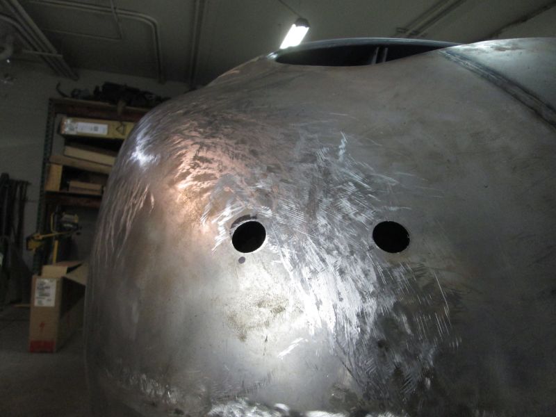

                Chased it about as far as I can given time constraints. My main concern was the transitional shape between the tail and fender and its now at a level I can live with.

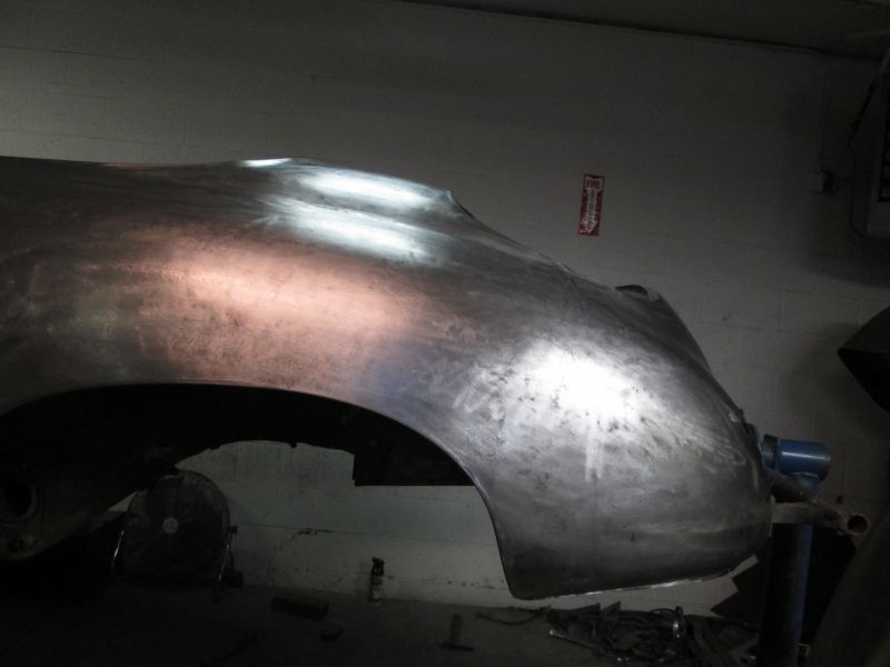

                The remaining rollers won't require even a credit cards worth of thickness to be smoothed out if the body shop decides to go straight to mud.

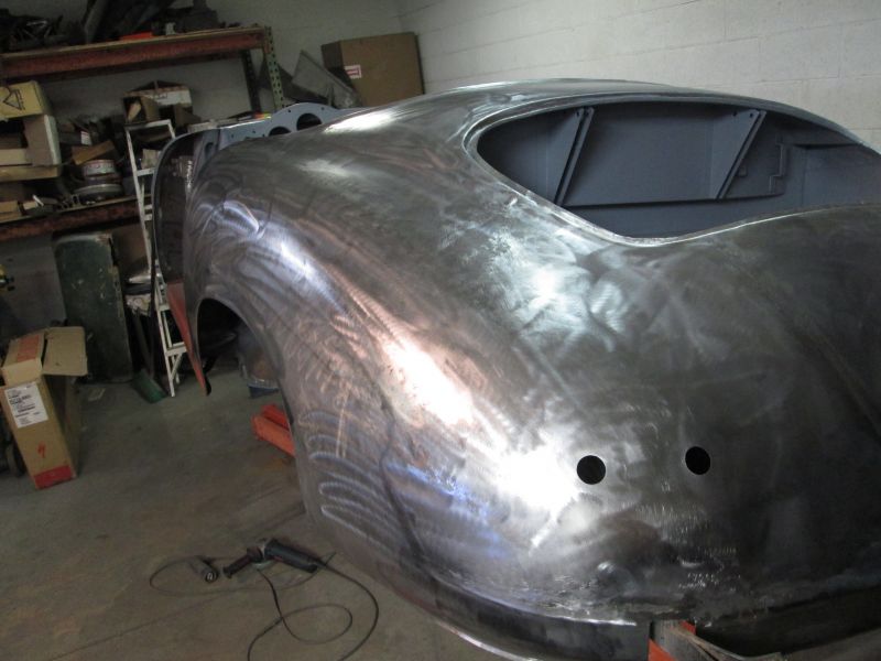

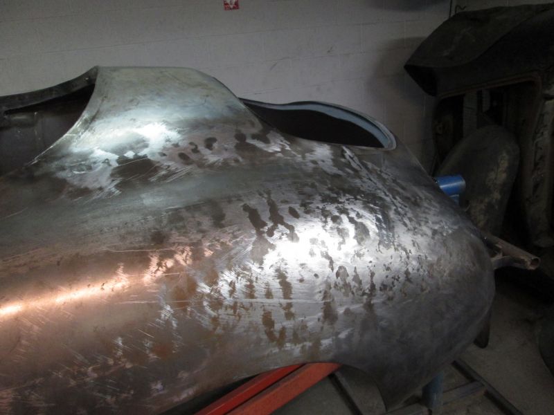

                Began cleaning up the surface in preparation for a sealer coat.

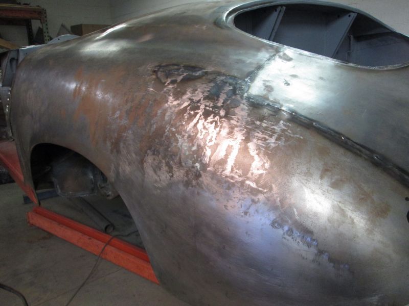

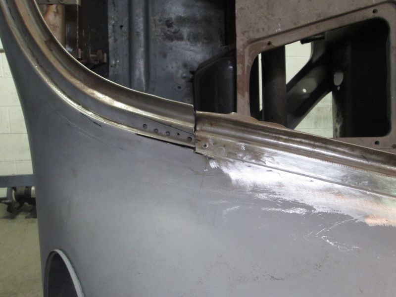

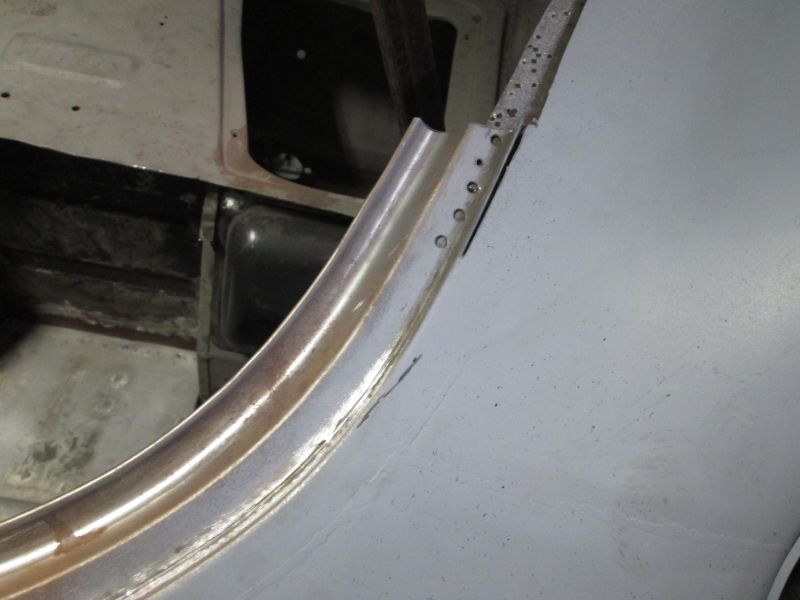

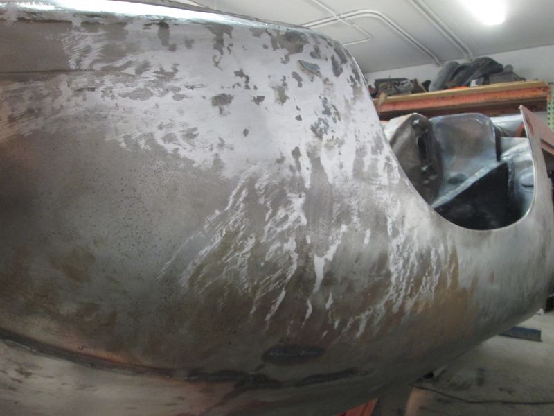

                I was actually in disbelief that this fender to tail joint cleaned up as well as it did. This area was really bad and I'm pretty limited.

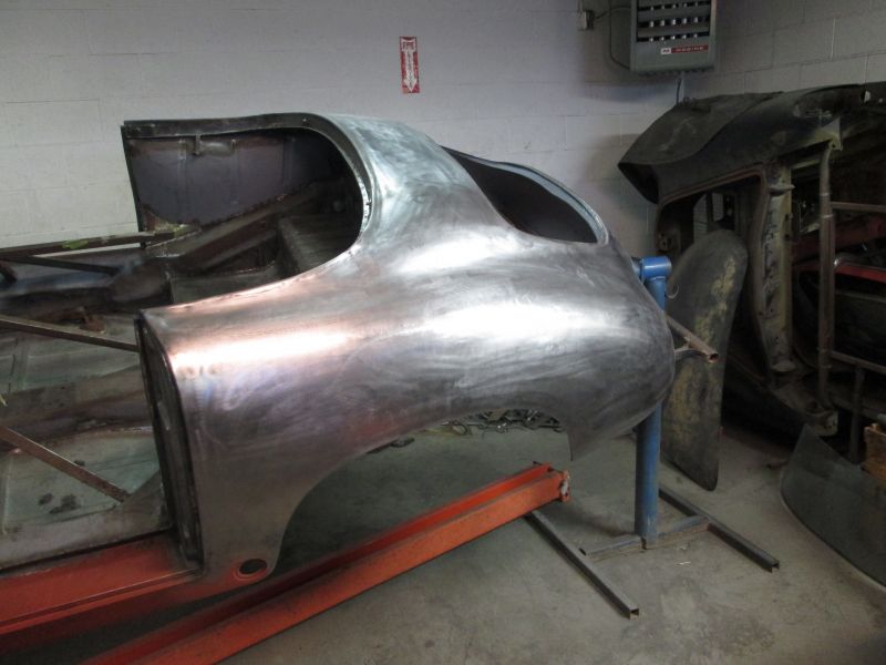

                All the contour details at a good fundamental level....I can live with it.
                cleaning up the rest of the body.

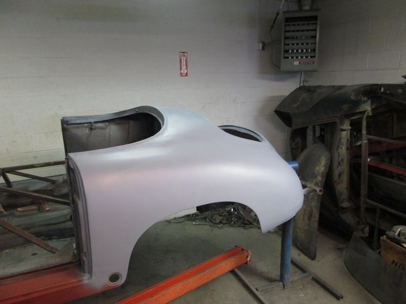

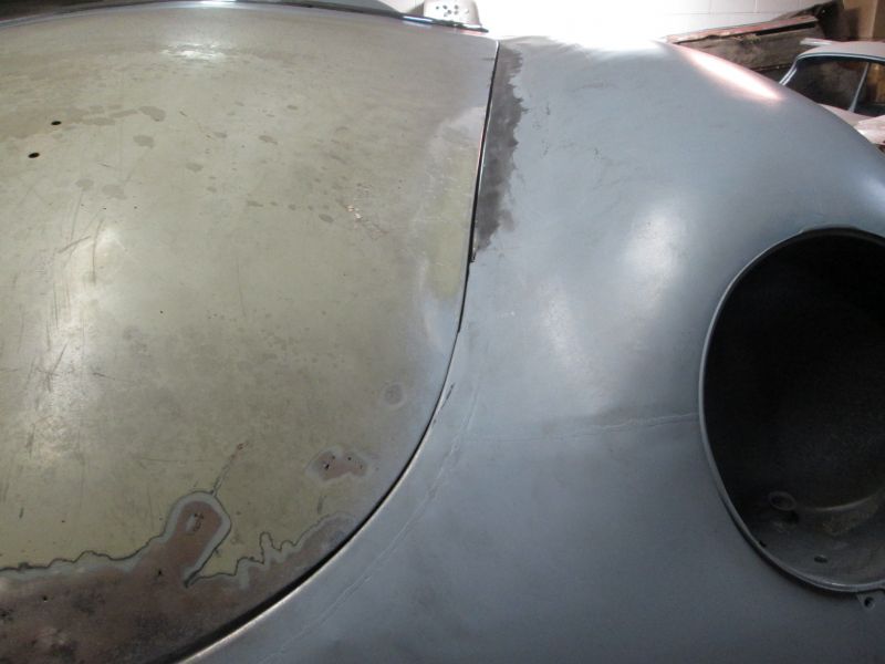

                    8/22/17

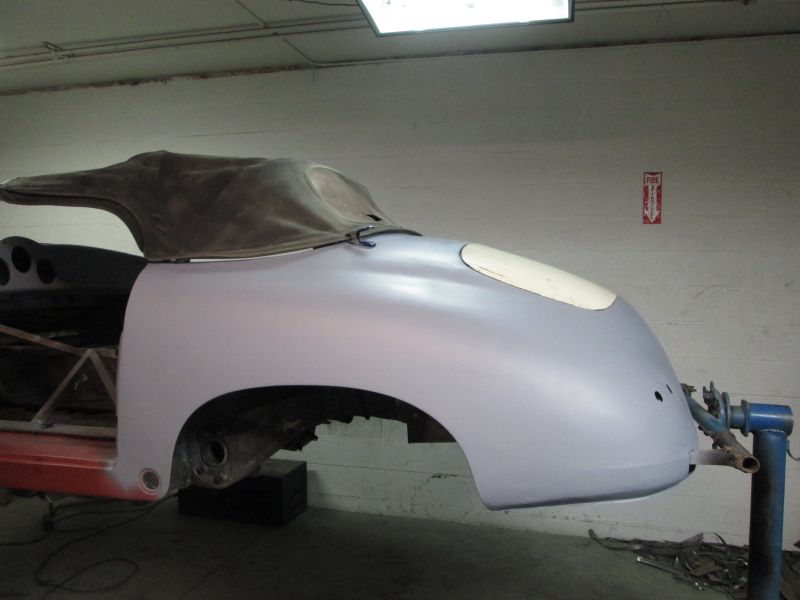

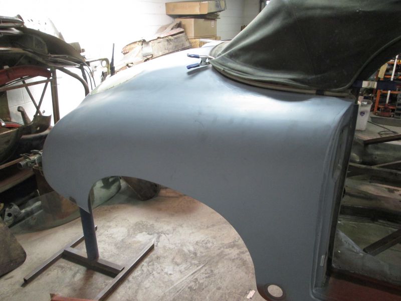

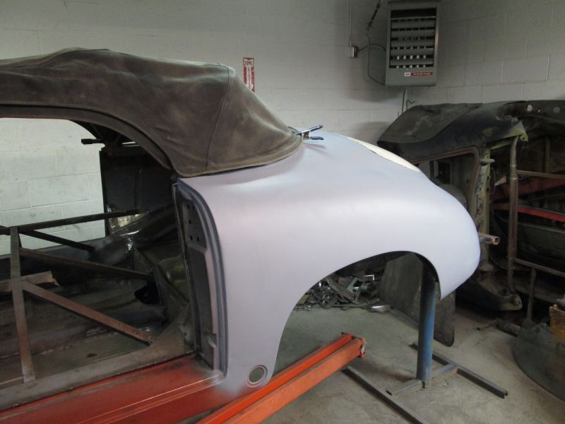

                    In sealer.
                    This officially closes the door on my fender duties.

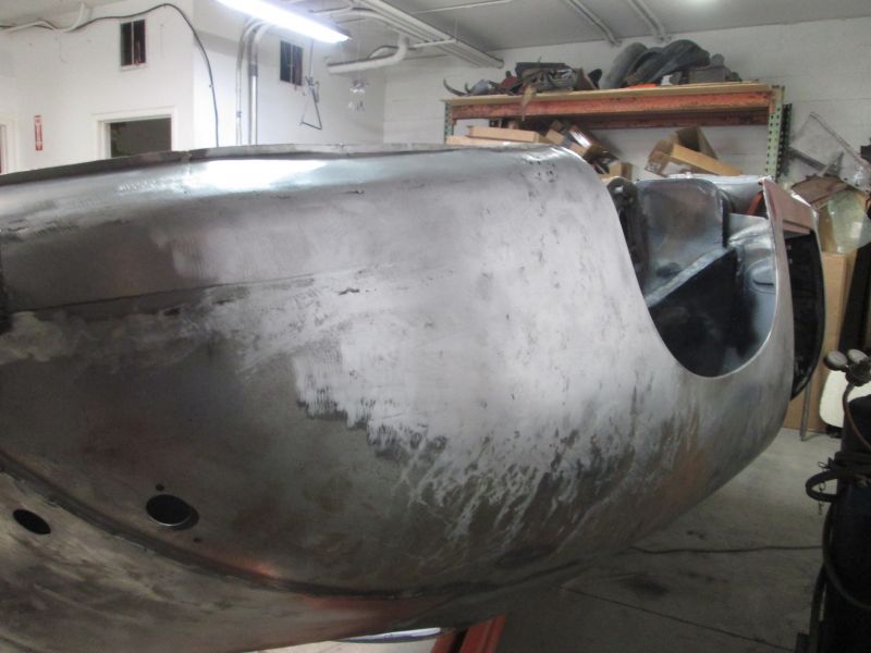

                    As much as the rotisserie has helped it is in my way at the lower center of the apron. I have a few things to quickly clean up after the car is dismounted for the final time. The seemingly never ending loose ends.

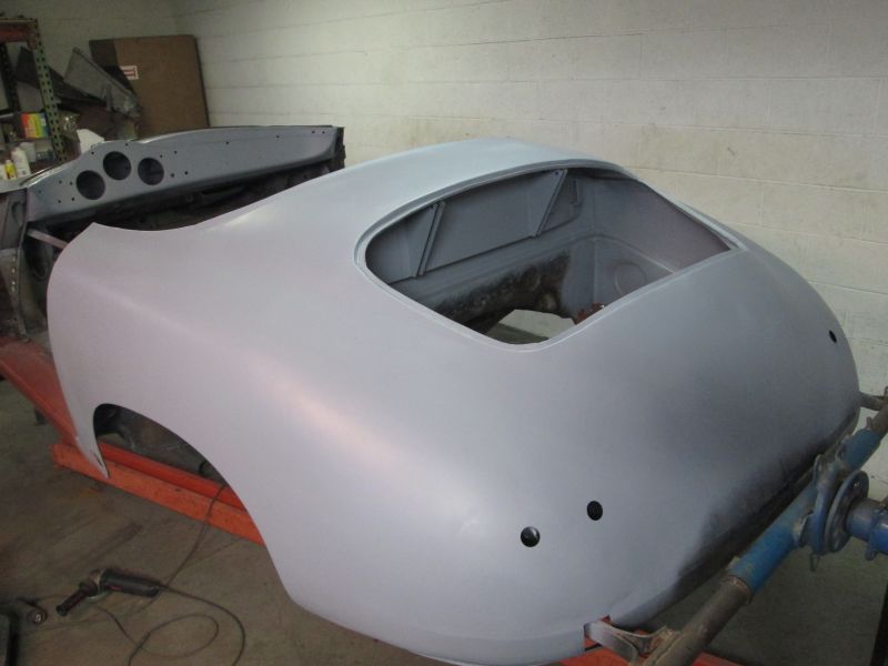

                    It was a nice feeling putting most of it in primer though.
                    My to do list is getting very short with only three main objectives left. 1) finish out the trunk troughs and gaps along the hood.(next) 2) build a dolly for transport out of those pallet racking runs there on the floor. 3) finally cut that interior sub-frame out after all these years. Several small piddly things in between for sure but these are the last of the "big ones" to do before she moves on.

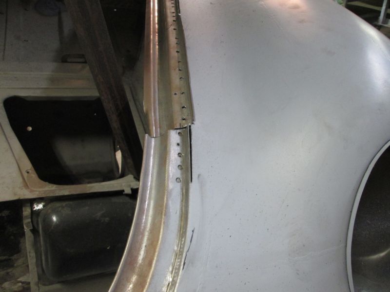

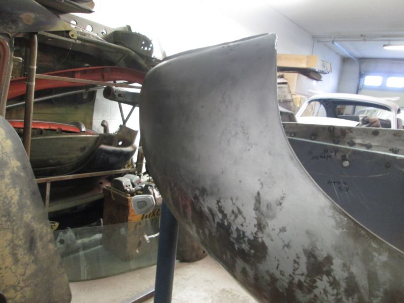

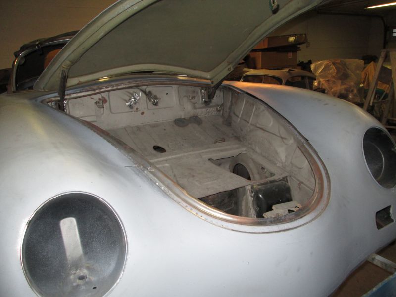

                    • 8/23/17
                      Trunk trough
                      The turn radius is just a little too tight as it transitions toward the fender encroaching into the hood. As I was fitting the nose I could have moved it out further to gain some space here but it meant losing the alignment of the leading edge/gap with the tip of the hood. A compromise had to be made and establishing the front was far more important so my adjustment/fix is here.
                      Here's how much I'll have to soften it beginning right around the magic marker line to both align with the fender trough section and create a gap with the edge of the closed hood. It of course won't be easy as all those stepped angles in the trough won't allow for very much movement so I'll have to section it to get what I need. That next...

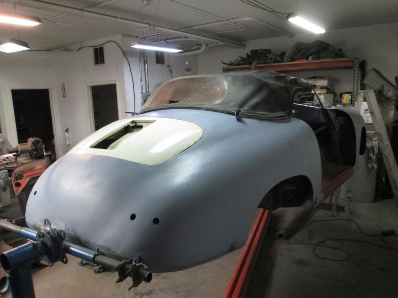

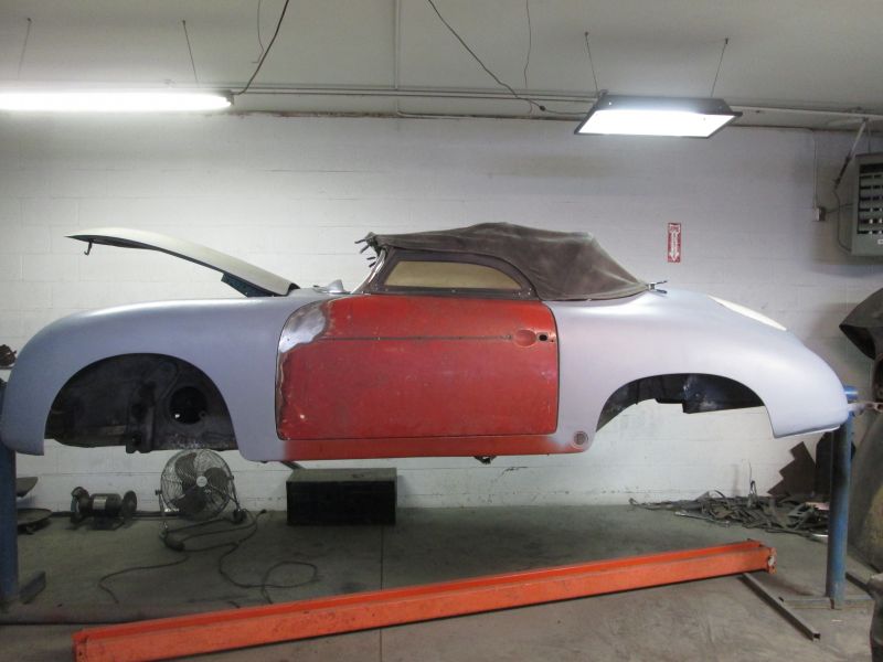

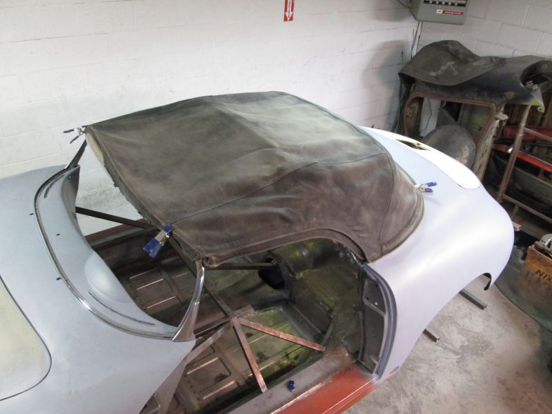

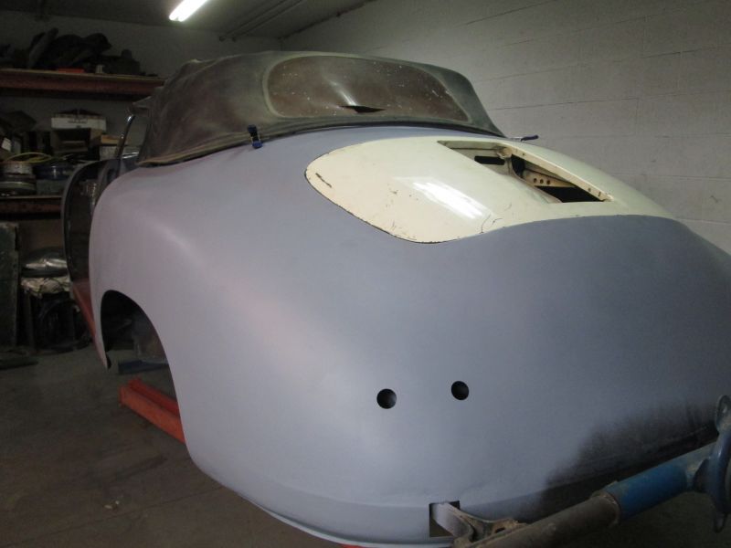

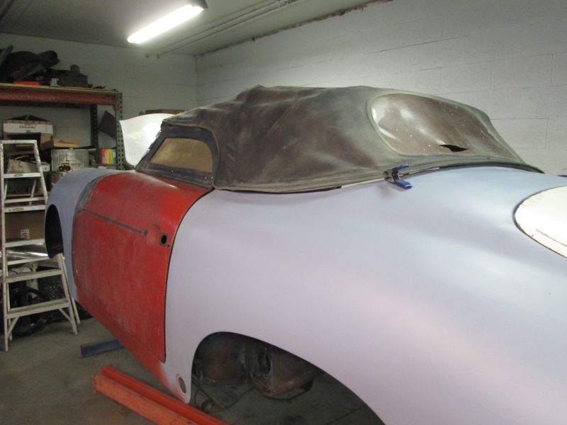

                      Just before this I had mocked the car up just to see how the illusion is turning out with its fresh coat of felony gray on the entire body.
                      added the deck lid, top and WS frame.
                      Looking more and more like an old "project Speedster" you could have picked up for 2,500.00 back in the day.
                      No two ways about it, its gonna need some more lovin at the body shop but its within range.

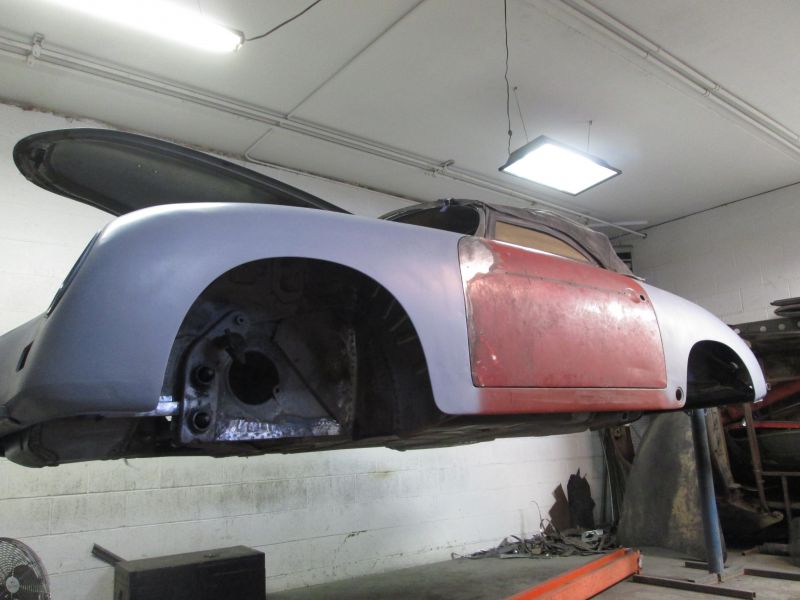

                      Added the door and a side curtain just to complete the picture just a little more.
                      Because the skin is not perfect as I rub my hand over the fenders its slight irregularities puts me in mind of an original car body that lived a real life through 60's and 70's when they suffered the abuses of being just an old car. Not that this is a good thing as I'd rather they be perfect but it puts me in mind of my original coupe body's condition.
                      It was fun distraction but time to take it down and get back to work.

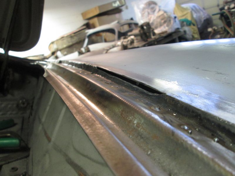

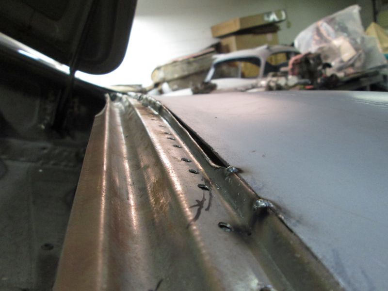

                            • 9/2/17
                              Finishing out left trough and gap
                              Most of the left side run welded up and dressed for the final time. Along with the inner leading edge flap closed tightly.
                              New gap and height relation to the edge of the hood all within striking distance and minimal amounts of lead required to be perfect.
                              This corner is too tight and will Have to open up this turn eventually.
                              But first I have to relax the trough so it will align with the fender section.
