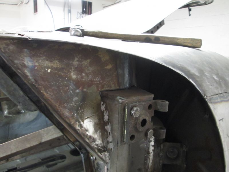

      Thank you too Scott, You're in the same boat so Likewise! In prepping for the "flange fold" I'll etch where the shoulder of the lip will be against the skin then die grind in a light line to help create a better defined fulcrum. I can only equate it to putting a crease in a piece of paper maybe. Then I just hold the dolly against the shoulder flange and slap the edge of the skin over a little at a time. I do glancing blows that slip off the edge as it feels like it may fold the skin around tighter. Don't know if thats true but it feels better in my mind. I'm sure there are better techniques for accomplishing this but this is what I've done here. Up around that sweeping corner I'll use a little torch heat so I don't have to get too rough with it. Hope this helps.

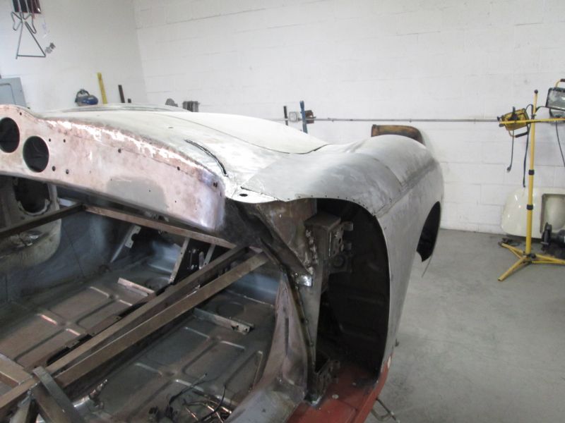

      A bit of change and upheaval these last several days (week) so not alot happening on this project until this afternoon; have to get back on track.

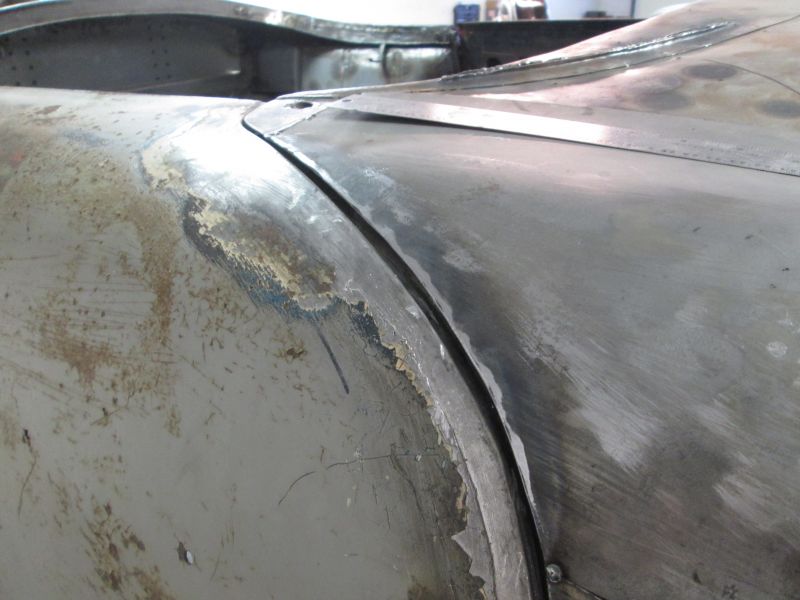

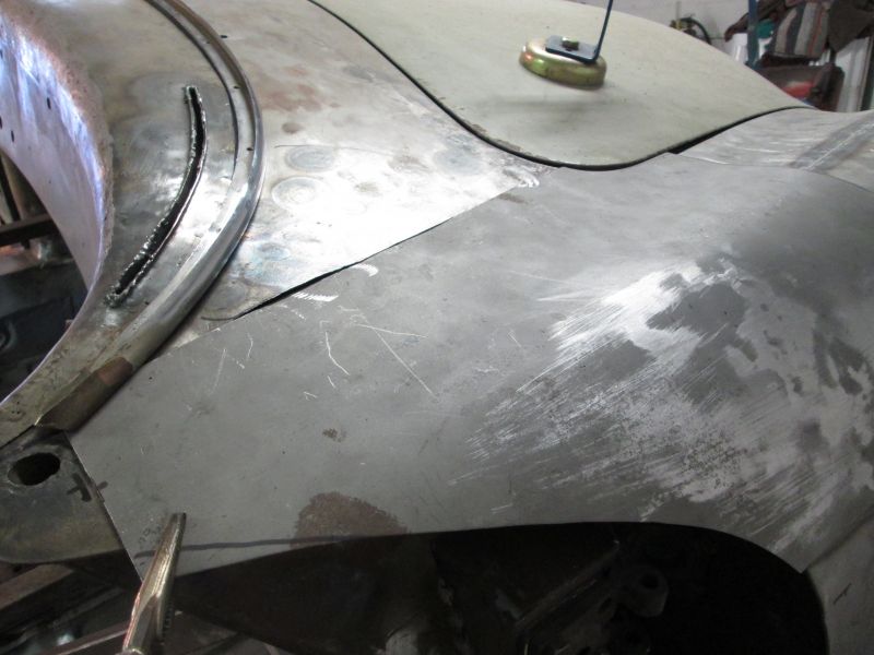

      Tunning in the final position so I can remove the remaining excess metal.

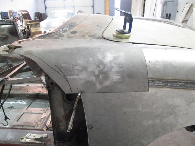

      trimmed with one more ultra-fine to go to get the butted-end joints. Picking and filing that old accident damage as I went.
      Raised a really bad low spot/trigger point on the cowl side. Its better but I'll finish it out once the welding is done. I know it will continue to be a bastard, especially after the welding. No choice have to go with it.
      Final trimming along the edges next then the first series of tack welds after that... Hopefully.

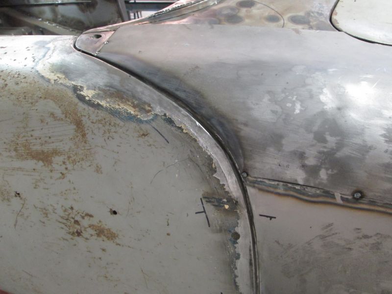

      • 5/10/17

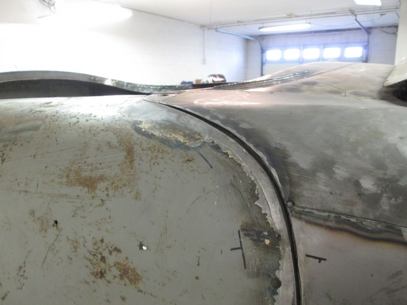

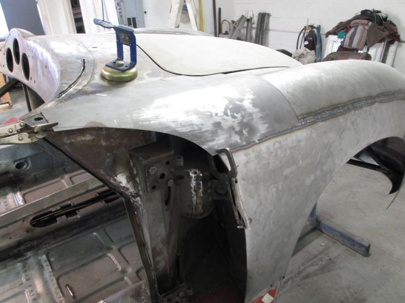

        Final piece of the puzzle tacked on.

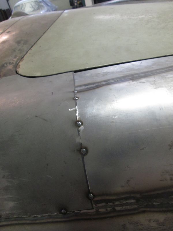

        trimmed, located in best average position and finally tacked on.

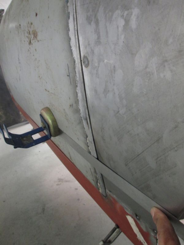

        I was mostly concerned with a smooth transition and continuation of that trough and the peak of the fender profile.

        Alot of variable along the inner joint so I decided it best to leave it loose for now.

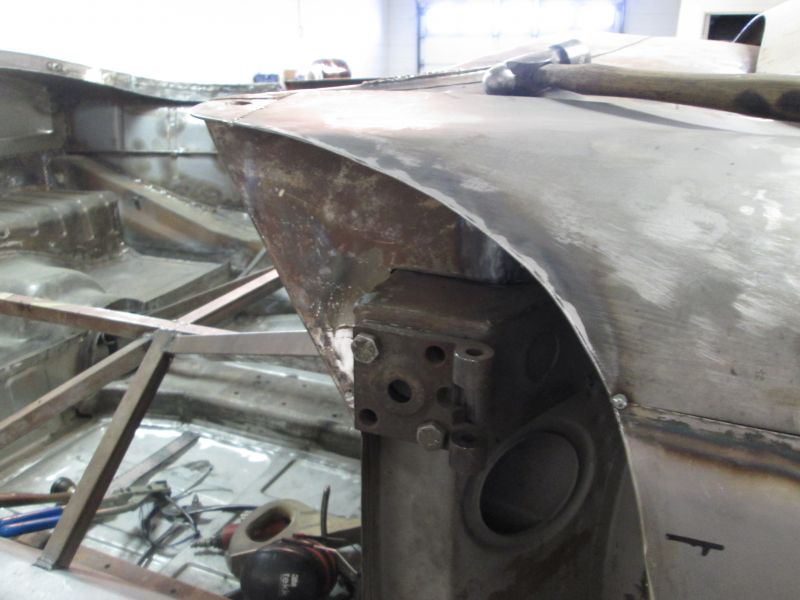

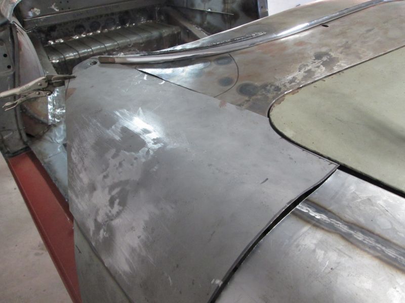

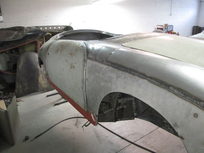

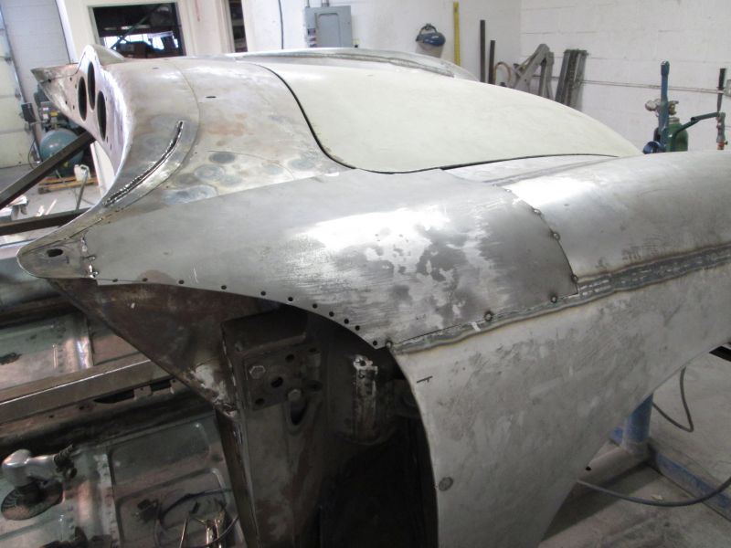

        Ready to begin heating and heeling over this final outer section.
        Reheated several times to minimize the distortion along this compound curve.

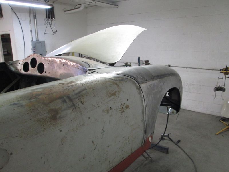

        Door test fitted immediately after the flange was clear as I was very anxious to now how bad I missed it. Swings a little wide at the center but thats why they leaded them.

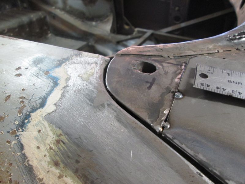

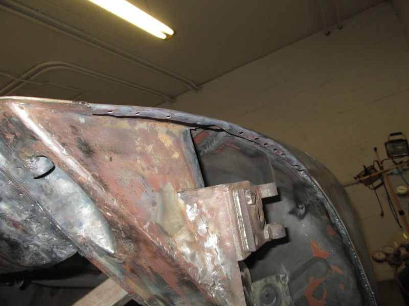

        One change after the flanging was along this inner edge. This section began oil canning as I now had too much length in there and is crowding the panel.
        Easiest fix will be to cut these forward tacks free allowing the patch to slide and "grow" foward using up that excess metal causing the "oil canning"

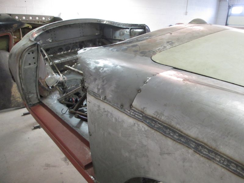

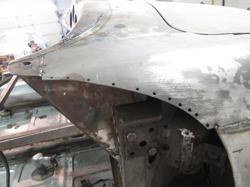

        Alot of cleaning up yet to do but it was close enough right out of the gate. I can at least work with it and doesn't require a redo.
        Again, I have a ton of loose ends and contours to clean up but I offically have no more panels or parts to add on this project. I just have to finish up whats there. Never thought I'd get here.

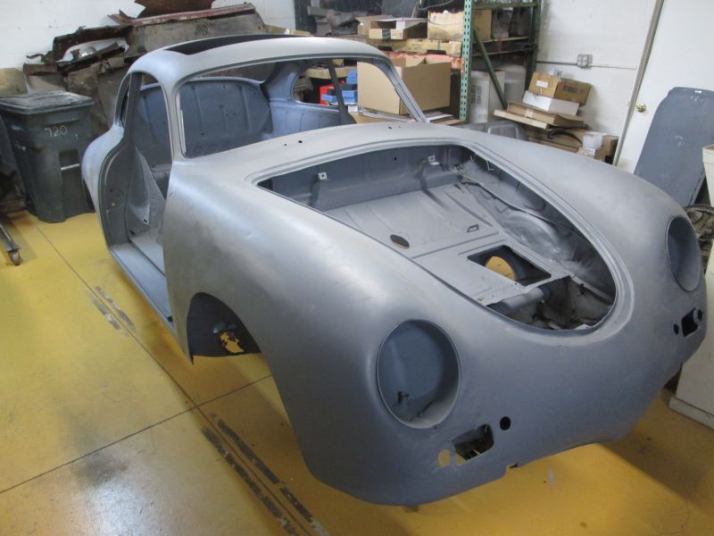

                      BTW: Bruce's S/R coupe is here. Actually this car belongs to really nice fella who has been patiently waiting for me to finish out this coupster project so I could help him with the weld repair on his '59 S/R coupe. He's kept in contact with me for the last several years so last summer I told him to bring it down when he could. Again, waiting very patiently since. He's a stickler for originality and detail so it will be another detailed build post, which I'll start here shorlty. Anyway this is the next welding adventure. Rusty but nothing like what I've delt with on this project.

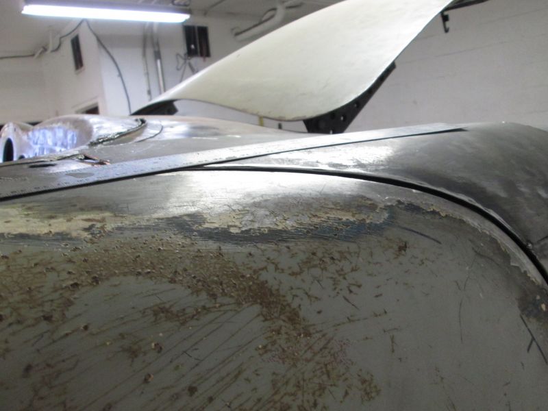

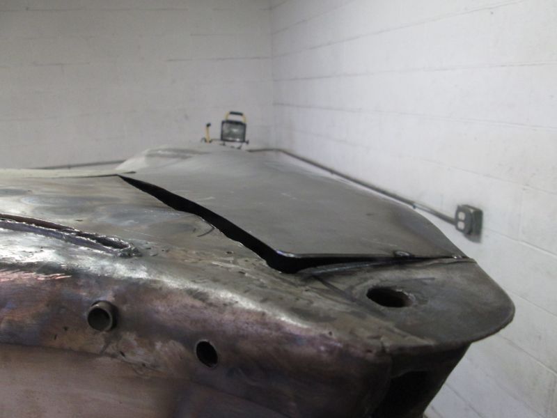

                          Improved but I thought the gap and relative elevation might get even better if I removed one of the shims (thick one) from the top.

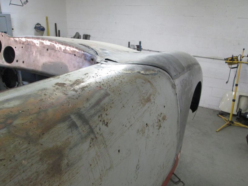

                          That turned the trick. The gap got better and I even had to peck this new leding edge down just a touch in places which was nice as my biggest concern from the start was that it was going to end low no matter what I did.
