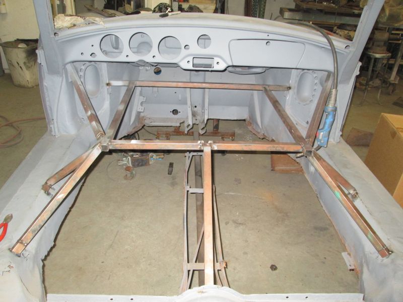

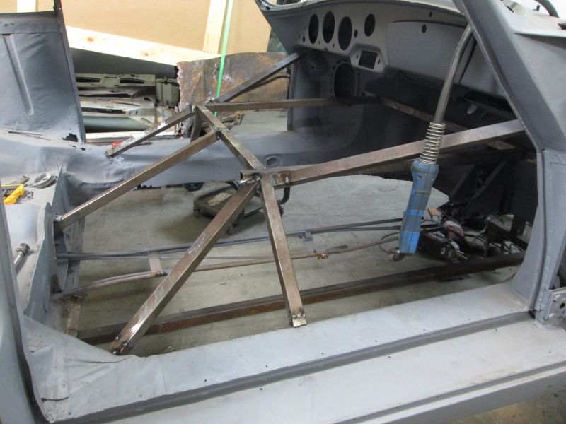

      Subframe/ Holding Jig installed.

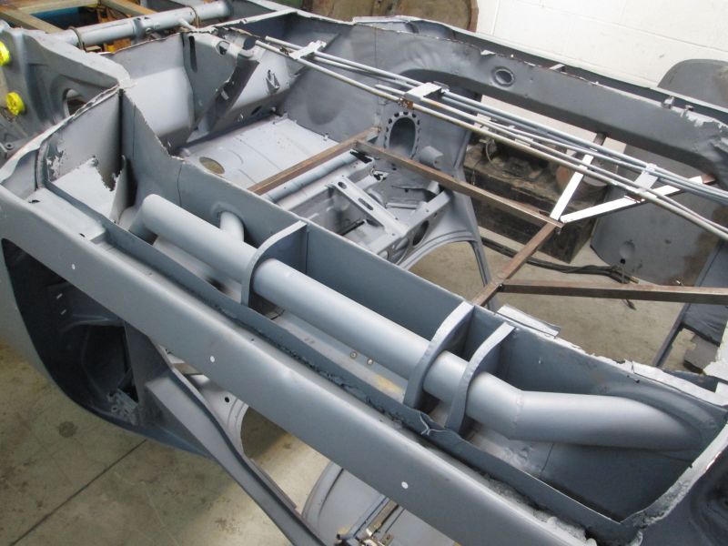

      out riggers repaired

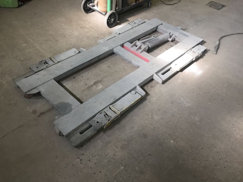

      Along with a few adjustments needed to get it to sit down square in there.

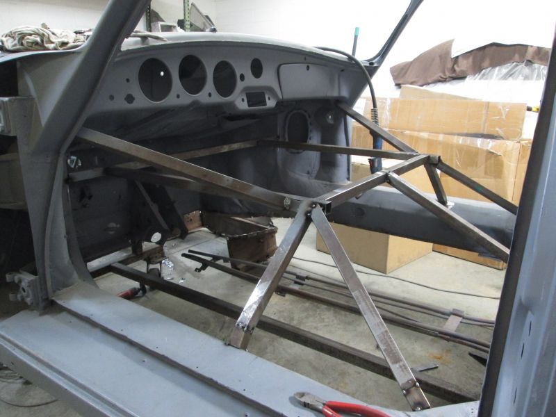

      through the coupster build this design pretty much stayed out of my way
      but this being a coupe once the longs and floors are all welded in I don't see the need to keep it in for the duration. Getting closer to rotisserie time.

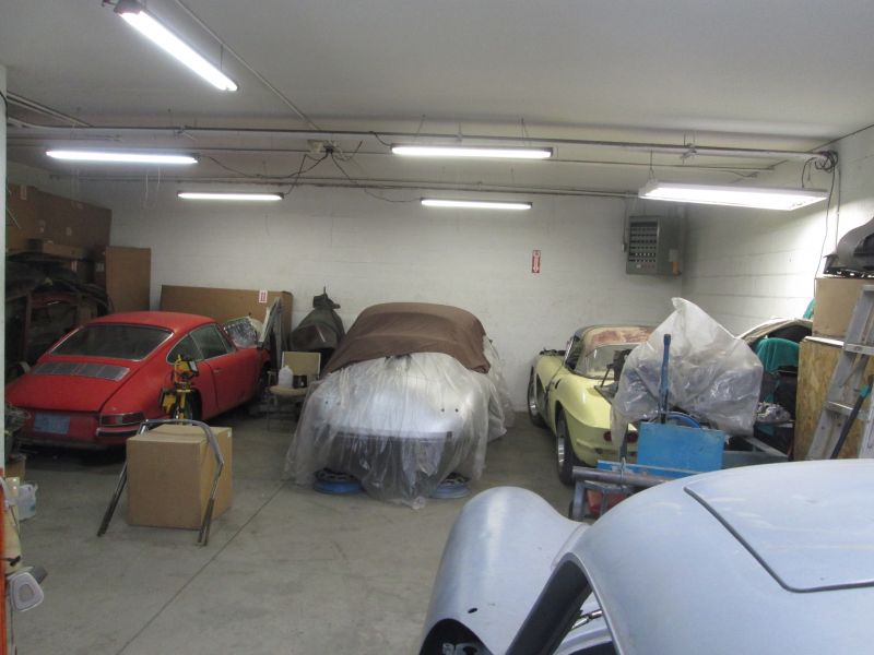

                      Thank you so much for the concern and the nice notes I really appreciate it! As Trevor mentioned I've had my shop literally turned upside down for the past few weeks and with the time change and loss of an hour I was just too beat to log in and reply. I kept saying, I post tomorrow, no tomorrow and so on. You know how that goes. I finally got everything back in order these past couple of days so things can finally get back to normal.

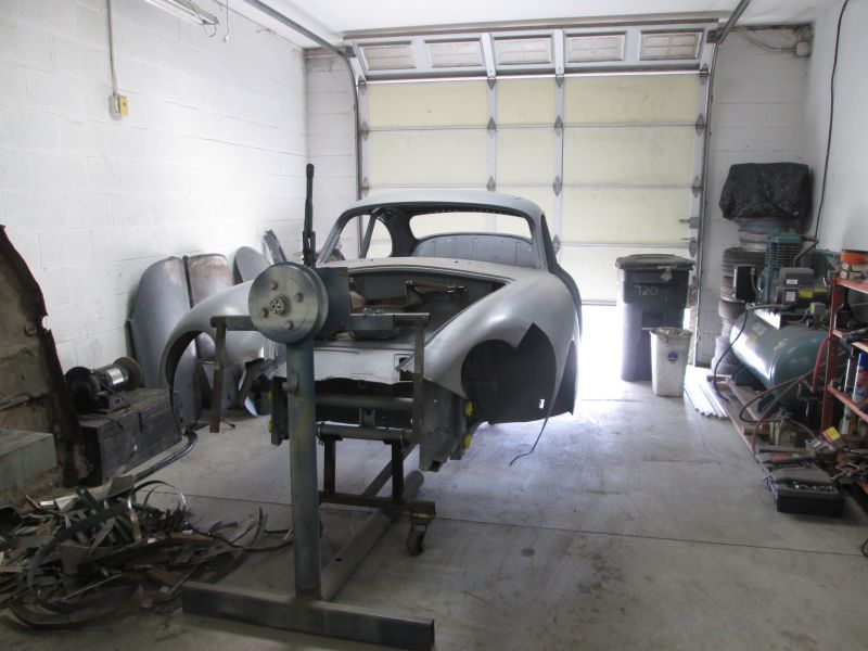

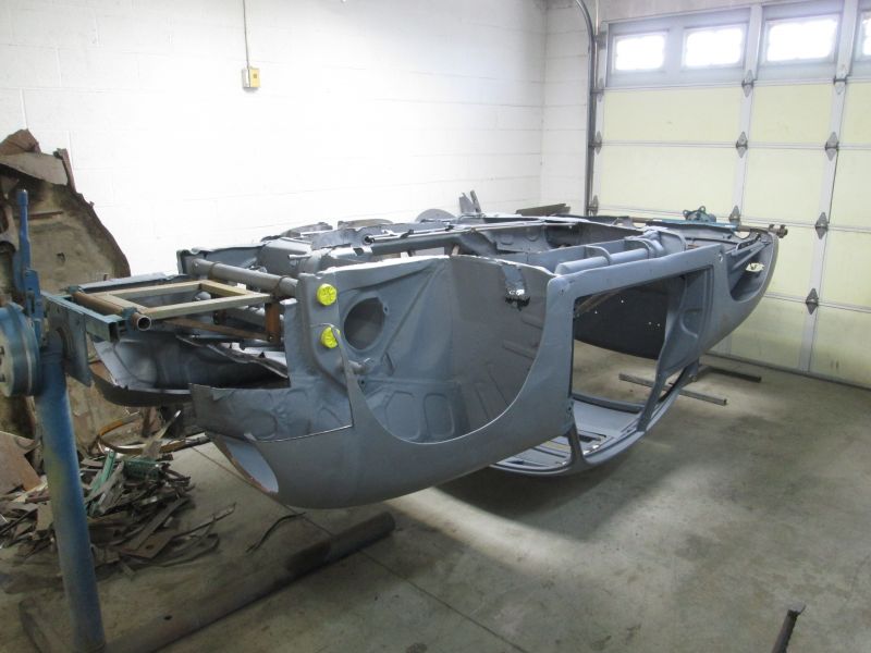

                      With the coupster project now gone I had the room to bring my Vette home and my fathers '66 which was at a buddy of mine's place. Due to my limited amount of space and growing piles of crap and cars meant some serious logistical planning...then there was the actual moving of everything. Had two main goals: Preserve a workspace for this SR project and keep that silver paint on my coupe relatively isolated and out of harms way as it still remains damage free through all of this. This was my best configuration. All the cars are stored where I used to work and with a good buffer of space in between; more than I had expected.
ID:	98594My coupster project was pushed to the other side and is now entombed with boxes and other loose crap in and around it.The 66 provides a nice barrier of protection for the '57 though I don't want to see the 901 damaged I prefer it take the hit if I'm choosing.

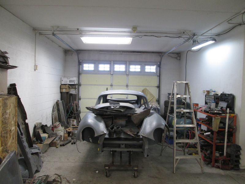

                      Forward bay of the shop is now my new work station. This was always just storage so lighting was poor which now required hanging some more while I was at it. All that loose crap on the floor was moved forward to begin with and now moved back with the coupster with everything reset back there. I kept asking myself "why do I keep all this shit around"? Because I'll need something from it once its gone.

                      As of last Wednesday I finally had a new home for that crap. Now All that remains is that floating pile of scrap metal that I still need to pick through but I know most of it needs to go. Just about ready to get refocused and mount this car on the hoist; That next.

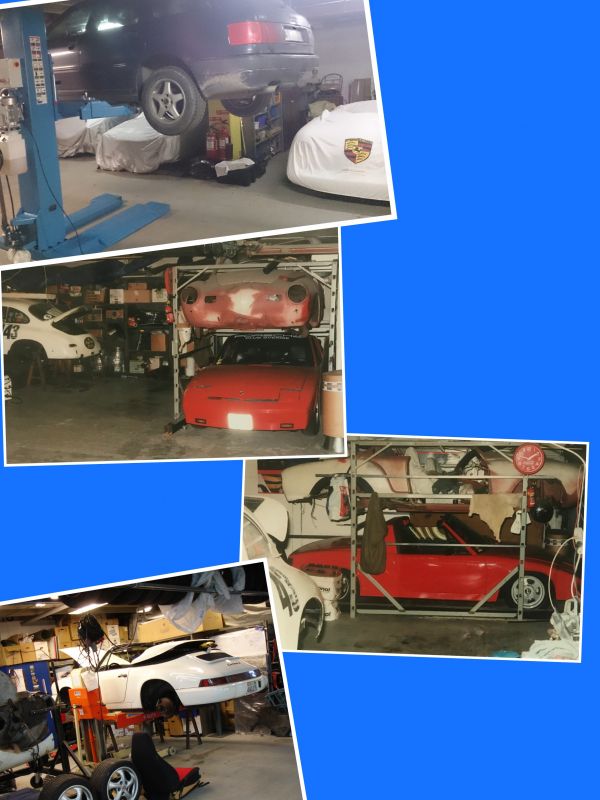

                            For the last 18 years in my current shop, I have only a ceiling that is ~11'6" (~350CM) and was not high enough for a traditional 2-post lift, so I have several mid-rise lifts that are moveable. I use one for mechanical/assembly work and another for bodywork. They are also great for painting. (We all know how painter's hate to bend down.)
                            These lifts economize floor space, as a car can just sit over it, or it can lift a chassis dolly that takes a car in process a bit higher. It can also lift or lower my Celette bench without it's wheels. It's amazing how much of a positive difference actual work can be with the benefit of height opinions. Ah, also rotisseries.....great access for better work.

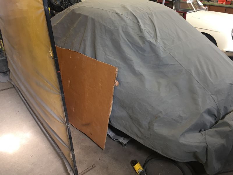

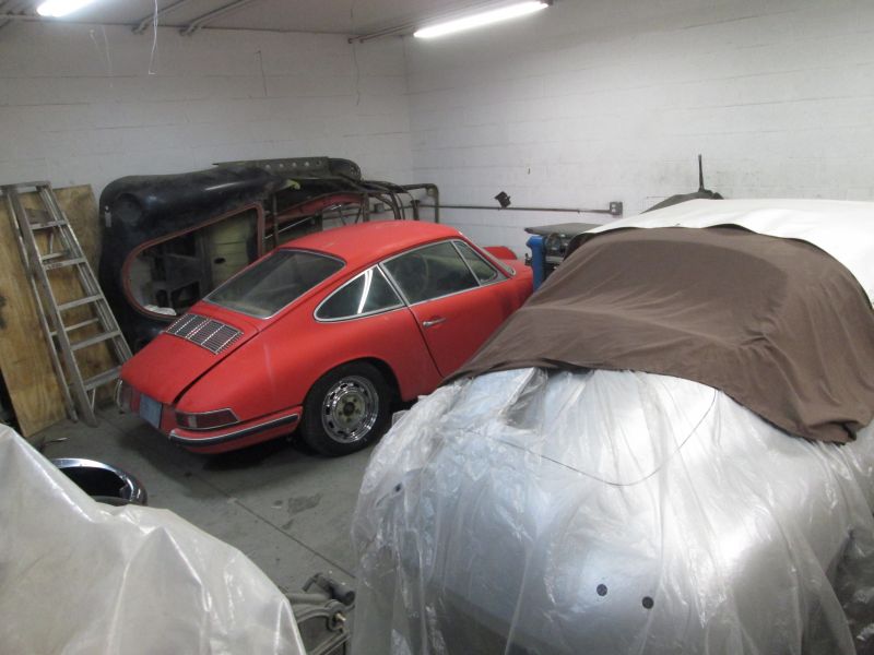

                            For the closeness of cars, especially finished cars, a cover and a big piece of cardboard can be sufficient. The movable partitions help as well. (That's also a silver 356 under the cover.)
                            Two thousand square feet is a far cry from 11,200, my largest shop.....but in "downsizing," it is still all about paying a lease based on cost per square foot. That's why my own tool boxes became the shop toolboxes with only one key employee having his own box taking up valuable space....and even a work bench and work table are on wheels and go outside when not needed.

                              Thats atleast TWO 356 that can be stacked in that enormous space
                              I have a Celette mobil lift max 1400 mm and bought a new mobil lift 1900 mm in my place today plus in the picture is a solution I did many moons ago of old warehouse pallet rack... got it welded to be able to get my old Porsche 914 parked under it
                              Just a tip on a cheap way of getting more space IF you dont need the top car daily

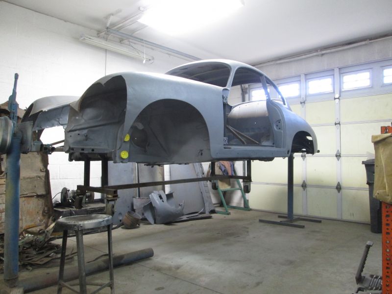

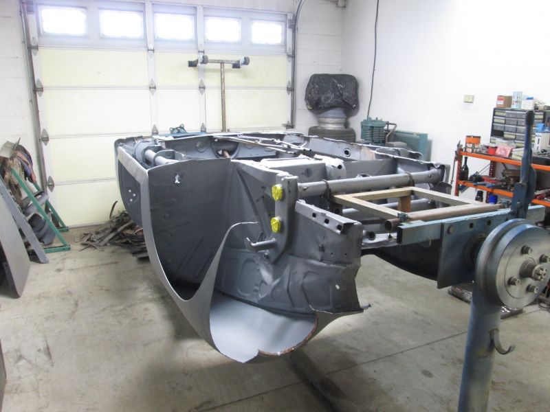

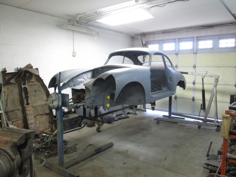

                                Body mounted to the hoist. The real "fun" begins.

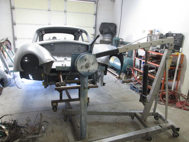

                                Rear ready and set up into the bracket mounts as before.

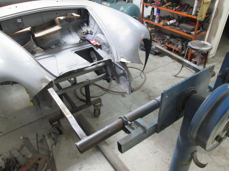

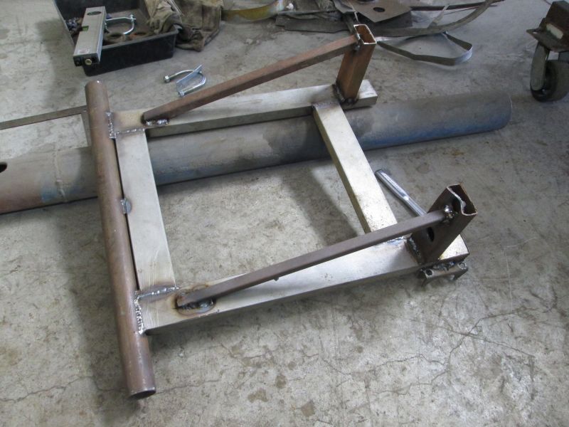

                                My front has always worked off the brackets too but seeing how this one doesn't have a battery box yet a new sub-frame carrier had to be made.

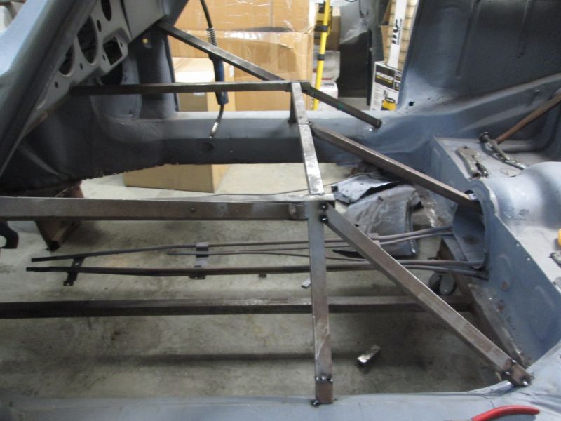

                                Basic frame tacked together here and all made from scrap metal. Triangulating to those rear uprights next.

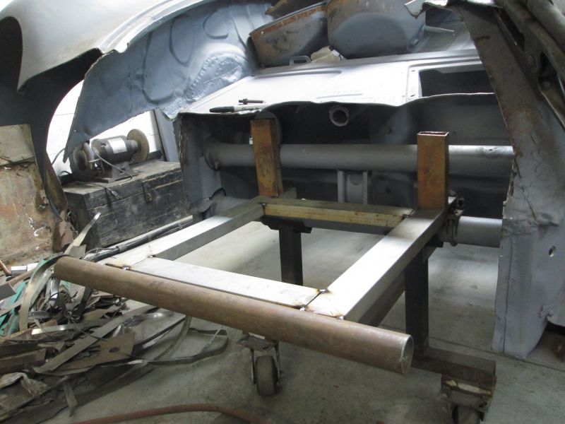

                                Triangulated and all welded up. Uprights clamp to the upper beam to keep the sub-frame from rolling or sagging.
                                Begin lifting the front into position.
                                My initial plan was to begin hoisting the front up then have my friend and his forklift simultaneously pick up the ass end. However as the front went I could see that the cart was high enough to allow the front to tilt high enough to be mounted without the rear apron touching the ground. Didn't have to bother my friend at all, I could take it one end at a time. Very slow and cautiously though.
                                Mounted and ready for the first flip.

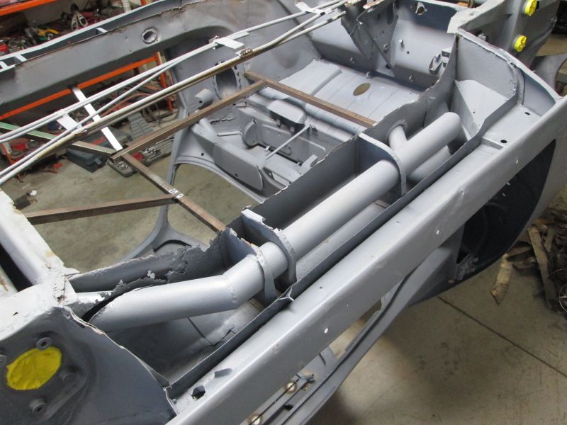

                                First clear shots of the longitudinals
                                both about equally as rusty. Both heater conduits are nice so that's something.
