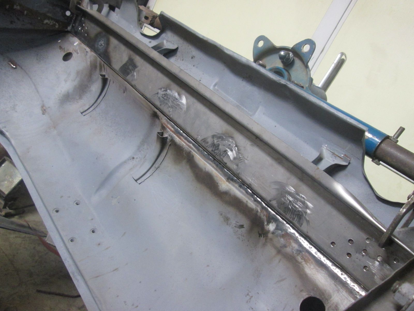

  • New cross-member in for good.

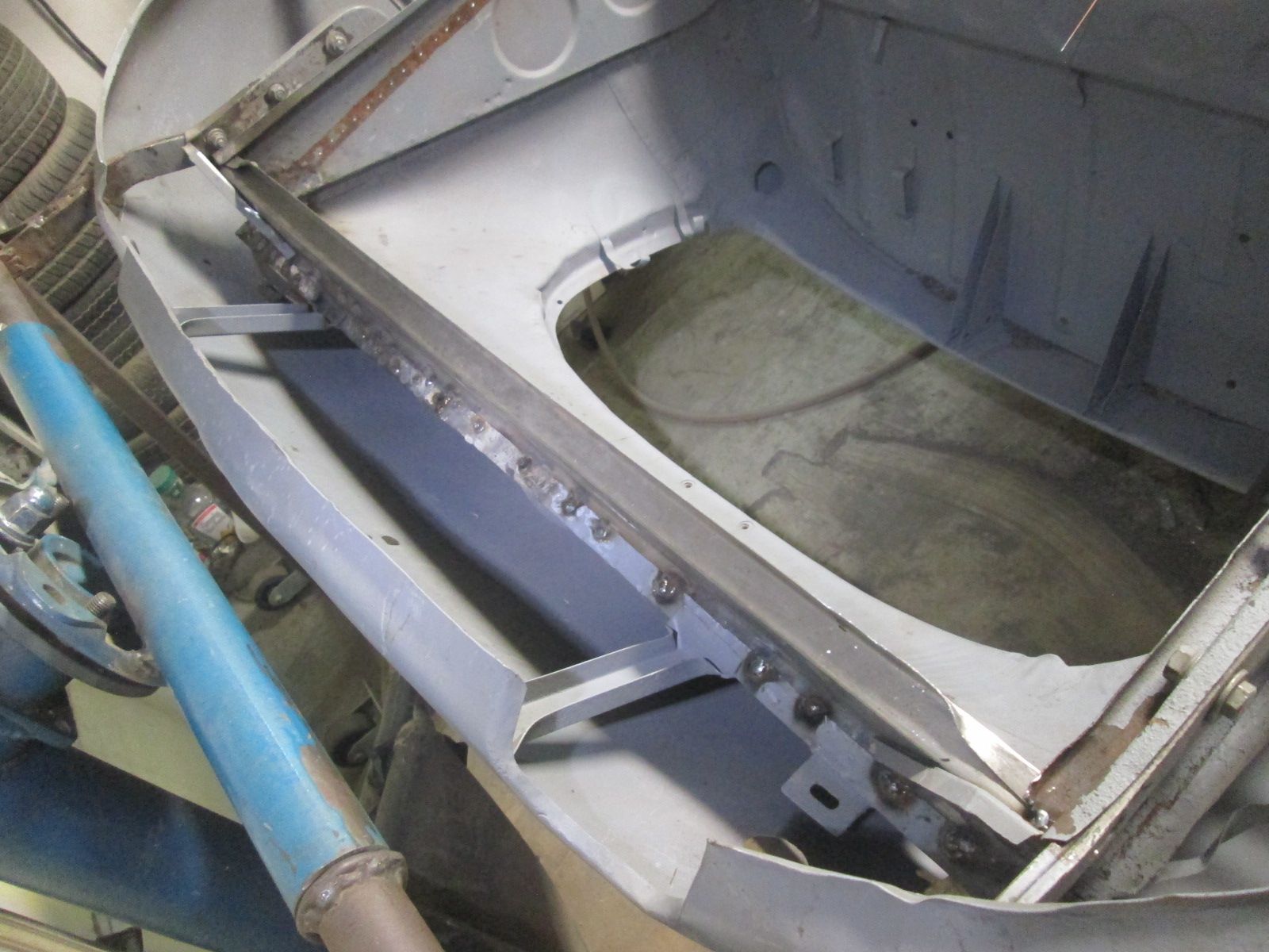

    Click image for larger version  Name:	IMG_3478.jpg Views:	0 Size:	200.4 KB ID:	117284 Reinstalled for the final time and ready to begin welding.
    Click image for larger version  Name:	IMG_3477.jpg Views:	0 Size:	197.7 KB ID:	117285 Double checking for "square" in the corners just to make doubly damn sure. My biggest concern at this point was getting it all glued in only to find out that the shelf no longer seated in squarely.
    Click image for larger version  Name:	IMG_3480.jpg Views:	3 Size:	210.6 KB ID:	117286 All that careful dissecting of these corners was to have a chance of recreating this multilayer presentation as closely as possible to the way it was before I had to dig it all out. This area will get one small gas weld at the end down deep in the corner but is left raw otherwise.

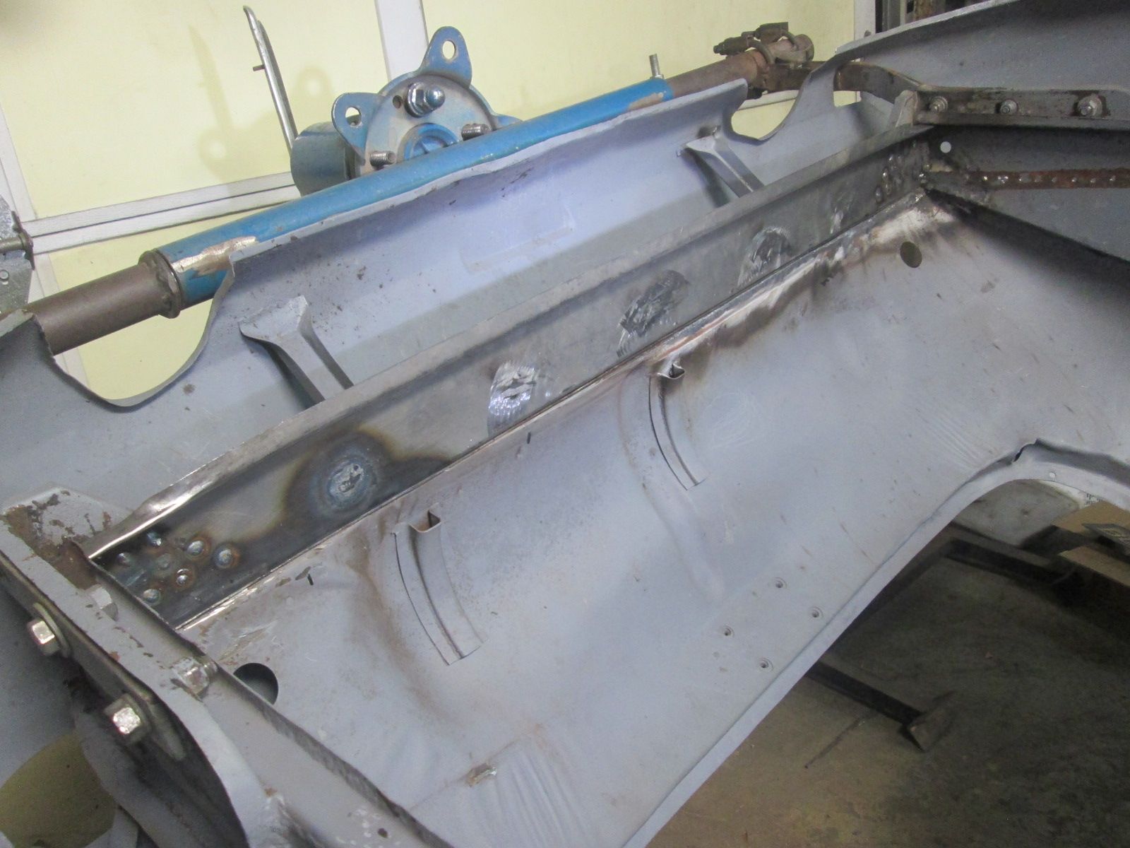

    Click image for larger version  Name:	IMG_3482.jpg Views:	3 Size:	212.0 KB ID:	117287 Begin plug welding from the center outward along the outside pinch seam. It was tough reaching down in there to weld as my hand would also block my view as I went.
    Click image for larger version  Name:	IMG_3483.jpg Views:	3 Size:	202.2 KB ID:	117288 Once the outer pinch seam was welded then it was onto welding up the corner gusset plug weld holes. Crossmember officially all welded in at this point.

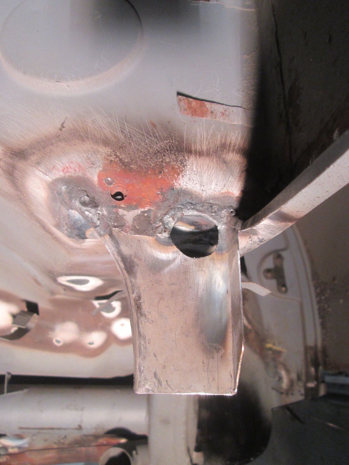

    • Installation all but complete but I needed another diversion to keep going.

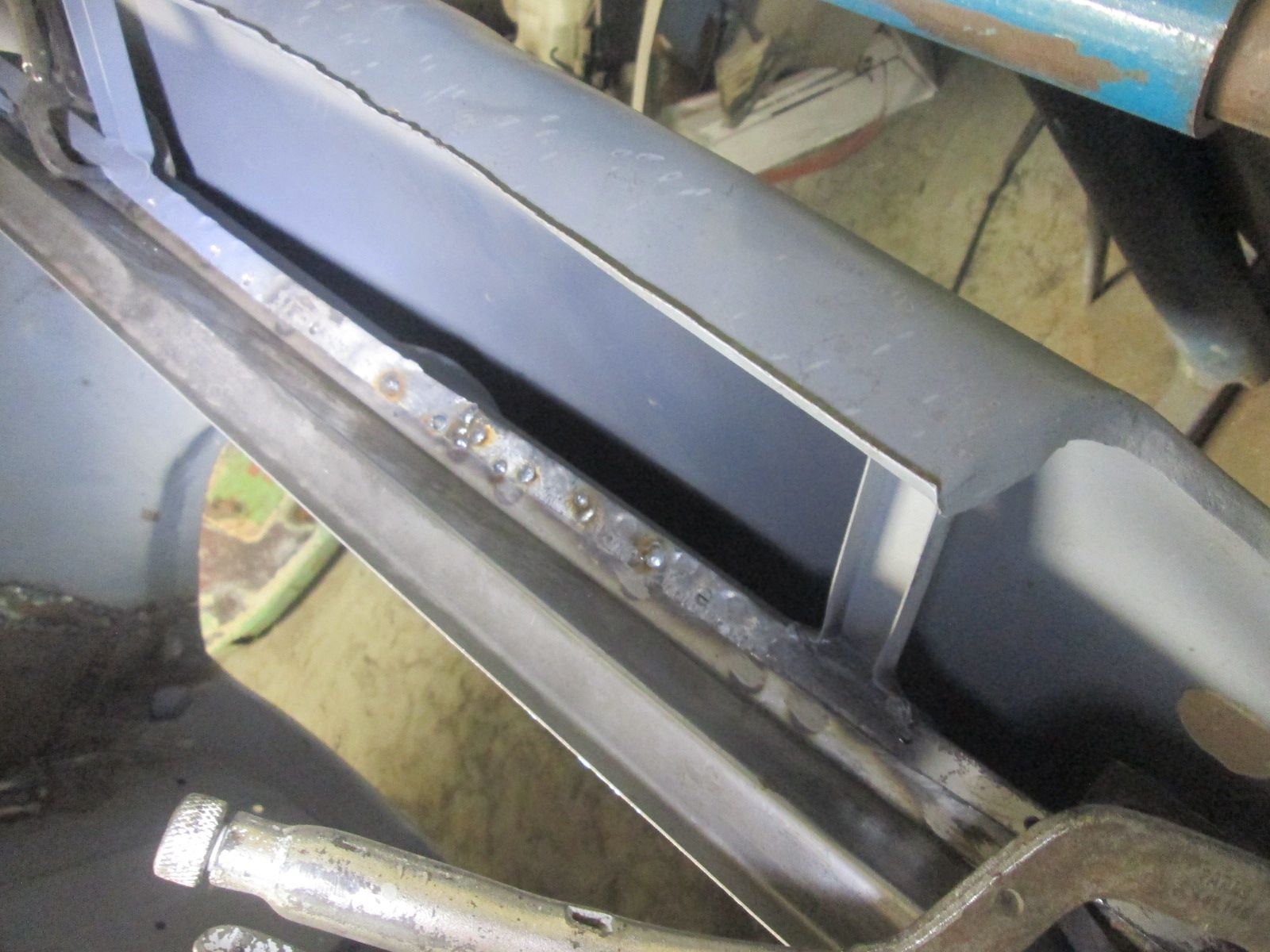

      Click image for larger version  Name:	IMG_3485.jpg Views:	0 Size:	219.0 KB ID:	117305Getting to the plug welds down in here was interesting; as I'd reach down in here with my gun my hand would sometimes obstruct my view depending on the angle I needed to apply the weld.
      Click image for larger version  Name:	IMG_3484.jpg Views:	0 Size:	220.4 KB ID:	117306 It got ugly, especially along the unrepaired side whare I'd have to chase the edge as it burned away due to being thin. Eventually got them closed and bonded but I have a bit grinding and weld clean up to do. After that I'll just have to repair the outer corners that I had to cut away as they were completely fused with a gas weld. Which will be replicated but at this point I needed a break from this area.

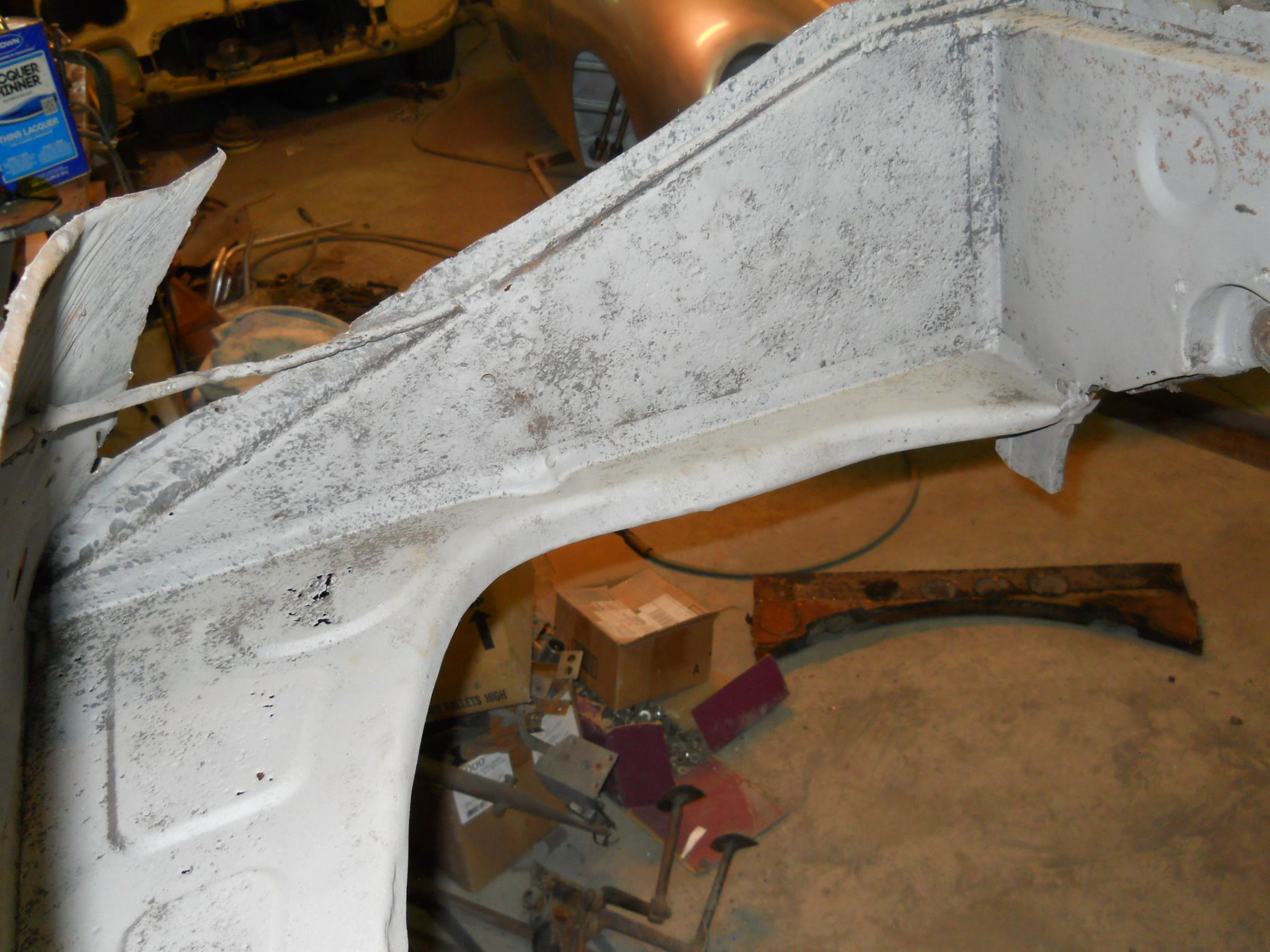

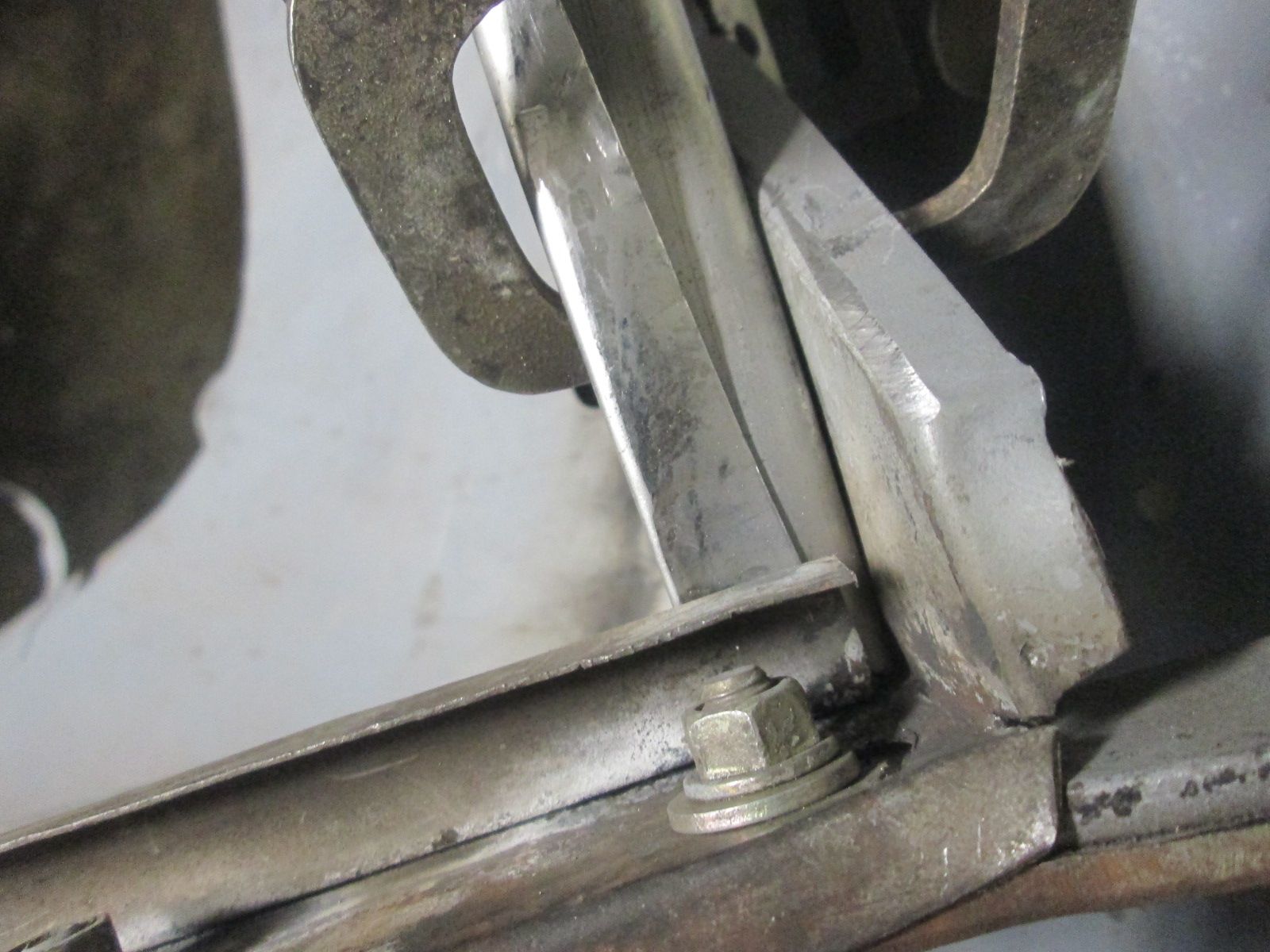

      Click image for larger version  Name:	A chassis 1086.jpg Views:	0 Size:	318.9 KB ID:	117307 This early '59 chassis show a low hanging corner tab that the engine's tin uses to seal out these corners.

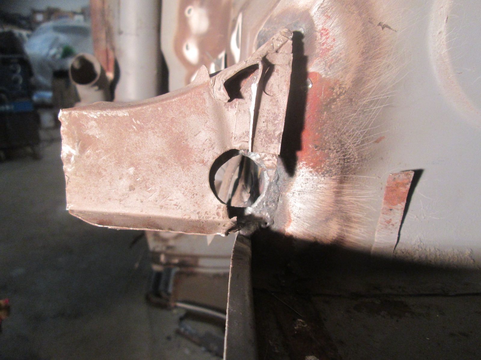

      Click image for larger version  Name:	IMG_3435.jpg Views:	0 Size:	207.8 KB ID:	117308 Whomever it was that removed the original shelf from this car got a little carried away and cut the original tabs off. I doubt that they were rusty as the example above is from that super rusty '59 chassis in the photo before this one and both tabs were in good shape. You can see the remains of this cars original tab just under that lap joint.

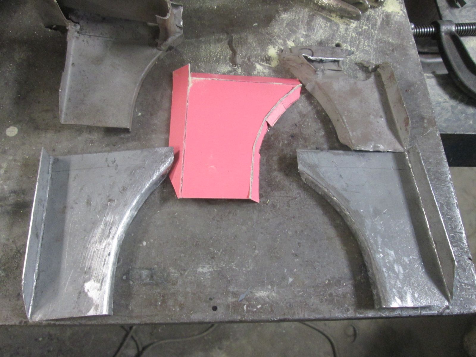

      Click image for larger version  Name:	IMG_3432.jpg Views:	0 Size:	245.0 KB ID:	117309 Template made from the original examples from that early '59 chassis then finally into steel. Have one more bend to add and some fine tuning but the basic parts are there.

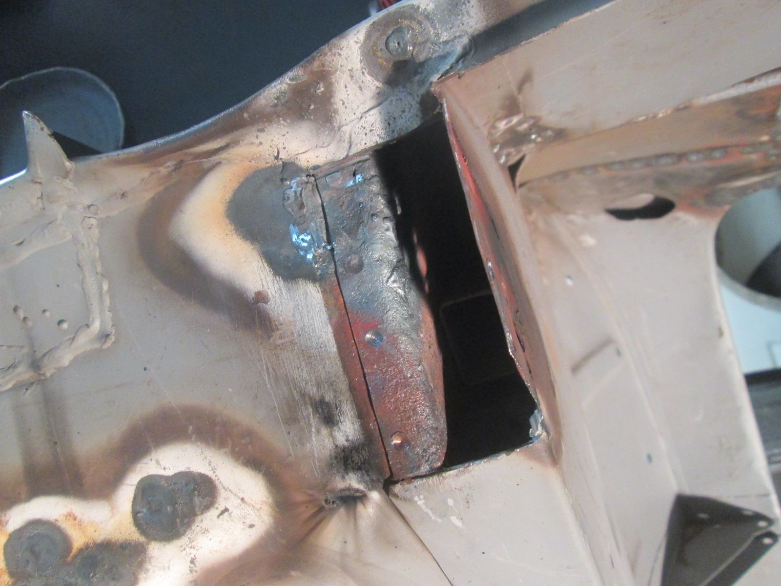

      • Cleaning and prepping the left corner first:

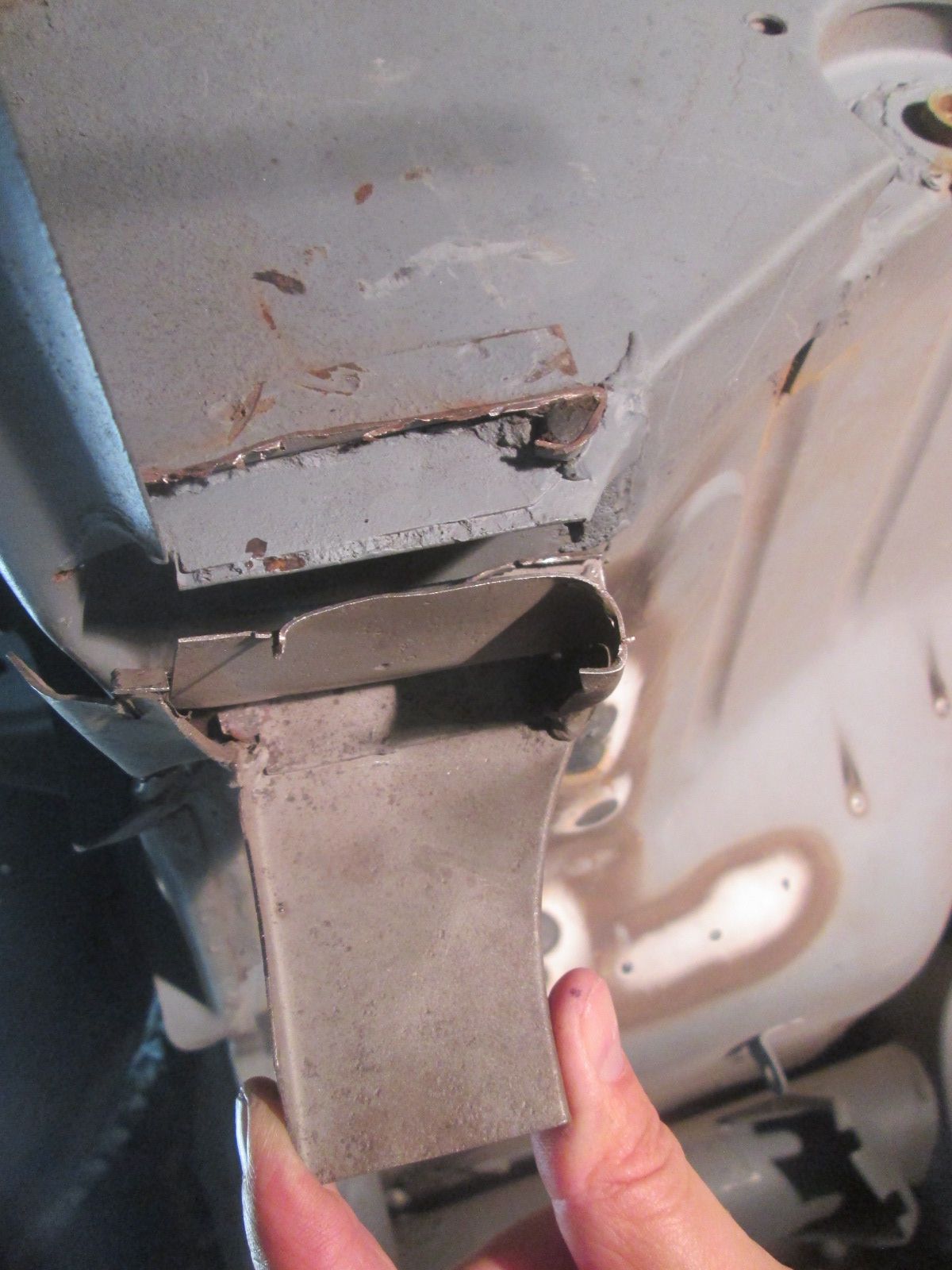

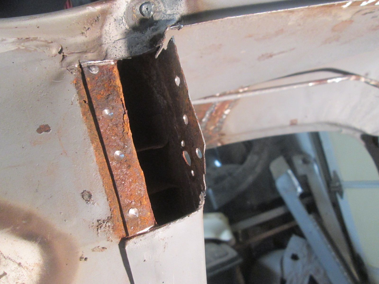

        Click image for larger version  Name:	IMG_3515.jpg Views:	0 Size:	214.1 KB ID:	117313 Remains of the original corner tab removed exposing this cavity and a bit more rust that would have otherwise been left behind.
        Click image for larger version  Name:	IMG_3516.jpg Views:	0 Size:	214.1 KB ID:	117314 Burned away the remaining rust and scale as well as closed up a few more tiny holes that made themselves known as the clean out progressed.

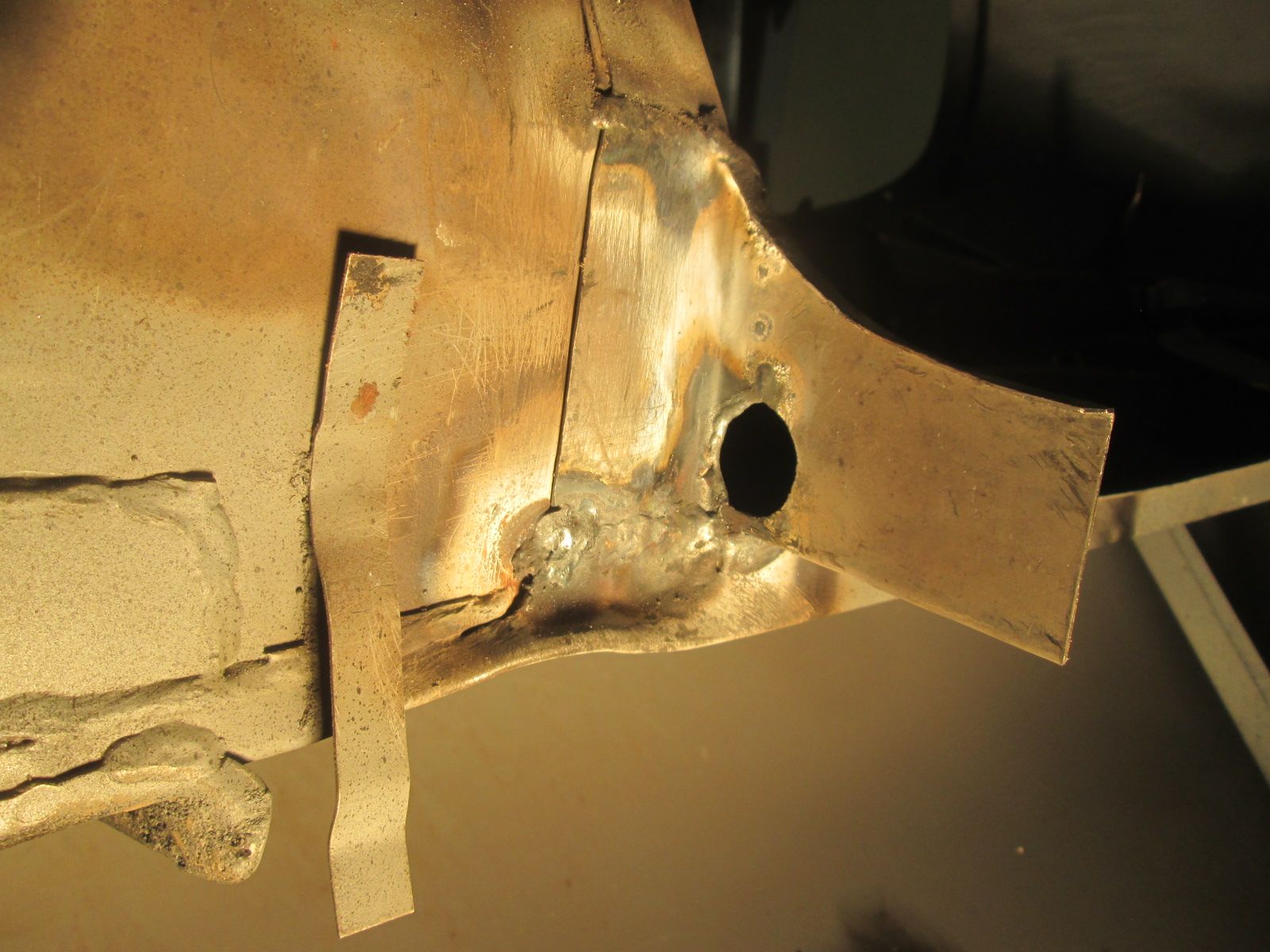

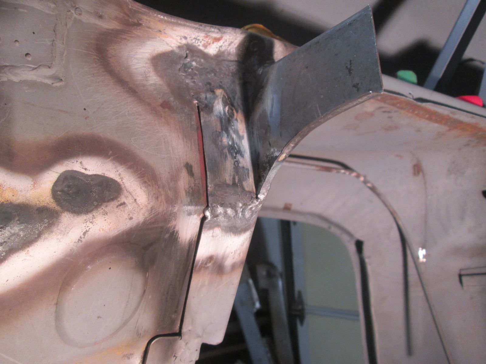

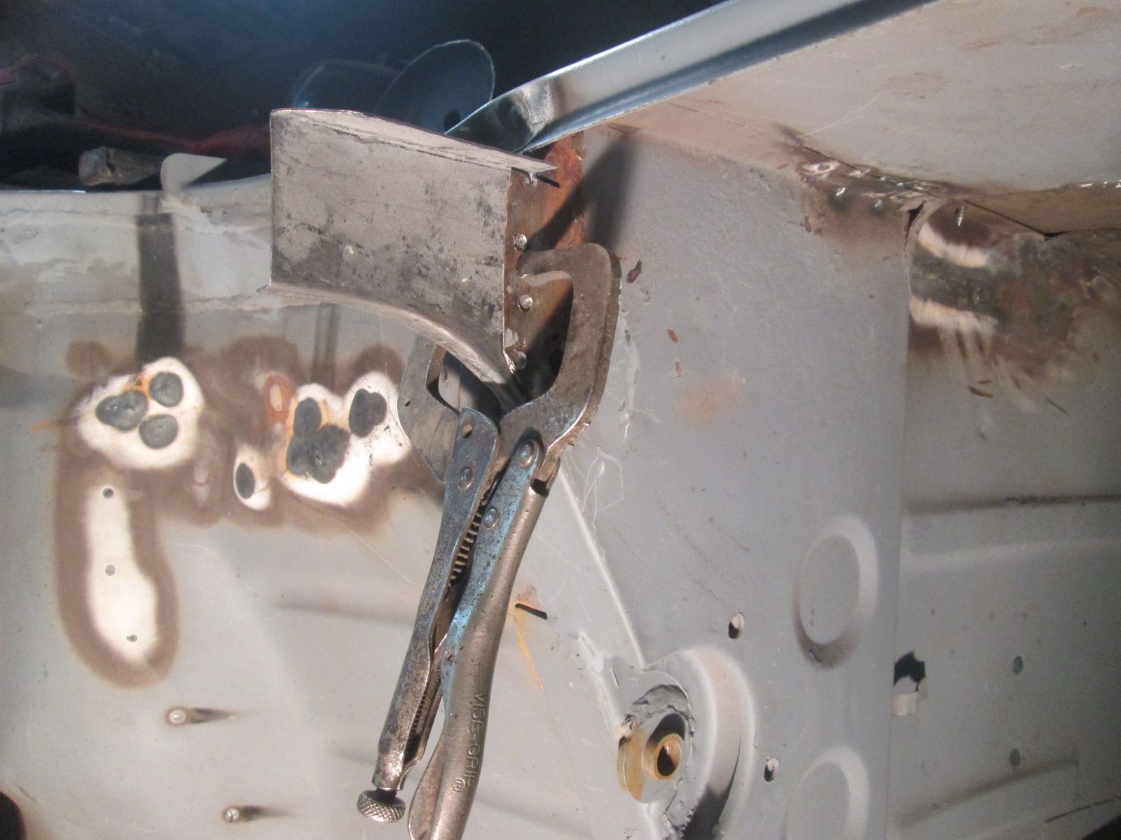

        Click image for larger version  Name:	IMG_3514.jpg Views:	0 Size:	203.8 KB ID:	117315 New tab now fit into best adjusted position and now ready to weld in . Lap joint detail preserved.
        Click image for larger version  Name:	IMG_3517.jpg Views:	0 Size:	191.7 KB ID:	117316 Welded into final position. Tab carries on the arch profile of the cross member.
        Click image for larger version  Name:	IMG_3518.jpg Views:	0 Size:	203.1 KB ID:	117317 Gas welded down the sides with the leading lapped edge left raw as found originally. Repeat right side.

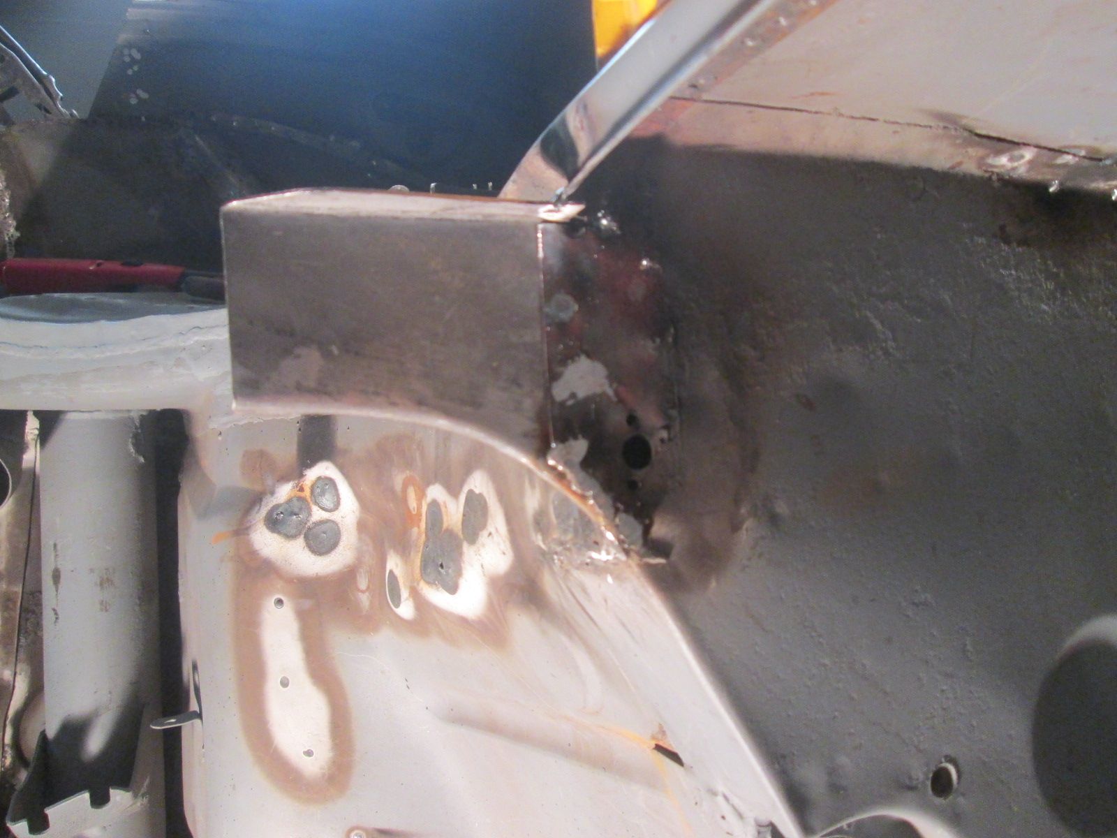

          Click image for larger version  Name:	IMG_3511.jpg Views:	0 Size:	239.4 KB ID:	117319 Installed and fully welded in with rear wire harness hole added. The top portion of the this hole was fused with a seam weld as found originally. A bit of fine adjustment as it went in to ensure it continued that arched opening shape of the cross member as with the left side.

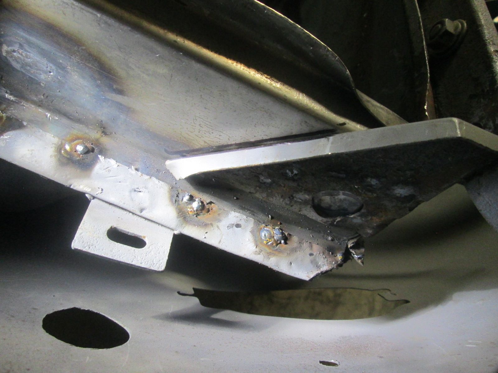

          Click image for larger version  Name:	IMG_3513.jpg Views:	0 Size:	221.8 KB ID:	117321 Then followed up with gas welds along sides as before. Had to make sure the holes edge was blunt with no sharp edges to chafe into the eventual wiring loom.
