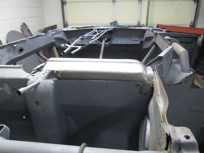

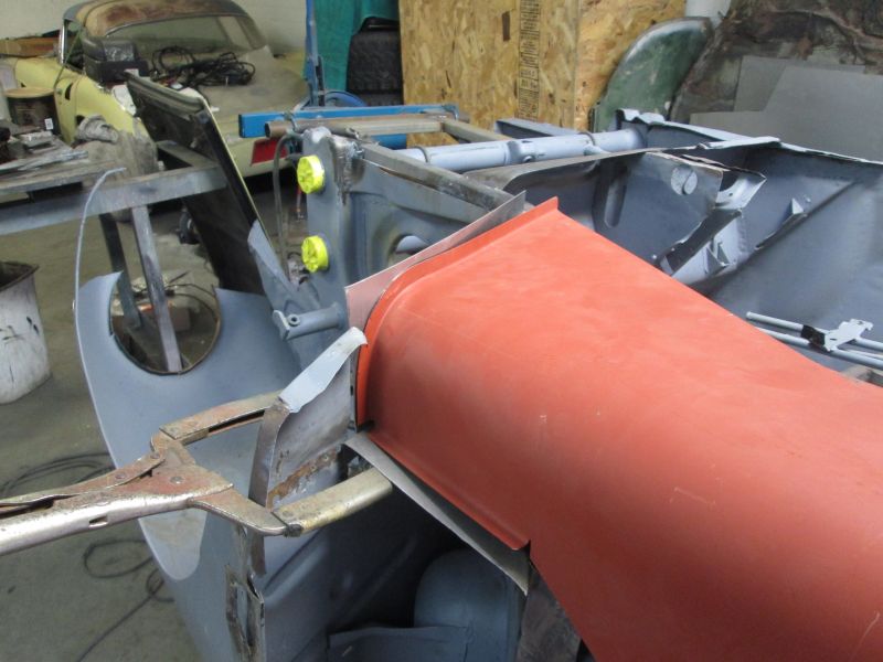

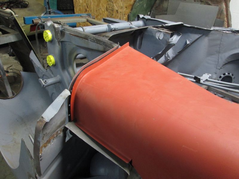

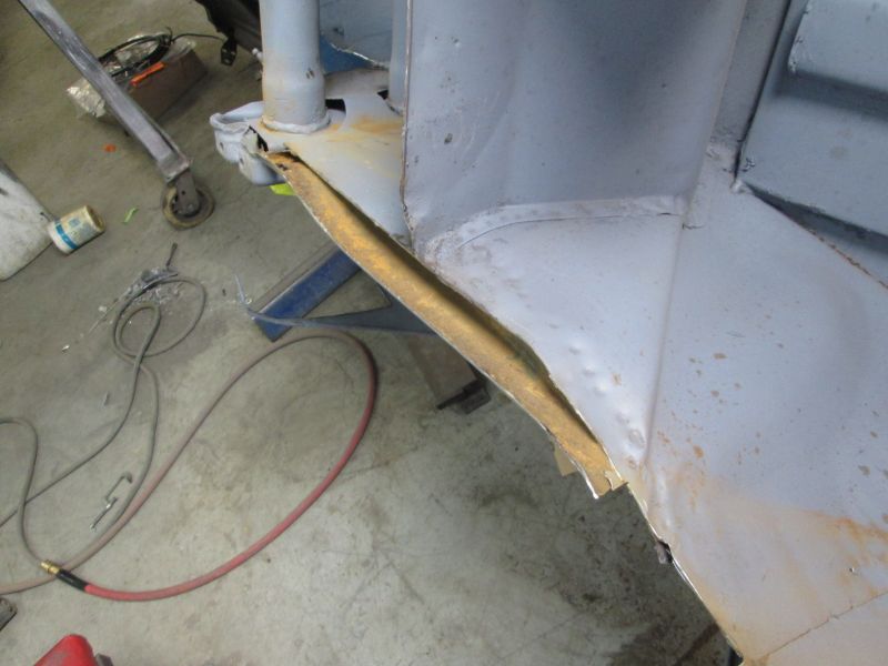

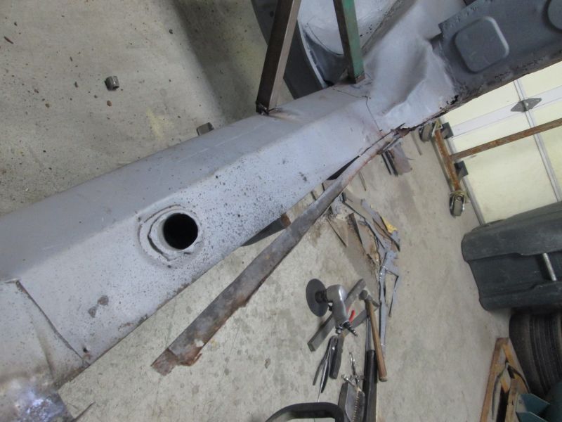

    Begin perimeter flange repair.

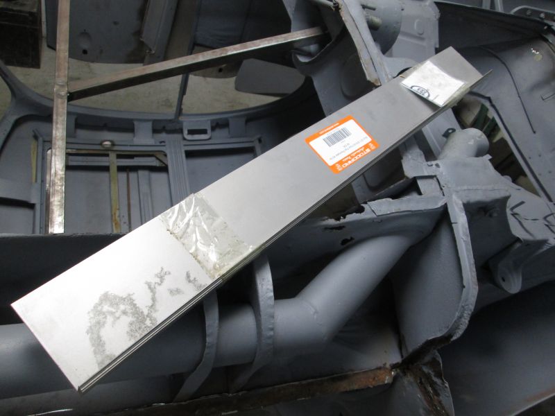

    Out of sheet steel until next week so I'm switching gears to keep things going; it all has be done.
    Just glad I had this kit on hand which I had ordered just as a spare some time back.

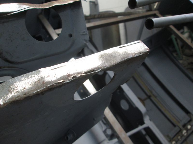

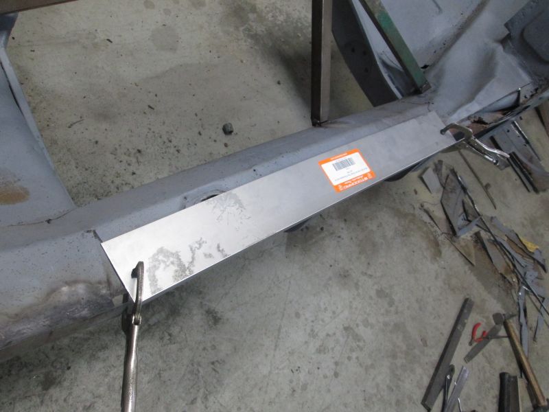

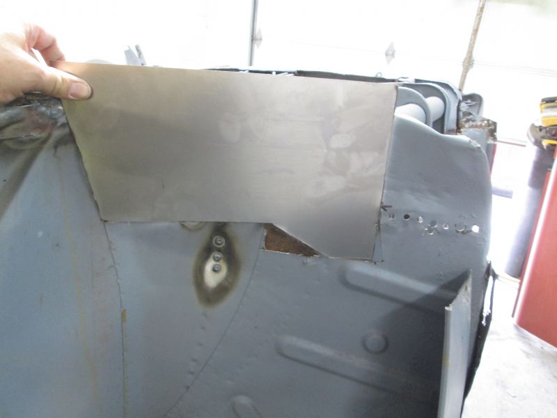

    Again the OG section is wider through this area. I did confirm that it narrows to this standard width as it makes its way back but I'll replicate this width up here.

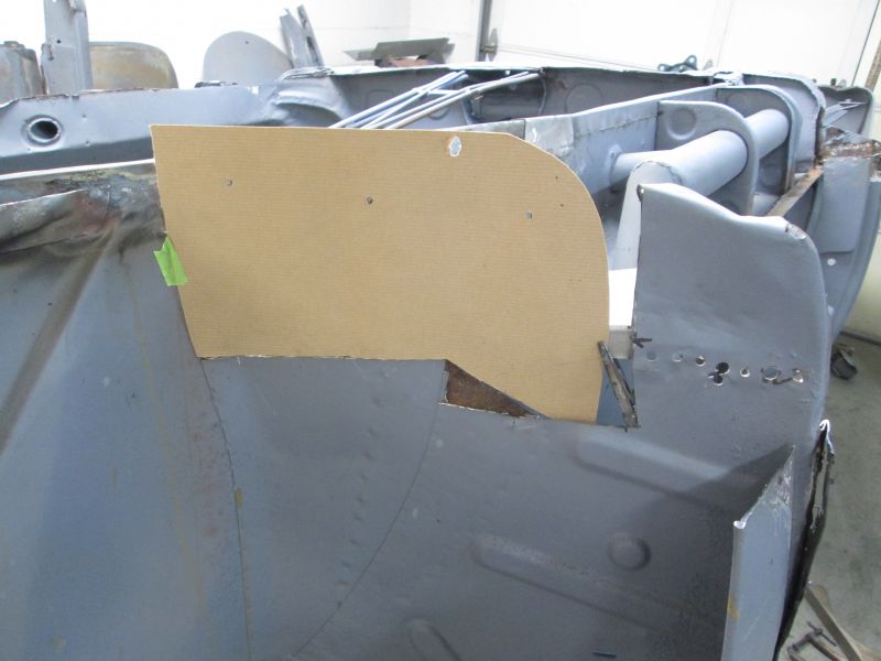

    Very little of the vertical wall on this project needs to be replaced so what would be scrap will provide the flange run I need. What's nice is I'll get double the mileage out of these sections. I found a bunch of other uses for these sections on the coupster project as it went so these are very handy indeed.

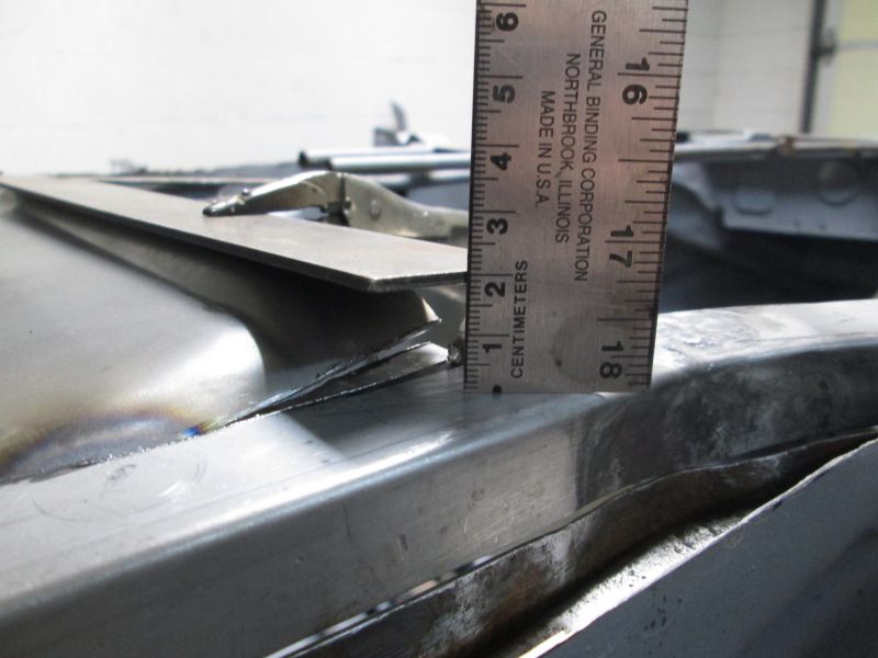

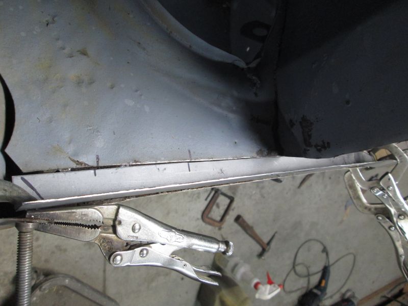

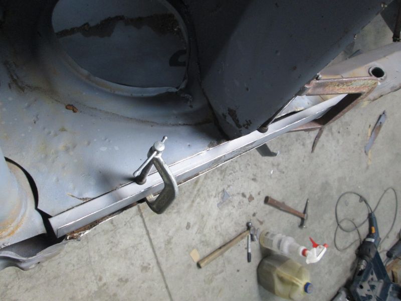

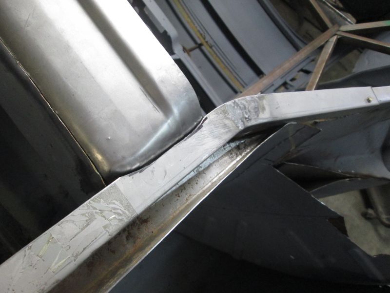

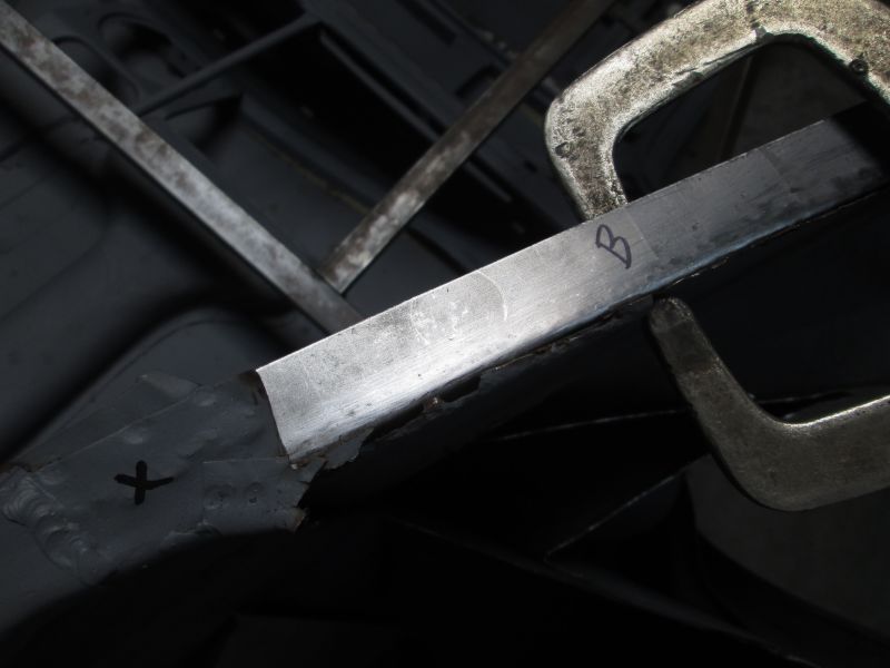

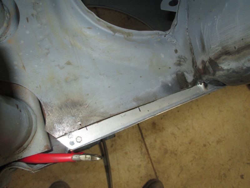

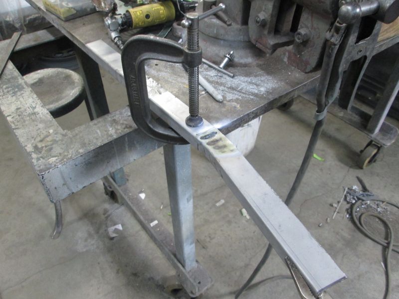

    Establishing the flange height for the cut-off line.

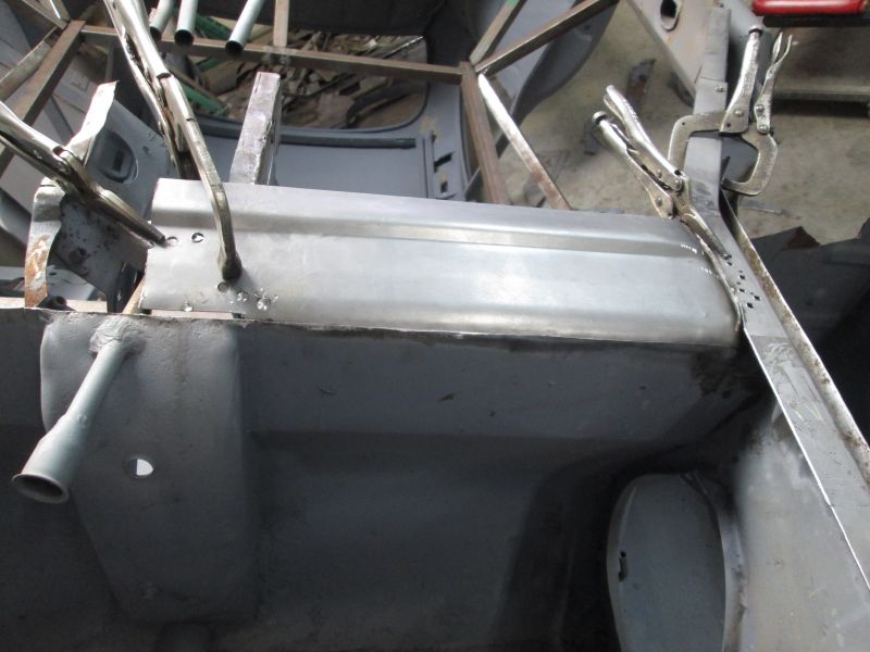

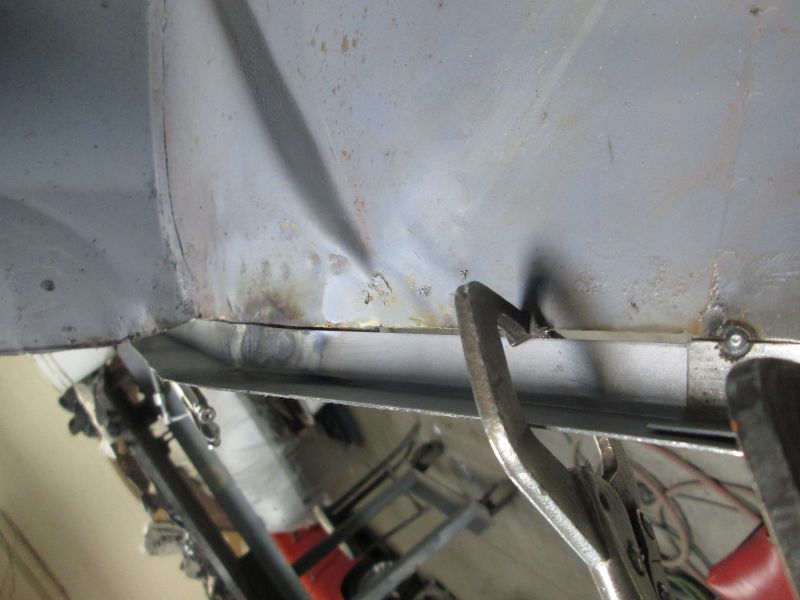

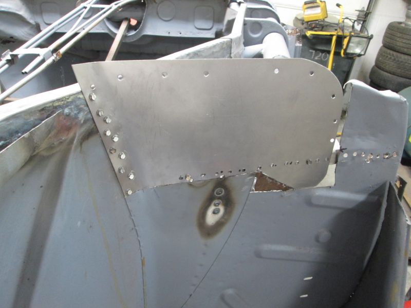

    begin stitching the first section in.

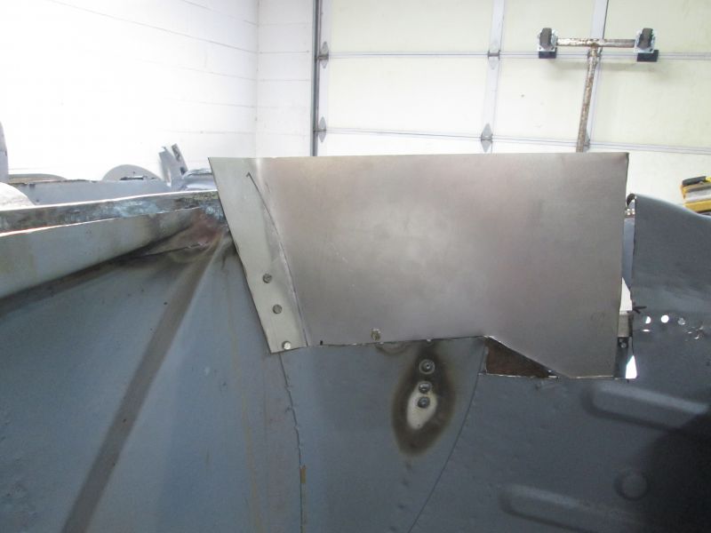

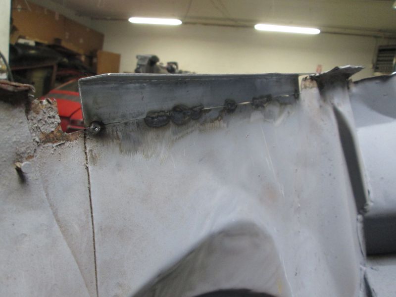

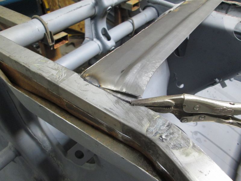

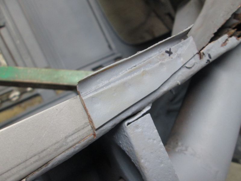

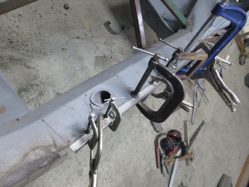

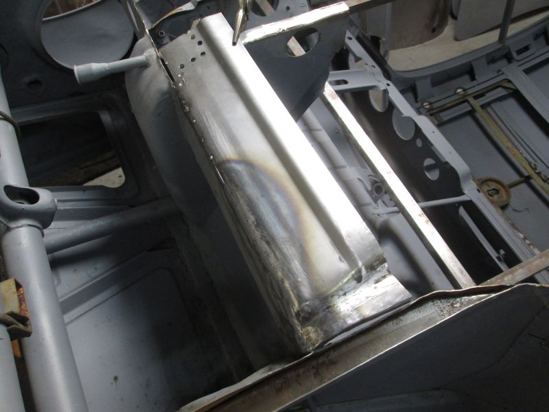

    Nice little short run to begin with. Original lap joints along the wall will be replicated.

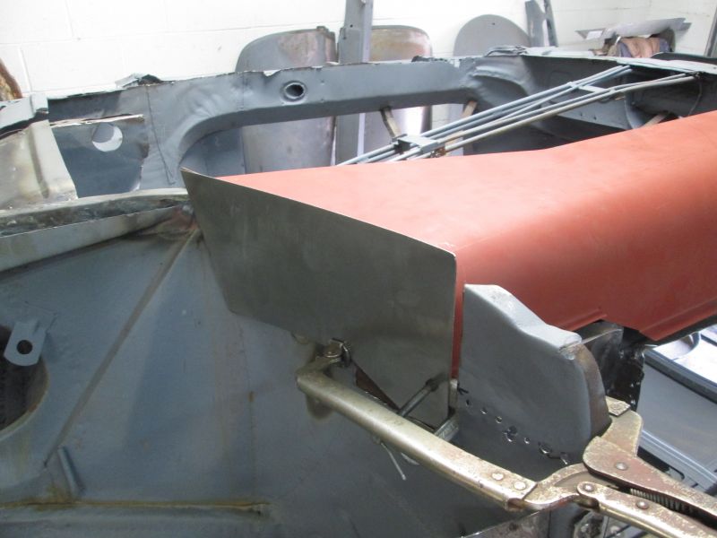

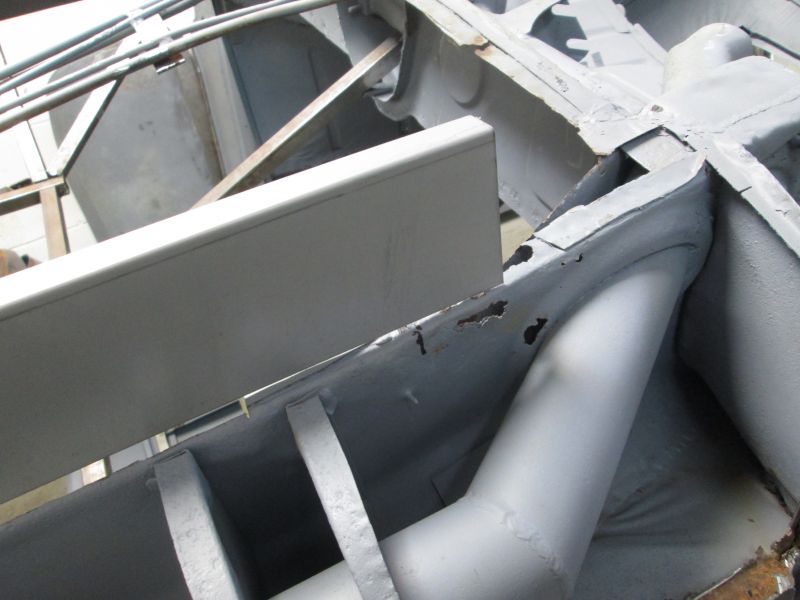

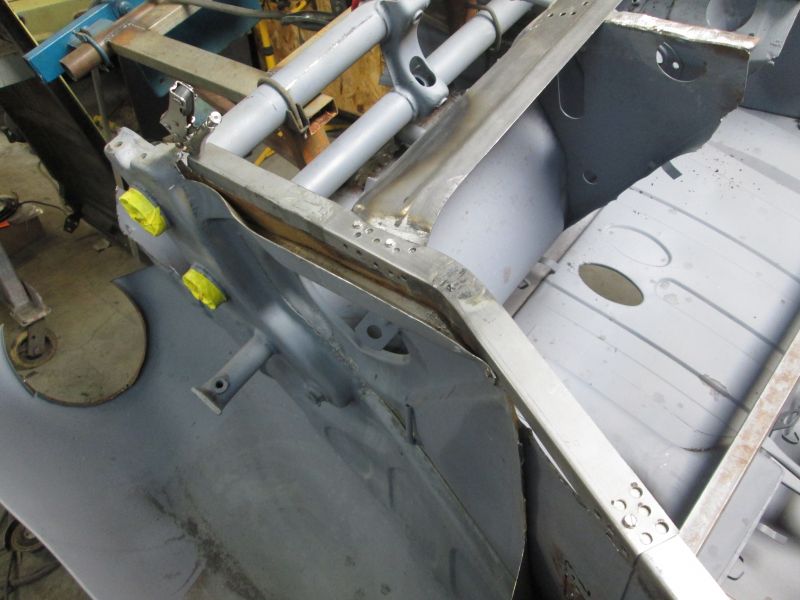

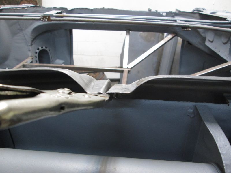

    Quick test fit against the outer closing section. Flange height seems fine.

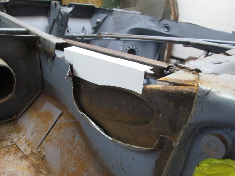

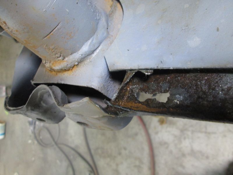

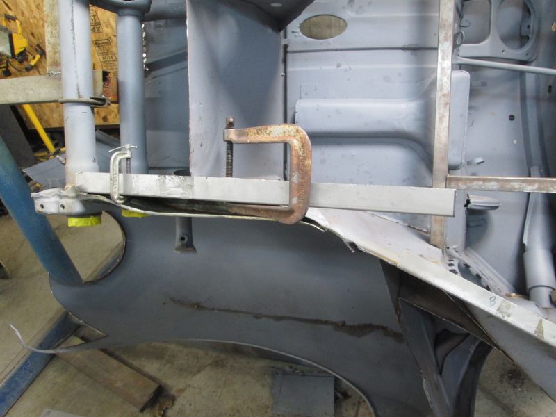

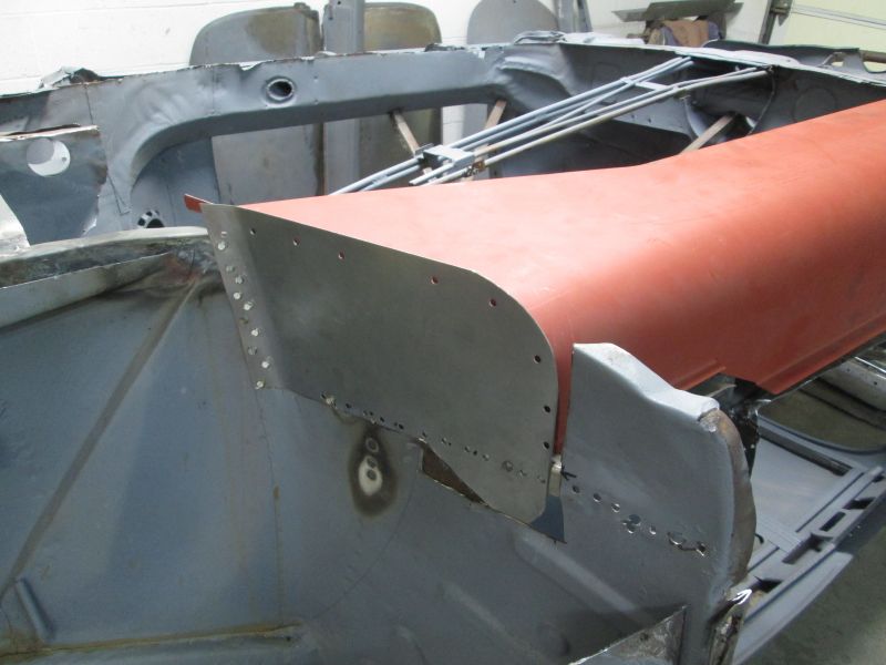

    Wasn't sure whether I'd have to replace the entire flange run all the way up to the end but as you can see the rust gone through up here as well.

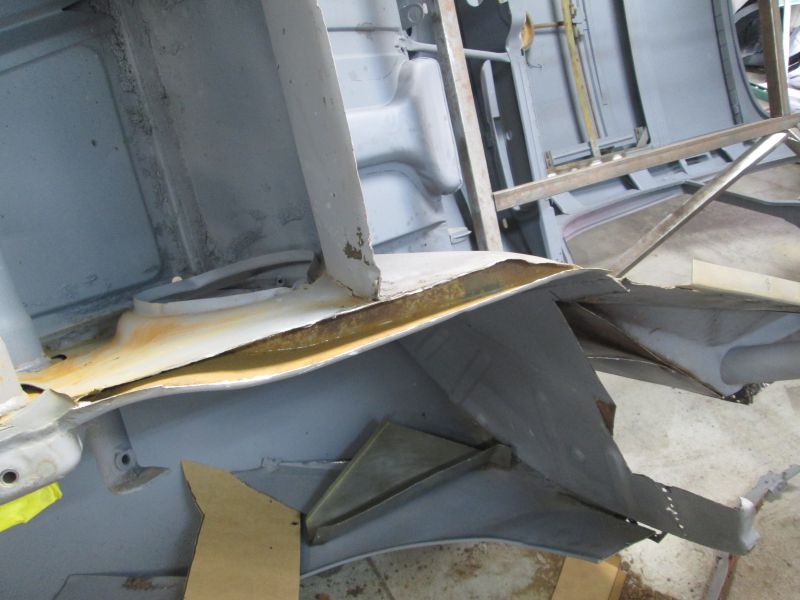

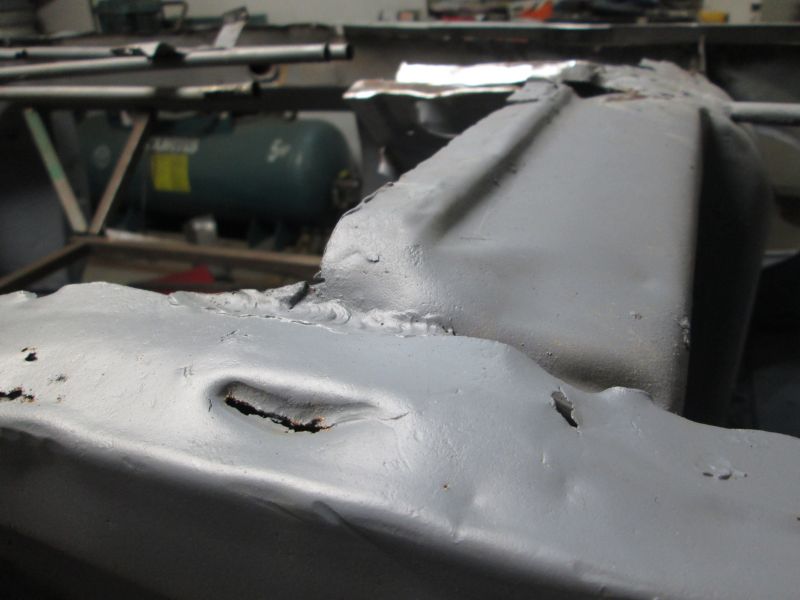

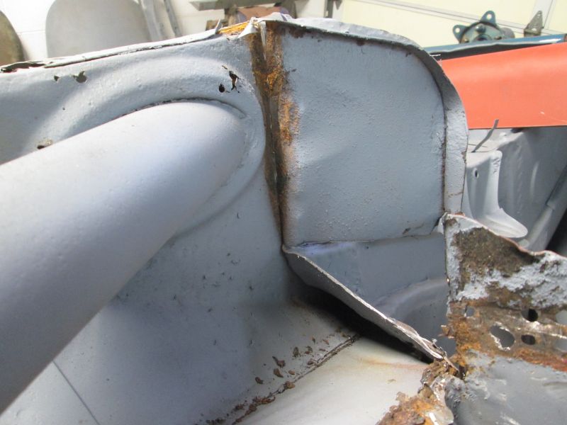

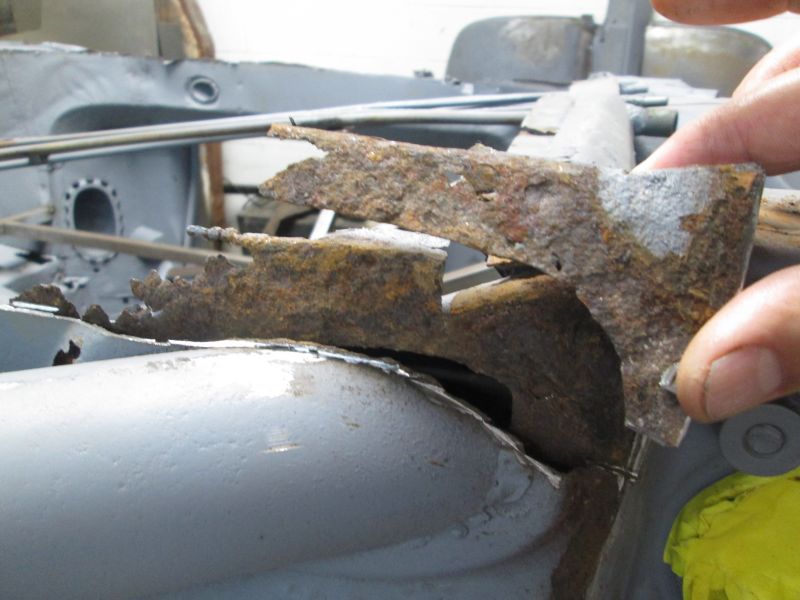

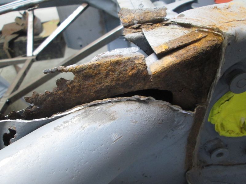

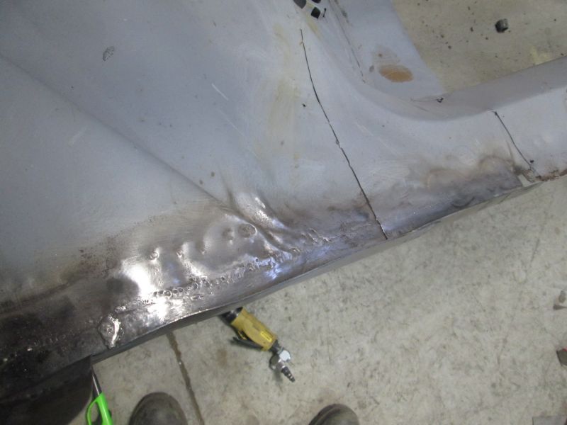

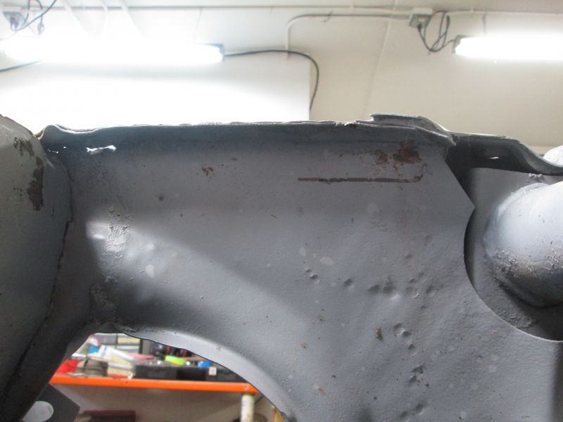

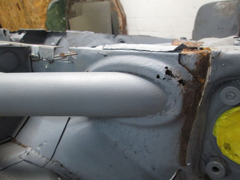

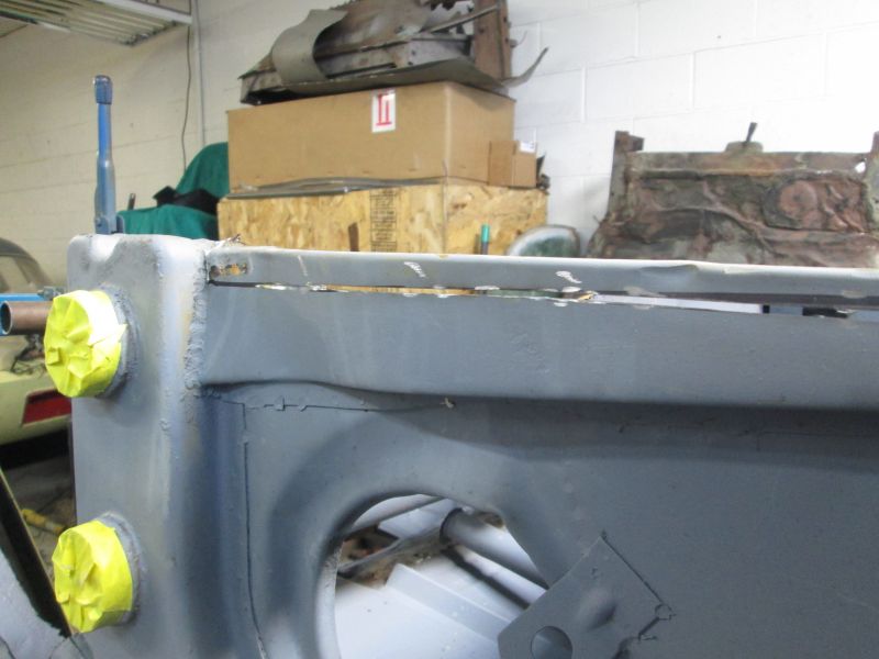

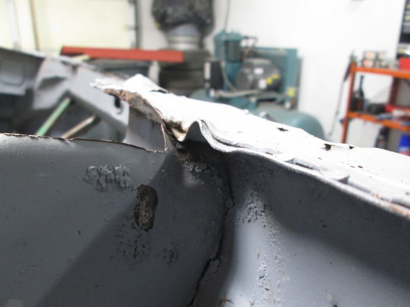

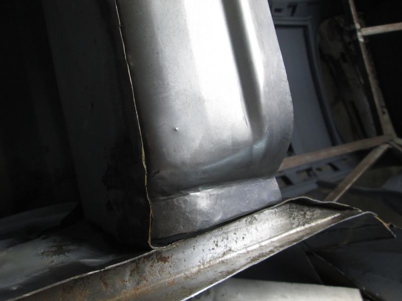

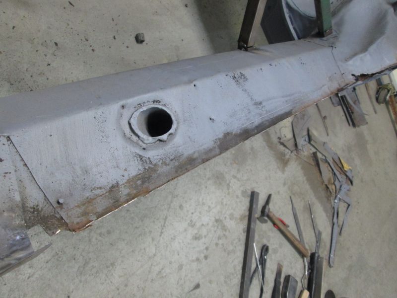

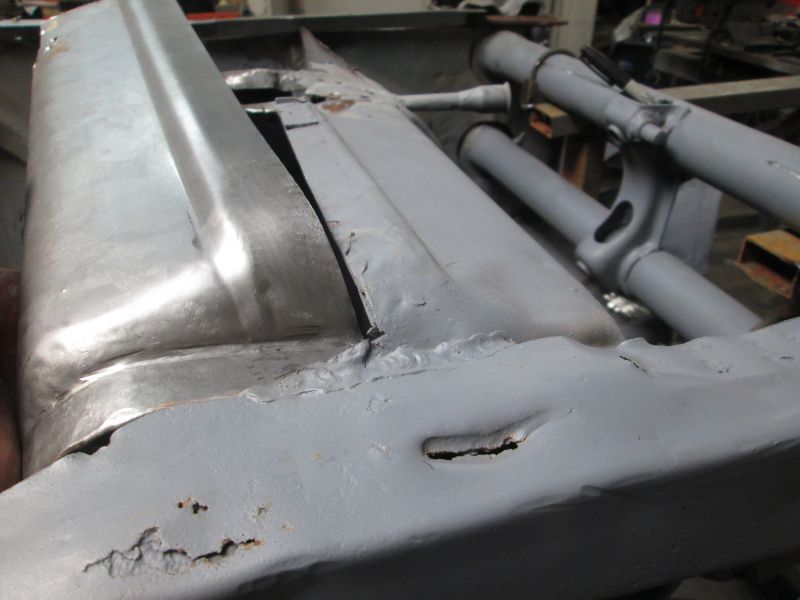

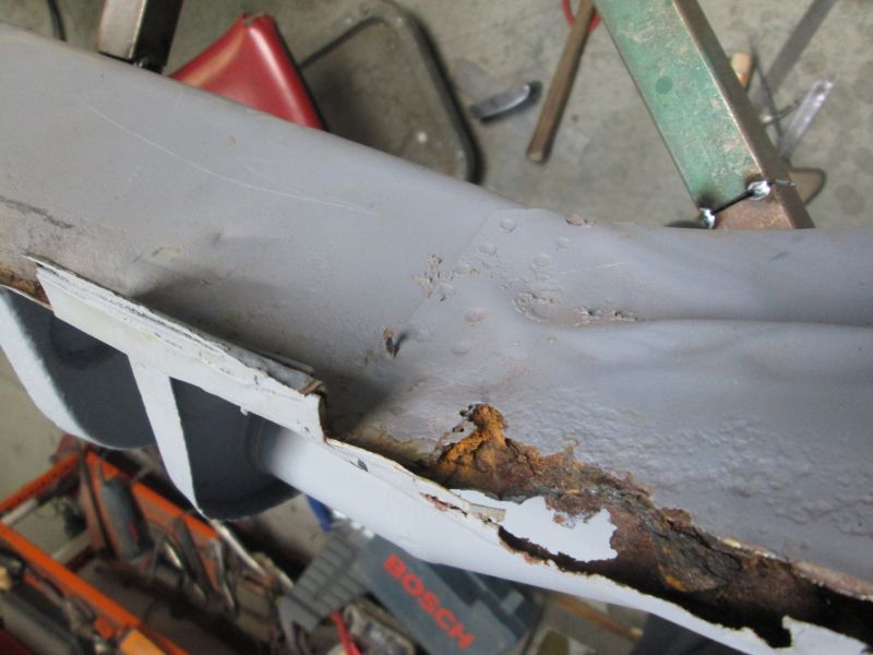

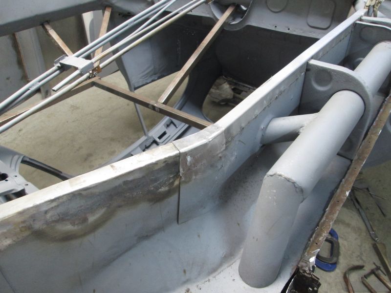

    Also noticed this buckle in it from that old front end collision. This is the side that bore the brunt of it so just more confirmation that the beam has shifted a little. But a silver lining is that its localized here and does not go past this bulkhead wall. This confirms further, my plan of attack of building everything from this bulkhead wall rearward and leaving everything forward of it loose until I can get it on a frame jig to make any adjustments needed to get the beam back into square with the rear beam.

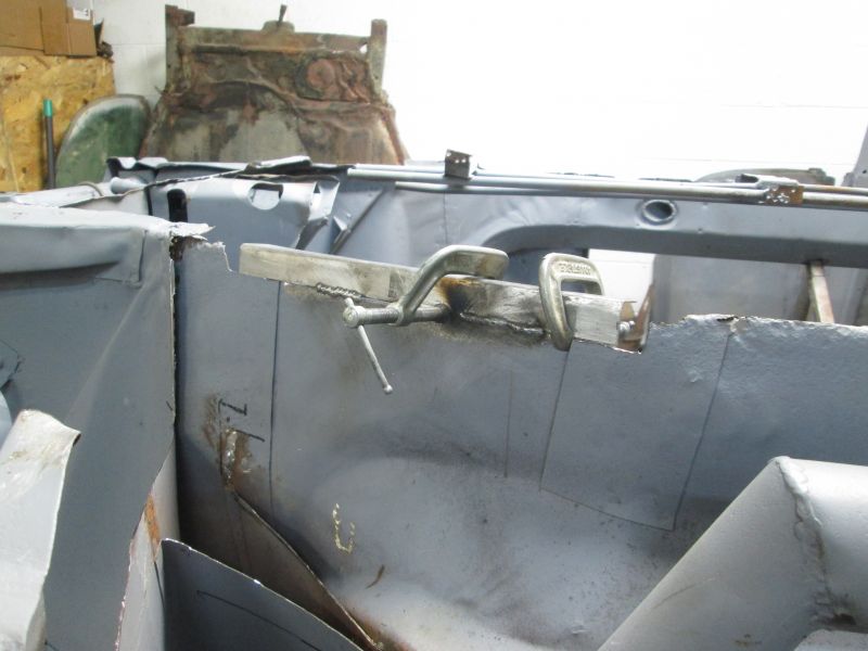

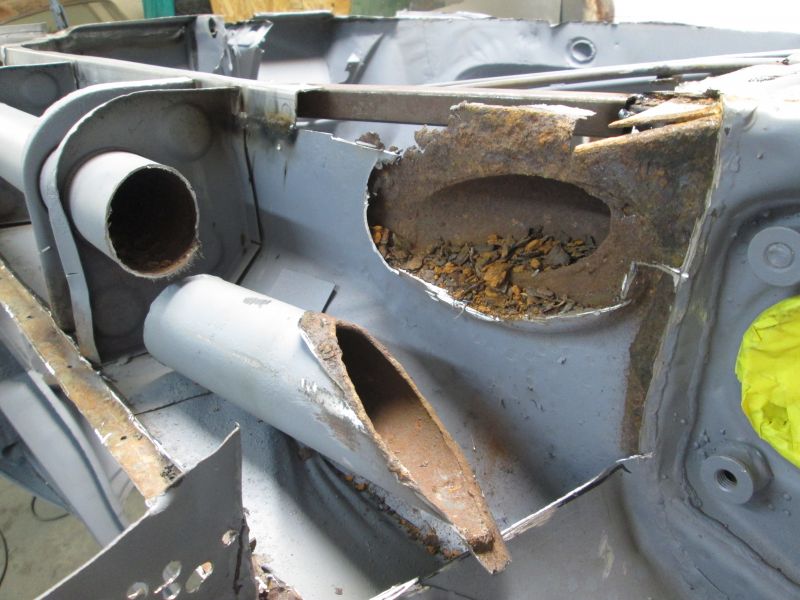

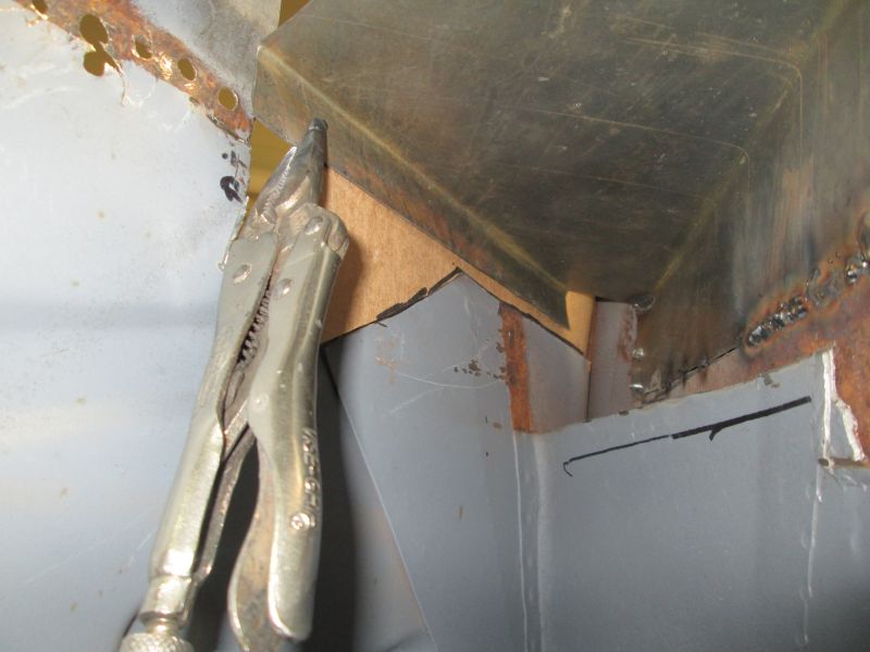

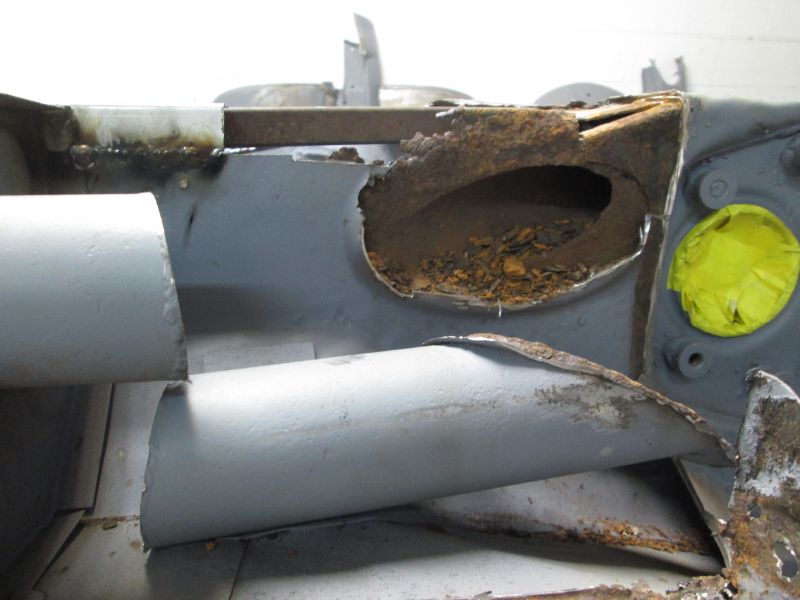

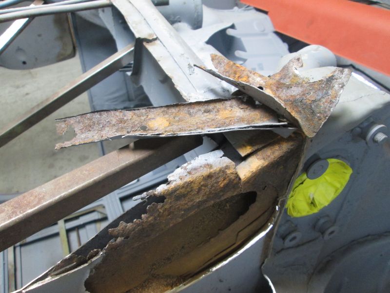

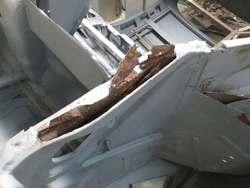

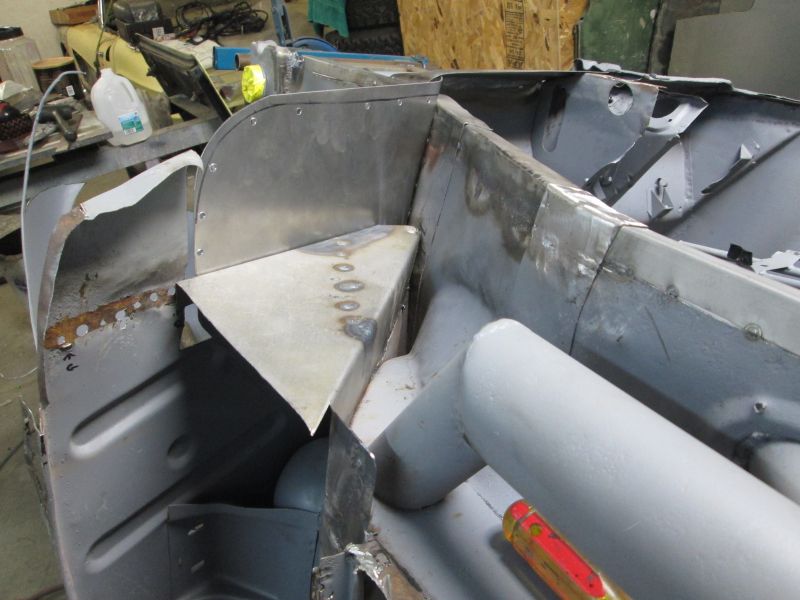

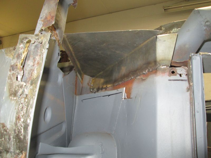

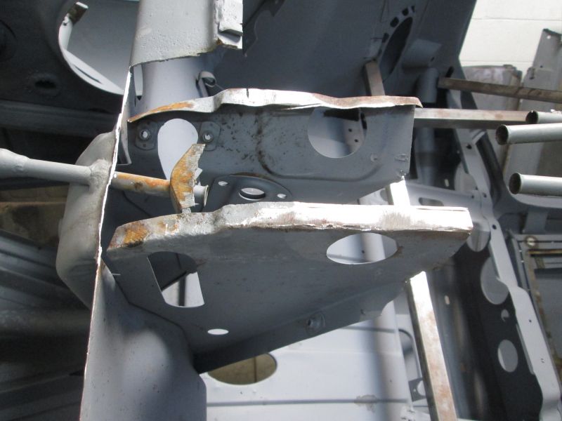

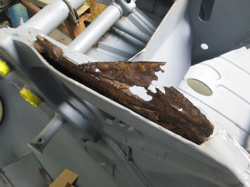

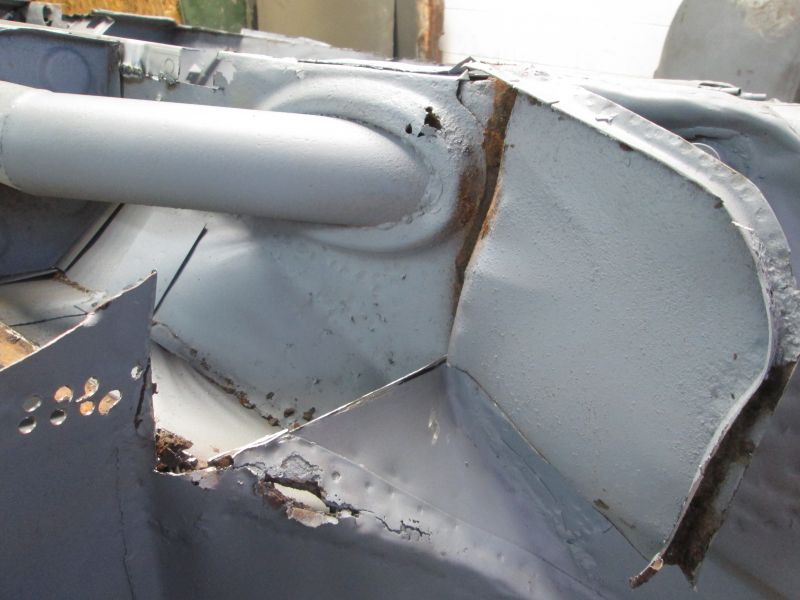

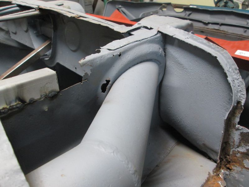

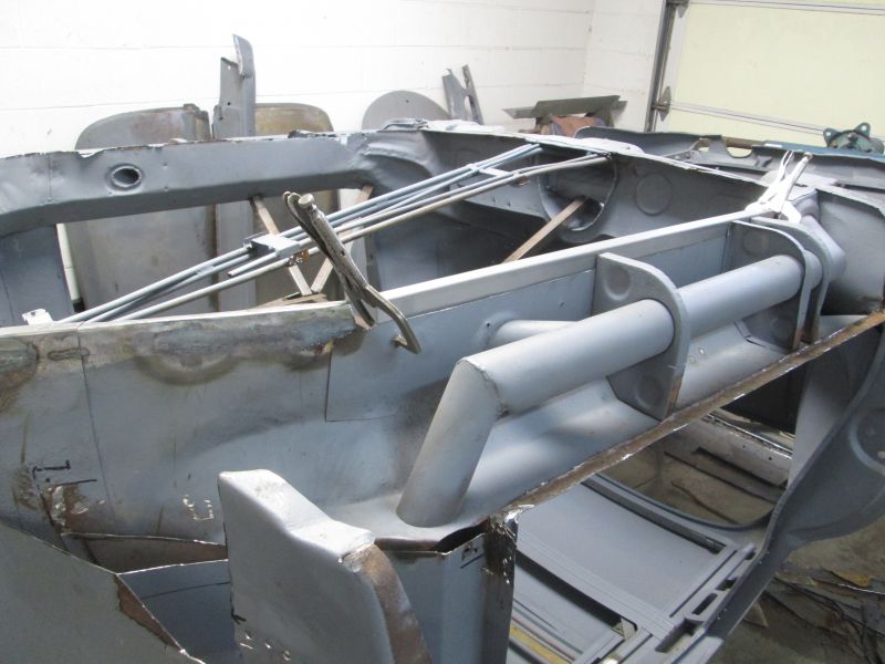

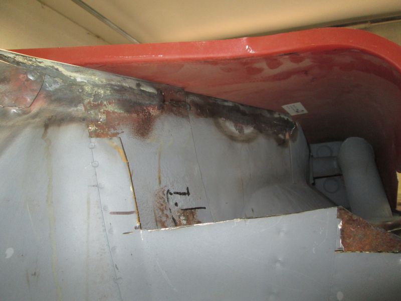

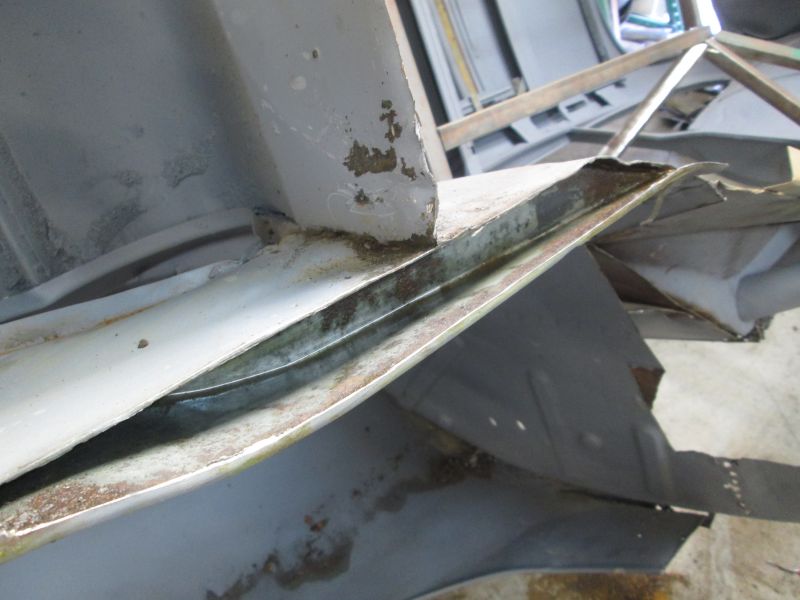

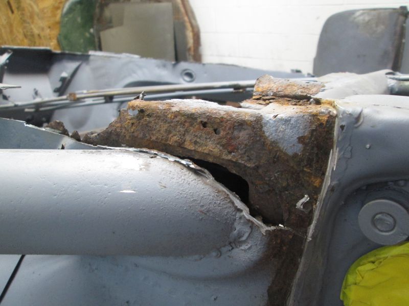

    Begin forward flange repair prep by opening the reinforcement gusset.

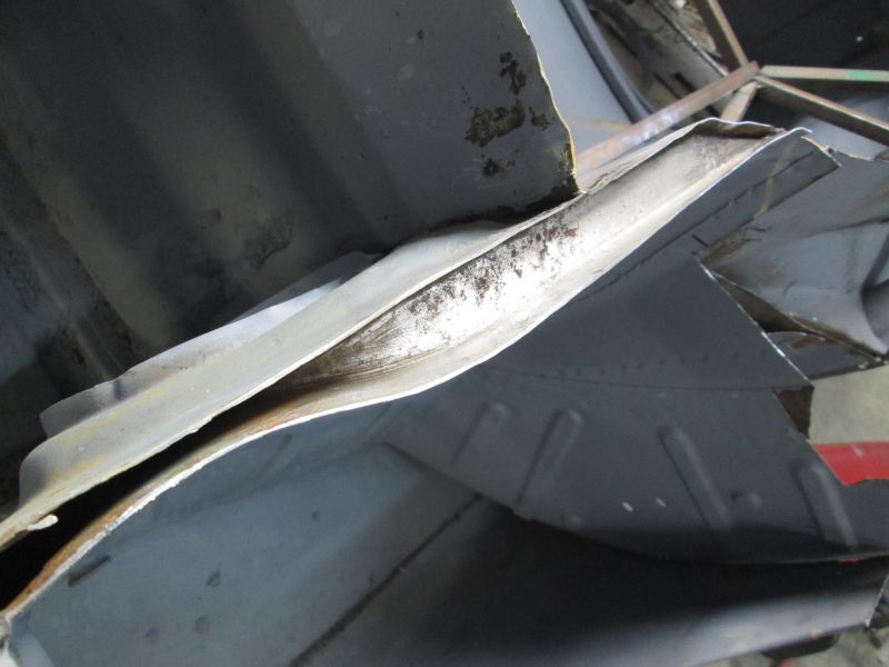

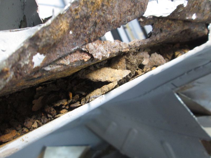

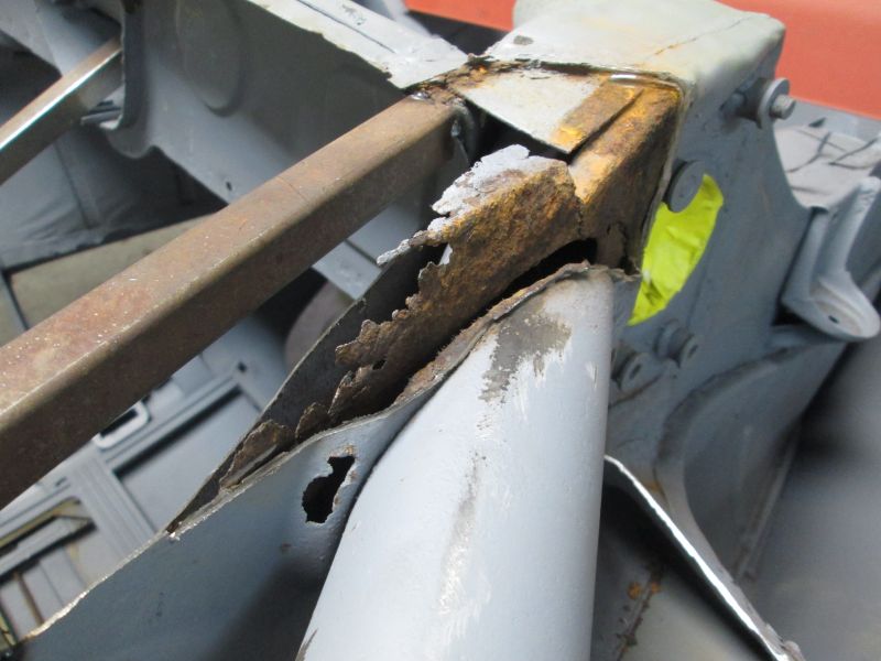

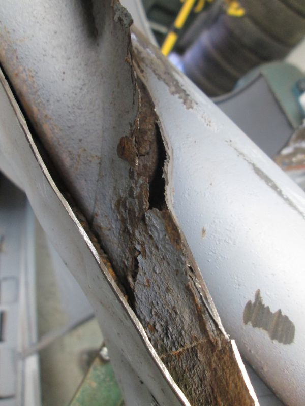

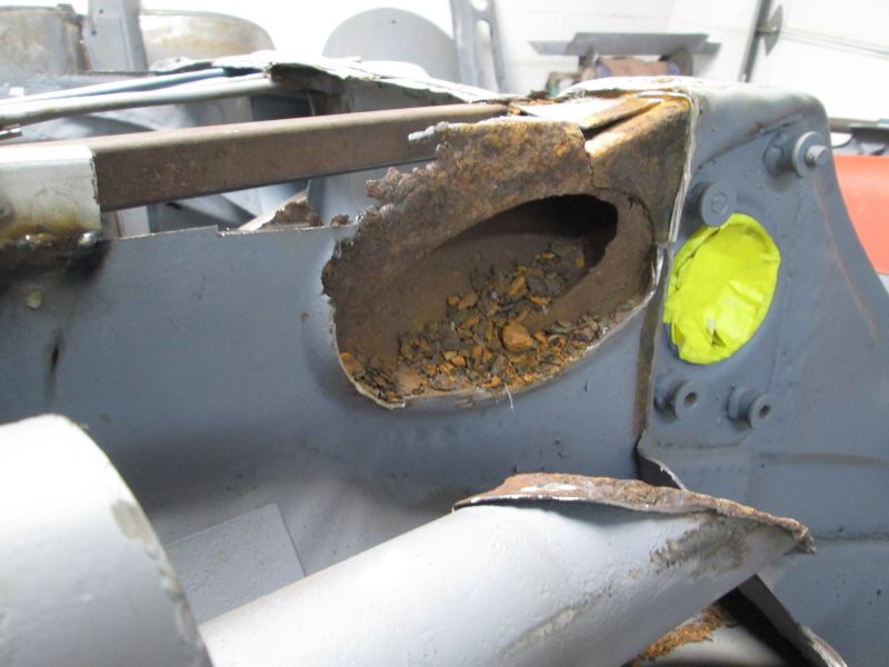

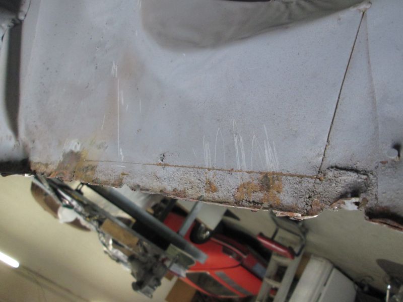

    A lot of heavy thick scale in here. This was full of water on more than one occasion.

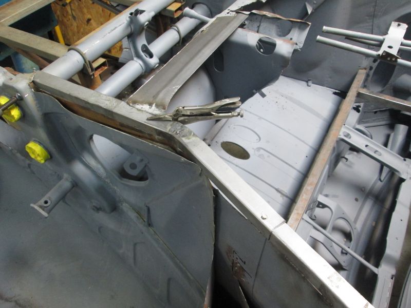

    Continuing on with this section of the flange.

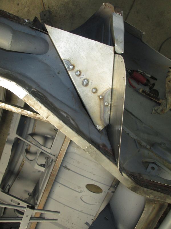

      Forward flange section removed

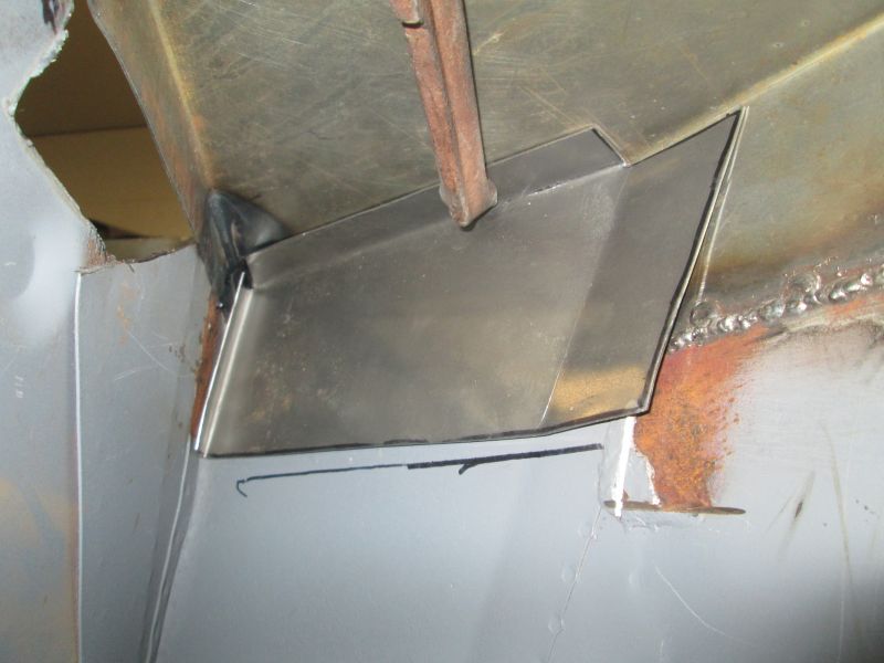

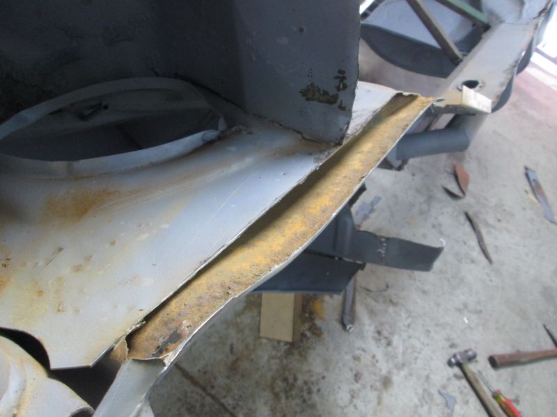

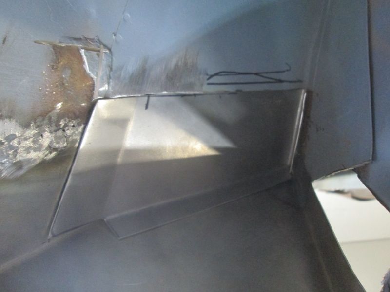

      Going to save most of the original gusset except for of course the bottom and about a 1/4 inch of this vertical wall where its gone through.

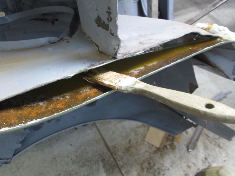

      Hard to see but at this angle it made a nice holding tank so I pooled some acid in there to begin clean up.
      Continuous bathing as it slowly dissolved the scale.

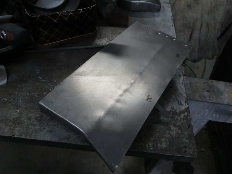

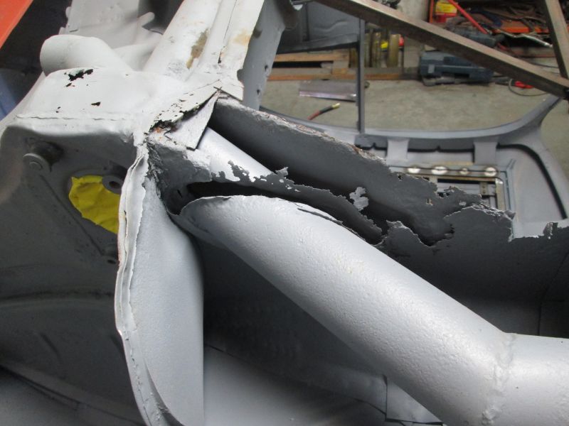

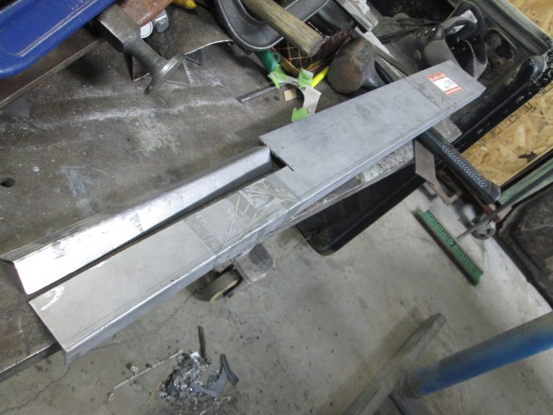

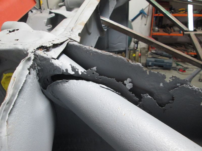

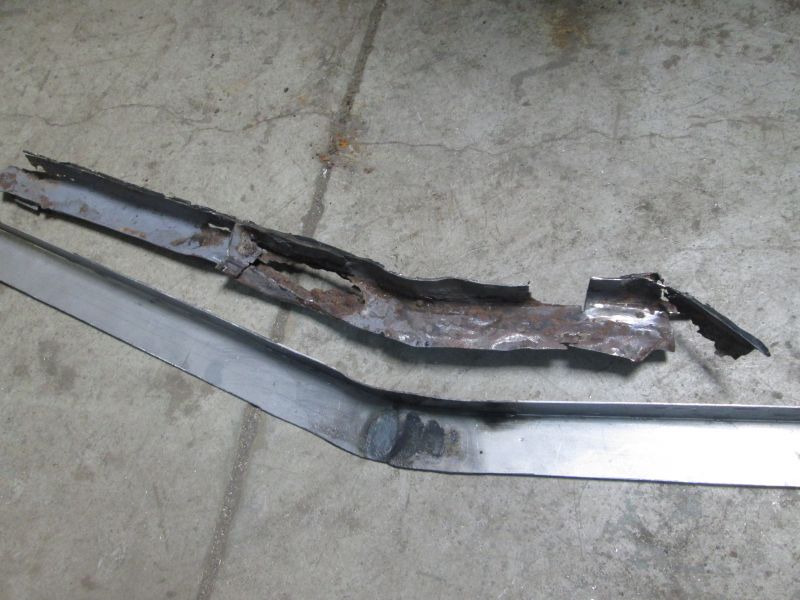

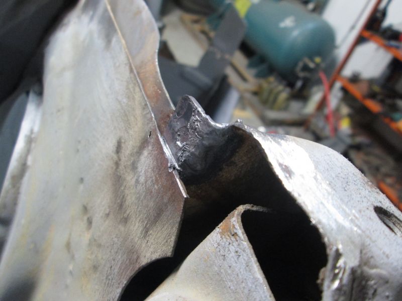

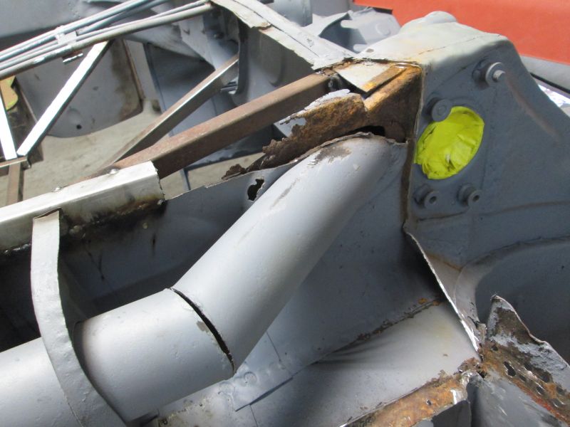

      As I said before its a mixed bag. This forward section got so bad that the last bit of heavy gauge flange of the suspension that the wall attached to has gone.

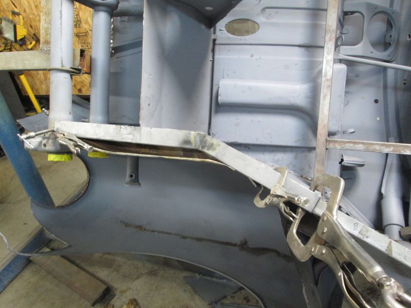

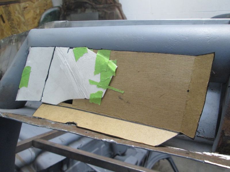

      New runner section trimmed back to the width I need.
      Now its got to make the turn.

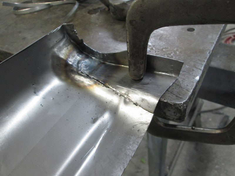

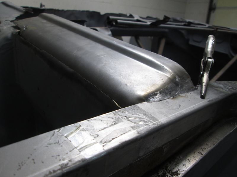

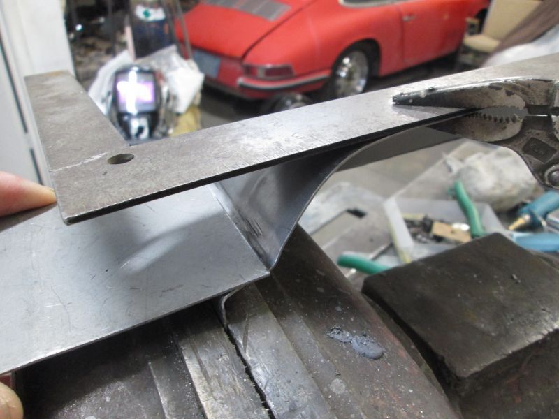

      Always used a series of relief cuts for this bends on my previous attempts but I went with heat this time as I get more and more comfortable using the torch.
      Several rounds of heat and refits but I eventually dialed it in. Like this much better than the cuts.

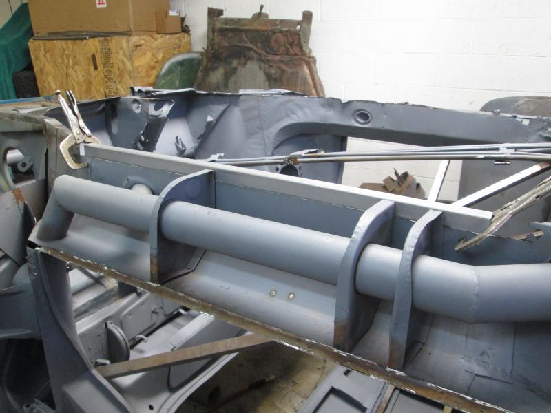

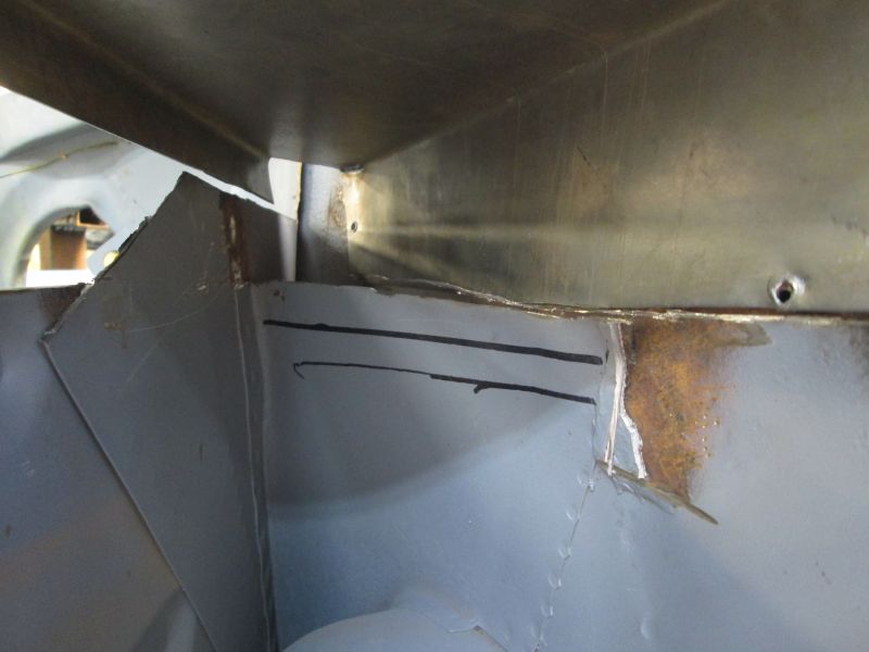

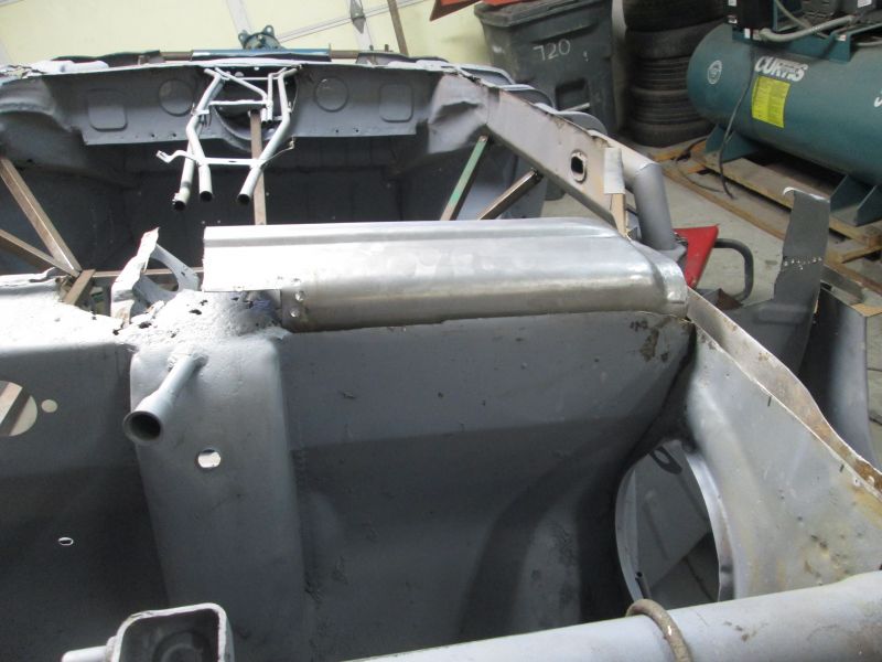

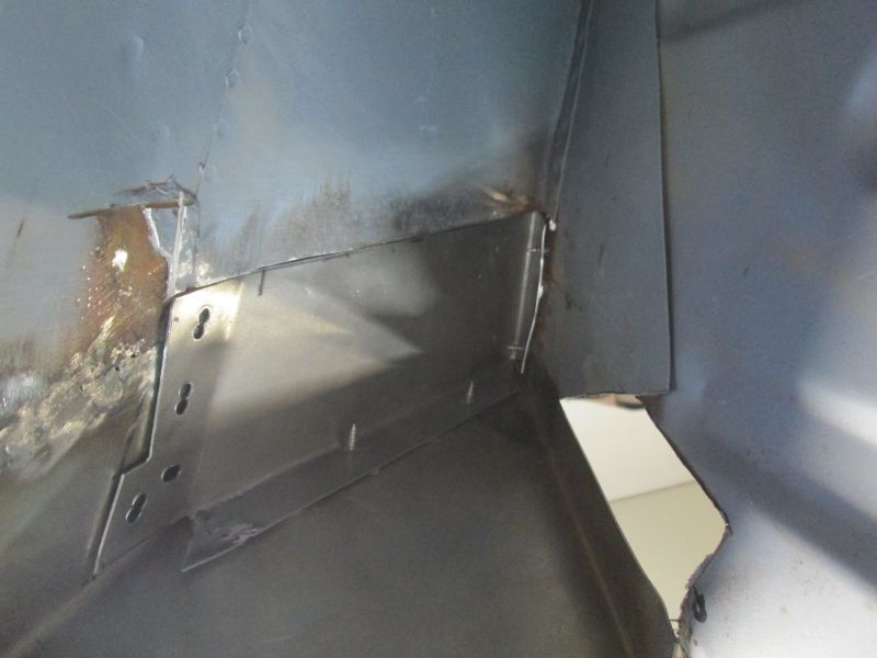

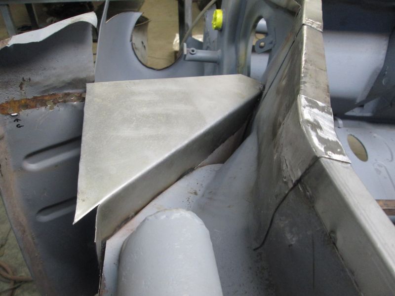

      I was just about to begin tacking this flange on then I remembered that forward bulkhead wall flange will be harder to weld and dress with the new lateral flange sitting on top of it.

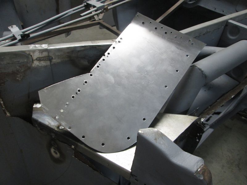

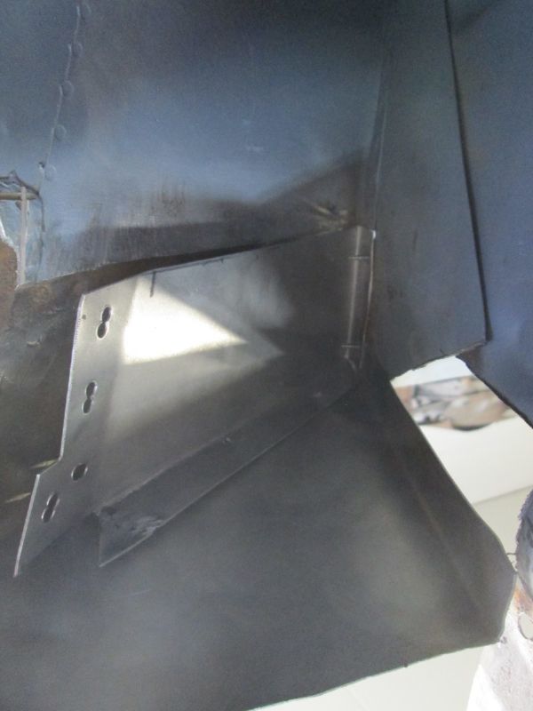

      The time is now to get this portion of the bulkhead wall repaired. I have found installation much easier by cutting this new section in half. Once its complete that weld joint is buried and supported a couple of times over.

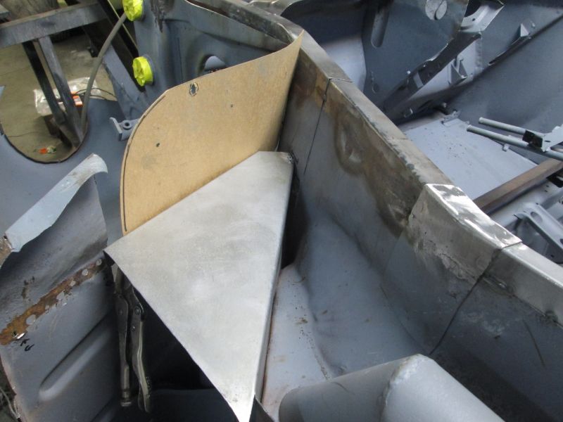

      Will be cleaning and prepping this forward center next so I can get this half of the new flange in.

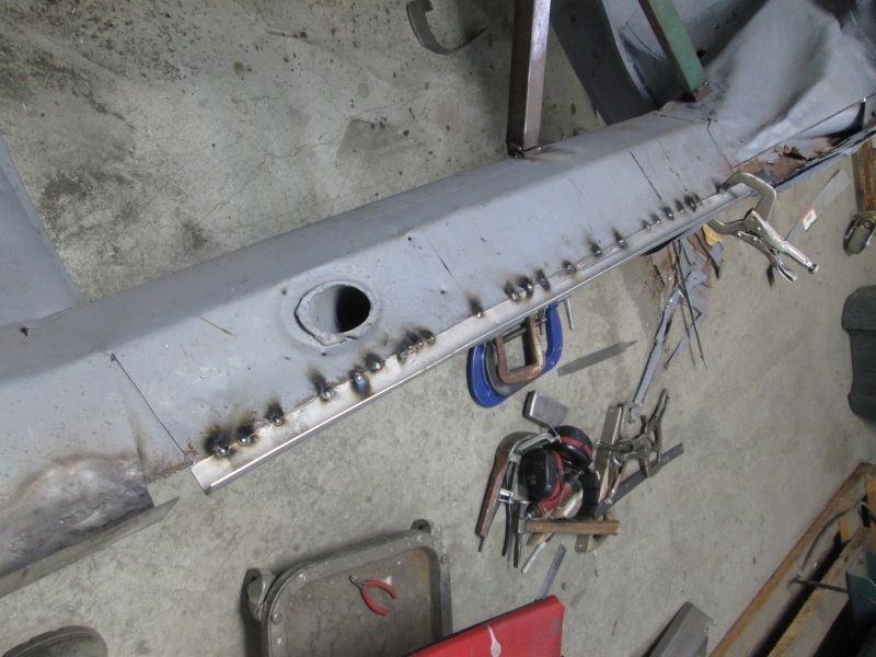

      Then I can go back to installing the lateral flange section it hides under.

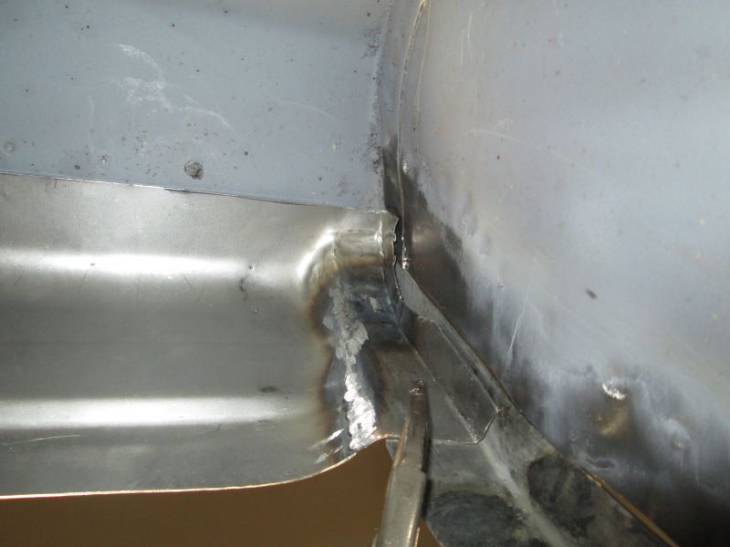

        Much easier and cleaner to weld this inner corner up first than to do it with the new flange runner over top of it.

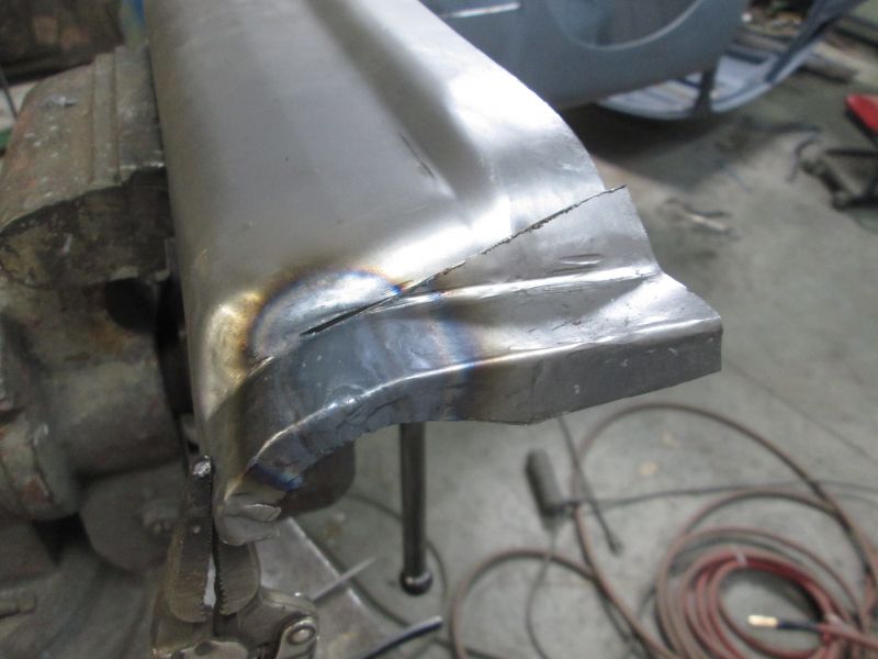

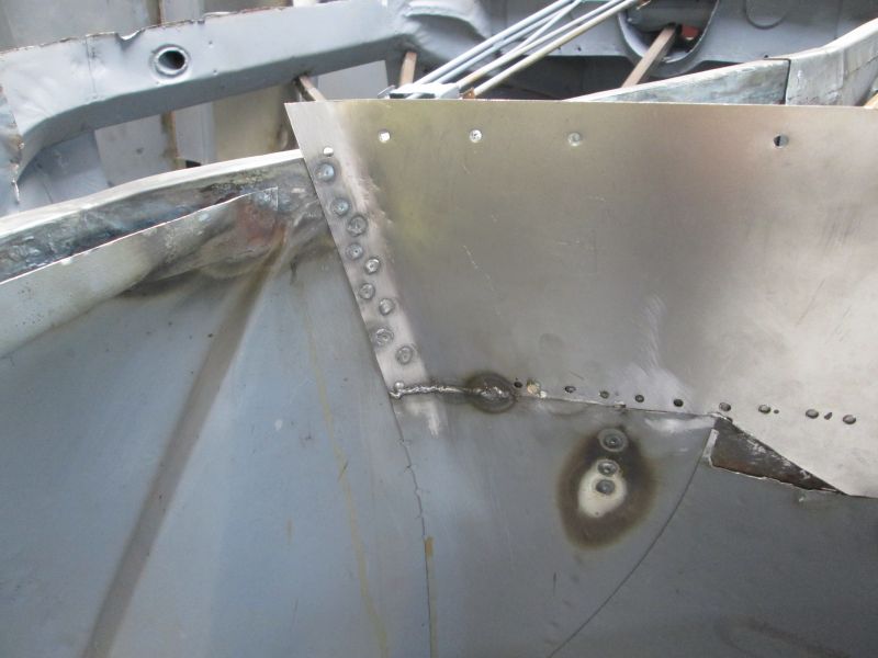

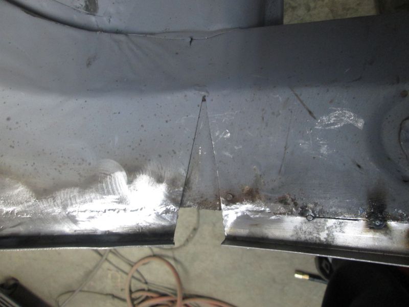

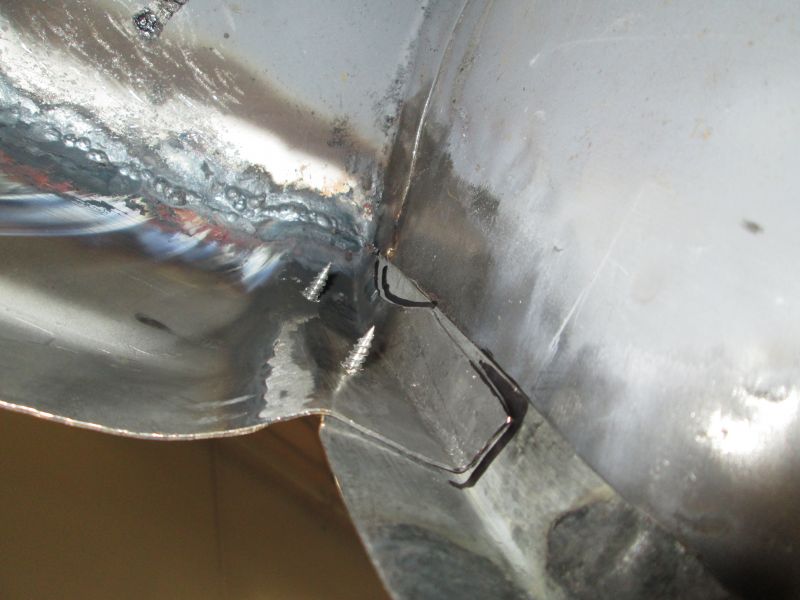

        Began trimming a relief in the flange to allow the inner mating lip to come in enough to reach the vertical wall.

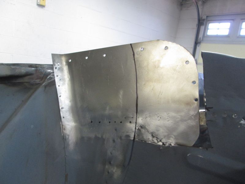

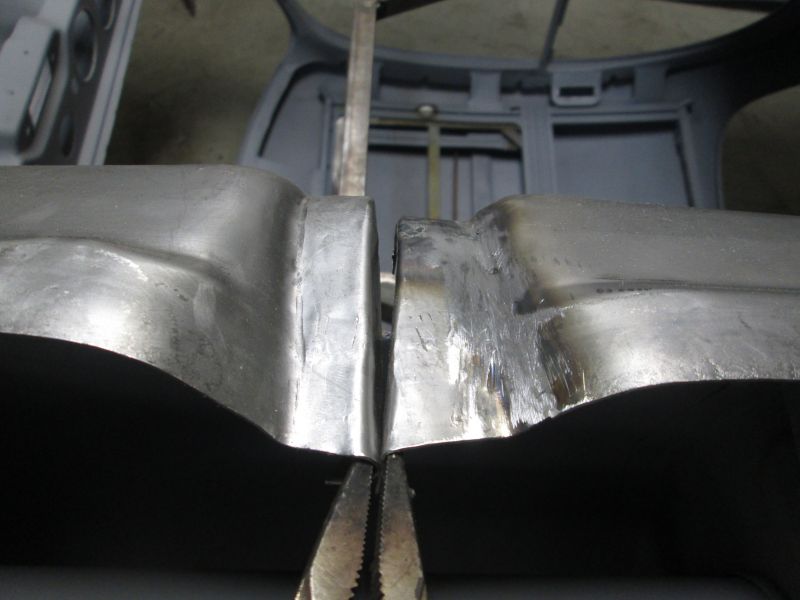

        As this progressed it began to dawn on me that this flange and corner relief wasn't shaped quite right. At least not for my purposes.
        Also noticed that the drop flange relief is a little too strong compared to the OG.

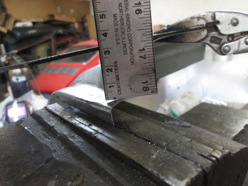

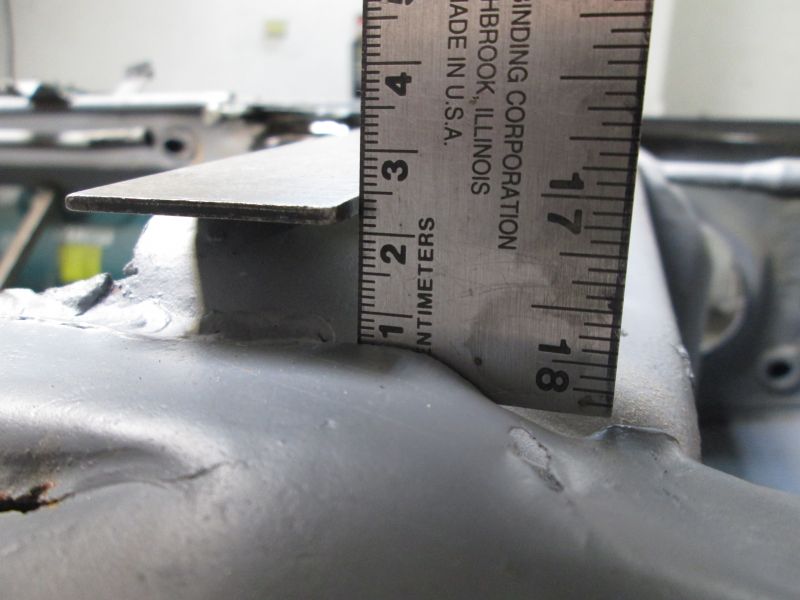

        Test fit to dial the new height I'm looking for.
        Coming in right around 20mm. Close enough...

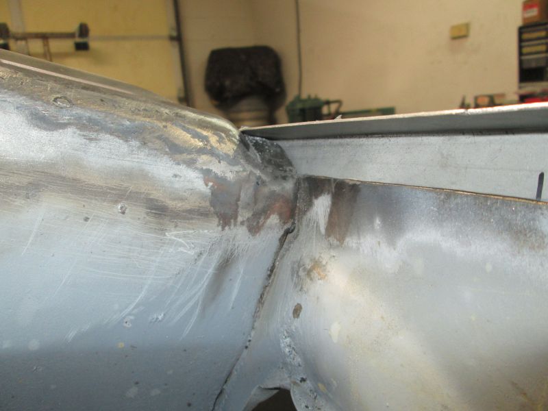

        Carries the line and attitude of the original section in the background.

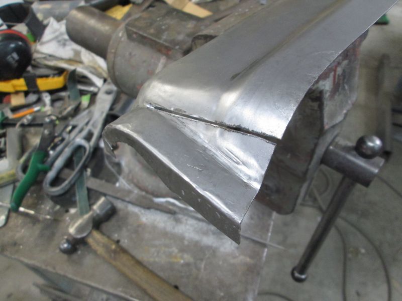

        While I'm at it I can use the excess metal to widen the mating flange.
        Lowered widened and welded up.

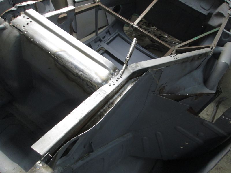

            New section seats in just fine.

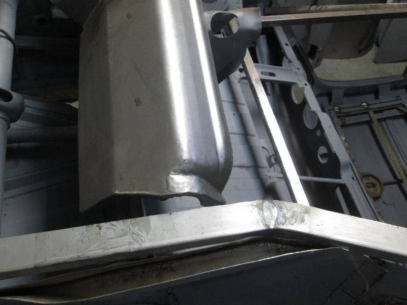

            The inside will clean up fast. Once I run across a few gas beads this transition will be hard to detect.
            Again would have been impossible to clean up that corner weld joint with the flange hanging over it.

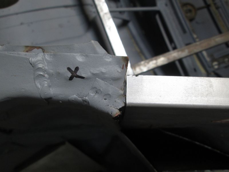

            All plug welds punch and was about ready to start welding this on

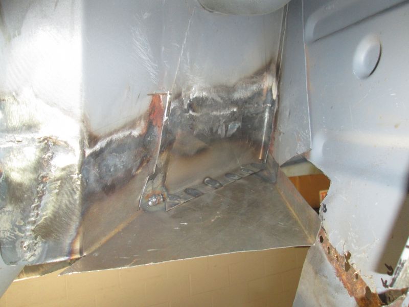

            Then I remembered there was one more loose end to tie up. Had to repair the lower corner of the suspension flange with some heavy gauge.

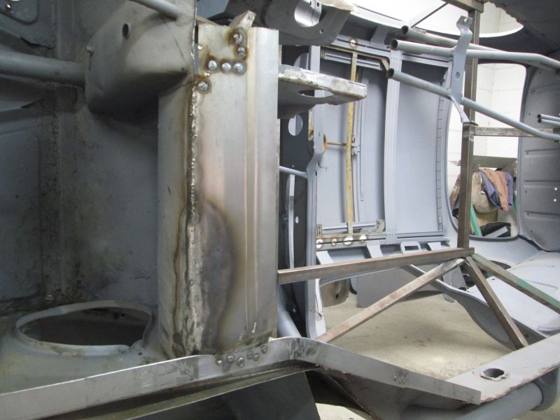

            Sticking with my plan I'm going to leave everything ahead of the bulkhead wall loose until I get the front beam squared. That set screw at the front will have to do until then.

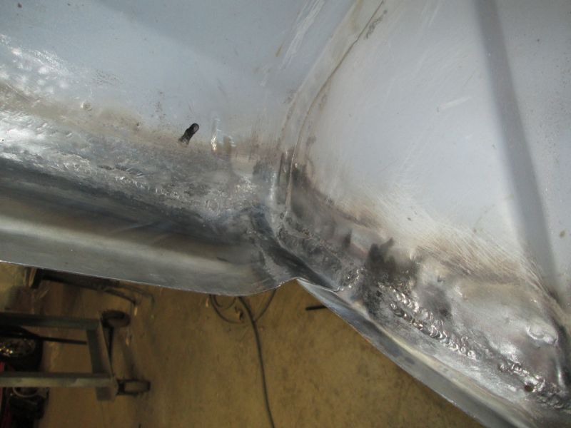

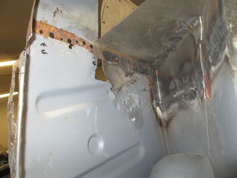

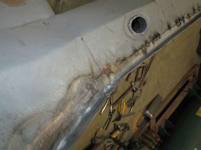

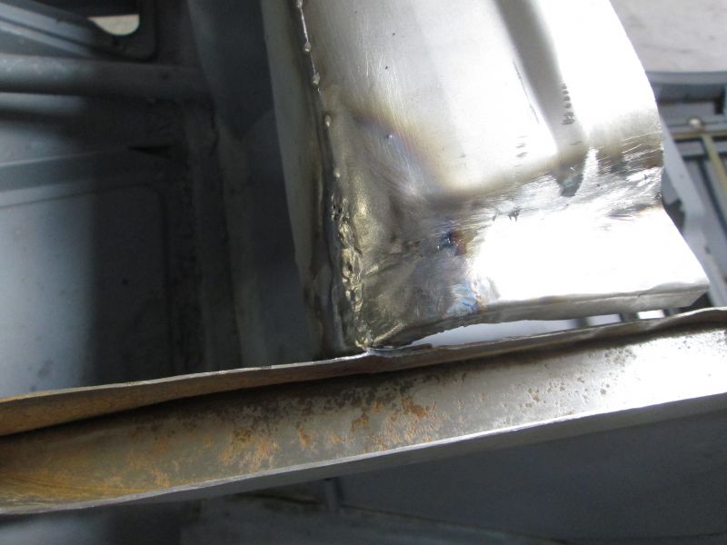

            Joint seam along the bulkhead finished out smooth. Onto stitching up the joint along the new lower flange. That next,Going to be a long one.

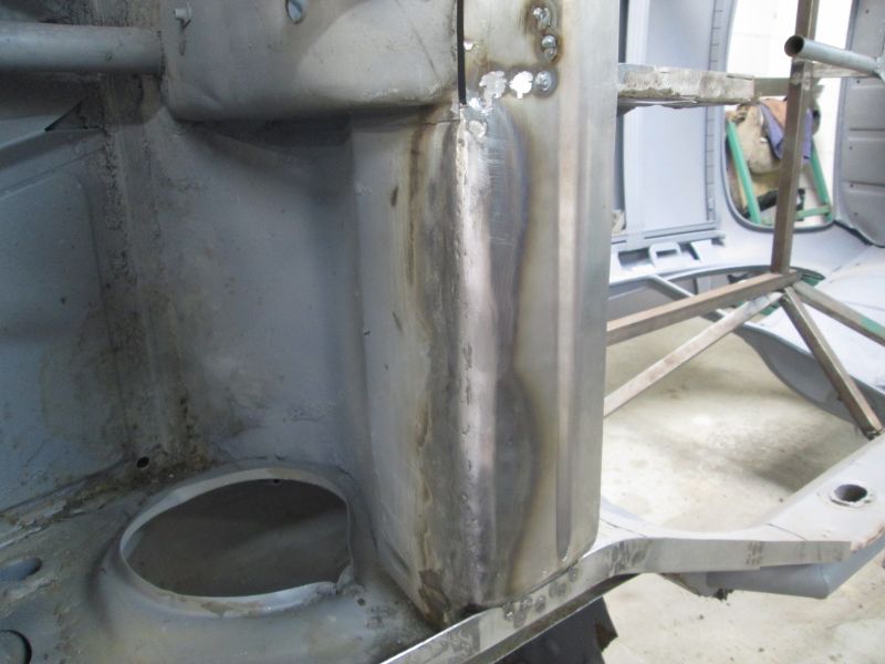

            • 4/22/18
              Right Corner repairs complete.

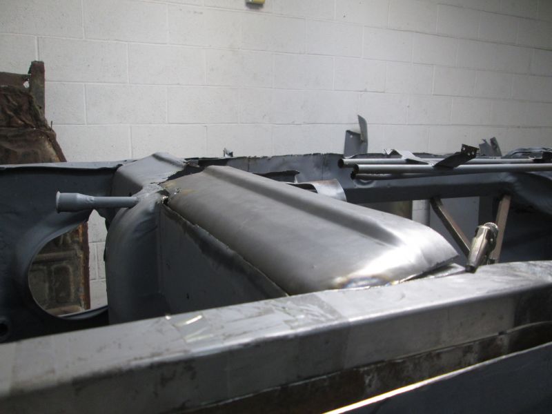

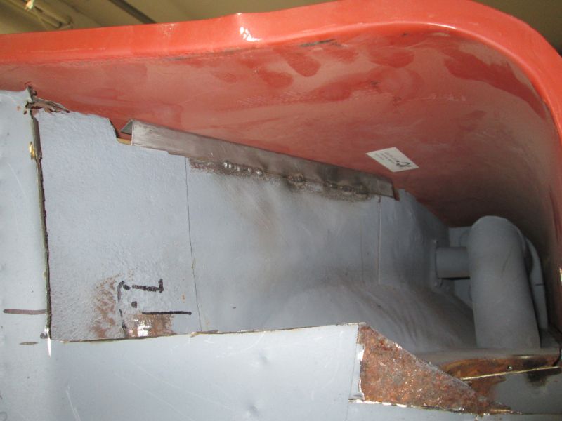

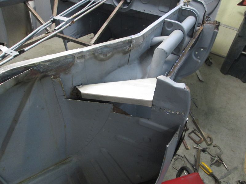

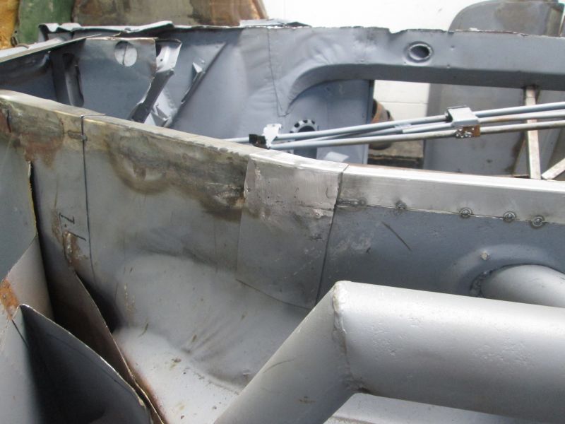

              This forward corner of the cockpit weld finished and completed. Gas weld detail at the leading edge of the bulkhead flange replicated along the way. This small portion ready to accept a new floor pan. Small area but it was a win today. Moving rearward to continue the rest of this flange repair.
              • 4/25/18
                the rest of the right forward flange section complete and prep for the next section.
                The rest of this run welded up and dressed. Lap joint details replicated carrying over the lines.

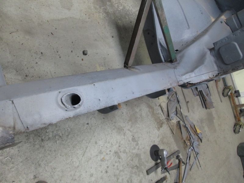

                I'll close and add the new gusset floor once the front beam issue is addressed.

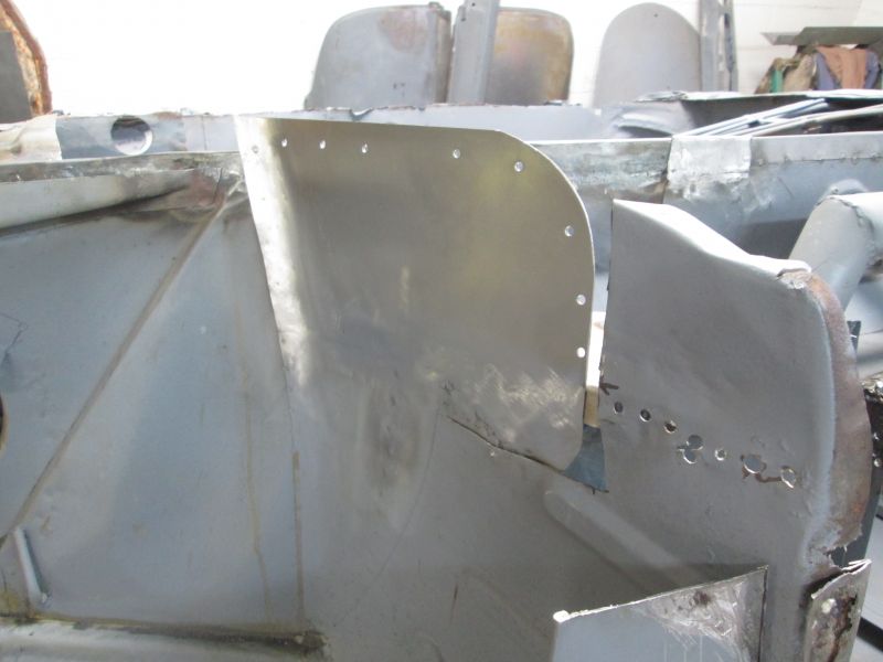

                Another mock up with the new closing panel just to see.
                Next section runs the entire length all the way back under the heater tube elbow and embossment detail. However the new replacement section isn't that long which is just as well as there is a lot of work ahead to repair in and around the elbow.
                I'm going to the make the break under this outer lap joint. A perfect place to quit as it will be concealed and supported under this lap panel.
                Original flange(X) is the same width as the standard issue back here so all I need to do trim away the excess.
                Like before cutting just at an inch above the flange line. This portion is actually still good all the way down the flange itself but its got to be weld repaired somewhere so I might as well keep the repair uniform.

                Section removed after carefully cutting around and breaking loose from the bulkheads. Prepping new section to fit next.

                  New section cut to basic length for a flush fit.
                  Now positioned for needed flange height.
                  Ready to etch my final cut line in and trim.
                  Cut to final width and clamped into position with a good tight joint. Begin tack welds.
                  Securely tacked
                  The end shape trimmed to continue that Delta-V relief shape.

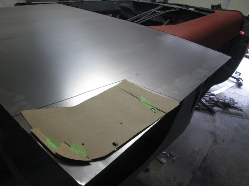

                  Quick paper template as now is a good Time to fill that hole.

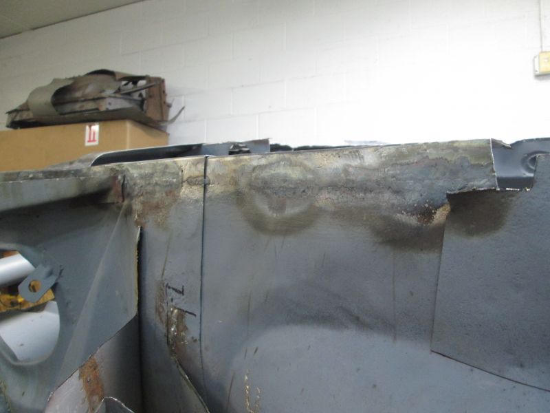

                  Lap patch all welded and dressed.
                  Its subtle curve and flange shape made for a smooth transition between the two flange widths.

                    New door well tray/floor installed.
                    Just about ready to tack this in. I wanted to as much of that secondary wall as I could but as it stands now its in my to get a clean shot at the most inner part of the weld joint so no choice but to cut a little higher or lower in this case.

                    Begin template for the new inner splash pan/closing wall.
                    Flange of the new pan will eventually join onto it. Ideally I would have had the weld joint run through the middle of this flange to both conceal and support it but the rust went just a little higher on this one.
                    Eventual wall patch should butt up nice and tight against the new pan. Working on this next.
                      Able to use the remnant section left over from the front bulkhead wall flange repair from earlier.
                      Folded and trimmed to basic shape before I ran out of time. Final shaping and tack welding next.

                        Secondary closing wall patch in.
                        Final trimming and shape all but there.
                        Final trimming on that butt joint eventually dialed in with plug weld holes punched. Ready to weld. Very tricky patch as the flanges come in at specific angles and the wall itself has a slight lean to it making dialing in all the lines for a clean fitment all the more difficult.

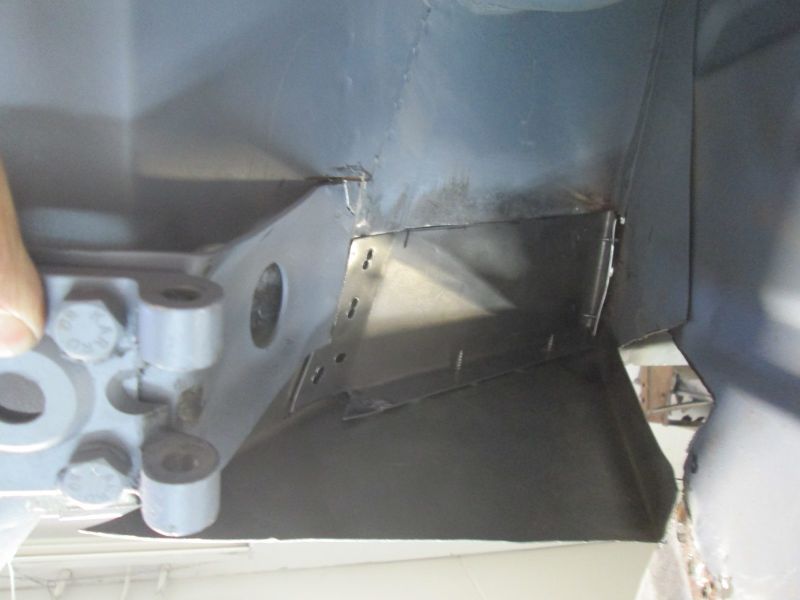

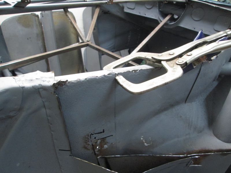

                        Would have been impossible to repair this area cleanly with the hinge boss in the way.
                        Getting ready to weld that inner vertical flange section from the outside. Loosened the rest of it up to ensure a tight fit. A lot of planning ahead had to be done as its almost impossible to dress any weld slop down in that deep corner.
                        More fine finishing to come but its at least in for good.

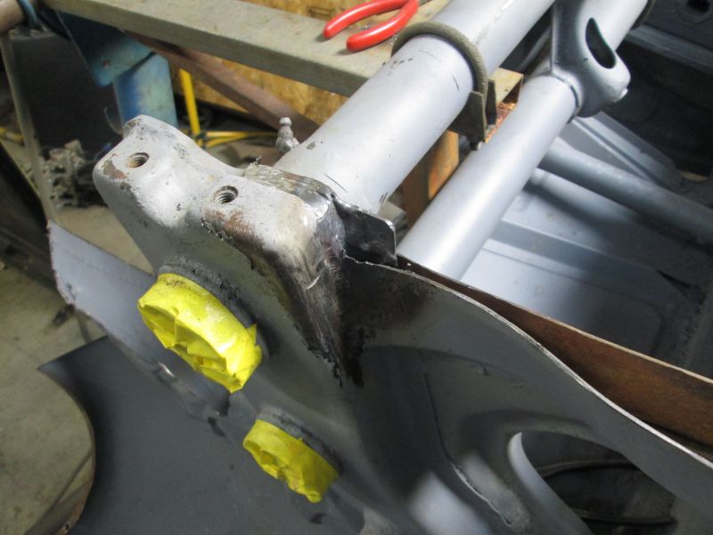

                        • "Very tricky patch as the flanges come in at specific angles and the wall itself has a slight lean to it making dialing in all the lines for a clean fitment all the more difficult"
                          This is why I have always saved empty cereal boxes and tablet backing cardboard. I buy a LOT of 3M green masking tape and among a plethora of other uses, that sure comes in handy in adding that sliver more of an angle without re-cutting more cardboard with another try at a "specific angle".... missed the first time.
                          Jus' sayin'
                            Everything gets a paper template first. I'm not good or lucky enough to go straight to metal Bruce. That patch was so tricky the template itself went through some evolution. My template material of choice are those white rectangular gift boxes for clothing that one gets around Christmas time. I save mine and everyone else's.

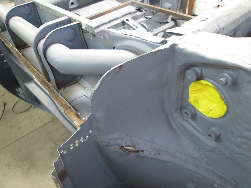

                            Right front longitudinal end cap.
                            New secondary wall pretty much set and dressed. Had a really hard time reaching down into that corner but going to leave well enough alone for now.

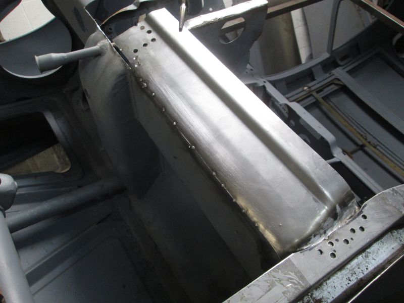

                            Onto the new end cap. A little tougher to work with 18 gauge but now that I have it on hand I want to try and make most all "chassis" related components from this instead of 20 gauge.
                            Cut to basic and slightly oversize shape

                            Rough mock up with the new longitudinal section to trim back a little closer. That new simonsen piece is made of 20 gauge which I'm not really thrilled about being such an integral component of the "frame" but we have the triangulation of the roof so it should live.
                            I will however reinforce it where I can.
                            Begin rolling in that curved leading flange detail.
                            Final trim and shape along with all the plug weld holes added. Ready to mount for the final time.

                            Carries on the flange line from the OG section

                            Begin stitching it on.

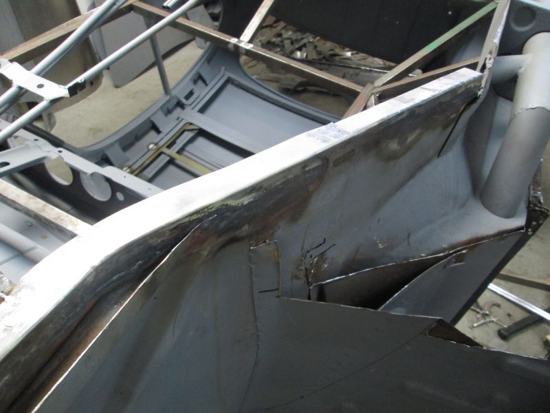

                            This pretty much completes my repair prep up here to allow that new closing panel to go on.

                            • 5/7/18
                              Final finishing first
                              Began planning the repair in and around the heater conduit. While this rear closing wall is in pretty solid shape it is in my way.
                              I hate to disturb it but its going to have to come out to get a clear shot at the end of the tube.
                              That up next. Thanks for looking!
                                Begin peeling this onion by carefully removing each layer of steel or at least what is left for info and templating purposes.
                                Bottom outer embossed layer which is directly welded to the tube cut free first.
                                Carefully removed the remains of the second layer. Again for copying purposes.
                                What is left is the remains of the inner most flange/wall run that welds to the end of the inner exit tube section. To the right of it are heavy gauge angle flanges off the torsion housing that were beefy enough to have just survived. I think, I'll know more once I start cleaning this area up.
                                Inside view that inner most wall and as you can see the rot runs deep.
                                To get a clear shot all of that will require the elbow of this conduit to be removed. No surprise of course.

                                This is really cutting deep and though I've got the roof and a sub-frame Jig in there I still got a little spooked so I added that tubular bridge strut there just to make sure it did begin sagging. A lot of leverage running through here with the weight of the body hanging off each end.

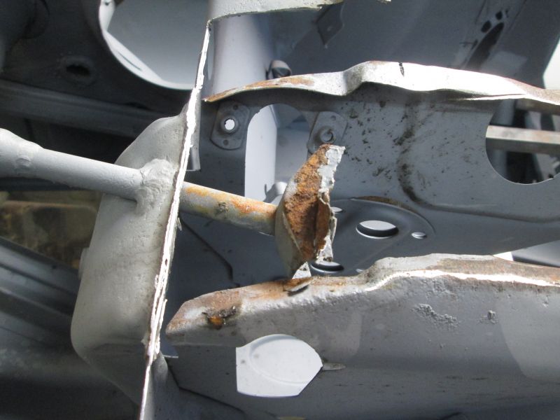

                                Sort of hard to make heads or tails of these crispy little guys but since I watched it come apart I think I can still reverse engineer it.
                                So gratefully just to have those rough examples because as you can see that information no longer exist on the left side.
                                It turns out the side I'm on is the "cherry" side.

                                Begin paper templates.
