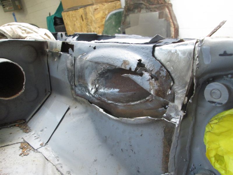

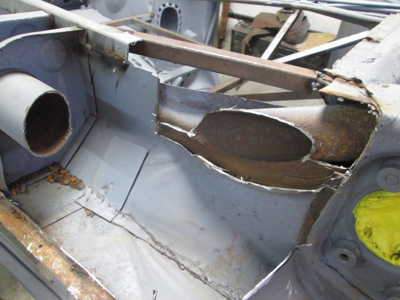

        5/10/18

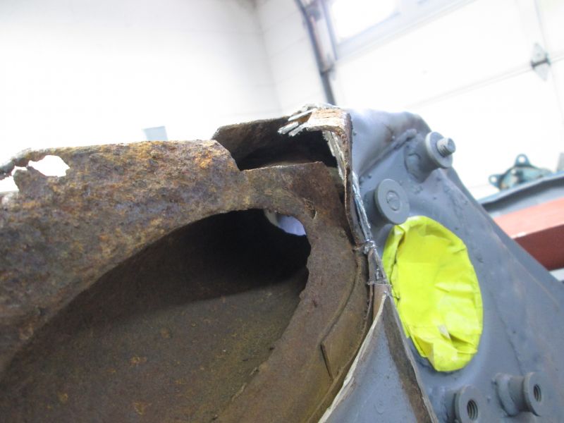

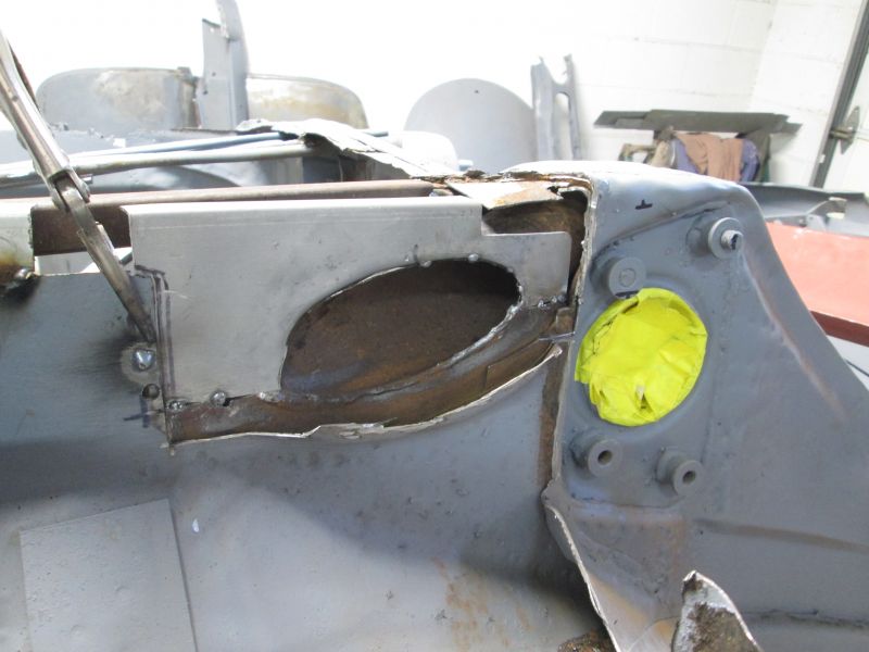

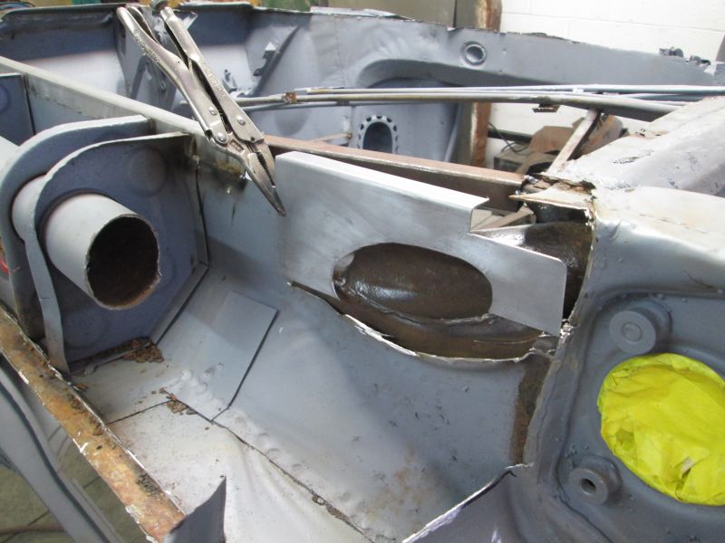

        Touching bottom with this corner repair.
        While planning out this most inner flanged wall I did want to replicate the details like this stepped overlap.

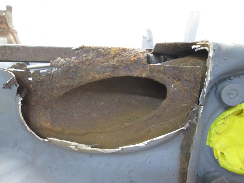

        However this rust hole was really beginning worry me as I wanted to know what the rest of it looked like beneath this flange.

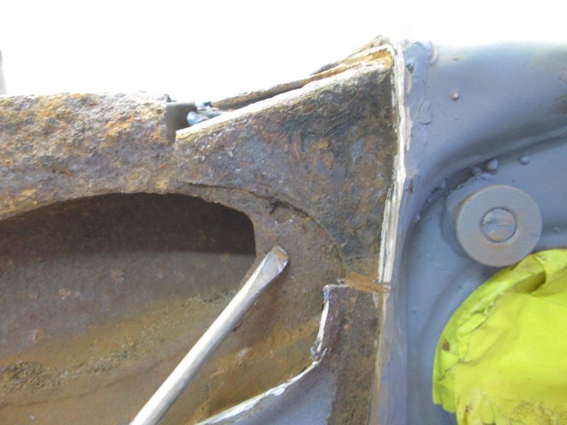

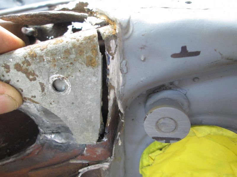

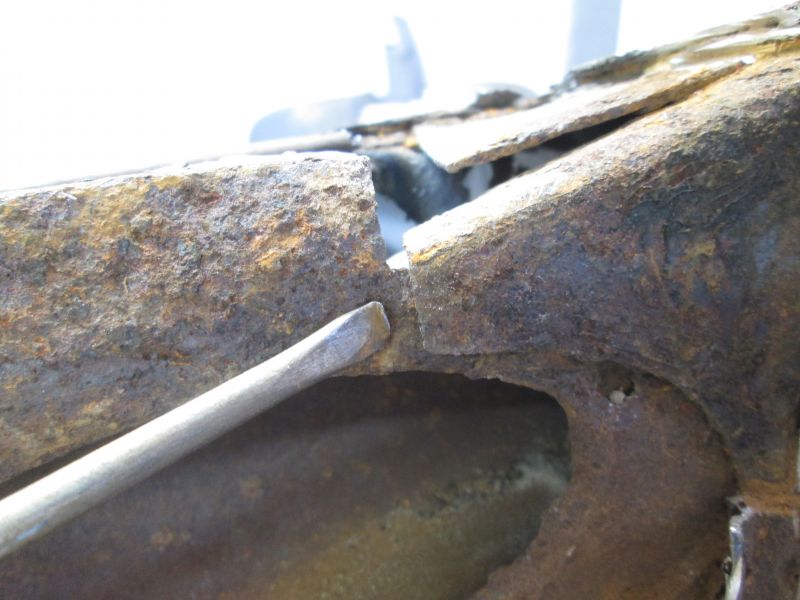

        Just couldn't leave it so I cut that overlap flange to find out.
        Much to my relief not a whole lot. The wall just ends with no attachment between the two which was surprising but nice as it made my life a little easier.

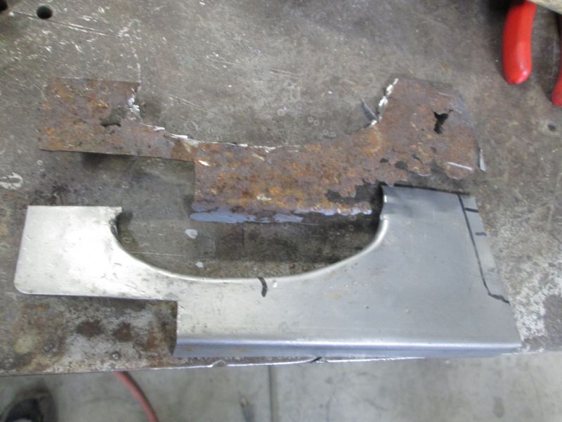

        Wall remains carefully harvested for a pattern.

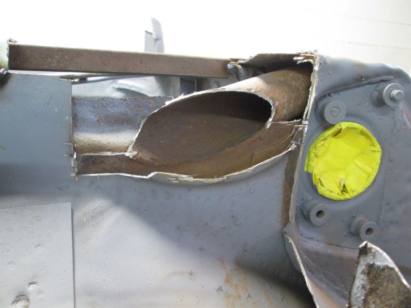

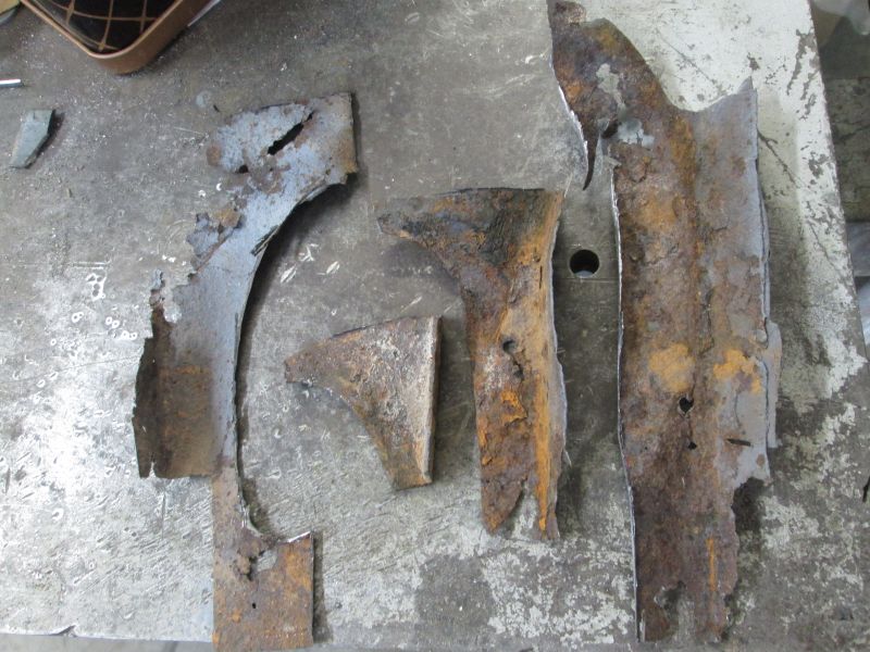

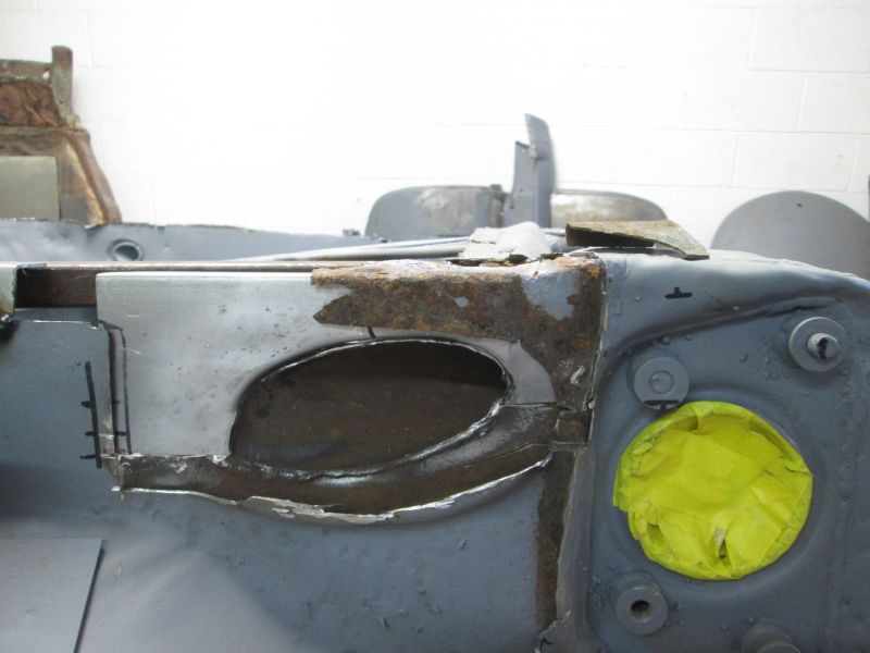

        Now past all the unsavable metal; I've officially touched bottom. Building this area back up from here.

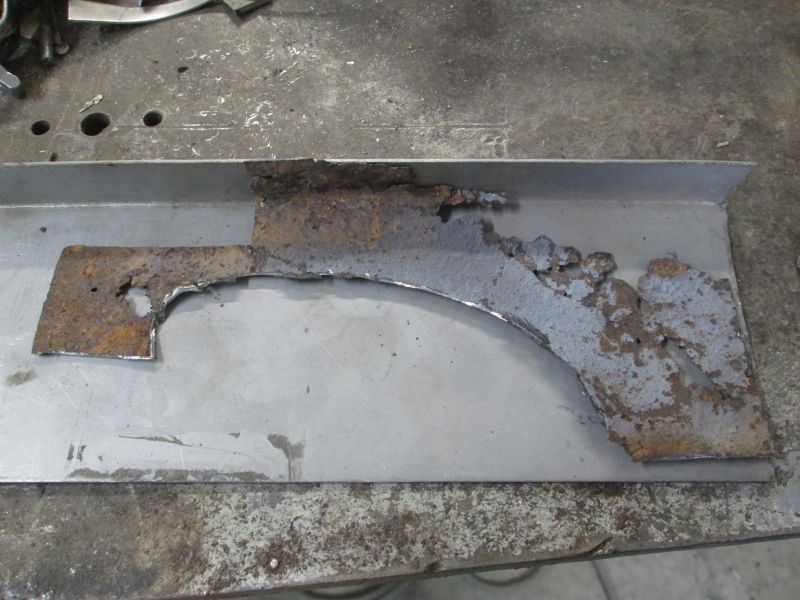

        Making copies of all these layers next.

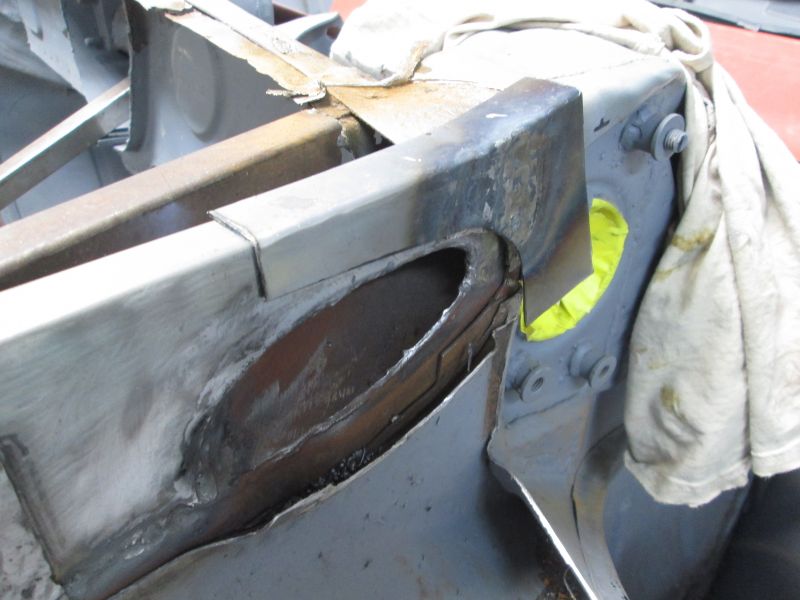

        which needs to be a smooth continuation of the end of that new section I welded in earlier. Remnant flange helping to determine that here.

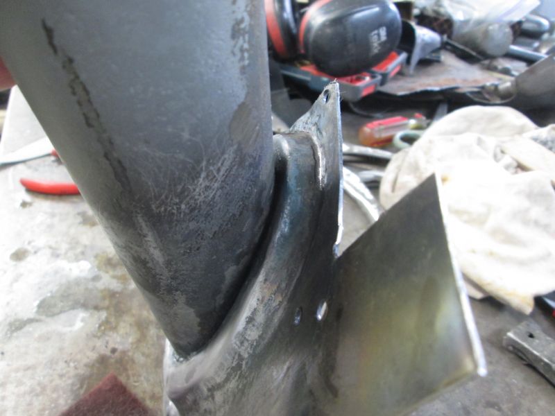

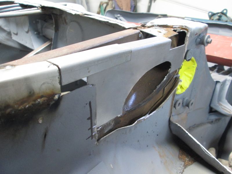

        Checking the height and fitment back here against that heavy gauge overlap from earlier.
        Then a quick check also with the next layer that will eventually go over top of those two. Everything sandwiched together as nice as I could tell.

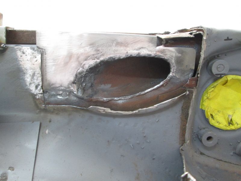

        New repair section finally tacked in. Stitching it up the rest of the way next.
        Thanks for stopping by!

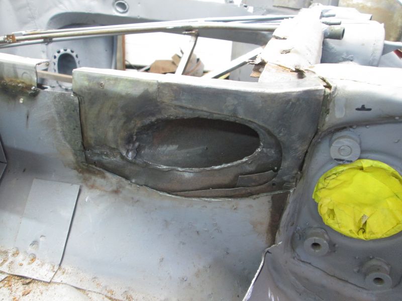

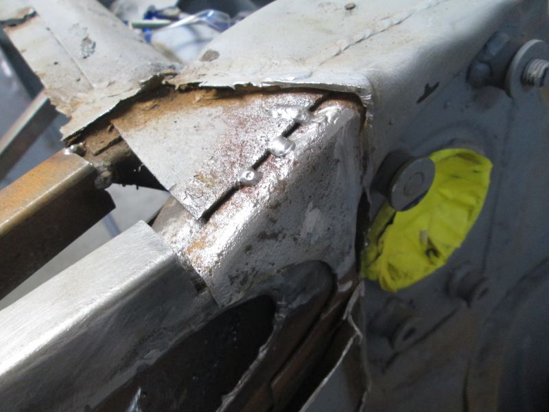

        • 5/11/18
          Corner just about rebuilt.
          All stitched in and onto the next layer.

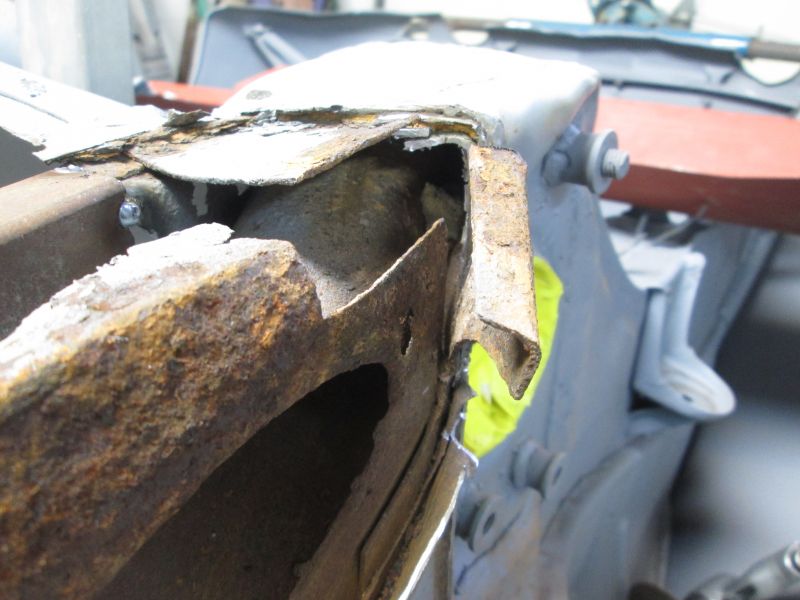

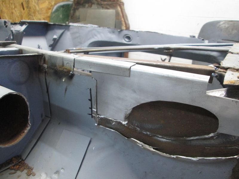

          Peeling back the shoulder a little further still just at the gas weld seam. No more trace of this section found in between so I can only assume it terminated there.

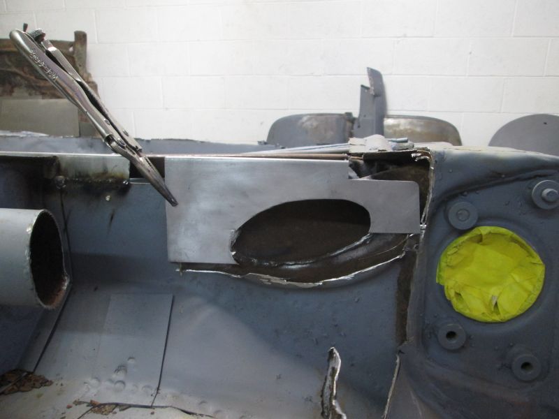

          New section from 18 gauge cut to basic shape with saddle profile added.
          It will have to be form fit as it goes to get it all perfectly snug.

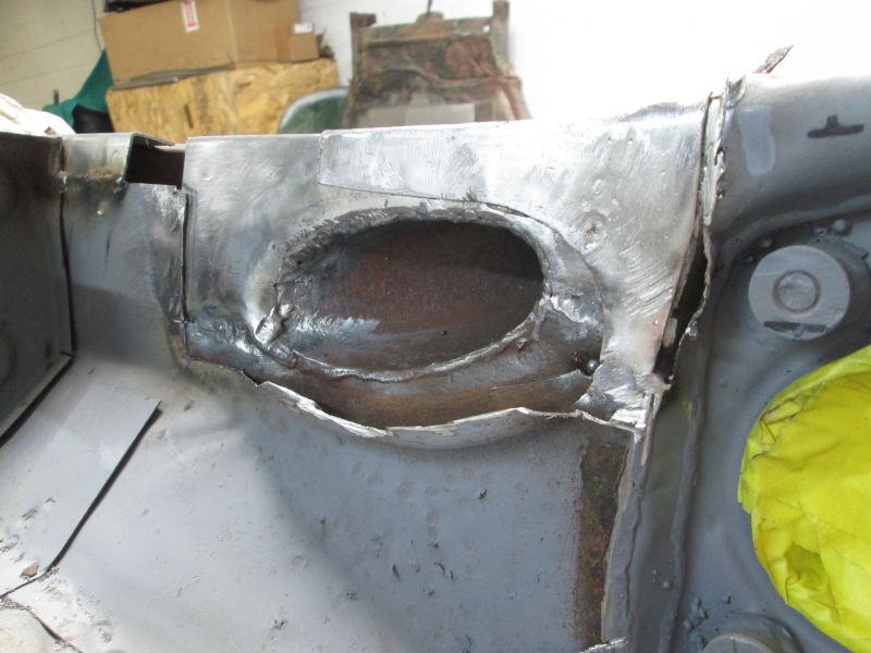

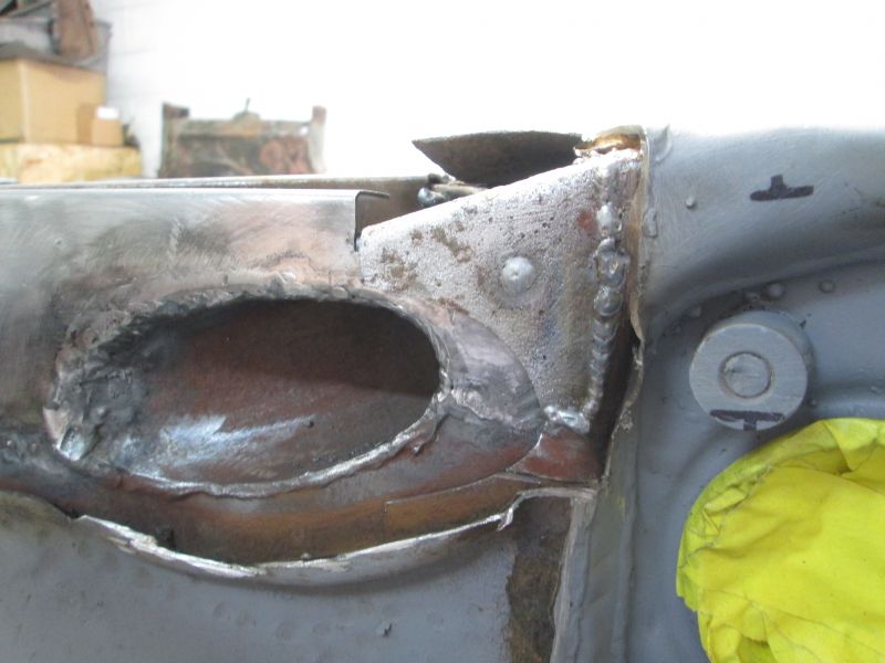

          Old with new. Though not a lot of the front remained there was just enough of a clean vertical end remaining to clue me in as to how long it was. Ready to weld.
          Started welding it at the rear then chased it forward.
          All dressed and almost fully welded. I still have to weld up the rear vertical edge but will do that before its all over.

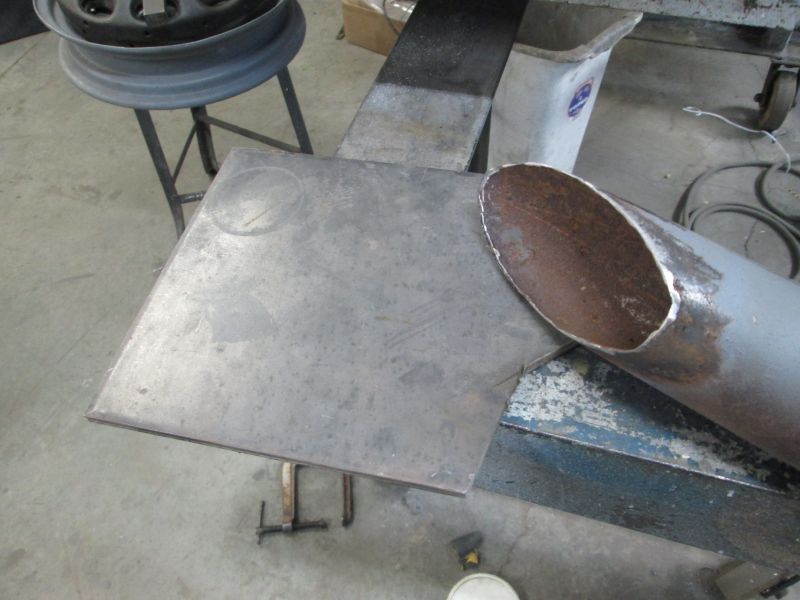

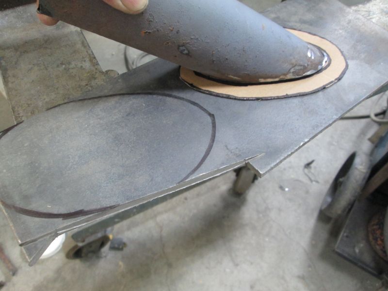

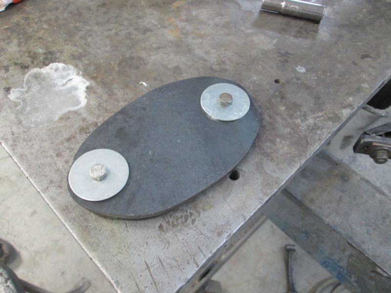

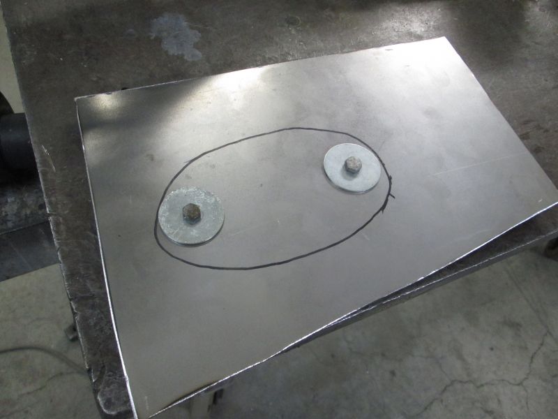

                  Begin hammer form
                  Thick heavy gauge plate I have on hand will make for the perfect base/step for the embossed collar detail. Cleaned the end of the tube so I could trace out that needed shape.
                  Paper template with the shoulder I'm looking for. Outlined on the steel and will carve it out tomorrow. A total pain in the ass but worth it as I have to do the same repair to the other side. Its a "two-fer"

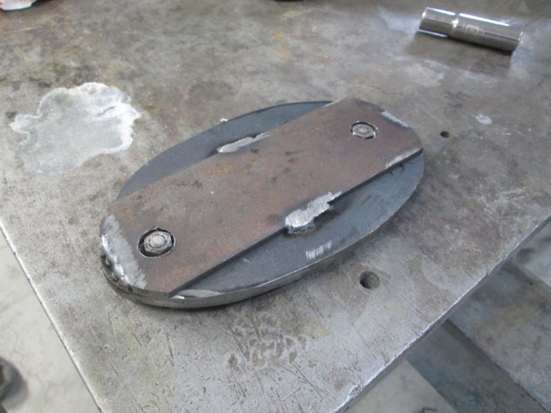

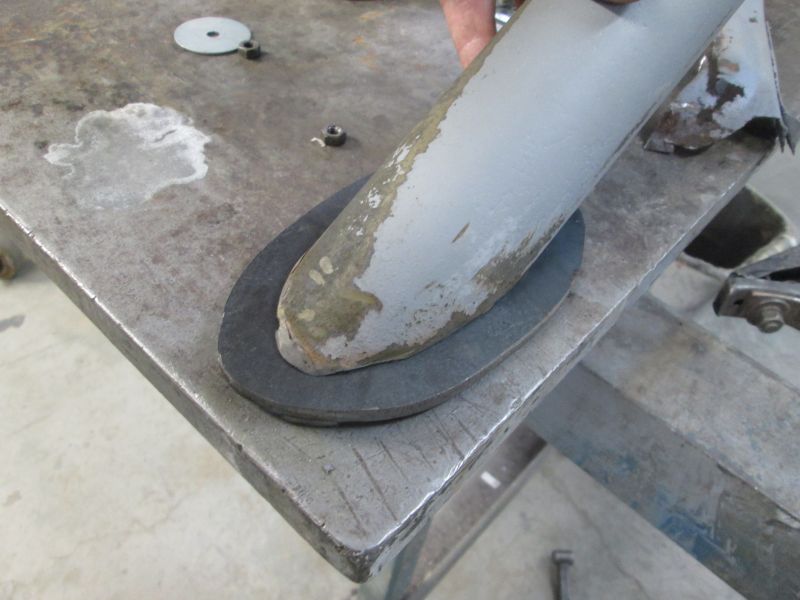

                      5/15/18
                      Hammer form built and first collar shaped.
                      Original tube section was small enough for my acid bath so it soaked overnight. Wish I could clean the rest of it like this but I'll have to take what I can get.

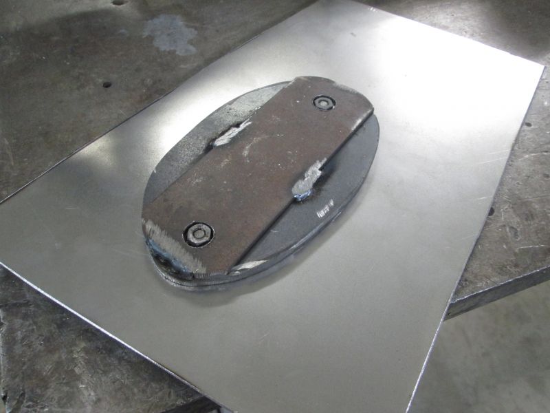

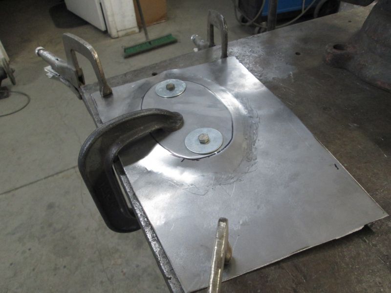

                      Hammer form cut out and shaped. Two holes were added so I could secure the work to it.
                      After a quick test with some 20 gauge I realized I needed more relief height so I added this strap stock to the back for a touch more depth.
                      Basic relief shape I hope to achieve. That thick stock was a bitch to cut out and shape so I was praying it wasn't in vain.
                      Section of 18 gauge all bolted up
                      ready to begin...

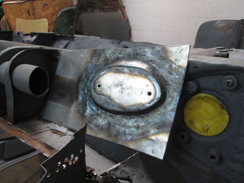

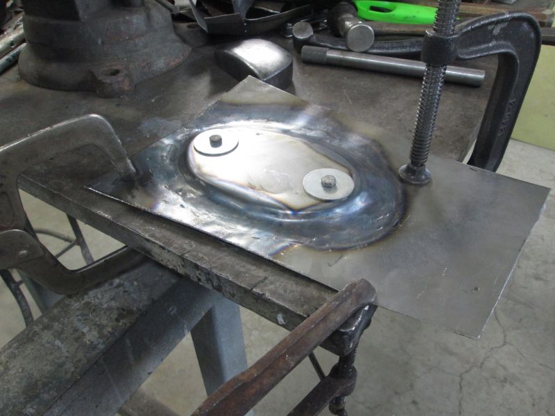

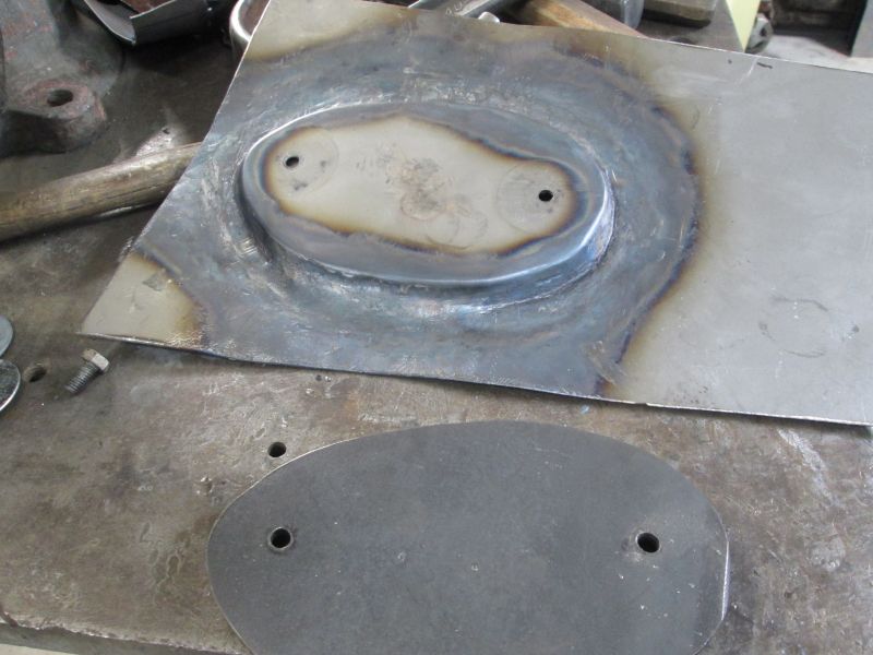

                      Started cold to get a feel for it.

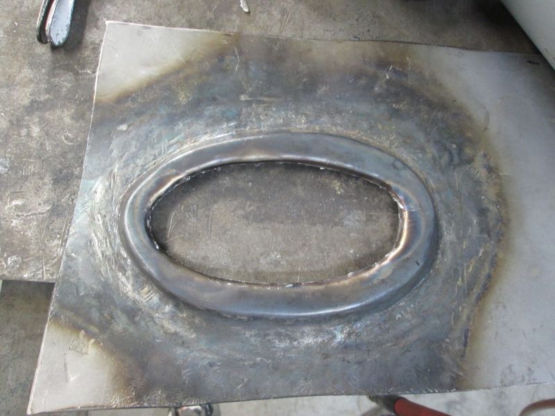

                      Certainly not as forgiving as 20 gauge so the first of many rounds of heat was applied to get it to take the shoulder.

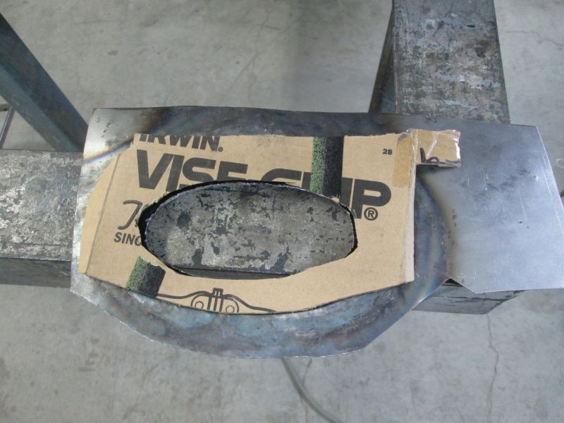

                      Basic relief shape complete. I have some lines and details still to clean up but I at least have my basic repair patch. Today was a physical one as it felt a lot like blacksmithing to get that thicker metal to take the shape.
                      Left myself plenty of excess for final adjustment and trimming.
                      I'll punch the hole for the tube end next. The tube and its ends position dictates where this patch will ultimately end up. Once I have that dialed I can do my final trimming and add in the 90 degree bottom flange. Getting closer to wrapping up this corner repair.

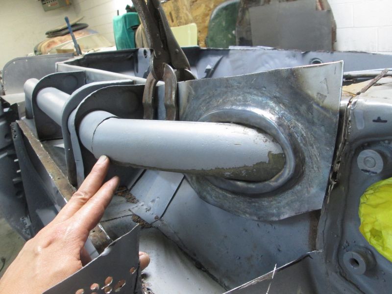

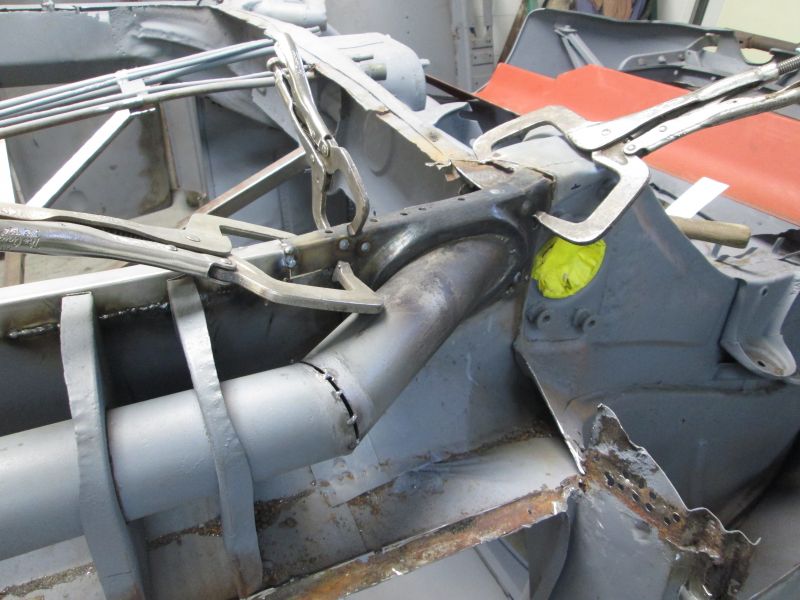

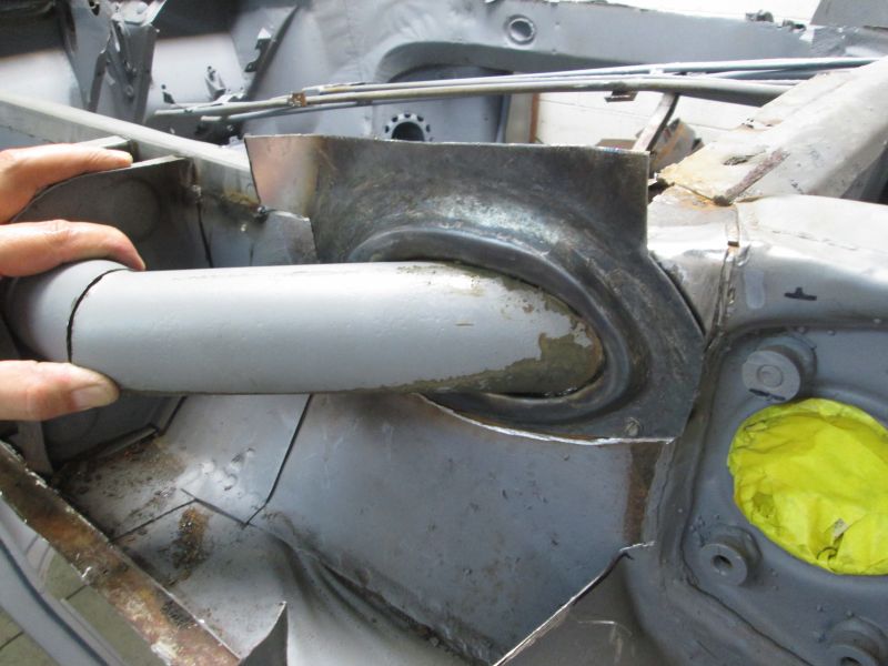

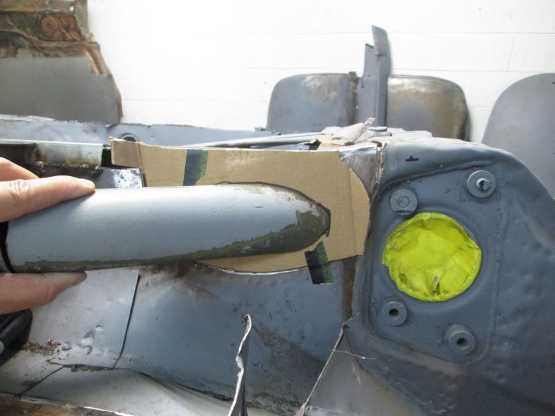

                        Good for starters now to make it all fit and align together in the car.
                        Trimming little bits away as it went with a closer fit on each try.
                        Trying for tube alignment with best average fit at the end.

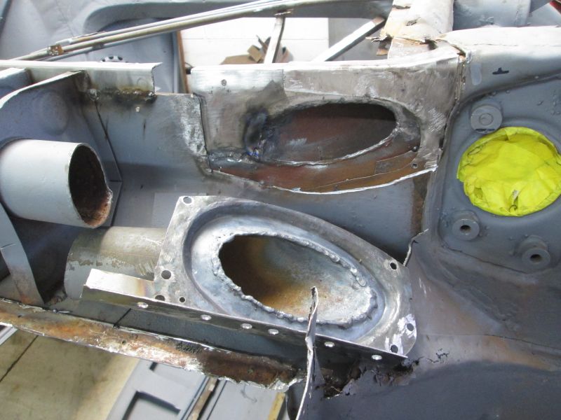

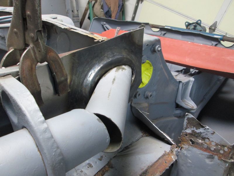

                        Trimmed and ready for final adjustments in relation to the tube. Shape didn't turn out as clean as I would have liked but its heavier gauge, hand shaped and will be eventually covered over so it really just as to do its job which is provide additional support at the tube end.

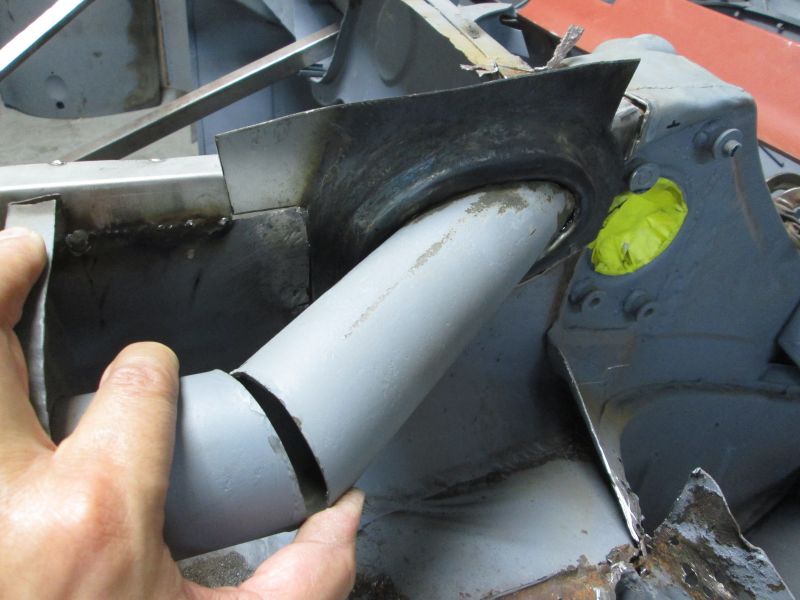

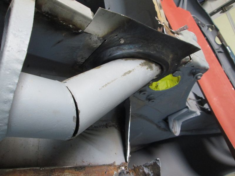

                        Aligning the tube. Close but the forward shoulder needs more rolling to allow the angle to drop in evenly.

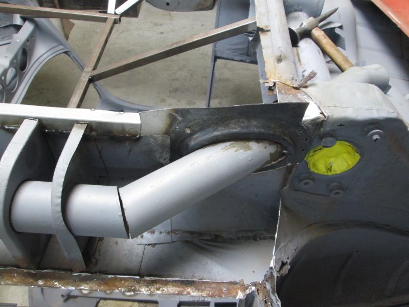

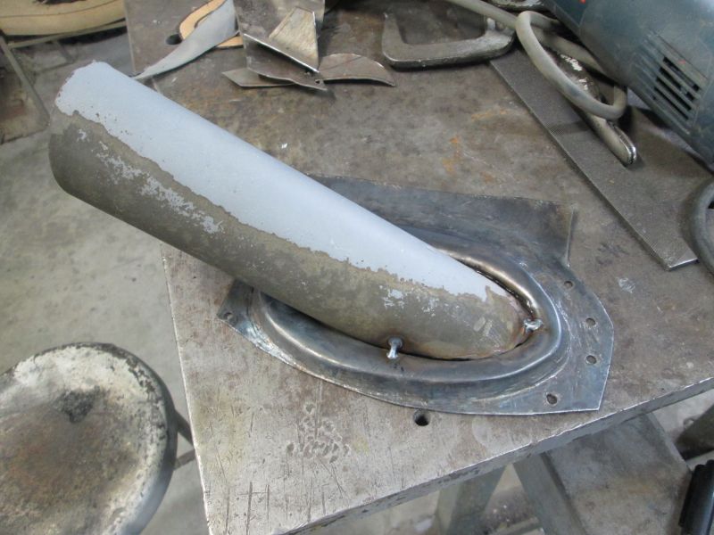

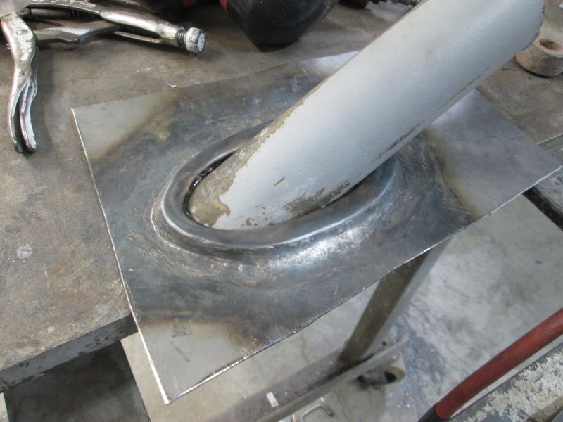

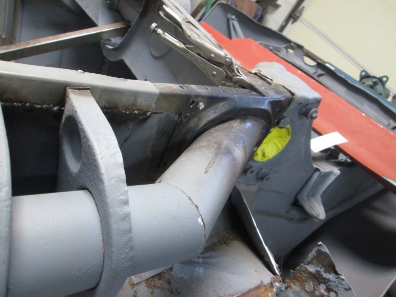

                        After some adjustment I finally got that tube section pretty much where it was before.

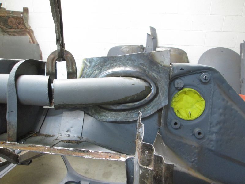

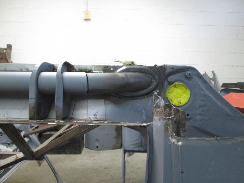

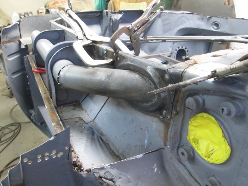

                        New section is set into its final position. These two tube ends do come in at different angles which is probably why they remained separated like this.

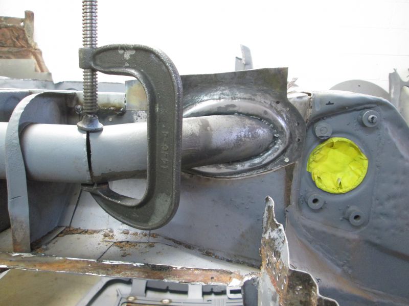

                        Tube tacked into final position.

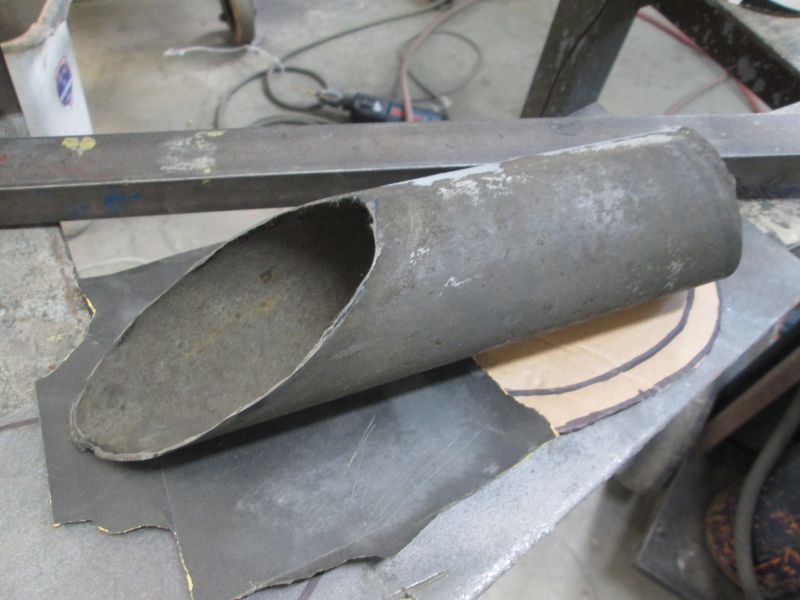

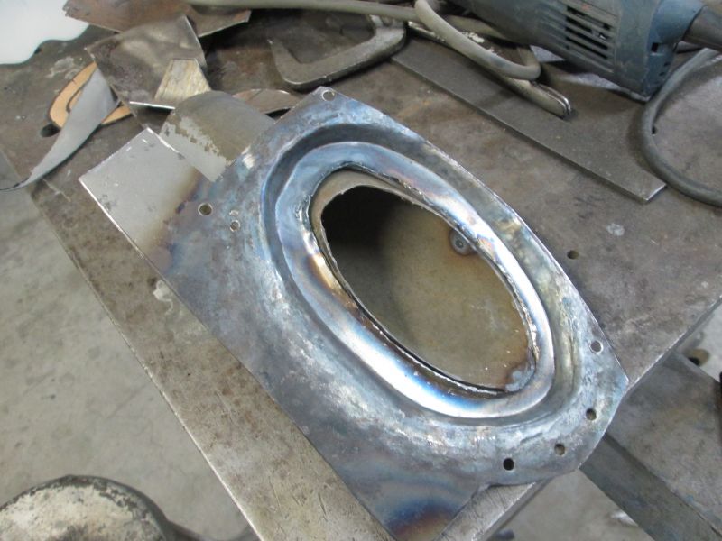

                        Removed one last time
                        To seam weld the edges up as originally done.

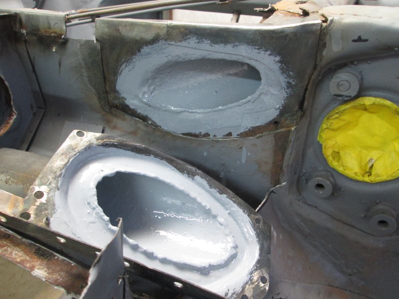

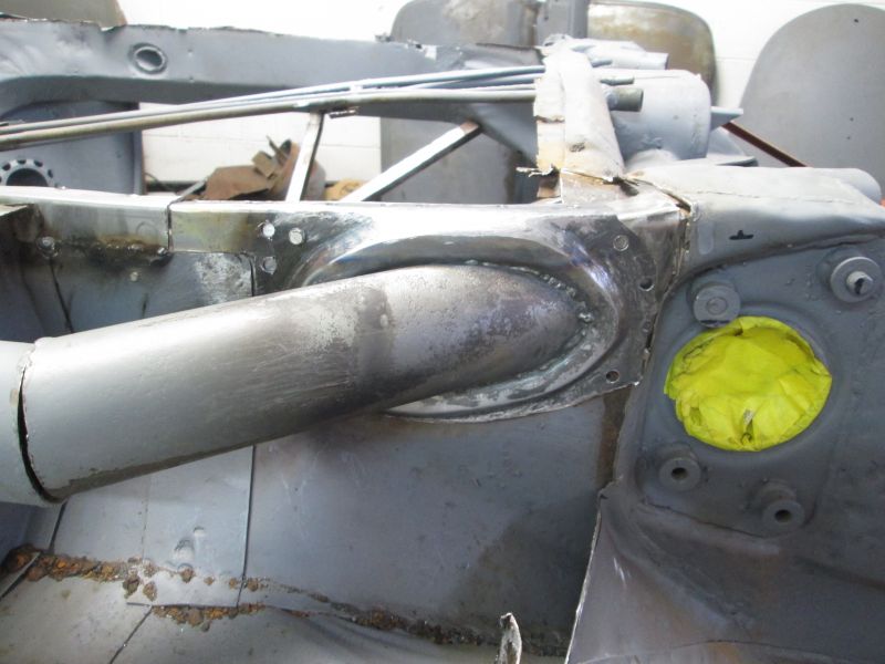

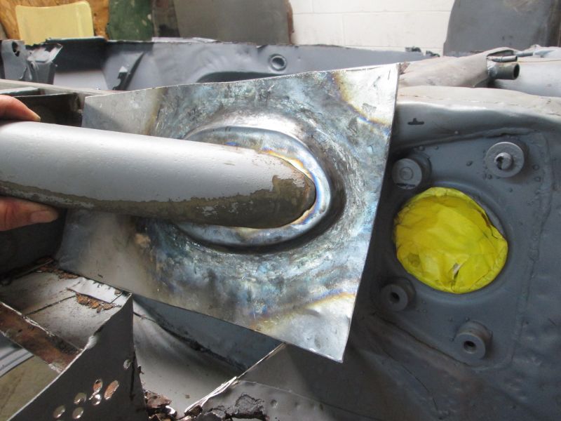

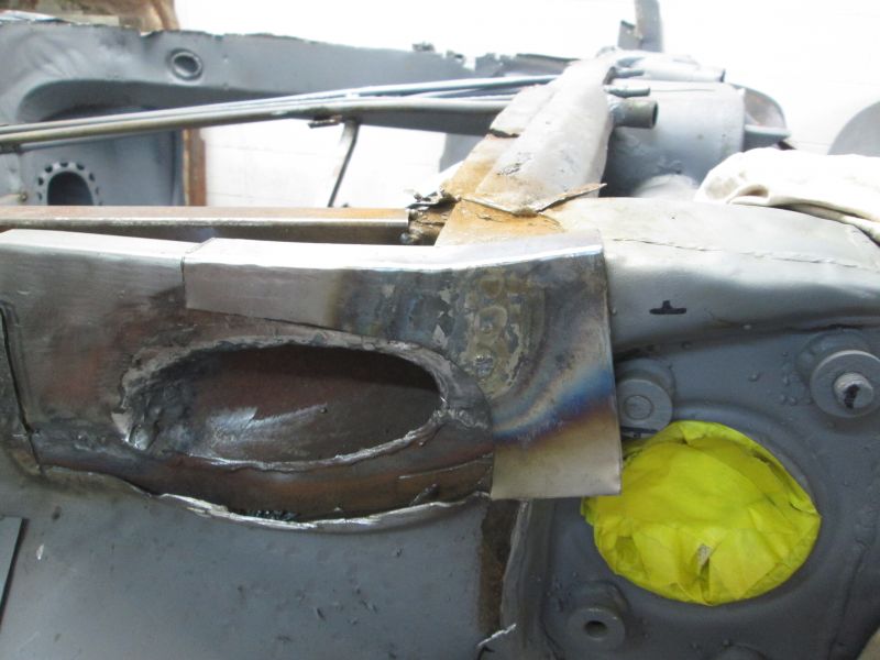

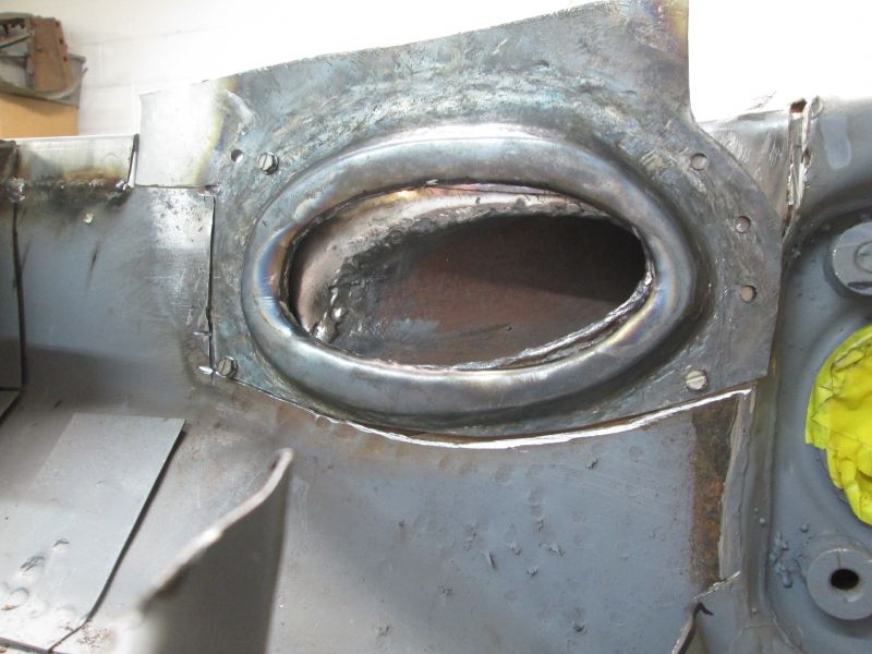

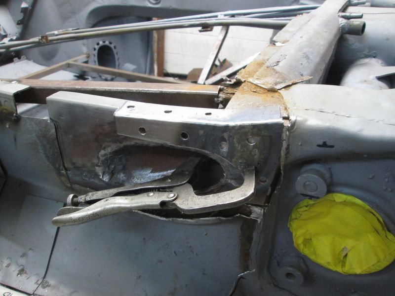

                              5/17/18

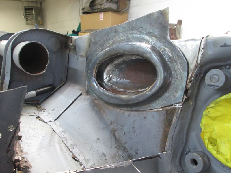

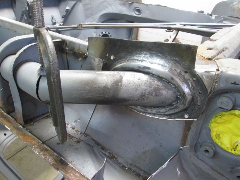

                              New outer closing wall installed.

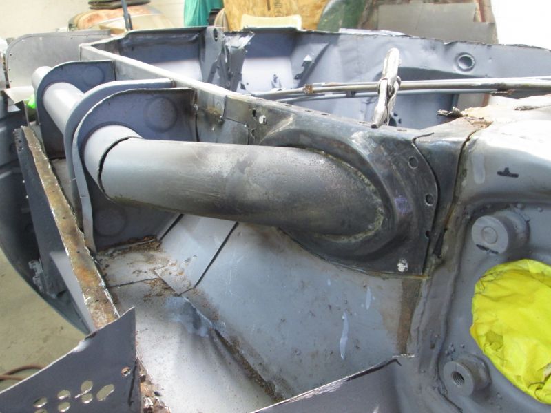

                              Seam welded end of the tube to the opening of the shoulder as originally.
                              Only way to do it BTW as you'll never laydown a nice bead in here.

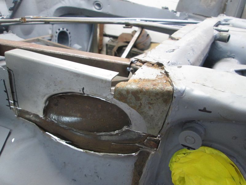

                              Another test to check my fit and alignment after all that heat.
                              Everything still in there and good to go. Time for the last detail. Heeling the bottom flange over.
                              Flange added, plug weld holes in and at long last I have this final piece of this particular puzzle completed.
                              Time now to get these inside surfaces treated and coated so I can close this up for good.
                              Best I can do with the remaining surface rust was to treat it with converter.
                              Then the inner cavities where slopped heavy with some epoxy sealer. A lot of heat still to come so I don't know how much of this will survive but it will offer at least some additional protection.
                              Mounted back on... For good this time.
                              Ready for the first few plug welds and tacks next.
                              End of this tube at the elbow is literally within a wisp of where it was originally. As close as I could hope for.
                              Commitment time. Plug welds and tacks added.
                              Elbow joint tacked and set as well. Looks close though not an exact copy but it is proper 18 gauge and one piece. I can live with it. Welding it in the rest of the way next.
                              • Justin, that was a complex repair; well done. The harvesting was obviously key in being able to recreate it as it was....seems obvious but how many of us have gone plunging in only to have the "D'oh!" moment afterwards, when it was too late to peel the onion this methodically, or to harvest the remaining metal with such delicacy. As noted by many before me: what complicated little buggers these 356's are to restore....properly. Best, John
