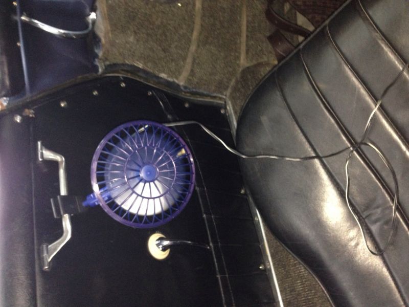

    I decided to not install an aircon. Got that sorted with a fan.

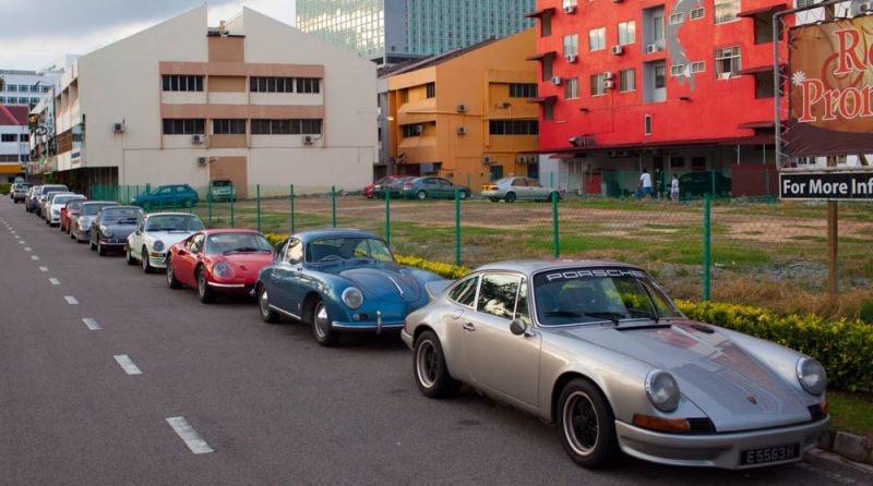

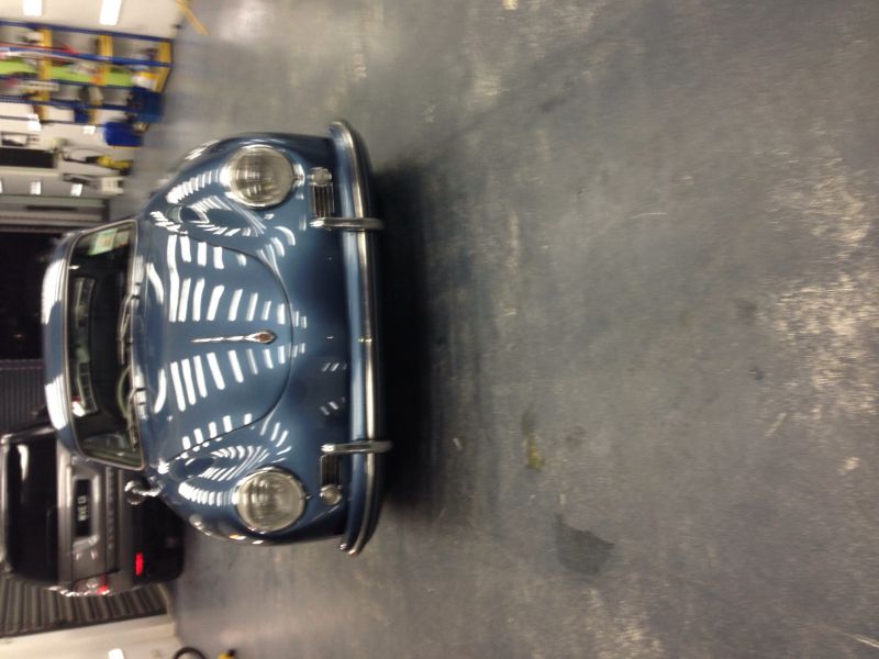

    Drive up the car for a local Porsche meet. Car travelled well to a 100mph. It was in Melaka about 150km from KL.

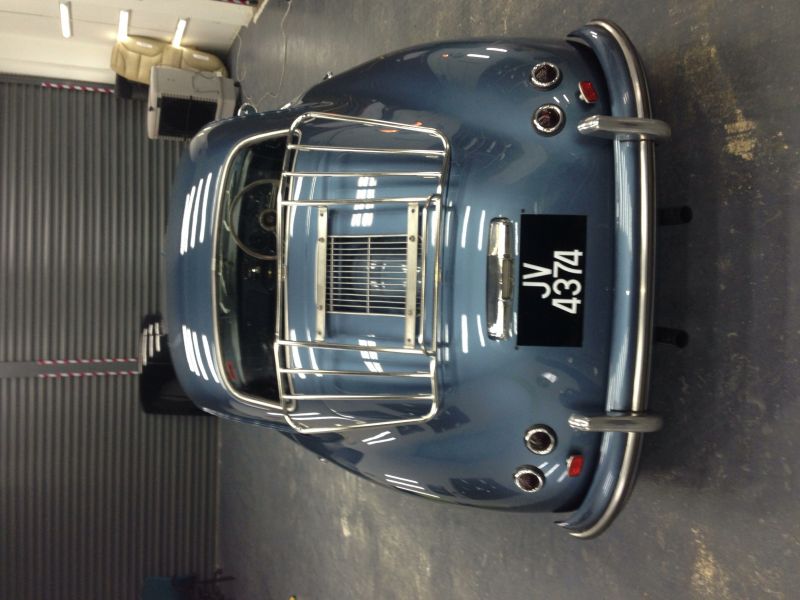

    Drove back to Johor (home) which is 350km. On the way there met a 993tt and a 930 and a 911 3.2. Convoyed back to home at 100-110 mph at 4500rpm. Am smitten with the car.

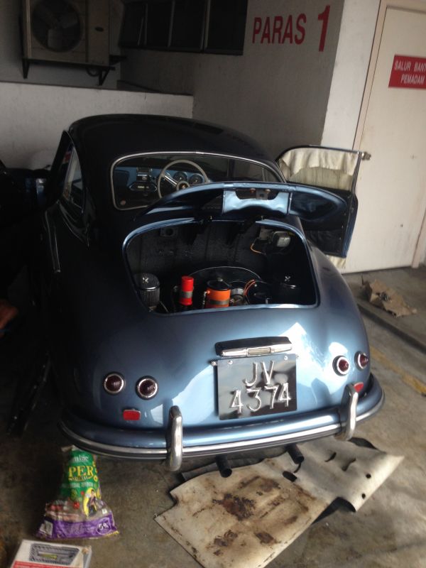

              • Hi guys, i guess the flogging got to her Accelerator cable rod came out of its place and accelerator had no spring back.(I am trying to explain in as simple as possible terms) The throttle linkage was taken off and re-assembled by a mechanic friend who has been working on the car from my home.
                Car has been grounded for the last 4 days, it had to be towed back home and we are working on it slowly. I also removed my rear luggage rack.
                On the carbs, the car was misfiring on cold starts. The carbs are clean(i thought that was the problem,maybe i am listening to many people), however. Car has been tuned and It is not as rich as before. Hoping that solves the problem.
                Few problems now.
                1. Battery was changed on Thursday. Fitted in a DIN55 battery. However whenever I start the car the orange generator light, at the tacho keeps lighting up. When i start driving it goes away. My car has been converted to a 12V but is still running a dynamo. Is there something wrong? I am using a 'new era' regulator. Could it be problem with the regulator.
                2.Starter cranks but car doesnt start. Hope it isnt the flywheel. The engine was rebuilt 1900 miles ago so I highly doubt it. Hoping it just is the starter motor.
                I have ordered the manual.Awaiting for it to come. In the meantime, how often does gearbox oil have to be changed? What parts should I always carry in the car and what parts should i stock keep at home.

                • If you take the top of the filter canister (I think 19mm bolt) then pull the filter out and there will be some oil in the bottom of the canister. Use the turkey blaster to suck up the oil and see if there is anything left in the bottom which isn't oil. If it's pretty clean put the filter, or a new one back in, and put a little clean oil back in.
                  • "2.Starter cranks but car doesnt start. Hope it isnt the flywheel. The engine was rebuilt 1900 miles ago so I highly doubt it. Hoping it just is the starter motor."
                    I'm not the best at this but you need spark and fuel to start the car. Therefore if your engine is cranking when you trying to start then it's one of the above.
                    To check the spark take each lead individually off a plug and see if you get spark between the lead and sheet metal. If not then start to trace back. Next look at dizzy which could be the problem that your points need adjusting. The dwell angle should be about 50. I suggest cleaning all the points in the dizzy and adjust and you may solve your problem?
                    To check the fuel take the pipe off after the pump and put into a tub and crank the engine. If you don't get fuel then start going backwards too.
                    • Car has started but the thread of the fuel pump was stripped,so the mechanic suggested to flare it out.(i have left it to him)
