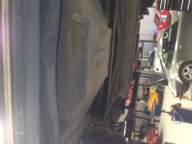

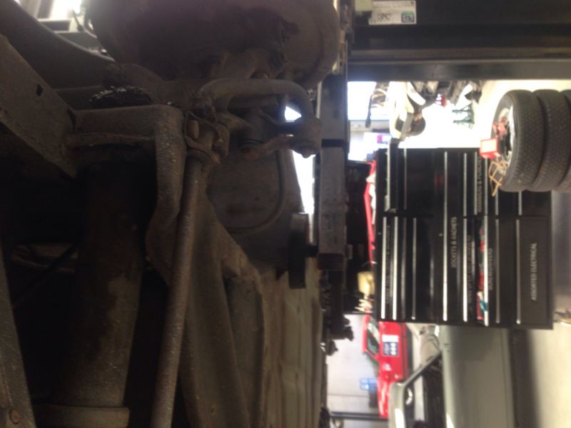

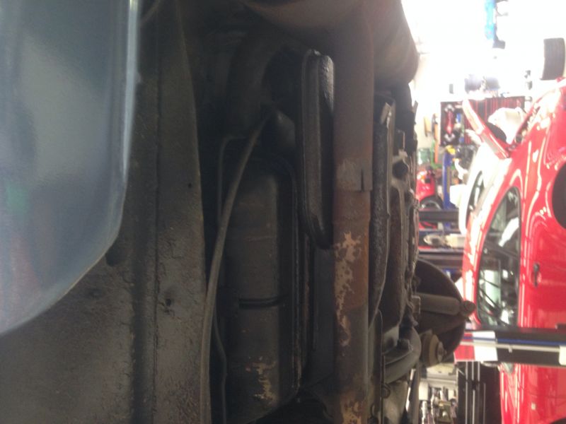

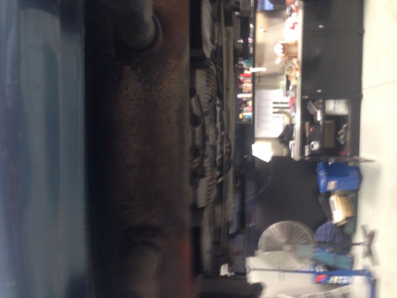

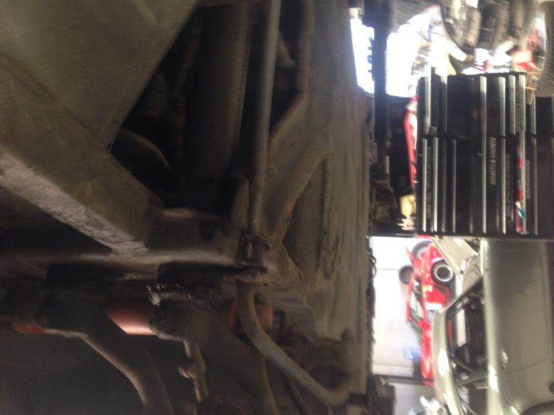

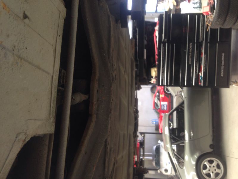

    Attached are some pics of my cars undercarriage. The car was rebuild professionally by a Spyder works in Melbourne in 1990 and has been maintained since then.
    I have never used rustbullet but a mate has just done it on his 23 window. That was why I was asking for advice. Might just stick to the conventional por15. Thanks Justin. On the service manual, will try looking for repros. Heard Charlie White makes excellent repros.

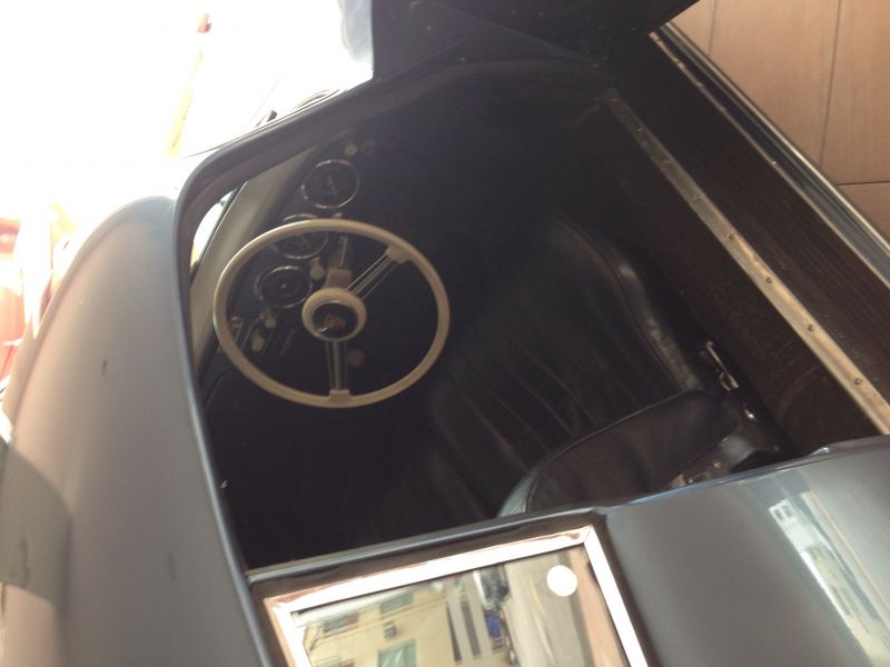

    Also am wondering, why my car did not come with the horn ring steering. Is this period correct?

        Okay, since this is painted, running car you obviously do not have the luxury of media blasting the underside clean. Are the plans to just degrease and wire wheel the rest to knock down any scale and old coating? If so I think Por15 is going to be your best bet in this instance. What's also good about it is that it can be brushed or rolled on (like bed liner coating)which will give a good undercoated look and eliminate the danger of overspray to the body if a spray gun was required.

          Thanks Justin. Using a wire brush now and will be using Por15 later. Will post pics of it completed.

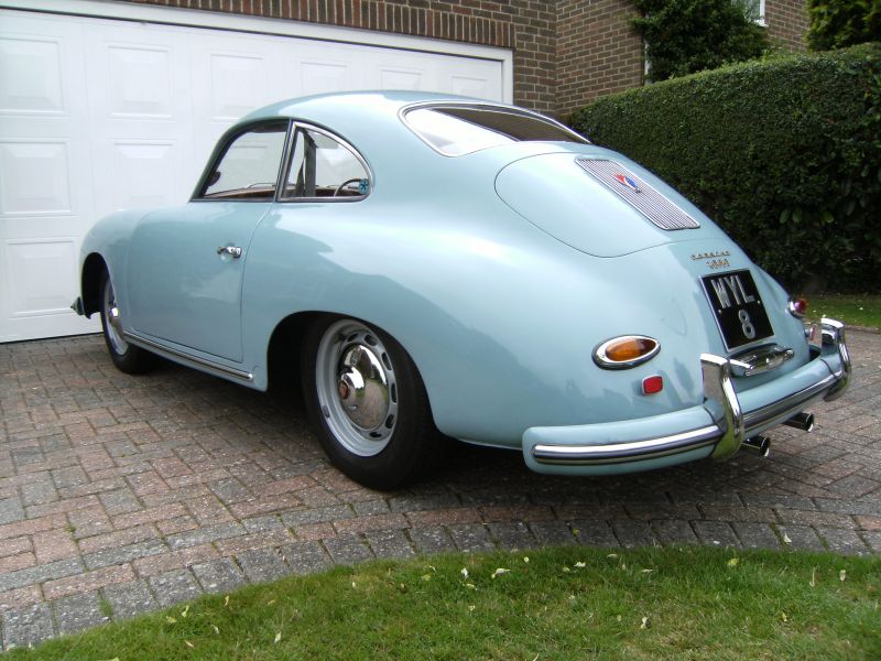

                      Bruce is correct the size is 165 R 15. The Vredestein tyres are as Justin says a nice tyre. Many have bought them over here. But they are more expensive than some.
                      I bought my car new tyres over five years ago and bought Firestone F560 versions 165 R 15 sizing for my standard rims. They look good and have been fine on my car. If you intended track events maybe pay more, but the Firestones made in France are reasonable in price and good in my opinion for normal driving.
                      I have looked for a photo. Can you believe I can't find a specific one just of the tyre. Maybe this one gives an idea. Don't know if you
                      can get Firestone in Malaysia?

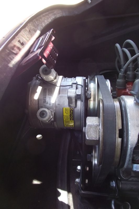

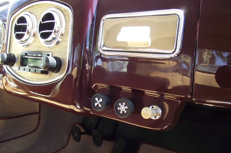

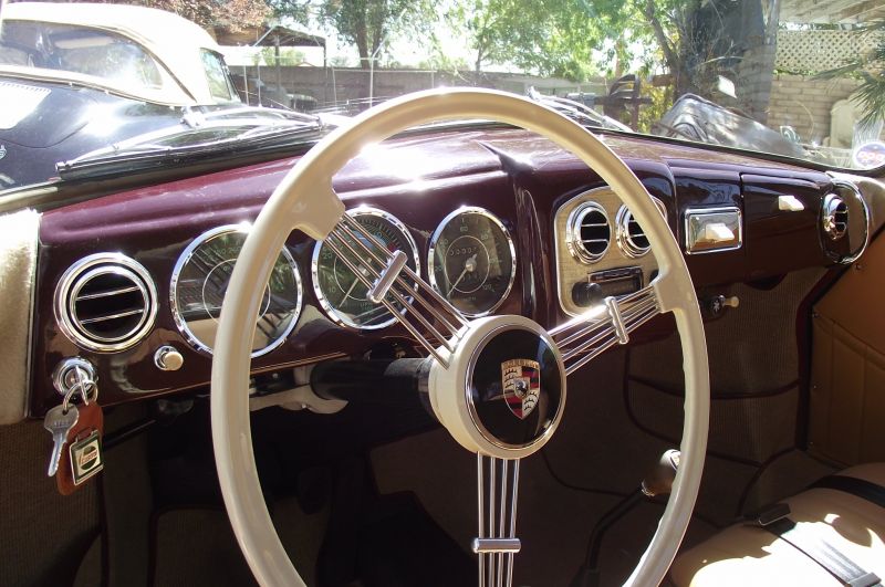

                            Hey Murugesh, was wondering what happened to you. Sounds like your making great progress with the car in getting weatherized for the tropics. If you're interested in putting A/C in it talk to Mark Van Deventor. He's Porsche guy here in Las Vegas that has been installing his own units (based on the old Dillon air design) for over 10 years now. He normal installs them himself but has sold them in kit form before. Look up: 356 Porsche West.com Here's an A/C sytem he installed in a Pre-a coupe a while back.

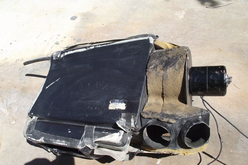

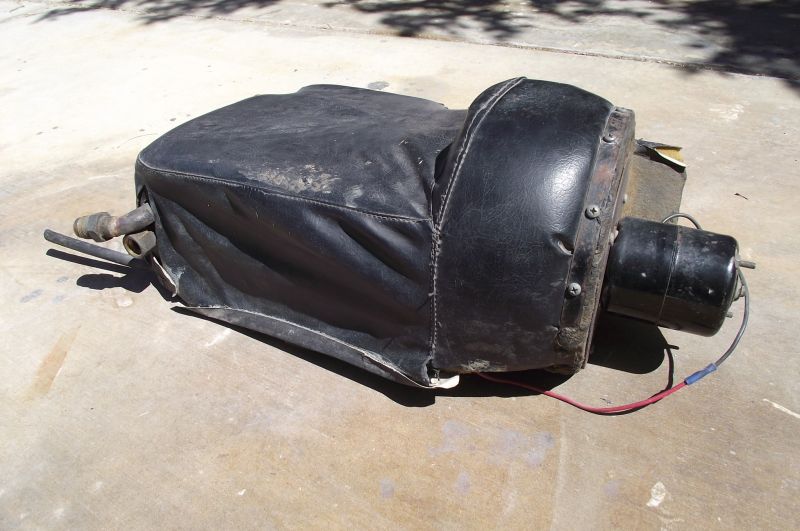

                                I believe the basic kit was around 5K however the basic kits were really designed for 356T6B and C cars. A unit could be retro fitted for an A car but the evaporator box and blower housing is designed to ride on top of the reconfigured B&C gas tank. You'll have to contact him for an accurate quote and details. To give you an idea this is an original trunk mounted evaporator box and squirrel cage:
                                As you might be suspecting there is a lot of engineering and plumbing involved I this not to mention a fender mounted remote oil cooler should also be installed to help dissipate the additional heat being generated.
