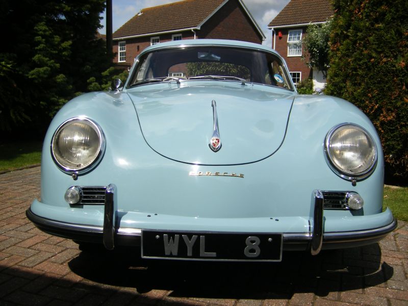

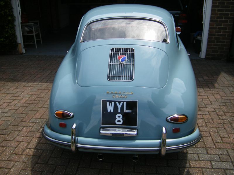

          • Murugesh,
            Regarding the badges, you need 2 off NLA 559-301-00 Gold Porsche emblems as shown on the page you posted. Some very early 356A had chrome versions. They fit front and back presume you have the holes for their 5 studs. If your car was a super engined version you need the separate 1600super badge to fit under the rear Porsche badge.
            You asked if I still have my 356A. Yes its been mine for 46 years now.
            See the front rear badges below on mine.

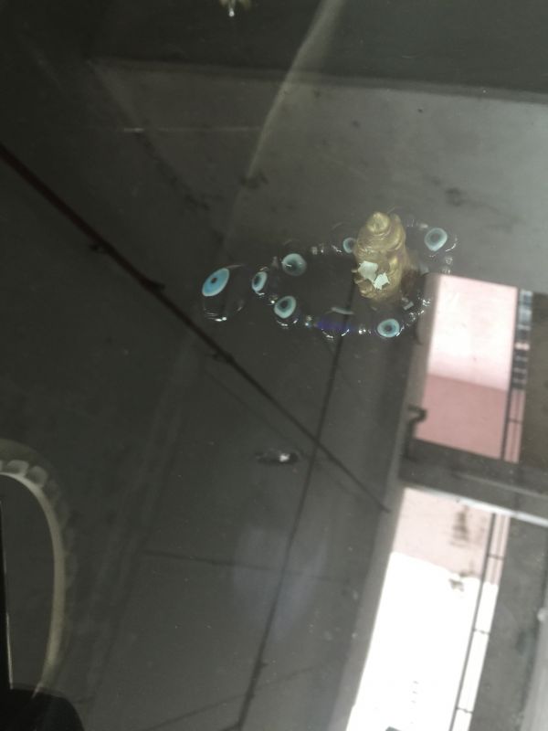

                        Today also,I got my first crack on my windscreen,which does make me awfully sad. Should i replace it, or just repair it.

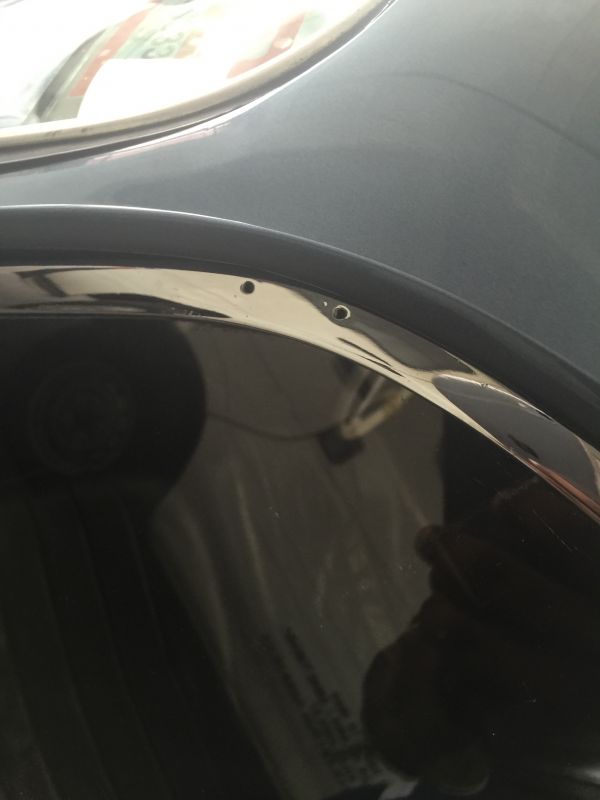

                        • Just wondering what are these 2 holes for? These are on the passenger door.
                          • Murugesh,
                            The best idling speed on the 356 is 900 RPM. 600 is possible but a bit too low. If you have to play around with the accelerator to lower it sounds like the advance slider or the springs are playing up in the dizzy. Its that 1200 rpm figure that makes me say that, did you oil the central shafts felt pad ( where the rotor goes on ) Also maybe 2 drops of light oil down a hole in the plate that holds the contact braker on might work too.
                            The crack if I see it correctly can't be repaired you will need a new screen eventually. ( Maybe the photo does not show it well ? )
