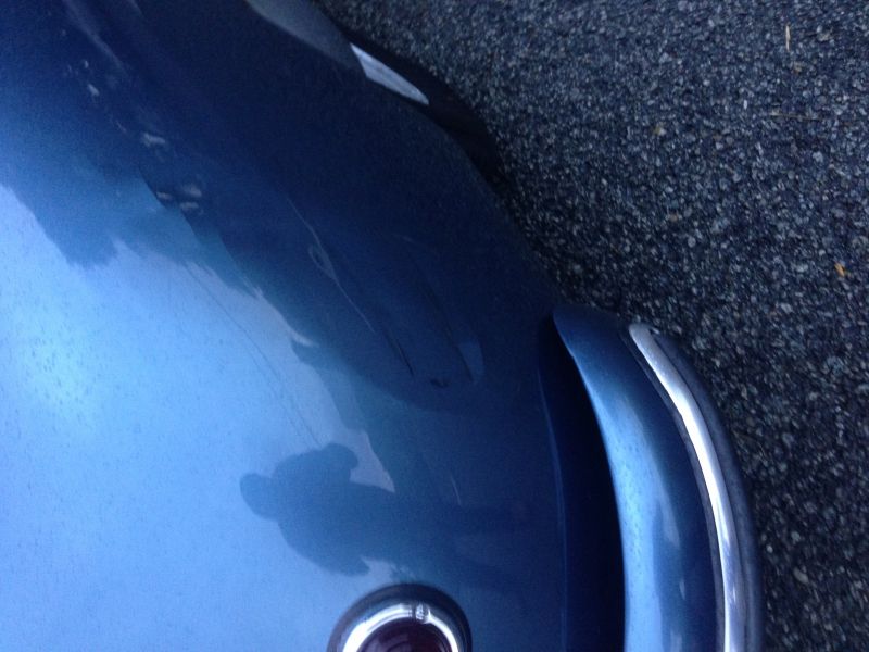

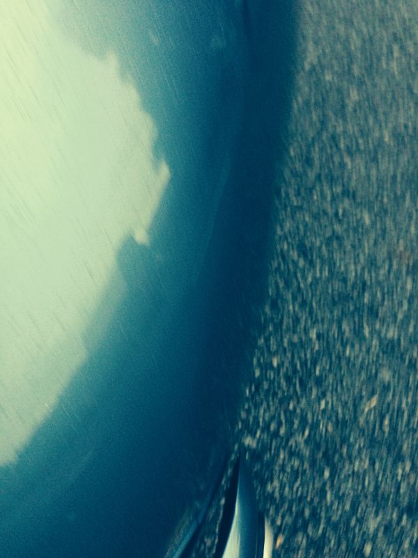

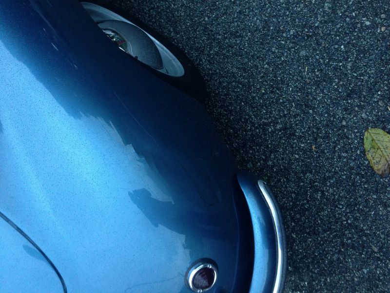

      • Oh the mechanic working on the car, misjudged when reversing the car and scrapped his 244 (
        I guess shit happens, waiting for the new year to send the car to the painters to touch it up. Hope they are able to match the paint well.

        • Murugesh,
          Shame about the paint! Wonder if you were given the paint coding?? Difficult to match on that area without knowing. Maybe on the restoration information if you have,someone has listed that? The original paint code when the car was new should be found when you open the passenger door and look on smaller identification plate rivited on the hinge plate. ( But maybe its no longer the original colour?)
          My throttle linkages etc are all original, If they work well and for example you can twist the ball ended part and it moves easily and smooth with no massive play then they are probably okay. I do grease mine with a light grease just a smear to lubricate. Remember if you go out to your car and without starting it just svivel those ball ended throttle rods they must be free to just move. If they are not the carbs idle will fluctuate.
          • The paint was painted in Melb by the previous owner. Hoping the spectrometer would help in my case. It's still the original aquamrine blue metallic and I am hoping that it can be matched perfectly.
            Thanks for the advise Roy. I need to learn how to grease my linkages. Will learn how to do so.
            • OOH! Can't believe that happened! Sorry to see that Murugesh. I hope you have shop out your way talented enough to blend that repair.

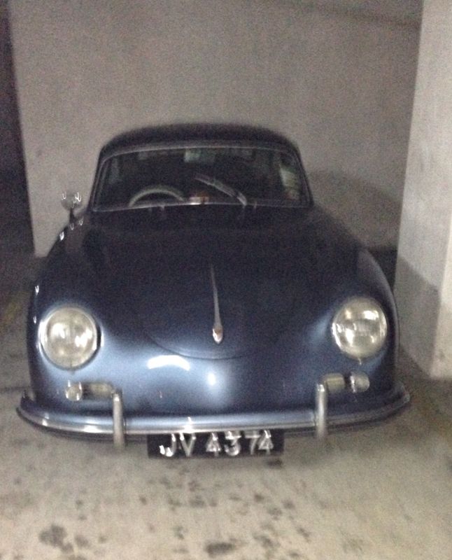

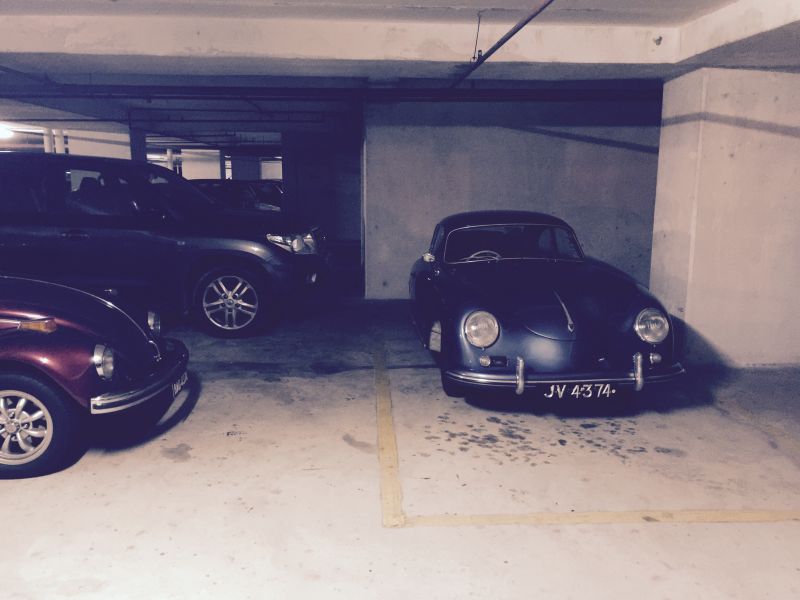

                • Best to you in the New Year as well Murugesh! This is your cars tucked-away home I take it?
                  • Yes Justin, this is the 3 cars back at home. Car has been painted and thankfully I can't tell with my untrained eye.
                    Thanks everyone.

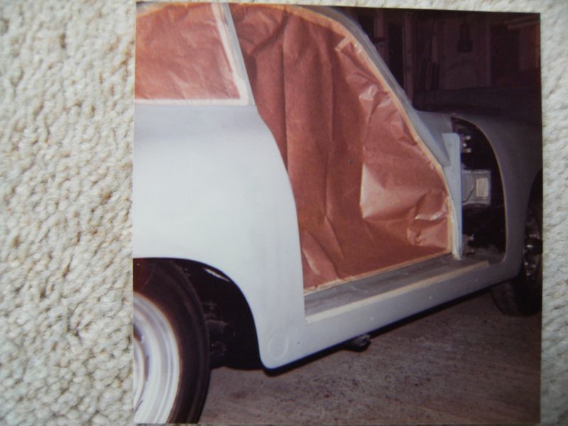

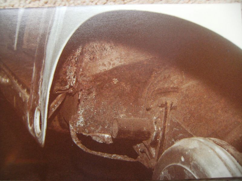

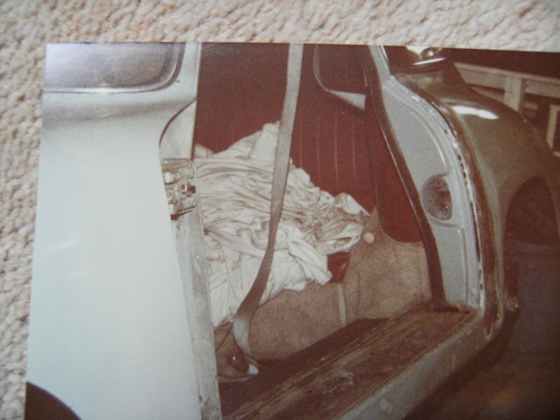

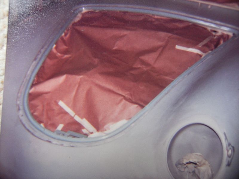

                                I was looking through my old photo albums and found a few photos I had forgotten about from around 38 years ago of some of the work I did then on my RHD 356A. A lot more are on slides which I have not converted. Put these below in this thread just to show I was trying to keep my RHD looking nice. The closing panel on the rear longitudinal was not driven like that. A few small holes and the hammer and chisel soon opened it up to the hole. I made of course the panel to replace and gas welded it in. For me, gas has that advantage of allowing the repair panel to heated to a point where after tacking it could be formed to match the contour of the remaining area so well. I must find at some point all my leading slides think my brother has them.
