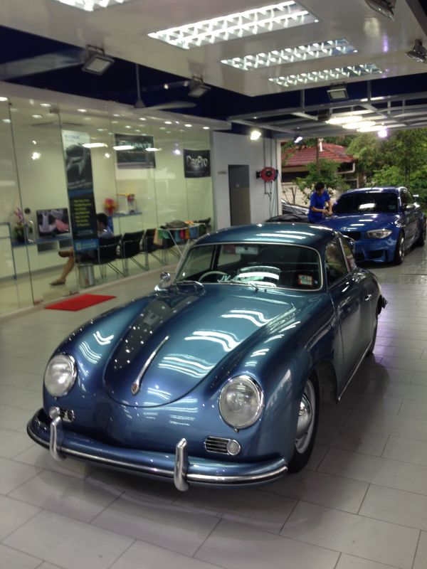

    So i took the car out of the anti rust shop and it is all done. Next step is to find a guy who can install an A/C.
    I drove the car for the first time today! Never really drove it before purchasing and I must say i am in love.
    I do find the throw of the gearbox a bit long and i think the bushings are worn, so will look into ordering those. Also the car feels a little 'wobbly.' I am not sure if that is due to the steering box, or the tyres.
    My uncle has suggested that maybe I put some spacers and run 175/80/15(if i can find them!)
    What do you think of spacers on the 356?
    Have they been put on before?
    IS there a ready made oil sump for the car?
    -I am thinking of installing an oil sump instead of installing an oil cooler,might be too big a job for the mechanics here.
    I would like to say thank you to Steve and Justin, as without your help, I might not have been able to get this beauty! ALso thank you to everyone else who has helped me in this beautiful search

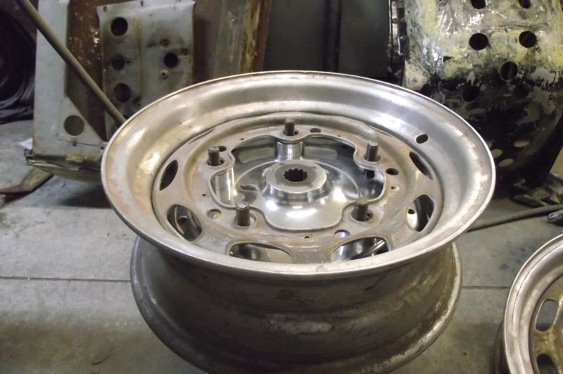

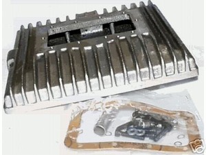

      SCAT offers a deep sump kit for 356/912 engines.
      Spacers have been used on 356 race cars since practically day one. If your going to run them you will need to install longer wheel studs.

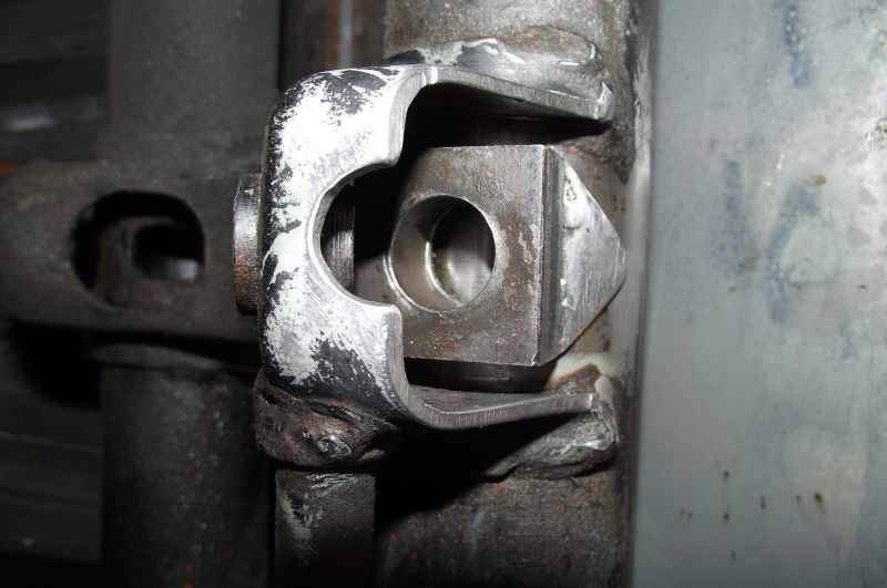

                    SJ is correct all 1956 and early T1 '57's were fitted with a standard type 1 VW steering box. Both my T1 coupes had them. The ZF introduction was one of those Mid '57 T1 to T2 transitional changes. I Posted this up a while back: http://www.abcgt.com/forum/4-356-Forum/5072-Evolution-of-the-356A-T1--T2-How-they-differ.html?limit=6&start=90

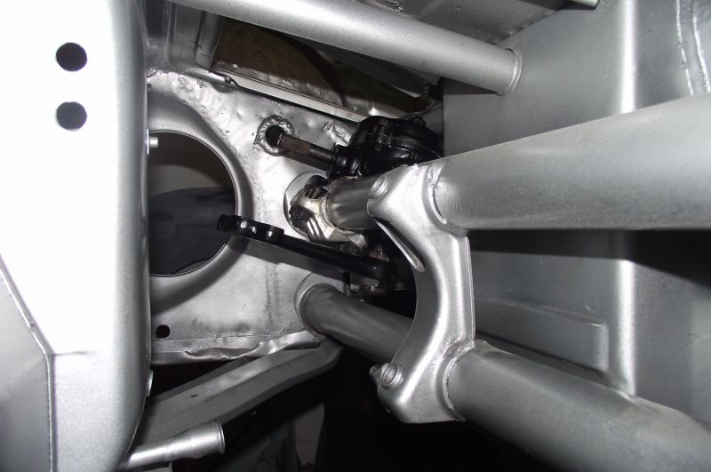

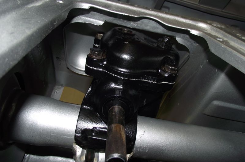

                    I've done the ZF upgrade on my coupe.
                    I've read that its an easy bolt-on upgrade but it was not my experience. This larger ZF unit doesn't fit or clear behind a T1 version battery wall as you attempt to install it. I could get it started on the beam but the cap and the wall soon collided not allowing it be rotated into final position into the locating dowel pin hole. I had to remove the cap install box then reinstall its cap. total PIA. You can see in this photo I trimmed away the center of that flange of the forward cover to buy more clearance but it still wasn't enough.
                    I tried every which way to get it to fit as one piece. Even tried without the pitman arm installed and also had the luxury of the car still being mounted to my rotisserie, no luck. I suppose I could have bashed the wall forward to clear but I couldn't do that.
                    You'll notice too that the T1 access cover in front of the steering box is spot-welded on and fixed into position. On later T2 covers both sides are removable. This change coincided with the ZF steering box introduction.
                    BTW: if your seals are leaking or weeping I've heard you can add engine stop leak or even brake fluid to get them to swell and buy some more time. I'm sure Jack would be able to confirm or debunk this.

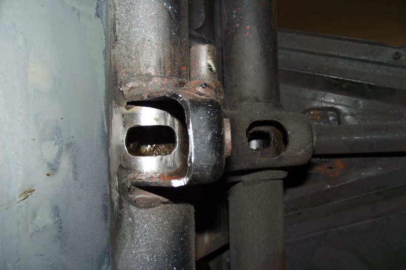

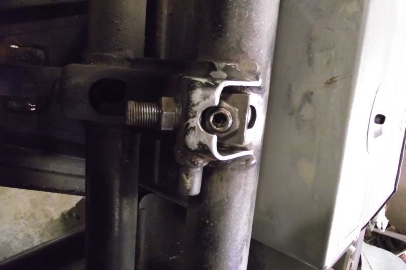

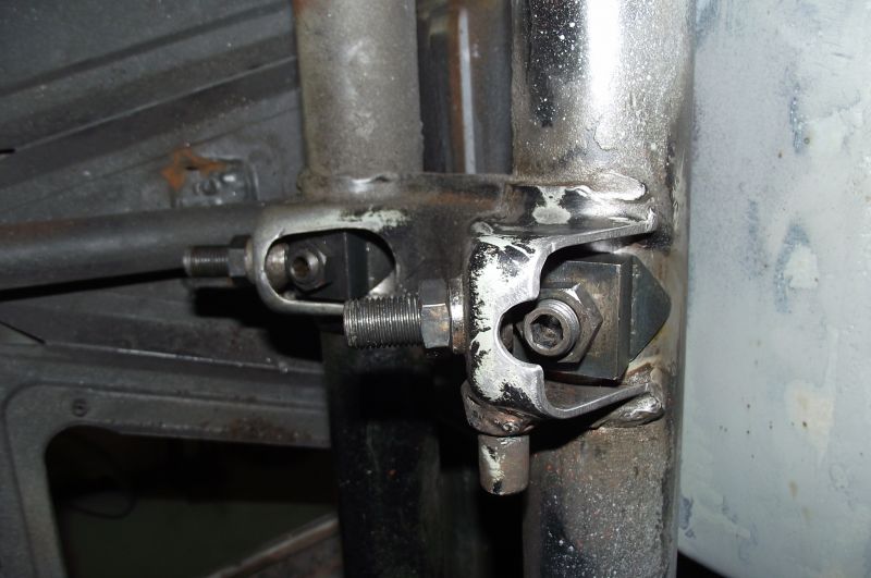

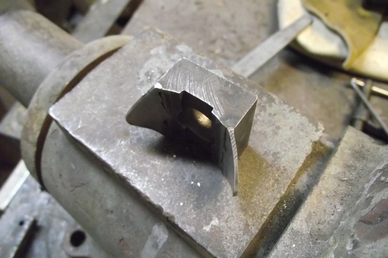

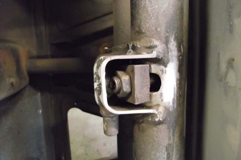

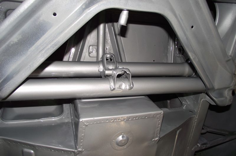

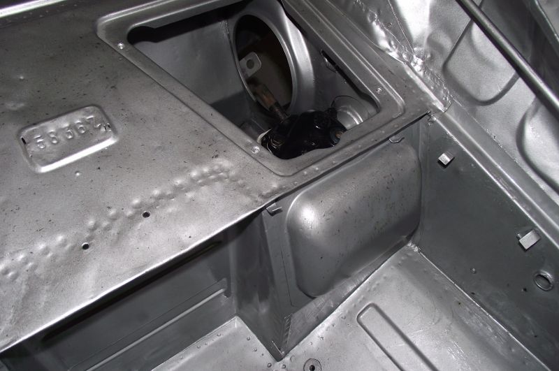

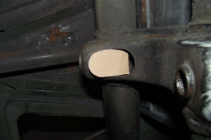

                            Thank you SJ, there was a ton of time spent in there to get that area prepped well enough for paint. I've never been a fan of the looks of a 356 in stock ride height form. The right stance and the attitude of the car are everything so yes, I am of that school of thought and the adjusters on my car were maxed out long ago while I still had it on the hoist.
                            The easy one was opened up first
                            As you are probably aware the shrouding must also be opened up to allow for hardware access.
                            Top shrouding was opened up which began with a paper template.
                            Didn't like the exposed adjustment hole with it all the way up.
                            I added a shield to both top and bottom of the block that way no matter where it sits the slot is covered.
                            The widened slot allows the block to travel and rest right up against the bung. This is as far as you go without major surgery.
                            Modification completed here. I figure by the time it translates out to the control arms its good for about 1-2 inches of additional drop.
                            Thanks again! Justin

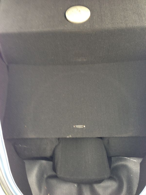

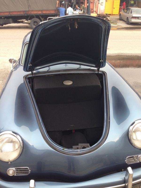

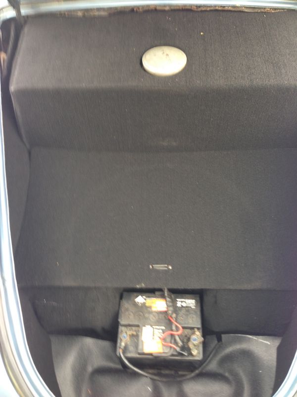

                              Collected the car today, carpet at the front is simple and spruces up the front of the car.
                              Next on agenda is;
                              1. painting some parts in the engine bay to spruce up and make it look 'new'
                              2. checking the wiring on the car
                              3. fixing the wipers
                              4. replacing the blown bulbs
                              5. replacing the felt at the window
                              6. checking the steering box
                              7. spacers 10mm front 15mm rear
                              Even though my car is a 1600, it feels much faster.My uncle who has a 60hp Beetle says it feels more like an 80hp car. In lieu of that thinking of getting disc brakes for the front. Can disc brakes fit behind the stock rims?

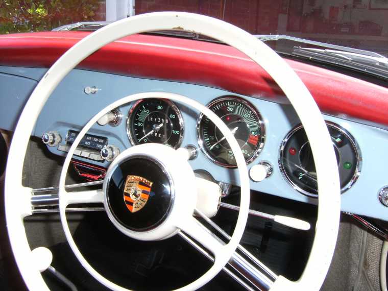

                                Sorry again for the confusion on the horn. I guess if you have the same as the photo here and your headlight flasher centre push button
                                works okay but the horn ring doesn't it could be the contact brush on the side of the steering column or the horn relay 7a The relay is on my car attached under the dash to one side and possibly on your car there is a relay 7b for the flasher which is linked to 7a.
                                The carbon brush is needed so the contact is made anywhere on rotation of the steering wheel. Maybe check all the earth wires and fuses as well. I presume you have the wiring diagram for your car.
                                Just checking the diagram Fuse 2 might be checked as connections for the horn and the wiper motor seem to be protected by that one.
                                Only a minute or two job to see if fuse 2 is okay, Don't want to lead you on a goose chase after my last comments
