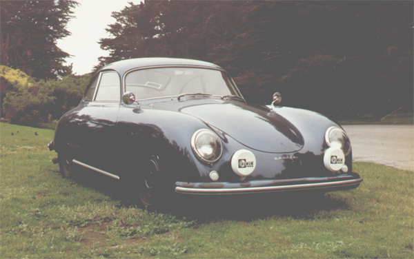

              I haven't got much (foto-wise) on this machine, besides some taken in '85. On the other hand, this was the best the Trusty Coupe has ever looked. Let's give it a try... Hmmm.. seems to have lost some density in the translation.
              The air dam I have had in mind is just a simple blade to keep more air from getting under the tub. I'd like to do a simple pan under the trunk cavity as well, but the mechanical (drill-no-holes)fasteners are a challenge.

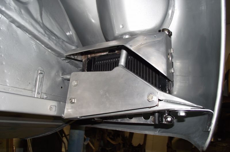

                    Similar to this non-evasive oil cooler mount and shroud I built a few years back:
                    Shrouds and cooler mount to a custom frame which clamps directly to the fender brace utilizing existing holes and requires no modification to the brace or car.

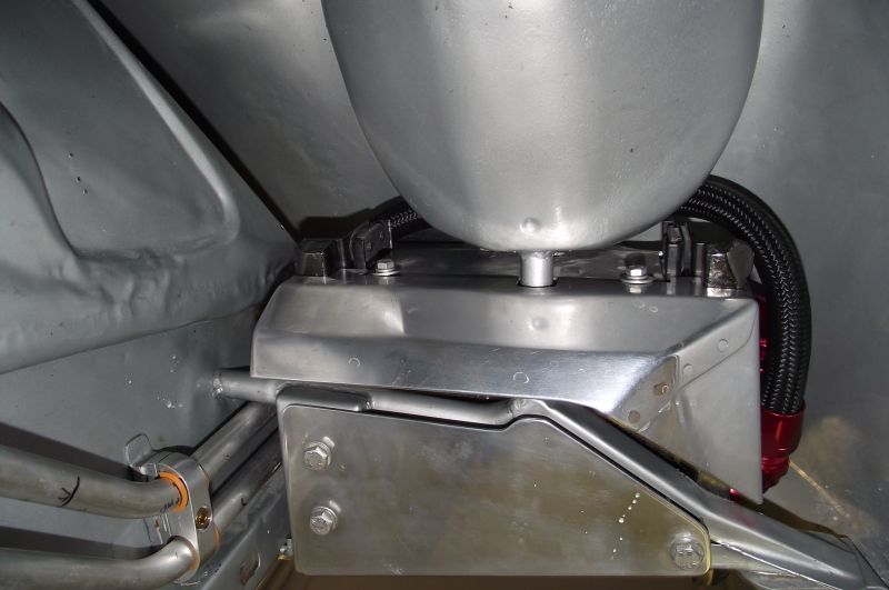

                    A better view of how it all sandwiches together. That was rule number one for this project; it had to bolt-on with modification to the car.

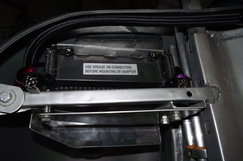

                      • Thank you! I spent way more time building than I should have but I just couldn't bring myself to cut corners. Exit airflow won't be too restrictive as the earlier vantage shot makes it look more closed off than it really is.
                        Mine just mimics what the factory originally did only shaped and changed to work my specific needs.

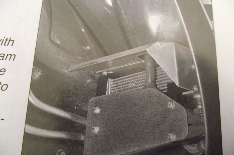

                        Its pretty open as this vantage point shows. Just had to make them overlap enough to protect the cooler from rocks etc. slinging off the tire.
                        Don't let the welding slow you down. You can still make the paper templates and have all the basics down for a local welder to finish up.
