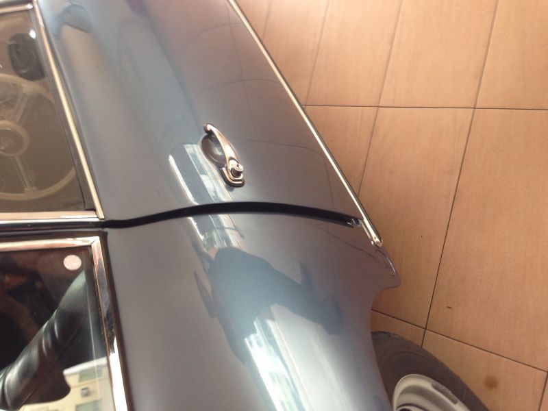

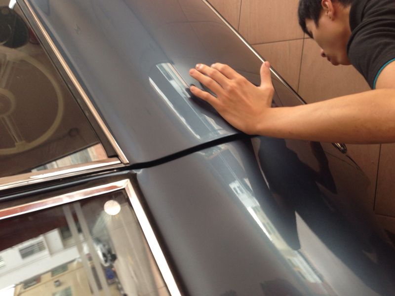

          • #65

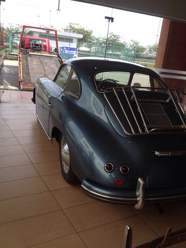

            Attached are some pics. Not sure why it's Suddenly out of place. Was fine 4 mths ago and fine when I opened the door.
            Did I slam it too hard
            • #66
              Justin, the car was in perfect shape before this. Could it be the hinges?
              • #67
                Hi Murugesh,
                No, don't worry its definitely not in the hinges or anything serious. If it was fine when you took delivery than what appears to have happened is the striker plate has been bumped out of alignment. Your remedy is to loosen those 5 large screws that hold it on and readjust the plate.
                • #68
                  Murugesh, just got an email response back from Bruce Baker:
                  I'm kinda thinking option 3 on his list. You may have tipped the inner handle to the locked position. Push it downward and try again.
                  • #69
                    Will definitely try this. Am a bit busy this next few days...and car is in the importers showroom.
                    My next step with this car, is to get some anti rust smothered on the undr carriage. The humid weather down here is Rust's best friend. The car is rust free at the moment and I am looking at options. Would zinc oxide and marine paint suffice?
                    • #70
                      Cars finally gone to the shop to do the anti rust. Door somehow is magically ok now

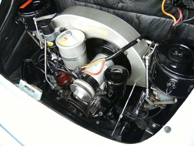

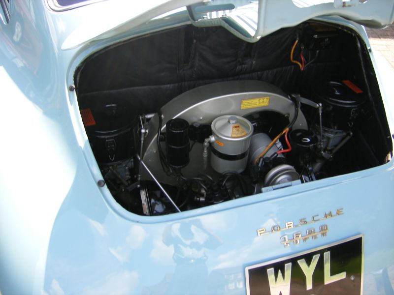

                      I am wondering is there a piece of rubber which is missing from the engine bay?
                      • #71
                        Murugesh,
                        The engine bay ( or where the engine lid closes onto is missing the 4 off rubber stoppers. The engine bay does not have a rubber seal like the front hood lid.
                        There should be 4 holes to insert these into. The photo of mine shows the rubber stoppers. Stoddard will sell them.
                        One of the rubber stoppers can be seen lower right in the photo above.
                        Just found another old photo of my car showing all 4 off stoppers.

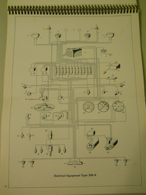

                              Also the electrical schematic depicts beehive lights. Hope this helps.
