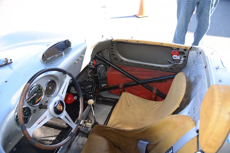

  • Just got confirmation that Fritz Schiedel - Joe Sheppard's mechanic drilled all the holes in the body of 550A-0144. Even the seat belts were drilled! The current owner has had the car since 1962.

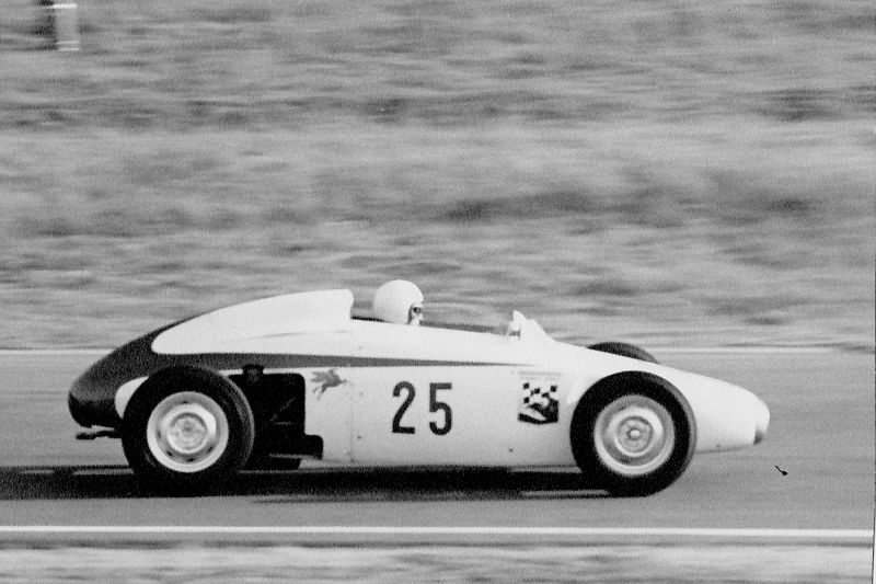

      • Did the Behra Porsche look something like this?

            • re Behra Porsche---
              I've been in LA and do not have info with me. I believe the '25' photo is not of the Behra Porsche. I have a photo of it at Porsche.
