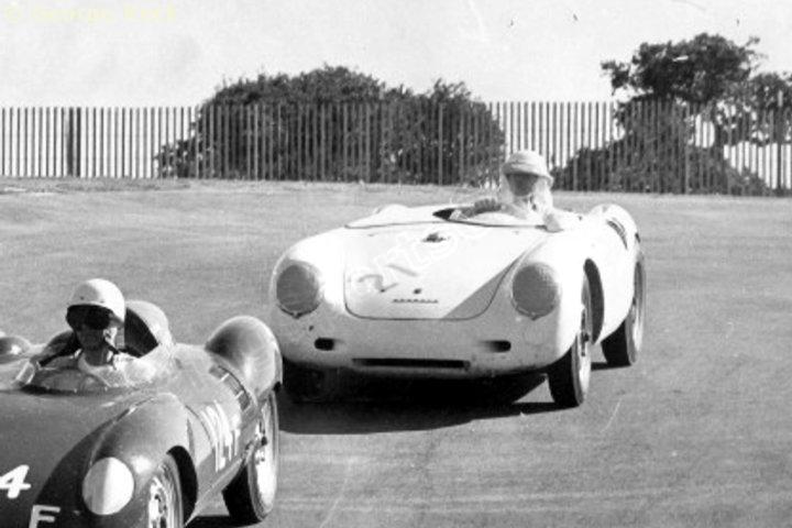

                        • Hello Everyone,
                          Steve Heinrichs has asked me to respond to a photo that Andrew posted about Erv Lehr at 8-9 November 1958. #25052He has shared a photo that shows Lehr with start nr. 21 and George Keck with start nr. 124. We will change Lehr's start nr. 21 from red to black font since we are now certain that he had start nr. 21.
