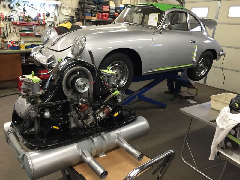

    Don, any time you want to stop by the shop is fine. I am here most Saturdays. That applies to anyone who may have an interest.
    I had a true "open house" when I moved into this shop in 2000 and a tech session or two since then. Always well-attended back then but the local 356 scene has become hard to organize in the last few years. A few have tried to organize informal events (like drives) but cancelled due to "lack of interest."
    Now, it's so busy and crammed with "stuff" I am embarrassed to have a formal party, but there are 'interesting' things here to see occasionally:

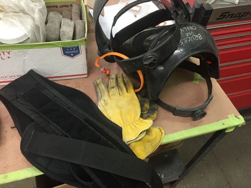

    As for sound deadening, I just walked out into the shop and photo'd my most used personal equipment. Ear protection, face and eye protection, hand protection and back protection. Out in the shop I or someone(s) else are always hammering, grinding...or both. Even using the shrinking disc is too loud for unprotected ears.
    My hearing is getting worse. Too often during our typical "height of immortality" we thought "aw, this little bit of standing in front of the rock concert speakers won't bother me later" or going to drag races (or any motor races) or at either end of an airstrip, etc. I did a disproportionate amount of "all of the above." Now:

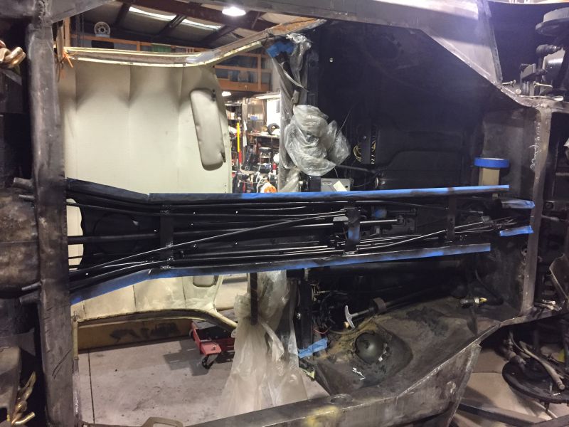

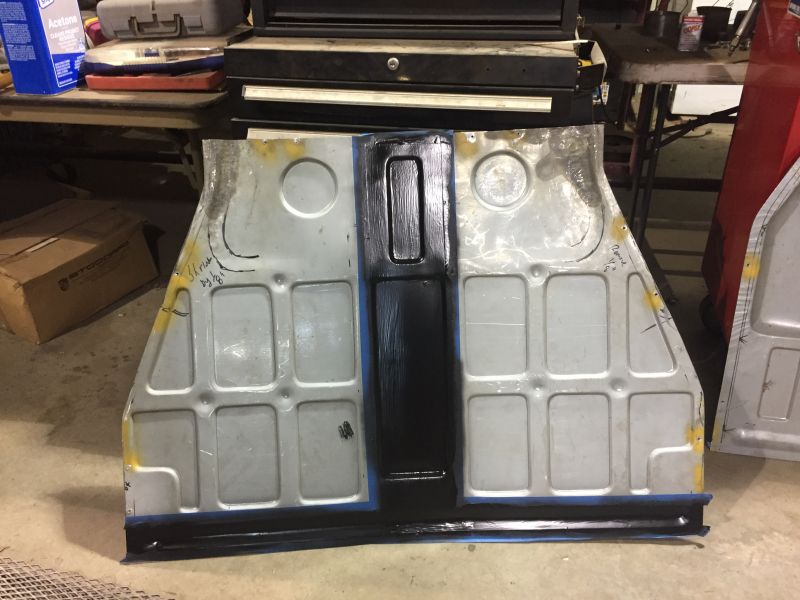

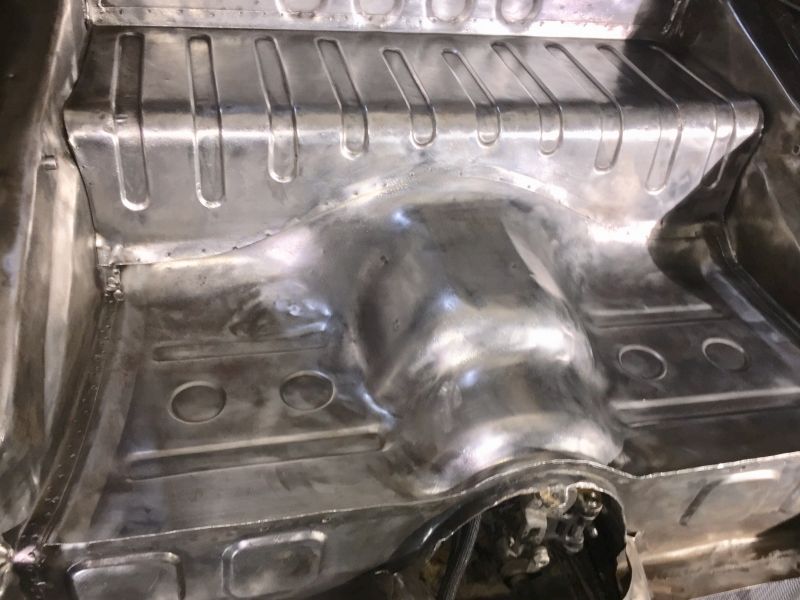

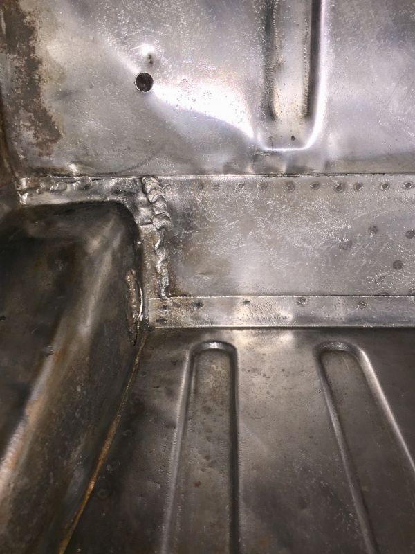

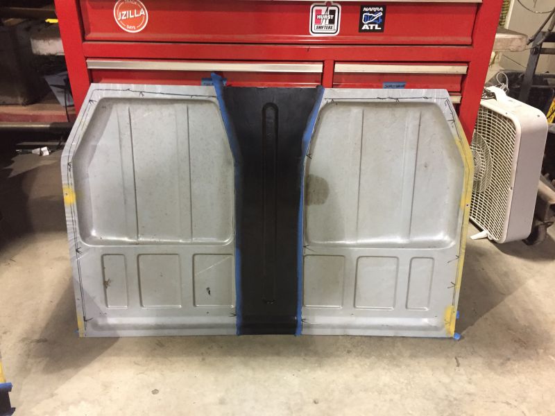

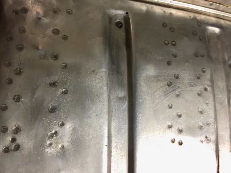

    • Progress! Getting closer to floors. No glamour shots, just small steps.

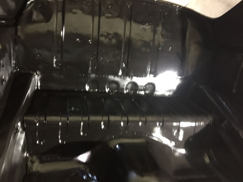

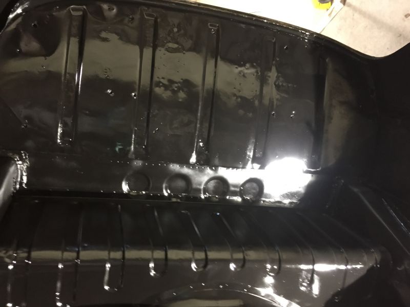

      • Would some of you post up your methods and materials used for seam sealer? Inside and underside please. I have used both the caulk tube and the brushable. I see a lot of guys use tape to get perfect lines, which I'm not sold on for this car. Plus I don't remember ever seeing anything done to perfection from the factory. On my other cars I have gooped it on and brushed it down being more concerned about protection and never wanting to see anymore rust ever again. Plus by the time it is Shutzed over will you really notice? On the inside it gets covered by sound deadening (see above) and carpet. As for brands, I have used Wurth brushable and some Eastwood also. Caulk tube stuff was 3M second tier called Dynatron. Worked pretty well.
        • Looking great Mark! Blind spots all coated with Por15 I see.
          I've posted it before but I really like 3M's "heavy Drip check" in a tube. That's what I used on my car. So glad to see you making progress here again!
          • [quote="JTR70" post=40234]Looking great Mark! Blind spots all coated with Por15 I see.
            Justin[/quote
            Justin, did you use the drip check from the tube on all areas? Wasn't that challenging squeezing it all out a tube?
            • All areas; it was good forearm work
              • Originally posted by JTR70" post=40308

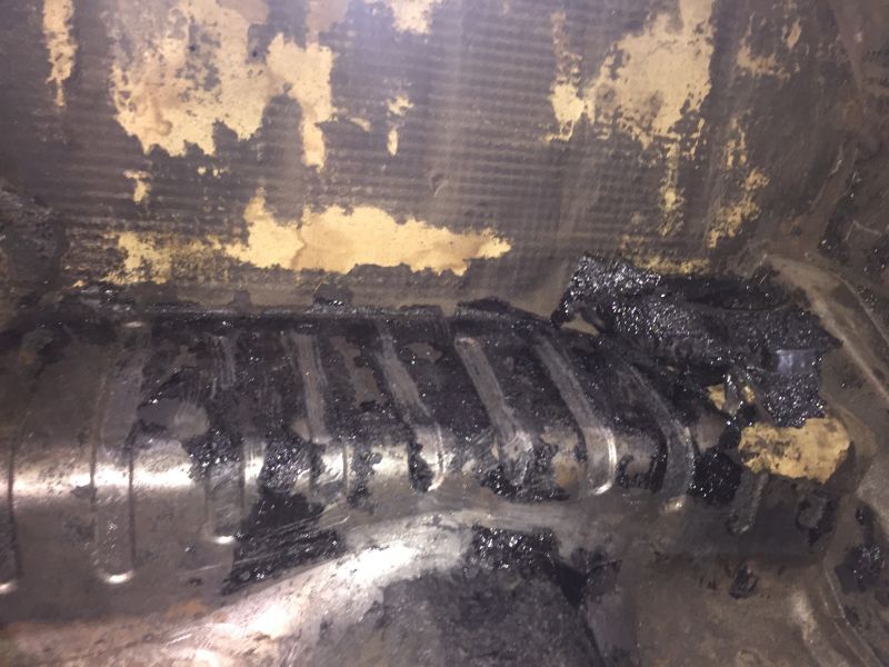

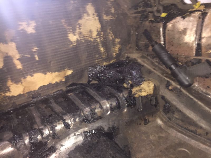

                Too much work for me! My hands and arms are already a wreck from Needle Scaler during sound deadening removal as next post will show. Caulk gun for me.

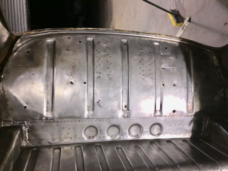

                  • During:

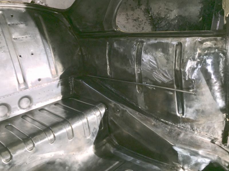

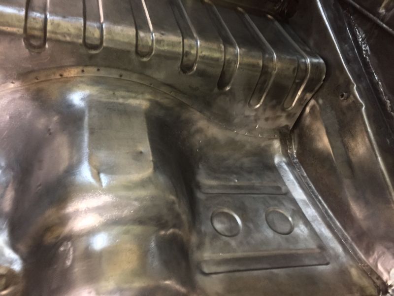

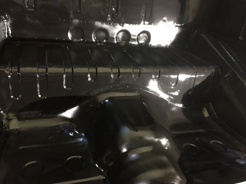

                      • And the finished product.

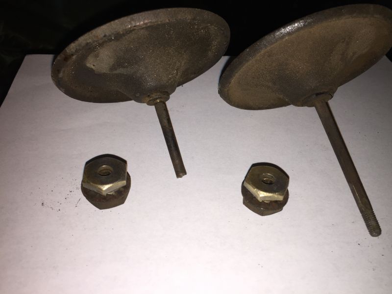

                              • Where can I buy one of the rods? One of mine is broken. Or do I need to have one fabricated? In my haste to clean car I also wire brushed the chrome off the lock but ?? That will cost me.
