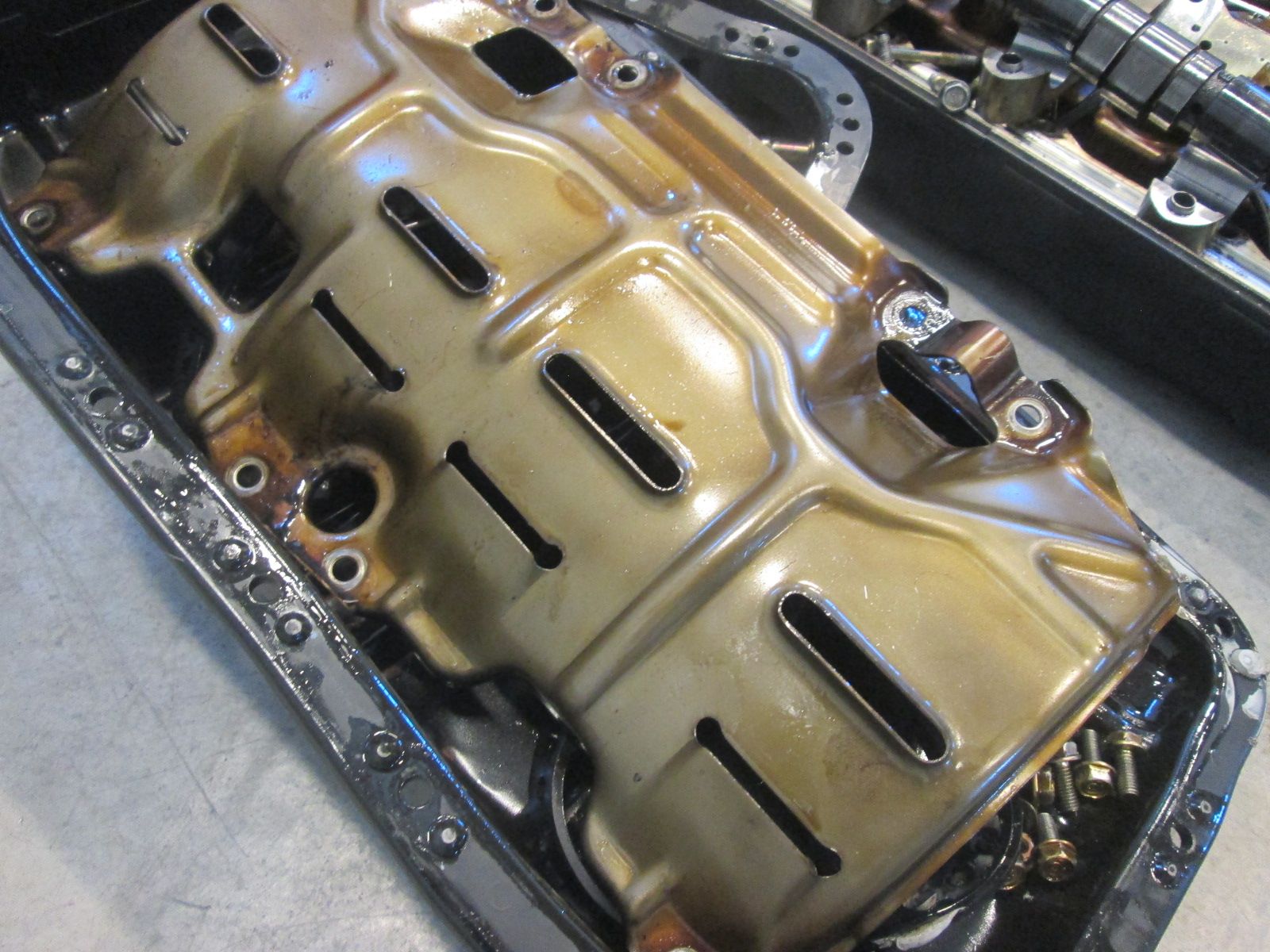

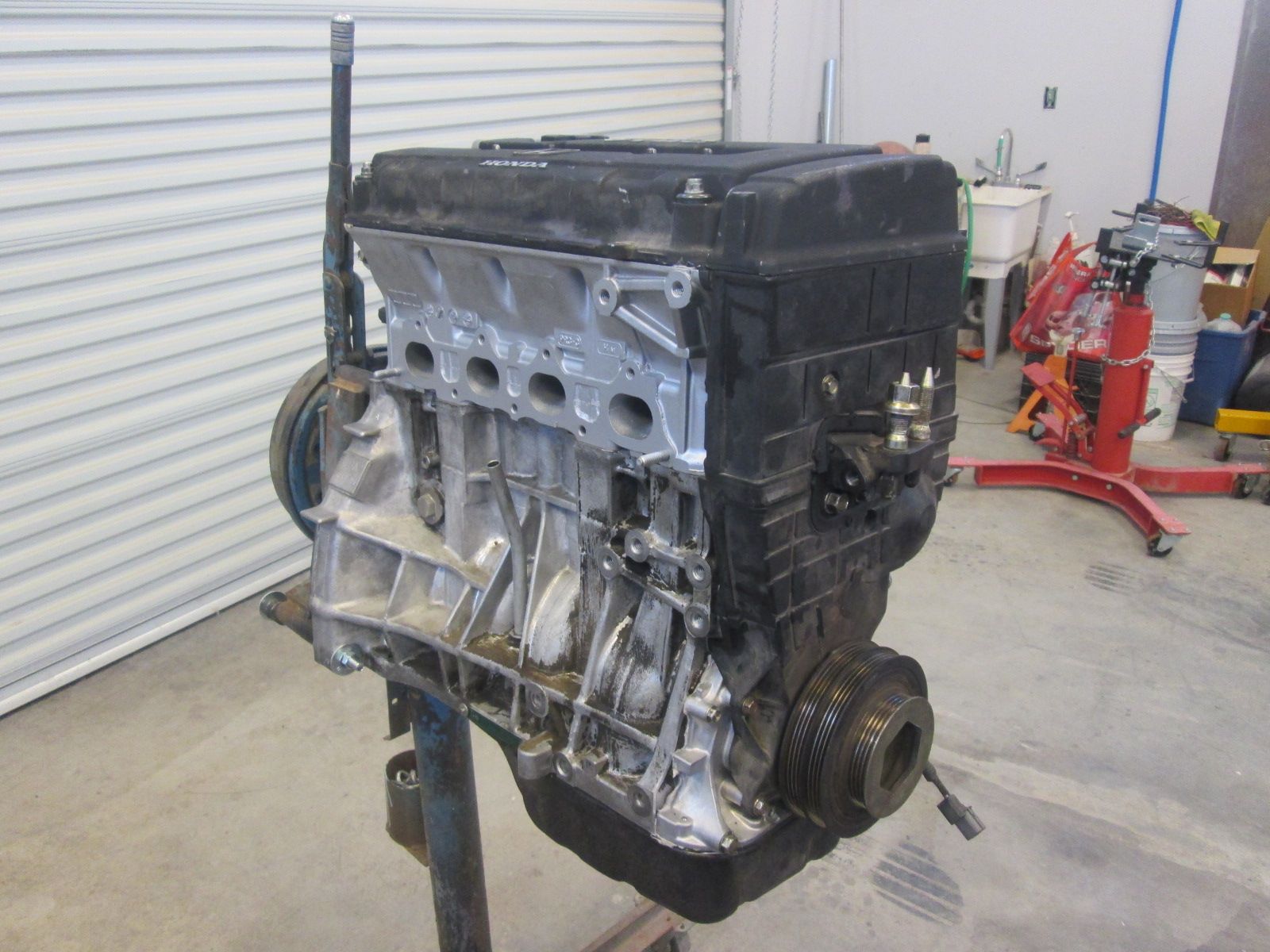

I let myself get intimidated by the V-tec logo on the valve cover so I thought I needed a Honda "expert" to rebuild my motor. This is how it looked after its rebuild and 2,500 bucks later. The head and block went to a machine shop and my expert did the reassembly. Other than the residual dirt I was getting old black oil running out as I rolled it over to install the accessories, I was screwed.
All the old oil and grime was there along with pet hair and Debrie from sitting on his floor for month. Nothing was cleaned just reinstalled.

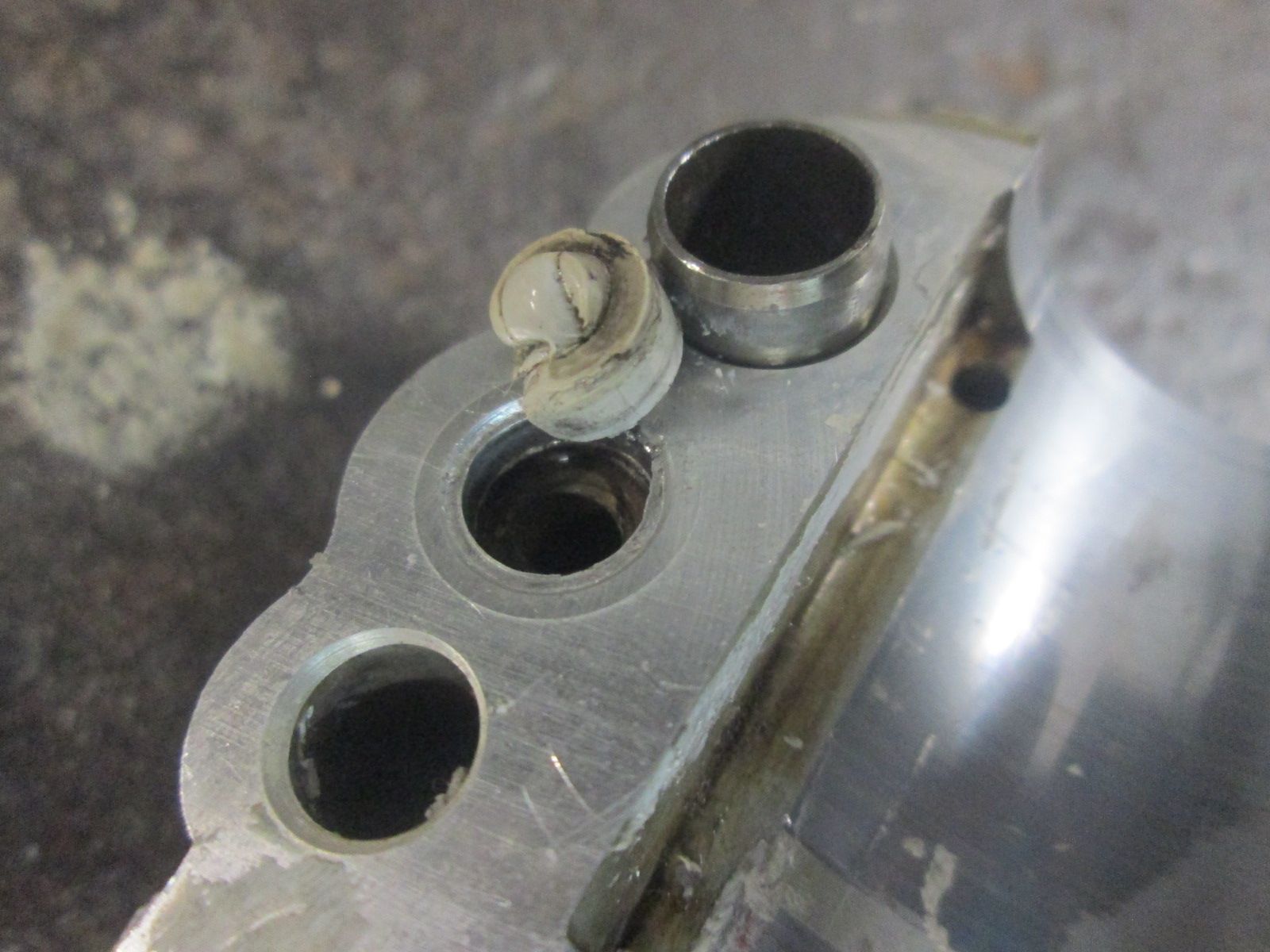

I found oil galley's on the cam caps plugged with Honda bond.

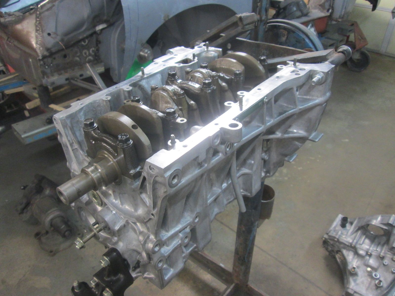

After watching several really good reassembly videos on youtube I had all knowledge and confidence I needed to handle it myself. Back down it came for a proper prep, cleaning and reassembly.

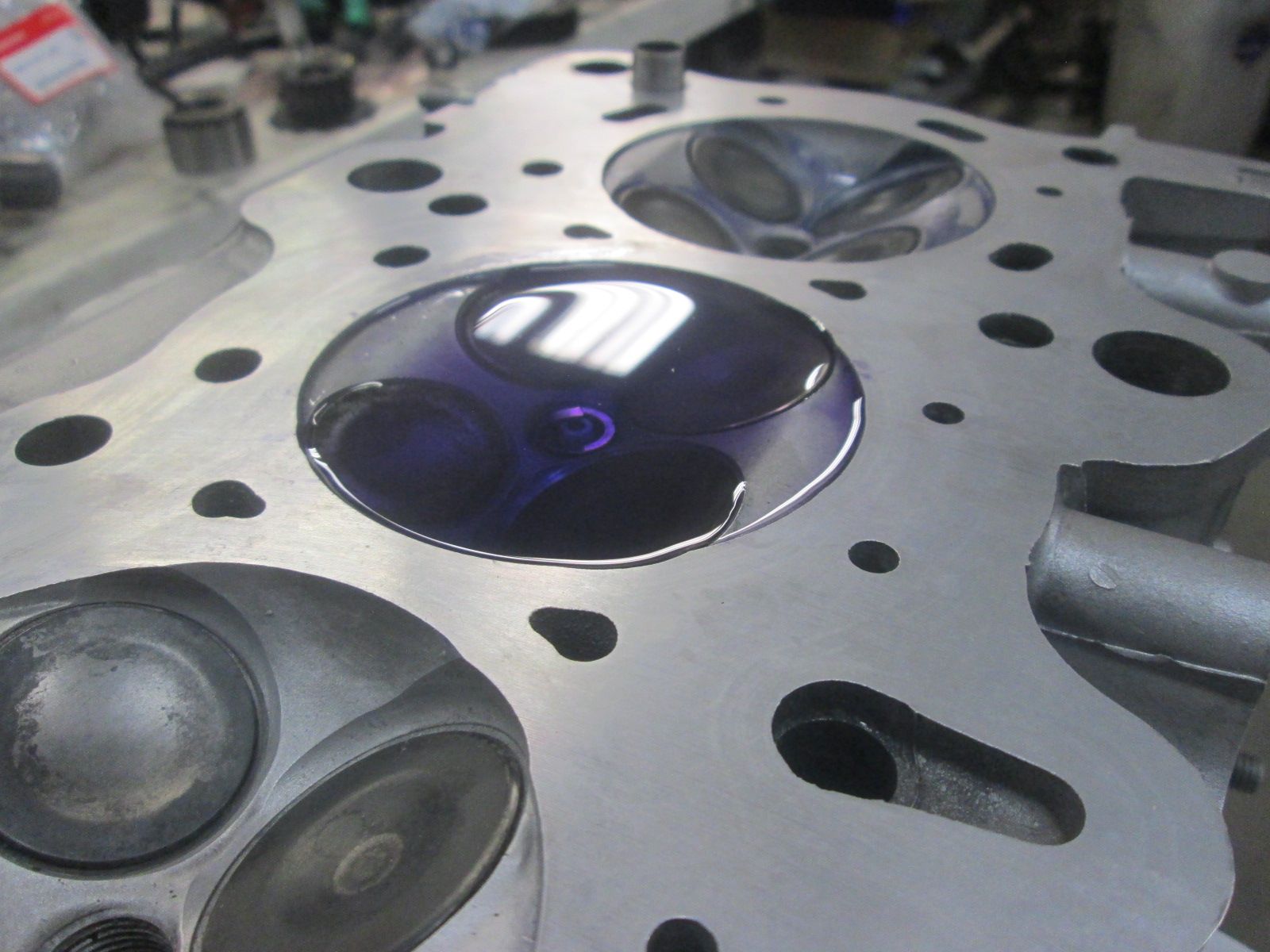

Leak tested all the chambers and found three valves that needed further lapping. Back to the machine shop that performed the work it went.
