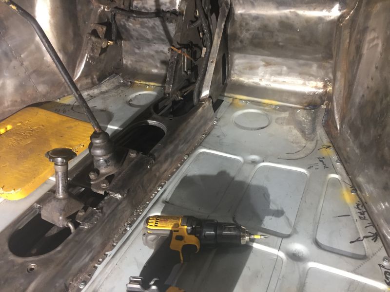

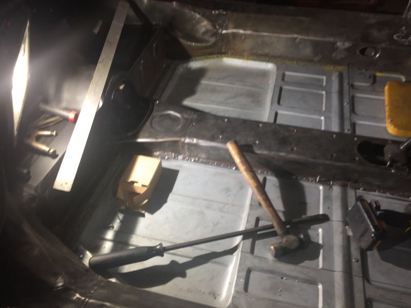

              • [quote="John Pierce" post=36699]
                • Good list of things to do. Nothing wrong with OCD

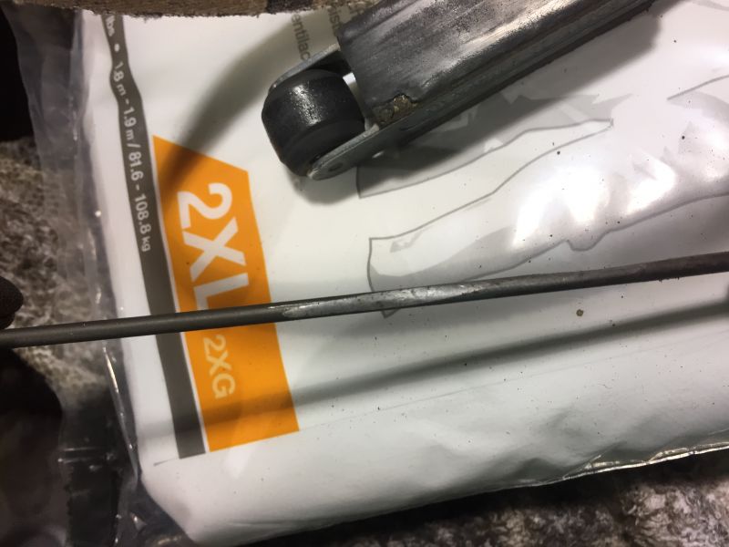

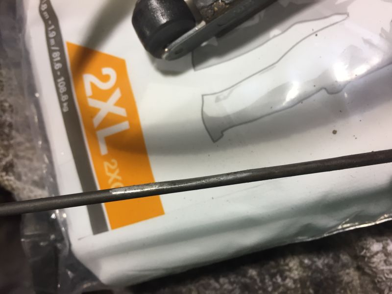

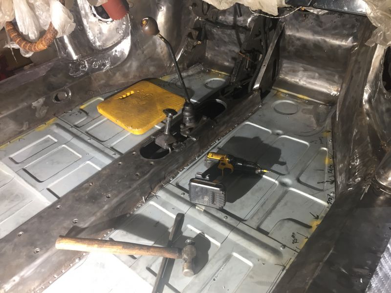

                        • The bottom of my shifter rod has a spot like that where the floor was pushed in long ago. I wouldn't worry about it as you'll never introduce enough force to pull it apart. You might want to run it the other way around to reduce the chance of it being "worked" more on that spot. Or run a bead of weld and build it back up.

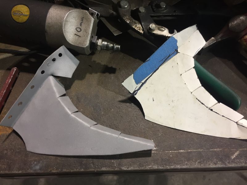

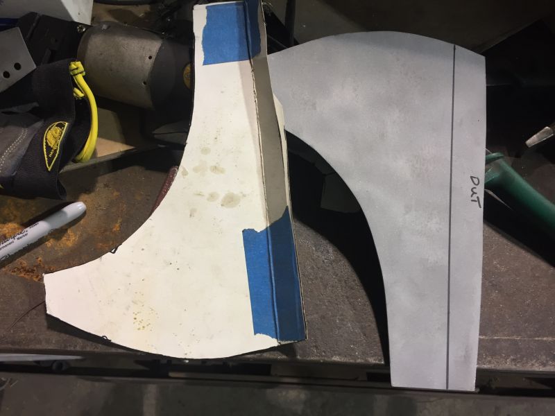

                            • Work continues with further detailing of floor edges, which is probably a waste of time because once this pan is welded in place it will be Seam Sealed so throughly that is will second as a bath tub. Appropriate given the nick name our cars have. Last major piece before floor goes in is very similar to work John Pierce is currently doing. Funny I made this template and first piece a couple of years ago, right before my last hiatus. So resuming this was easy. Larger gusset is also built.. Both pieces are now primed and ready for next shop visit

                              • That looks great. Too funny.... We're twins
