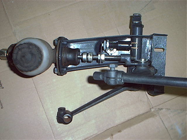

    I've only done this once, but if your tunnel and inner long. flanges are in the correct elevation, you should be able to weld the pan in without regard to the pedal assembly. Once the pan welding is done, the pedal assembly can be bolted to the bulkhead with the m/c studs so you can determine where to drill the 3 holes for your bracket. Keep in mind that the holes in the pedal assembly for the bracket bolts are actually slots. That is because you install the m/c studs first, then rotate the pedal assembly down over the bracket bolts, thus the need for the slots.
    • Thank you gentlemen. I hope my round embossment is in the right spot. I have time to move things if I need to. Not sure what Phil means about the holes being slotted tho. Exciting to be getting closer.

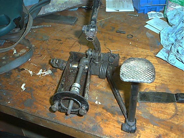

        The pedal assembly "frame" has 3 slotted holes that your under pan bracket bolts go through
        You can see one above
        • Originally posted by foamcar" post=40139
          Mark
          Ah, now I understand. For ease of installation into car. Thanks, Mark
