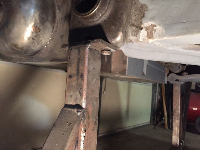

                      Hi,
                      Here's a few shots of my rotisserie.

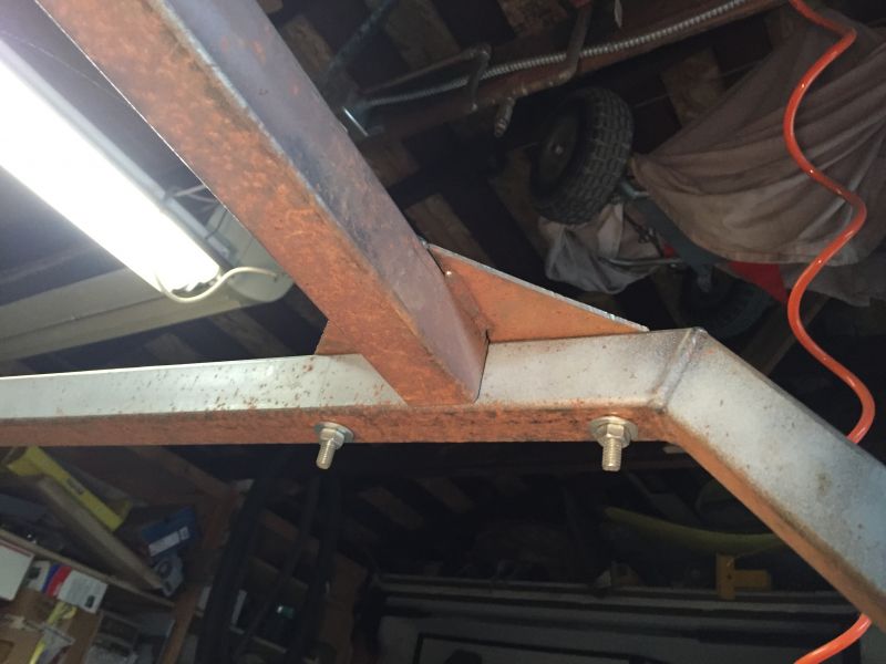

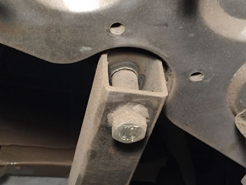

                      The rear attaches to the trans hoop. There are round sleeves welded in so the square tube doesn't collapse.

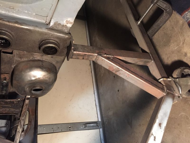

                      Here is the front, I think it's a 1/4" thk plate welded to the square tubes.
                      These bars are moveable to several different locations to allow access to whatever it is you are working on. The gusset plates do stiffen the hoops.
                      Perhaps Steve will chime in here, but his advice was not to grind the welds smooth. Unfortunately he had one fail and caused a little damage to his car.
                      If you want, I have a drawing with all the dimensions I used. My contribution to the Emory rack design was to adjust the lengths so all the cuts are at the same angle and the car can be rolled with a low ceiling height.
                      You will love having a rotisserie as it makes everything much more pleasant.

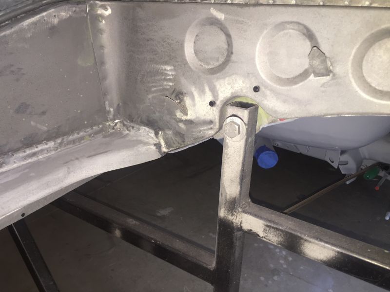

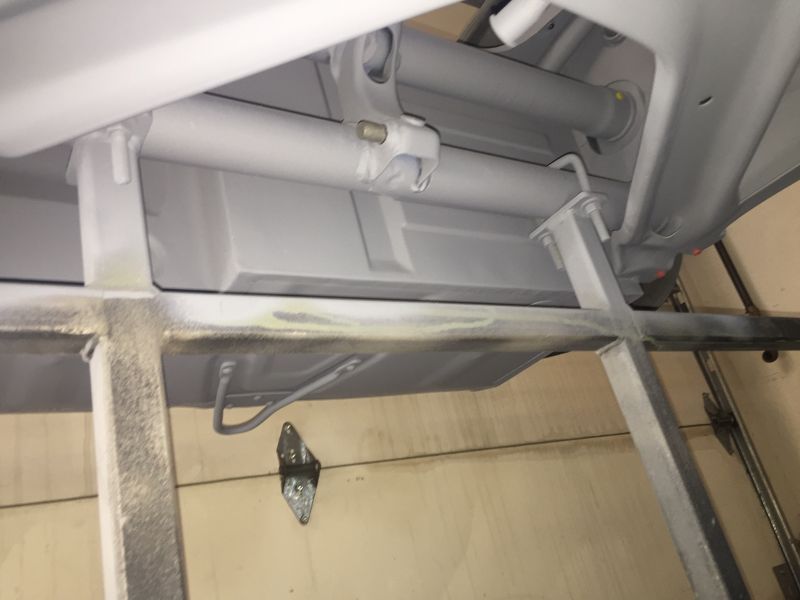

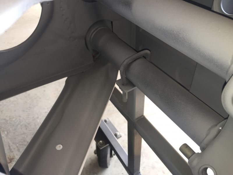

                      • #41
                        Here's my set up:
                        The rear is the same as Tom's at the transmission hoop bolt attachments.
                        The front is different as my torsion bar attachments were rotted out and had to be remade. I bent threaded rod into a loop to go around the lower torsion bar assembly.

                        HTH. Let me know if you've got any questions.

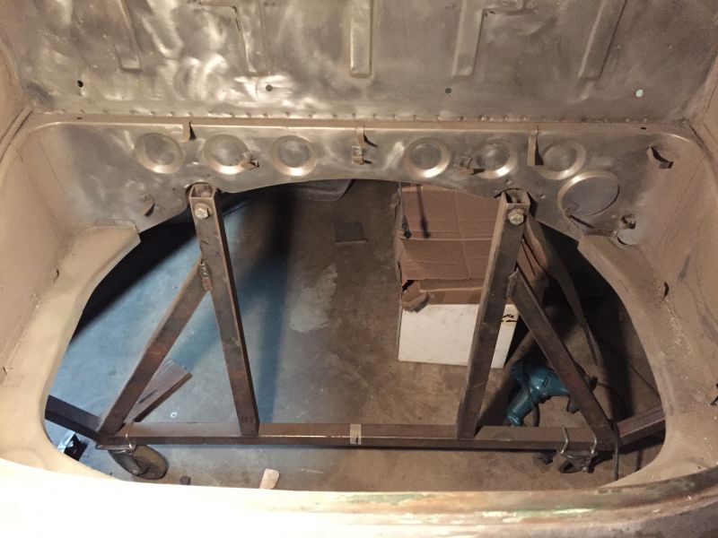

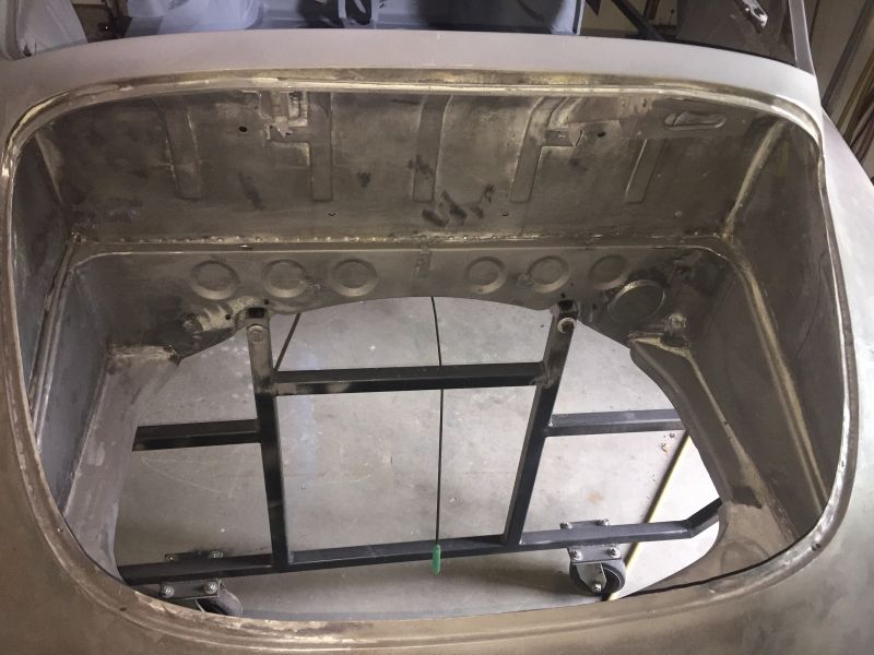

                        • #42
                          Great, excellent help........my rotisserie is coming along nicely......
                          need to get a weekend on it to get it all set up and braced correctly. aware that there can be body flex so plan to brace it well.

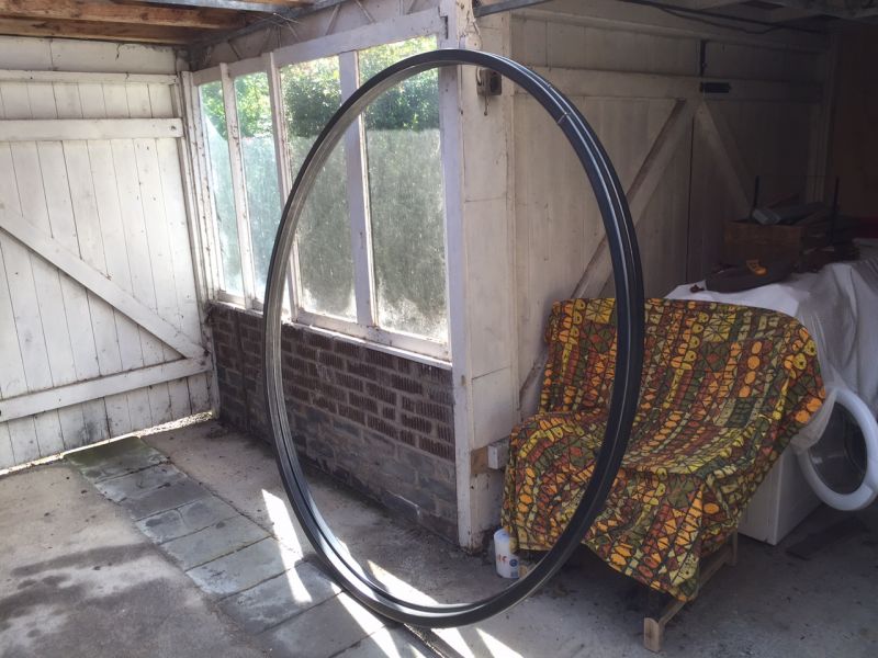

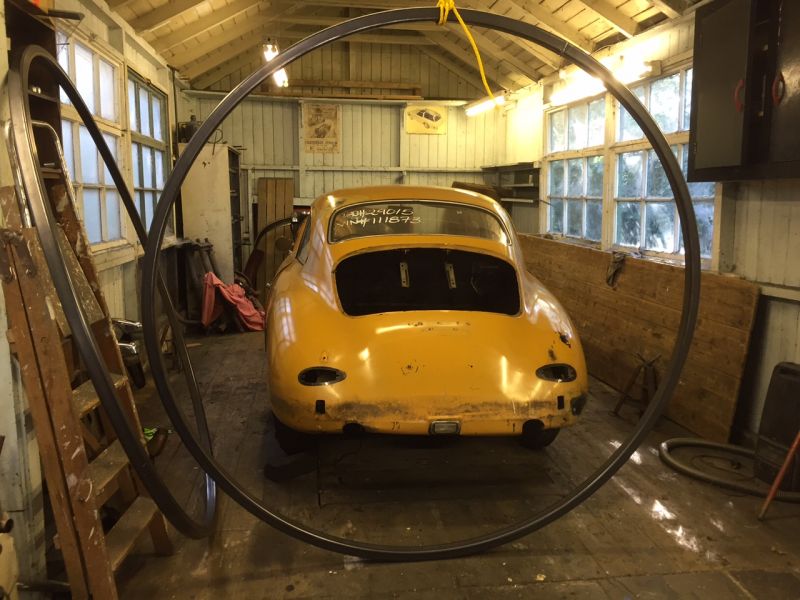

                          • #43
                            Looking good! I see you're going with the same "hamster wheel" design as Trevor Gates is using for his project. I think that was the right choice given your limited lateral space. I meant to ask Trevor a long time ago but where does a guy go for perfectly round square stock hoops?
                            • #44
                              yes exactly limited space means a rolling systems was the only option really. I went to a steel fabrication company who rolled and welded the steel to my measurements.....very quick turnaround.....only 2 days and for a very good price.
                              • #45
                                Mark,
                                What diameter hoop did you have them make?
                                Thanks!
                                Don
