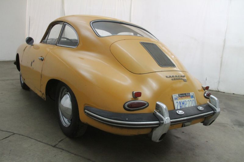

    Hello All
    So i have been watching from afar for a while and am super impressed by all the work that you are doing to your cars....an inspiration! so much so I purchased one in california and it is in a shipping container on its way to me here in the UK. I have come from the VW world and have restored my 59 splitscreen over 4 years and have just completed a 4500 mile round trip from the UK to morocco over 5 weeks which was amazing! Im a surfer so i spent a fair amount of time in the water which was awesome!
    Im sure that some of you may have seen my new 356 on BHCC it was the yellow/orange car that is actually fairly complete apart from the engine which is a date correct super75 instead of the original 90, but is seized. Initial plans was to do a full bare metal resto from the off but im thinking more and more that hidden under the orange could be some fairly good black OG paint that it might be nice to enjoy. It obviously needs welding work, battery box, below doors, headlight bowls and surrounds. behind door striker area. longitudinals. im sure more as well!
    I want to find the correct engine (ideally!) and am in the process of tracking down the original owner to see if it may still be lurking in a shed unloved! i can but dream! And if not an engine that is as close to the original number as possible.
    What are peoples thoughts on trying to keep OG paint and using it as a bit of a beater for the moment before I do a full blown bare metal when i have enjoyed it for a few years? What ever i do due to UK laws i will need to do all the welding and necessary mechanicals so wonder if it is worth it or not to go the whole hog from the start?
    I will post some pics when i get chance but wanted to get something down here and get some pointers thanks

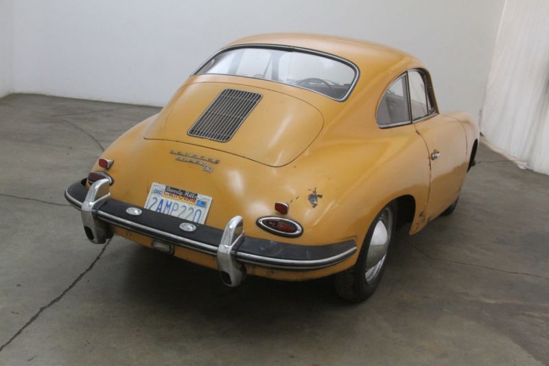

    Bumper in the photo is installed up side down. Check for the drain holes on the trailing edge.
      Hi Mark,

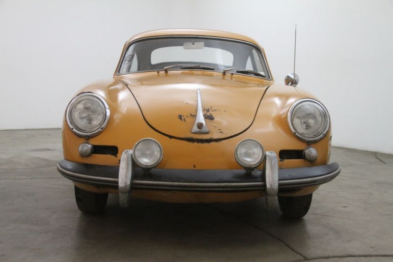

      Congratulations on your first 356! Thanks for joining us here and Welcome. These cars can become an obsession so tell your girl not to be surprised or too upset when the next one shows up. Sounds like your VW resto was a real milestone and what a way to cap it off with a 4500 mile trip; quite the adventure I gather. Your new project car looks to be relatively unmolested and complete. You'll find out soon enough exactly what you have once you begin really poking behind carpet, panels etc. Without anything to go by but this photo you may very well have some serious chassis repairs to attend to. The cancered out area above the headlight seems a bad omen to me. I hope that its not the case but it wouldn't be an old 356 if it wasn't rusty. Either way we'll all be glad to advise you and answer any questions you have about it.
      Welcome once again!
        Welcome to ABCGT & congrats on bringing home a 356.
        As far as driver vs. restoration only the chassis inspection will tell you what is needed & if it will be safe enough to become a driver. Once it is in your hands you can inspect it & decide to repair & restore. Do not start taking it apart & getting rid of the "old junk rusted" parts until you have a plan. Take lots of pictures for future reference & do not throw away anything!

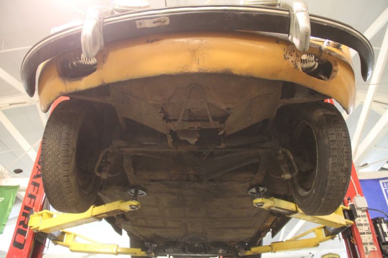

            hey all thanks for your words of support.....heres a few more pictures

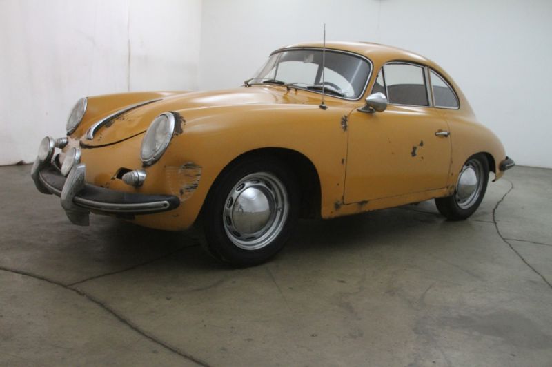

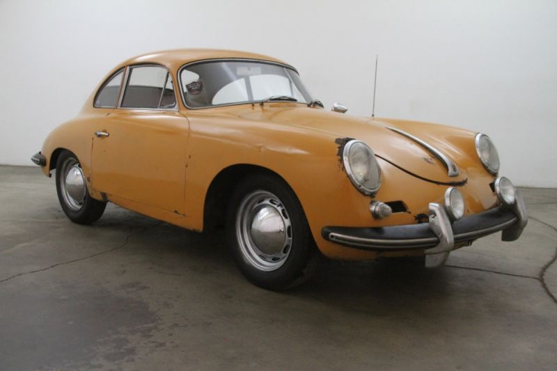

                Hi,
                It's got the correct parts for a T-5 S-90 with the front battery box and compensating spring.
                Are you planning to media blast it to see what things look like underneath?

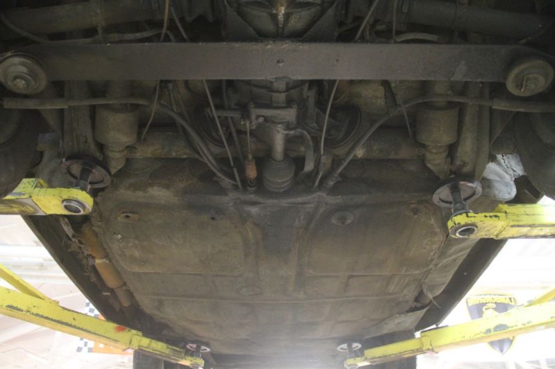

                  Not as in bad a shape as I was expecting.
                  So this car was factory black?

                    Yes thats what i was surprised about....from the wings it looked as if the rest might be toast but was presently surprised underneath! And was so pleased that it hadnt been messed about with/crashed (that i could see by a light inspection) or hot rodded! just a shame the old engine went walkies! has the OG tranny
                    Yes factory black (red interior) which i believe was a special order colour for 60' ?
                    John - I will wait for it to arrive and decide whether to do a full media blast and resto or whether the welding can be done, blown in carefully, mechanicals sorted, get an upholsterer to carefully repair the seats and use it for a while.....been reading alot about cars that have a full resto and owners are then scared to use them.....having said that im pretty sure i would still use it as thats what its meant for right....not to become a trailer queen!
                      Yep, looks very original as though it was just driven and not touched much with bad repairs. I agree with you if possible, get it back to a driving state to enjoy it.That still though will take you time to do.

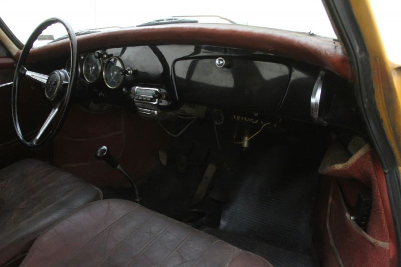

                        Really digging this car - especially love the interior. The black dash with rich burgundy patina rocks. Looks very complete.

                          welcome! Yet another BT5, although yours has all the right specs. You've got a good engine with an even better original if you can find it or a suitable replacement. You've got the good 'box (741, double front mounts), and compensator. All good!
                          But if I can be the one to be a bummer for a moment - mate, you've got a lot of metal work to do here. Having lived in the UK I'm familiar with MOT. You're going to have to do both longitudinals - they are both trashed. Rear chassis areas around the heater tubes. Likely front wheel well closing panels. Battery box floor. Front guards/fenders. You might be able to patch that front floor pan, maybe not. If not, then at least a new front half floor pan. For what its worth, my early advice would be to do it once and do it right. One thing leads to another anyhow, and you may find yourself with many many hours put into the job wishing you had stripped it and put it on a rotating frame right from the start. But that's ok - like Justin says, having an old 356 means working with rusted metal.

                            But you correct Jonesy the longitudinals and no doubt other structural area's will need a fair amount of work on this 356B but its well worth while doing correctly. Money or time well spent I think.

                              the bottom area does look like it needs a fair amount of work, as you'll know living in the uk the rust area is always bigger than it looks... hope all goes well though i shall be watching with interest, just like all the others being worked on
