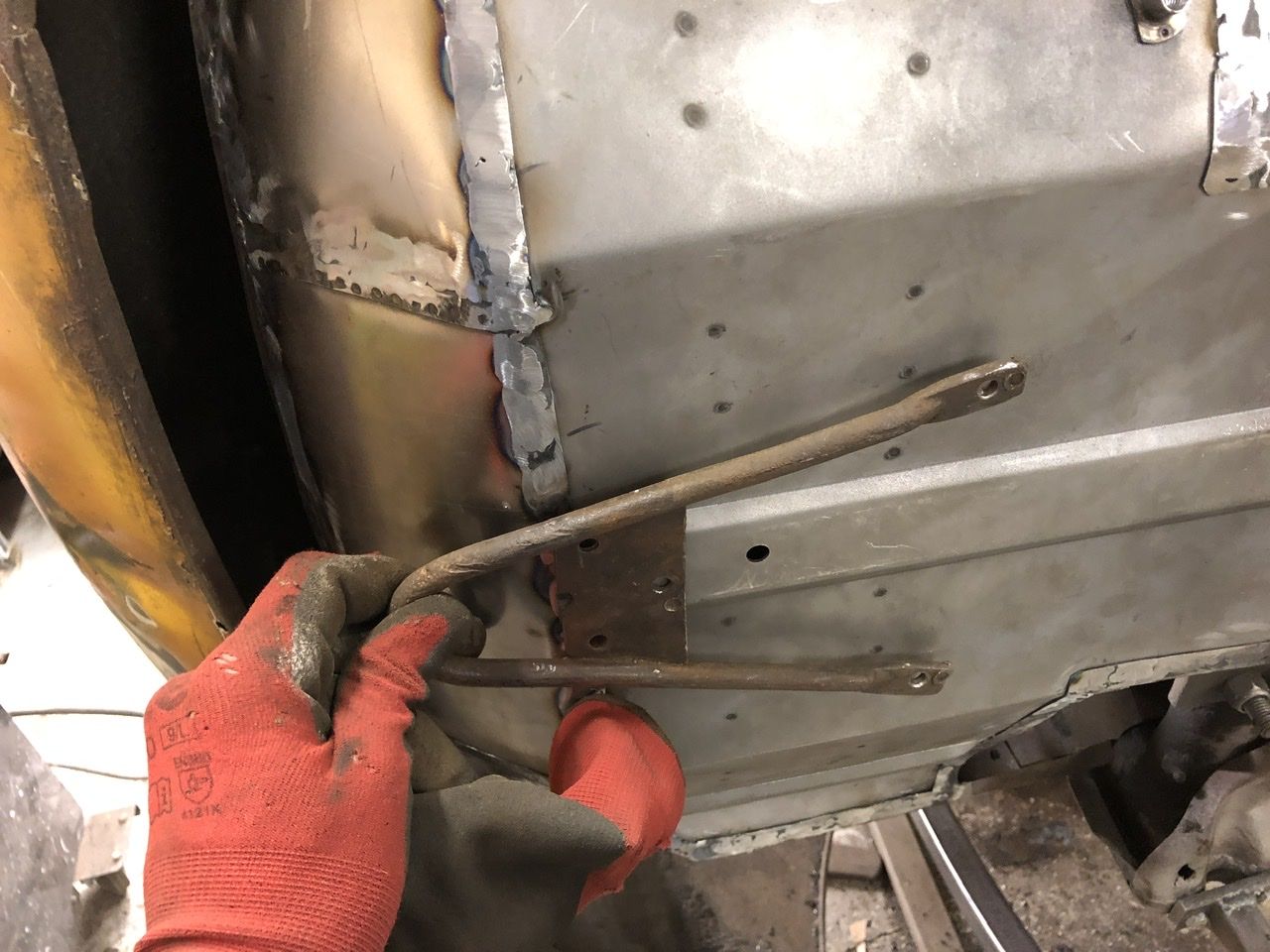

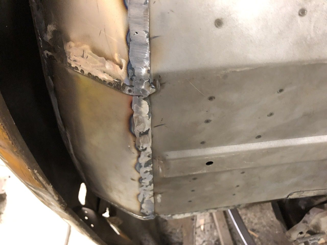

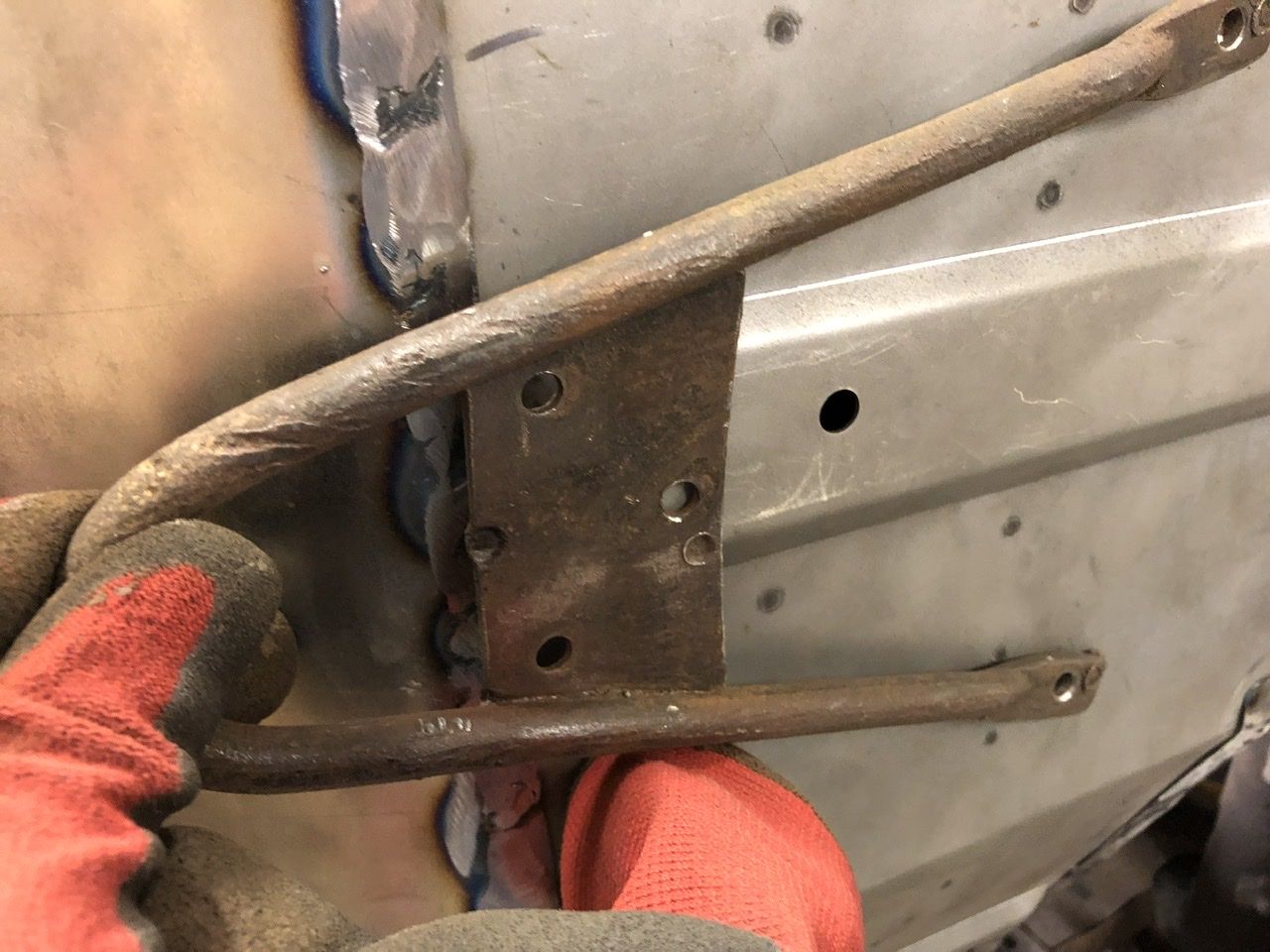

    I finished plug welding the battery box in place yesterday, I’m pretty happy, just needs a bit of tidying. I’ve been looking at fitting the tow bracket but can’t see how it will fit!? Best to bend the rear bracket brace around the stamping? Or bang part of the pressing flat? It’s a restoration design panel and its pressings are more pronounced than originals, annoying!

    • #78
      Mark,
      You are getting on well this work! Its not easy is it! That tow hook securing point looks different o my 356A one. I must look at the old pics I have somewhere I am sort of positive the bottom of the battery box is flat. The tow hook I have never had to remove.
      Keep it going bit by bit.

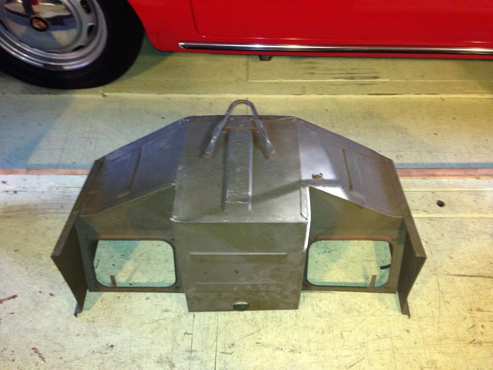

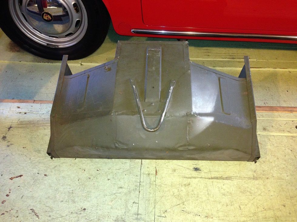

        Here's some shots of an NOS T5 box.
ID:	109086Click image for larger version
        Looks like it drops in flat right at the tow hook. HTH Keep up the great progress!
        • #80
          Mark my T2 is the same as the picture above. The tow hook lays flat central to the the raised rib that is in the centre. It looked to me like the raised rib on yours comes forward too much ( too long ). Maybe the way you photographed it? Justins photo is very clear how it goes.
