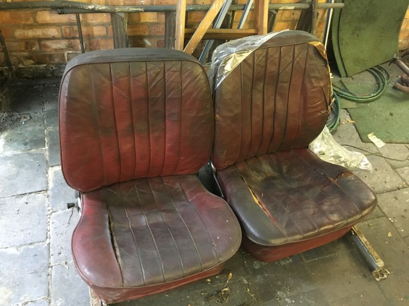

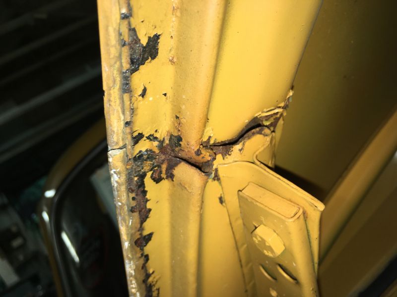

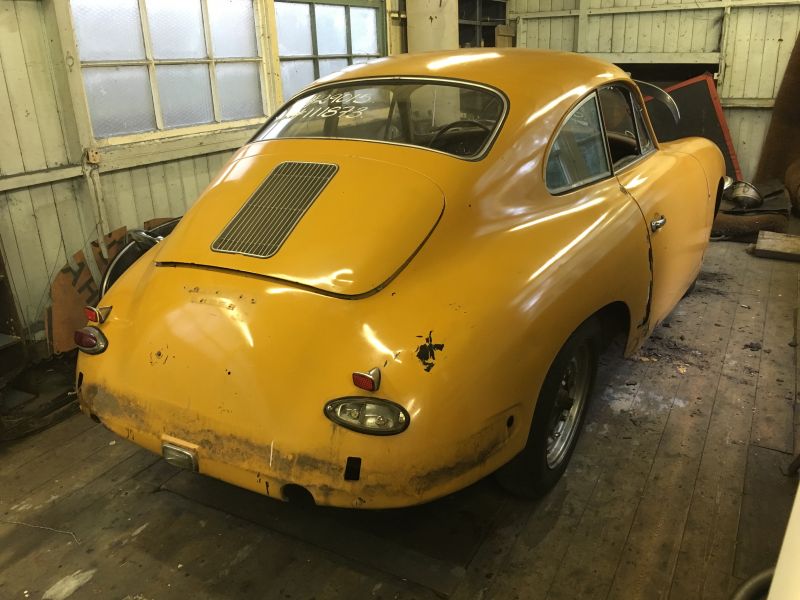

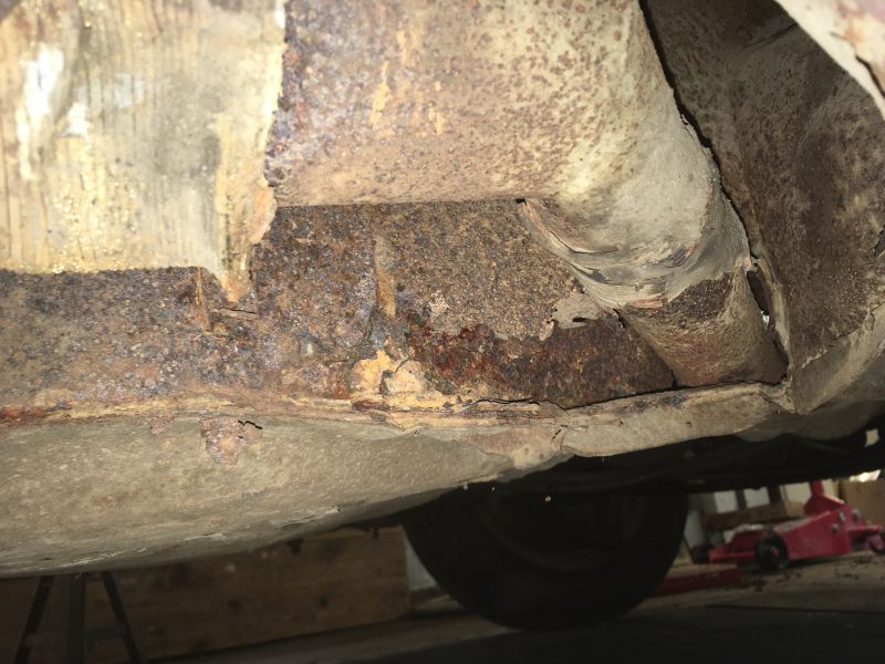

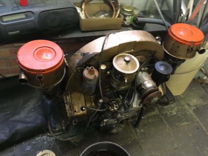

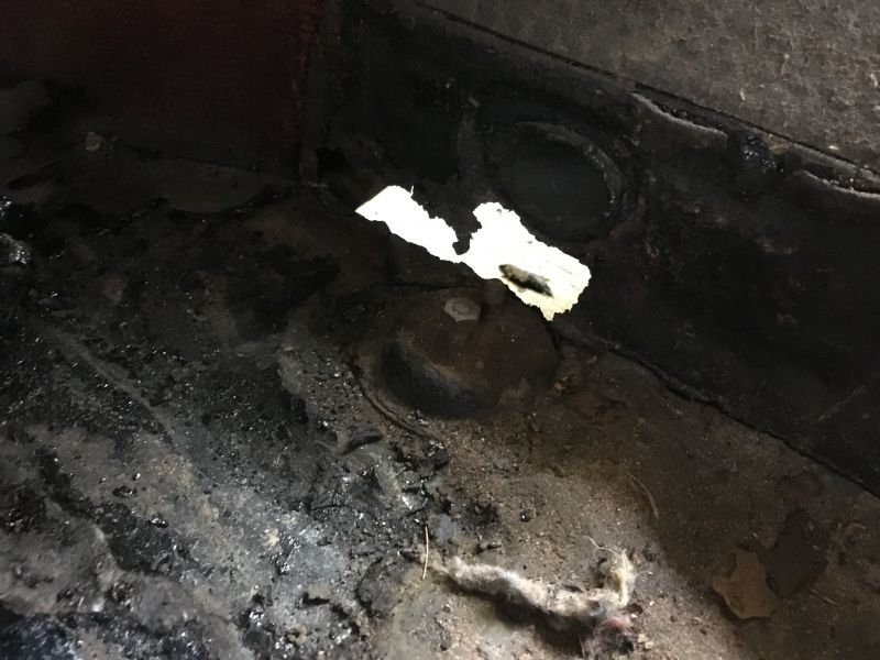

              Well exciting news.....she's arrived! Had a day pulling her apart and seeing how bad the damage is. Whipped the engine out and looks like someone has had a go at doing some work to it as its missing the clutch/flywheel, front crankshaft pulley and push rods. Not sure what I'm going to find when I eventually get it apart but I'm not so hopeful for its condition.
              The body isn't too bad although the chassis needs more than expected. Im really pleased with the interiors condition and also super pleased as I found the horn push wedged between the seats. It is also a 1 key fits all which I have no reason to think it isn't original. I'll let the pictures do the talking!

                  Congratulations on taking delivery! Dismantling a new toy sure is the fun part so enjoy it while you can!
                  From the shots of the body I saw earlier the extensive chassis rot is exactly what I was expecting to see. Welcome to the world of old Porsches, she's just doing what they do best. Study the B&C build threads here carefully as you will be going deep into the longitudinals and in around the rear torsion housing to bring back structural integrity. If you don't have a rotisserie...BUILD ONE...You'll be glad you did. Best of luck on your new project and am looking forward to the updates!

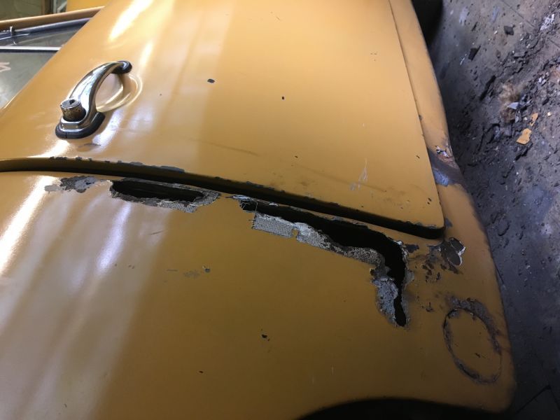

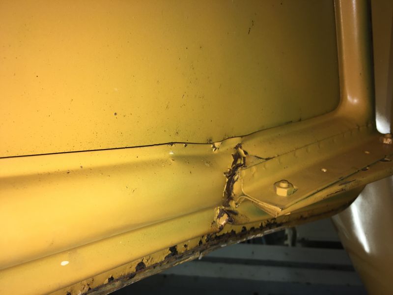

                    Yes I should have known to expect more than less rot but one can be forever hopeful ! One thing that is a bit of a pain is the bonnet. Looks like it's been propped up then driven into something so hard it's bent and snapped part of the framework. See pics. Will need some skilled work t get it back to life. Yes rotisserie sounds like a great idea. Only thing is I'm not sure I have physically enough space in the garage I have. Also are there plans for any?I'm sure there are on this site somewhere.

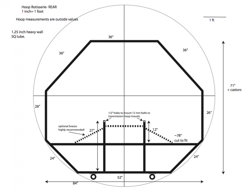

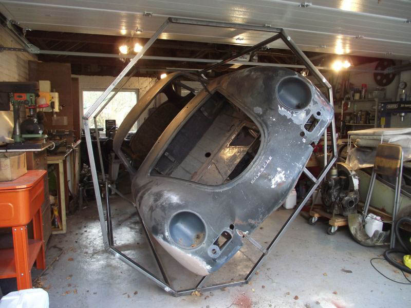

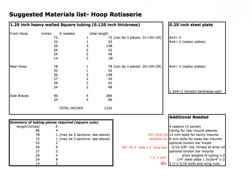

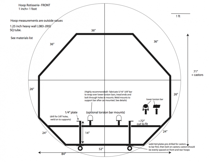

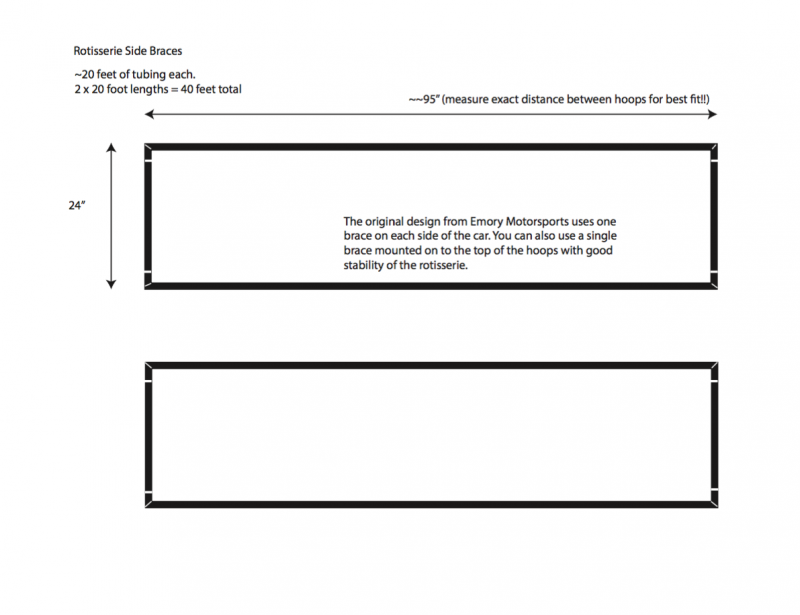

                        A rotisserie is definitely a plus. Especially if you don't have a lot of space as the car is easily turned either inside or outside the garage. Below are plans for a rotisserie based on the Emory design with modifications (I don't remember the author).
                        Emory Motor Sports: http://www.emorymotorsports.com/workshop
                        Included is a parts list which I've modified in red. You can see many rotisserie pictures on my build blog and other's blogs on ABCGT and many others on the R.
                        HTH.

                          Nice honest photos's. More or less just like so many 356 cars that have rusted. If you study the resto pages on here every area is probably covered. Like Justin and all the other guys be prepared to make all the templates where you can. The bonnet is not an easy job but has been covered already on abcgt. Delve deep into the resto's this will take you a lot of time but it will be worth it.
                          It looks like you will not have to try to remove poor welding jobs on this car, it looks quite original to me.
                          • #28
                            That hood has been through the ringer and as severe as its been kinked then "rekinked" the only way to really repair it properly is to remove the substructure from the skin. It also shows very advanced rust so this would also give you a chance to address that thoroughly as well. Tom Perazzo did just this repair on his hood with outstanding results. Here's the link: http://www.abcgt.com/forum/14-356-Restoration-Projects/8963-SC-Coupe-Restoration.html?limit=6&start=102

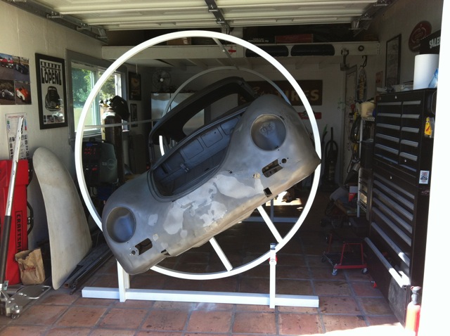

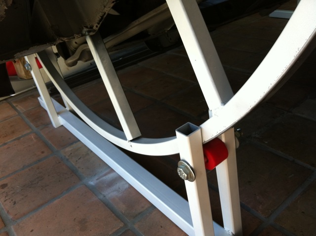

                              Here is a link showing Trevor's rotisserie to give an idea of another design. He posts here also. Page 3 shows good pics of it.
                              http://forum.porsche356registry.org/viewtopic.php?f=4&t=29204&sid=18670ee696168731b68c902485bef3e2&start=30

                                Just a word of warning, I have built an 'Emory' rottisserie and there is a wrong dimension on one of the drawings, so if you are about to build one ask and I will confirm which one it is.
                                Great car looking forward to seeing it take shape.
