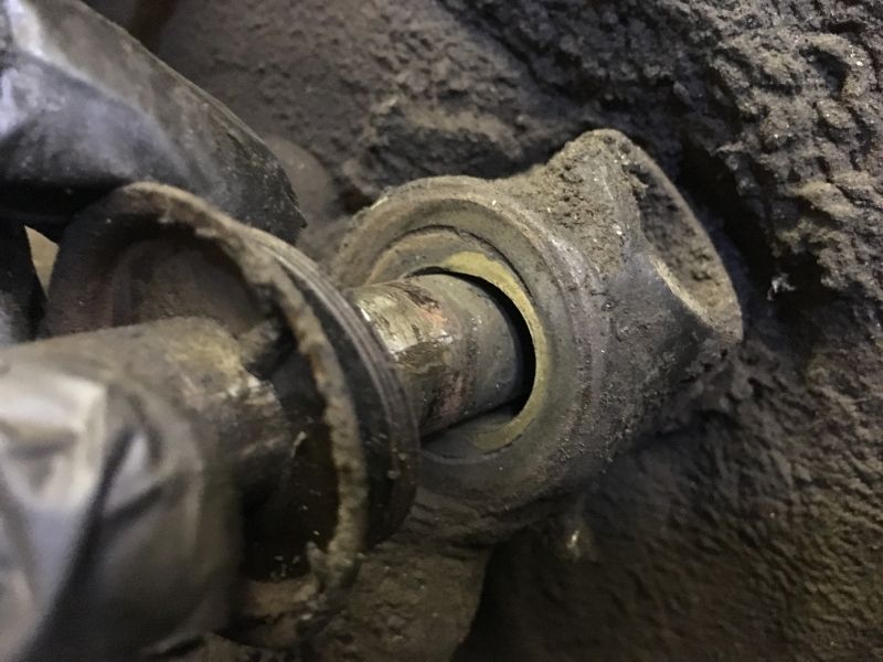

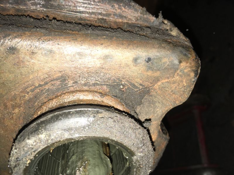

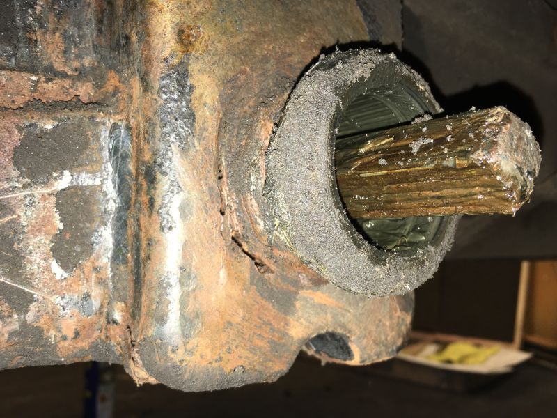

      Hey all. So a bit more work these next few days. Hoops look good so cracking on with getting her mounted. Gearbox out and front hubs and trailing arms off. I noticed when removing the front RHS trailing arms that there was a ridiculous amount of wear in the link pin bushes. See pic! It must have been banging around like crazy! Was trying to work out why this might have happened. Noticed a few cracks around the bottom of torsion tube. Will need attention along with everything else!
      The crack goes from the bottom back of the beam end. Over the top of the bottom torsion tube and down to the front bottom of the beam front edge. (If that makes sense!?)
      More pics to follow tomorrow as this jig progresses.

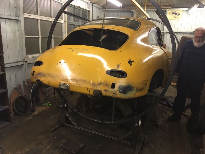

          • #50

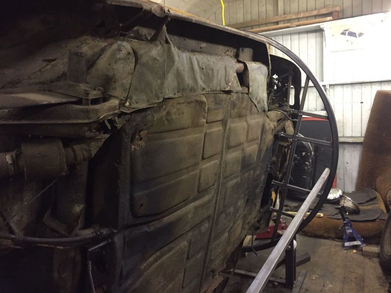

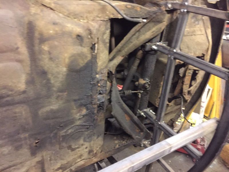

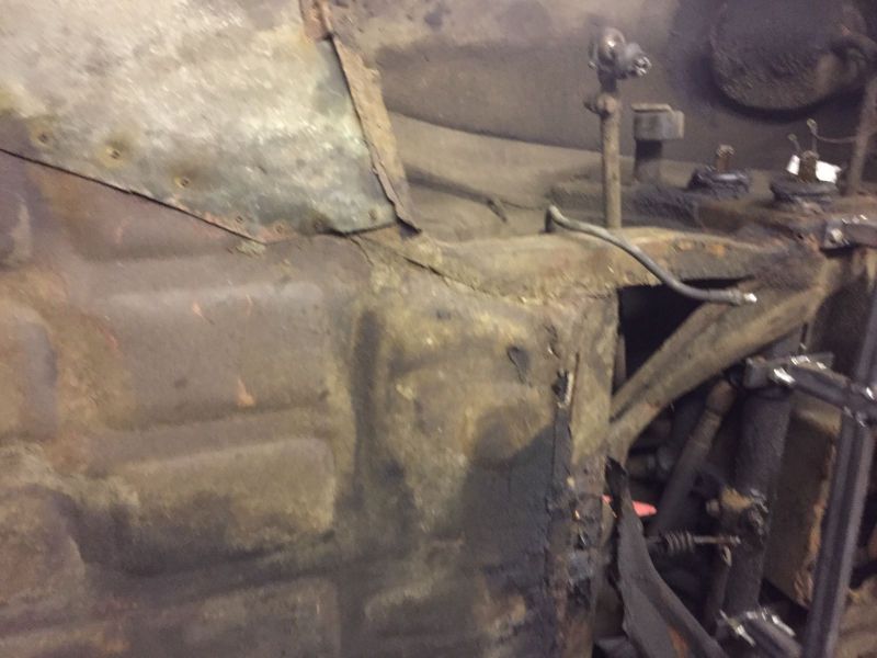

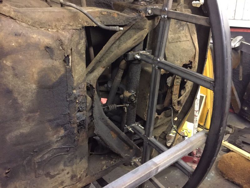

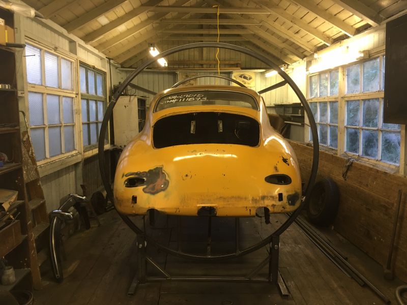

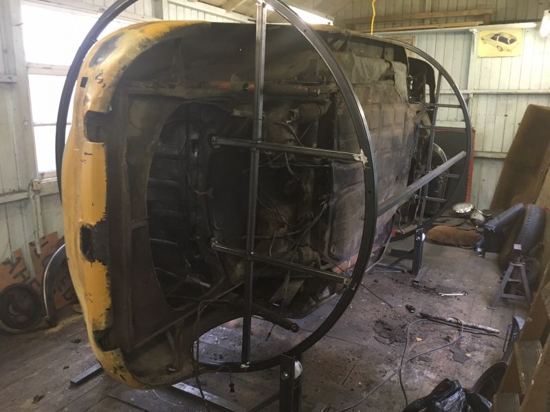

            well....had a good few days on the car...she is now mounted in the roll over rotisserie jig and had chance to have a good look underneath.
            Really pleased with the roll over jig ive made, super smooth and easy to set (although for counterbalance it could have been further up in the cage but works fine to 90' ). Was fun welding it underneath as all kinds of angles...meant welding wasnt so neat
            had a better look at the crack to the bottom RHS torsion tube/beam area and it appears that the PO must have driven into a rock or somwthing as the area below the master cylinder (between beam and floorpan) is all caved in and i think when this has happened is has stressed the beam and possibly split/cracked it. Does anyone have a few pics of the underside around the front beam to chassis part that is in good condition?
            I have also decided as discussed earlier in this thread that there is too much work to patch/repair and roll as is....now i have it on the jig i think it will end up being a full resto. Will be a pause for a while but planning on stripping the rest of the bits off it next time and buying a blaster to spot blast the areas that need it underneath (the bits that will not be replaced for new), plan to manually strip the paint as ive read plenty about it going wrong with blasting!

            • #51
              Mark,
              The few pix of the rear underneath look pretty solid. Especially around the torsion area.
              The T5 and T6 cars are different so I can't help you with pix around the battery box. Sorry.
              Your jig looks really nice. Great start. I can't wait to see your progress.
              You might want to consider bringing your car to a media blaster as the spot blaster makes a hell of a mess! I know that from media blasting the areas that couldn't be reached by the initial blasting after metal was removed.
              • #52
                That's going to work beautifully! How do you Brake the assembly for a hold in a particular position? Vise grip or a C-clamp on the roller resting against the base? Nice job there!

                      thanks for the kind words people. Im actually based in london but car is up north where my folks live.....space is at a premium in london ....hope to bring it down so i can work on it at some point when i can afford a bigger workshop!
                      Yes i plan to sand the paintwork off.....decided against using paint stripper after a fair bit of reading and also its so messy even when just doing a small thing at home.

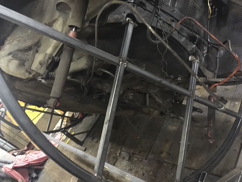

                      The rotisserie is held in position by 2 8mm pins that drop through the base and the frame. I have drilled it so that it can be locked in 5 positions which should give every angle that I need and more can be added if necessary......I decided that I wanted a mechanical lock rather than just relying on a clamp.....didnt like the idea of being smacked in the face or nether regions if the clamp failed!

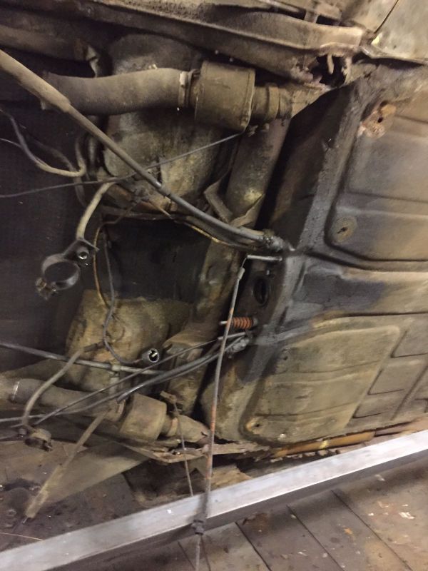

                      I wonder how a can check to see if the bottom torsion tube has been nudged back and is now not true to where it should be......heres a few more pics of underside.....doesnt show the damage very well, will try and get some more.

                      • #56

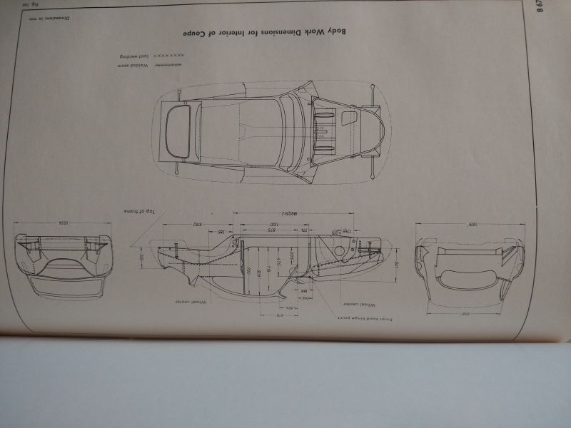

                        Some rot and strange repairs you have to clean there !
                        This might help ... from Workshop manual.
