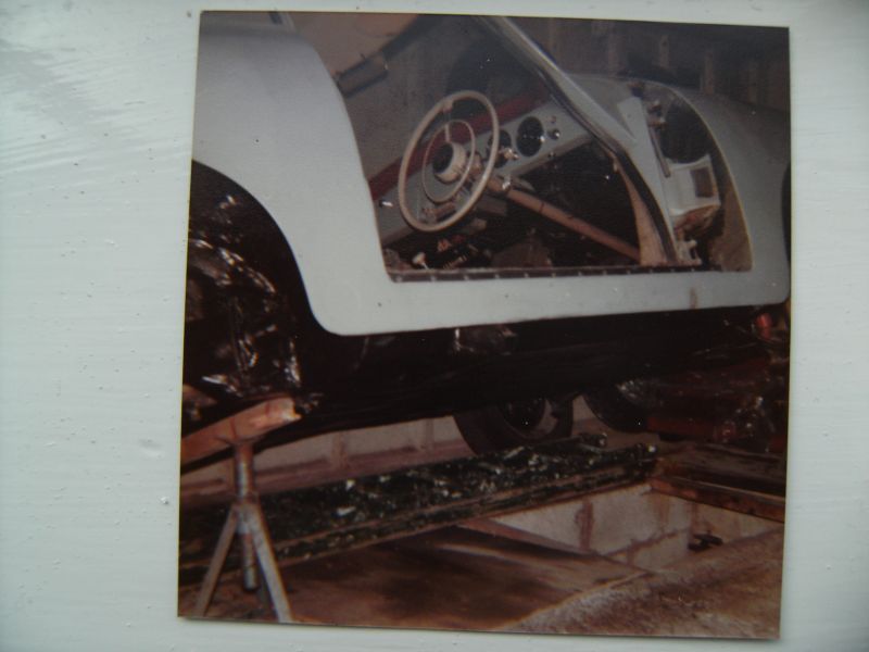

    Well to find that and bring it home in your luggage is amazing no other word for it. Its very odd when find out something about your car that you thought impossible. The underneath looks so much like many 356 cars I looked at here in the UK in the 60's. You have the right approach to attempting the work,the spit will prove so useful. In the early 70's I dug a pit in my garage and had extension hoses for my gas welding kit. It made it easier but did it tire me out sometimes, trying to reach things. I attach a photo
    Only half the length pit is shown so many had pits in the garage the first rotissories were I guess not made up till the 80's ?

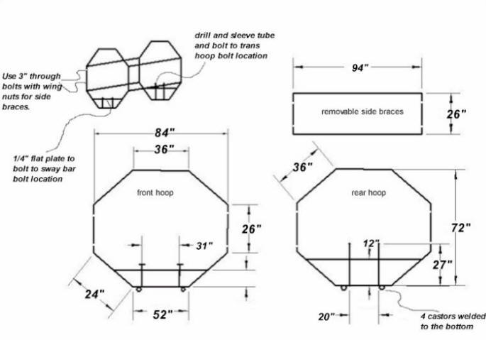

      Hello Drew .. or others that may know about this.
      I'm inquiring about the wrong demension in one of the drawings as noted below.
      Can you please identify what that demension should be?
      Also, can it be confirmed if the doors are able to be opened when attached to this unit.
      My email address is also shown below.
      Thank you.

      Just a word of warning, I have built an 'Emory' rottisserie and there is a wrong dimension on one of the drawings,
      >> so if you are about to build one ask and I will confirm which one it is <<

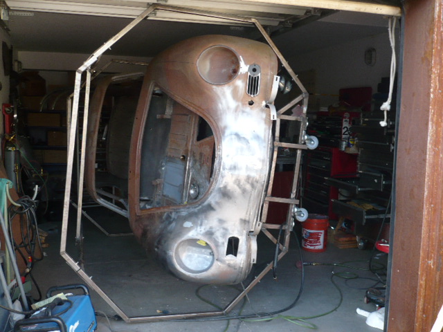

        The doors can only be opened several inches with the rotisseries sides installed. I take the sides off to allow the door full range of motion. The rotisserie remains very stable with one side off. Here's my rotisserie build:

        I'll send you a .pdf of the plans with a materials list.

          Hi Michael
          The one dimension i found wrong was on the front hoop.
          On the original drawings they state 14" for the uprights that attach to the sway way bar mountings, the measurement should be 16".

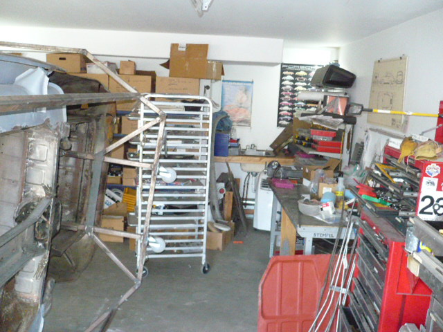

                One final comment ... if you're working in a confined space, the hexagonal rotisserie is PITA to turn; I can do it but I have to slide it over the concrete floor to re-position before each rotation.(made a mess of that concrete for sure).
                Also when the car is 180' upside down, is is nigh impossible for one person to right it (turtle style) due to the center of gravity being so low.
                If you have space go for it ! Otherwise I would seriously consider the "Spit" style or maybe the round hoop. I wish I had.
                Tight fit.

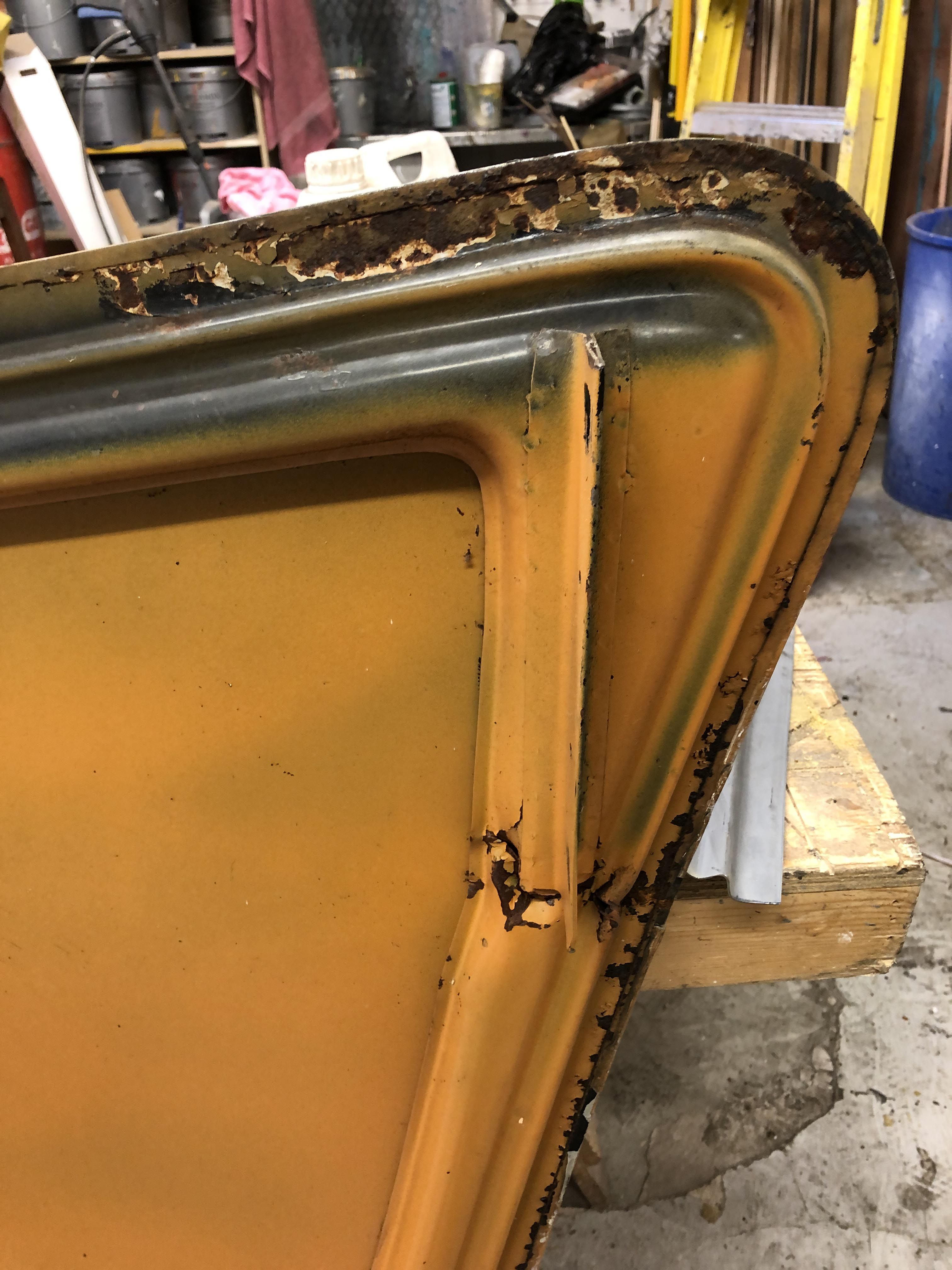

                      Also is there a logical order to how first attack things on the shell? I would really like to keep as much original metal as possible and wonder if possible I can keep my floor pan and patch the edges neatly? what are peoples thoughts? Attached a few pics here to show.

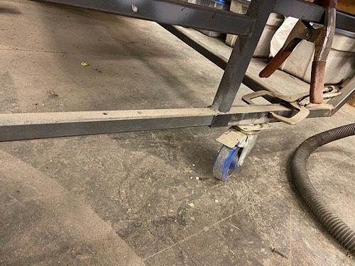

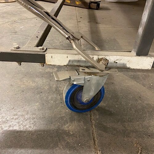

ID:	108219 I used a set of basic swivel dollies from the local hardware store and welded to a u channel that can then slide off and on the rotisserie- just held in place with vice grips for when it is in the air. I think these small ones can hold 500lbs more than enough strength when spread around.

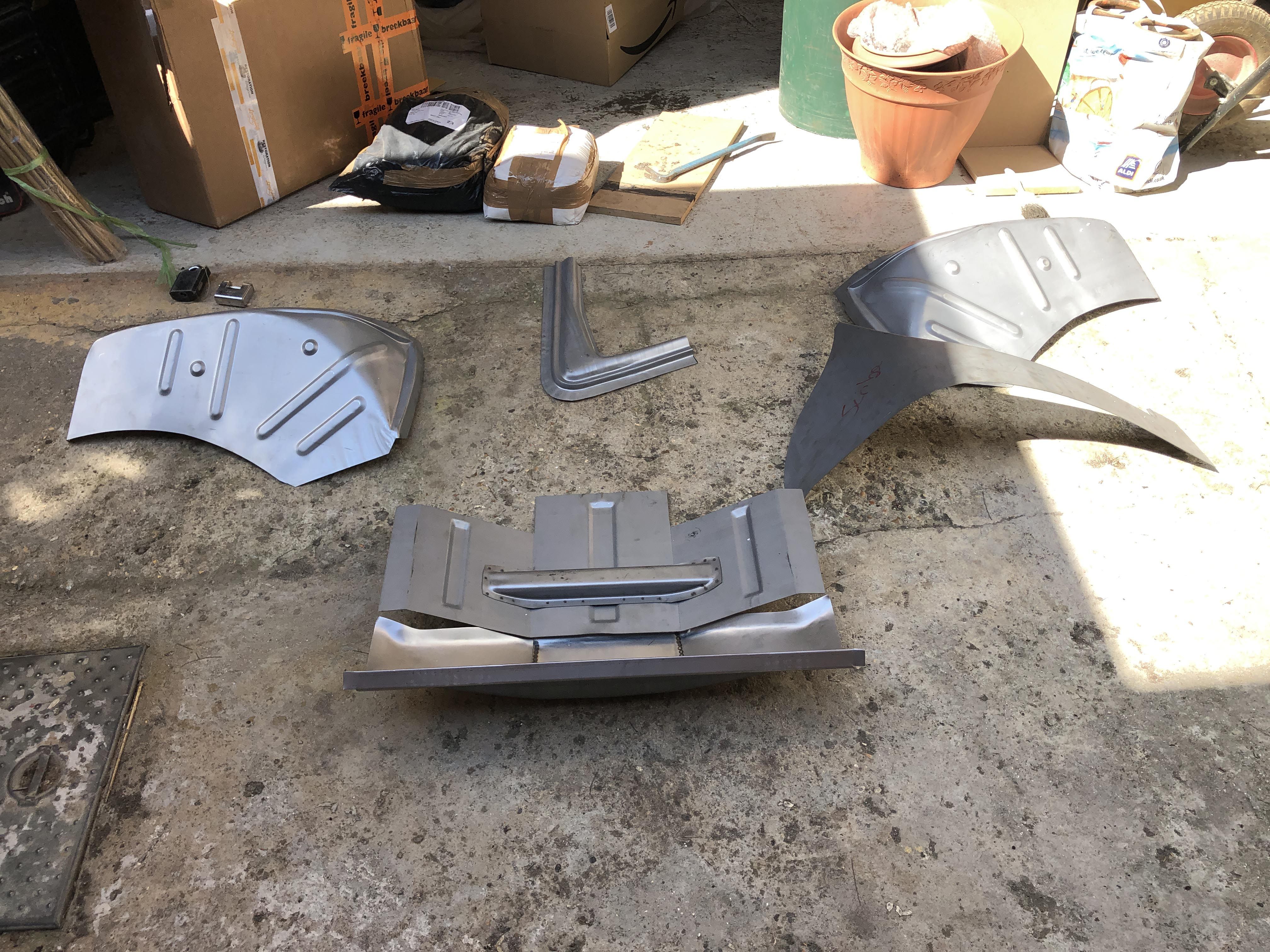

                              Thanks for the replies. Good progress over the past few weeks which has been great! I managed single handedly to get the car from storage onto the back of my Luton box van and into my workshop to commence works! It was a fun few days, a worthy challenge that was satisfying when it was in the workshop!
                              Ive managed to strip off all the factory sound deadening /tar stuff which im sure you will know is a horrible job, Also the pulling of the wiring loom from the centre tunnel was a fun job solo! I purchased as small pressurised shot blaster and have blasted the majority of the front inner wing areas and the trunk compartment in the front so i can see whats going on in there. Its likely that I will get the car done by someone eventually but for the moment this is fine. The blaster is good, its just my compressor that has given up the ghost....awating a new thermal cut out switch as its finally dead after a long drawn out problematic period!
                              The car has rust....confirmed! but ive had the welder out and managed to chop out small section below the fuel tank and start my repairs, this area wasnt in too bad'er shape so i decided instead of a new panel it was worth spending time to save the one that is in. Im happy with the results and just a few bits need cleaning up with some new die grinder bits when they arrive. I pulled the remnants of the old battery box out and the panel in front of that was all mangled up from a crunch at some point, so have chopped a section out to replace that but the new panel is miles off, so its a case of cutting and re welding to make everything fit correctly as per the original. Im torn on the nose as whether it need a complete replacement or I can get away with localised repairs. Both headlight surrounds are shot, the areas between the horn grille and lower opening are also shot and the nost has a fair amout of filler in it so im kinda thinking a new front end unfortunately.

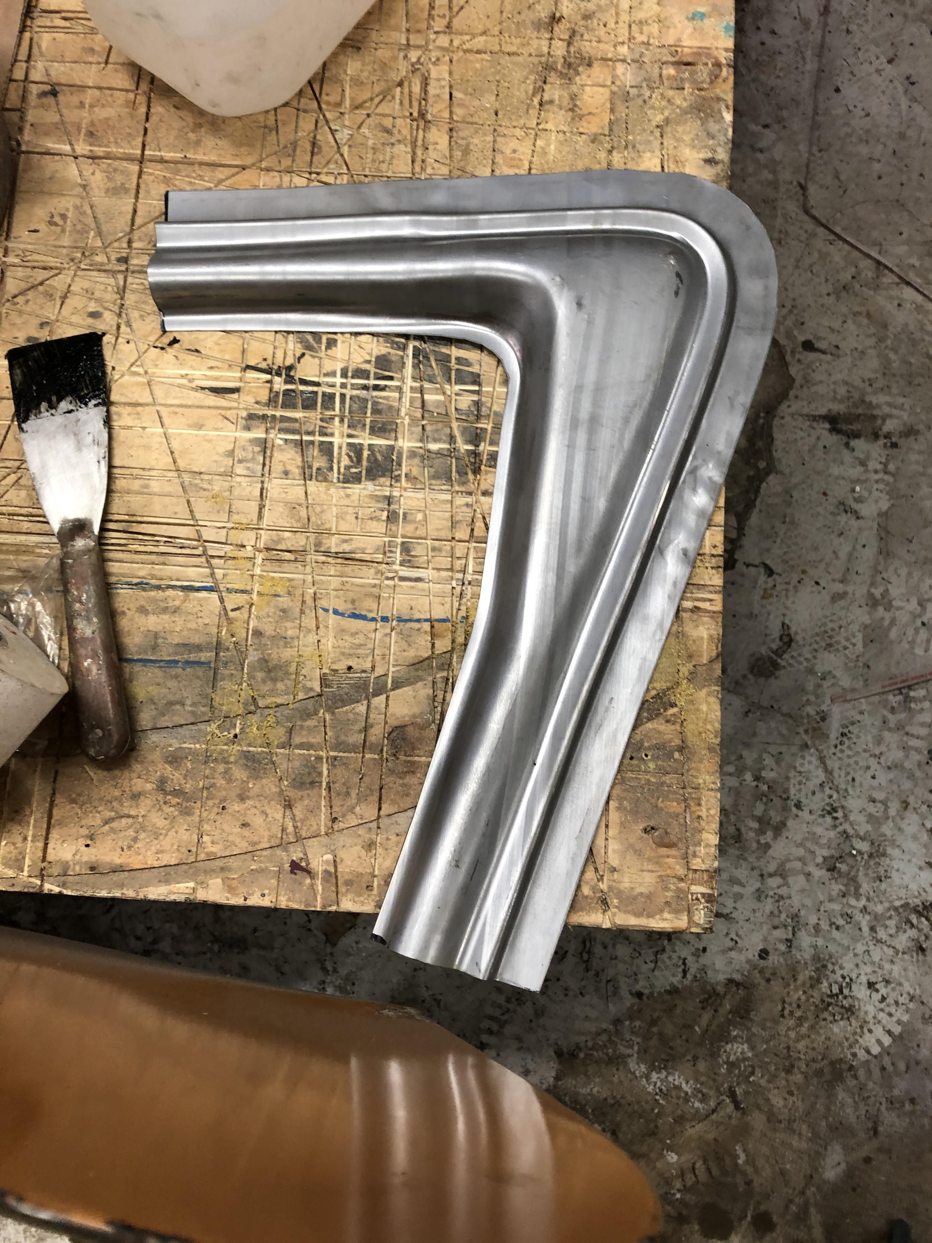

                              Im slowly working my way backwards after that looking at the rear wing areas and closing panels. Also the bonnet/hood kink as well as I got a repair section for that which looks like it will work.
                              Slowly slowly!

                                Click image for larger version  Name:	bonnetrepair.jpg Views:	0 Size:	1.29 MB ID:	108583
