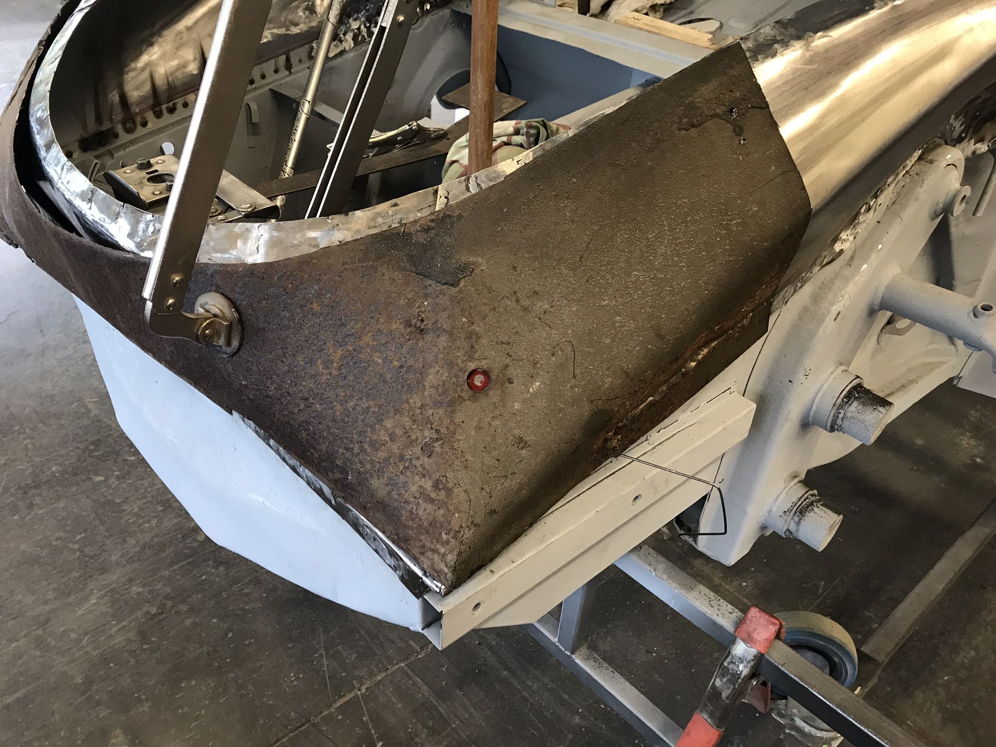

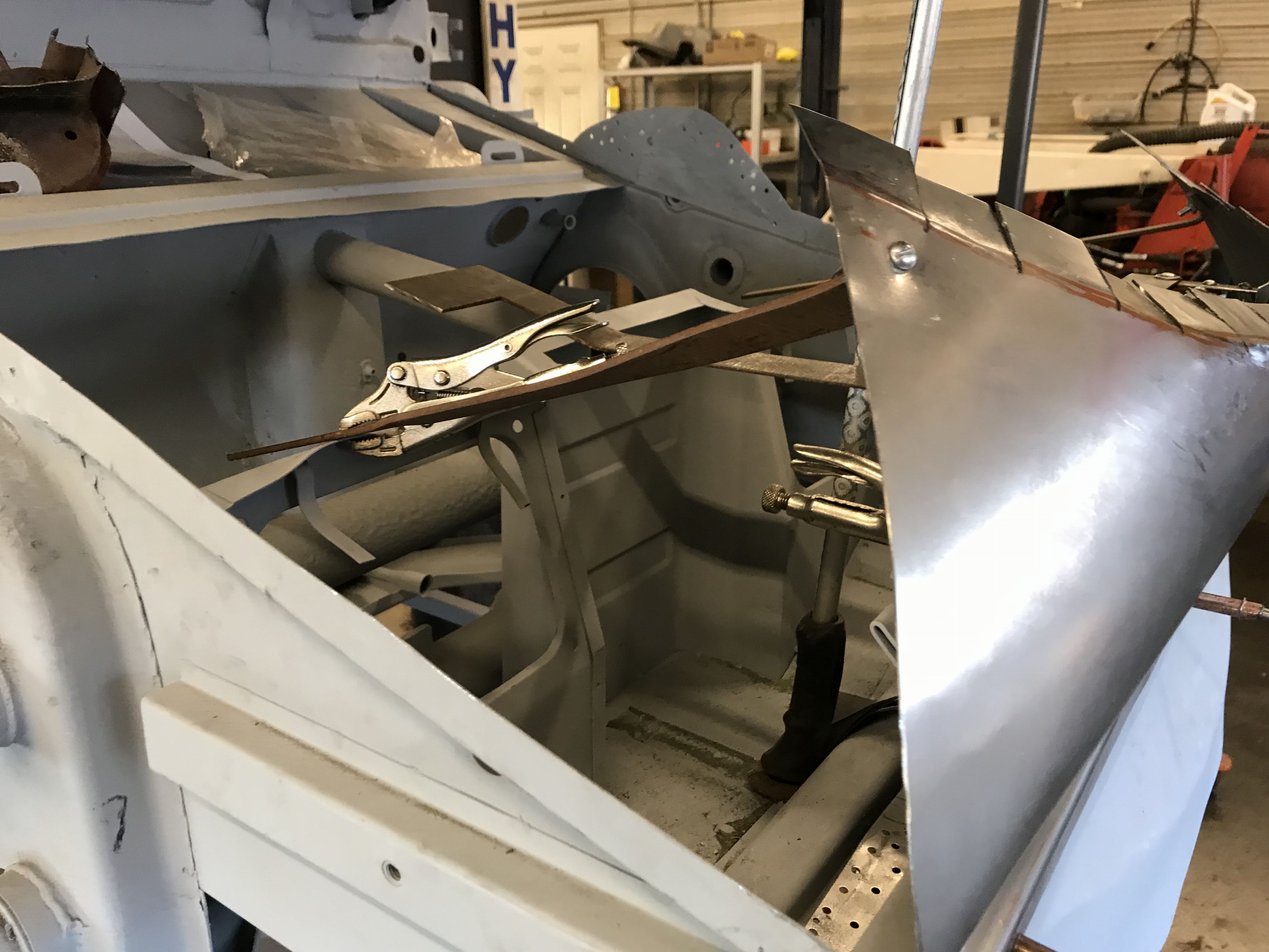

ID:	104690 Still slowly massaging the inner panels. Get one shaped then the one that shakes hands needs effort and back and forth. Getting closer.

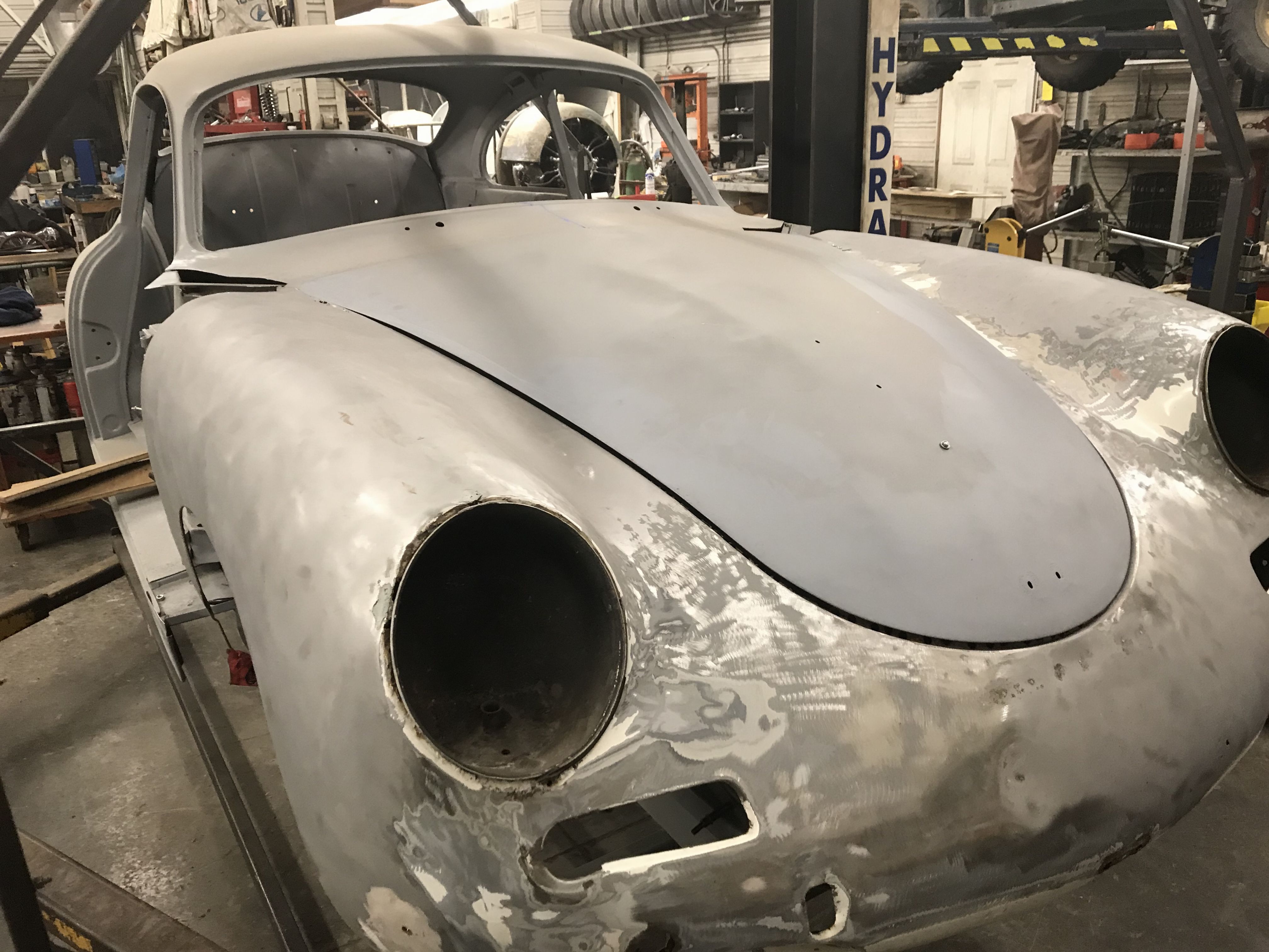

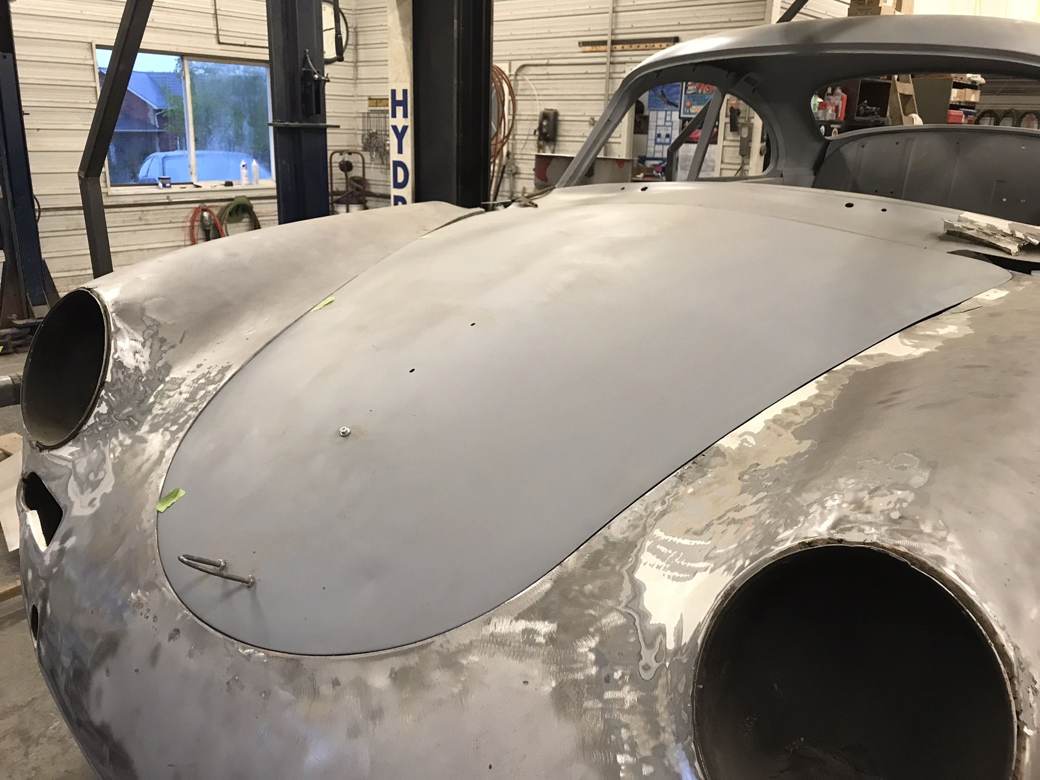

              • Getting close enough to slip on nose for a trial fit. It was closer fit then I thought. Off it comes and back to some more dolly work to shape the curve of the inner panels

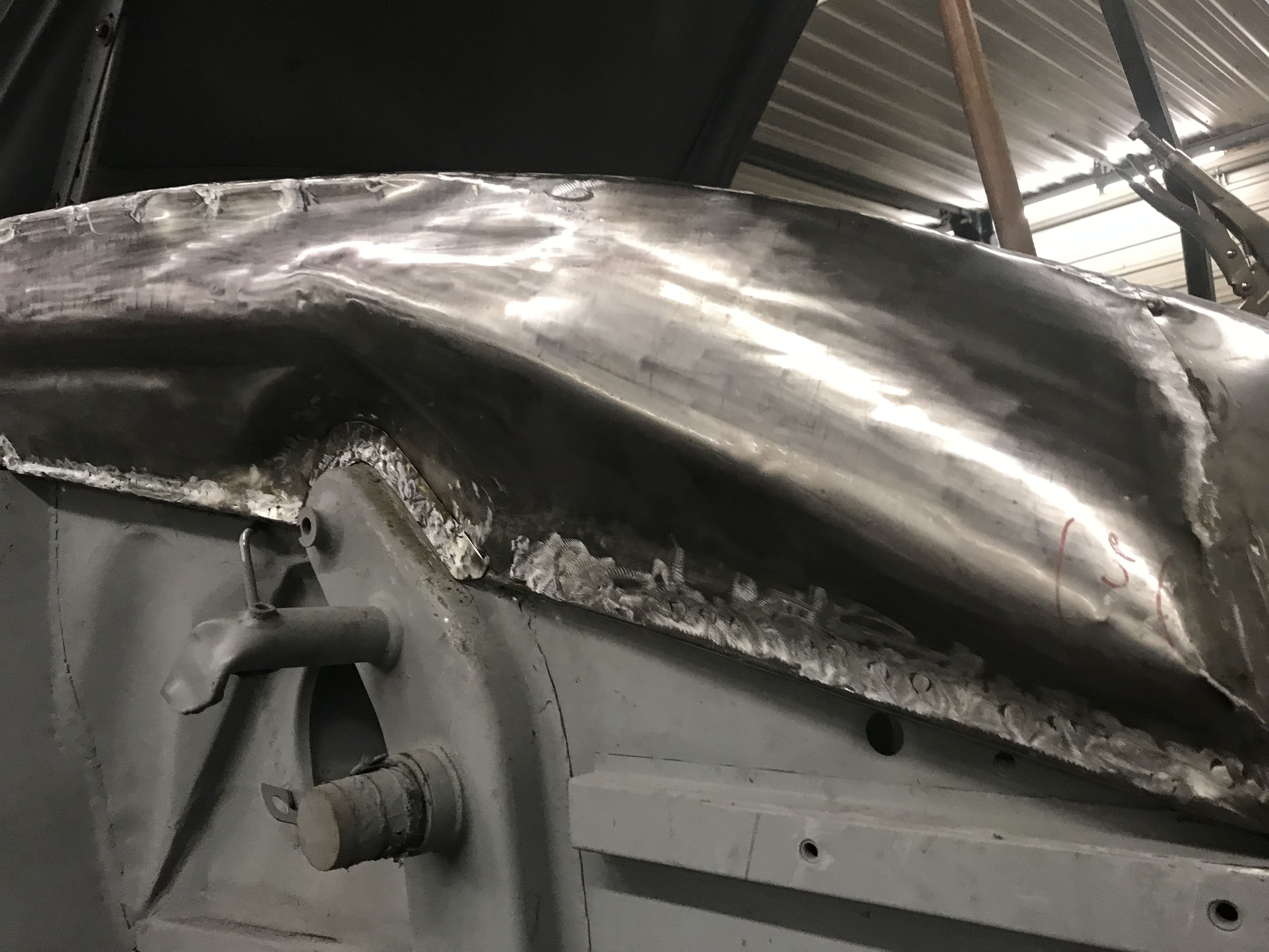

                • Finally got the inner panels all aligned with the hood.
Name:
ID:	105608 Now burning them in.
Name:
ID:	105609 Lots of welds to lay down and grind.
Name:
Name:
ID:	105611 This has been a surprisingly difficult effort - getting all three pieces to shake hands; follow the correct line of the front clip; and for the weld ledge to have he right angle to follow the rain gutter.

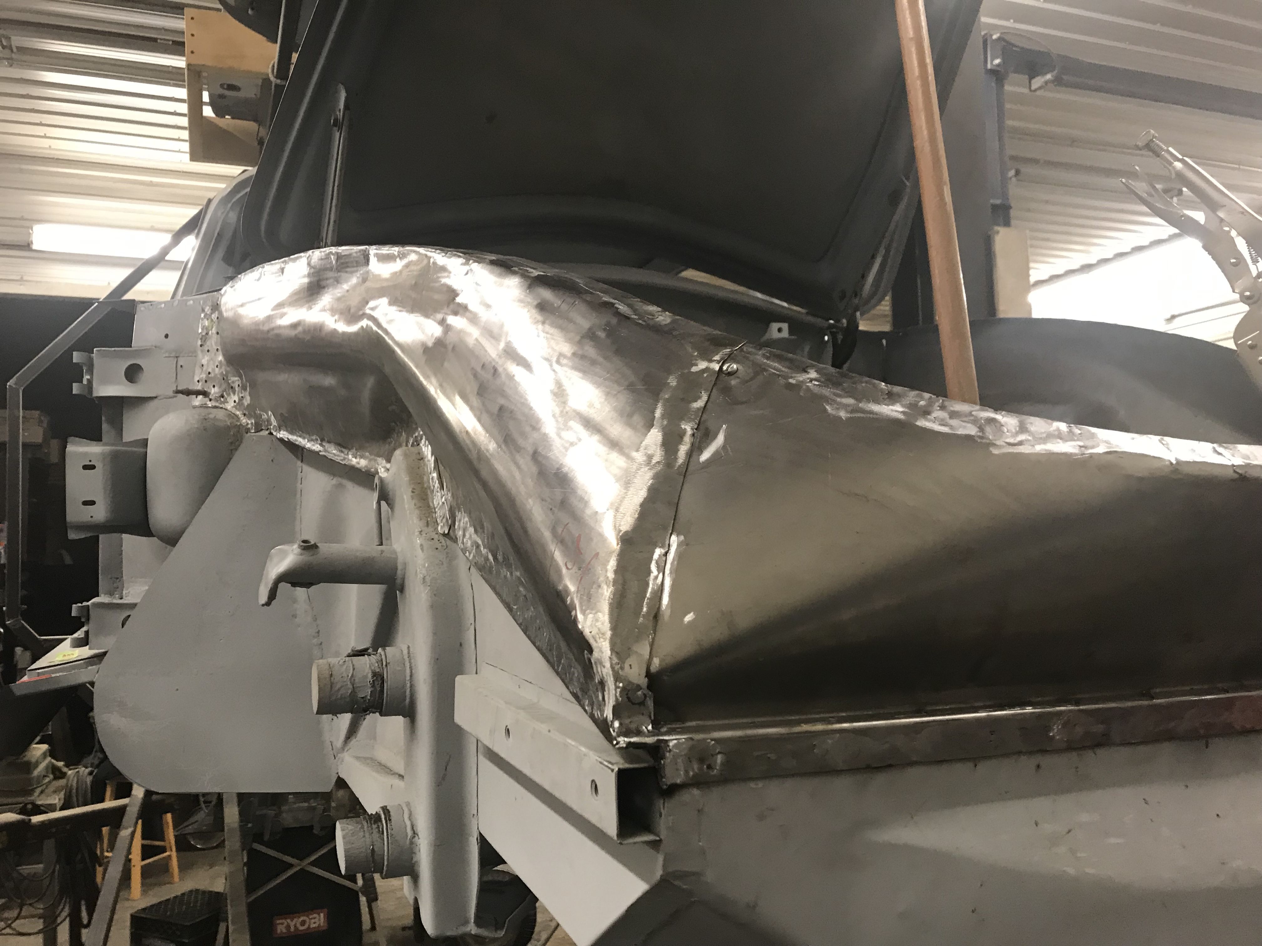

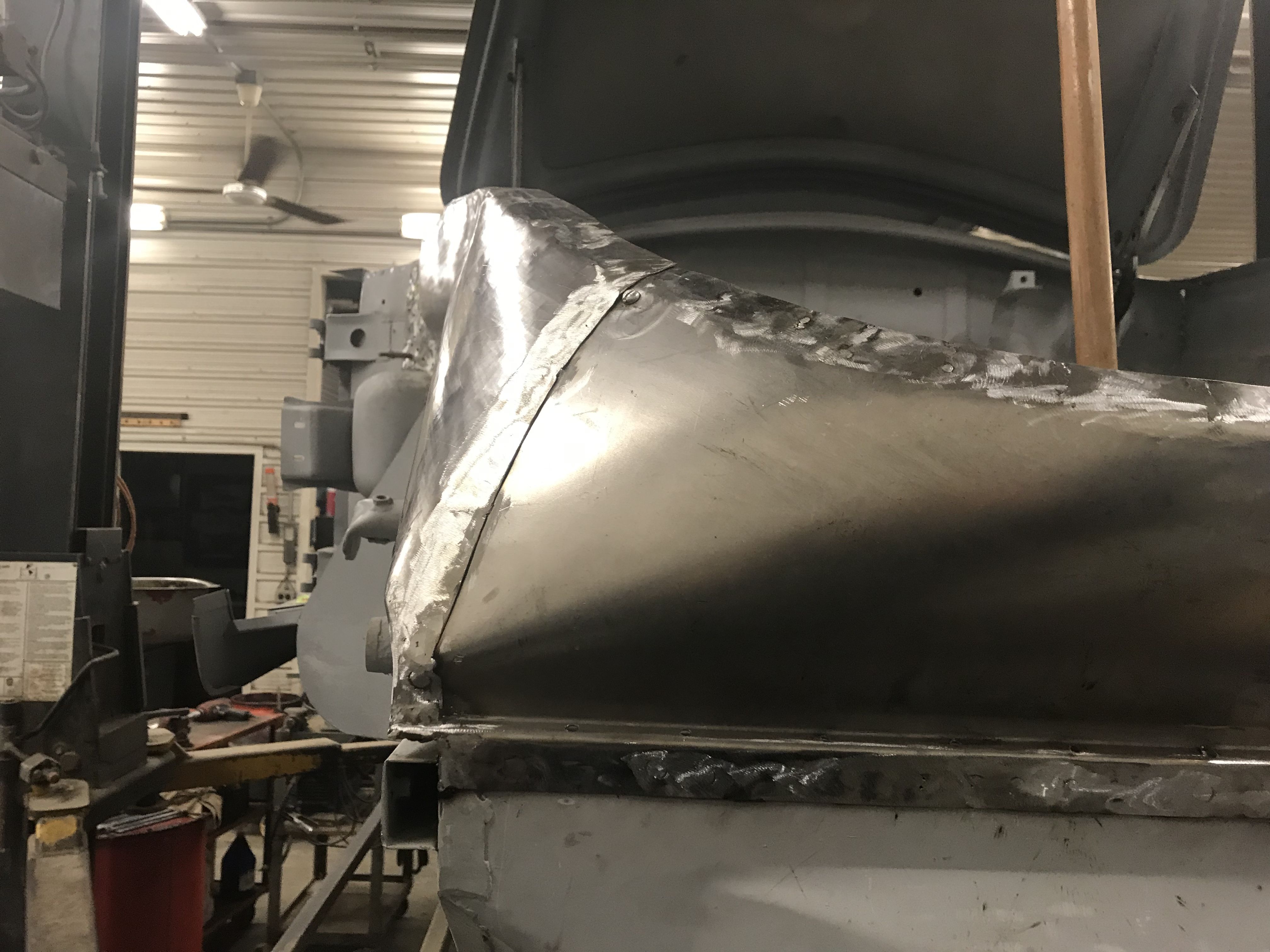

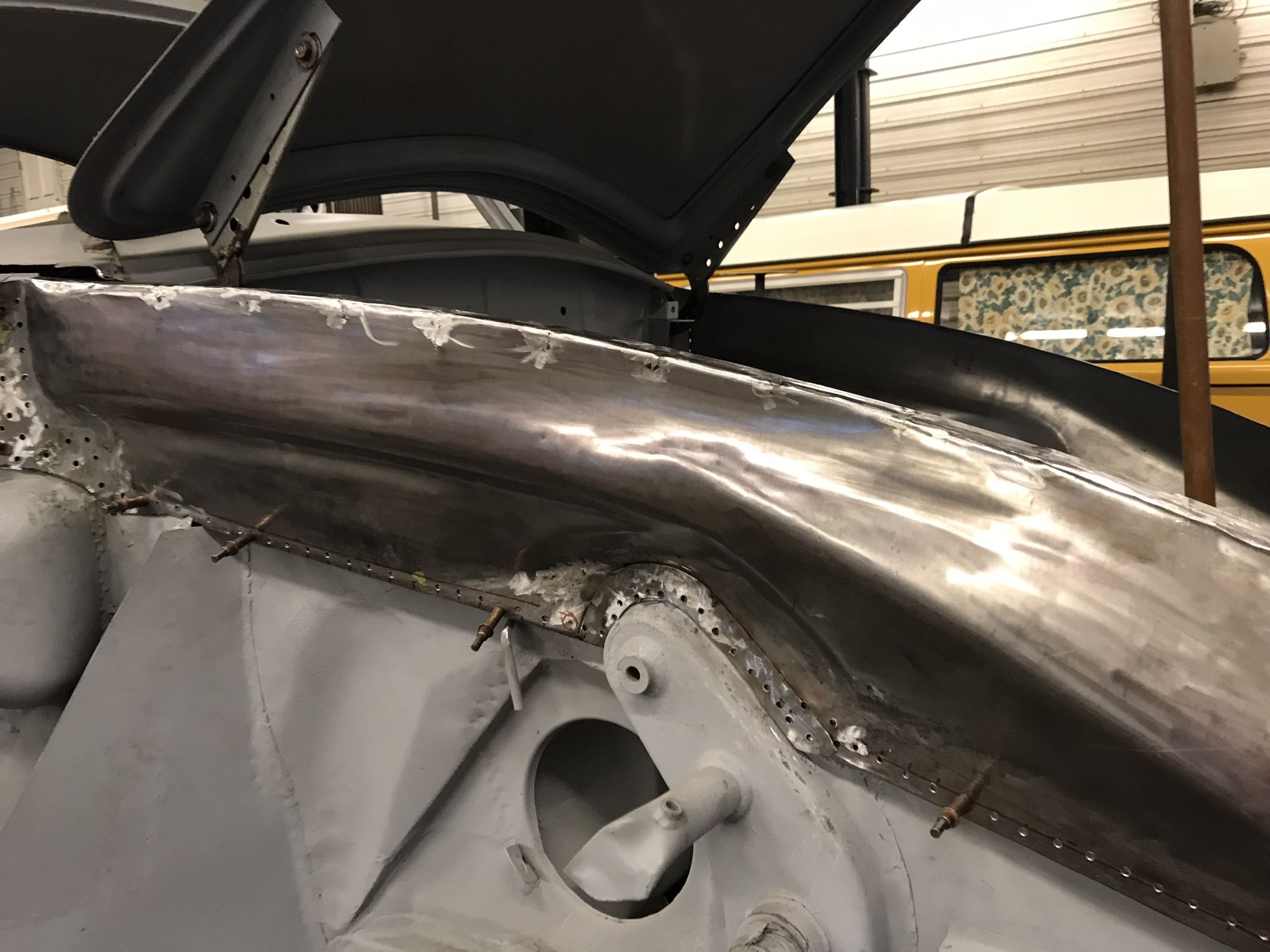

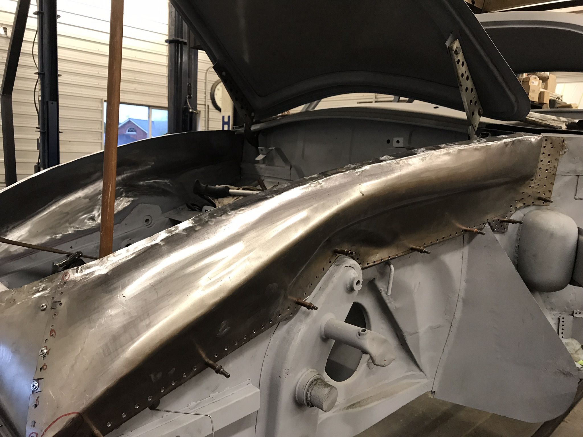

                  • Welding underway along with the requisite grinding
ID:	105694 Click image for larger version
ID:	105695 Click image for larger version
                    356 Registry main thread;
                      Yep, A lot of grinding, I feel your pain. Great work!
                  • So, front inner panels are all welded in and ground down. Having the ability to flip the car upside down and weld the underneath lip was so handy. Also got the inner latch cable tube formed and brazed in. Front hood latch is also in final position and then welded the wing supports. A little masking tape on the top of the latch for the male end to touch and make a dimple helped ensure the receiving hole was properly centred before committing to the finale weld.

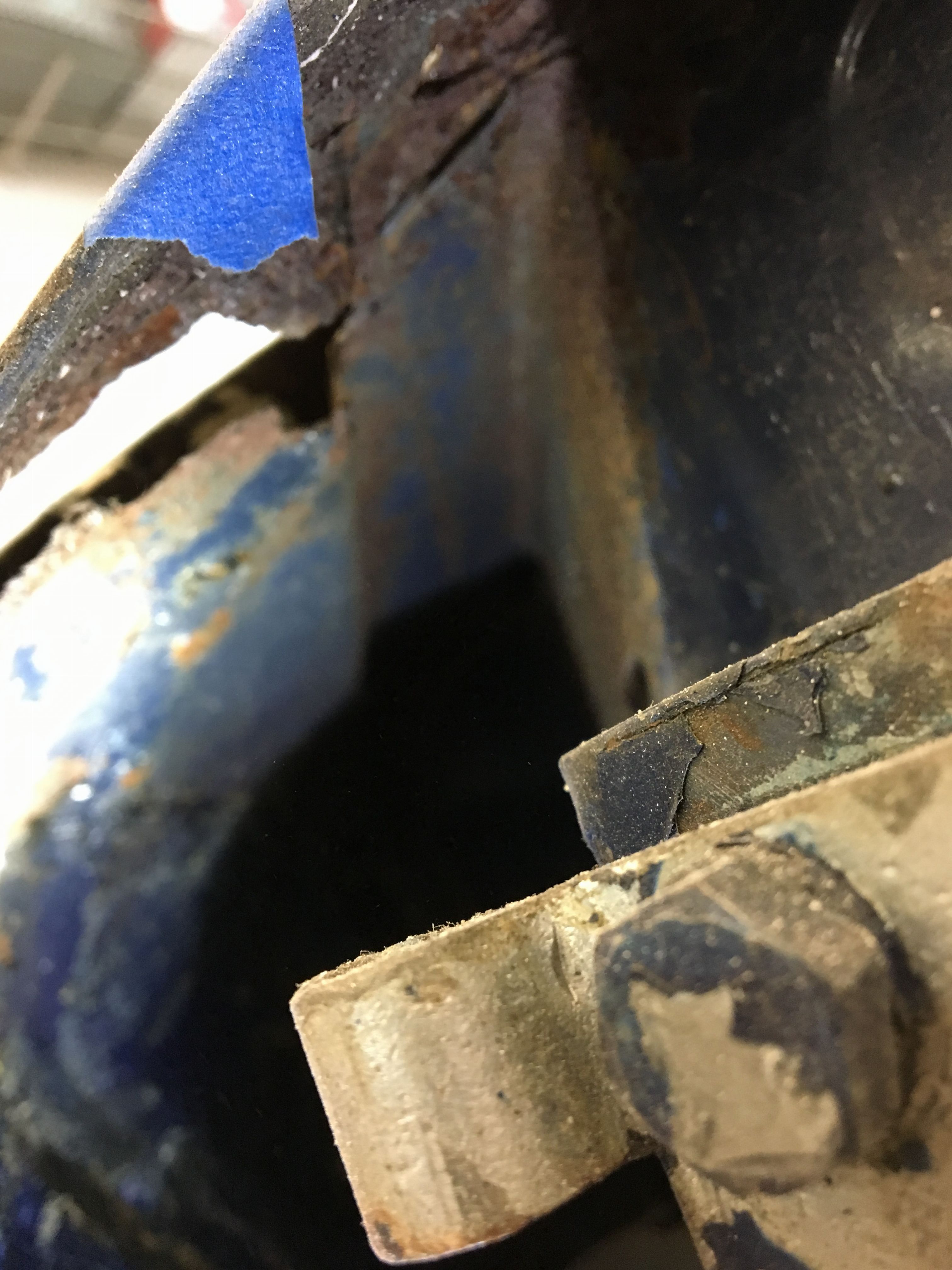

                    • Question - on the inner front panels on the originals I removed there is about a 3/4 inch hole. Any idea what this is for - emergency access to poke a stick in and release a locked hood latch?
                        A ton of welding going on there. All that new substructure is looking great! Scott, take a look toward the middle of this page for some photo loading and display options I think you'll like better: https://www.abcgt.com/new-forum/foru...-amelia-island
                    • Thanks for photo tip. Anyone know what this hole is for.?
                      Click image for larger version  Name:	83EB36E0-DA6A-4956-8862-AEF4CD0FE384.jpeg Views:	0 Size:	506.7 KB ID:	106104
                        In case the pull cable breaks or gets loose that hole is for a fail safe emergency lead to poke through. The examples I've seen are coat hanger to welding rod thickness.
