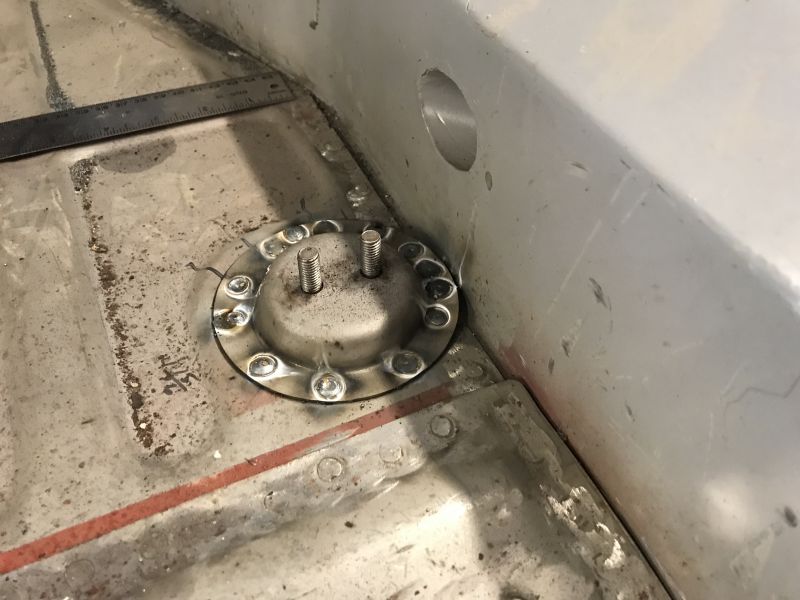

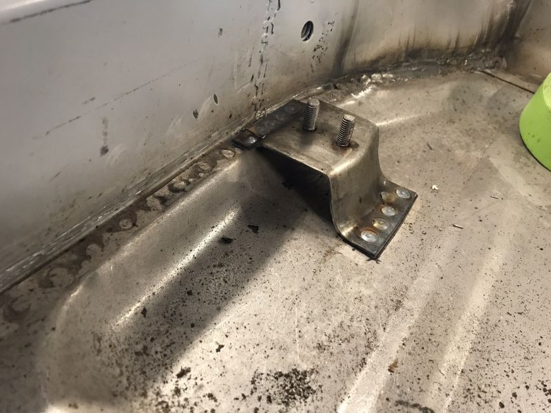

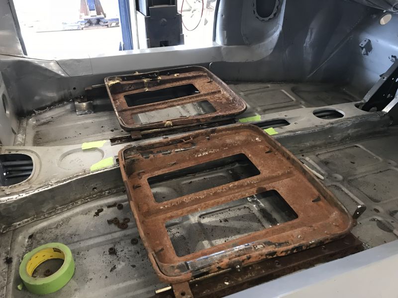

                  • Bruce. Thank you for your detailed response. Took your advice and took the seats apart And stripped them down to just the pans. Truly the best way to approach this where everything goes using the rail on the top of the tunnel as the constant as you suggested thank you. In terms of level the new mounts for two are within an 1/8 so a washer shim down the road will work fine. The key as you suggested is the sliding distance side to side. Mounting the whole assembly together was the only way.

                    • Nice work, looks really good. The humble MIG plug weld is the unsung hero of our restoration work. Yours are particularly tidy. Best regards, John/CT
